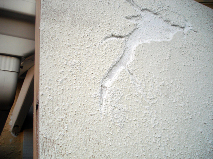

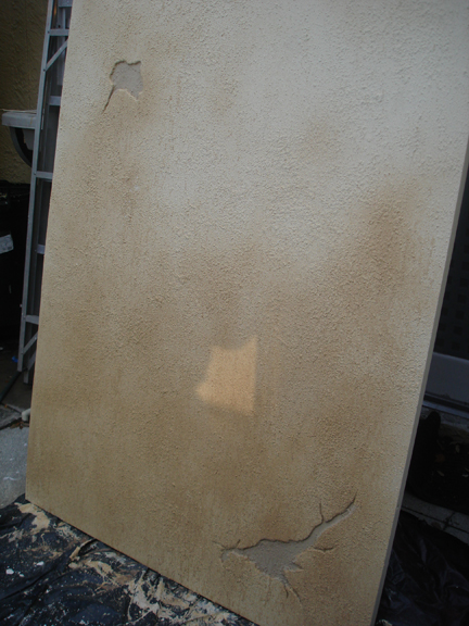

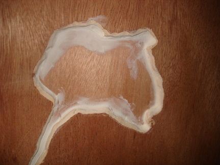

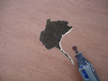

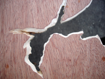

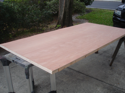

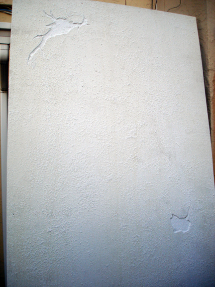

Here's a Tatooine wall set I'm working on. It's only 1/8" thick wood panels on a 2" x 4" frame. I cut out sections and glued a piece of 1/8" wood on the backside to make the "damaged" areas. I painted on ceiling texture to get the stucco look and painted over that with some tan color.
It's very light weight for easy transportation.

Very Nice!
