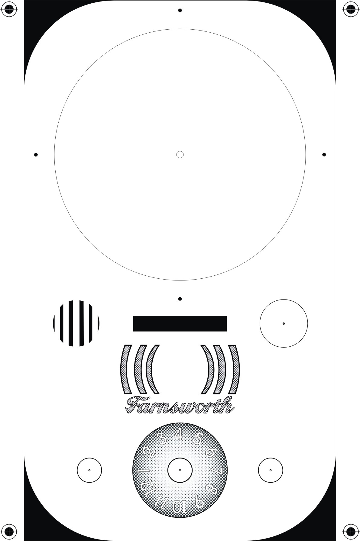

Here's a jpeg of the artwork I produced to etch the brass face-plate. I put a dot screen behind the numbers and as a fill in the Farnsworth logo to make them stand out. I had to redraw it from scratch (in CorelDraw) because my fly tin/case had slightly different dimensions to the original wheatley ones. Obviously, I had to produce this artwork in negative and reversed to print on ink-jet film to UV expose the etch resist coating.

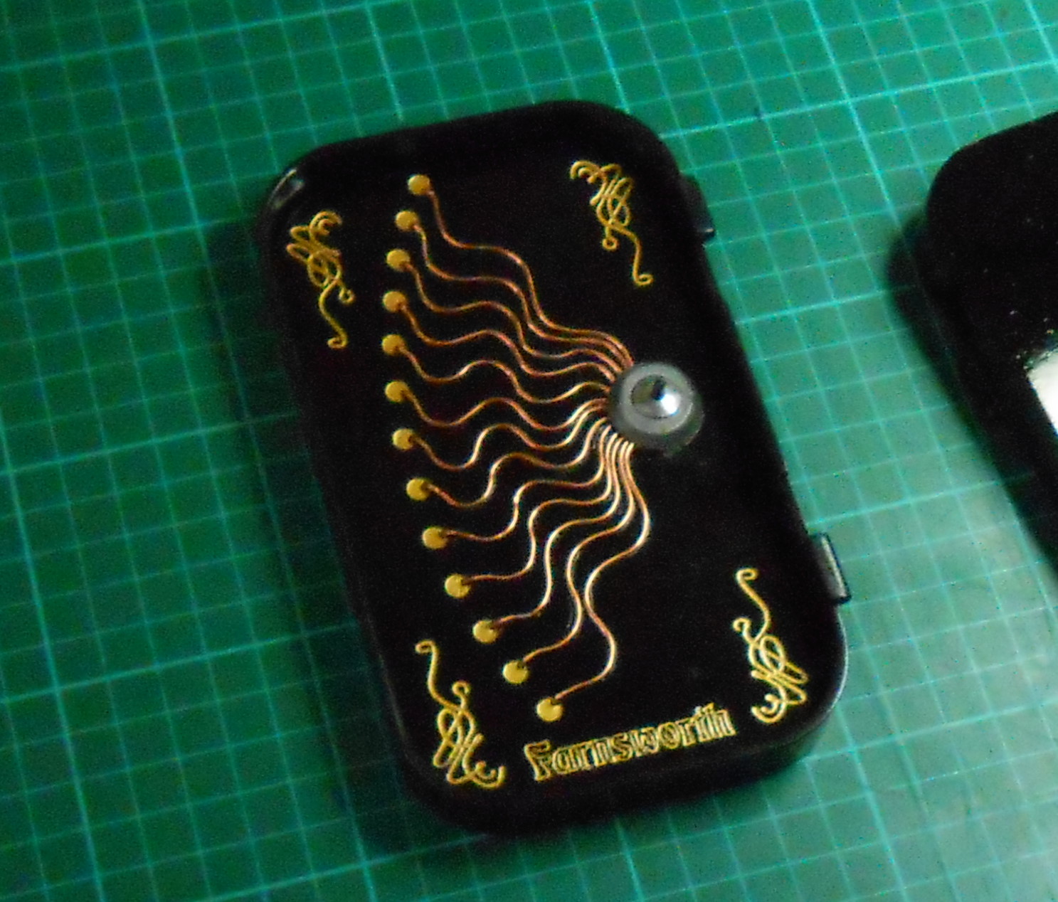

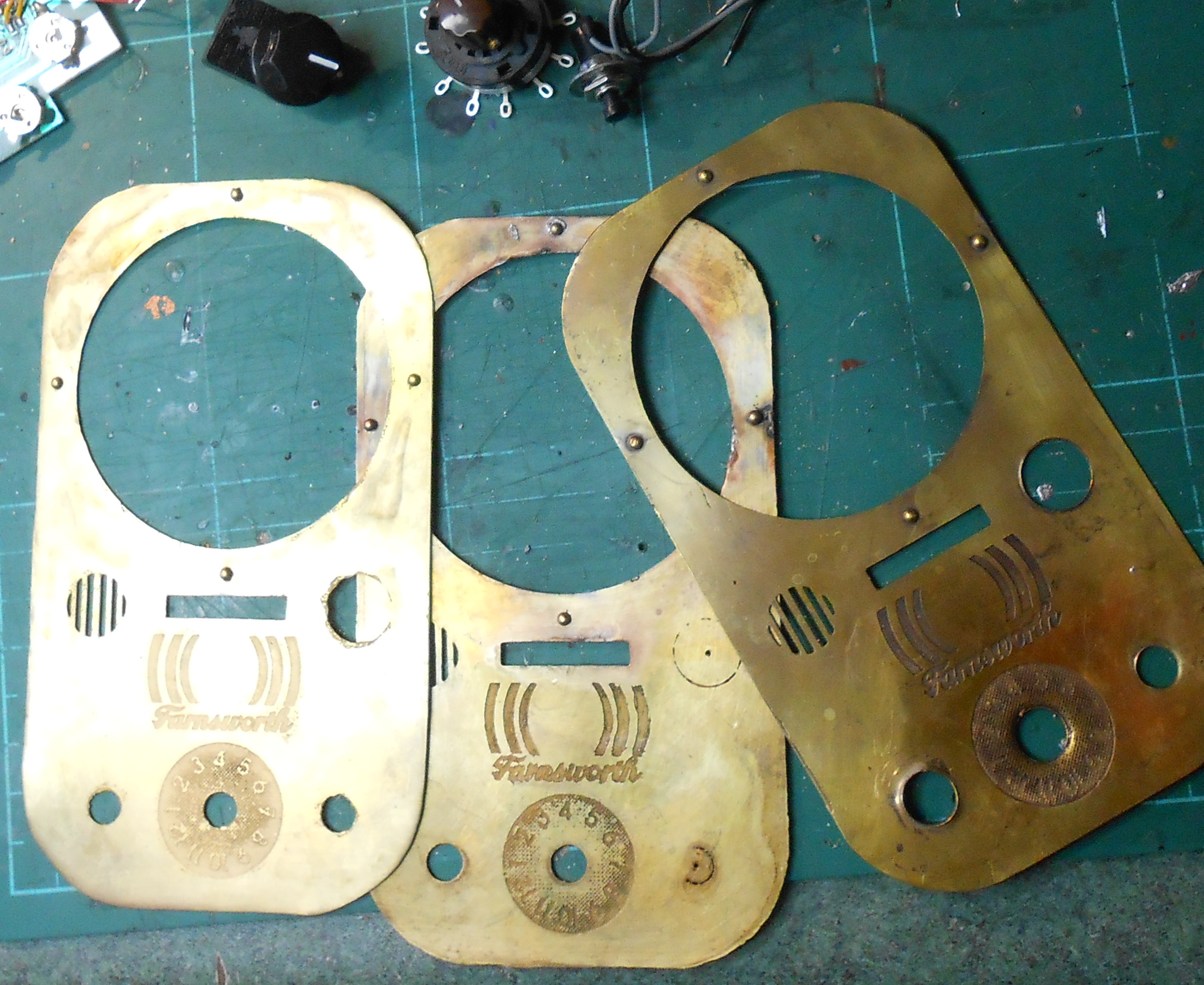

I continue to try to perfect the art of photo-etching brass. Here's a quick snap of the graveyard of reject Farnsworth faceplates I'm accumulating:

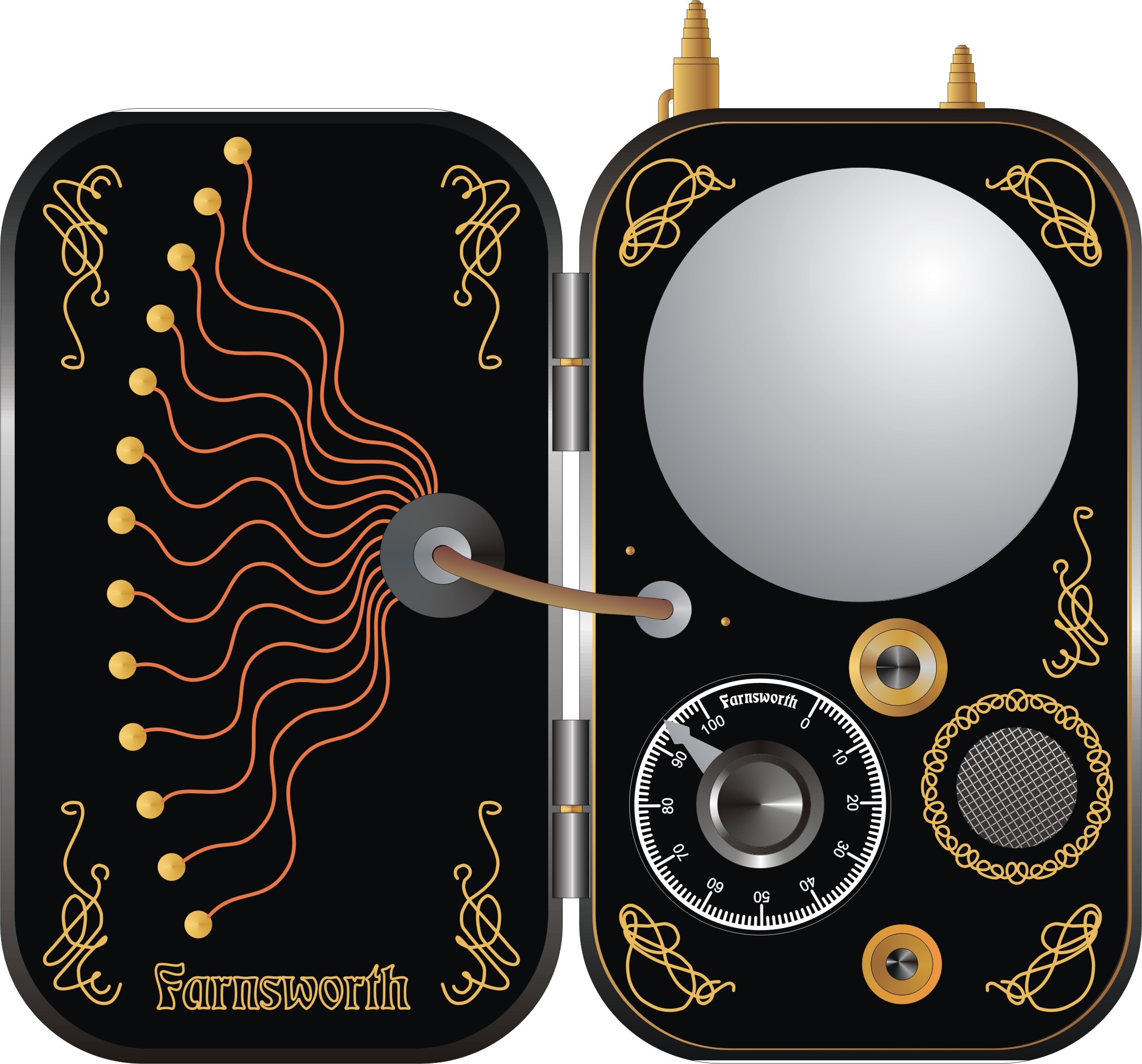

Just finished re-drawing from scratch (using photos & screen-caps) life size vector artwork of 'Farnsworth's Farnsworth' ready to make photo negatives for photo etching plate inserts.
farns-farns.jpg Thoughts or suggestions? (before I go too much further and waste brass!)

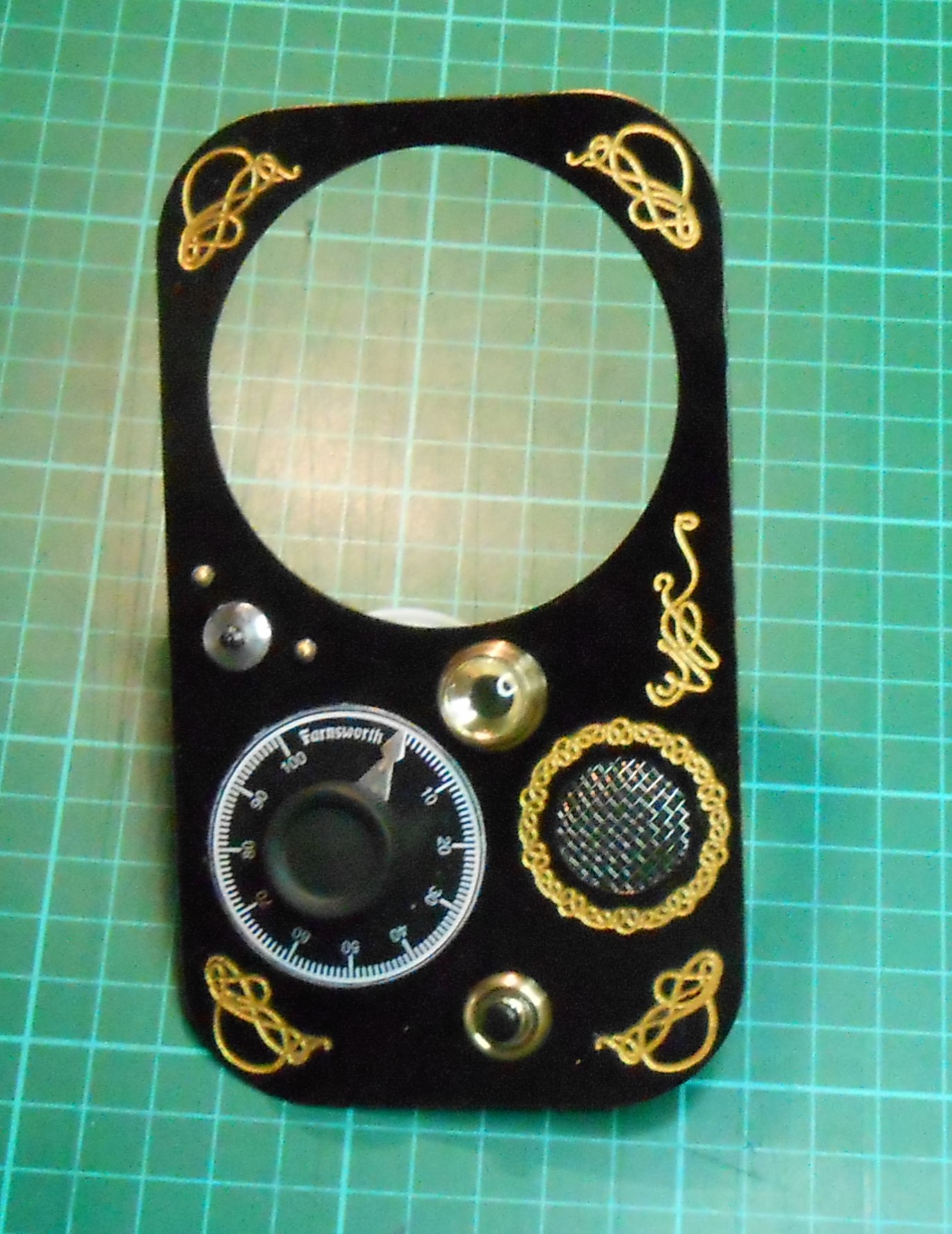

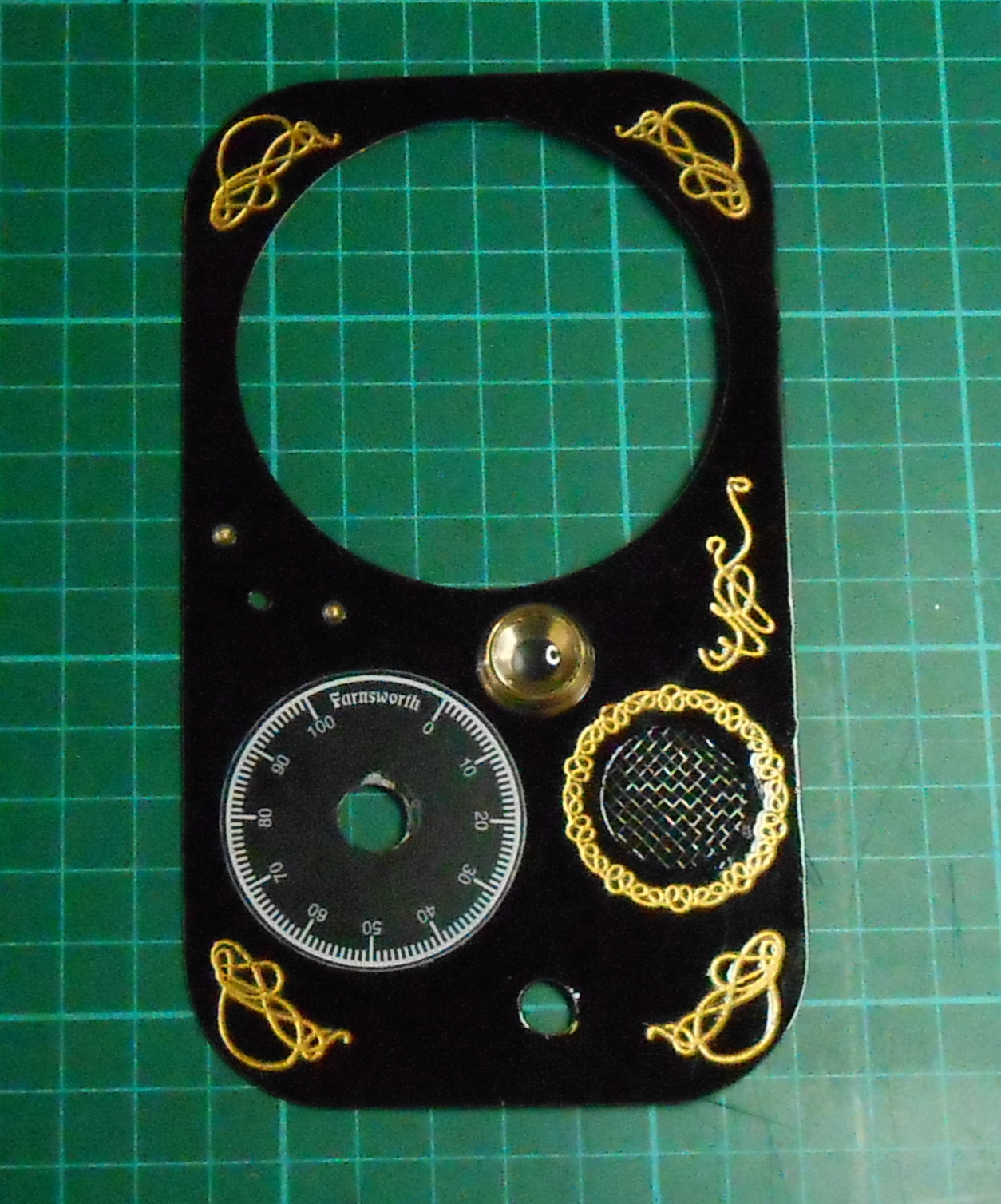

My progress on the 'Farnsworth's Farnsworth' has been considerable, but has temporarily stalled for want of a suitable tft lcd screen, because I can't use the configuration I had in the previous 'standard issue' model that I crafted. I've been posting my progress on Tumblr, so you can search the hash-tags 'Warehouse 13', 'Farnsworth', 'show prop', 'working replica' and 'Claudia Donovan' on there if you're interested. But here's a few pics to whet your appetite:

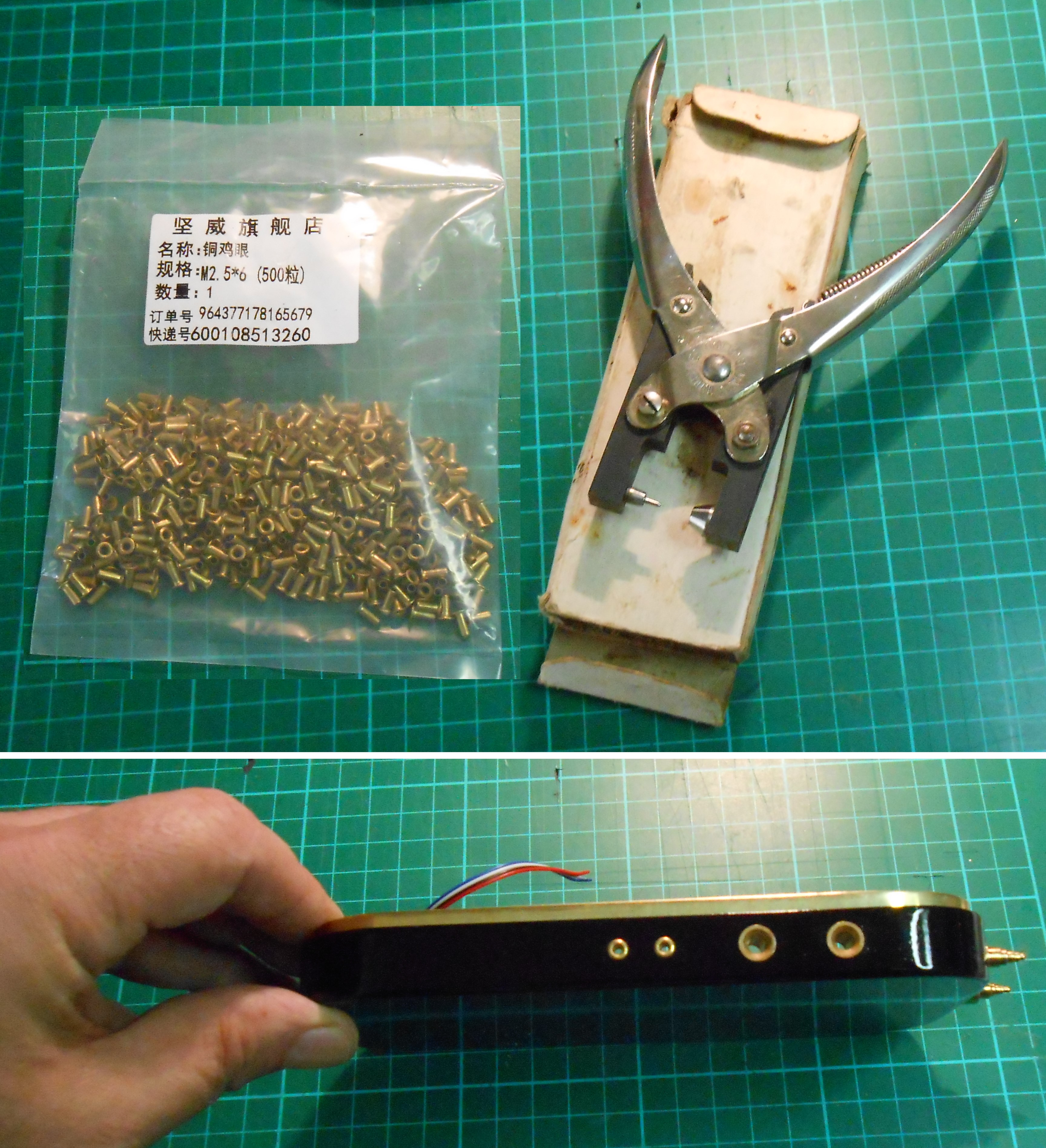

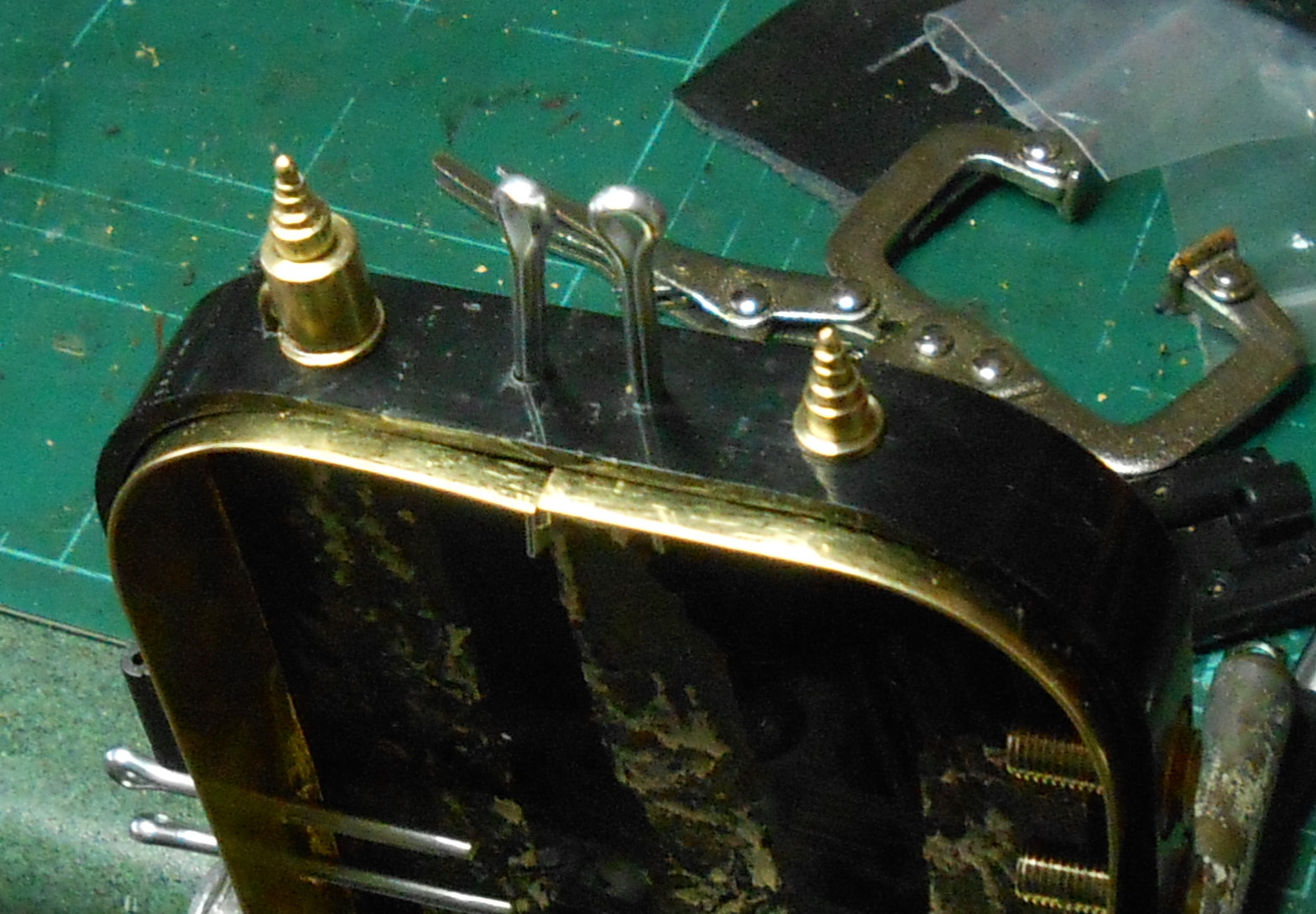

I've just posted my latest report on Tumblr, but to share with you guys here, the supply of tubular rivets finally turned up from China. With the aid of the vintage tool I found by accident on Ebay (and picked up for a bargain price), I had the job done in under 10 minutes. They all went in as sweet as a nut, and the crimping pliers made a neater job than setting them by hand with a punch and anvil. (I foresee many riveting projects in my future - just for the sheer joy of using these pliers!). Now, do I paint them black, to stick strictly to the show prop, or do I leave them bare, to enhance the ‘brass on black’ theme?
