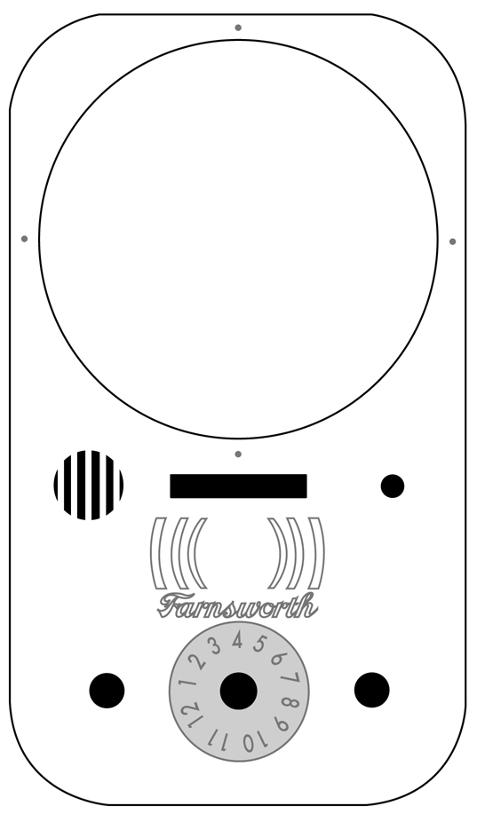

I apologize I haven't looked through the thread very much but its just a quick question. Does anyone know what Lens to use/ how to get one and does anyone know of anyone still making the custom faceplates? Anyone know of a printout for the faceplate? Debating cutting and tracing with an exacto knife and pen before cutting into metal just to get the placement right. My goal is a non-functioning one and if it comes out well I may go more advanced for my next one.
Thanks,
As far as I know no one is currently making runs of faceplates. There is a drawing you can use to make the faceplate here in the thread. As far as a found lens that info is in the thread too. You can use 80mm watch glass (laboratory drying glass) or an old Ford radio dial glass ('36 or '37 from memory). Details should be here too.

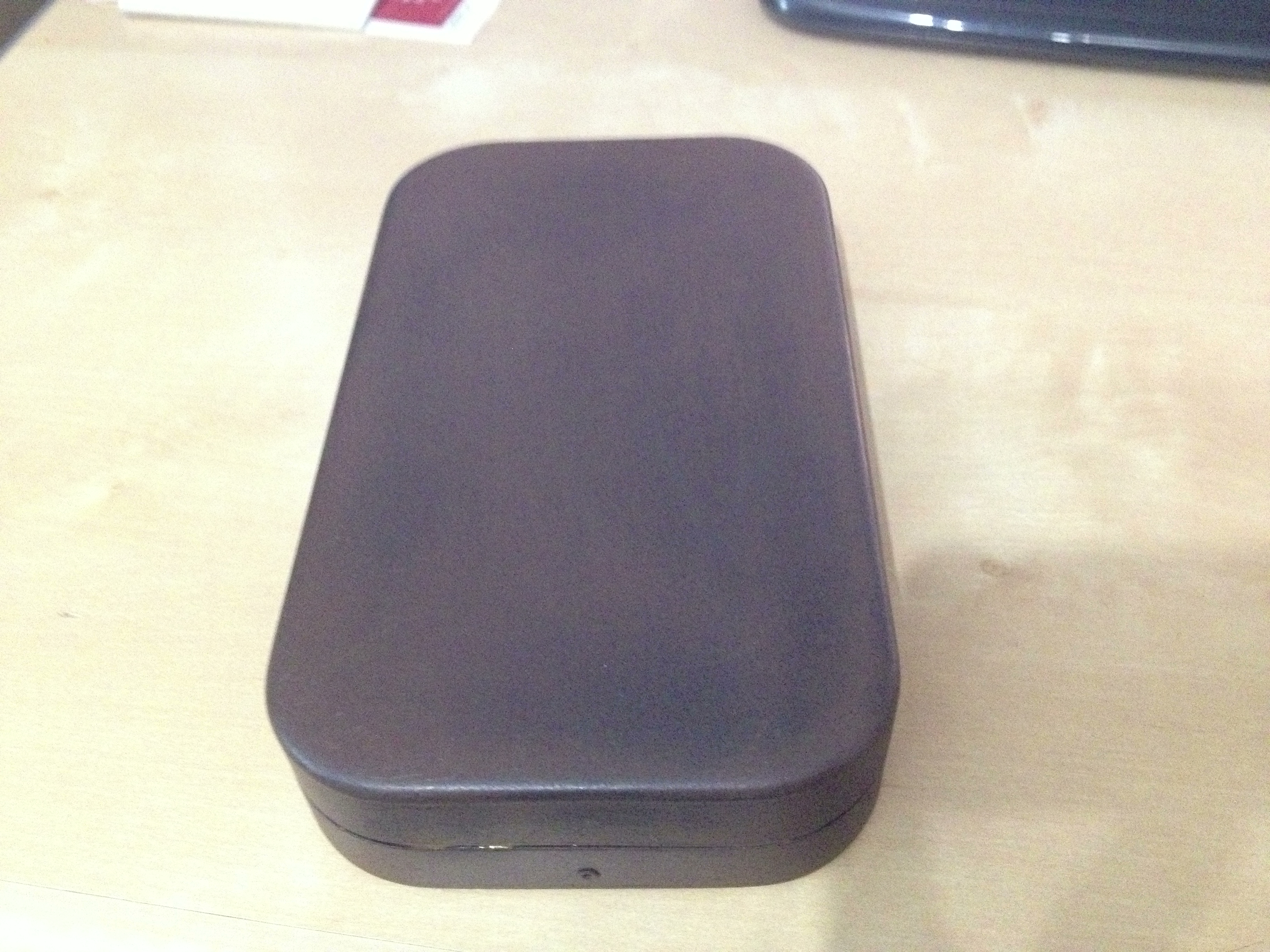

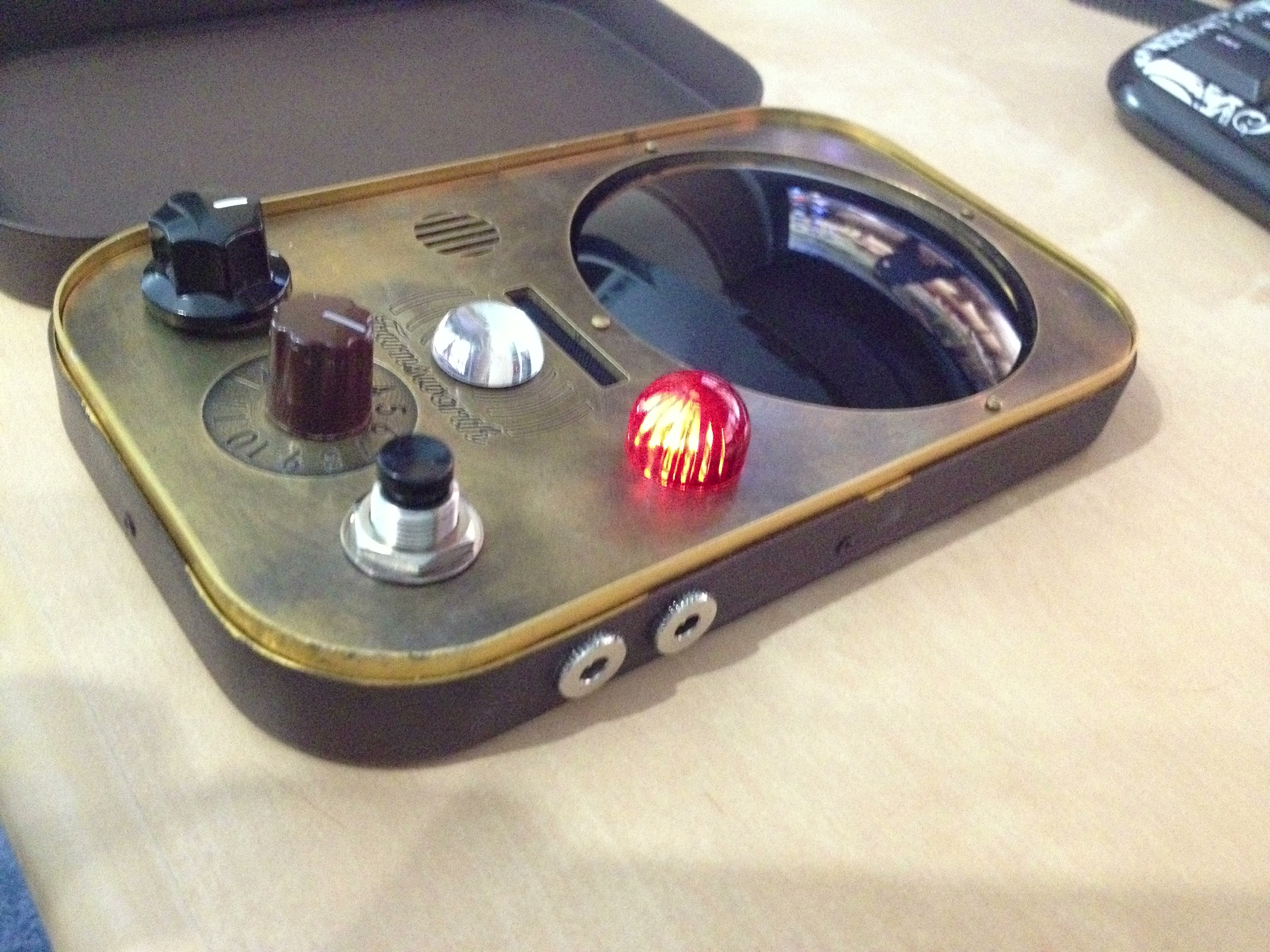

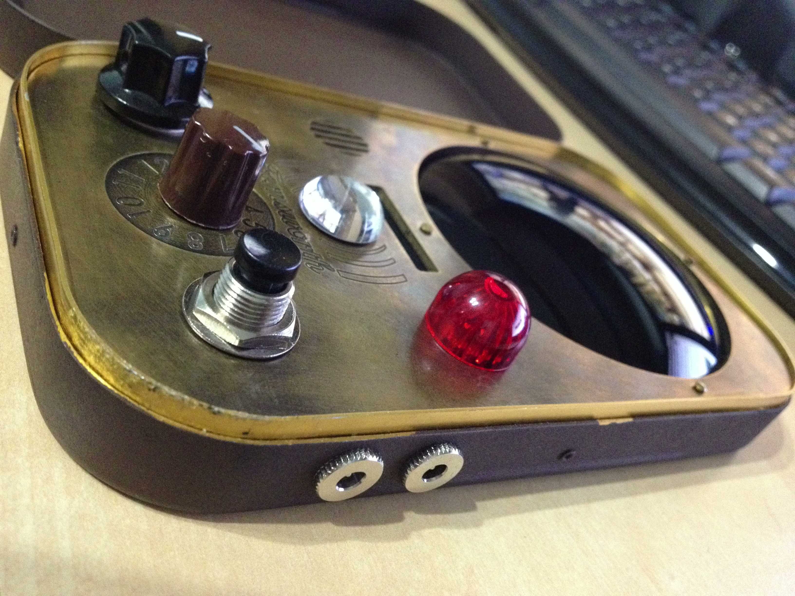

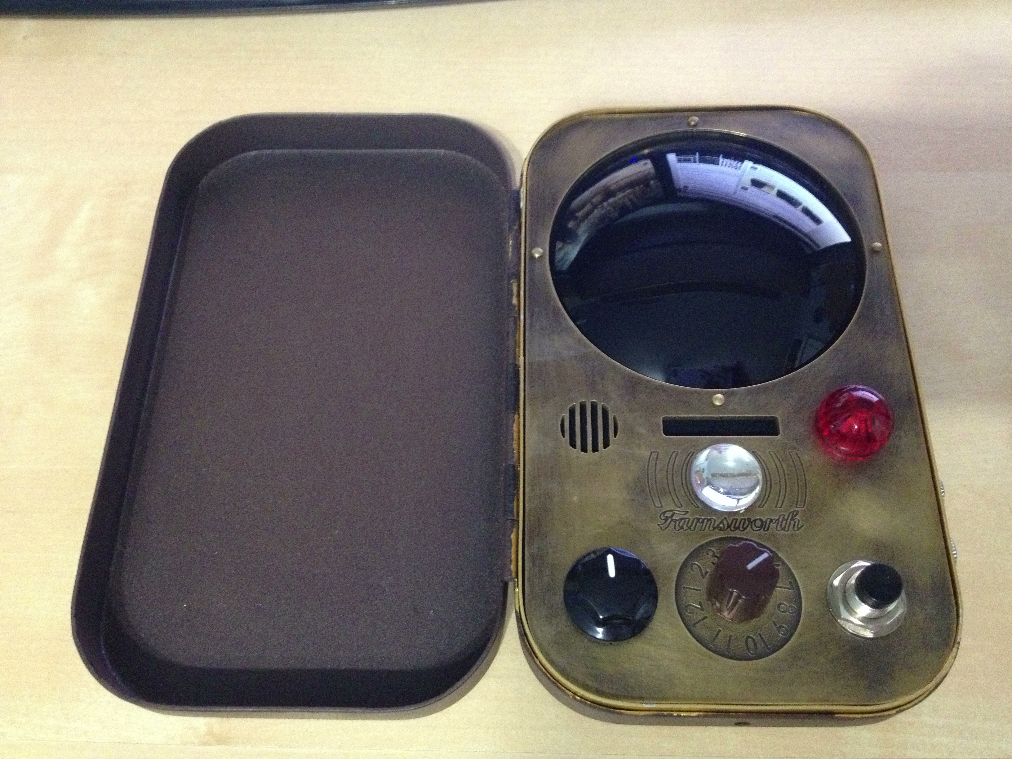

I know I'm late to the party now we've seen the last episodes of the show, but I've been following this thread for years whilst developing my own 'tribute' working Farnsworth. O.K., not working as in communicating with other units, but it does play videos, has a remote control 'ringer' and is rechargeable from it's own charger or any USB source.
After many false starts, I've managed to cram in all the electronics, both 'home brewed' circuits and commercially available ones, and an LCD screen. I guess if a picture paints a thousand words, then I should post a video to show it off in action.
I look forward to your comments and questions. I'll do my best to help.
WOW.. that simply amazing! Great work on the Farnsworth BeachcomberBob :thumbsup
Looks realy, realy cool... simply like the "real thing" congratulations :thumbsup
Many thanks Murdoc.
I suppose I should explain that the cable you see at the beginning of the video is only used for attaching to the universal 'Worldwide' mains charger, and the one in the packet at the end is the full USB data cable for use in case the embedded videos ever need replacing or changing. When plugged into a PC, it's simply seen as an external drive. I just didn't know when to stop :lol

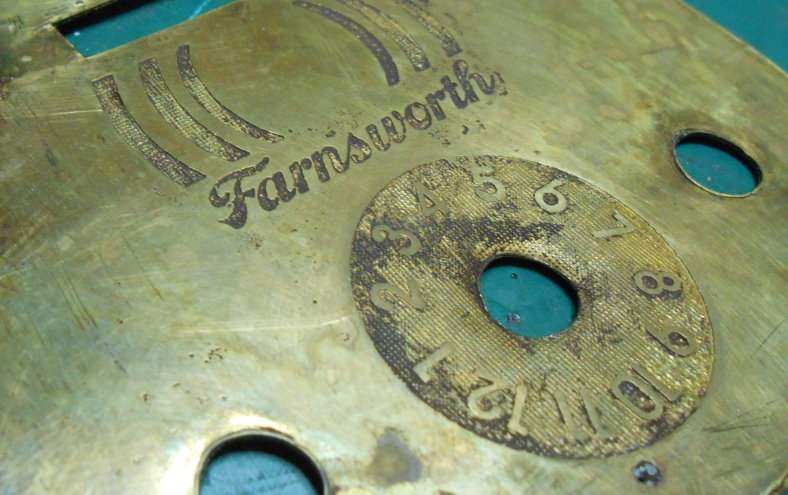

Without access to a laser, I had to photo etch my brass in one go like a p.c.b., including all the holes and slots. Tip: To 'antique' it, try leaving kitchen paper towel, soaked in caustic soda solution, in haphazard clumps for a few minutes. (Make sure you rinse well after - and wear gloves!)
