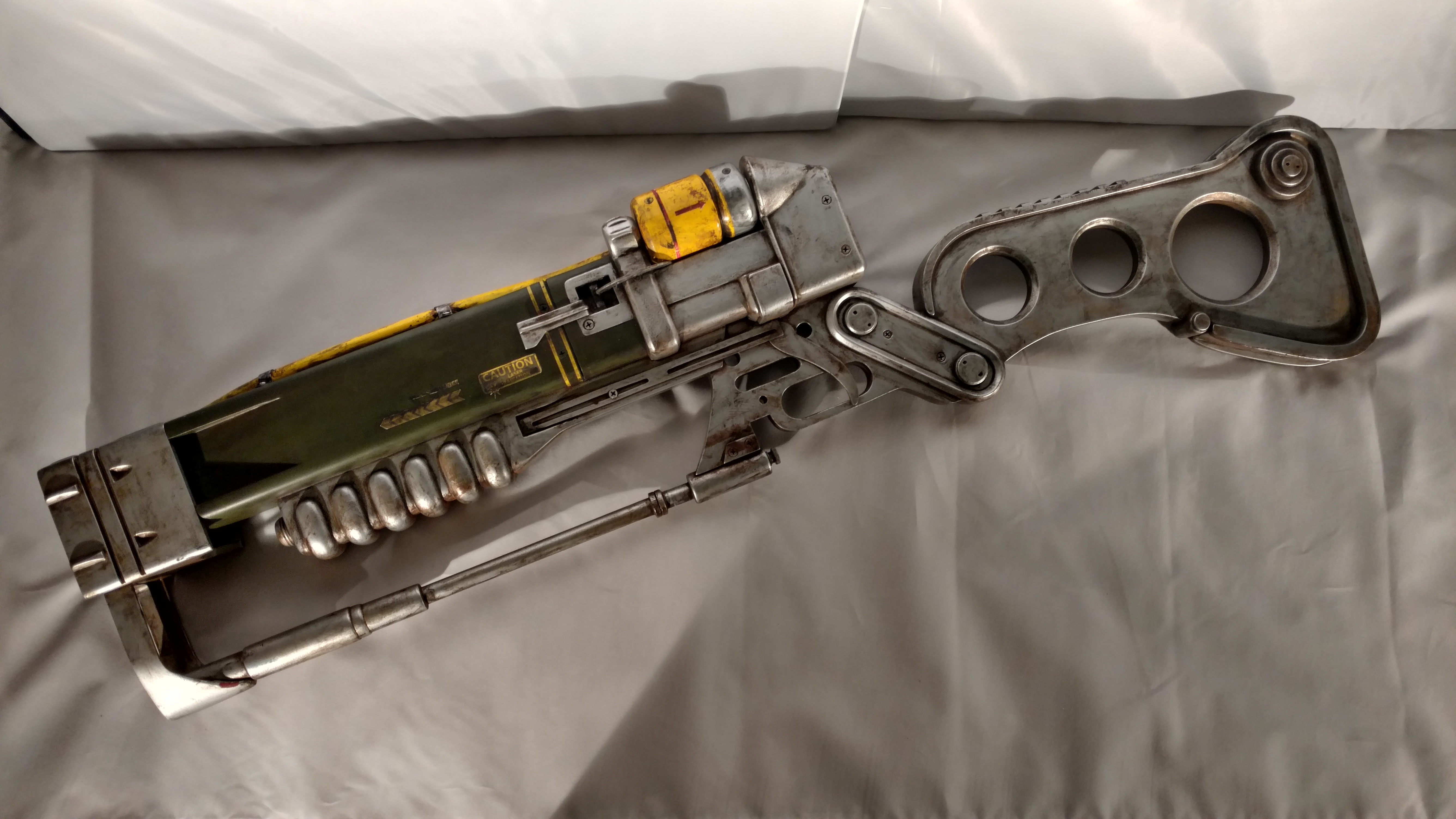

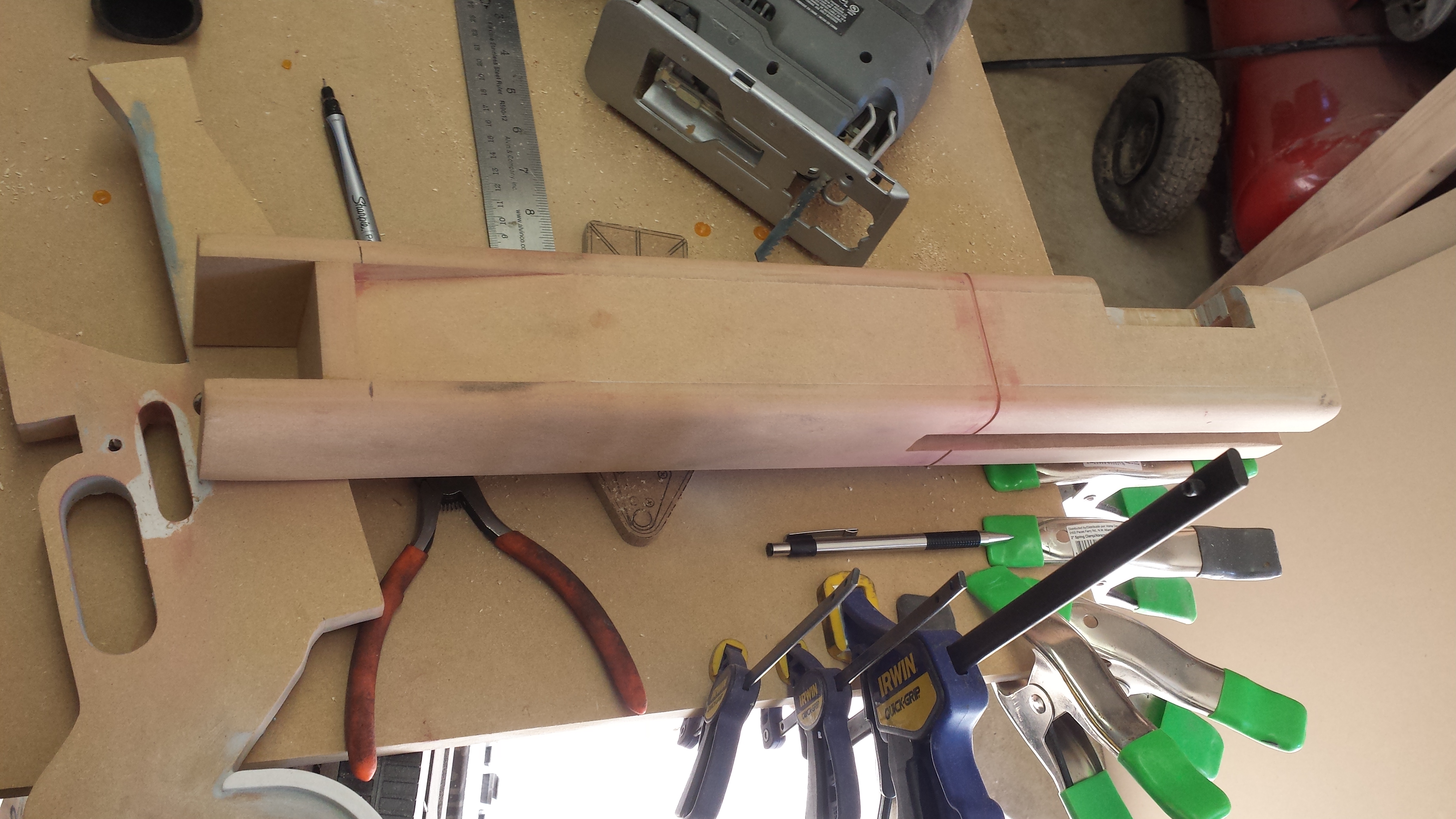

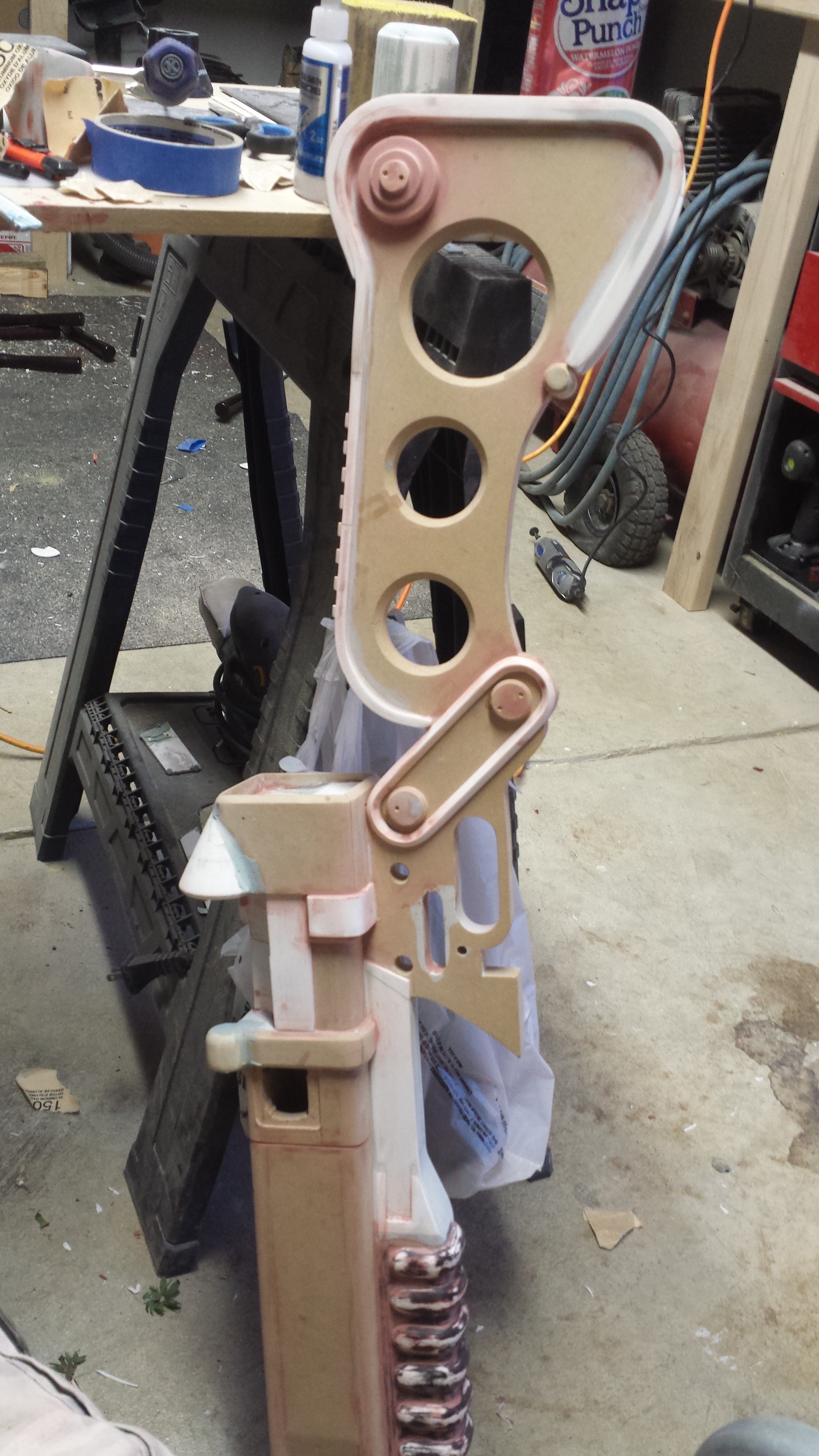

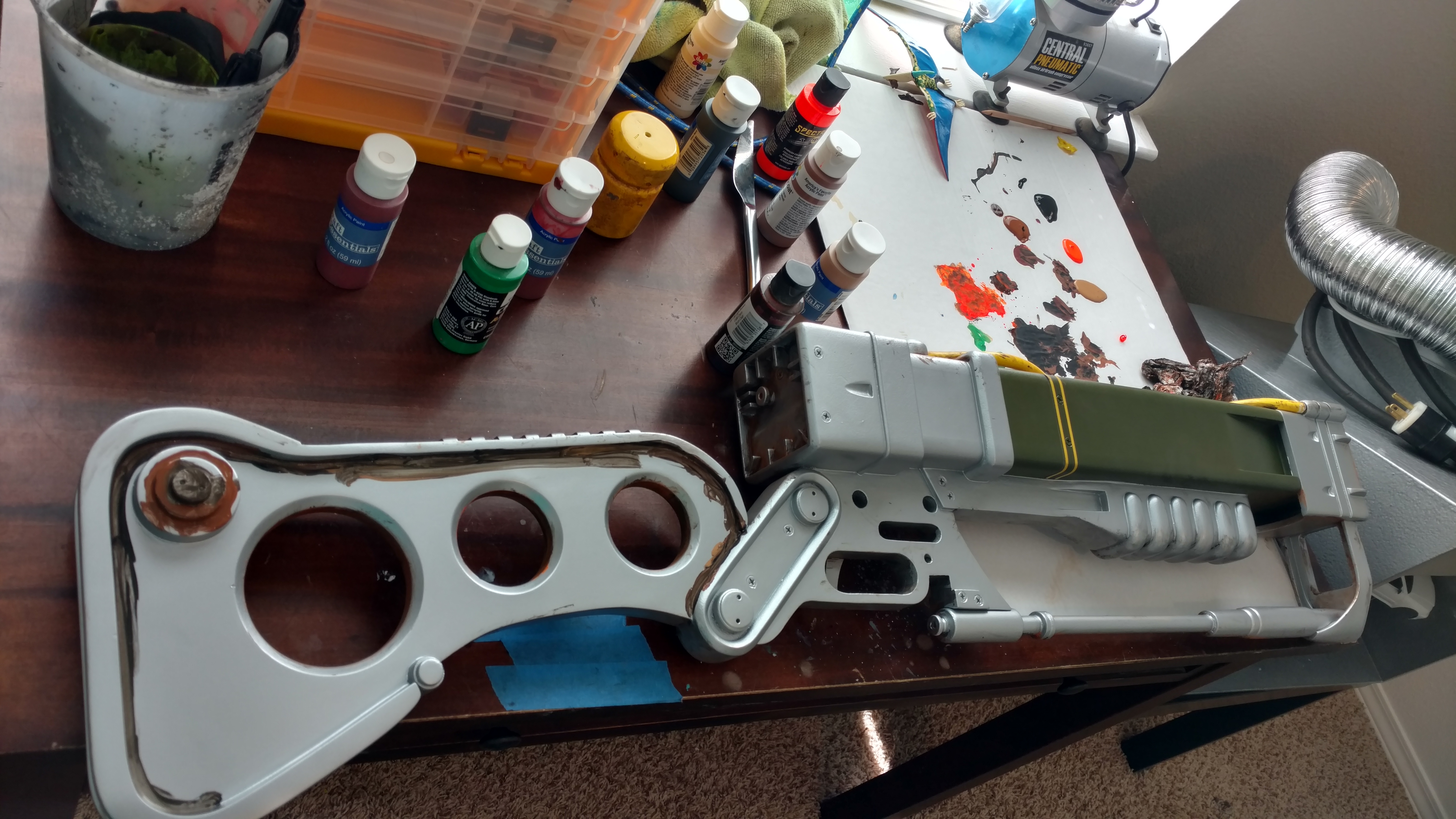

Just recently finished this project and wanted to share. Took a few pictures along the way of the progress. Let me know what you guys think
Here is the finished product, but I put some pictures of the build below for those who want to see
IMG_20160531_140725775.jpgIMG_20160630_152218712_HDR.jpgIMG_20170316_241907098_HDR.jpg
Holy crap that looks incredible!!! The edges all look really clean and the paint looks great.
