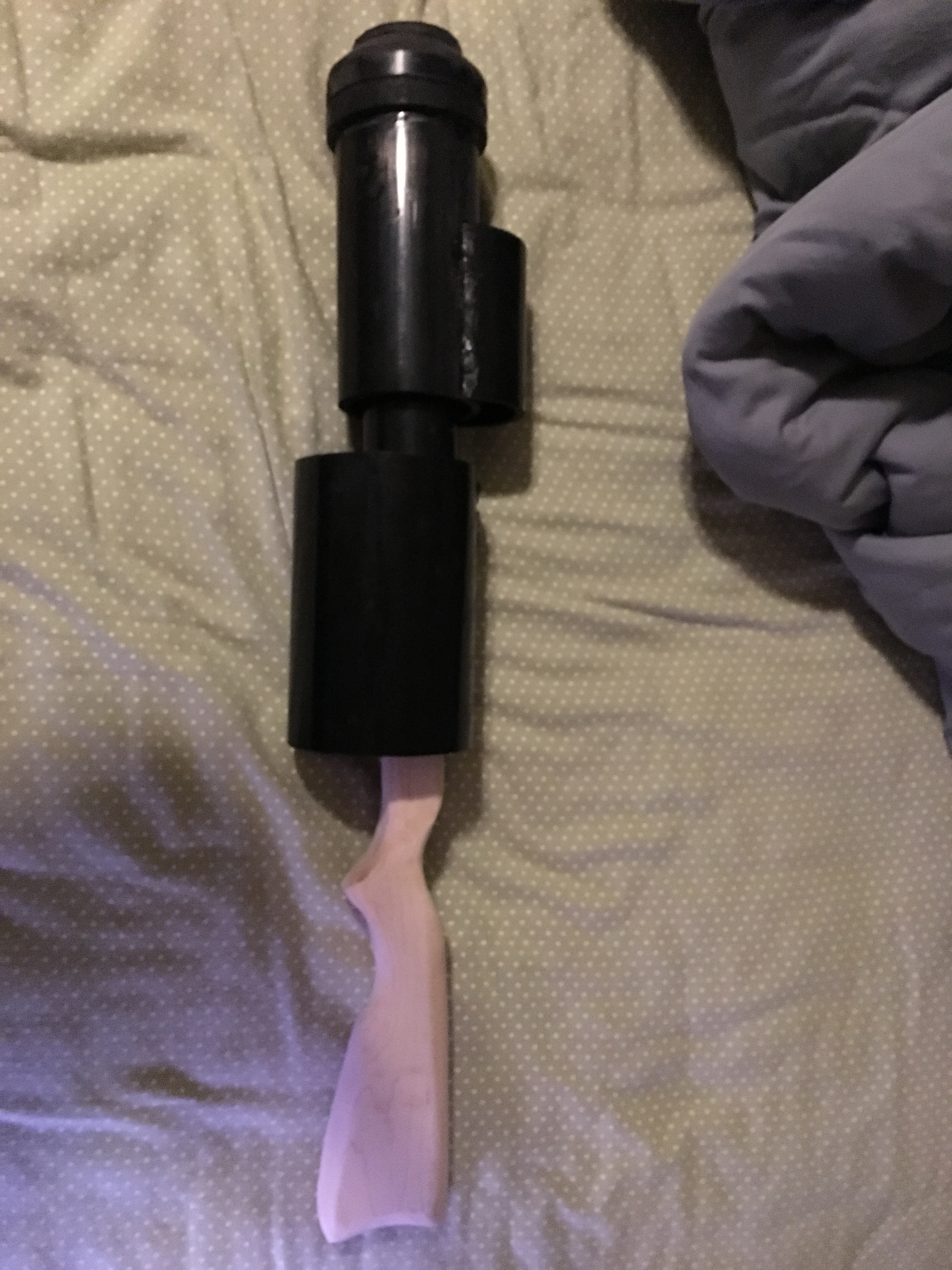

Some Progress shots i took today. Kinda dove straight into it. I grabbed 2 foot long pipes of 2" 3" and 4" abs and welded them together in the muzzle configuration.
Still need the top piece on the main body to finish off the core of this build. The stock I made out of maple wood (which was the stupidest thing i have ever done. It took me so damn long to saw through all that and twice as long to sand it all down.) It is pretty cool because the maple tree is native to the Boston area, so that made me happy at least. All in all this whole build has probably taken me 7 hours in total so far. I bought everything new so the price was a bit high at around $70 in materials. Still needs a LOT of work and even more clean up, but I'm satisfied with the progress i have made. Let me know your thoughts!,

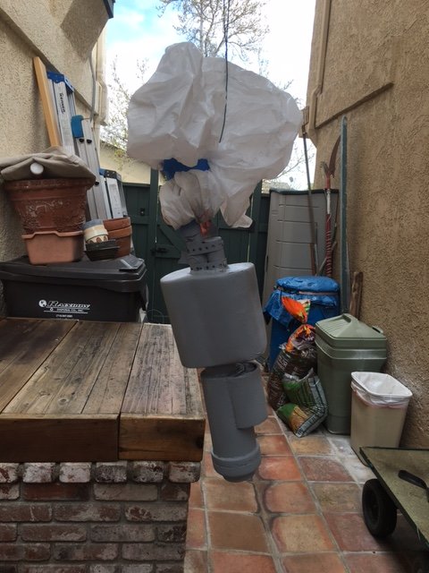

Project Update! I'm still going! I've been pretty busy otherwise so its slow progress. But still progress! Finished fiber glassing it to shape. I took Floral foam and carved out the top of the canister. Then i covered it in packing tape and fiberglassed it on. It took around 3 coats of fiber glass and many many days of getting those damn shards out of my arms. IMG_3977.JPG
Then i painted it with a sandable grey primer. It wasn't all the way filled so i took some spackle and filled in the rest. Painted that grey as well.

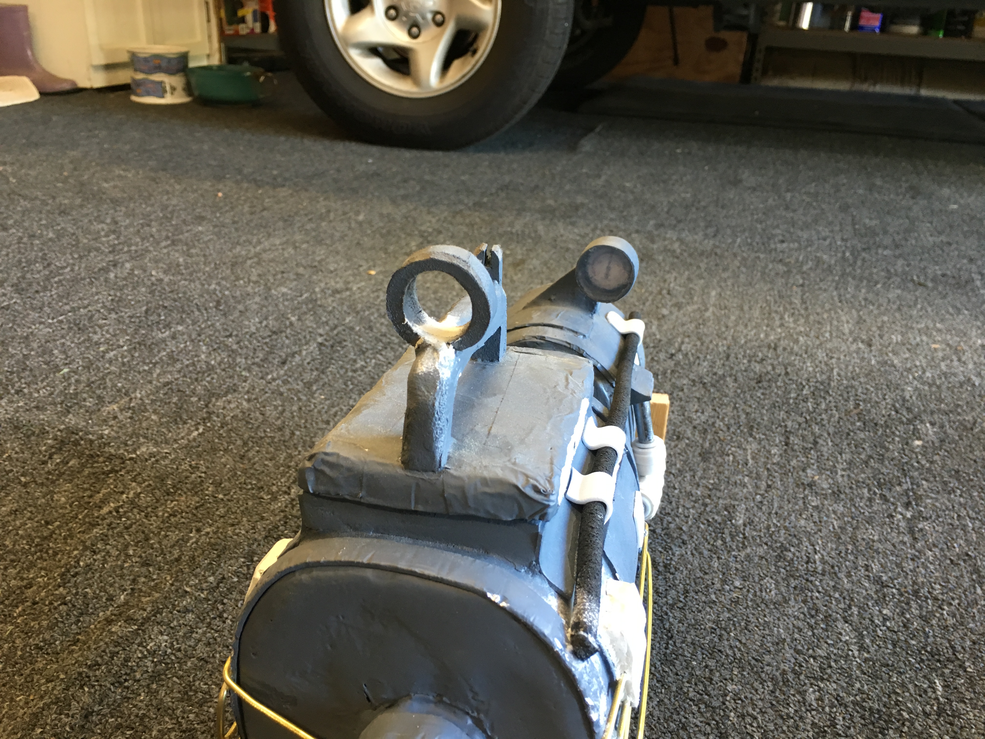

Then came the trigger. This was fun to figure out. The trigger itself is a piece of aluminum that i bent over a bench vice. Then i sanded down the end to a point and drilled a hole through it. The part that connects to the main chamber is just a uniball pen cap around a screw. Inside is a spring that is compressed when the trigger is pulled and shoots out when released. I had to sand down a nut until it could fit inside the pen cap but keep the spring in place.

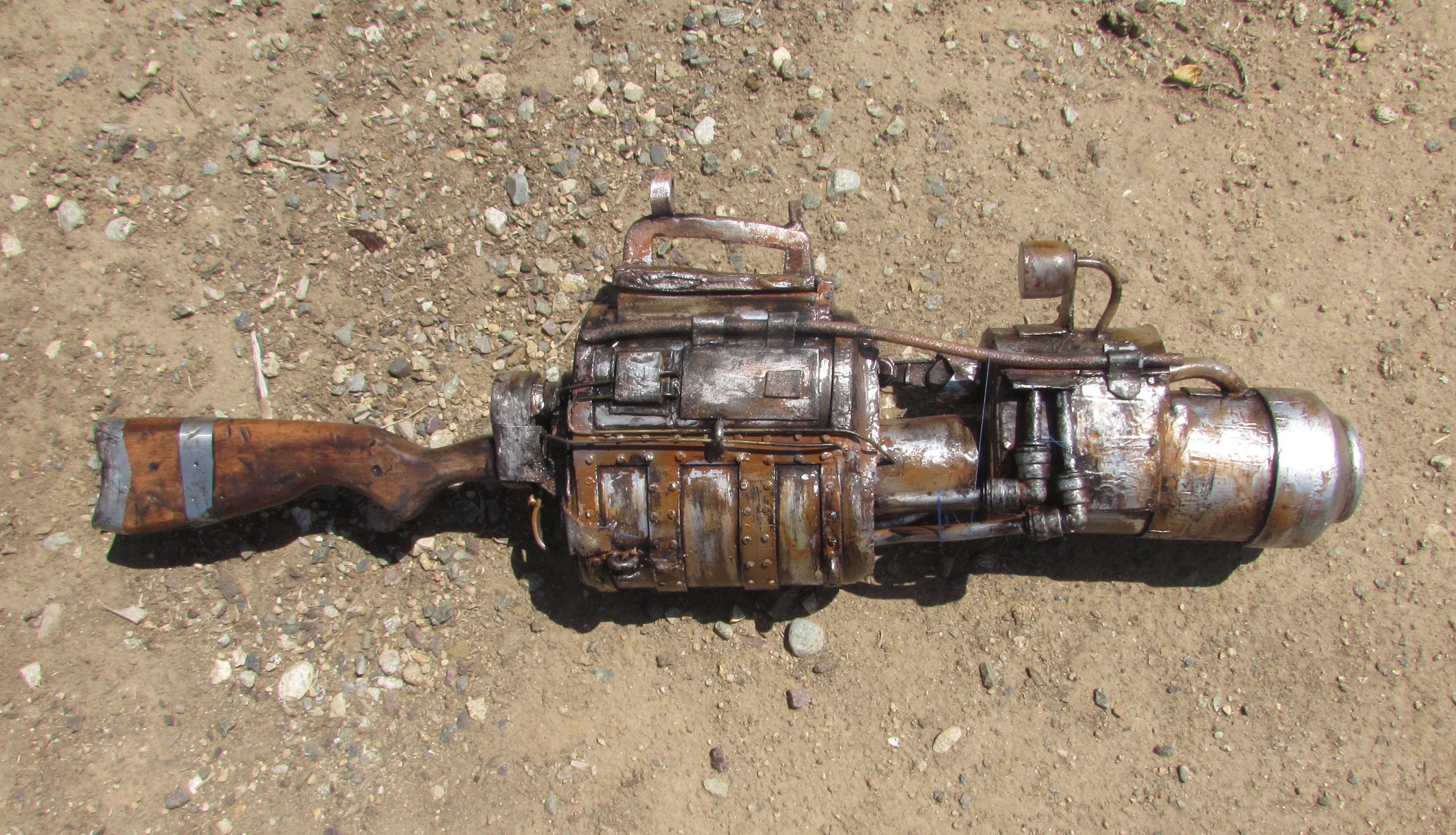

My friends, after many many months of work. I'd say this project is 99.99% finished. Now no it isn't a perfect replica. But for my very first project and introduction into prop making, I like to think i did a pretty okay job. Im sure this thing is RIDDLED with apprentice marks, but I do hope you enjoy it for what it is. At least a little! Thanks for staying interested :D1.jpg2.jpgIMG_2573.jpg4.jpg6.jpg5.jpg
Very cool build, I like the aging quite a bit. I am almost done my Anti-Materiel Rifle, Needs a scope but Fallout builds are always fun, since most things that are in game are built after that war and It makes mistakes seem intended haha.
That looks awesome! Yeah fallout builds give you some wiggle room when it comes to messing up. Cracks/bumps/rips look natural and intended most of the time. anything post apocalyptic seems like a good first build.
