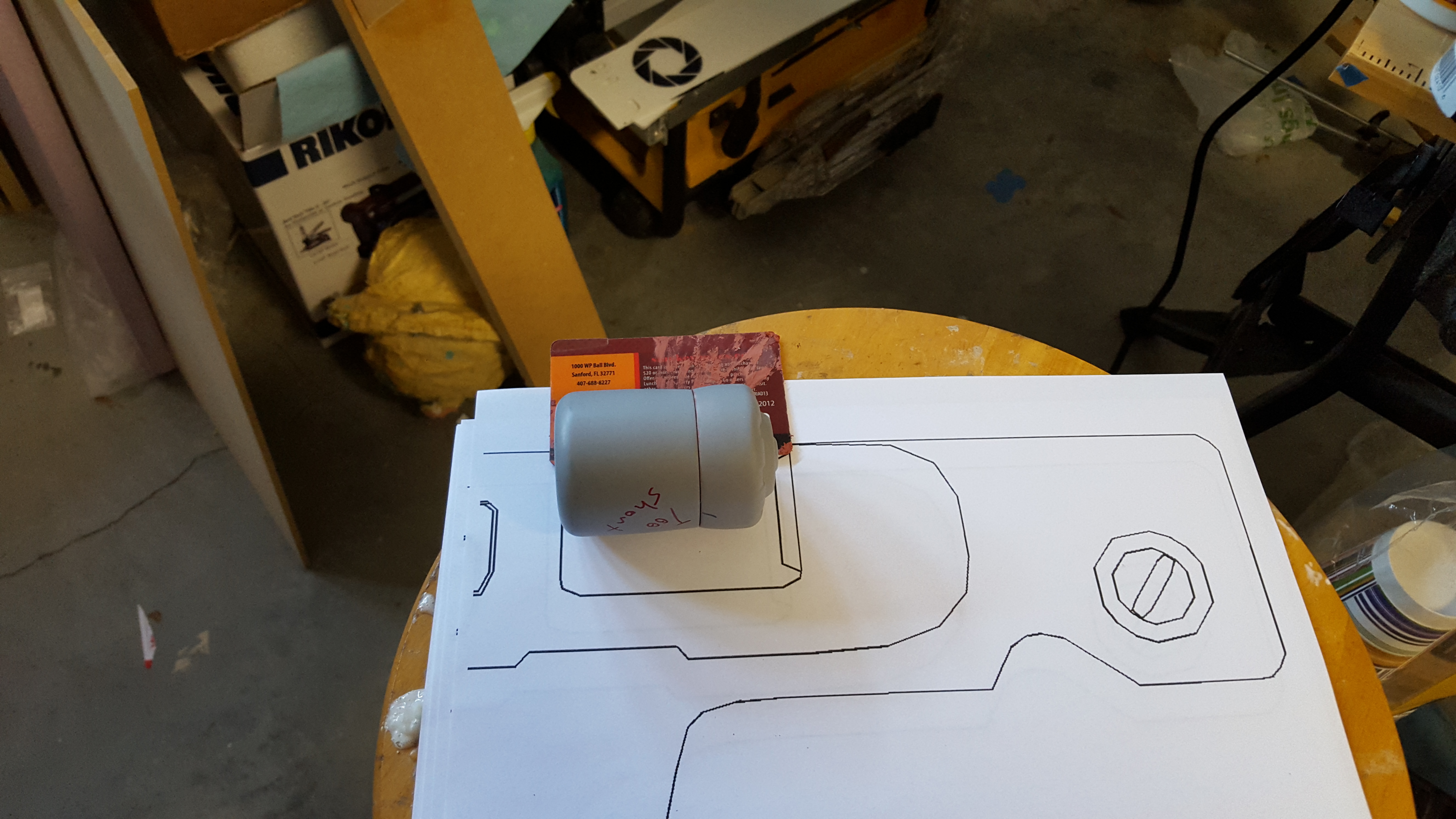

It's bad enough that I do not work on this on a regular basis, but to make matters worse I seem to have to backtrack a lot. I printed out blueprints for the Institute Pistol and thought, "Let me put the fusion cell in there and double check it fits. It doesn't.
The length is 3mm too short. I tracked it down the the longer part, the cathode. So I adjusted the model.

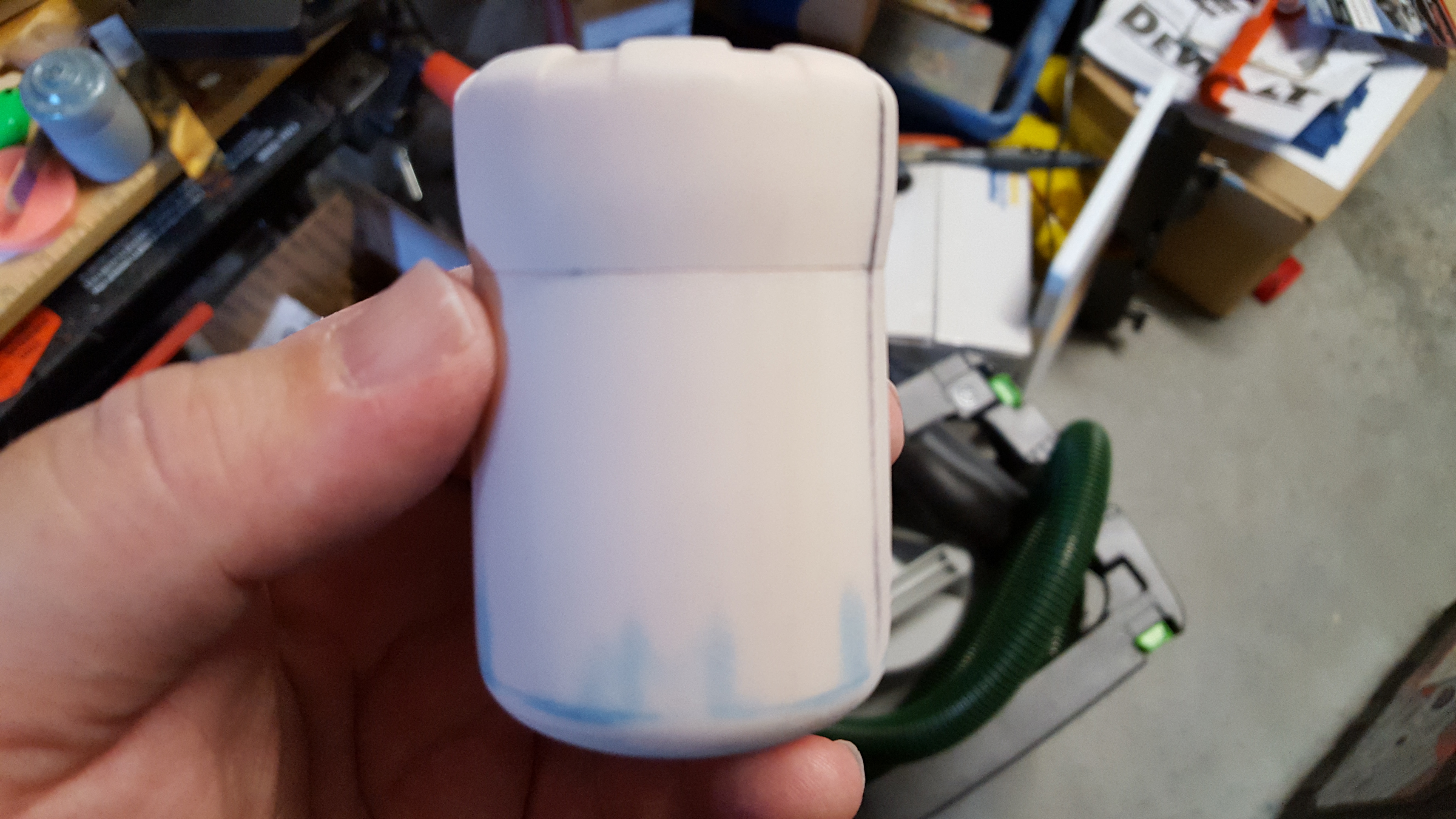

One of the problems I noticed was that when I sanded down the previous parts I rounded over the edges slightly. It's not horrible, but I really notice it.
So I printed out some caps that will go on the ends while I sand.
An hour of sanding later the cathode is pretty smooth, but there are some spots that will need to be filled on the bottom. I put the anode on for a comparison. The anode obviously needs a lot more sanding.

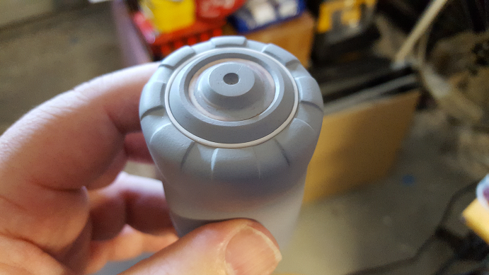

Did some puttying and sanding. The lines are because I keep having these visions of a circle with a line through it. Sorry, Independence Day joke. I use the lines so I know when I have made a complete revolution while I am sanding.
Here are the parts right now. Or this morning actually, I dusted them with primer and still have some more filling to do.

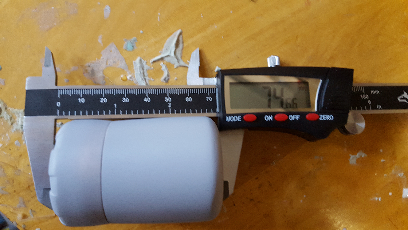

I was aiming for 75mm. So close. I can live with it.

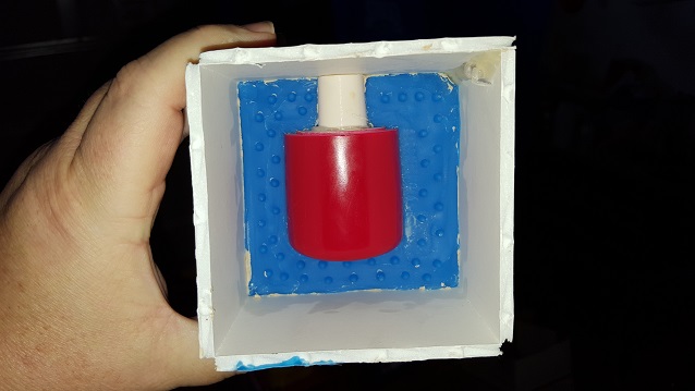

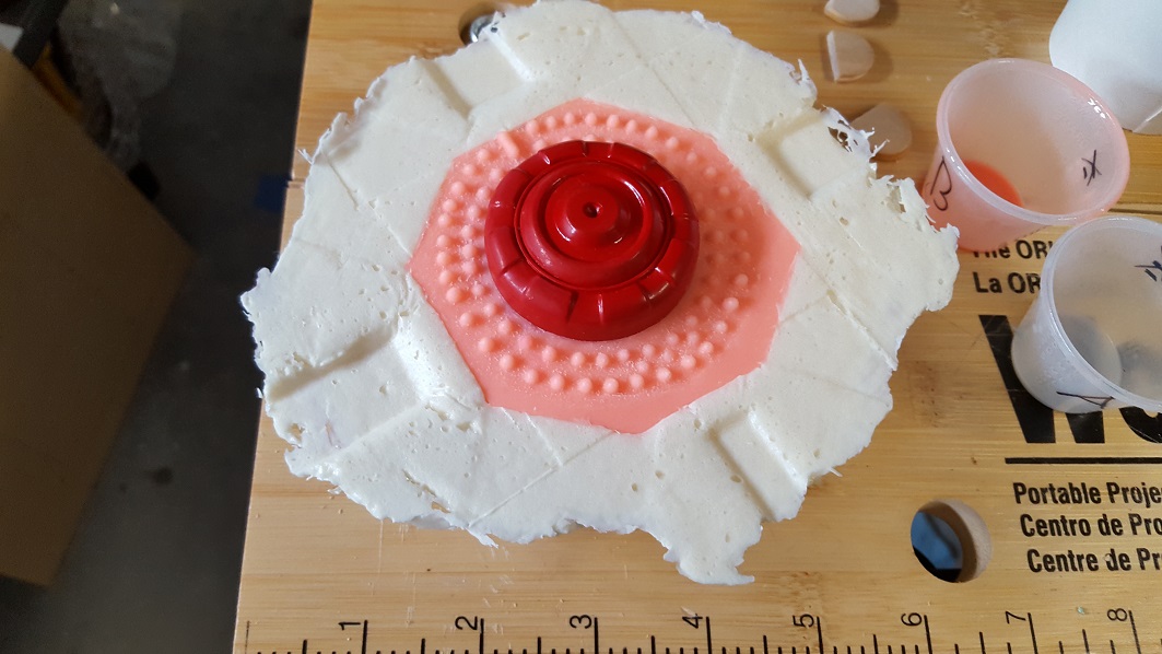

I clayed up the parts for molding on Thursday night. I forgot how miserable that job can be. See how much of the anode is sticking out of the clay in the bottom half of the picture? Remember that later on.

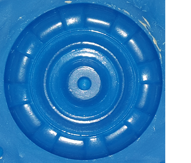

For the first five minutes of separating the mold I was afraid I had not used enough mold release and I was going to have to cut the part out but then it finally came apart. Looking inside there might be bad seam on the bottom, but I won't know for sure until I cast a piece later.

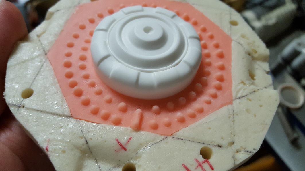

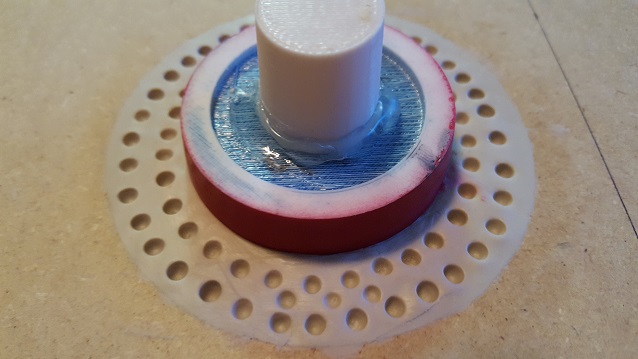

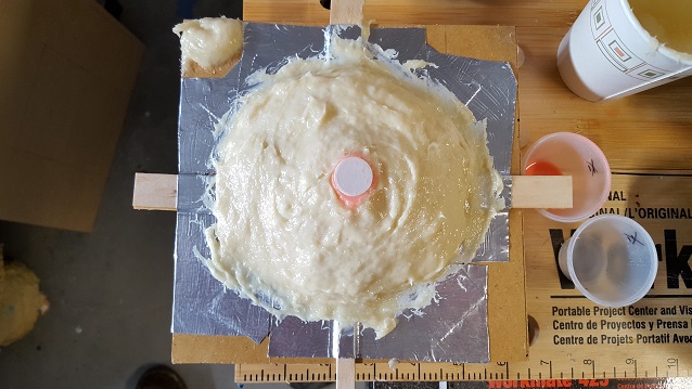

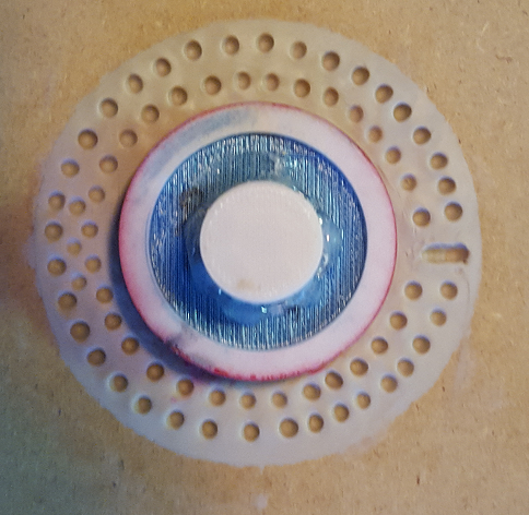

I decided to get fancy for this mold. I cut a hole in a piece of MDF, then screwed another piece of MDF to that to form a cup. Then I put one end of the anode in the hole and jammed some clay in there. I may have smoothed it a little. The white thing in the middle will be the opening to pour resin in for rotocasting.

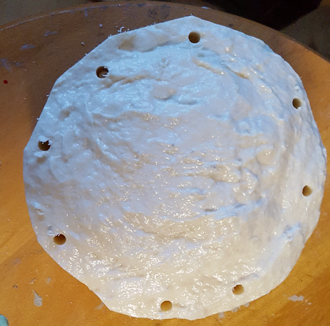

Almost there. This is the Plasti Paste 2 shell. I did not think to take any pictures of the rubber portion. The sticks are to create keys for locating the other half of the mold. I had planned to coat the MDF with Smooth-On sonite wax, but my container was dried out. Second plan was to use Turtle Wax, but I tried it on a piece of scrap MDF and I did not think that was going to work. So the plan I went with was aluminized real duct tape and then spray release on top of that. On a whim I put a dab of the Plasti Paste in one corner. When I removed the shell that test piece popped off too so the tape was probably unnecessary.

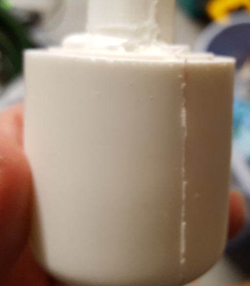

And here is what came out. I'm very happy. No picture of it, but that I got 95% of that flash off with my fingernail. Some light sanding and maybe putty and it will be perfect.

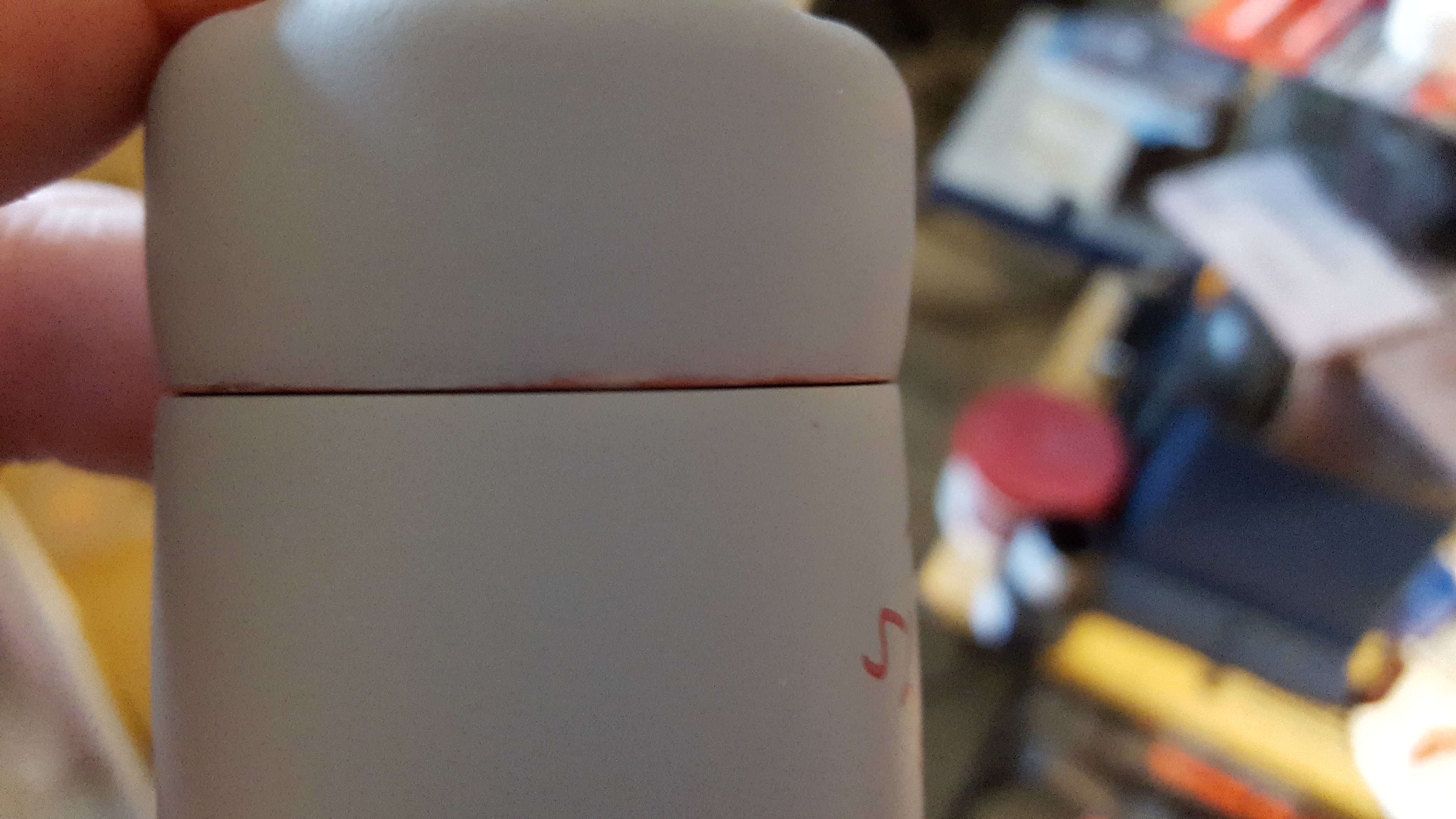

Did a cast of the cathode last night and gave a quick trim to both parts. Again, most of the flash came off with just my fingernail.
