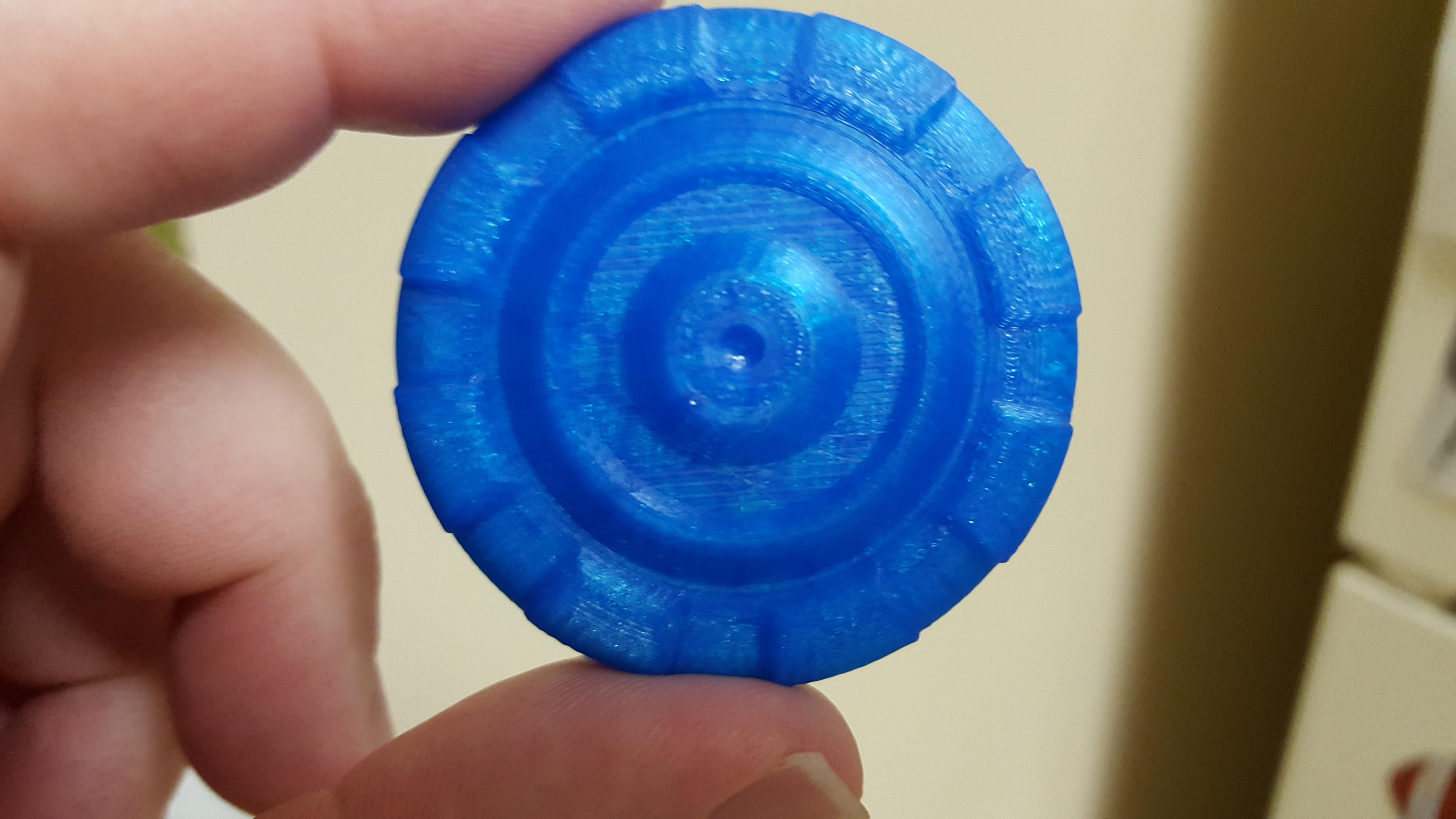

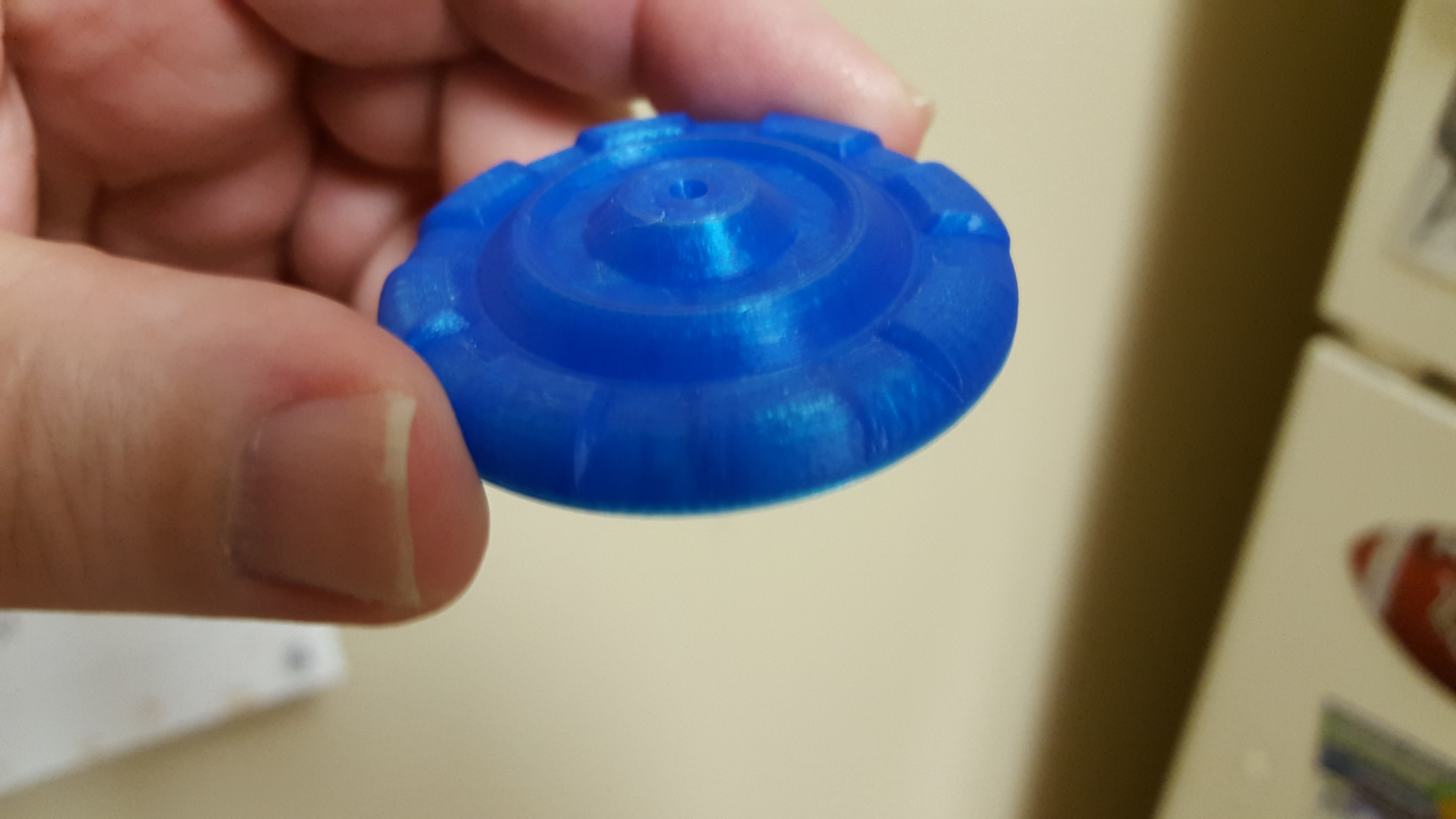

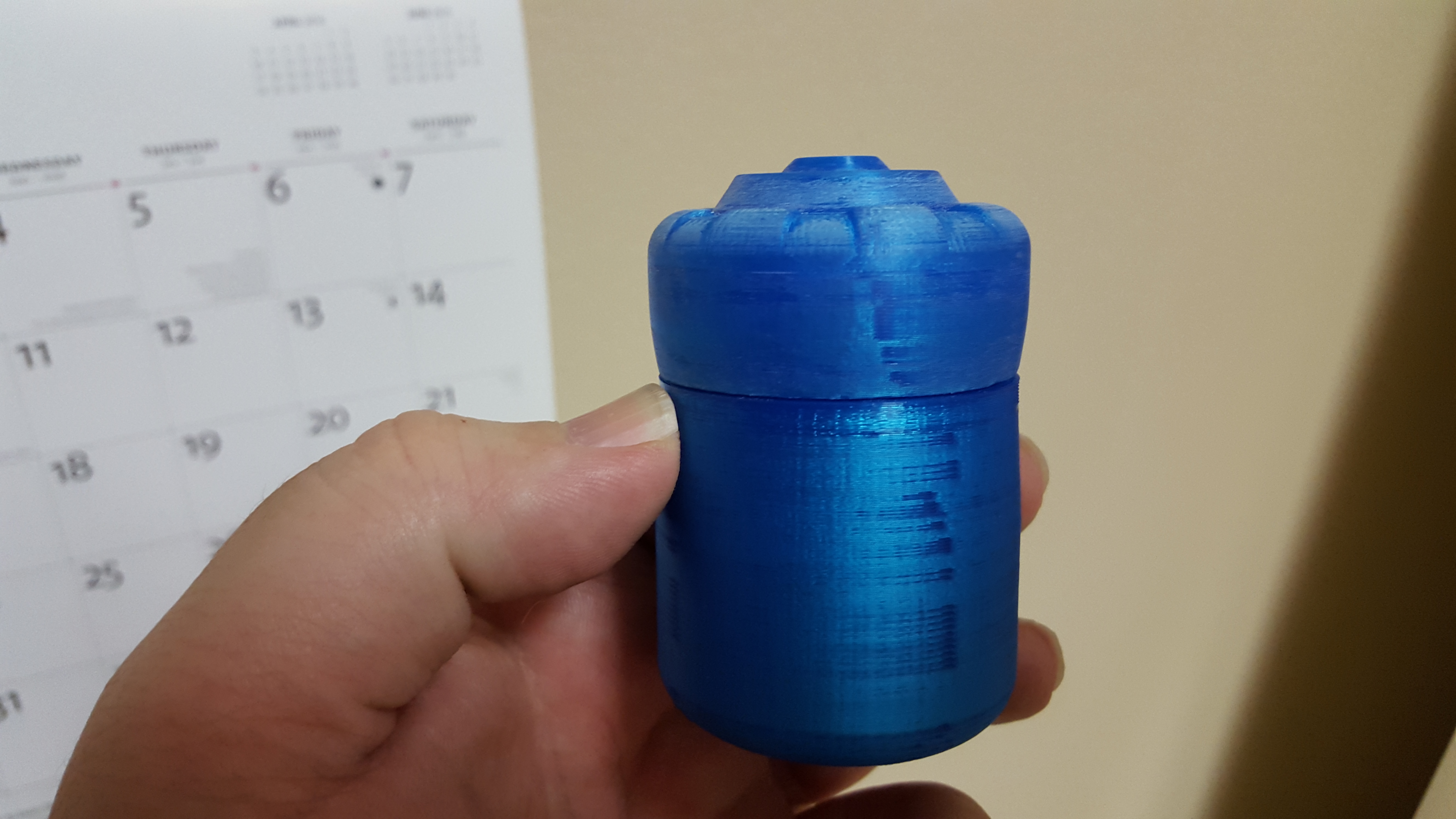

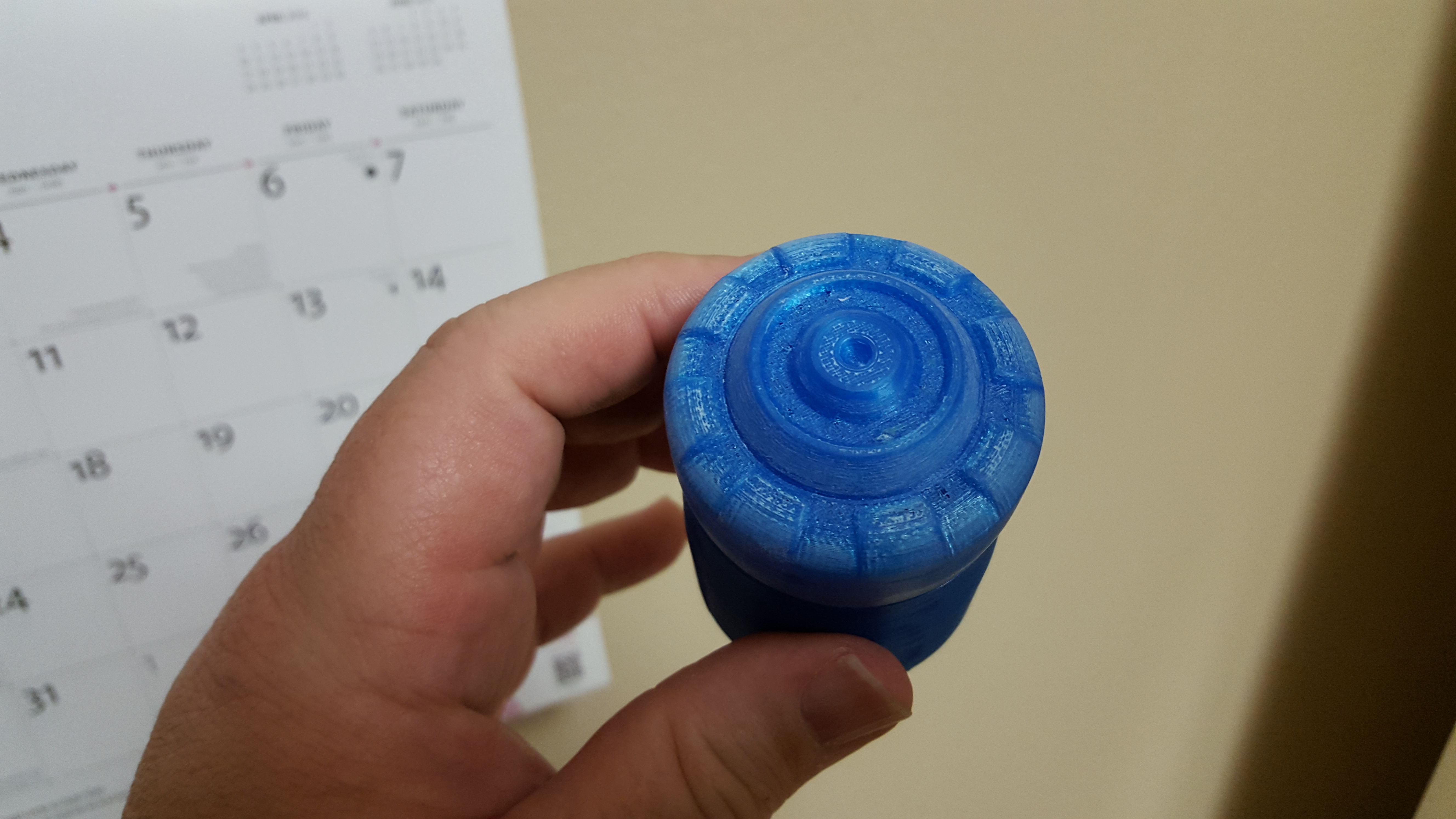

I got hold of a 3D printer and decided to see how this thing looks in the real world. It turned out pretty good. There is a tiny detail that got lost, but unless you have been staring at screenshots you would never notice. However, I still think the Shapeoko will turn out a better part. But that depends on whether I ever finish getting it setup and calibrated.

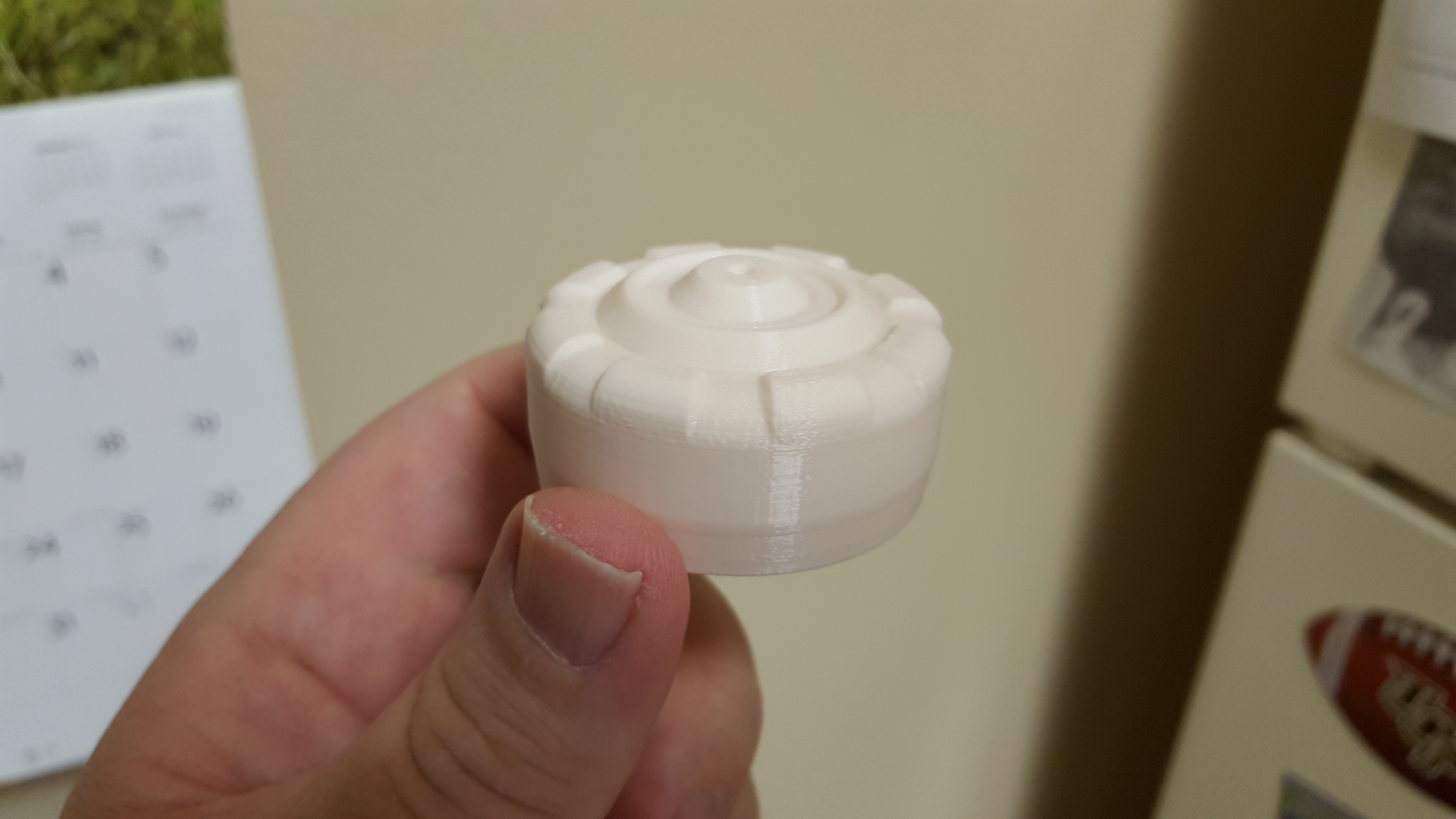

Printed out in Hatchbox "beige". Uh, ok. But it turned out pretty nice. It will still need finishing. I did not look at the total print time but it would have been around 3.25 hours. Heck, now I want to model and print the bottom half that I had planned to turn on the lathe.

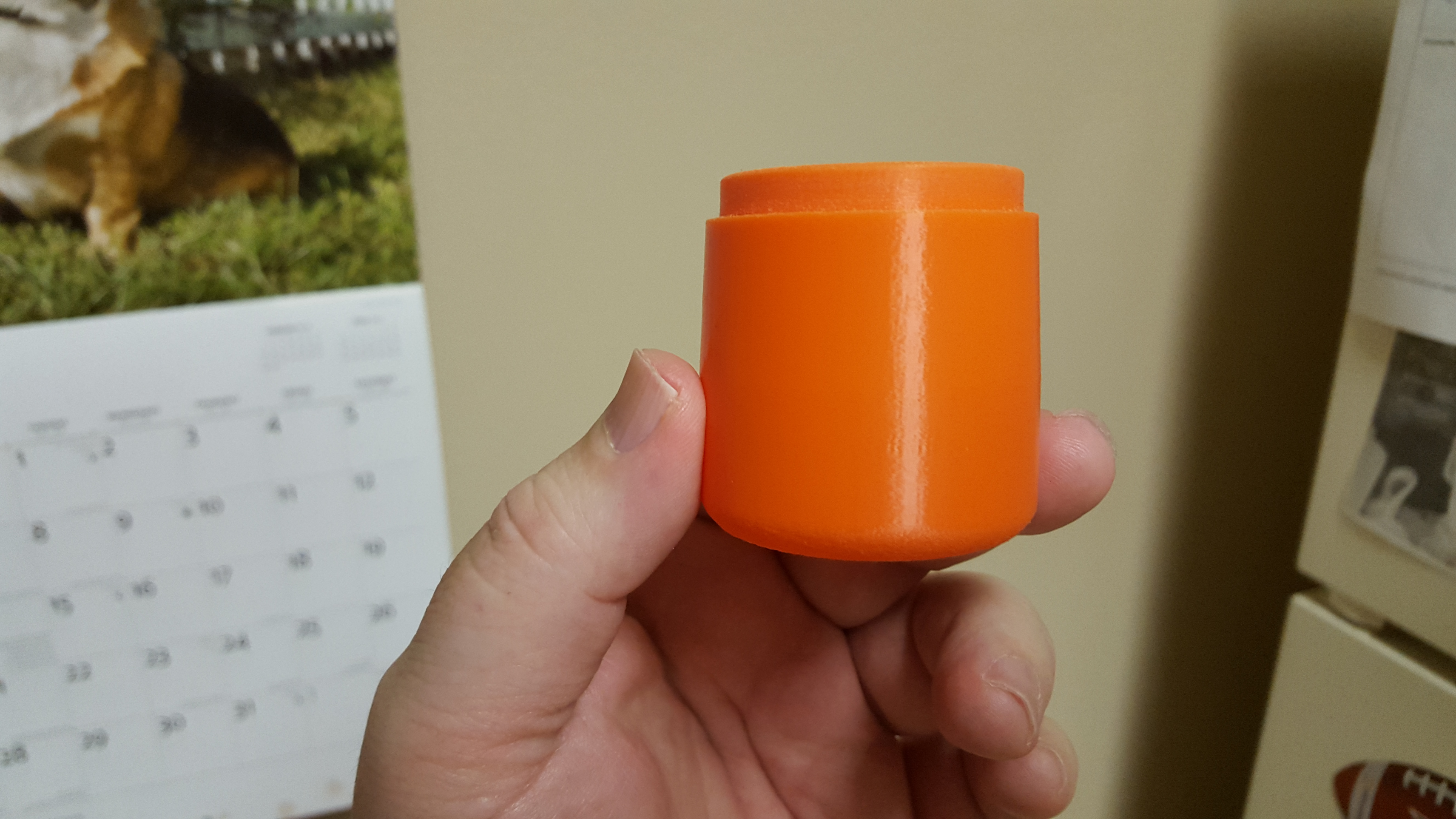

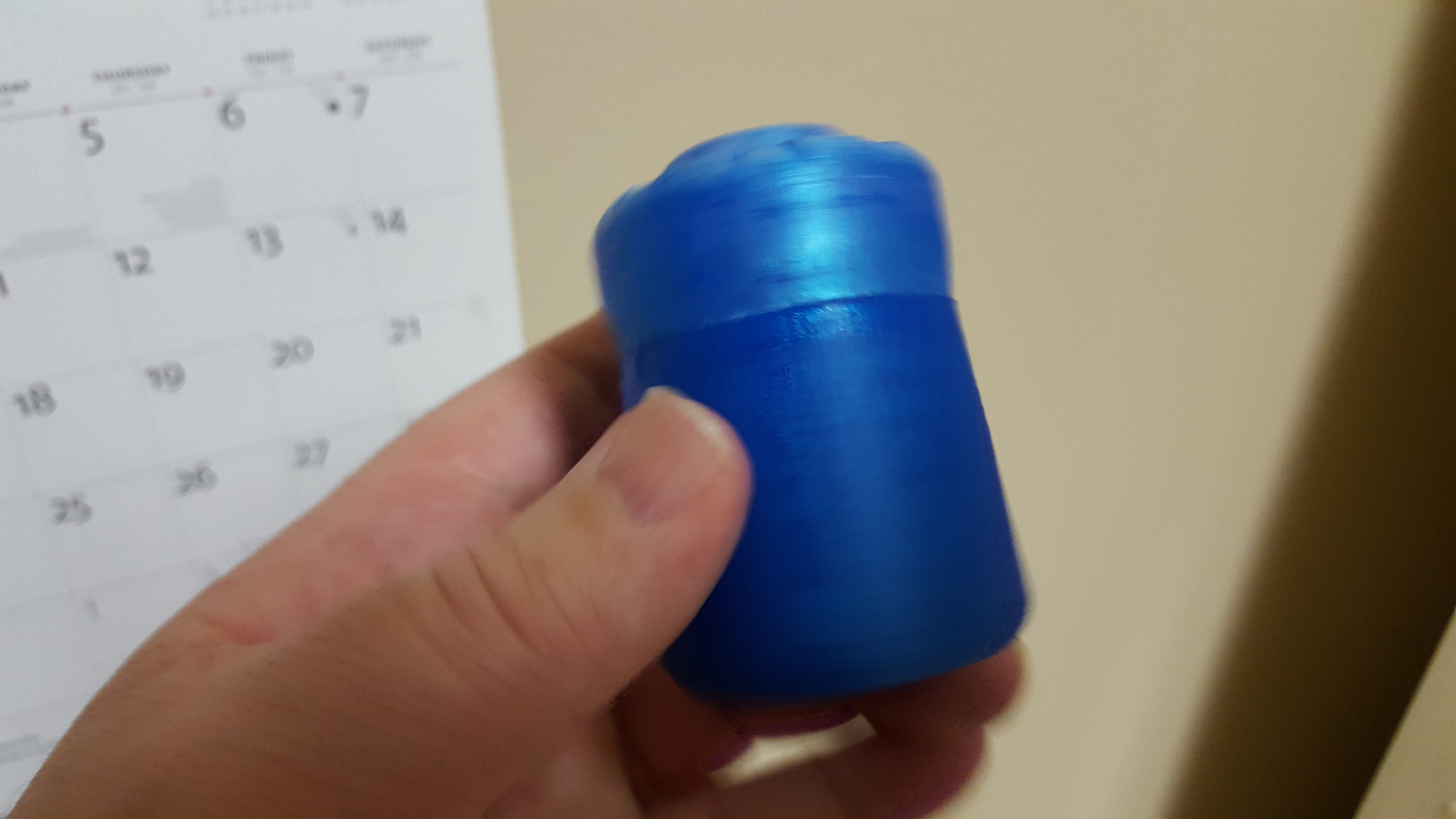

Printed out the bottom in Hatchbox orange. This one is actually orange! Again, it turned out pretty good. I printed it with no infill on a raft, but the raft did not want to come off. I want to make some changes to it though. The part that goes into the anode was too long making the gap too big. I'm actually going to do away with the gap altogether. So if you want a gap either paint one on or don't put the anode all the way on. It is a very tight fit and at some point this these parts are going to get some high build primer to fill the almost non-existent layer lines and then auto paint for molding, so I need to reduce the diameter slightly and put a chamfer on the the part that goes into the anode. I also want to make a small change to the anode itself. So there is 6-7 hours of printing weeeee!

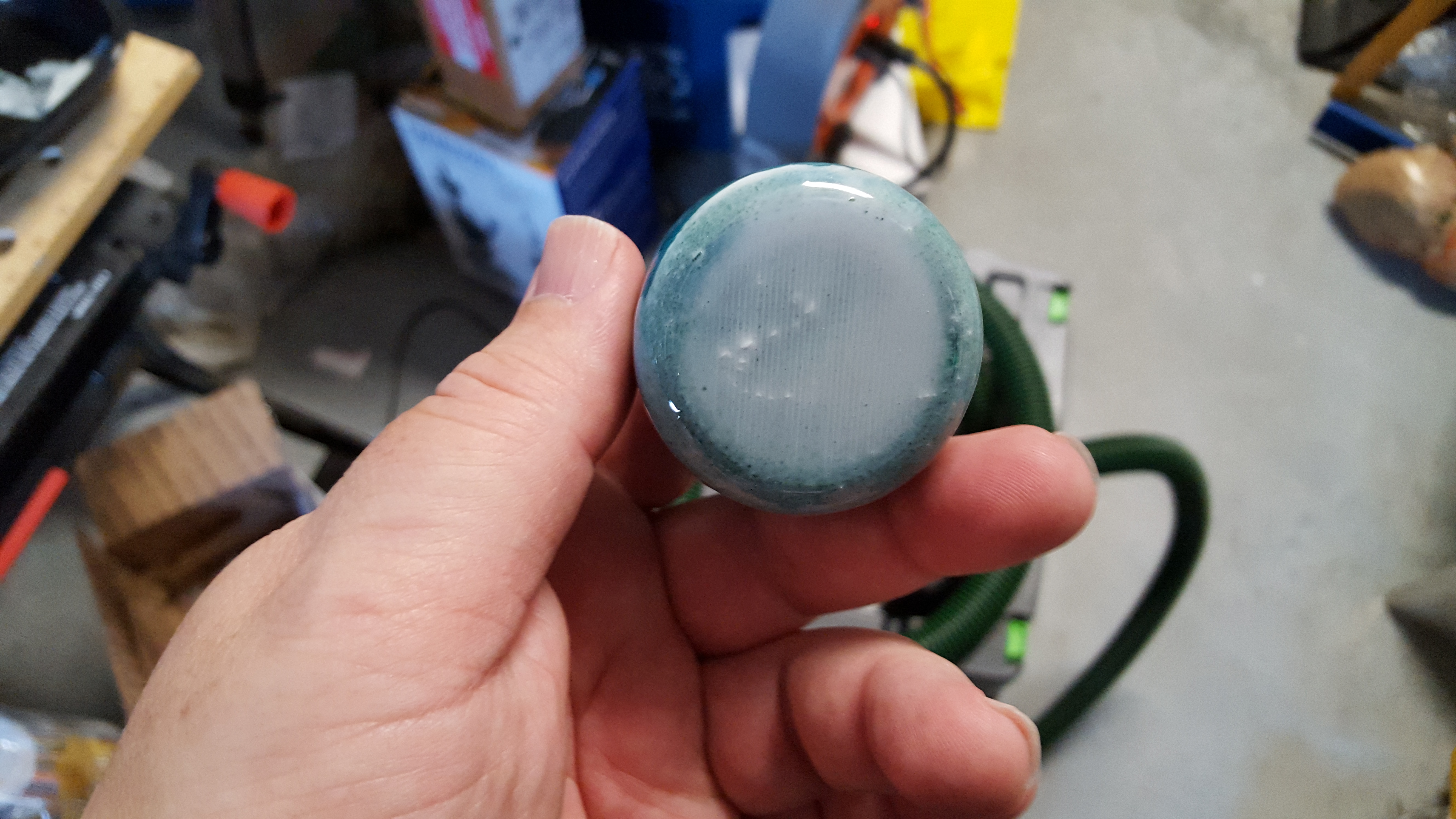

I suck at doing updates. Anyway, I applied two coats of XTC-3D. This stuff is thin, so go light. To help see if I missed anything I added SO-Strong coloring. First coat was yellow (yellow + blue = green) and the second coat was white.

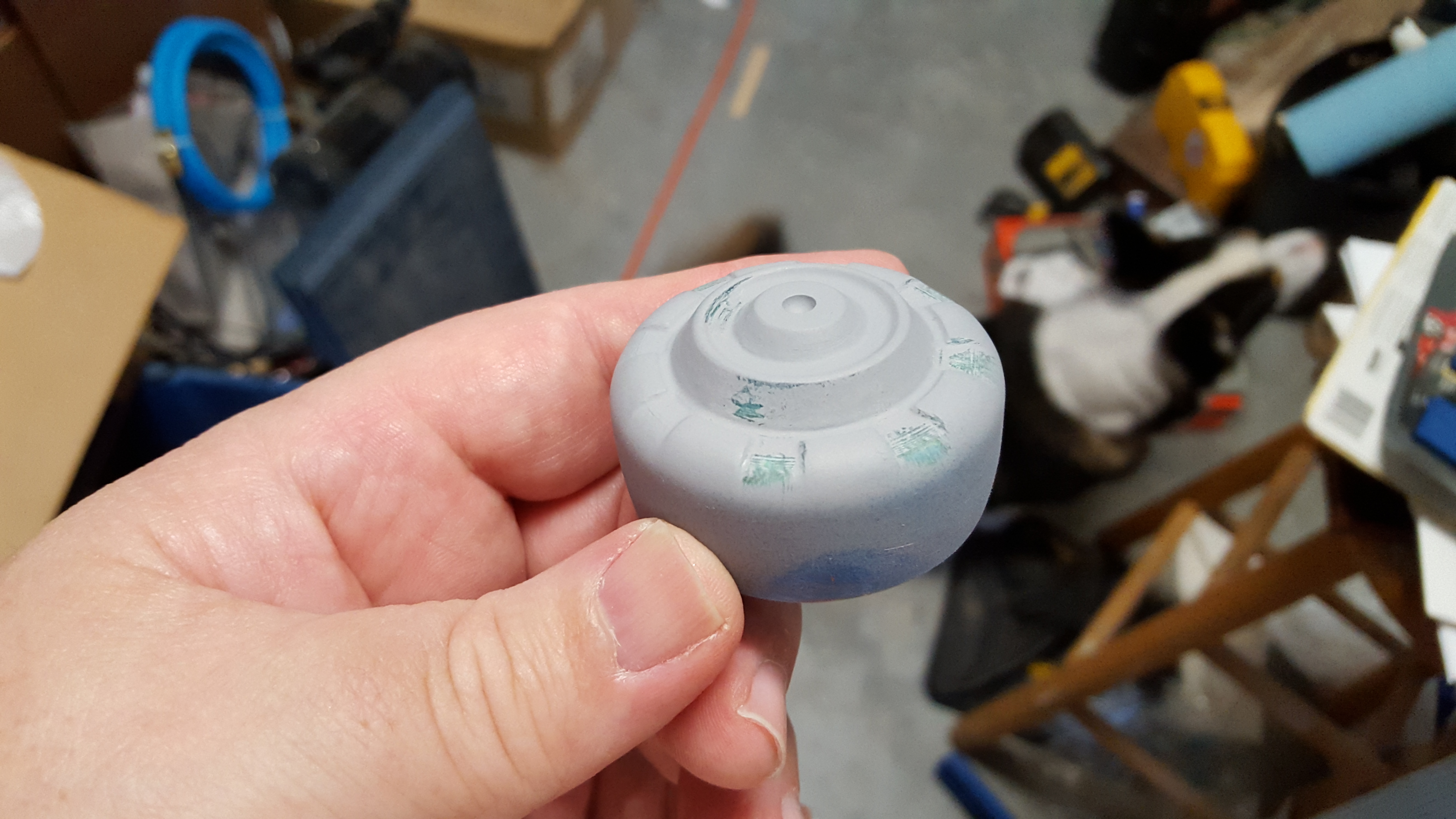

I sanded through part off the top piece so I tried to fill it with putty. I was not totally happy with the top anyway so I'm going to redesign it.

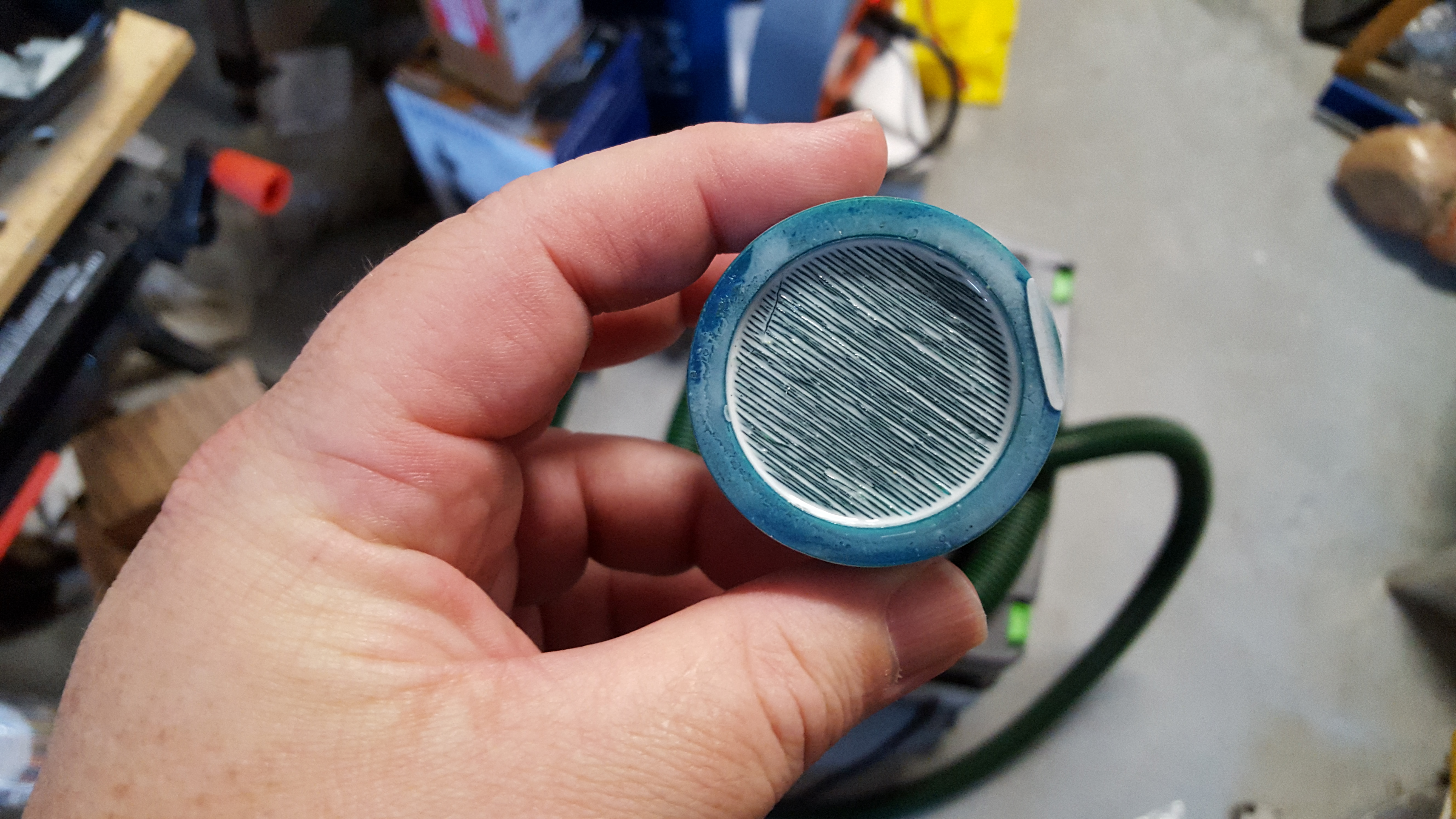

You know, I did the same thing on my mini nuke that you did on the top half of your cell, sanding away too much on the rim area. If it helps, you can do what I did to correct it. I cut out a hole in a 12x12 square of MDF (by tracing the male end circle), then I took a sheet of sand paper and cut a matching hole. Then set the paper on the wood, lining the cut holes up. You can then insert the male end of the cell half in the hole and twist it to sand it down to a perfectly flat edge. May need slight touch up afterwards, but this worked for me with the nuke. Just thought I'd mention it.
I was actually doing something similar for sanding down the red putty and it does work well.
