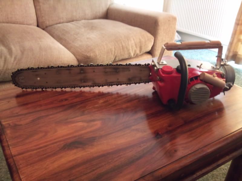

I built one of these a while back and really enjoyed the process. I strongly recommend anyone who is thinking about it to jump in and make one. It's such a fun project from start to finish. Stripping out a real chainsaw, modding it and ending up with a gruesome Evil Dead prop is way better than simply buying a replica one. Half the fun is making it yourself, the other half is strapping it on and battling some Deadites!
Here's some pics of mine:

One question... how easy is it to slide your hand in and out? There's so much of me that would love to do one of these but I've got big hands.
