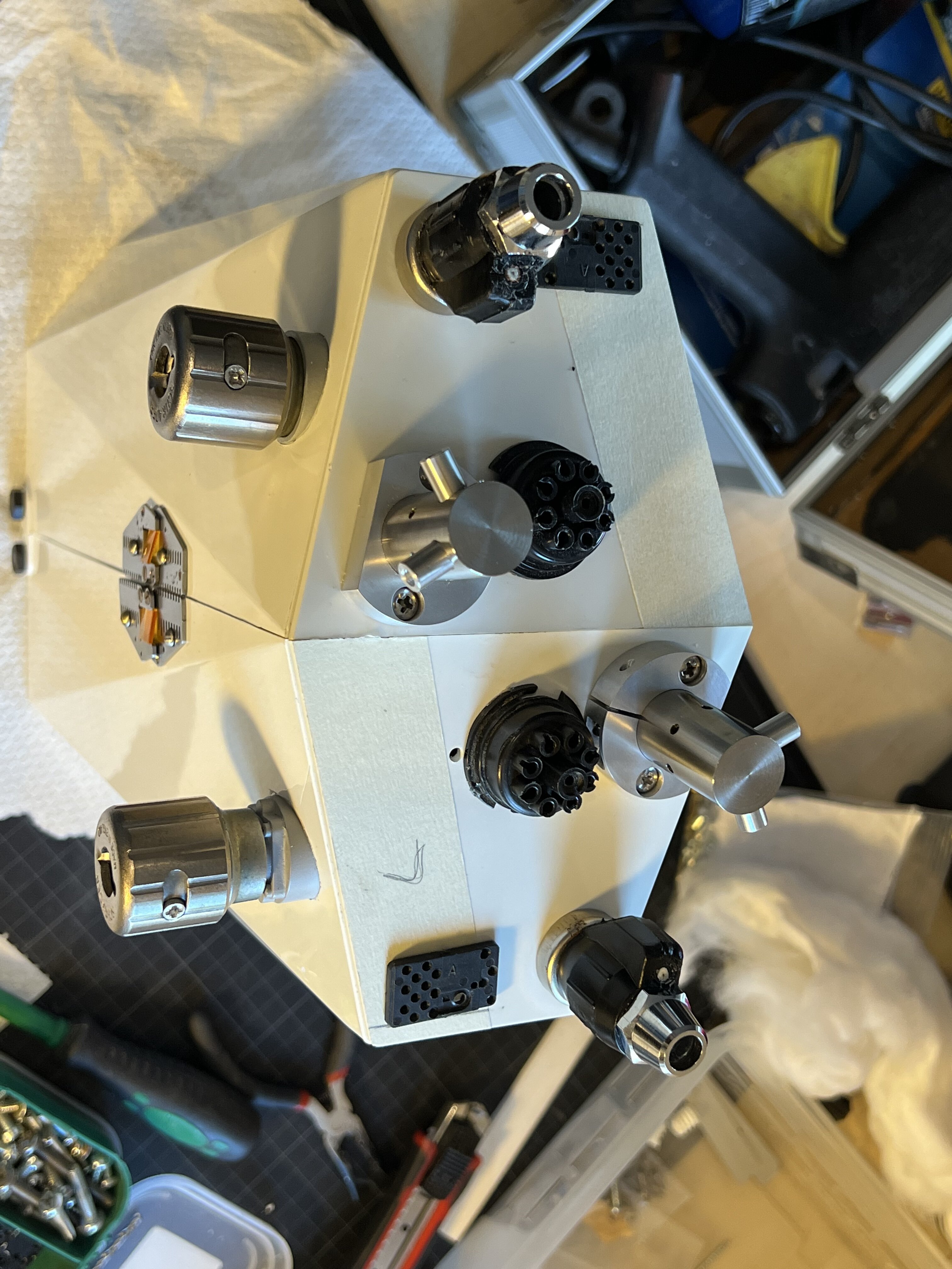

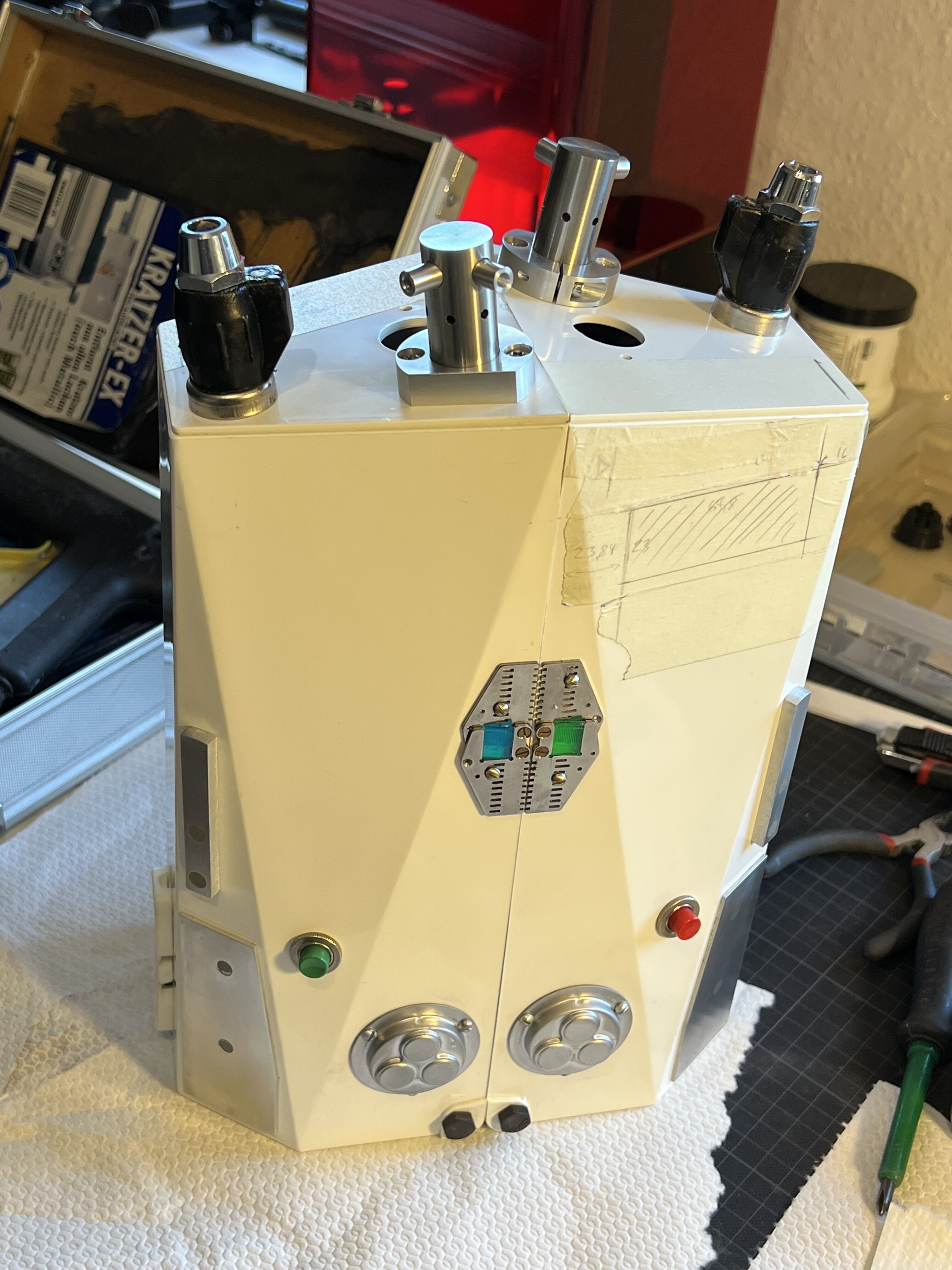

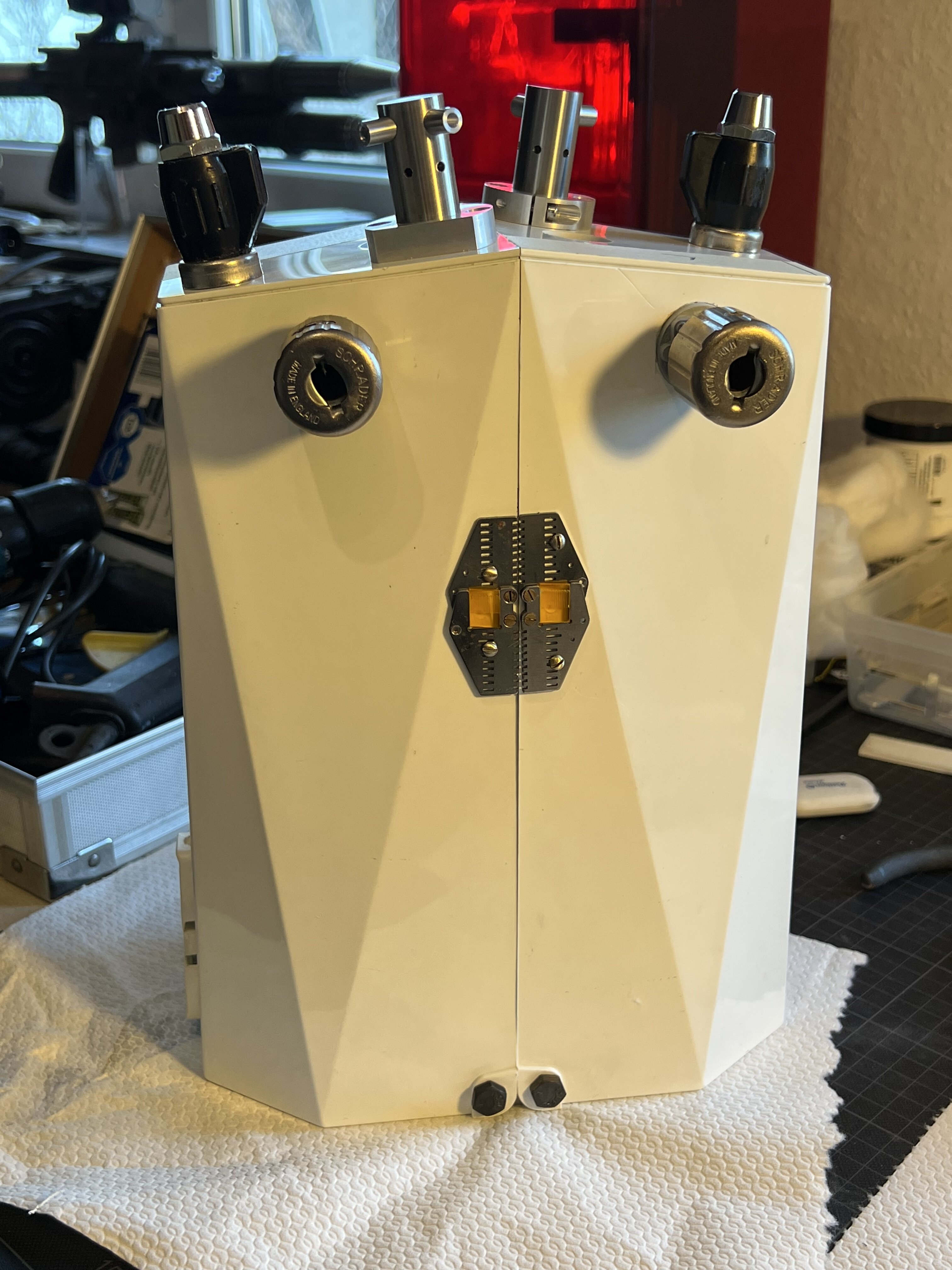

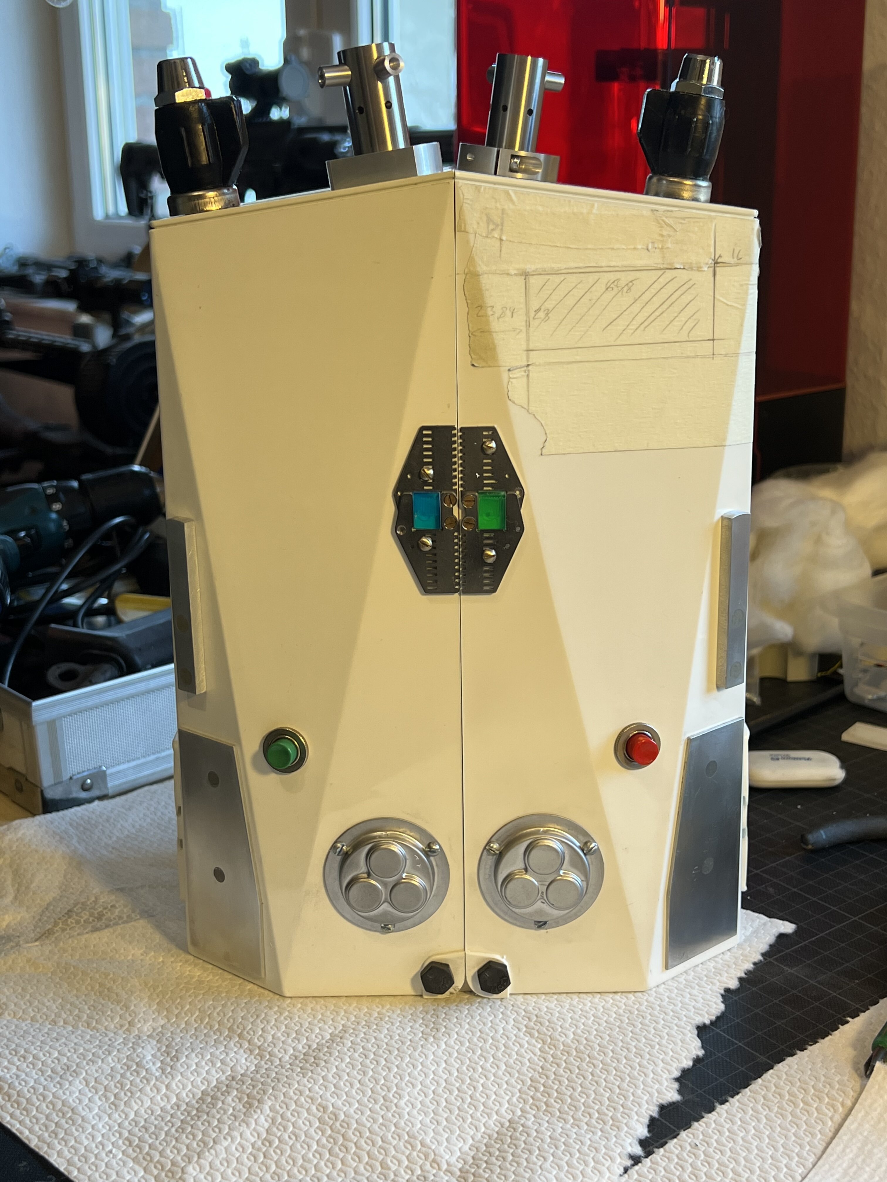

Some small progress…
F0A6DD6C-8E9B-412C-B593-FB50EB525019.jpeg8AA01359-E535-4871-BE0F-7EACC95F48B8.jpegD259FC80-EF7F-4EE1-8F6D-8ED54725867F.jpegFF201C32-FEDB-43EF-8E6E-A92C8B555727.jpeg
So cool! Thank you so much for sharing, that's the first scanner I have seen yet with my clamps on it!
Looks great Markus, looking forward to see what's next :)
Looking good Markus. What did you use for your quick disconnect bases?

I simply used 25mm O.D. grey PVC piping, added the threaded inserts and filled all voids with Aves putty.

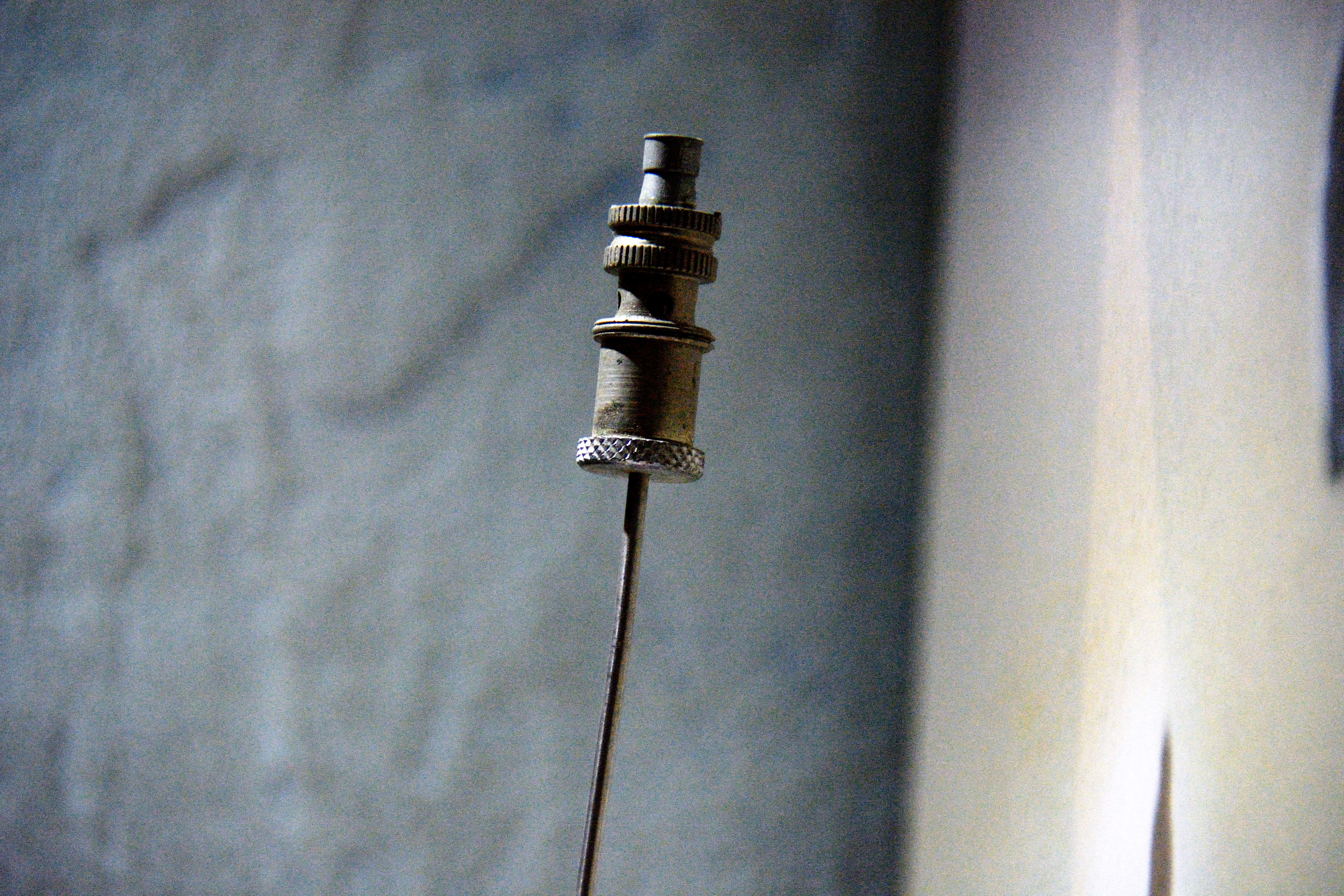

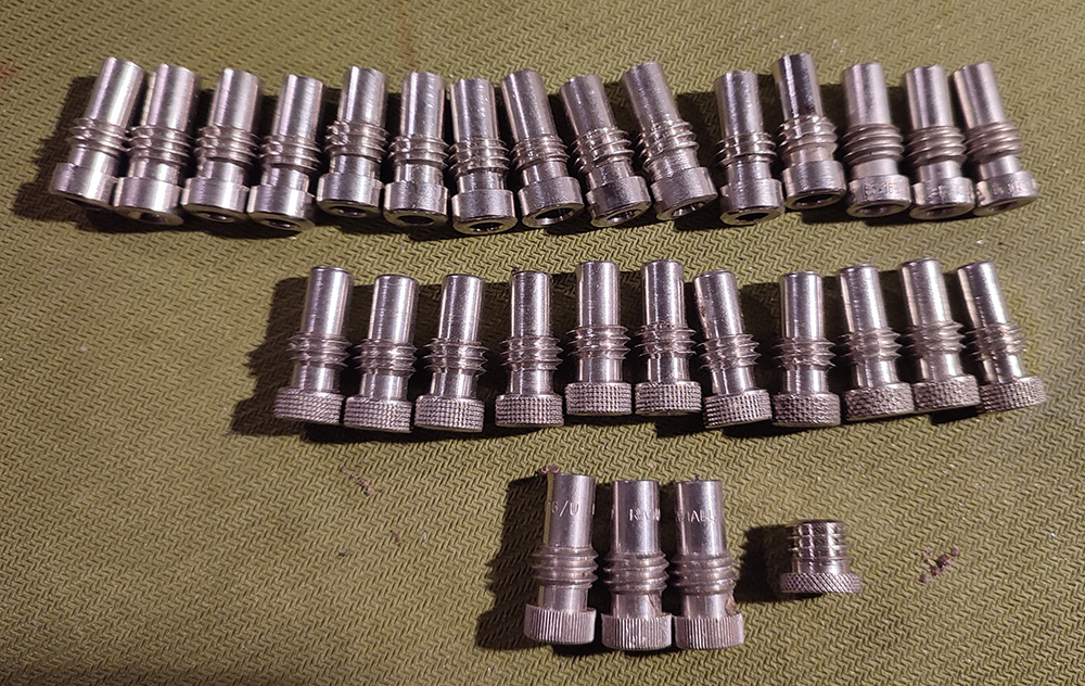

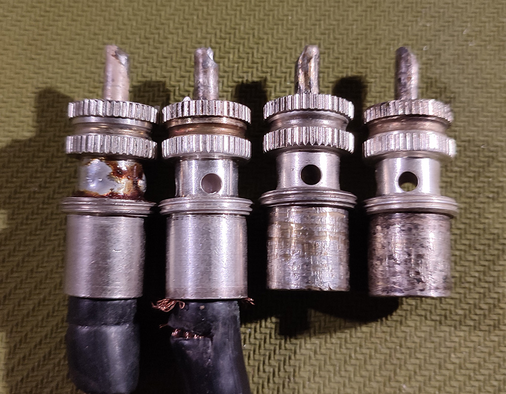

Just went through my huge box of PL connectors that I found a while back at the hoarder's house I helped emptied and found 4 of the correct amphenol insides, I had no idea that those were used on the scanner before I completely re-read the thread today!
does anyone have any idea what the knurled ring at the bottom is though?
I have a huge stock of those types of connectors and I found 4 different types of threaded insert that go on that end, including the ones that were initialy on the amphenols, and none of them match, even the one on the bottom right:

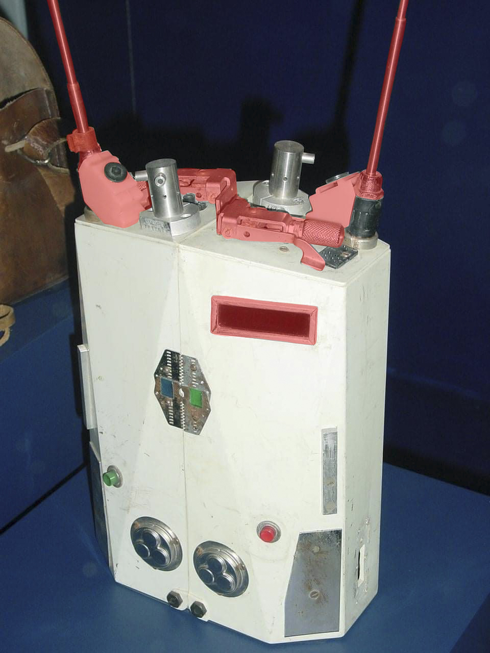

reference (from OdiWan72) reposted for convenience:
cheers

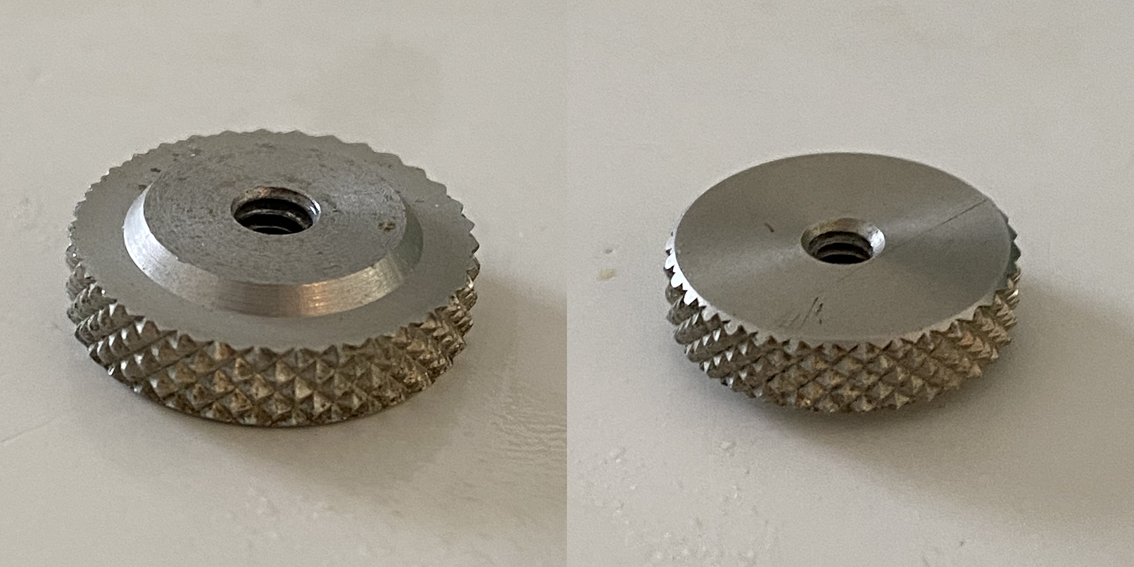

The knurled part is not a PL259 part, but we will need these made. If you need help with a drawing, this is probably something I should be able to do.
Actually, there are quite a few antenna bits that will also need to be done.

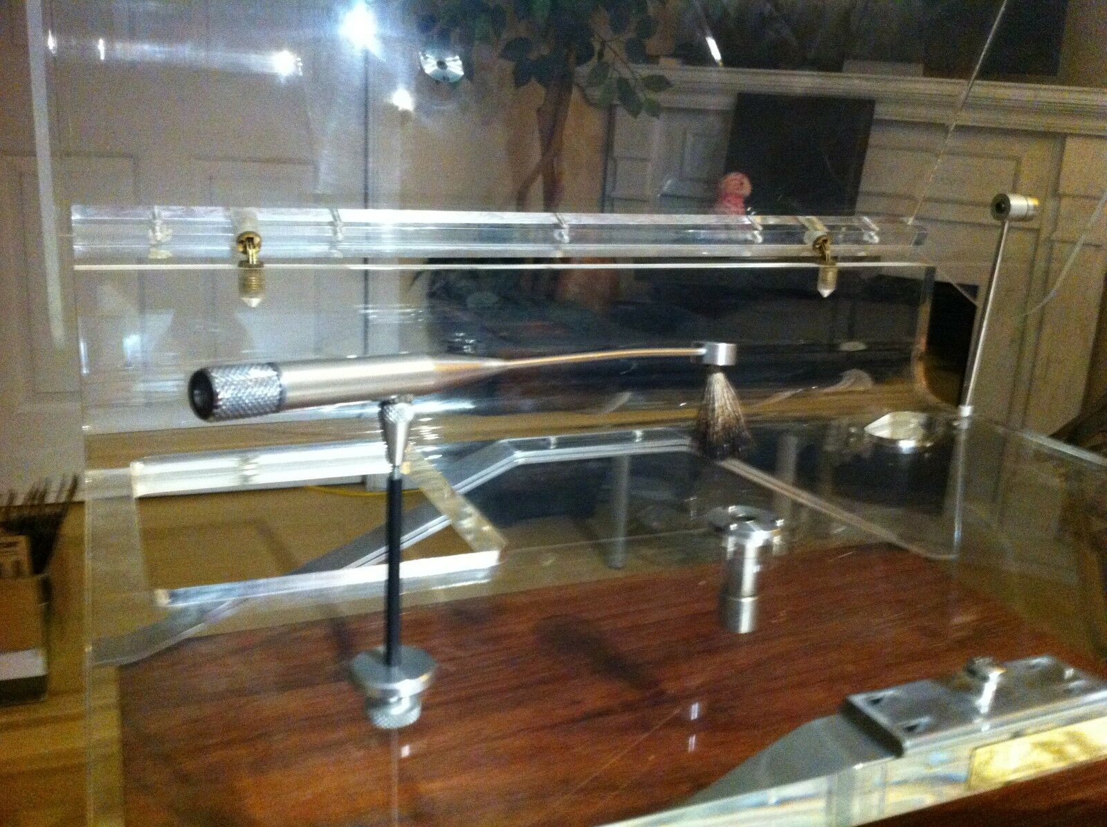

The knurled piece is a Michell Prisma turntable sweep arm nut.
Earlier Michell models used wing nuts, but the Prisma has a transparent deck so they used a fancier knurled nut.
Michell Prisma parts were new for ESB (not used in ANH). One of these nuts are on the AT-AT driver chest box, Hoth glove comlinks, and other stuff.
I can provide pics and measurements of mine.

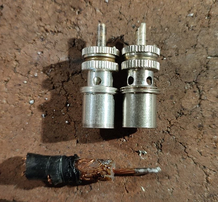

speaking of amphenols, the 4 I posted above, as you could see, two of them still had the cable attached. Apparently, at least in my case, the cables were soldered to the plug! so quite difficult to remove. especially one of them on the far left in my previous photo was soldered both at the tip, but also on the 4 holes in the middle. But my wife an I managed to remove the cables and clean the solder as a small couple project tonight :)
