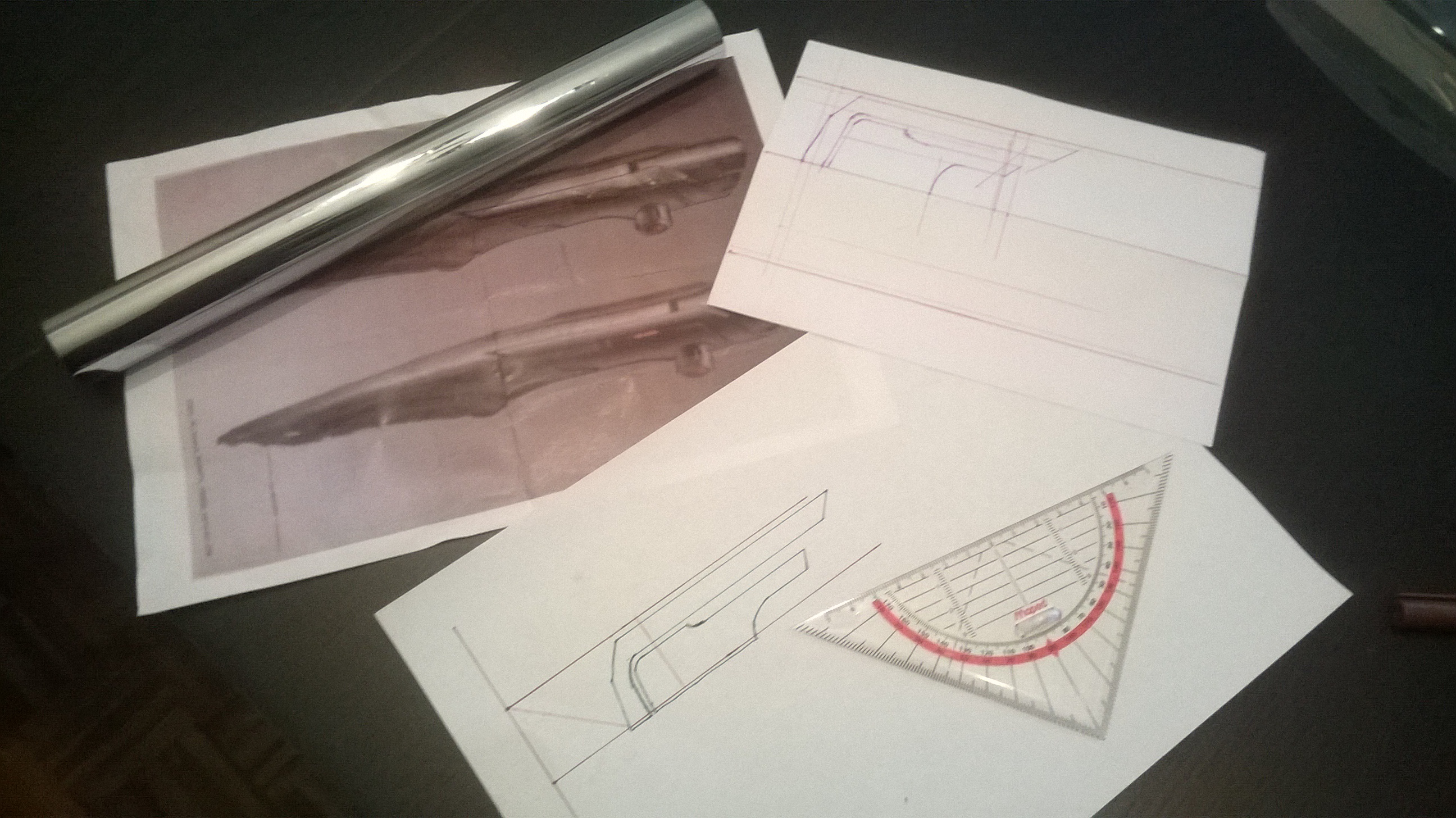

So. I found the concept picture of a lightsaber here and on some other blogs last week and I thought I'll give it a shot. I happen to have a chroom tube laying around and am planning to use that and scaled the picture an plans to that tube. It's 32mm in diameter which was the base measurement for the plans. Up till now I have drawn the templates for the metal parts. The wampa tooth I plan to make from XPS foam which I also happen to have laying around left over from a rc spitfire project. I'll keep you all posted on this project but it may take a while because ill have to do it between work, family and working on props for the production of Aladdin from the local youth theater .

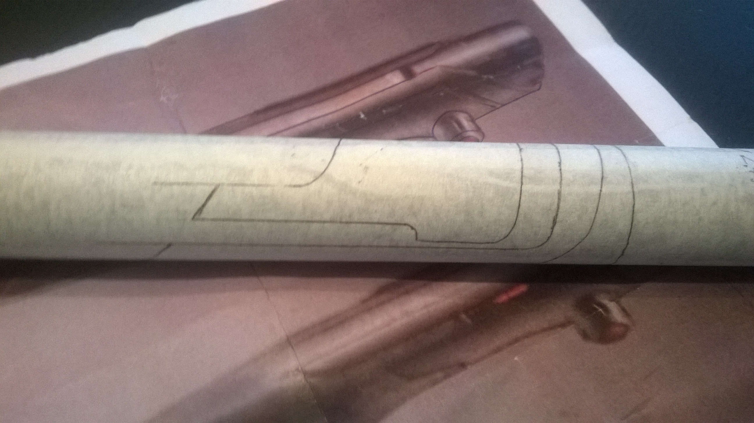

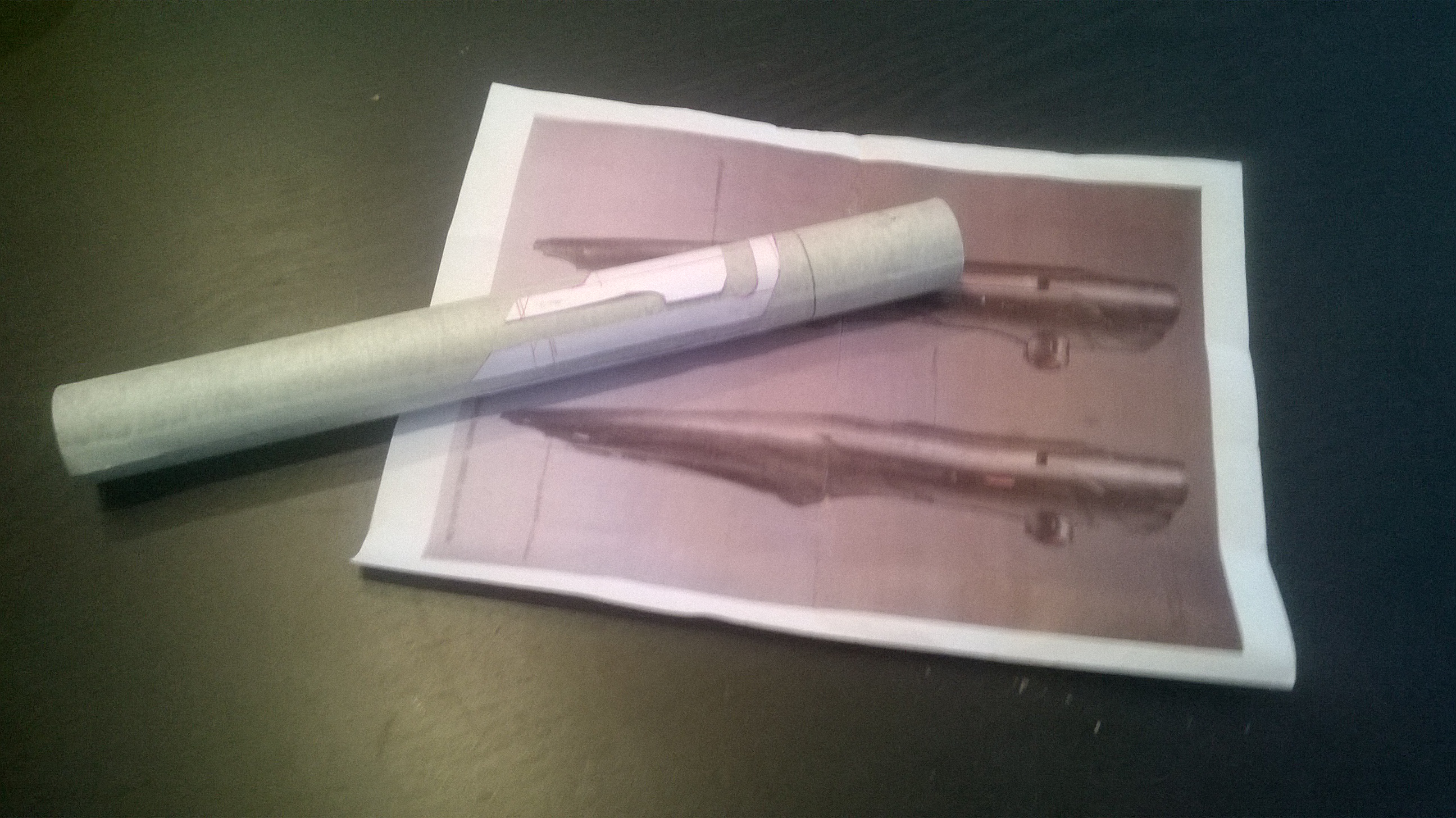

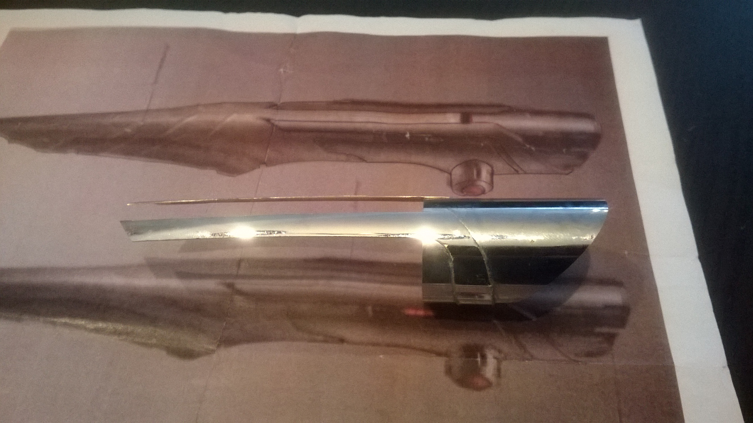

Quick update. I taped the tube with painters tape and transferred my templates on it using spay adhesive. I've got pics but can't figure out how to post them in a reply using tapatalk

Small update. The metal part is almost done. I'm also making an emitter, as this isn't pictured in the concept drawing I'll have to use my imagination. I'll be keeping it simple.

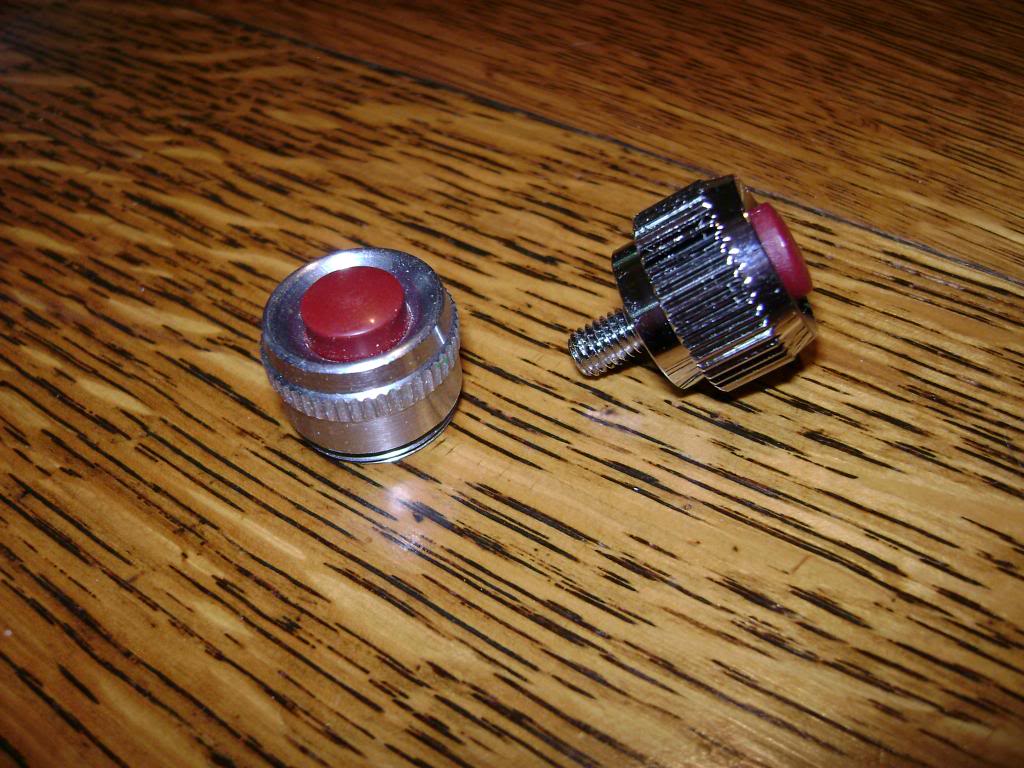

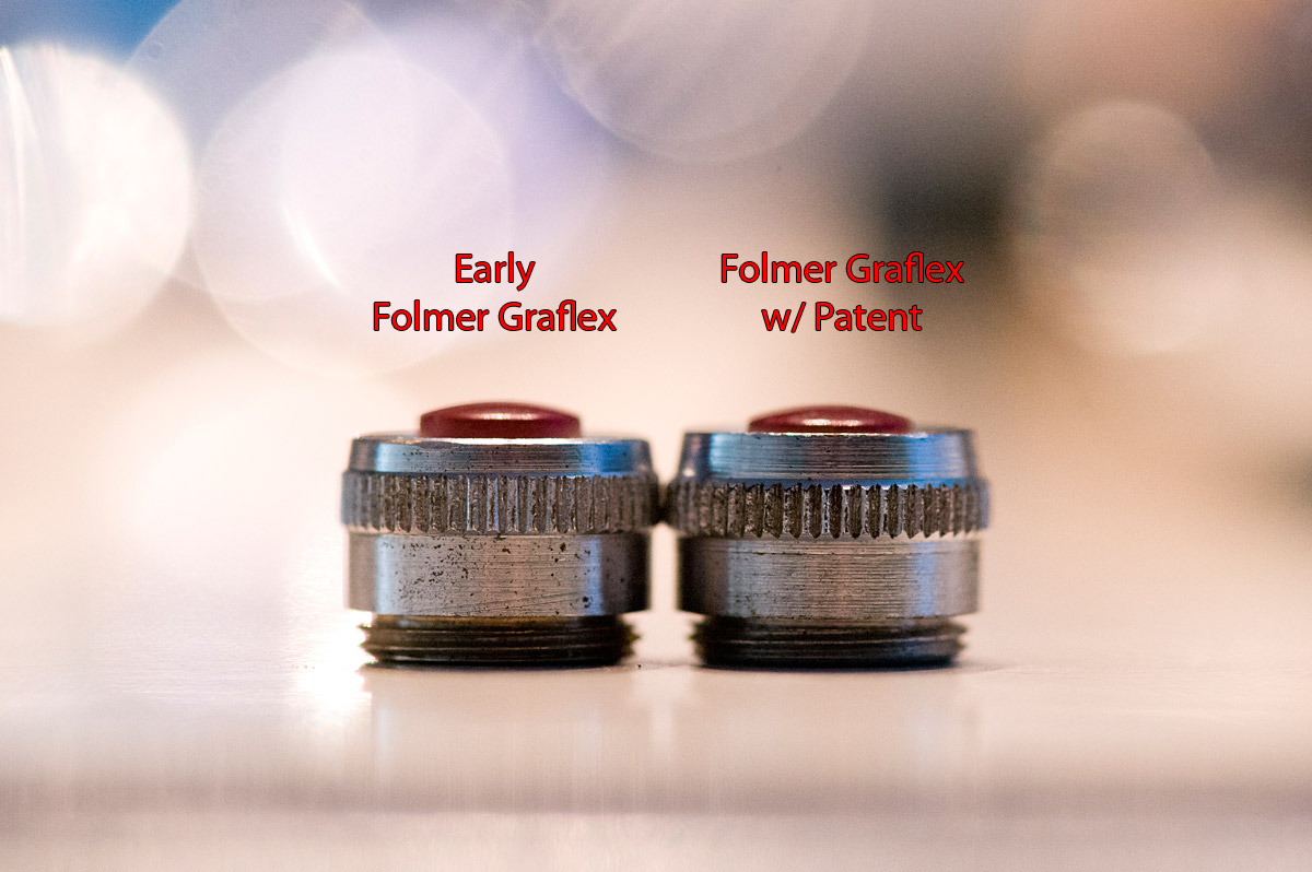

Yep! They have a tiny threaded rod like a screw that screws into whatever is inside your tube. The "real" buttons have threading around the bottom rim of the button - they thread into the wall of the hole itself.
Real buttons, Credit to the makers of the website and people that took these for that outstanding thread on Graflex variations:
Fake or replica on the right
ignore the knurling variations! That part is identical, I have a vintage one with full knurling - these photos just happen to have the tiny knurling of another graflex variant.

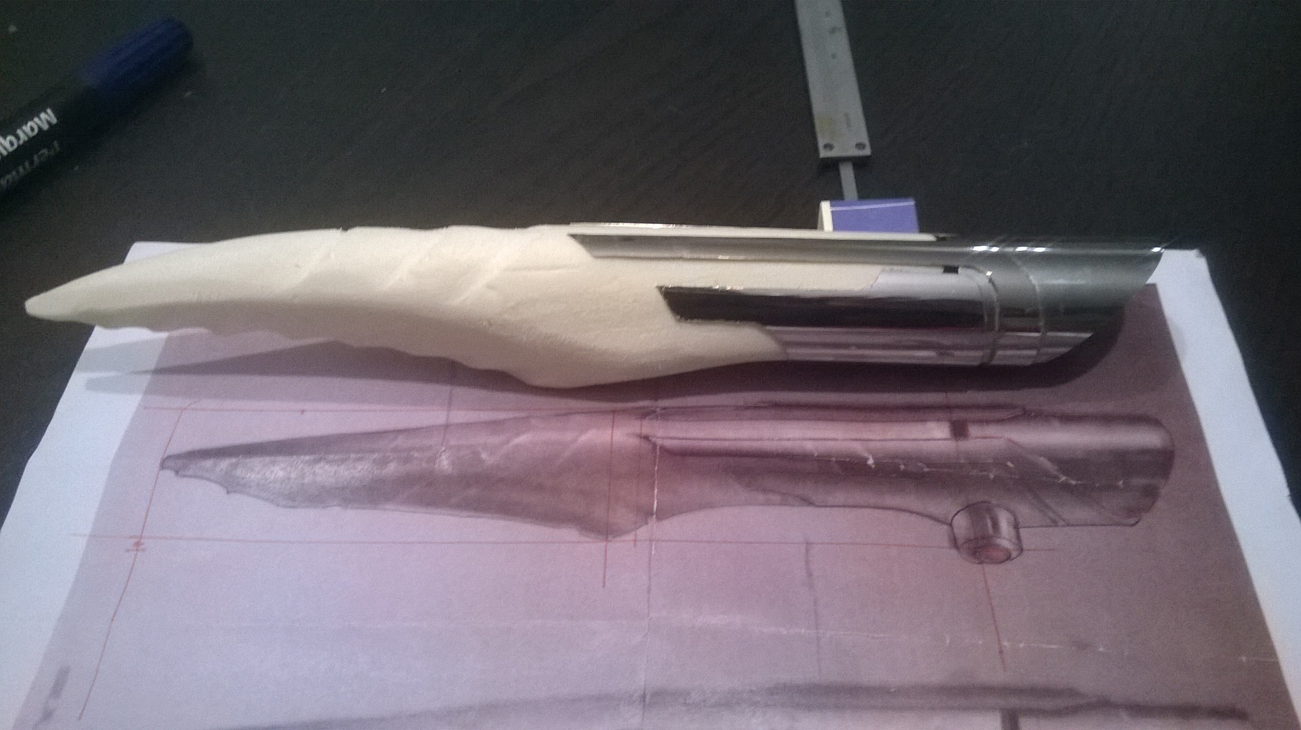

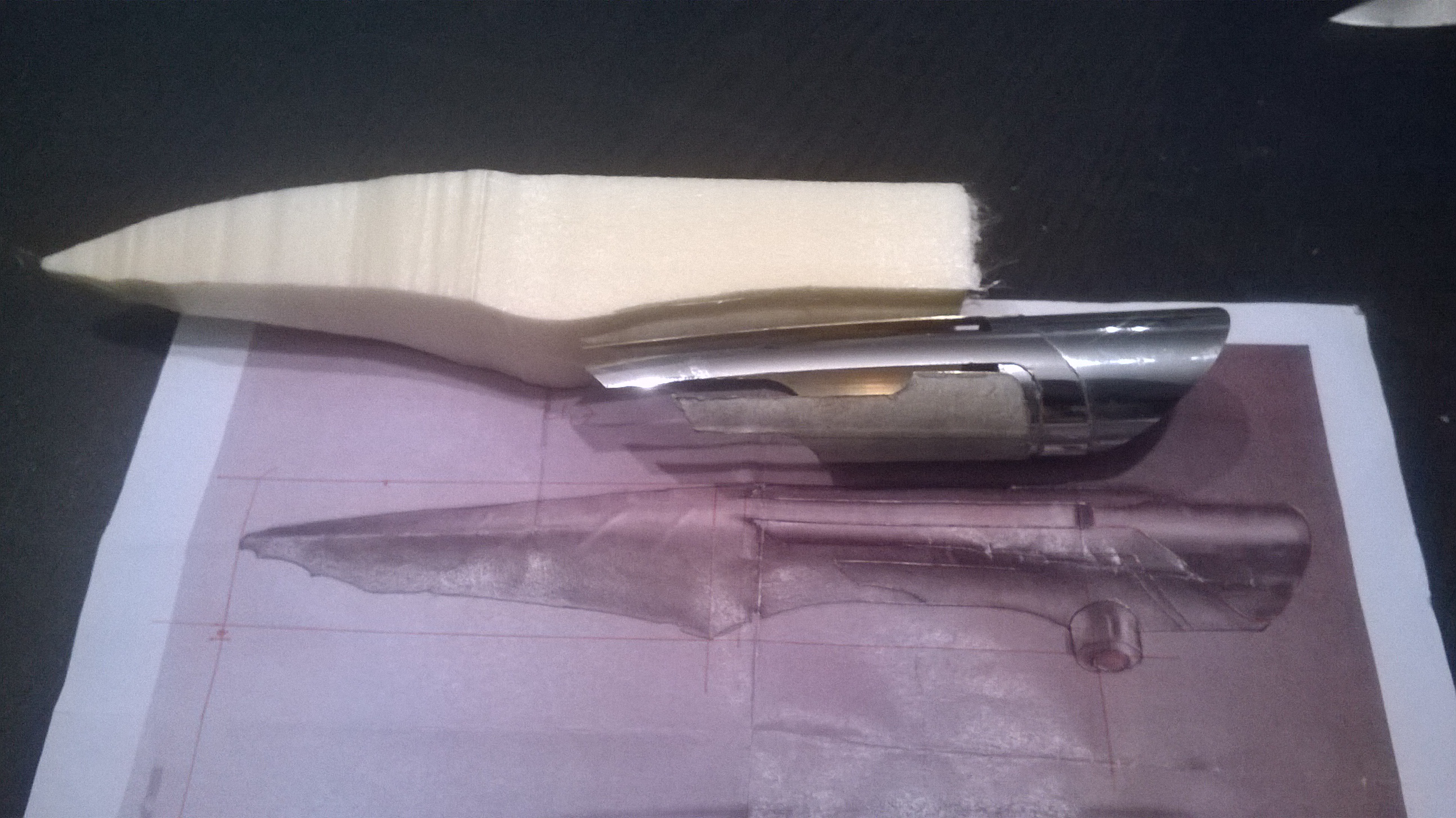

So I got some work done today. Even more than I thought I would.
The metal part is done, except the button that is. And that was what I hoped to achieve today but the spare time just kept coming.

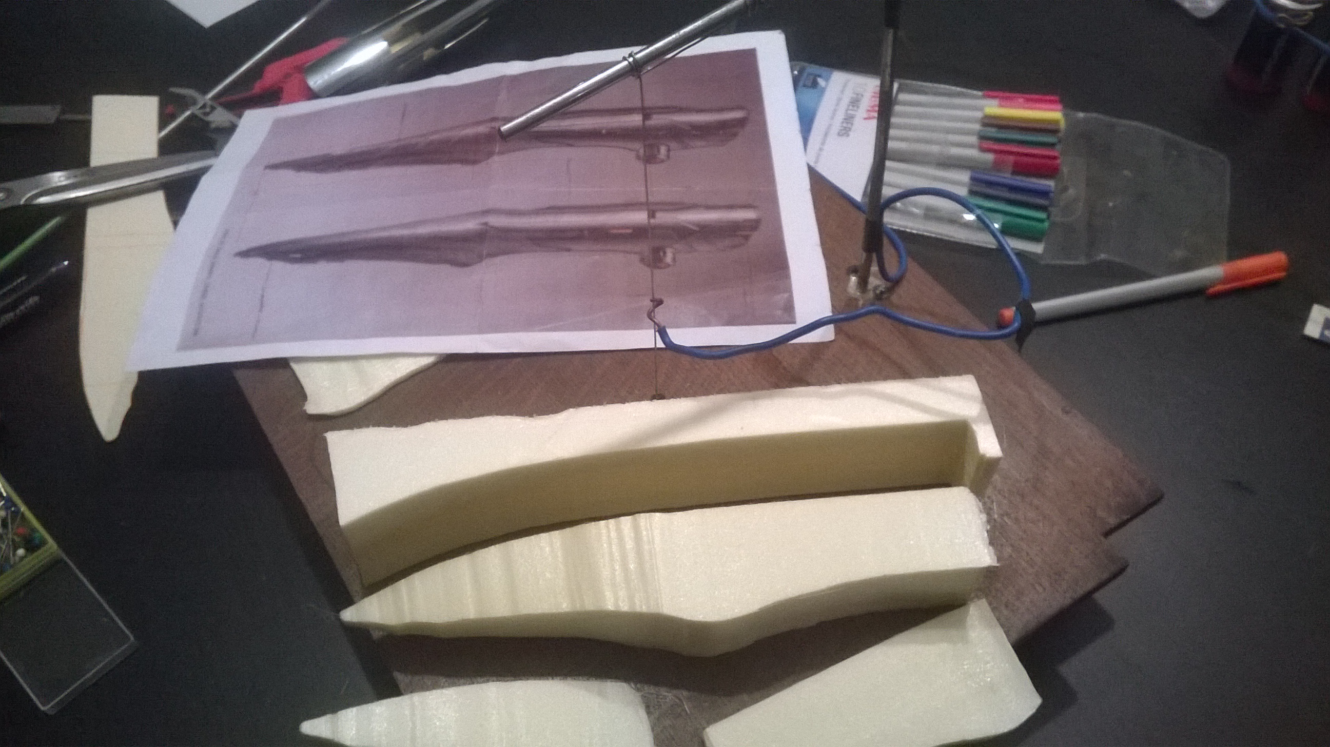

For the tooth I glued two layers of 20mm XPS foam together and used my homemade hotwire table to cut the basic shape. I then used a knife and 120 grit sandpaper to Finnish the shape. I used the drawing for inspiration but tried to give it a bit more of a tooth like appearance. I also looked at T-Rex teeth for inspiration and used some elements of those.
Lucky me, the tooth fitted at the first try.
It being made from XPS foam it needs to be sealed before I can paint it so I just put on the first layer of glue. I'll let it dry tonight and pit on a second layer on tomorrow. I cant wait to start painting the tooth. I've got the whole paint scheme in my head since I started this build, hope it works.
Again thanks for the tip on the button. But this is a budget build and I haven't spend any money on this yet. Al the materials I just happen to have laying around so I'll look for the red button I should have l somewhere.
