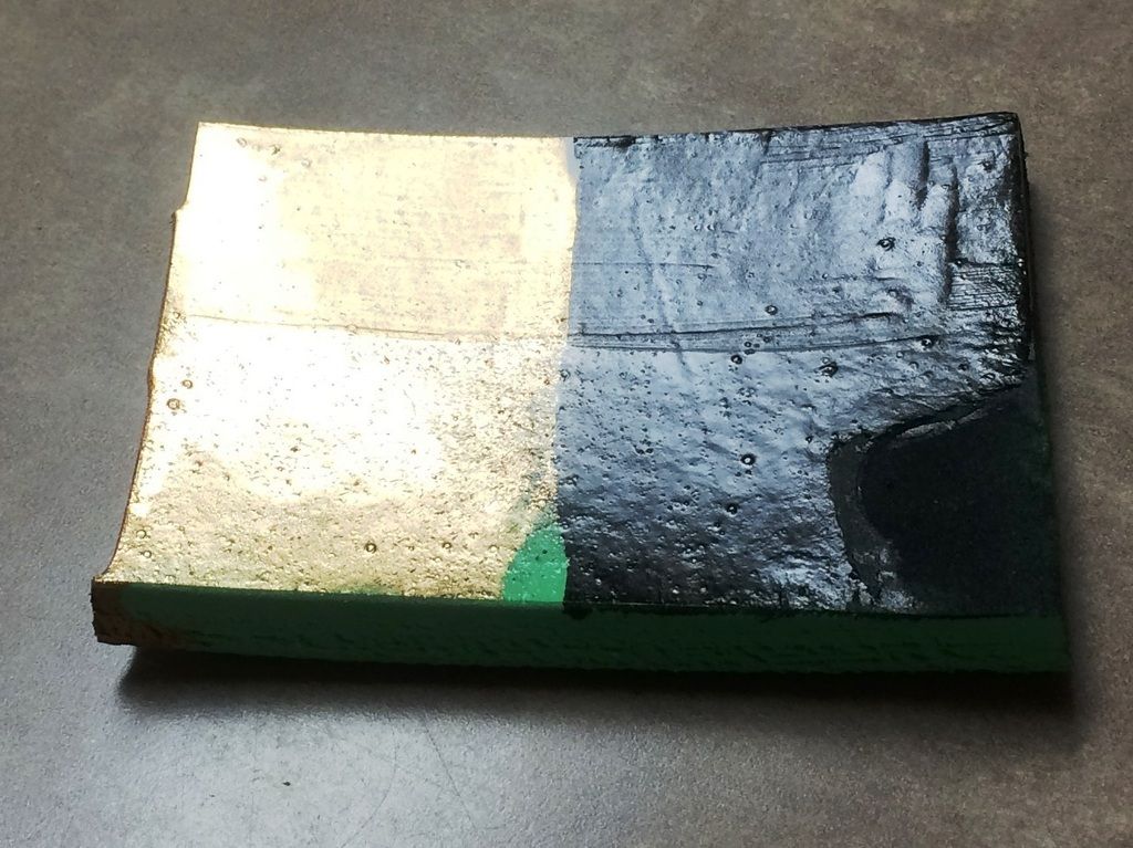

3x pure + 2x diluted: Good seal, but has texture from 3rd pure glue coat - http://i1276.photobucket.com/albums/y470/Martaxus/3x full w glue 2x diluted_zpsoif7un5d.jpg

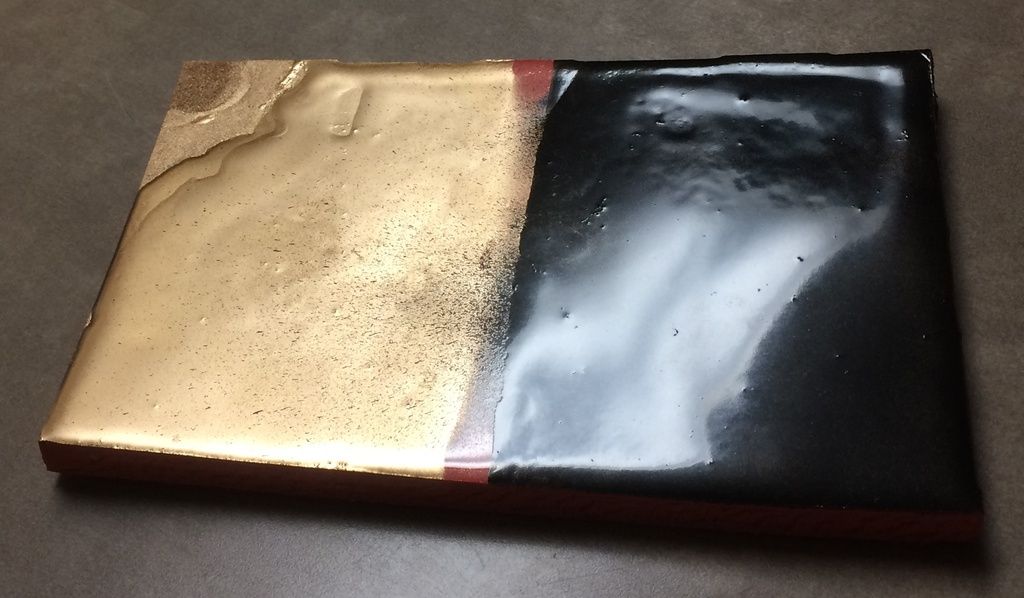

1x pure + 4x diluted: Almost good enough seal, good smoothness: http://i1276.photobucket.com/albums/y470/Martaxus/1x full 4x d bubbled_zpsxjpvznf6.jpg

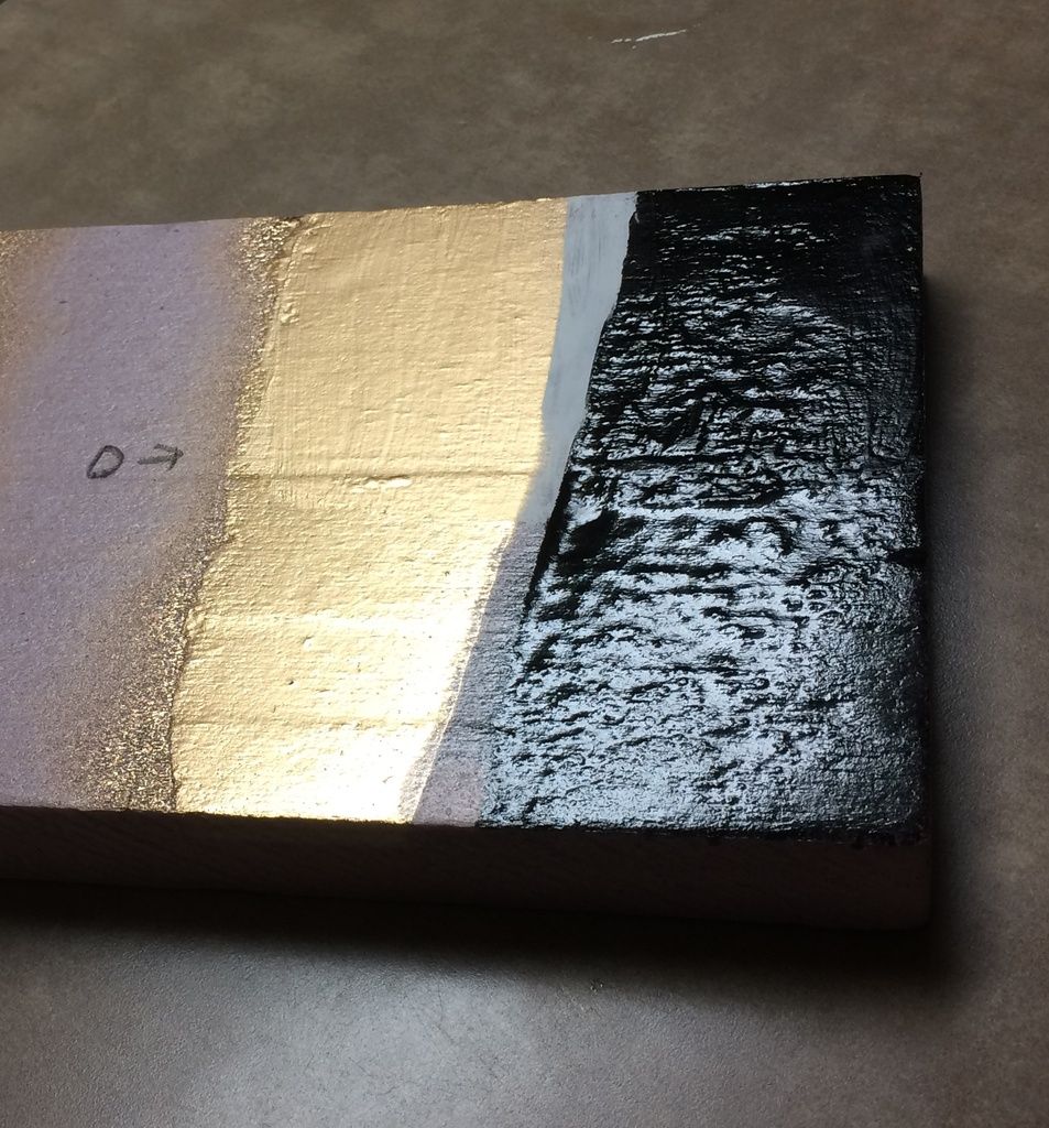

5x diluted. Texture of foam was still notable to touch. Not good enough of a seal: http://i1276.photobucket.com/albums/y470/Martaxus/5x diluted_zps2mhmtpnw.jpg

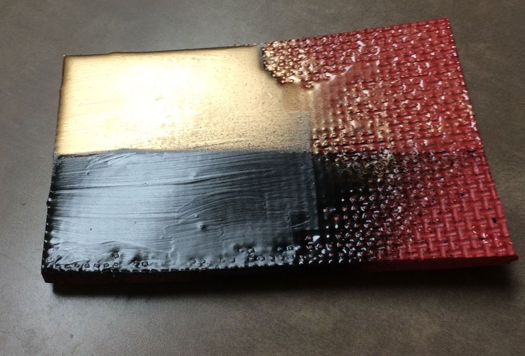

I found the Elmer's Clear glue at a larger Safeway store. I painted on 3 coats, which took much longer to dry than the white glue. I had hopes for this, but it did not accept the paints well and I feel it is the loser of the test, as I don't think the primer coat would remain flexible even if I wanted to use it: http://i1276.photobucket.com/albums/y470/Martaxus/Clear Elmer Glue 3x_zpslpfoswbc.jpg. It did pass the flexibility test well however!
