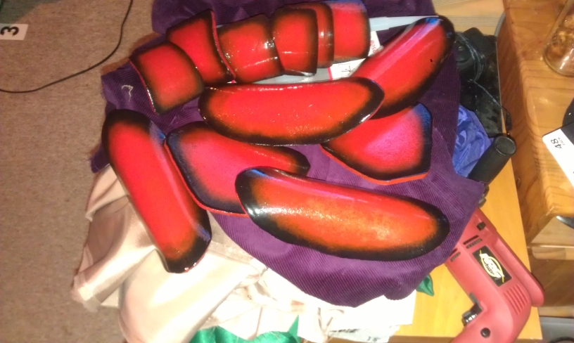

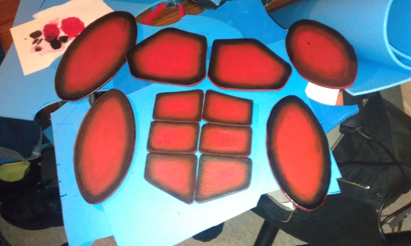

Apologies for the lack of earlier pics of this process, but here are the armour pieces for the torso and upper arms. All 5mm foam ($25 for a 1mx2m roll - KangaRubber: Brookvale, NSW). The arms were roughly measured, the rest were just realistic imagination and good measurement before cutting. 2 layers of glue, undercoat of black spray paint, then dabbing red and black acrylic all over. So.Much.Dabbing. Good practice for the wrist and shin pieces to come.

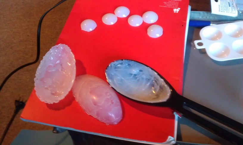

This is the garnishing on the armour, known to fans as Spirit Stones. I used a cheap paint well (on the right) to make the smaller ones, a purpose bought serving spoon for the larger ones (total, $4). After smearing the inside with butter to avoid sticking (unnecessary as they just snap out with some leverage), I crammed those wells full of hot glue, then put them in the freezer. On the spoon, after a couple of tries, I got the smoothest results from putting down the glue in parallel lines, working up the sides. In each of those spoons is a full stick of glue, the shell design is plenty sturdy and filling the whole thing is stupid. Note that craft glue does not stick to hot glue, at all. I'll test these more in a later post.

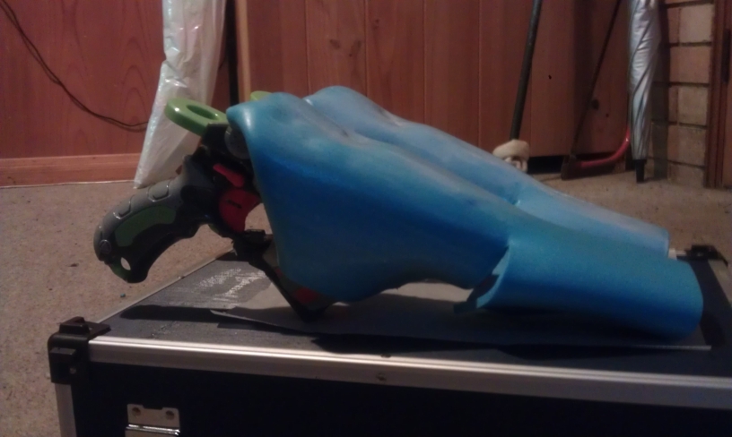

These are preliminary stages of the pistols. The Nerf Vortex guns ($8 each) inspired the design, being roughly the right shape and shooting the right non-lethal ammo. The foam on top is just a rectangle with two cuts for the separate looking nose piece. The foam was mashed on with hot glue along the spine, with the corners over the trigger folded up under. Wrapping the foam under the bottom was a two person job - Cheers, Marty - that side was too awkward to photograph after the glue coat seen here, semi dried. The curves of the nose were heat shaped, but I haven't hot glued them yet, which will hopefully provide a better shape. There will probably be additional foam on the final piece, but that's not yet designed.

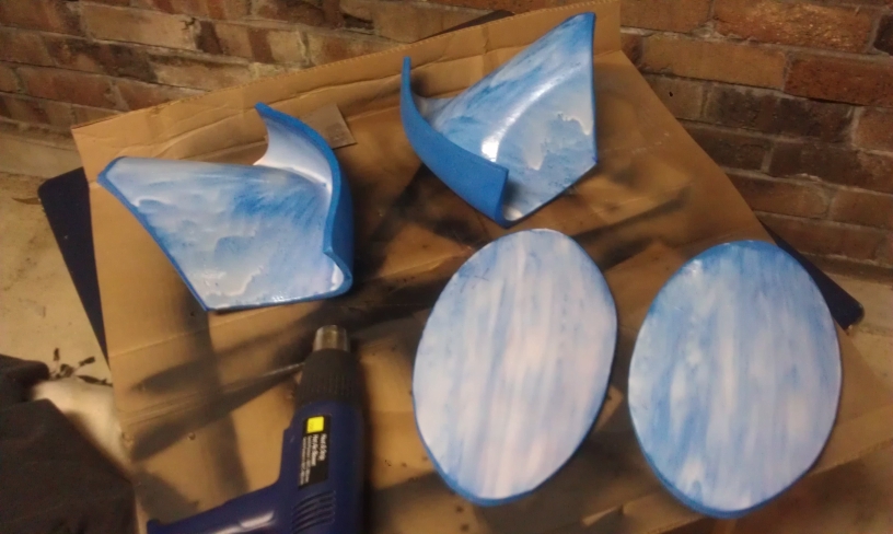

These are the shoulder and outside thigh pieces. These are both 9mm foam ($30 for a 1mx2m camping mat). After discovering the power of heat shaping, the shoulders were easy. The thigh is just a straight up oval with estimated measurements, the shoulders are rectangles with corners cut into the points you see. The glue is still fresh on these.

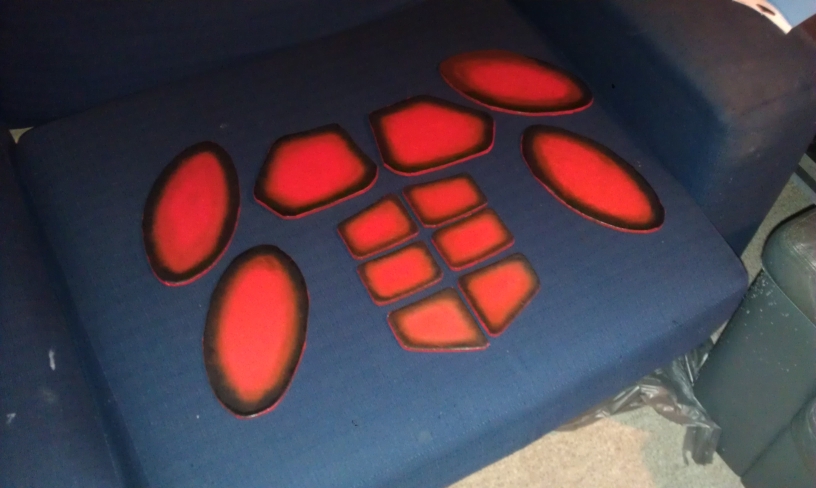

Maybe a little hard to see but these are the earlier torso pieces, gloss enameled and heat curved. I gave them a bit of over-curve so that when attached to the planned clothing, they'll sit firm. Or be easily reshaped.

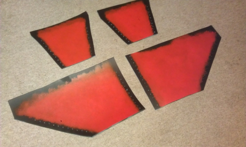

Here we have the wrist and shin pieces, close to finishing. 5mm foam. These will be laced on, hopefully you can see the eyelet holes there, unfortunately pre-drilled. Learning from this, before drilling holes in foam, seal it up with a bit of glue - hell, it seems like the full paint and gloss finish might be the way to go, keeping it firmer. The wider edges are going to be covered by an additional piece, in 9mm foam - forming the upper wrist/shin bits. When the outer pieces are finalized, some of those wider edges will come off. They don't look like much, but initial tests show that they fit. Dabbing all of that red on, twice now.. That's a whole lot of fraking dabbing.
