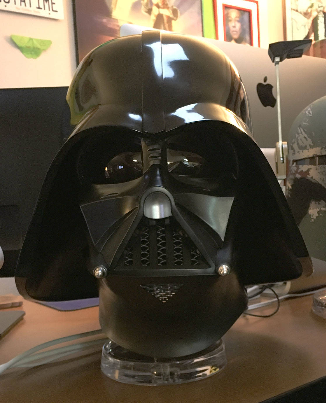

Made a stand for this (and my other helmets) using a $9 clear acrylic paper towel holder from Target and materials in my garage:

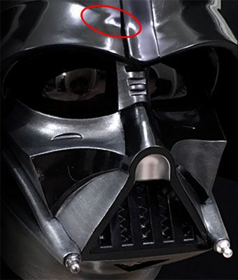

Plastic on my dome seems a little wobbly, see the dimple in the surface here, highlighted on its rim by reflected light. Is this present on y'all's?

That dimple is in every single one I've seen (difficult to see in some angles and lighting... but it's always there) as I've pointed out in an earlier post in this thread. Even the example pics on EFX's website have this same exact flaw.
This is probably the only big issue I have with this helmet mostly because it's a production flaw that simply shouldn't be there. The early prototypes didn't have this. The rest of the helmet is sharp as a tack so why does this conspicuous area look like this? The reshaped tusk tubes I'm perfectly fine with as this was necessary for the manufacturing process. I also don't mind in the least that the master pattern's surface texture was heavily cleaned up, sharpened and idealized, while thankfully retaining much of its screen-accurate geometry and proportions. This only makes the Legend and LE fiberglass/resin release all the more special and desirable. But that dimple has no reason for being there and I'm surprised only two or three people I've read online seem to notice it. It seems to correspond to the area where one of the latches inside the dome connect with each half. Overall, it's a really nice piece. But personally that dimple just drives me nuts every time I look at it. It's wishful thinking, but hopefully EFX will address this issue and maybe offer replacement domes.

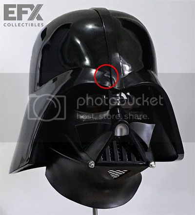

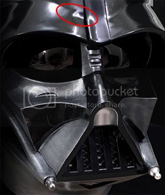

http://img.photobucket.com/albums/v50/alandron/efxvaderwarp02_zpscamste8f.jpg http://img.photobucket.com/albums/v50/alandron/efxvaderwarp01_zpsano9evja.jpg
Good call, that's exactly what must have caused it. It's what happens in injection-molding when there's a big piece---it shrinks as it cools, resulting in a "sink" in the thickest part. Model kit builders have to deal with it often.
I'd be more upset if this were originally designed as an injection-molded piece, as there are steps they could have taken in manufacture to prevent it (like make that inside piece a separate part added later). But since it was originally fiberglass, there was no need to make such an accommodation in the mold. So I get it, the reason we got this version at all (and at a good price) is because the molds for the fiberglass version already existed.
So I can live with this one artifact of that product production history. (Not that I wouldn't welcome a replacement if that happened. ;) )

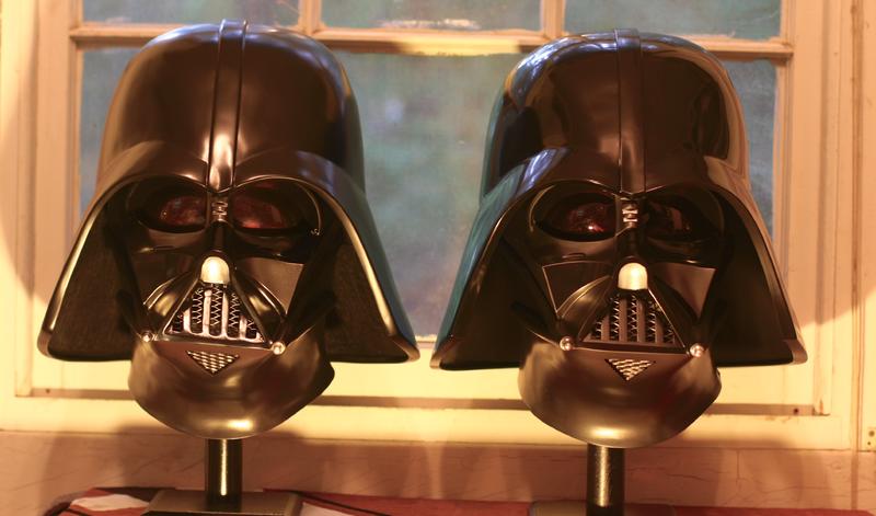

This looks in person only a little softer area on my helmet.Not really a big thing.Same with the "Y" on the middle stripe.Here is a pic from a member here that has both helmets in his collection...you can see that the areas over the eyes are sharper on the Legend:
But the plastic helmetdome has also lots of dents and flaws from the Originalhelmetscan.
