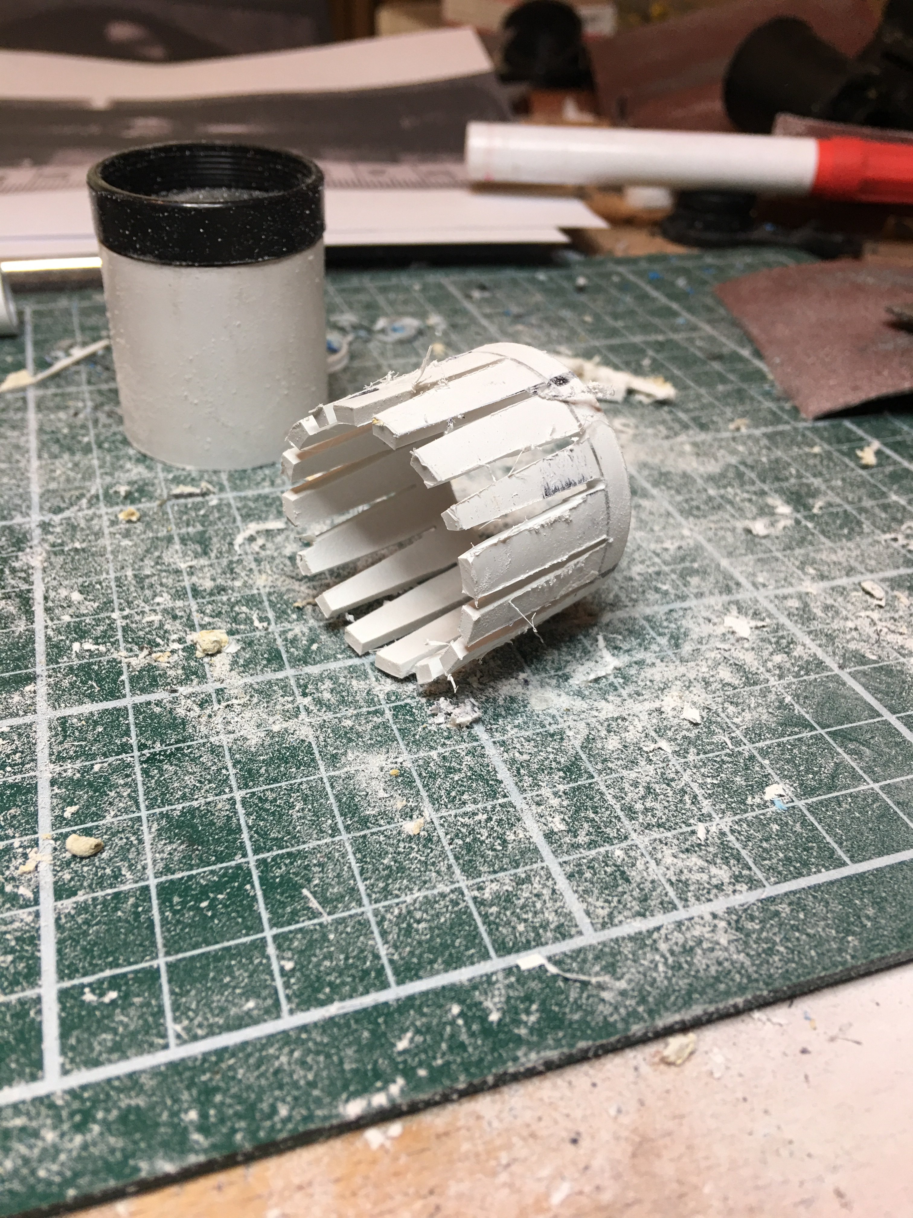

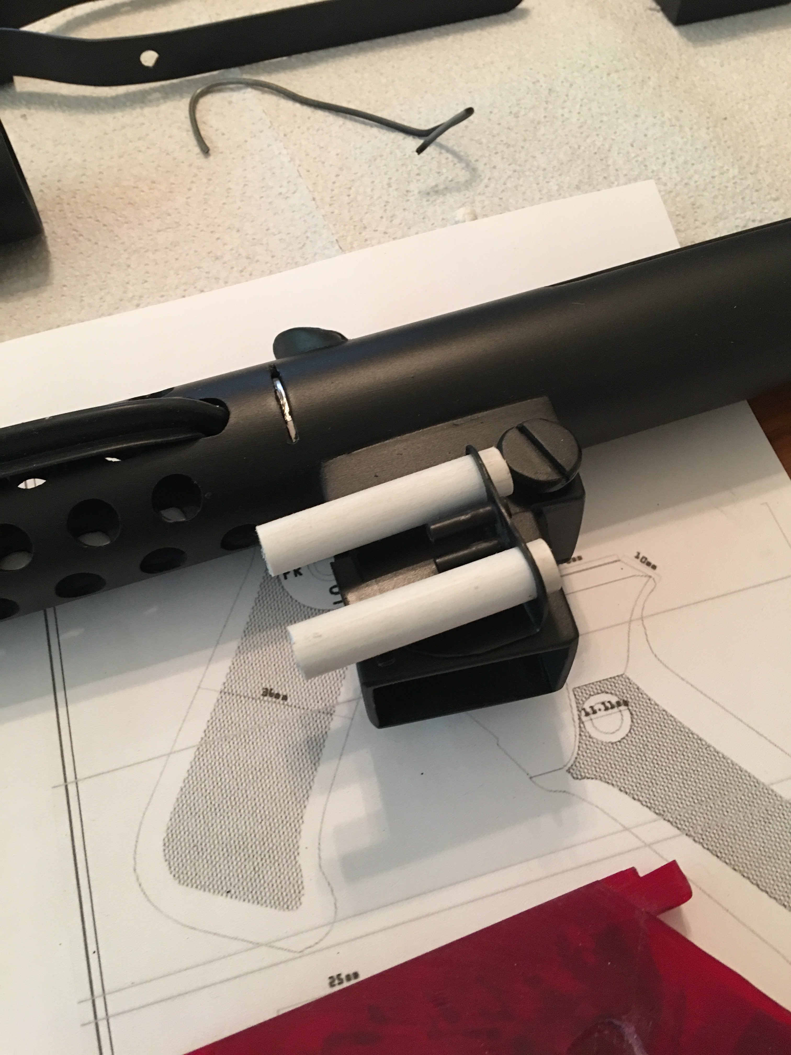

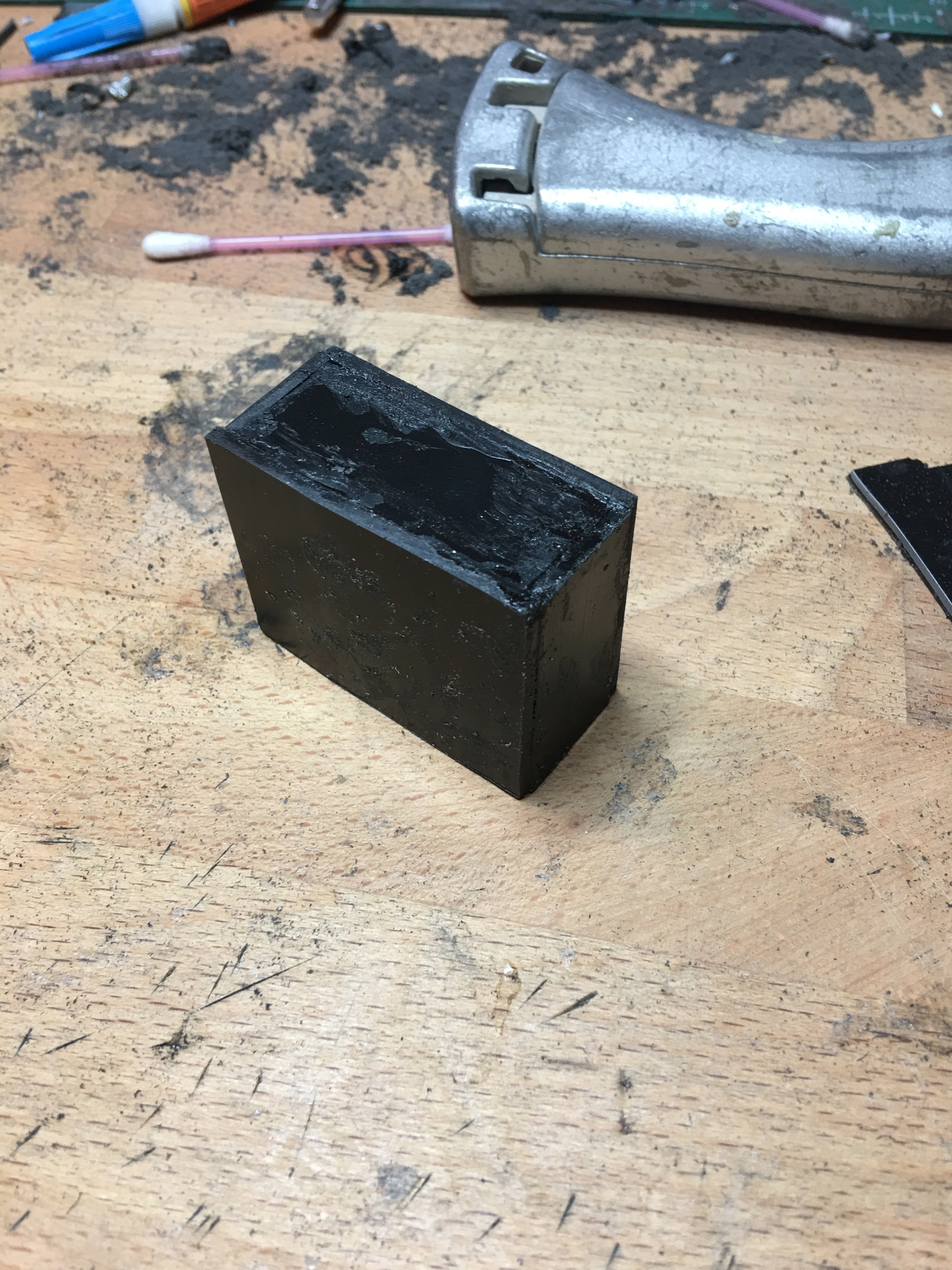

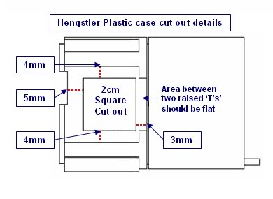

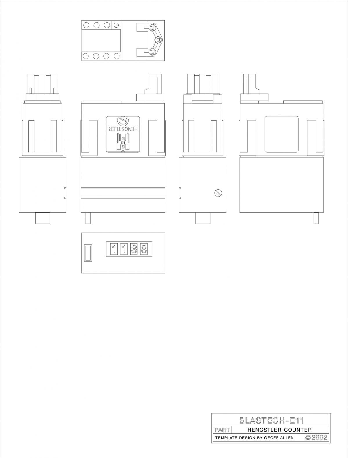

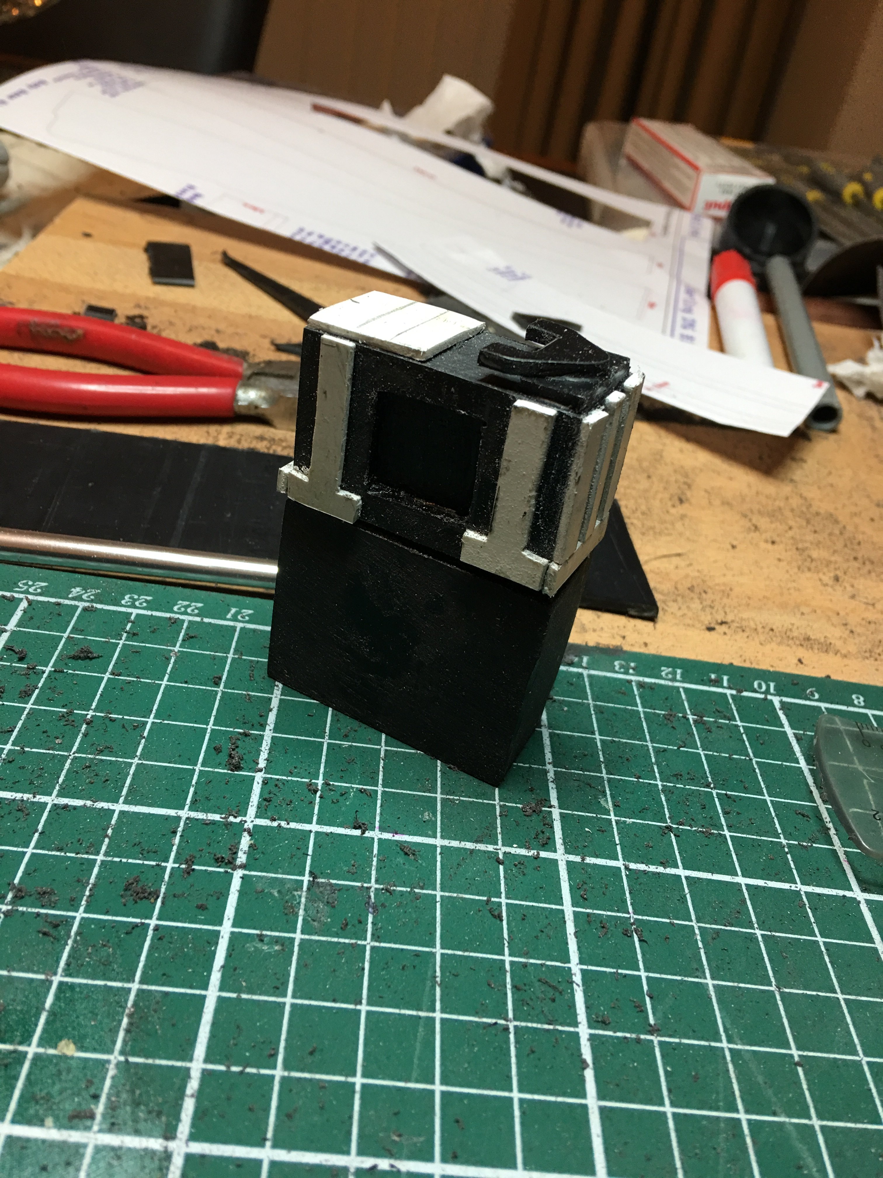

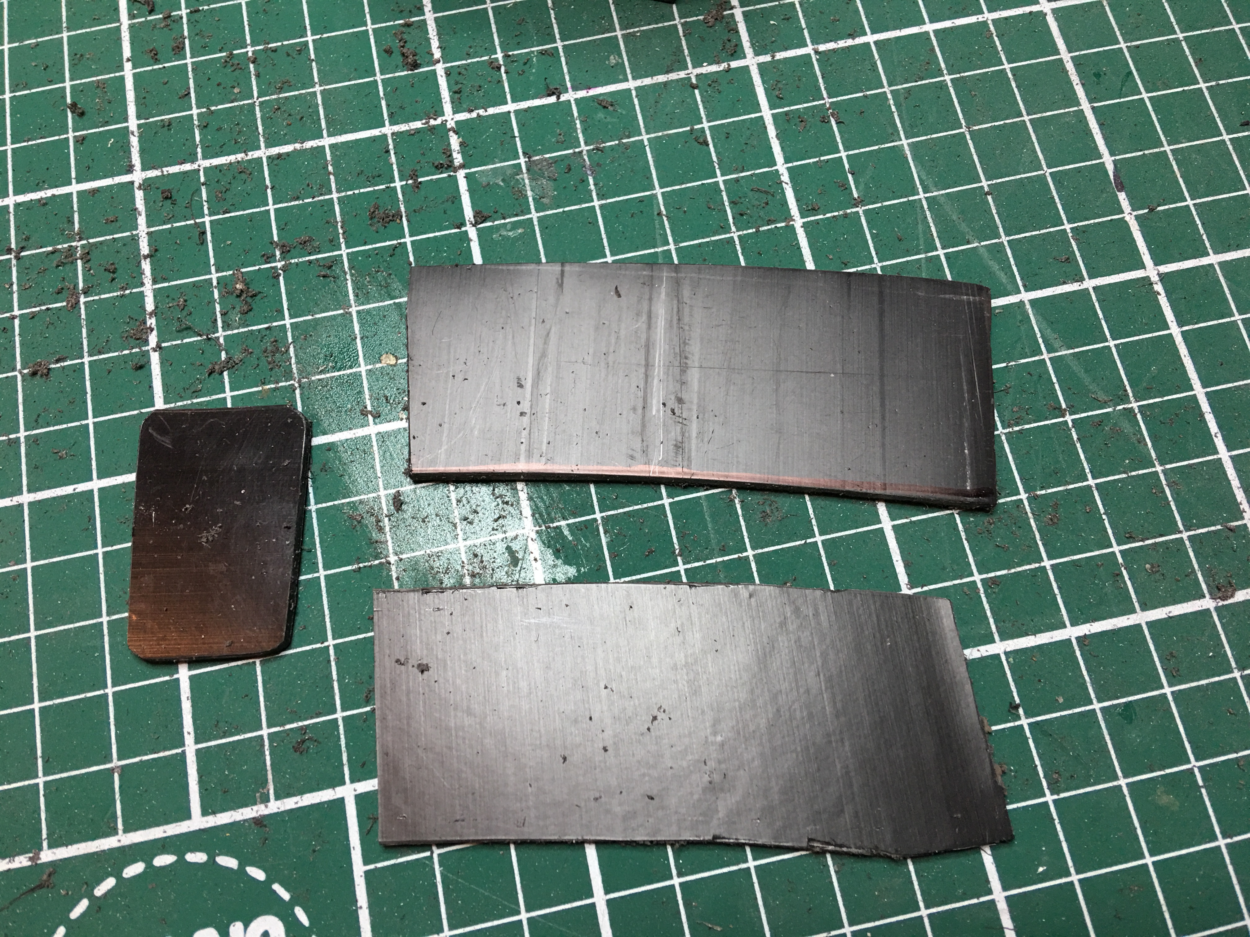

Ok I’ve made 2 boxes for the Hengstiler counter, they now have to dry over night so I can sand them down
CD200A51-252A-46AF-9B9A-BE63B860300F.jpeg6E61EA53-4F9A-4304-92E0-8C9CAAF04C95.jpeg68B6C3CE-C163-473C-AAA1-5D5A013E4D6A.jpeg
I’ve cut some 19mm white plastic ABS pipe down and stuck it in the oven for 10mins and flattened it down
The white plastic can now be used for thinner / smaller details on the Heng box
I can’t do any more work on the boxes as I need to let them dry and sand them down

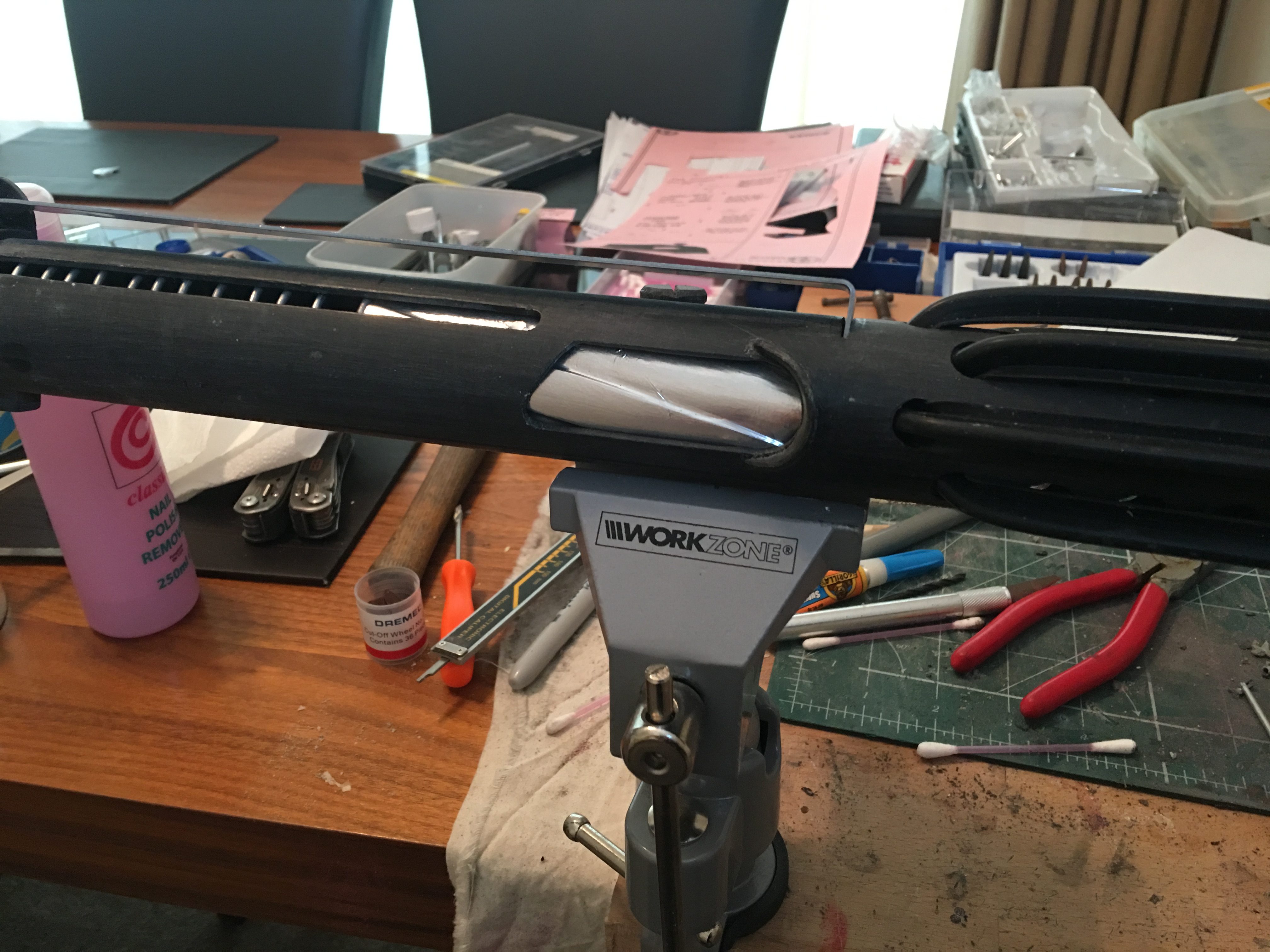

I’ve added to the cap end a small detail that also needs to dry before I can sand it down
Also having a test fit of the folding stock to the underside, the new 1.2mm stock hasn’t turned up as yet

I’ve sanded down the heng counter box and started to cut and stick some side details on BUT I was looking at the wrong drawings and cut them all wrong so I’ve peeled them off and now I’ve to let the glue dry overnight before I can sand away the residue and start again ( to many crap drawings flying around on the internet )

I’ve cut and stuck some pieces ( roughly I may add ) on the heng box, the glue needs to dry so I can sand it down and add a couple of more pieces ( mmmm not very pretty) but it will be

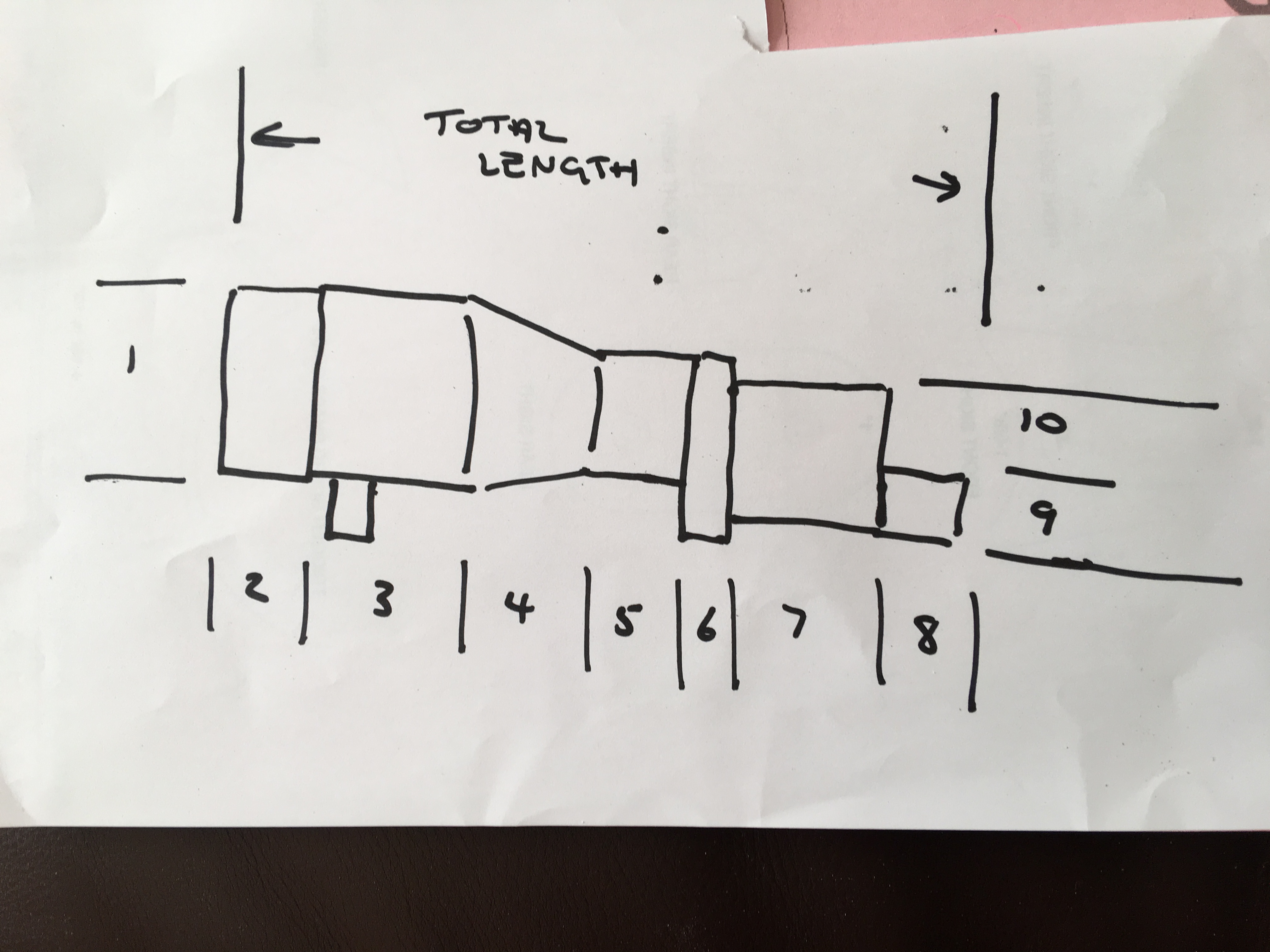

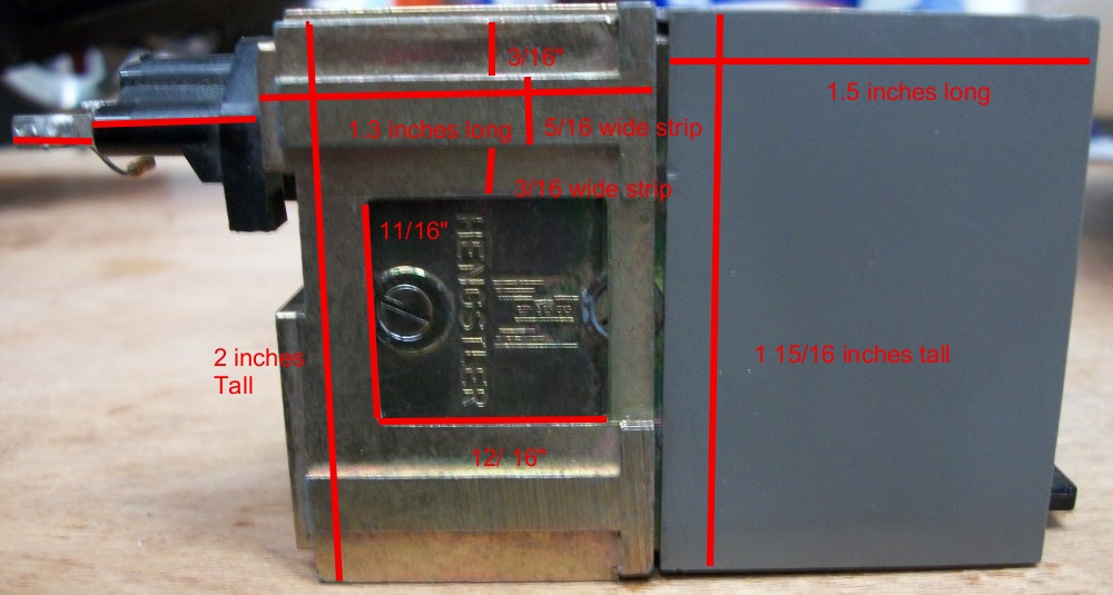

I cannot find any measurements for the scope all I can find are original pics or resin copies, nothing that shows actual measurements, I would like to make this over the weekend along with the handle/grip
this is the last weekend for building the main components as I need to get this painted next week
can anybody please help
nobody with scope measurements ?
I have one but not sure how to take measurements. How would you like me to do it?
Sent from my Starfleet-issue communicator
hi zsherman I really appreciate your reply and would love as many measurements as possible, measurements in mm if possible and they really don’t have to be exact just as close as possible, this build is not going down as screen accurate just for fun
here is a pic with numbers written on if you could just reply with the numbers and relevant measurements
many many thanks
Ben
many many thanks
Ben

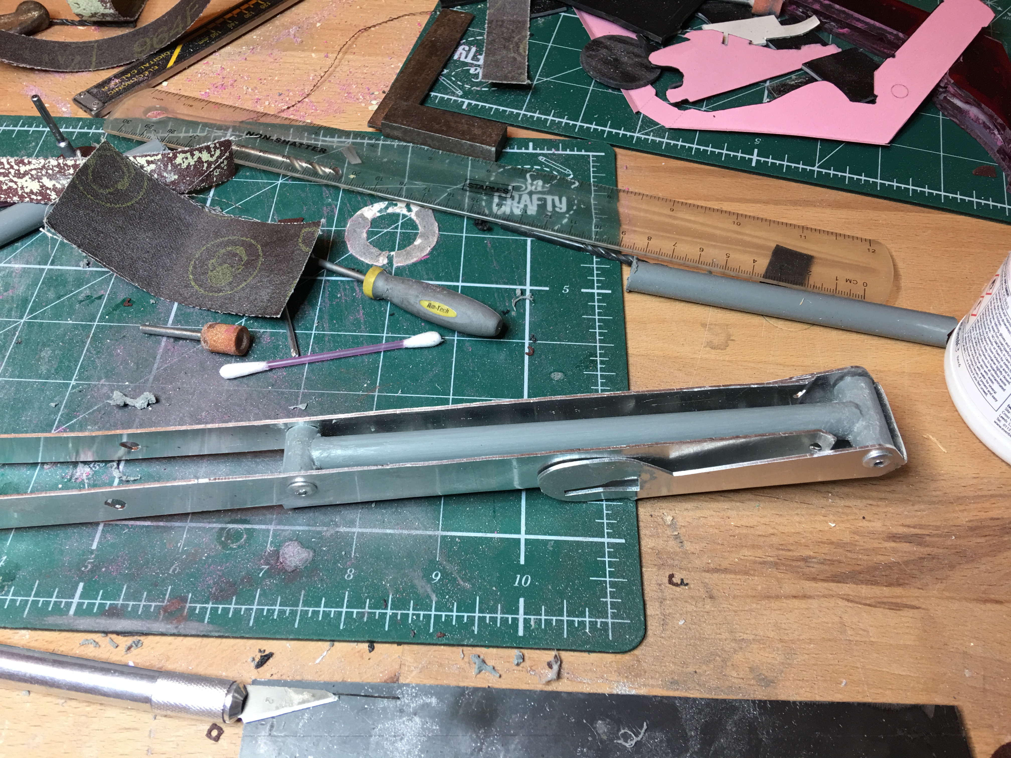

I’ve got the new 1.2mm folding stock that I need to fold, 0.2mm makes so much difference, so much stiffer than 1.0mm
ive now got my measurements for the scope thanks to zsherman

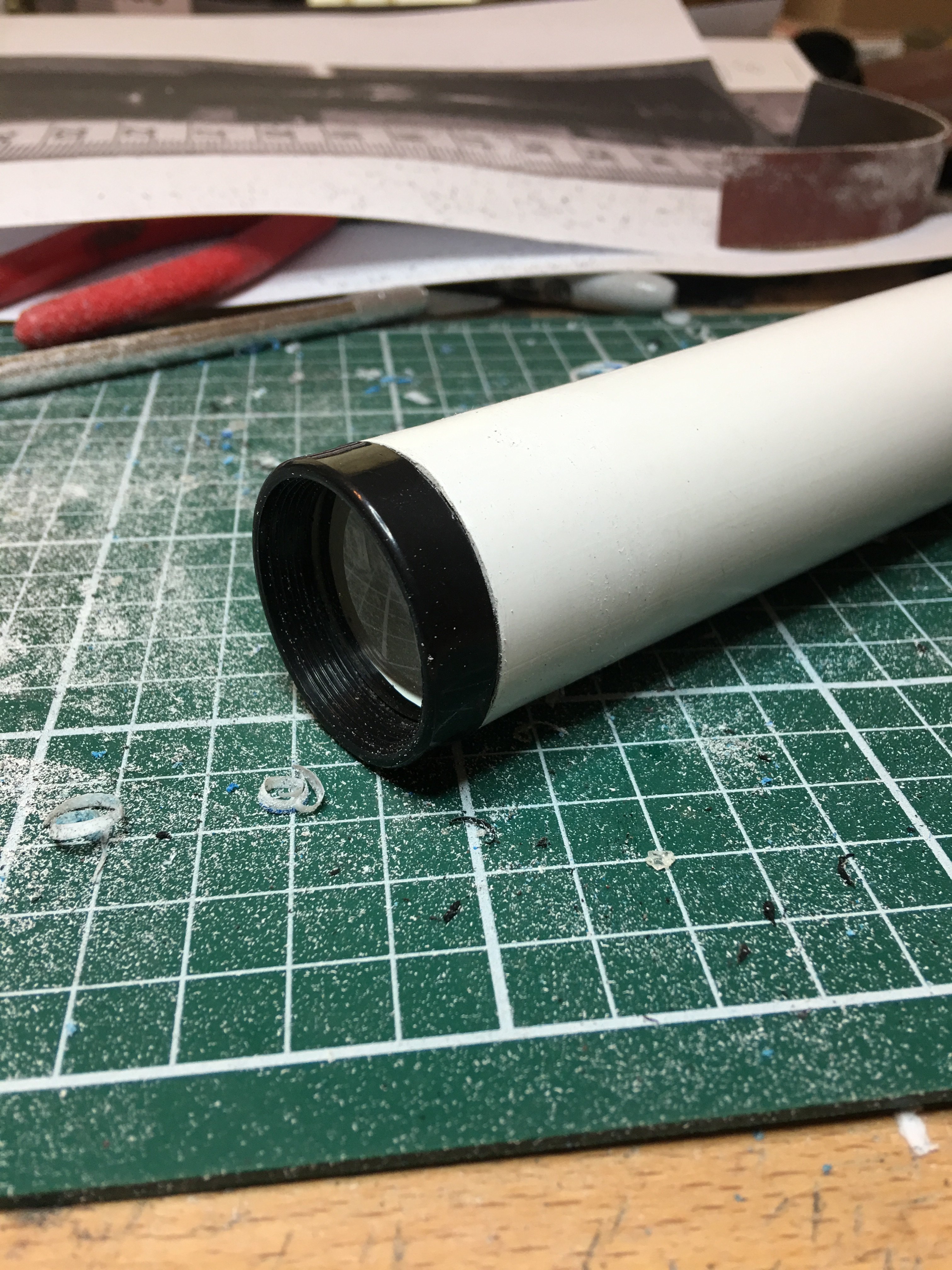

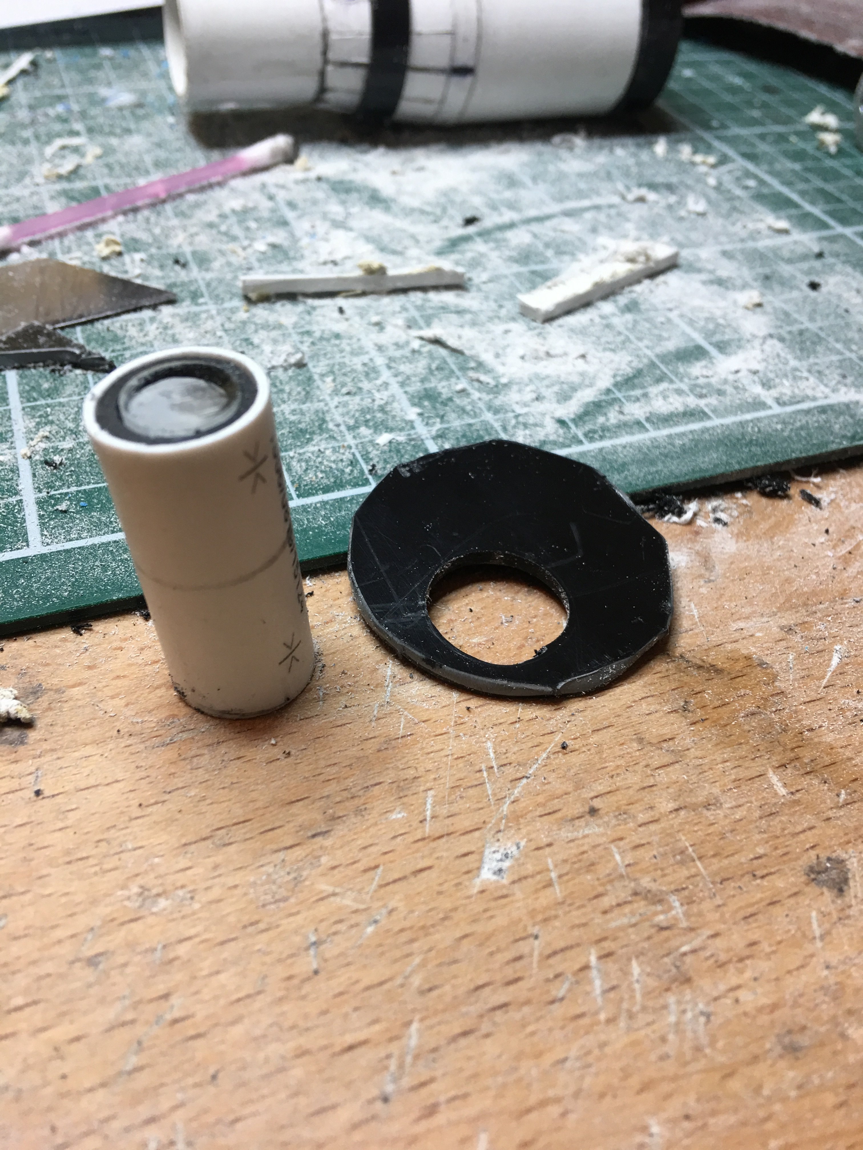

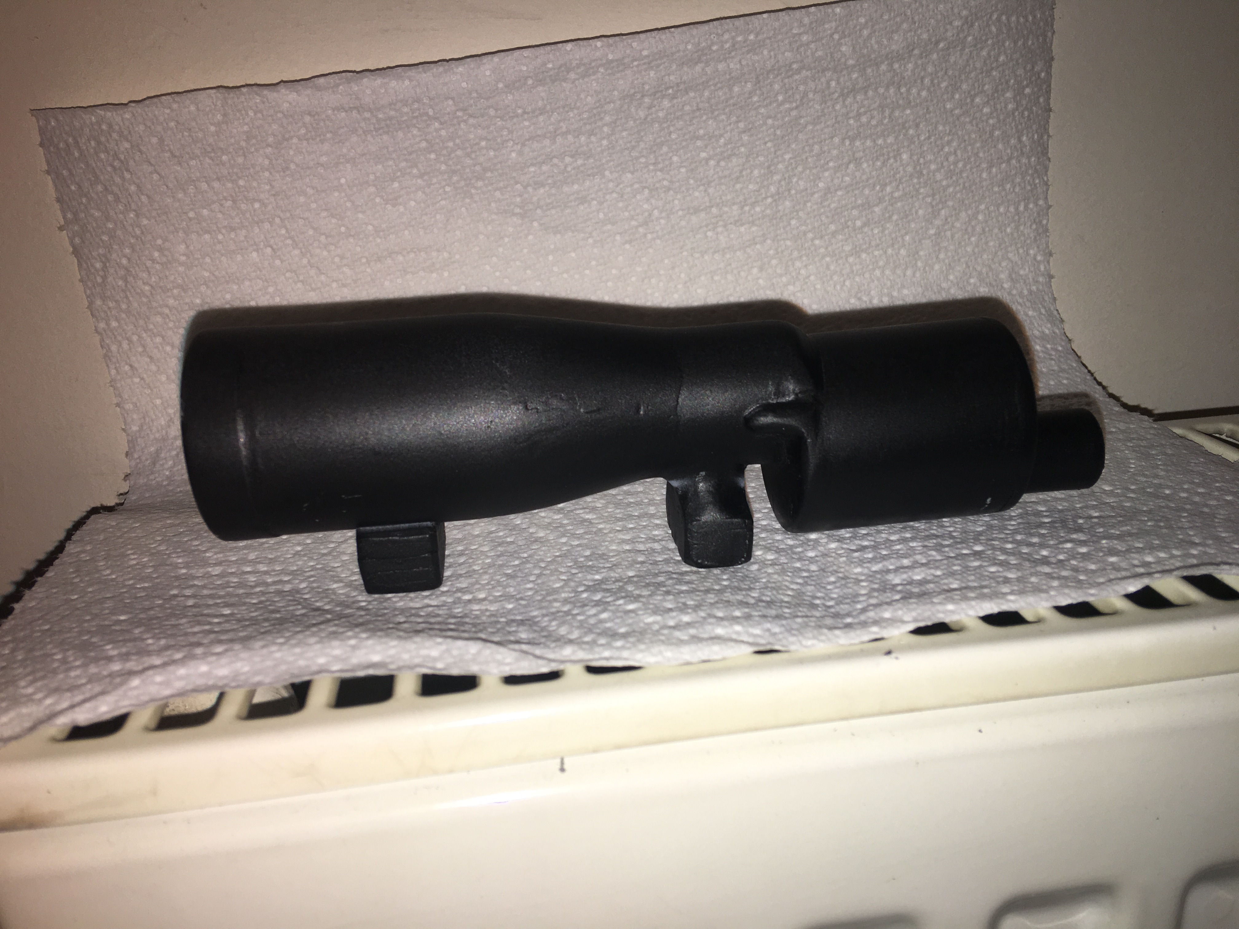

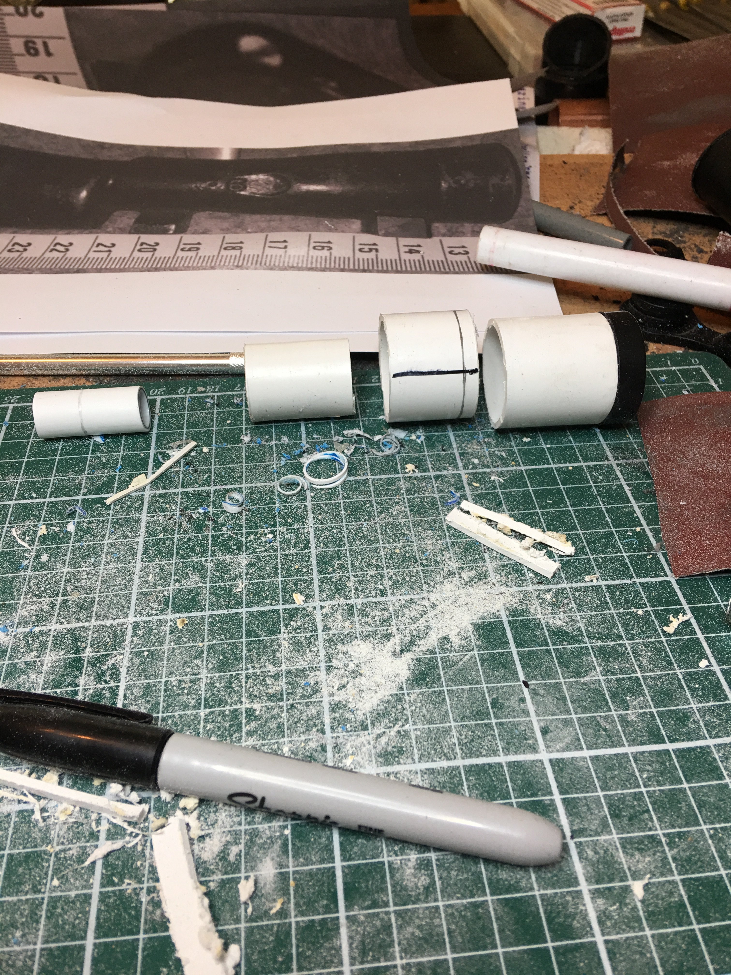

I started work on the scope

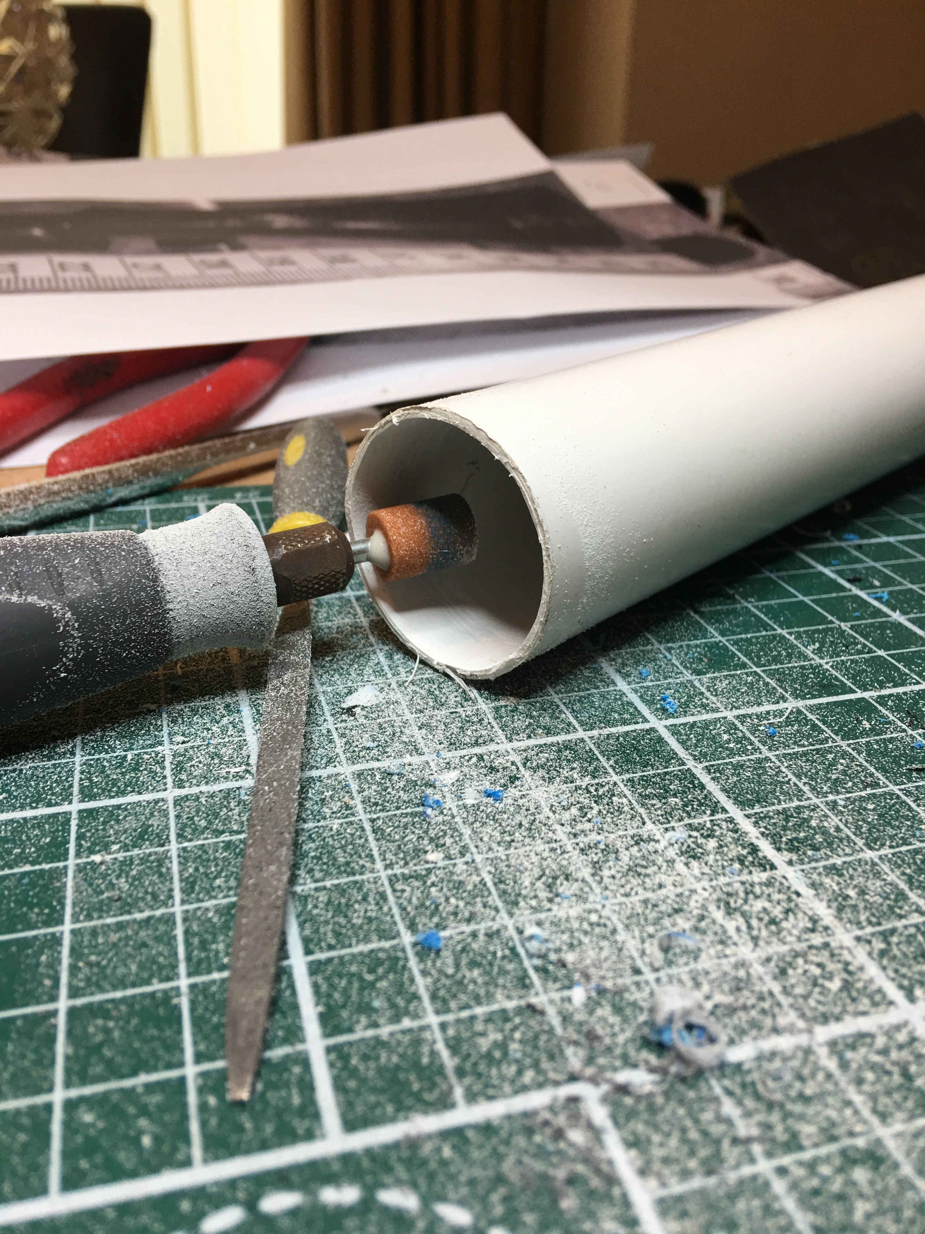

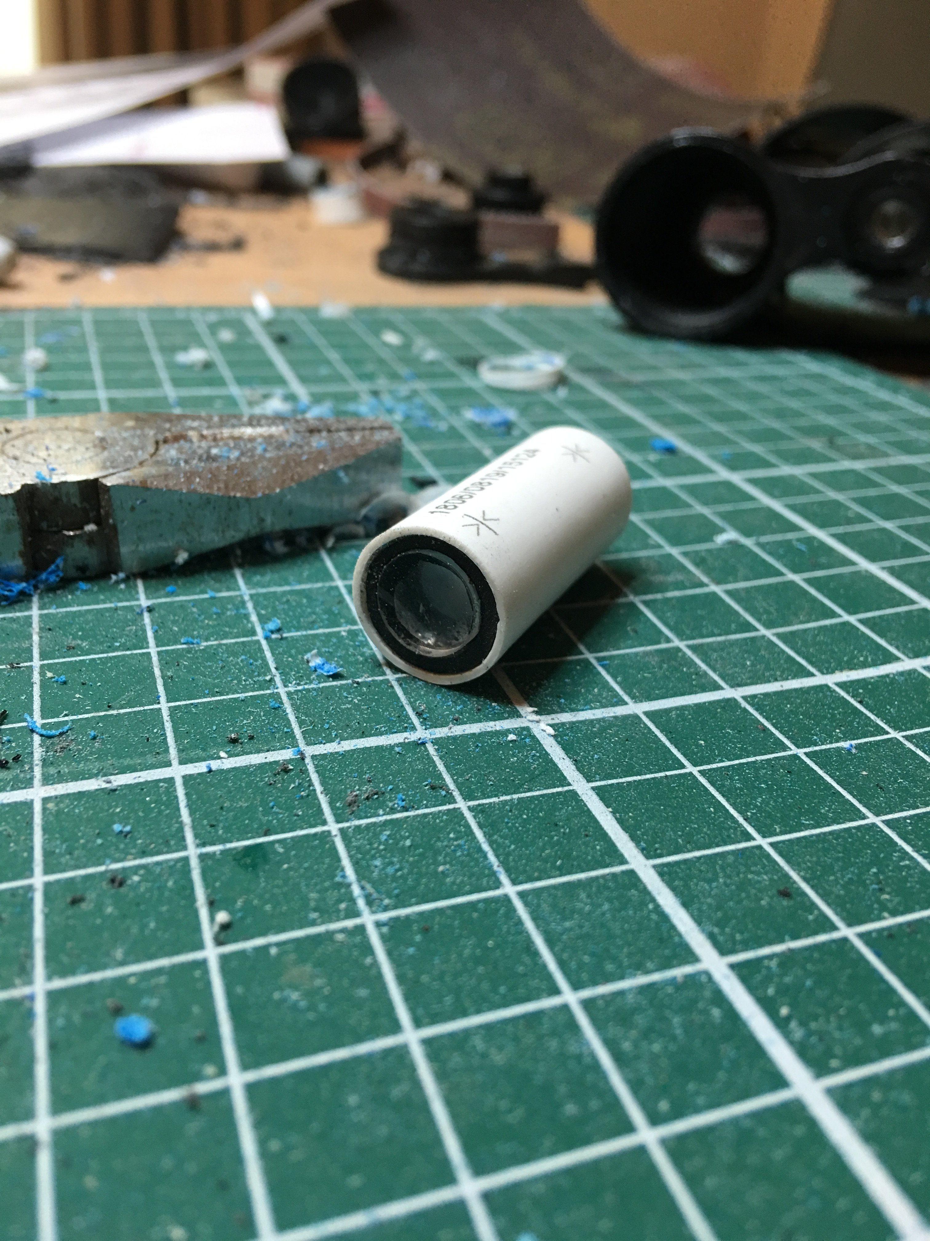

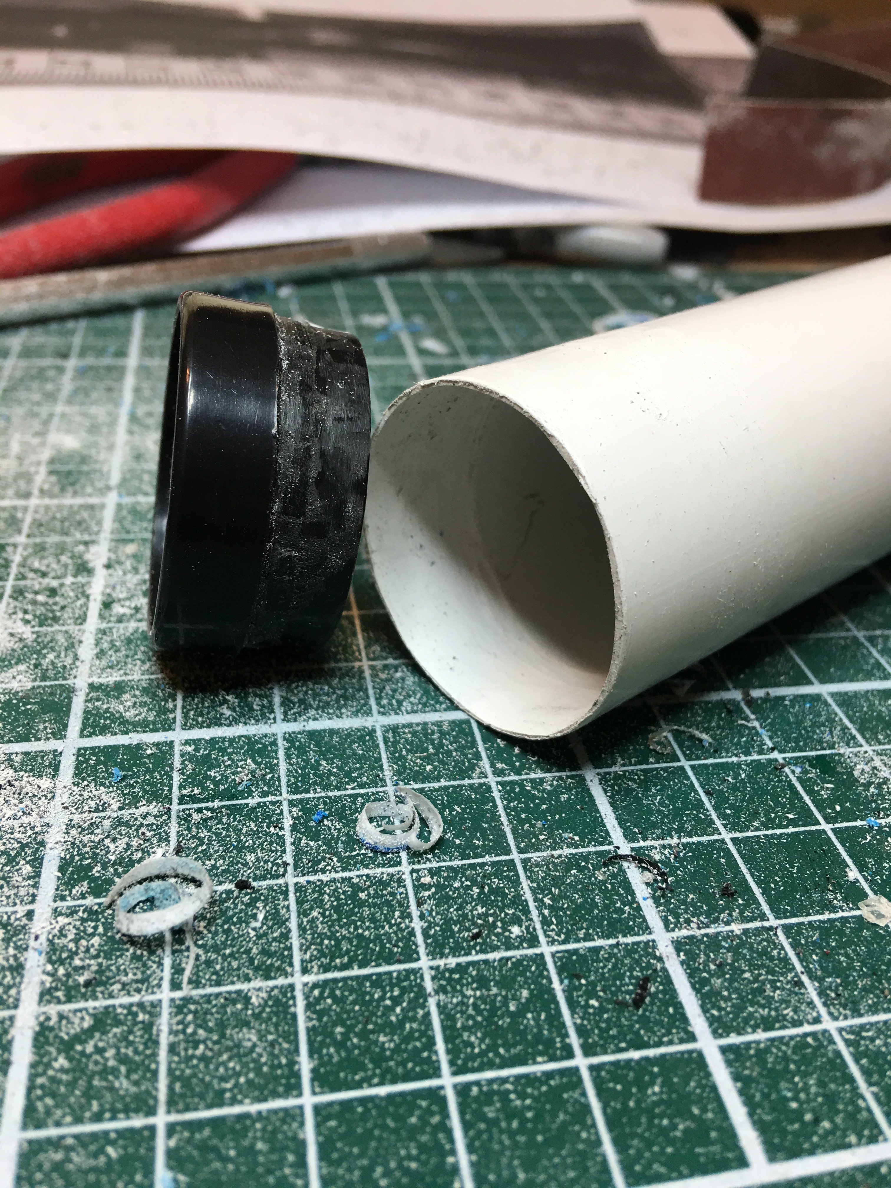

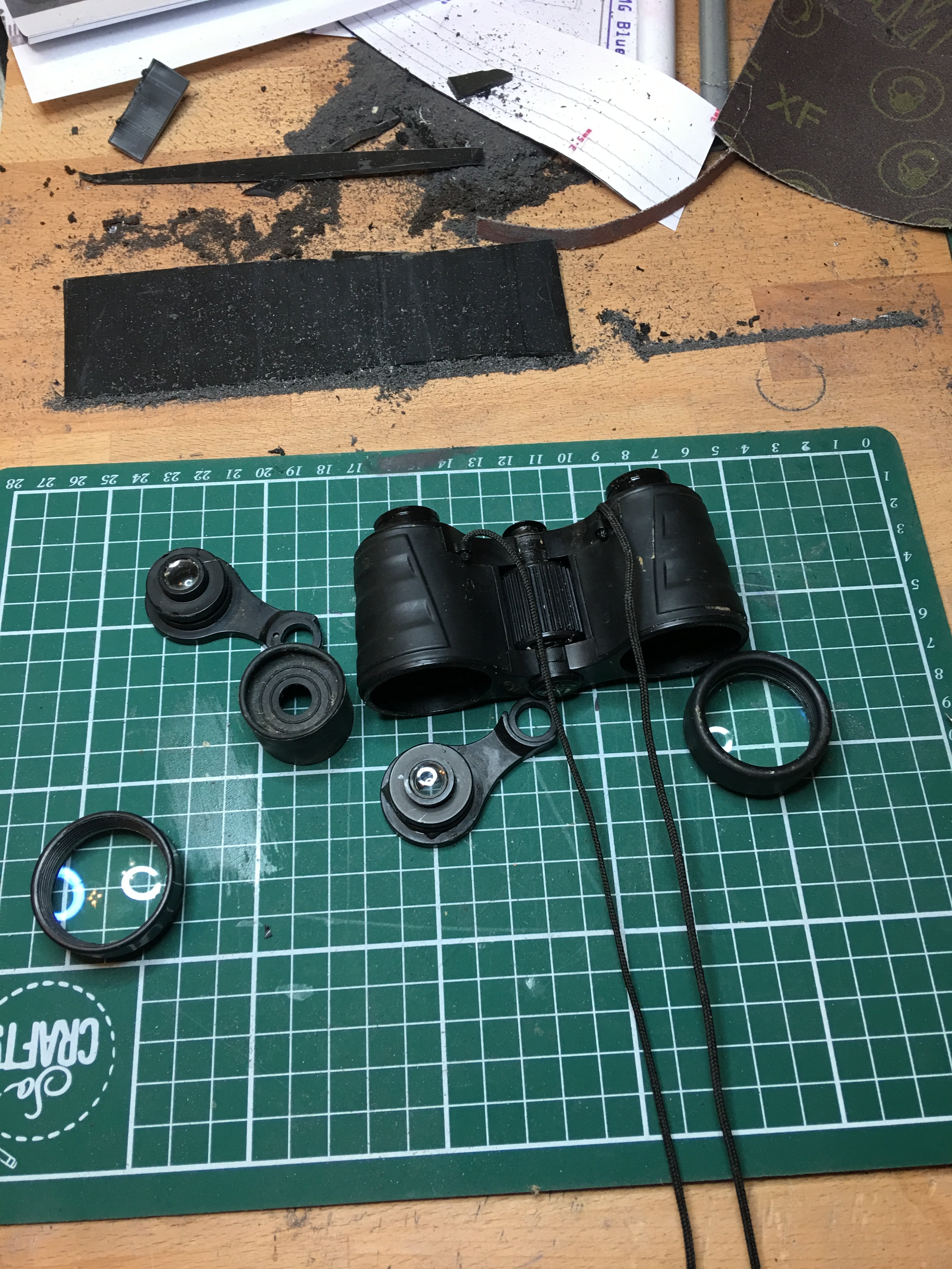

i started with a cheap pair of binoculars that I picked up from a car boot sale for £2
the small lense nearly fit inside the 15mm plastic pipe, with a little help from my dremmel and sanding the inside edge of the pipe it fit snugly inside
35305A1C-B765-401F-9A3E-D3A702D68239.jpeg3836E9B2-0ED4-4DE2-84B6-9BA2A08F6185.jpegE431858C-038C-4F40-8975-CEFE9B29F412.jpeg
For the larger lense I used 1.1/4 waste pipe that was the same size of the larger lense, again I had to use my trusty dremmel to sand away at the inside edge of the pipe for the lense to fit
FF64D59C-0C48-4EE3-814B-39E3BF264133.jpeg9092ECF8-E438-4948-ABE1-507942C3863D.jpeg3174D975-228F-4628-8EE4-DD66563235CE.jpegA74AC806-EEDC-4B64-962B-85A543EA5FE2.jpeg

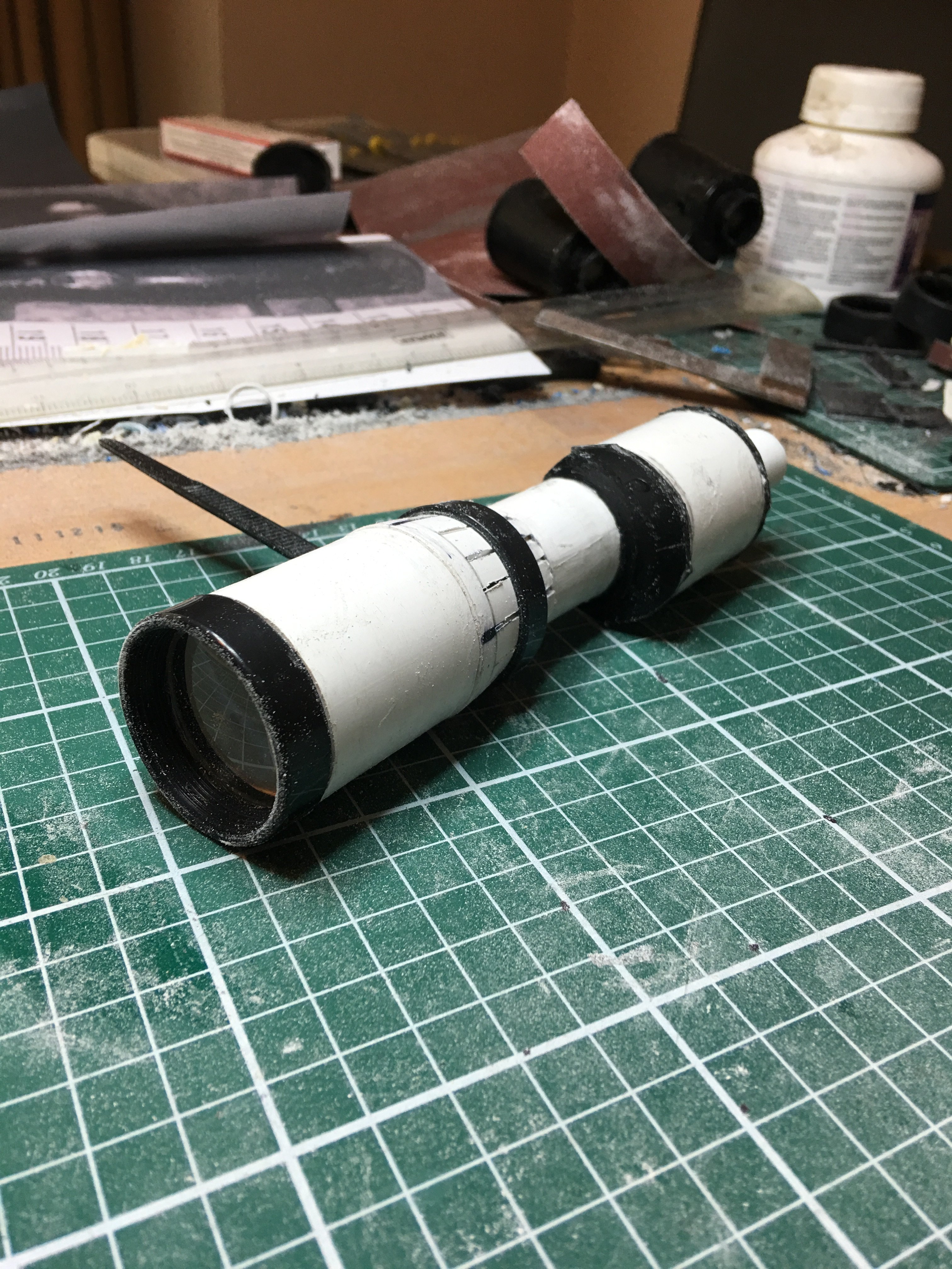

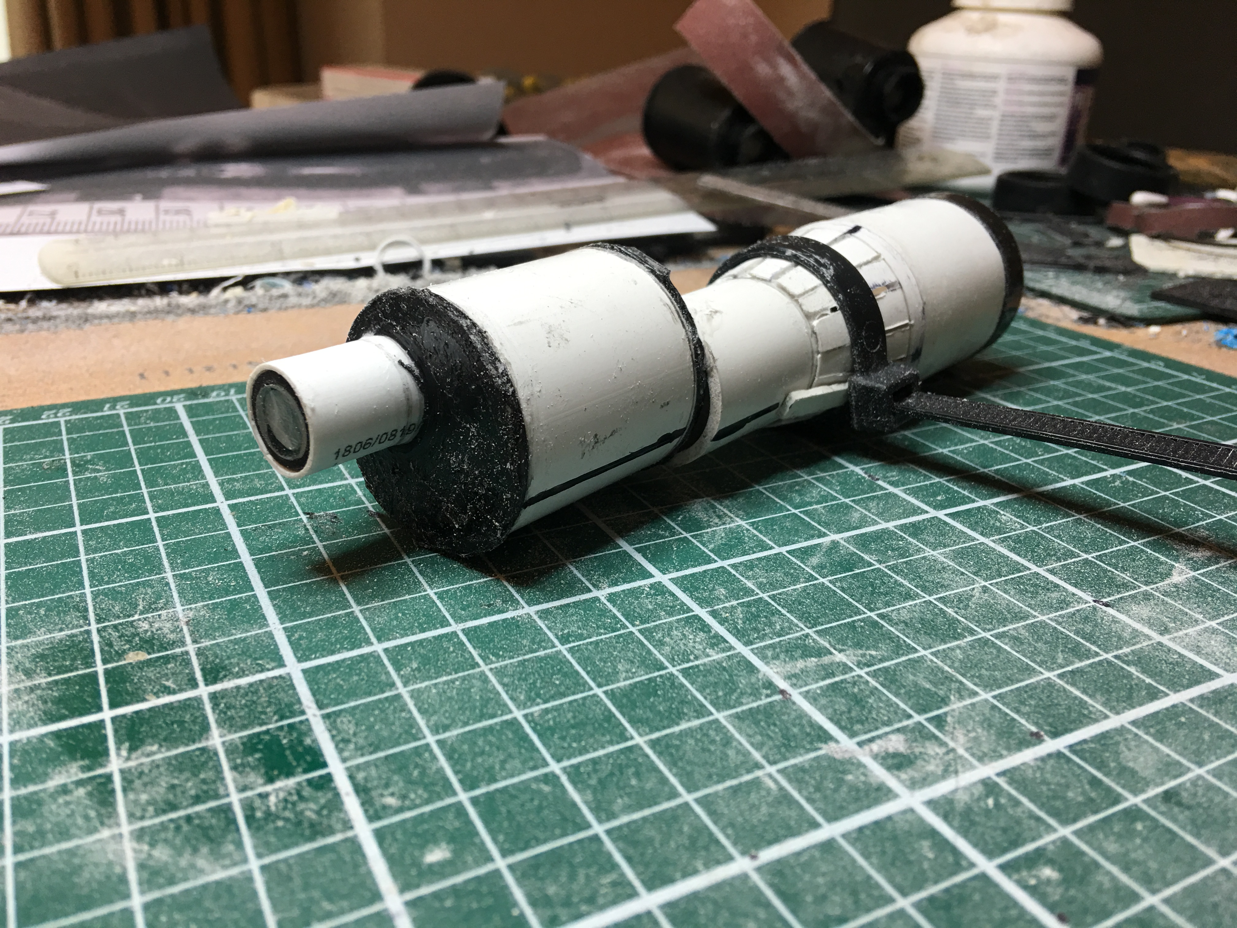

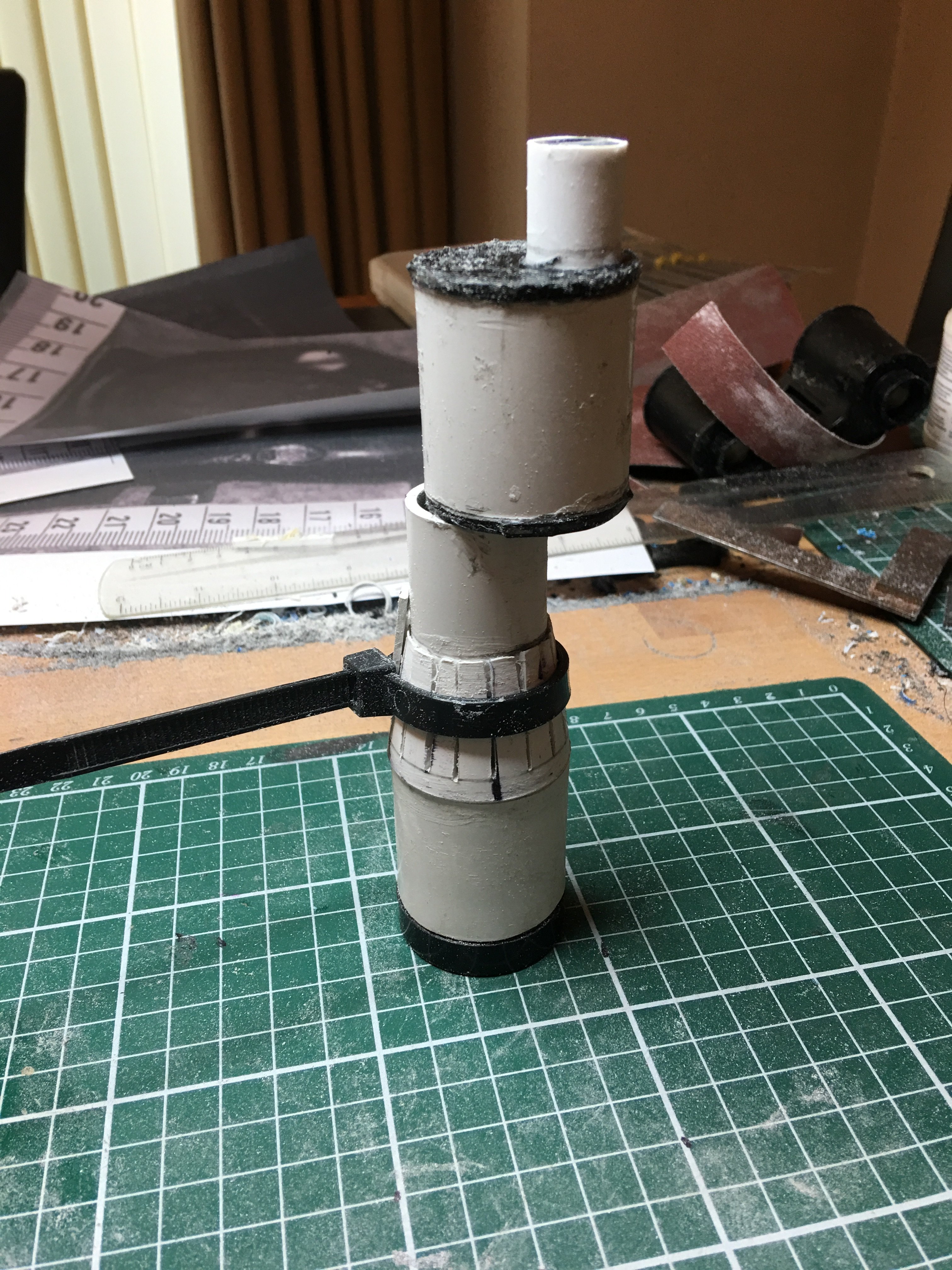

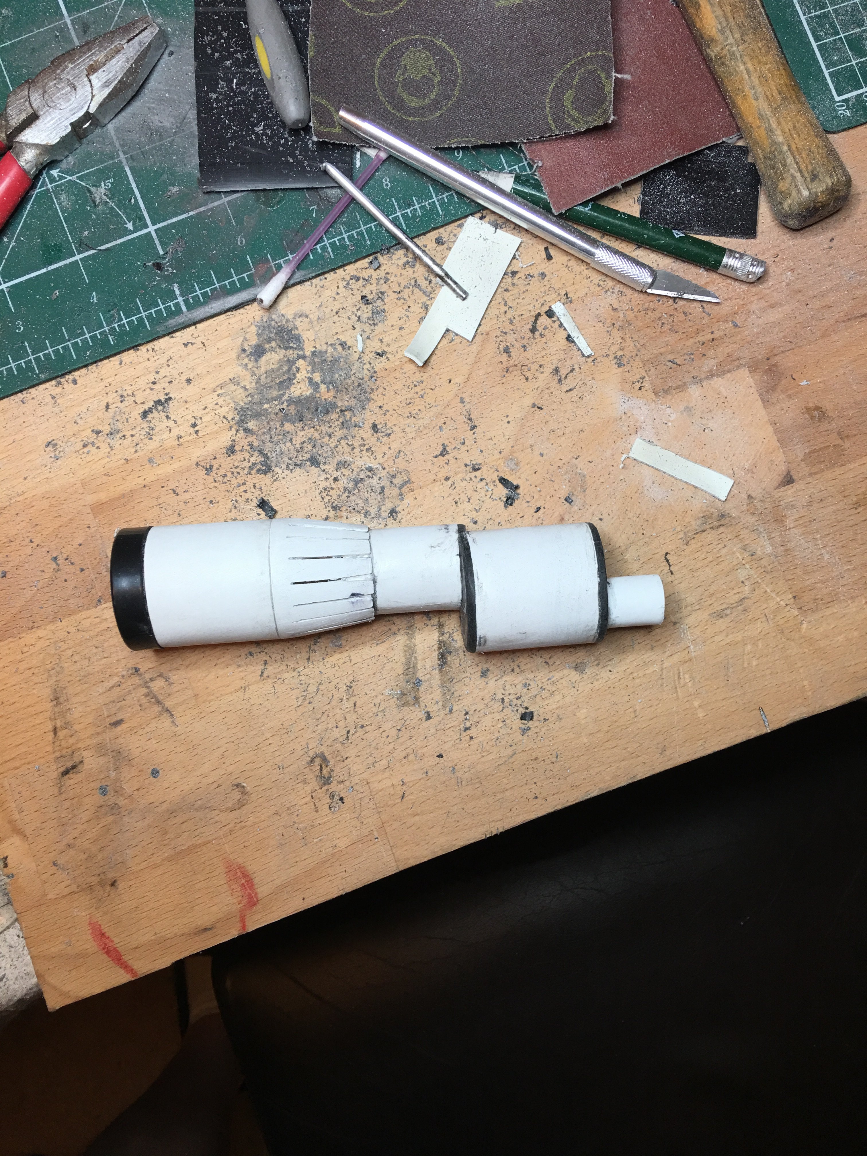

I then cut some pipe to length for the rest of the scope, one piece I had to cut and pop it in the oven so I could re-roll it into a 26mm tube then re-glue it
For the Sloping piece I cut lots of lines in the pipe so I could pull the edges together and glue inplace with a cable tie around the 26mm piece
I then started to put end caps on for gluing it together
F247D29A-2709-4C6B-AF37-99E664AFB7A1.jpegC1279C77-FA05-4C0E-A144-15B1E6811CE8.jpeg0F990977-4340-4A5D-A29D-D663E6BBD9DD.jpeg6E45D138-B9BC-4B87-9192-D06E94E1A753.jpeg40A81209-A6AA-4030-ADB2-7FFFEC5F347D.jpeg
After the glue had dried I gave it a quick sand down, tomorrow I will add some filler and brackets then rub down again

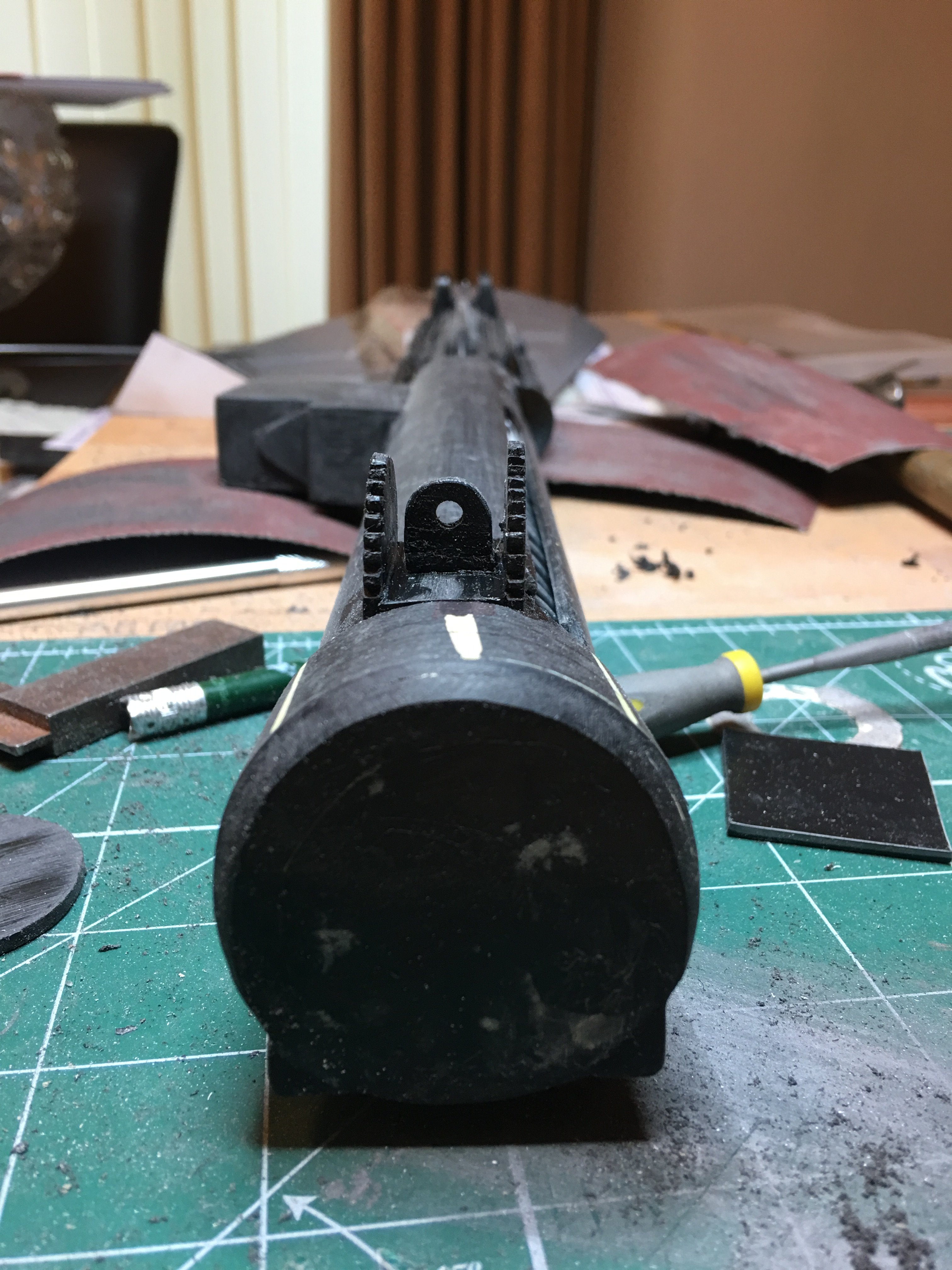

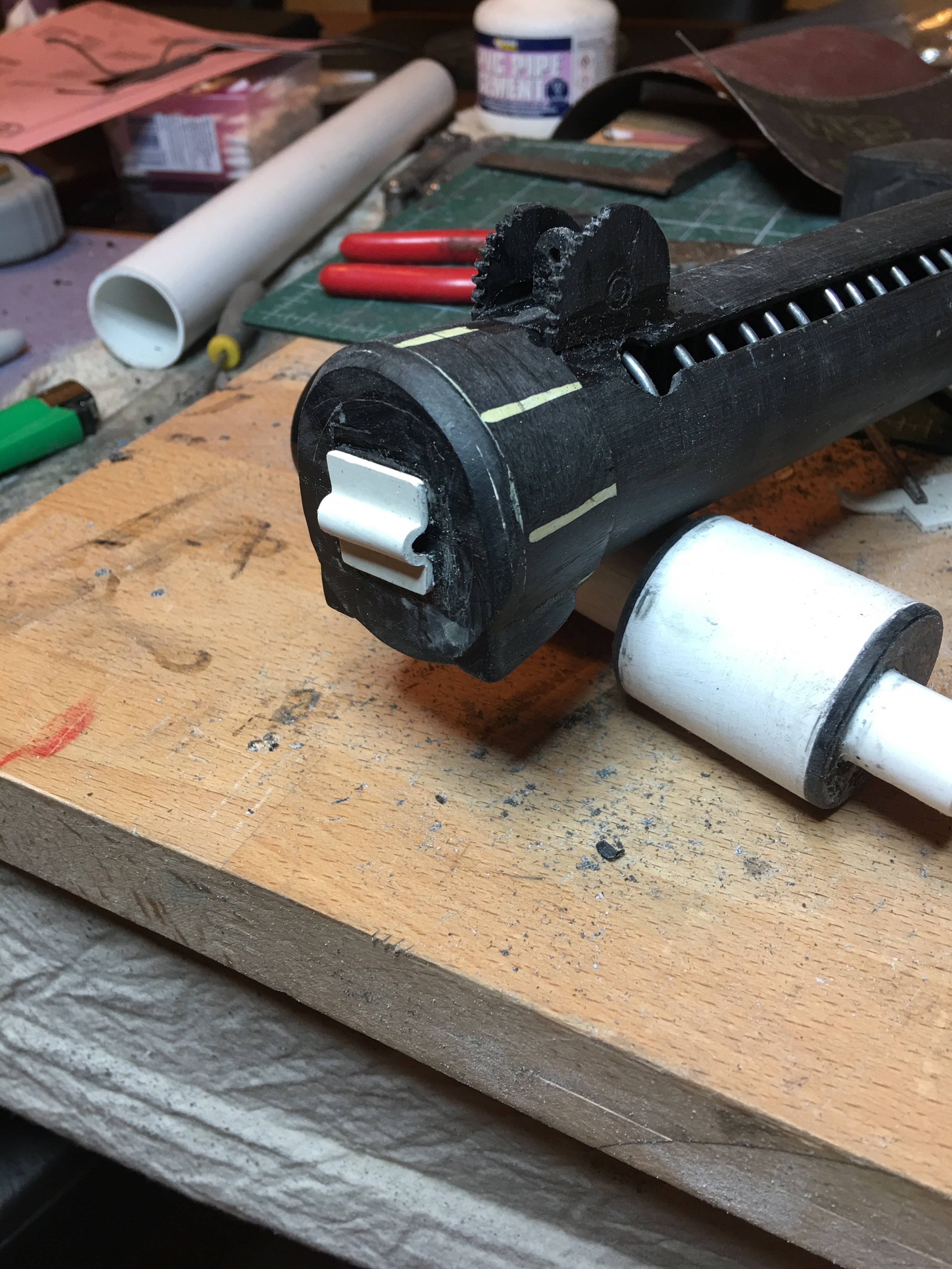

I worked on the end cap, I made it so it twists and fit with the lugs I glued in the back of the cap, I also cut and fit the rear sight
I cut and heated up some more plastic and shaped it for the end cap strap bracket
Thats where I’m at for the end of today, more to follow tomorrow

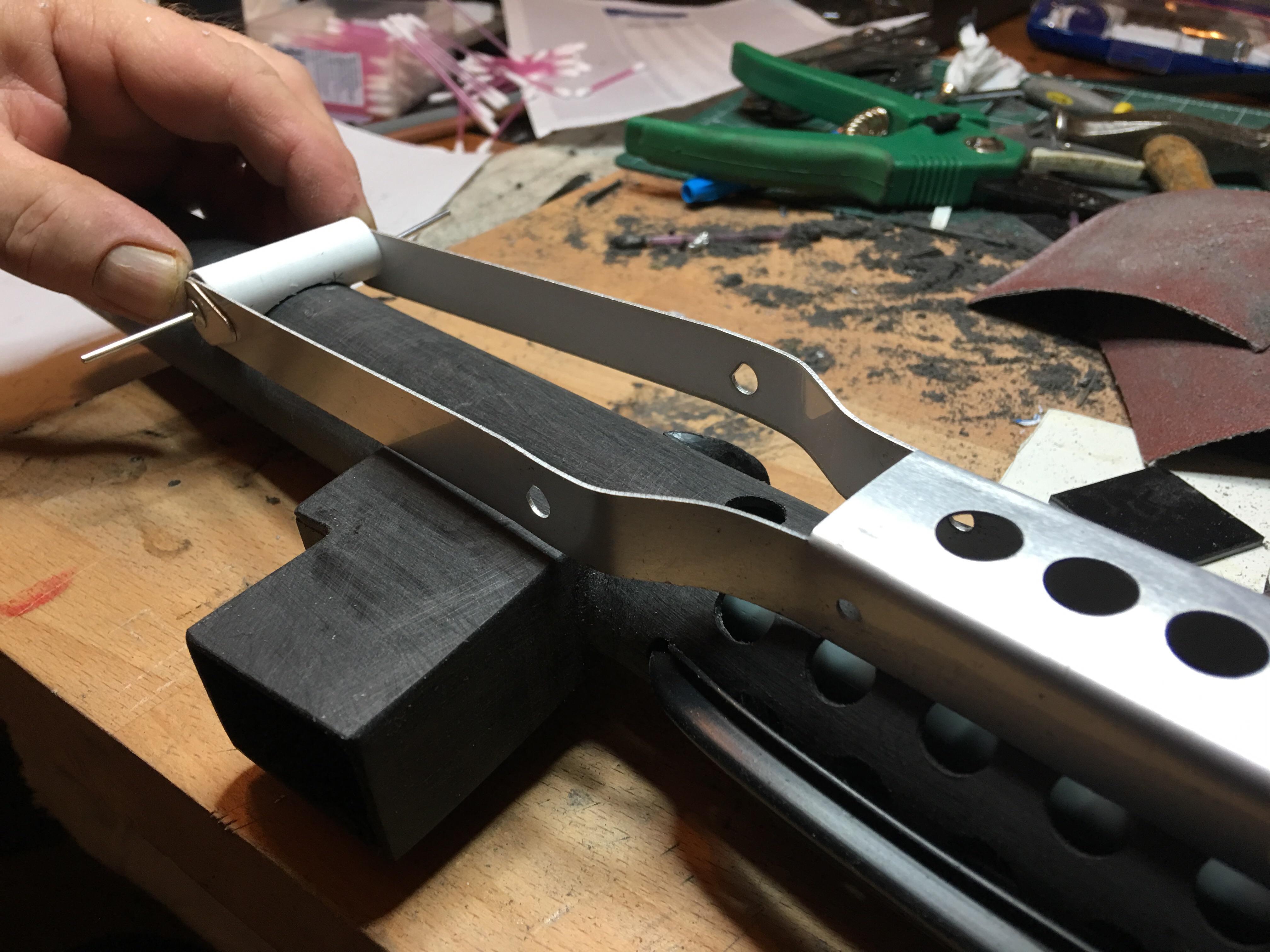

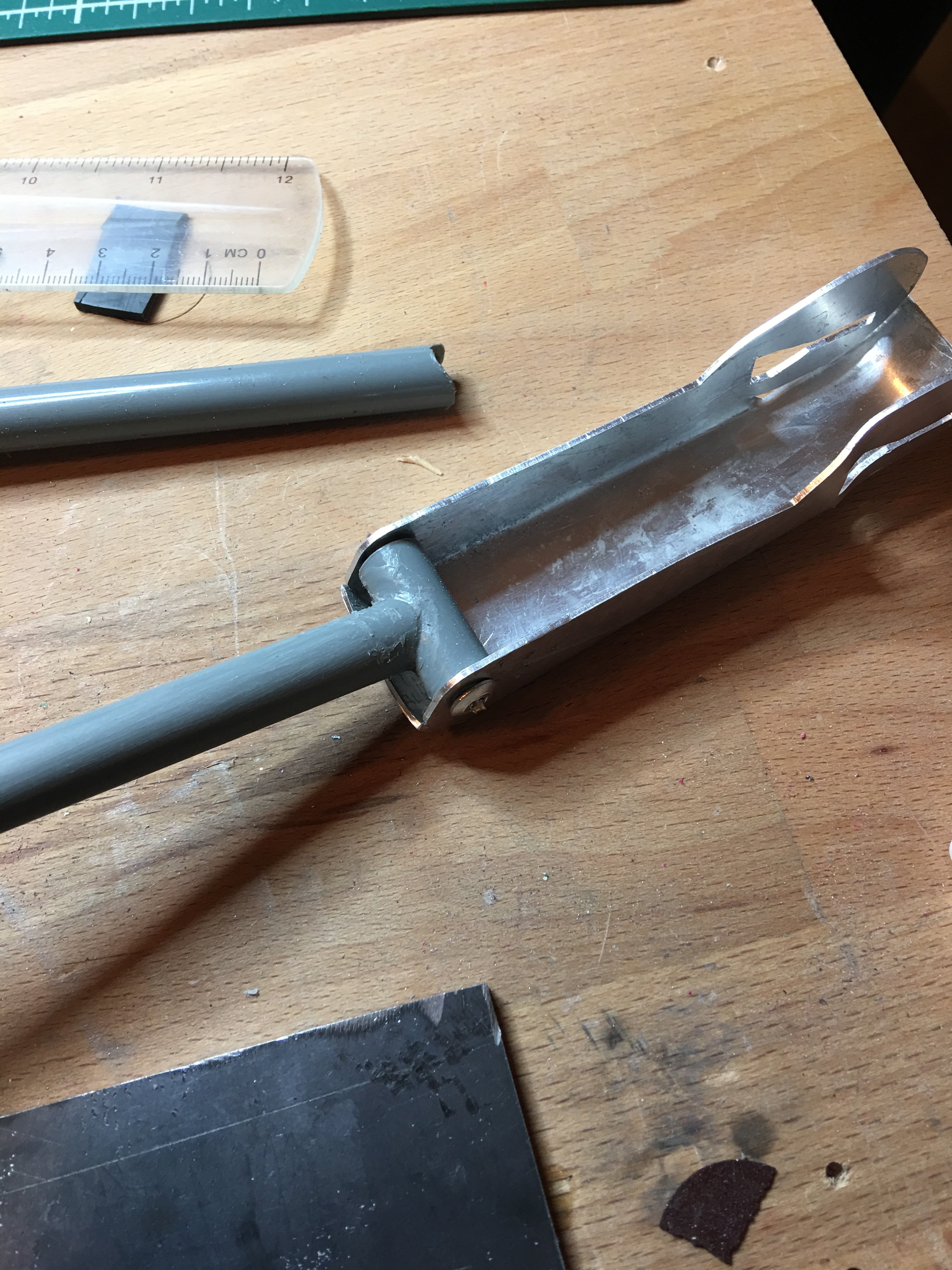

i folded the new 1.2mm stock and decided to try and make it a functional folding stock, with some 12mm plastic tube, glue and some rivets, it does work but it needs to be adjusted a little here and there, but it’s only for show
329D958B-6782-4628-8E4D-F88F991AA860.jpeg8C9F9A85-695C-42C3-8194-652179F520E0.jpegAAAA3A79-07C9-49AB-8BE6-B6A9634B570F.jpeg972F5F03-E934-4165-B25F-1F51C6188A81.jpegE73F5499-4331-42C7-B8A1-0A9CEDCEEC07.jpeg

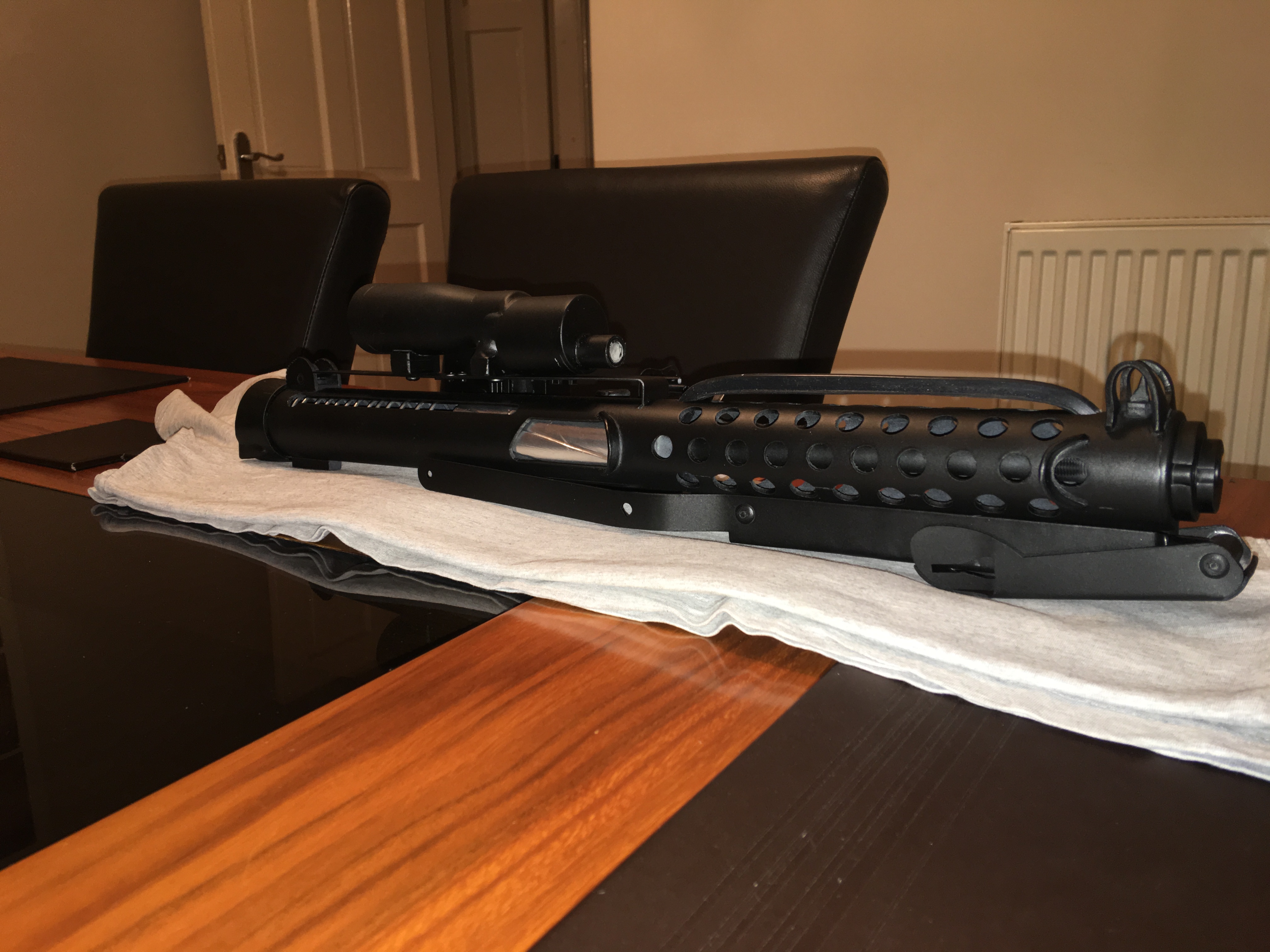

so what I did this evening
i primed and painted my scope ( could of done with a little more sanding) but the pressure is off for finishing so I can revisit that, I will also get some bronze buff and might try a little weathering, something I’ve never done before but I’m will to give anything a try, I was originally going to lay a bronze coat under the black for weathering later but in a rush I forgot to get bronze paint.
I had some silver foil tape, so I put some on the bolt, quicker than painting

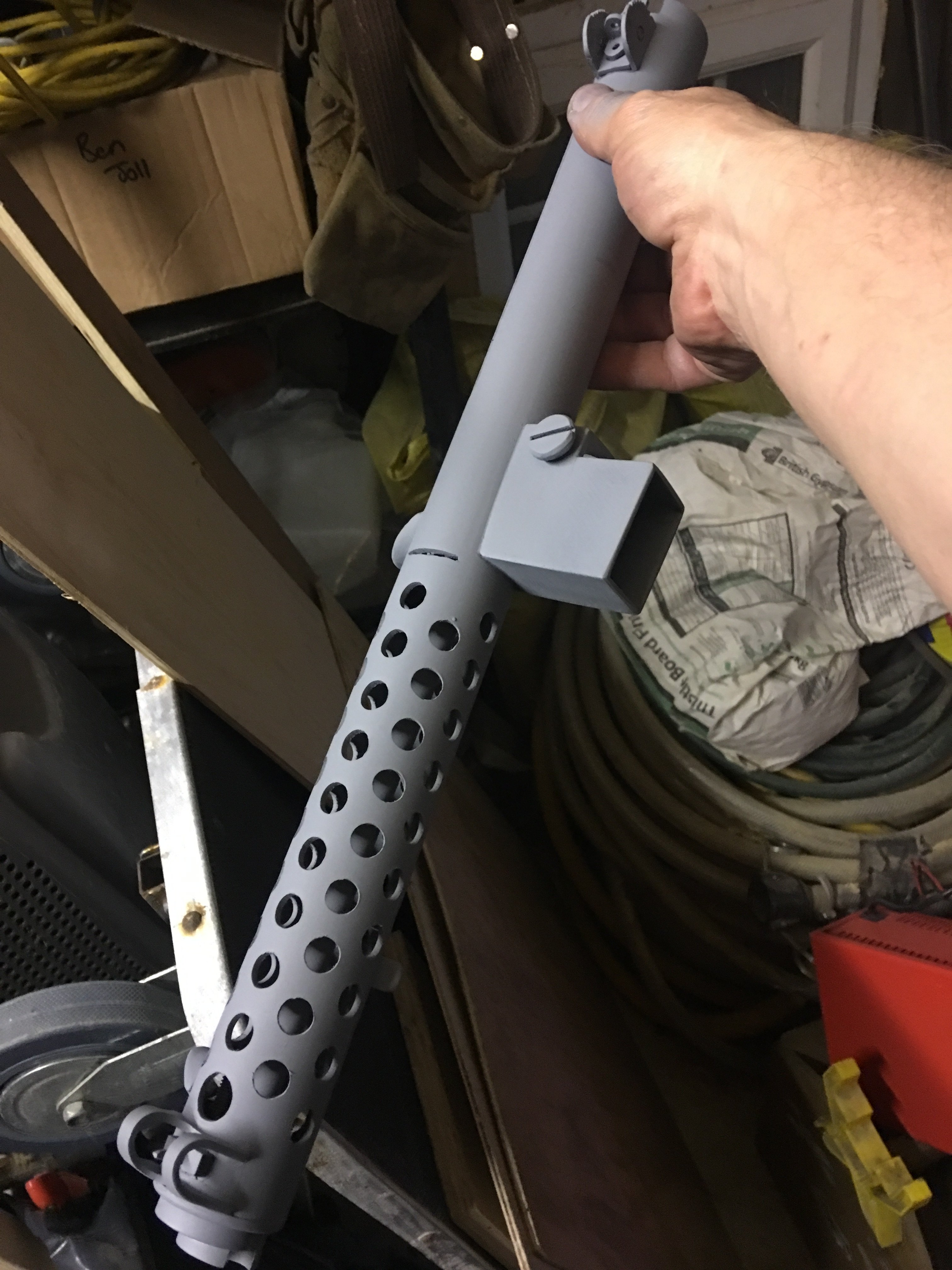

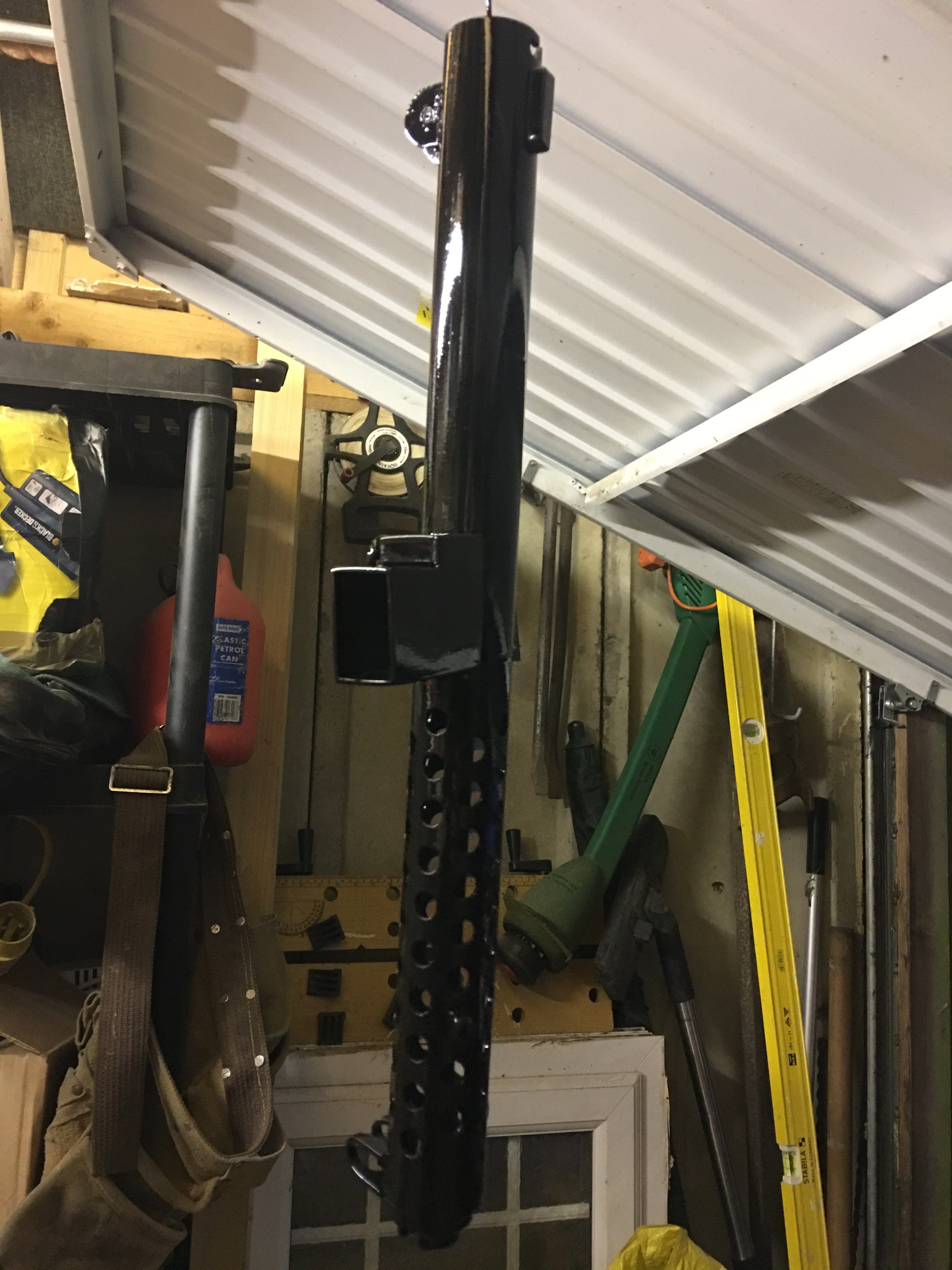

I primed and painted the barrel, end cap and heng box, I ran out of primer so I couldn’t do the scope rail, primer is now on my shopping list for tomorrow.
B2296DDF-B157-452D-B6F6-61C387E8EDCD.jpeg957D6DEF-3EC7-40B4-BBCA-139F555DB7E9.jpeg178639F6-F783-4885-80BE-6A320DEC4E36.jpeg
So so this is where I’m at this evening

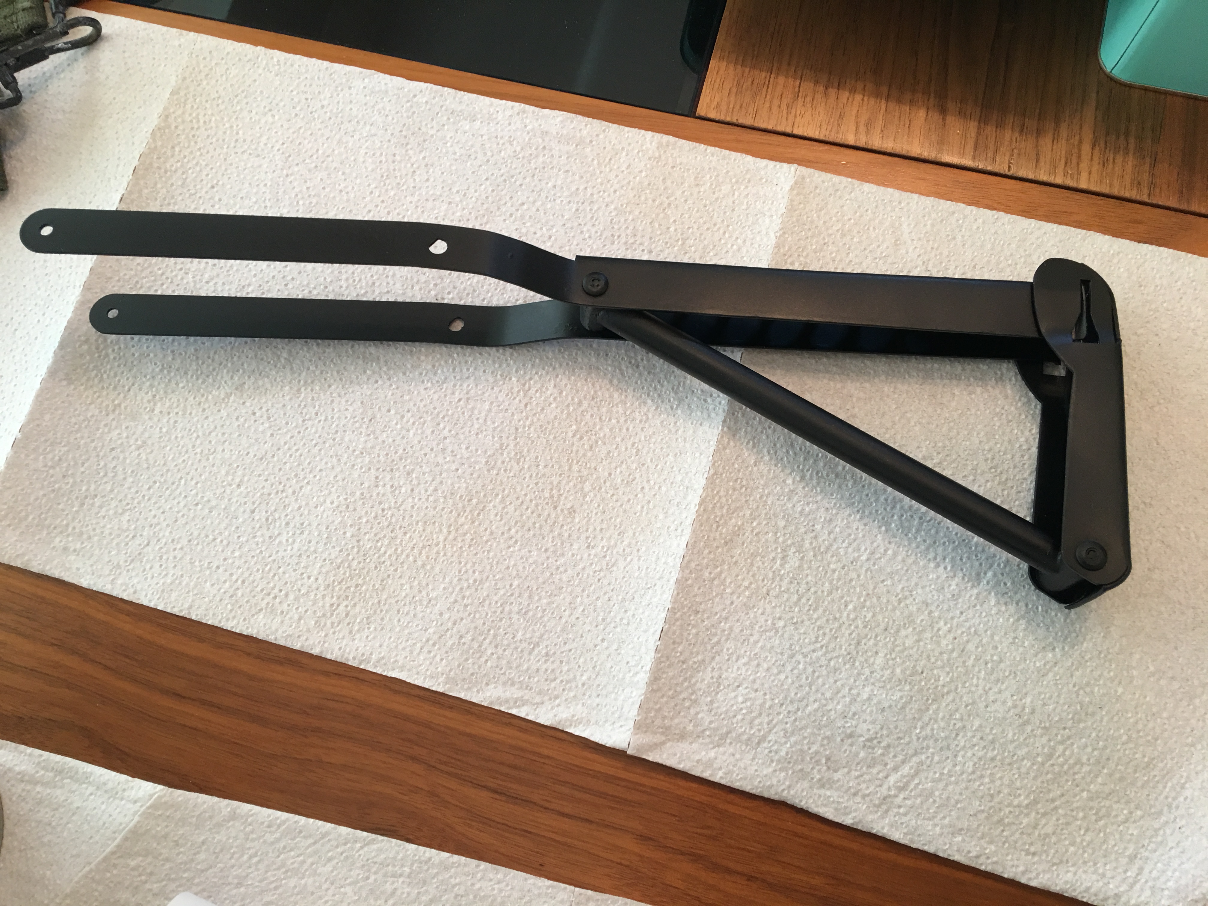

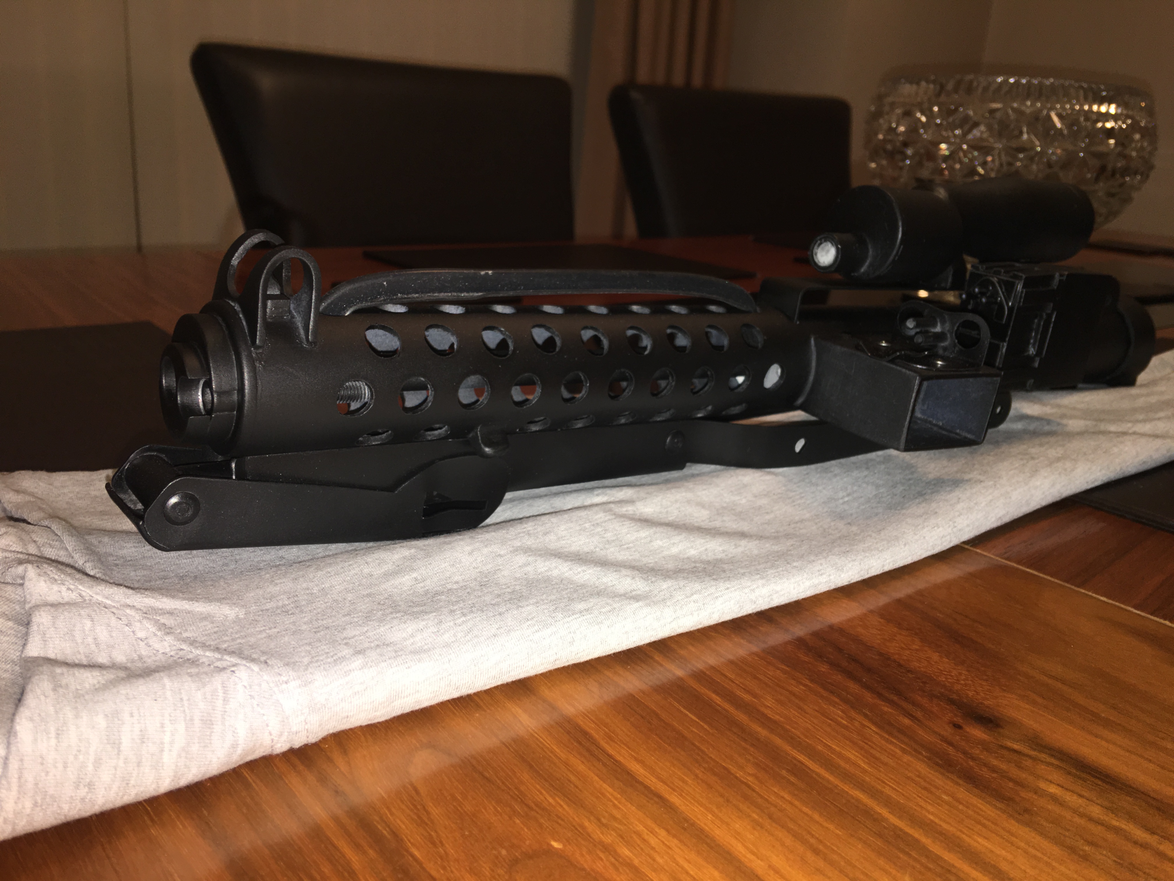

i stiffened up the pivot points and made the stock more ridged to open then I primed and painted it
Looking nice with the barrel

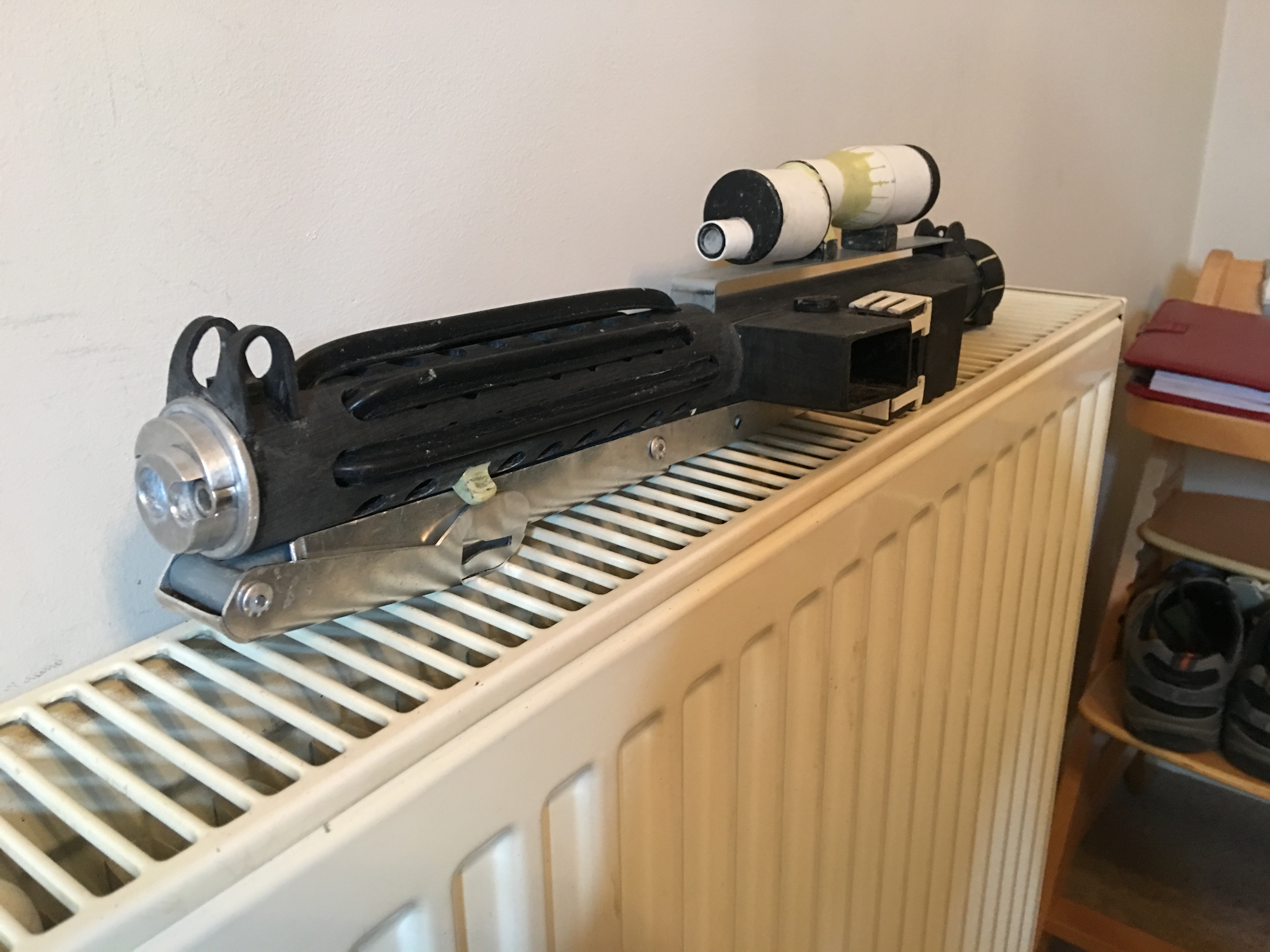

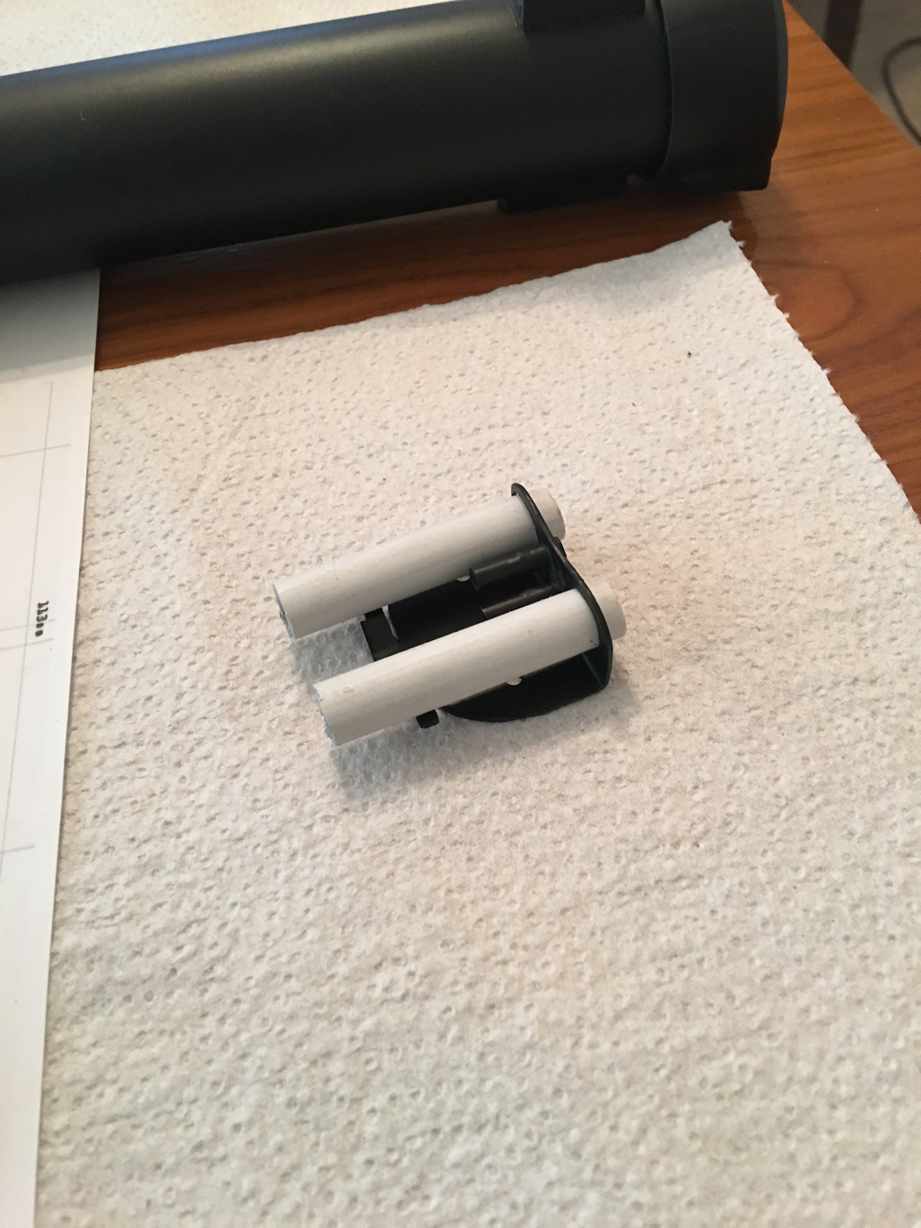

I then started to make the power cylinders and holder, the cylinders are not finished I’ve something to pickup for the ends
3914663E-F49D-46A0-9855-A81DA85BEA60.jpeg1D742B17-0F3A-42EE-9052-16CA6DECB506.jpegB945B226-B5E1-4BE5-AEF7-E427A405F1F3.jpegB9D2F640-99D2-496B-A39E-13DBE8FF7127.jpeg
I also finished the scope rail and bracket for the Heng counter and put them together,

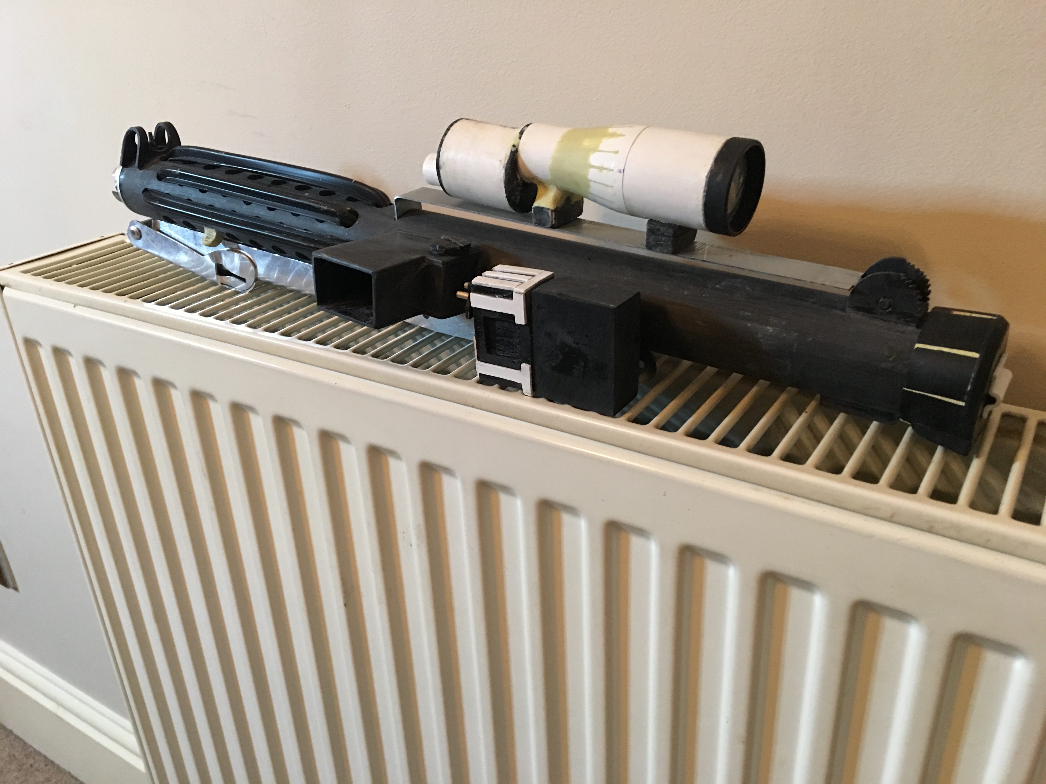

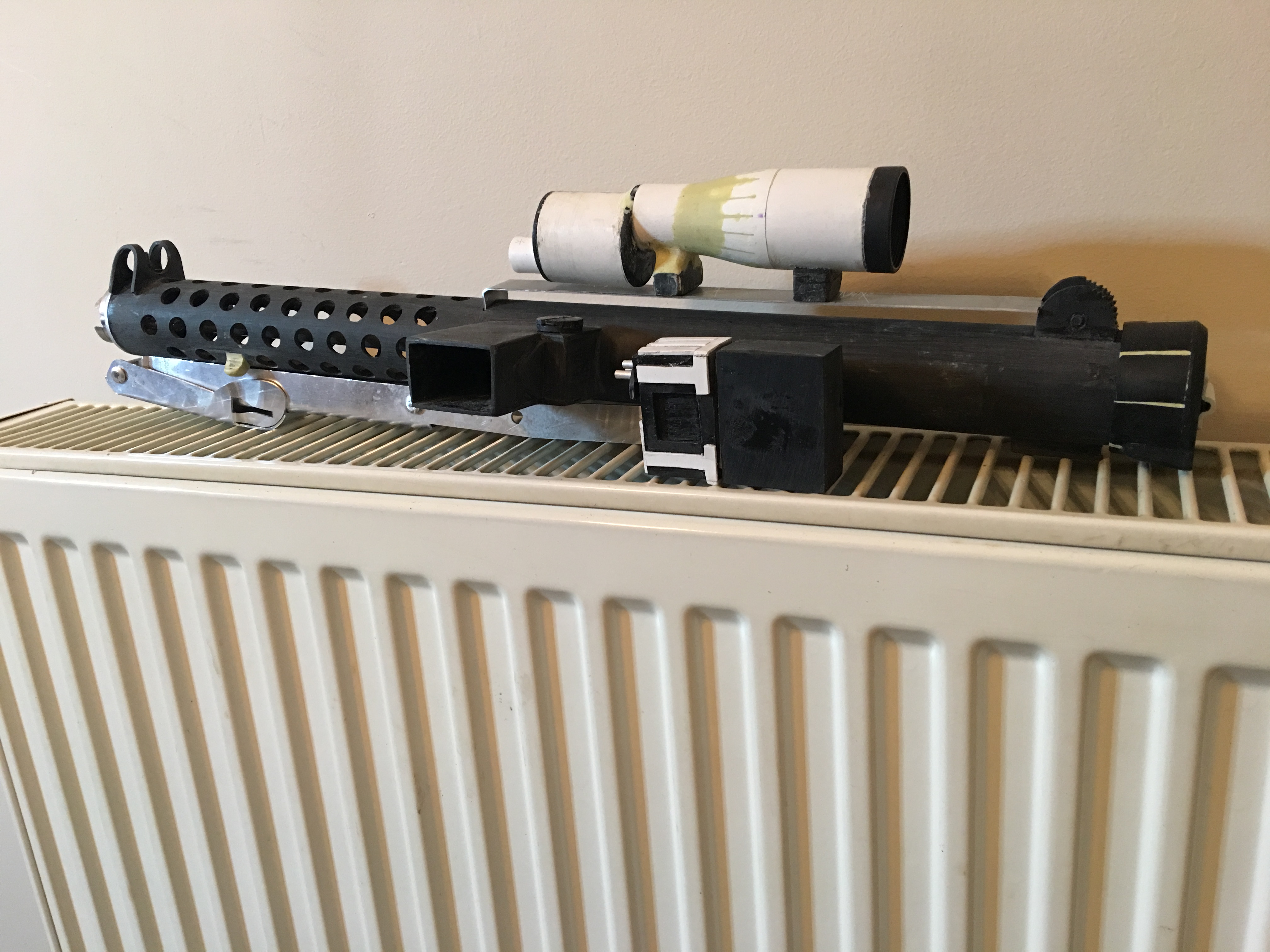

ive temporarily fitted things together just to give me a look at what I’ve achieved !!
I’m sooooo happy with it, a couple of more things to build and add
This is where I’m am at the end of week 2 and a couple of days
EA5C6C77-2E49-47D7-A422-6FA8513D1FA0.jpegE2C3C7A4-A964-4FAB-84D3-BE0FFAC52152.jpeg5633FF8D-E92C-4CC5-ADCB-6B20C0EB3416.jpeg5AC5EA68-4B55-4BF3-ADAD-6FCAE55B5F54.jpeg
