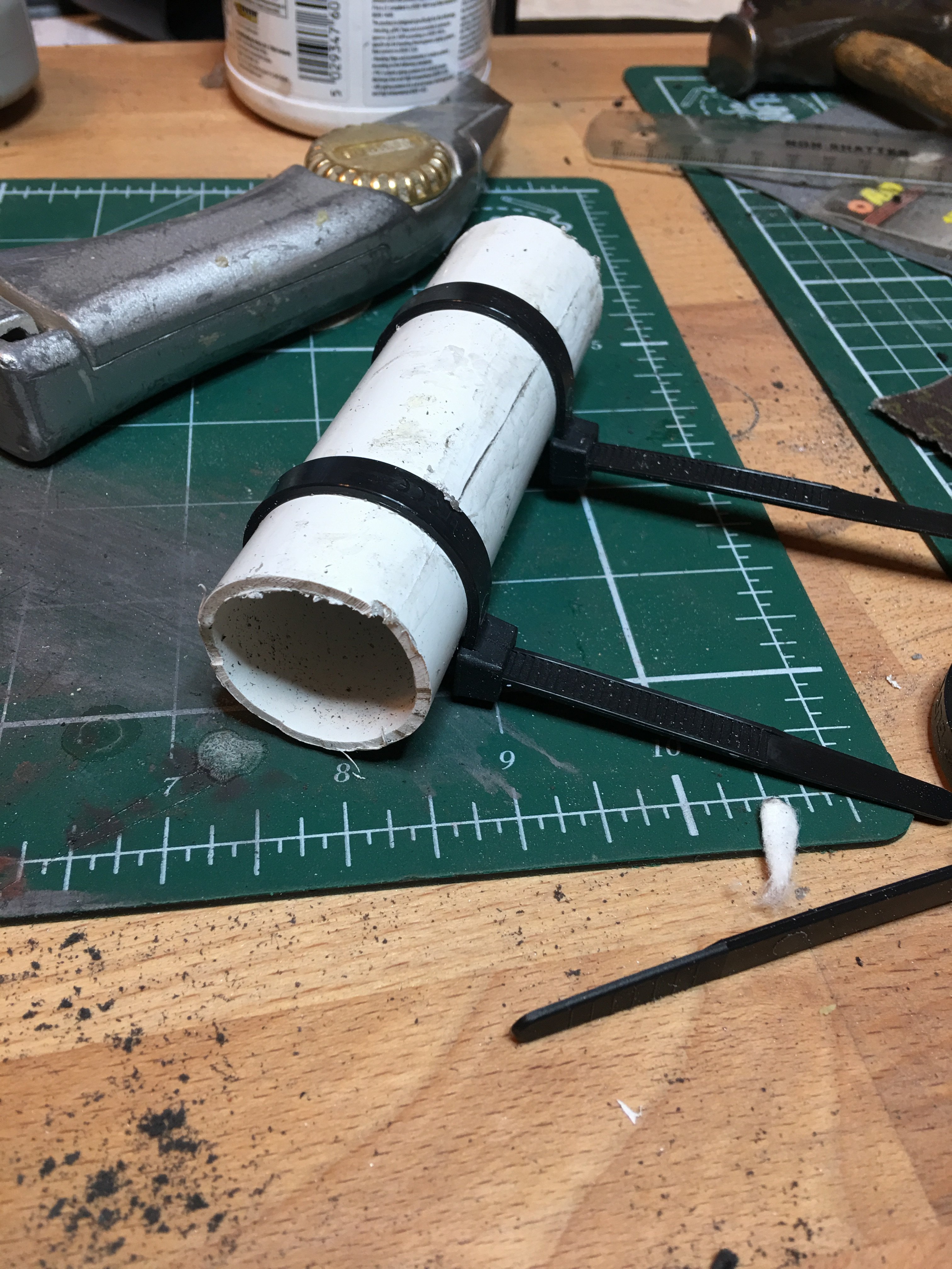

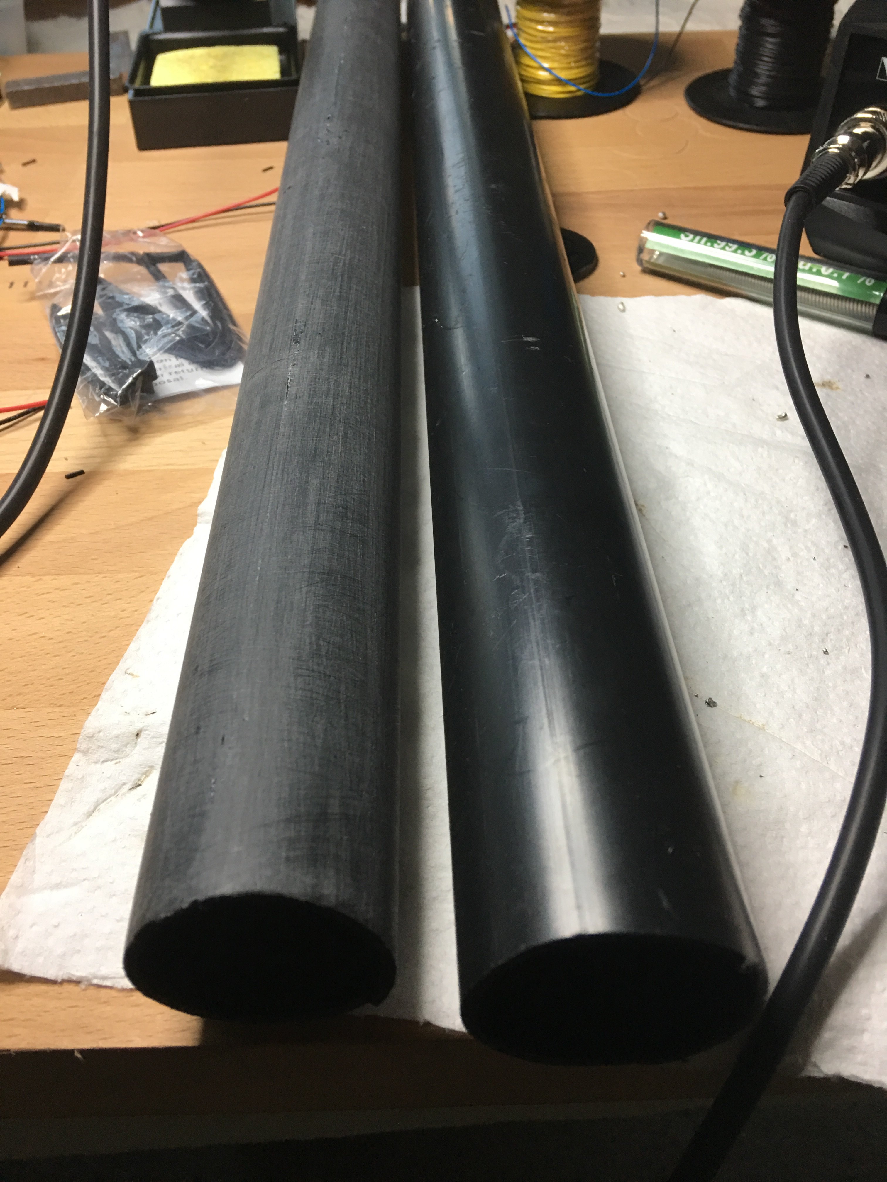

With being a plumber I had some 1.1/2 inch waste pipe to hand (ABS solvent weld pipe) the type you glue all the joints together
I did a test cut and glued it back together as the OD was 42 mm and I wanted it as close to 38mm as possible

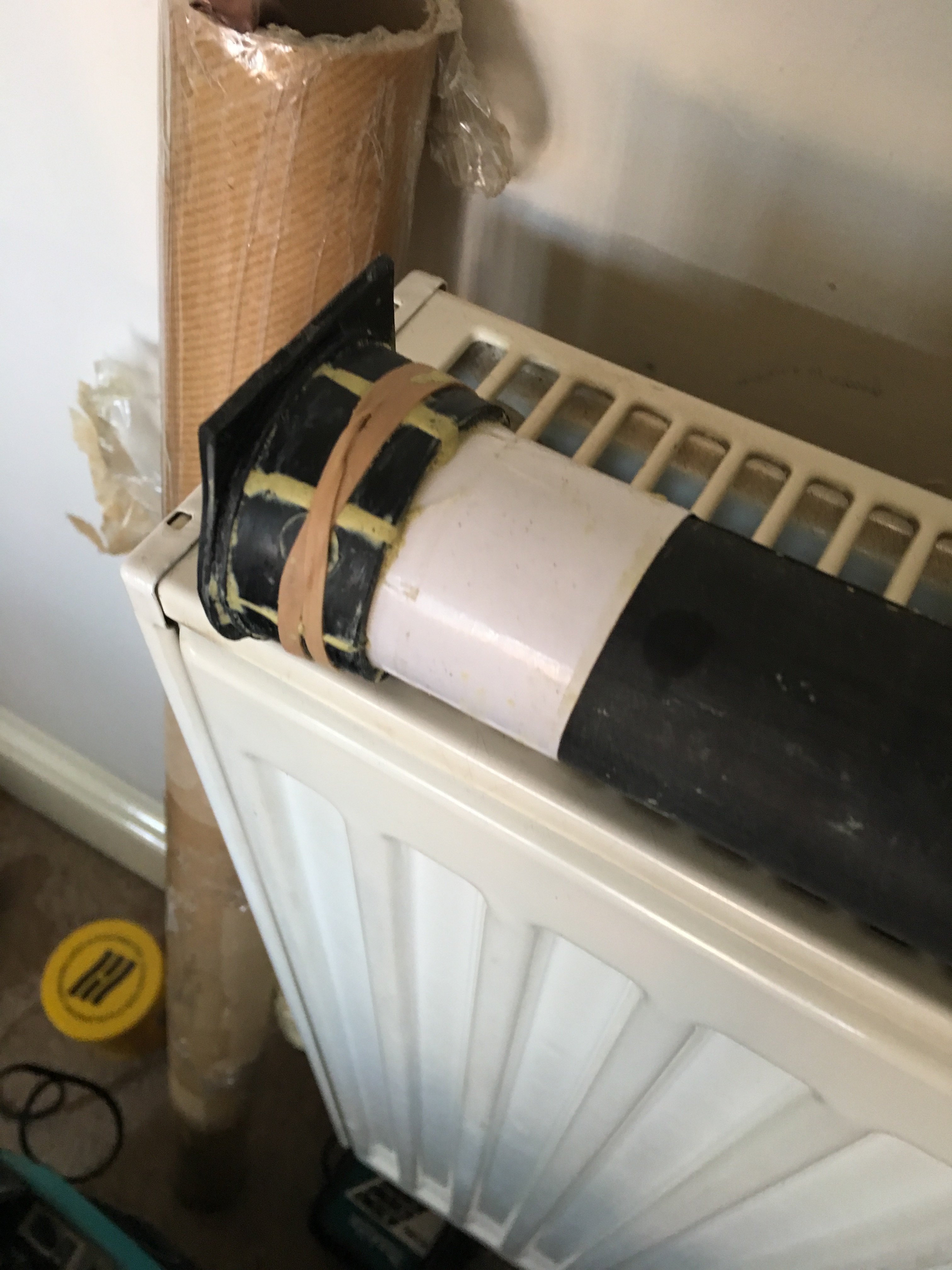

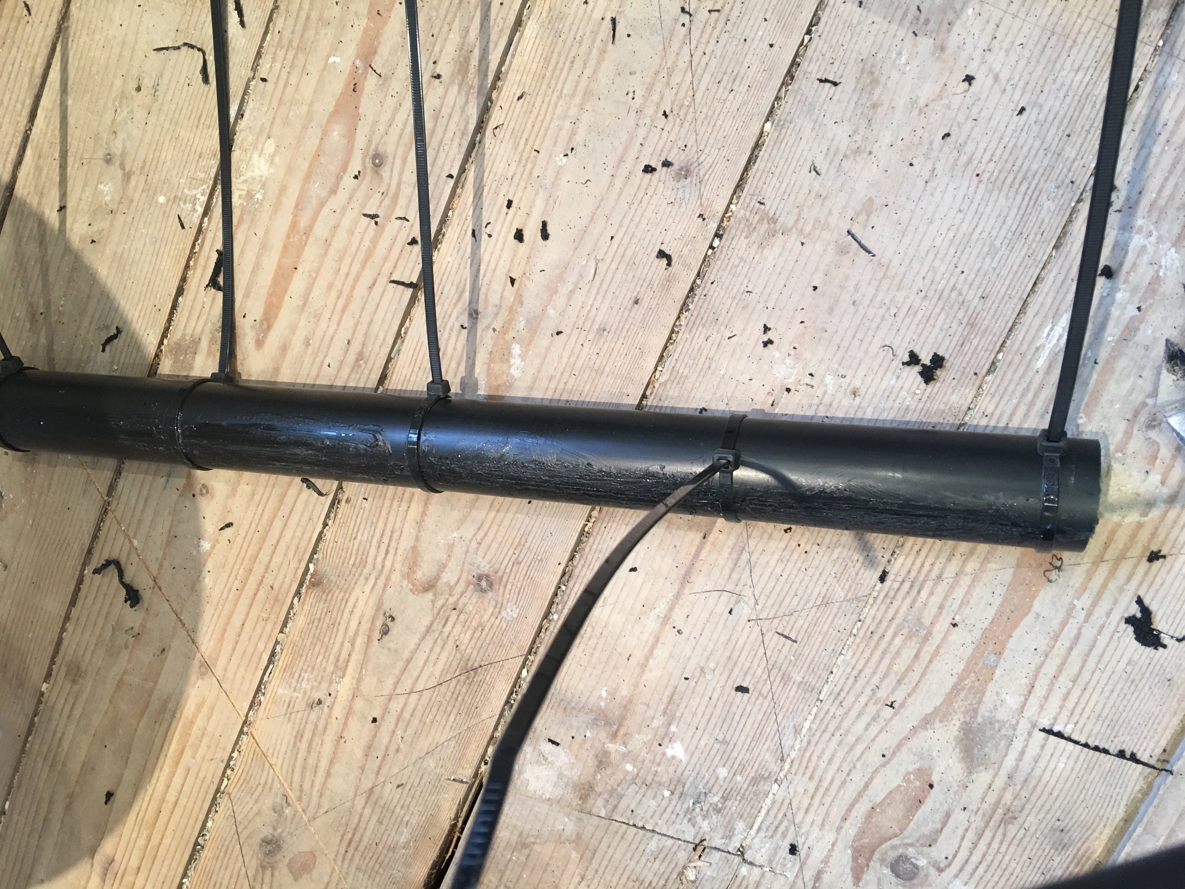

Knowing I could achieve the size I wanted I cut a 600mm length down one edge, I then glued the edge up and cable tied it back together
The glue goes off In minutes and totally hard for sanding in about 4 hours
once the glue had hardened I gave it a good sanding down, as you can see, hardly a seam noticeable
left pipe recut, right pipe as it was

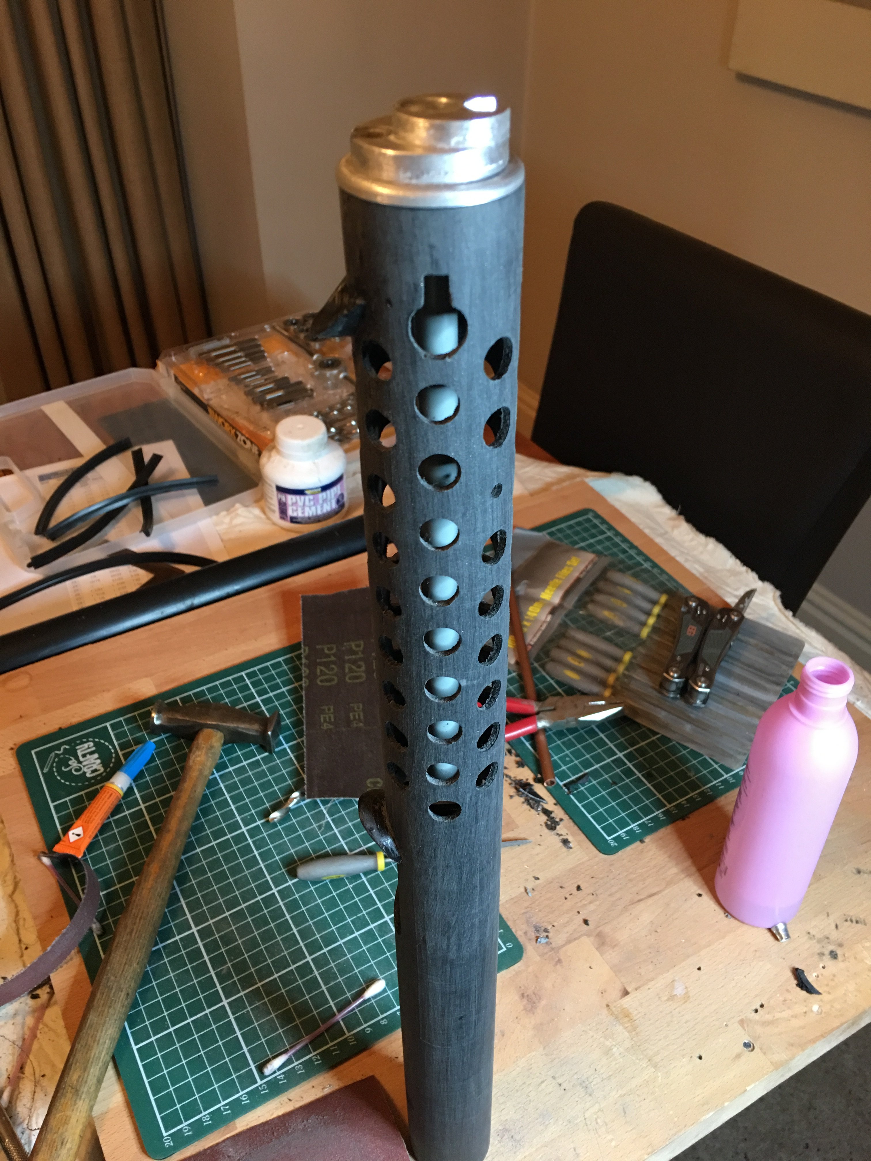

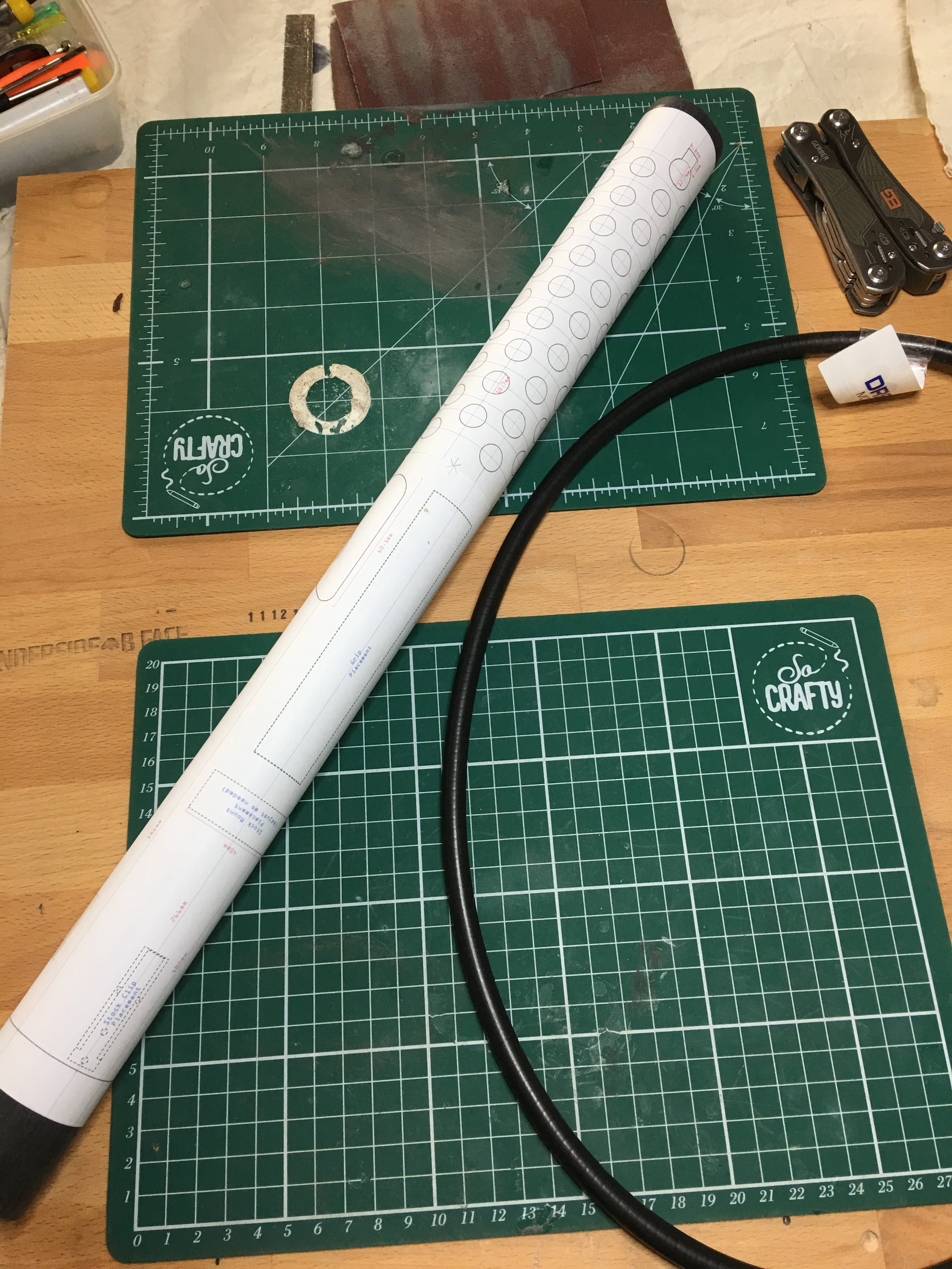

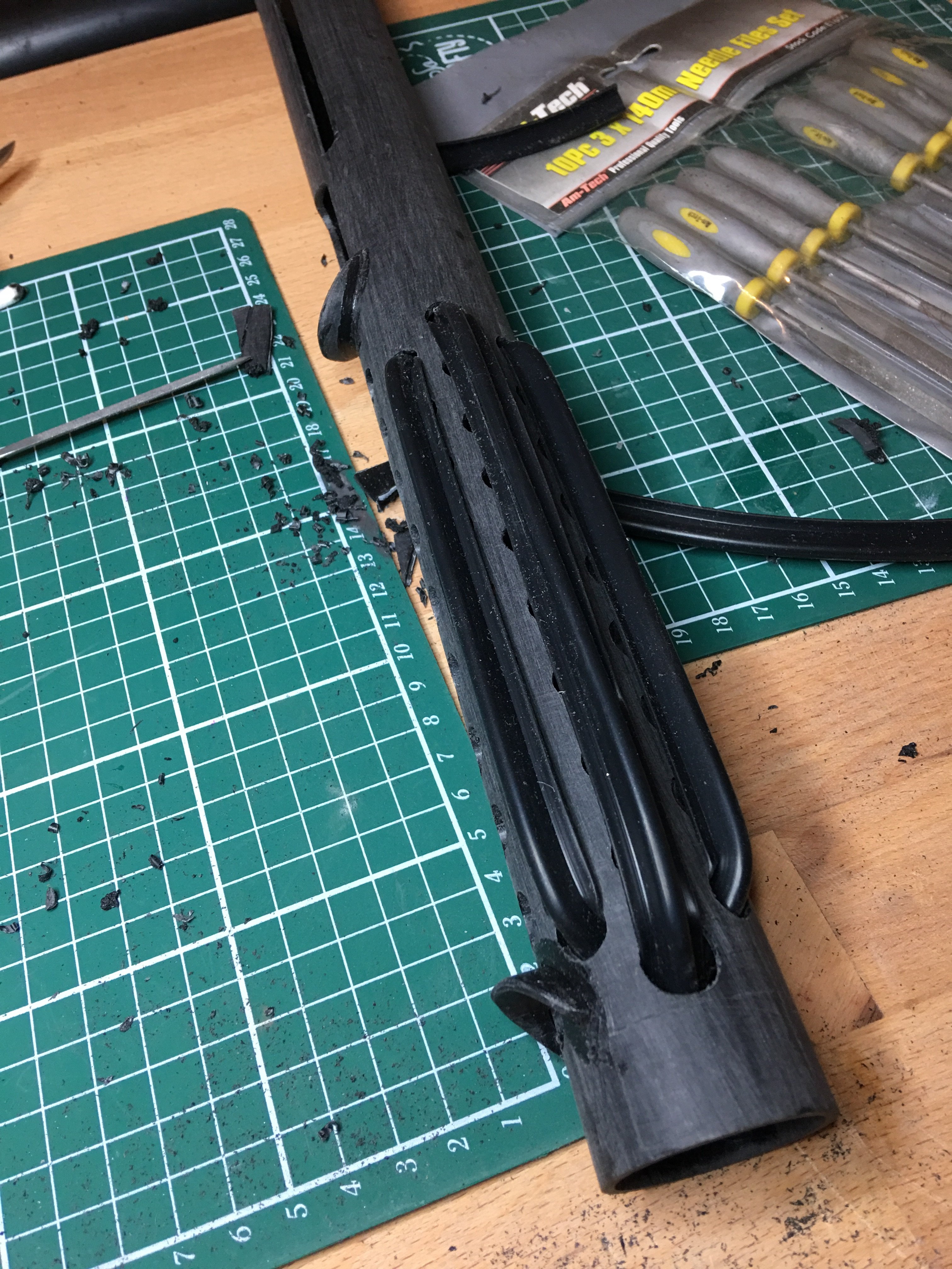

Template down loaded and placed oround the pipe

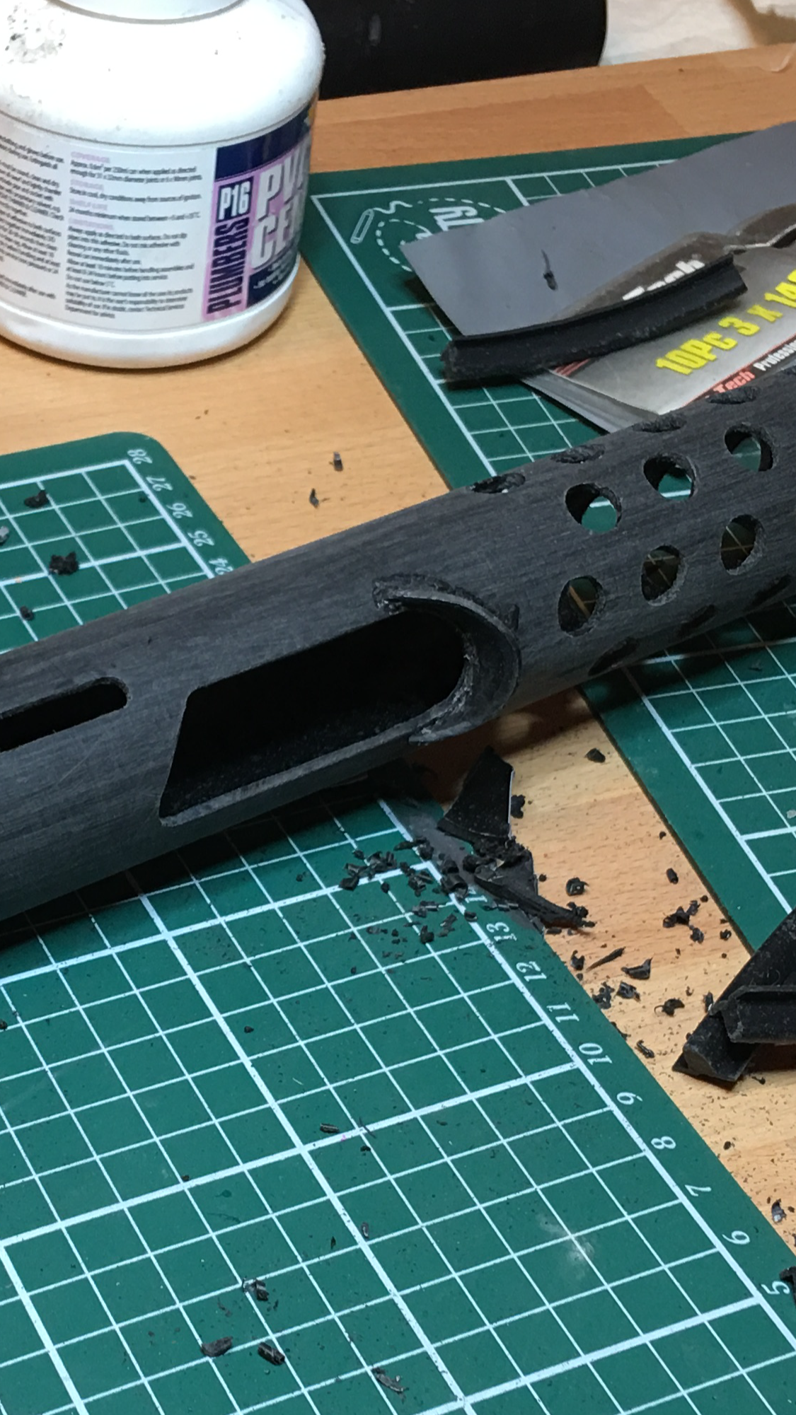

I drilled all the holes and cut out all that needed to be cut out, I also cut, shaped and added the flash guard to the front and guard to the cartridge ejection point, the excess glue will be sanded away later

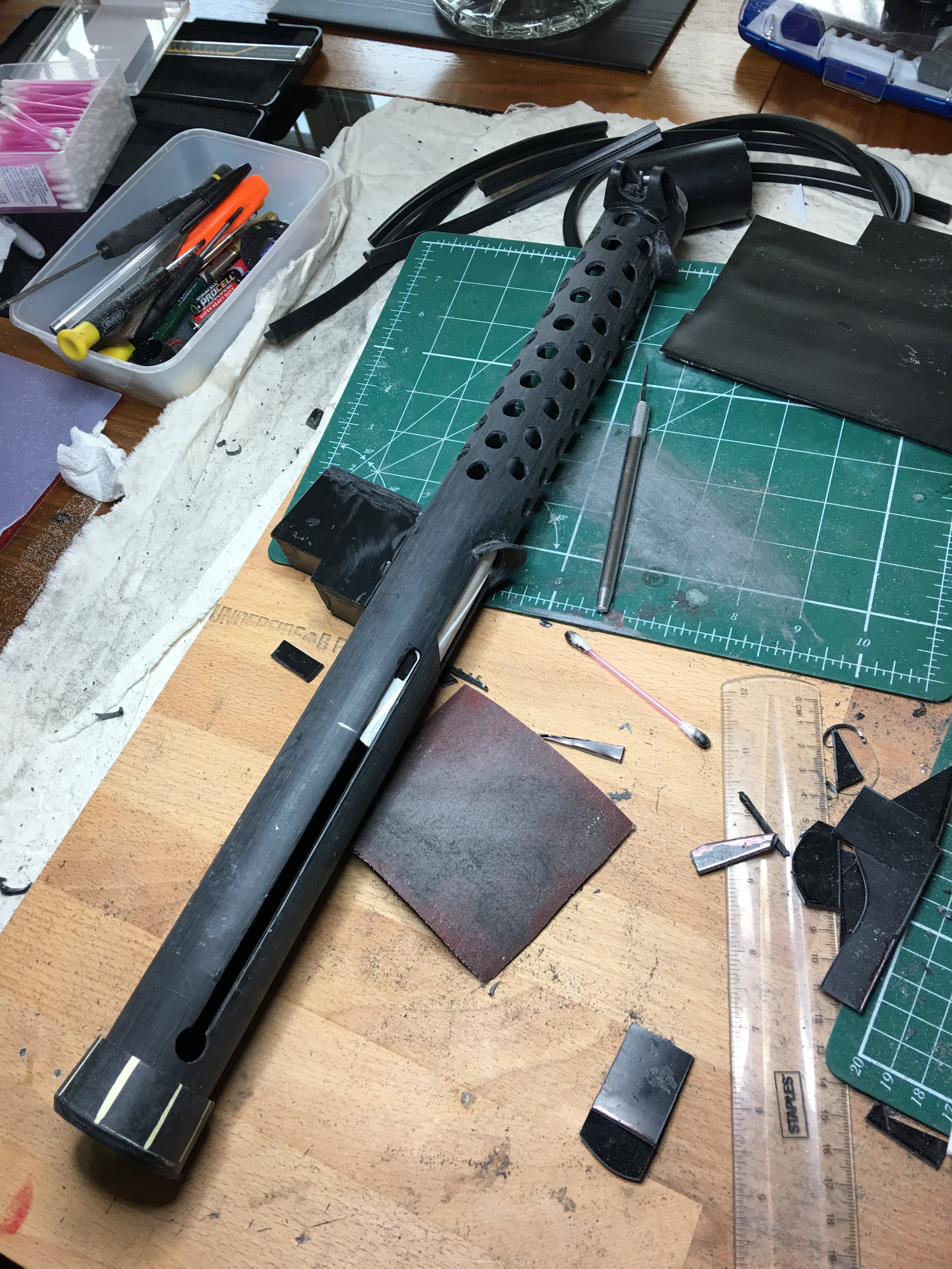

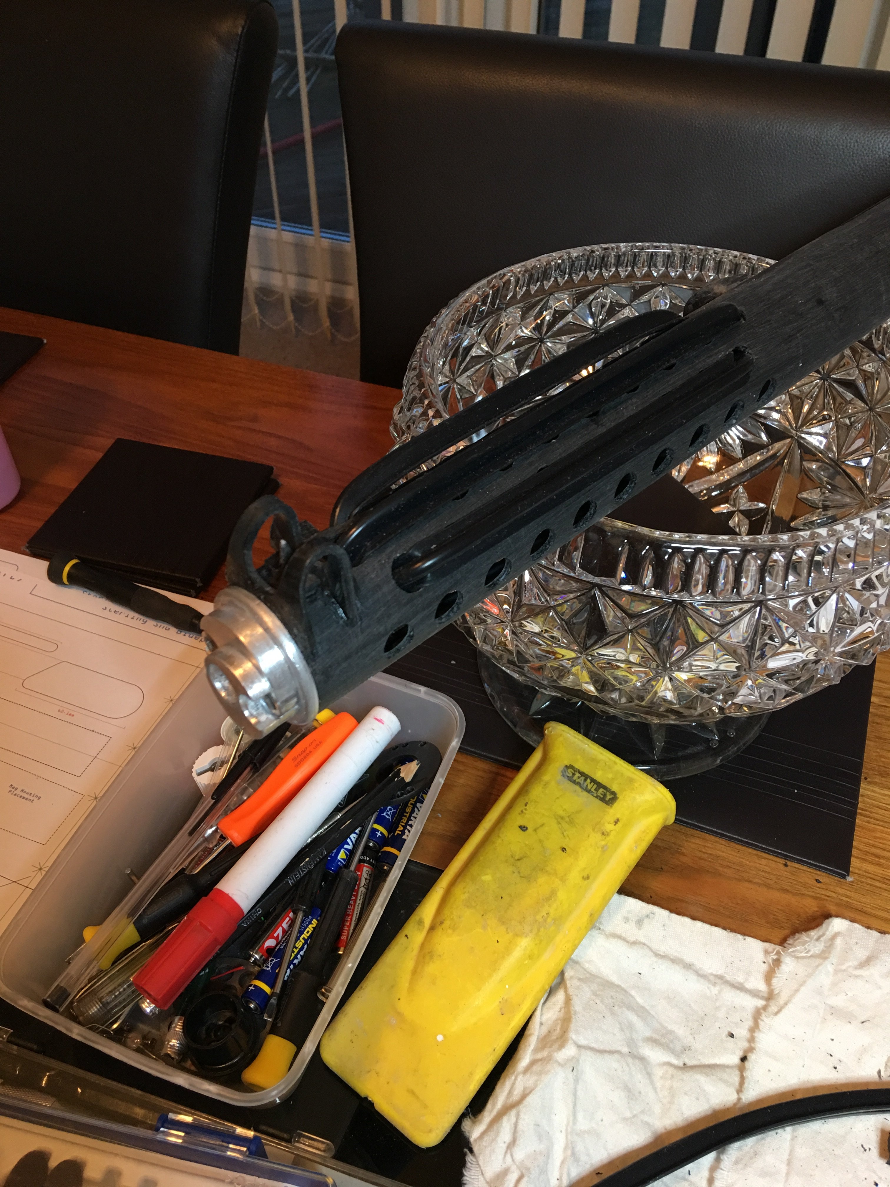

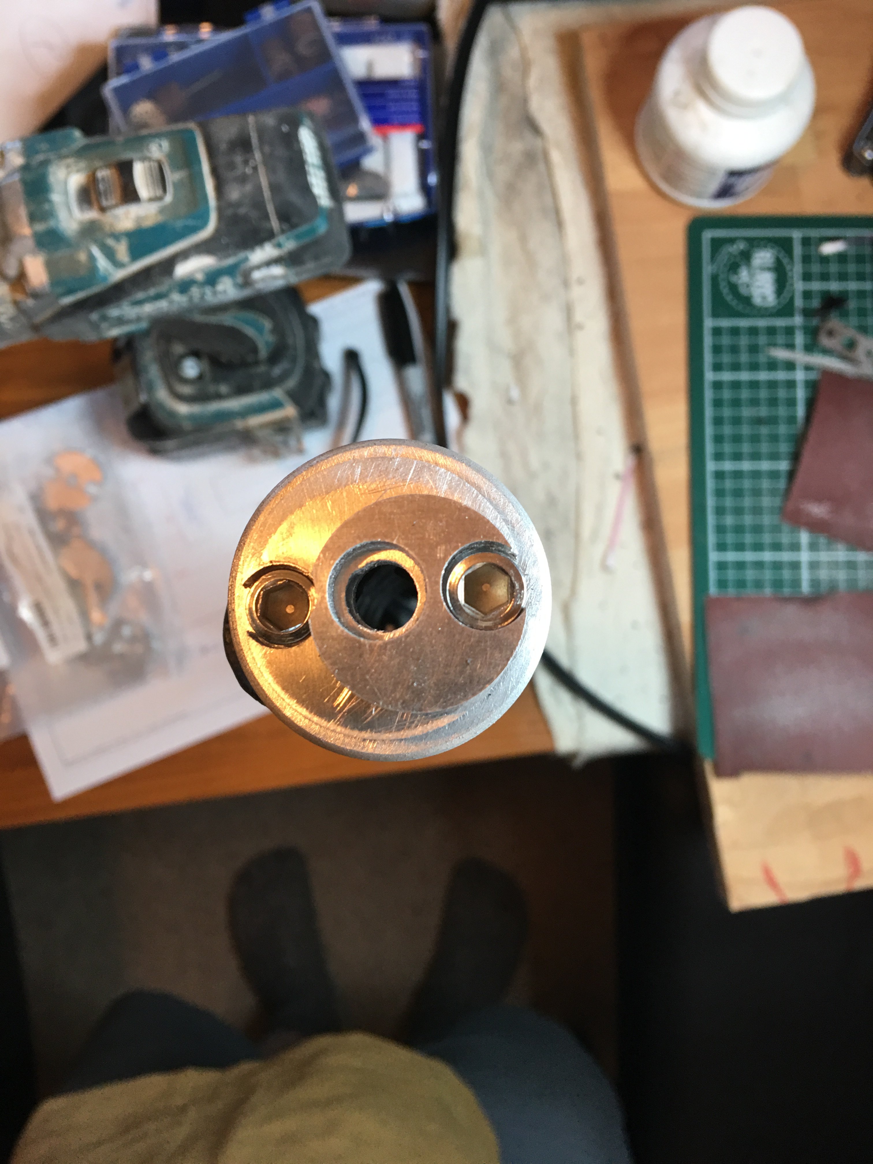

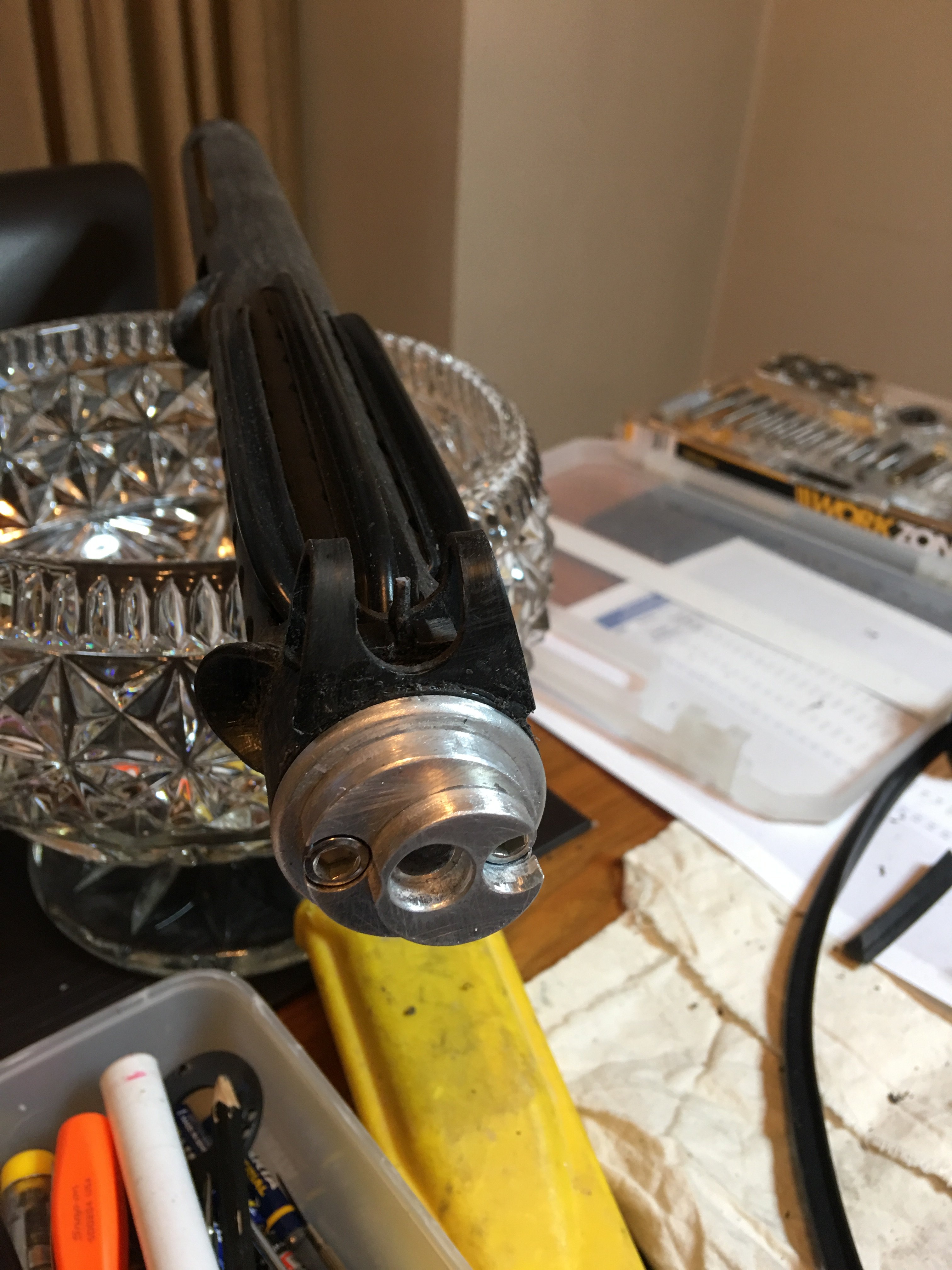

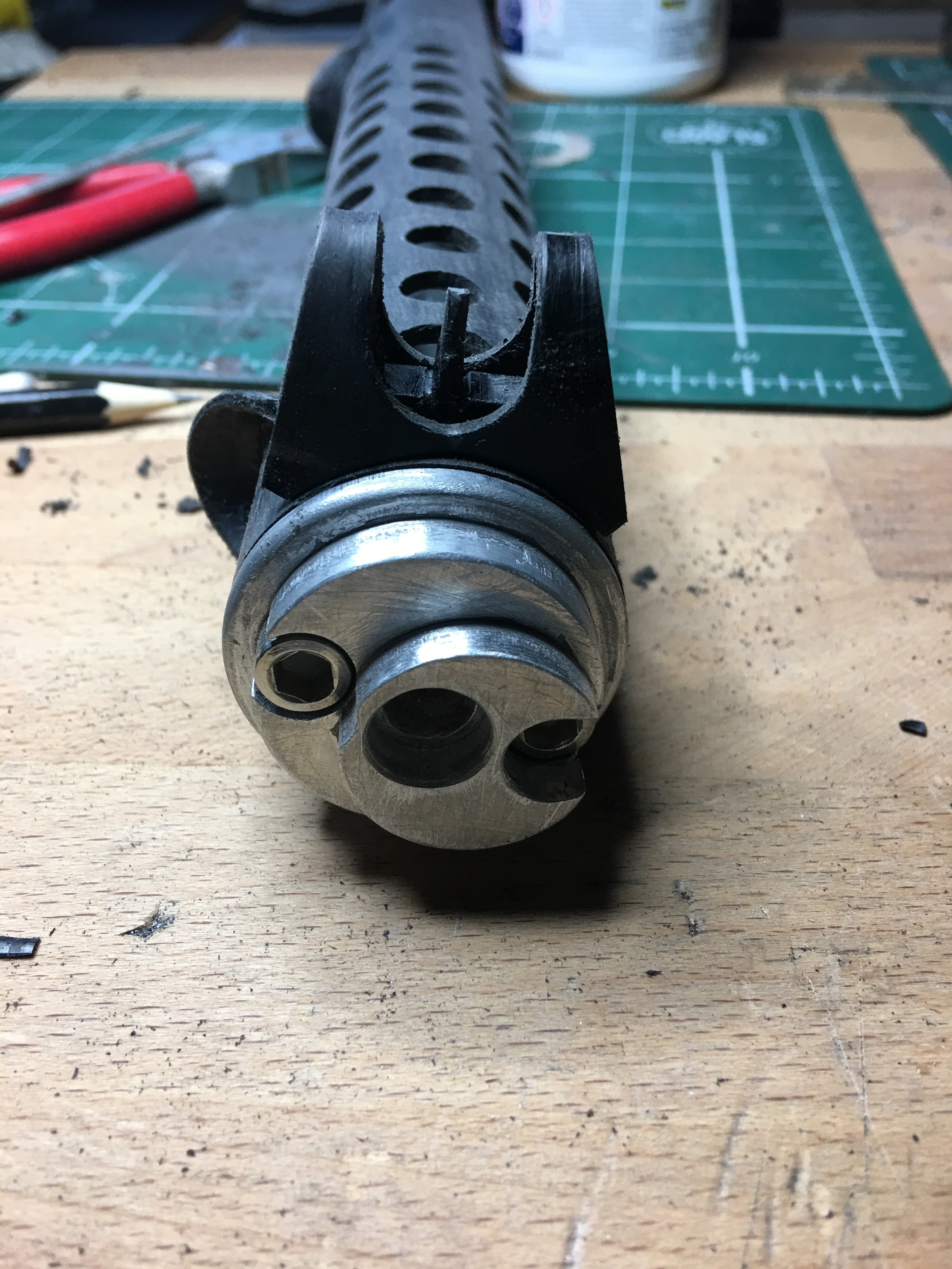

The muzzle pieces are done including a back piece for the barrel and hex bolts to screw up to, I will pick these up tonigh and try and put them together, I’m also going to try the front sight tonight
I forgot to mention on my party night depending if people are interested in what I’ve built this will be going forward as a prize for most original costume design ( the wife might win if this turns out to good to give away ) ;)
I’ve now got the muzzle pieces and I’ve slightly cleaned them up, they do need more refinement but they have the look I wanted, they are just loosely fitted
2F2B33C5-0EF6-442D-B680-B2A56D7B4F57.jpeg57B77092-297B-4B46-A45E-909BD94BCB4A.jpegFEA25AF6-5498-48B3-829E-34FA19FEEB64.jpeg
The back plate for the barrel and the muzzle has now been tapped out for the hex bolts and they fit perfectly
More cleaning up for the muzzle pieces and on with the front sight
tomorrow I will find something for the barrel, 9mm ally tube I think

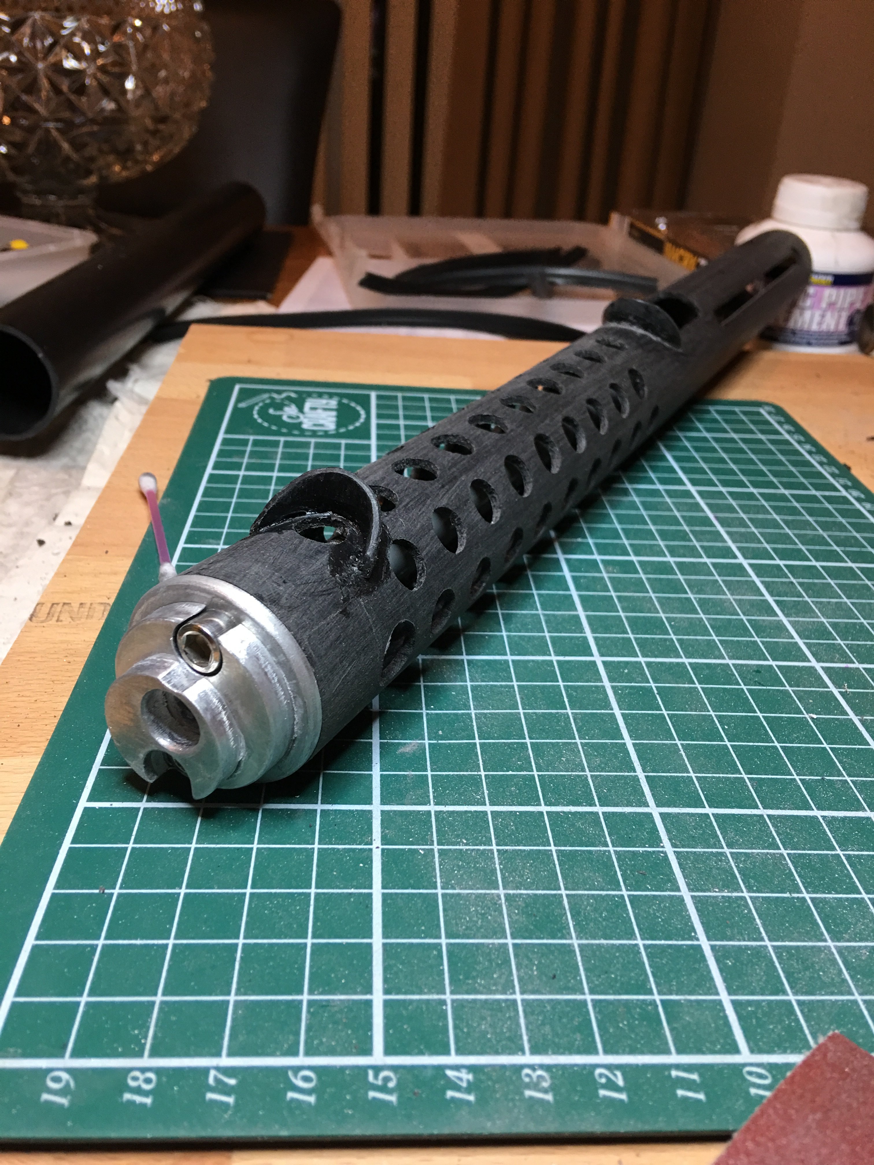

Barrel sorted
11mm plastic pipe, 8mm copper tube, another back plate from the muzzle pieces for a spacer near the bolt end, knocking and banging a bit of glue and hey presto
AEDEA802-245C-465D-8B5E-403CCCA5A60A.jpegEC4AD9EF-DC8A-41D3-B4AA-60E050EFA266.jpegimage.jpg
Before the barrel can be fitted permanently I need to spray it up
now back on with the front sight
cleaned up and temp in place
962A99B4-9539-4A44-AAEB-DA0B14D49A44.jpegB2AFAD37-8C7E-42C4-896C-0CA75E69DD1F.jpeg41B9525E-6992-4E64-B1E9-BFA4250AFC9D.jpeg

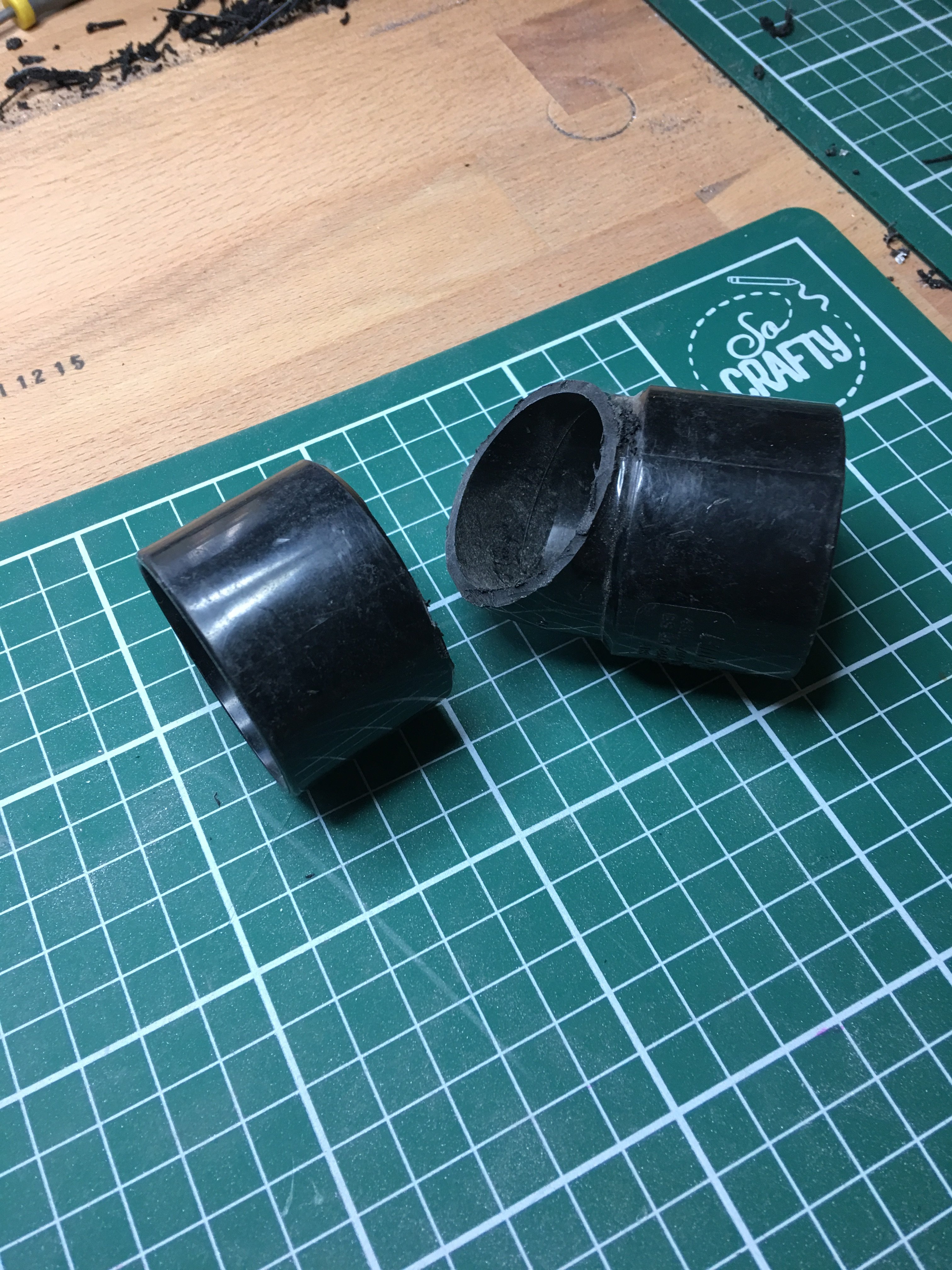

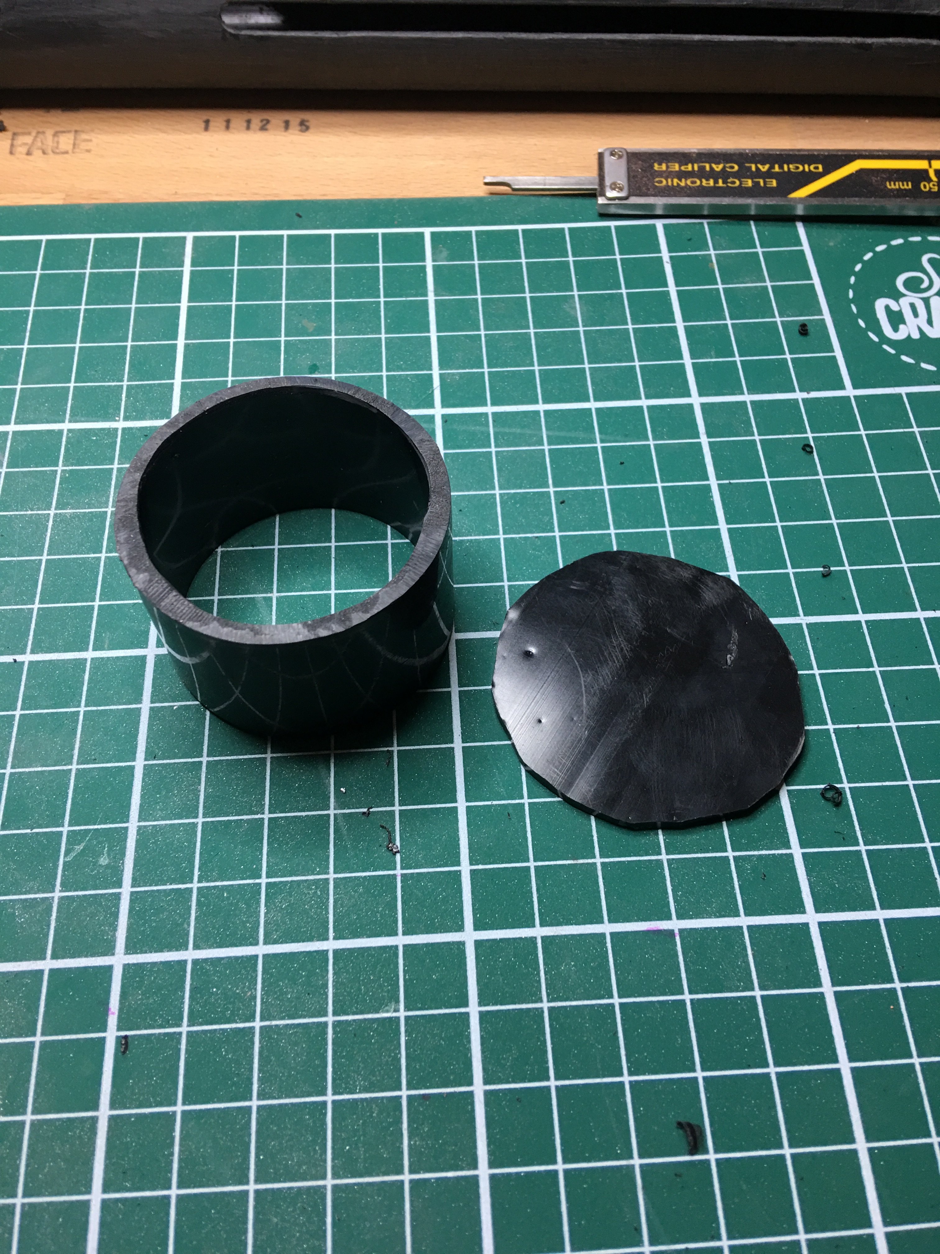

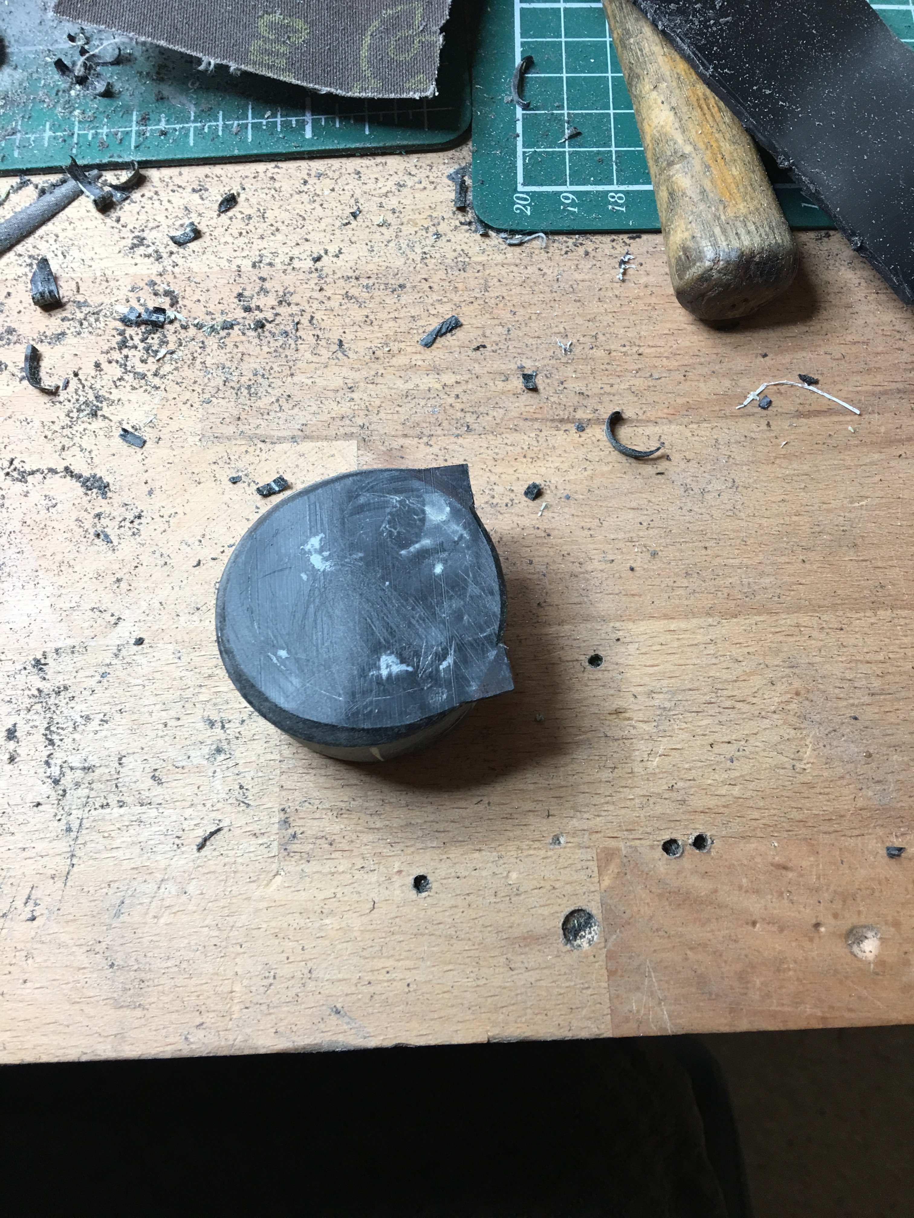

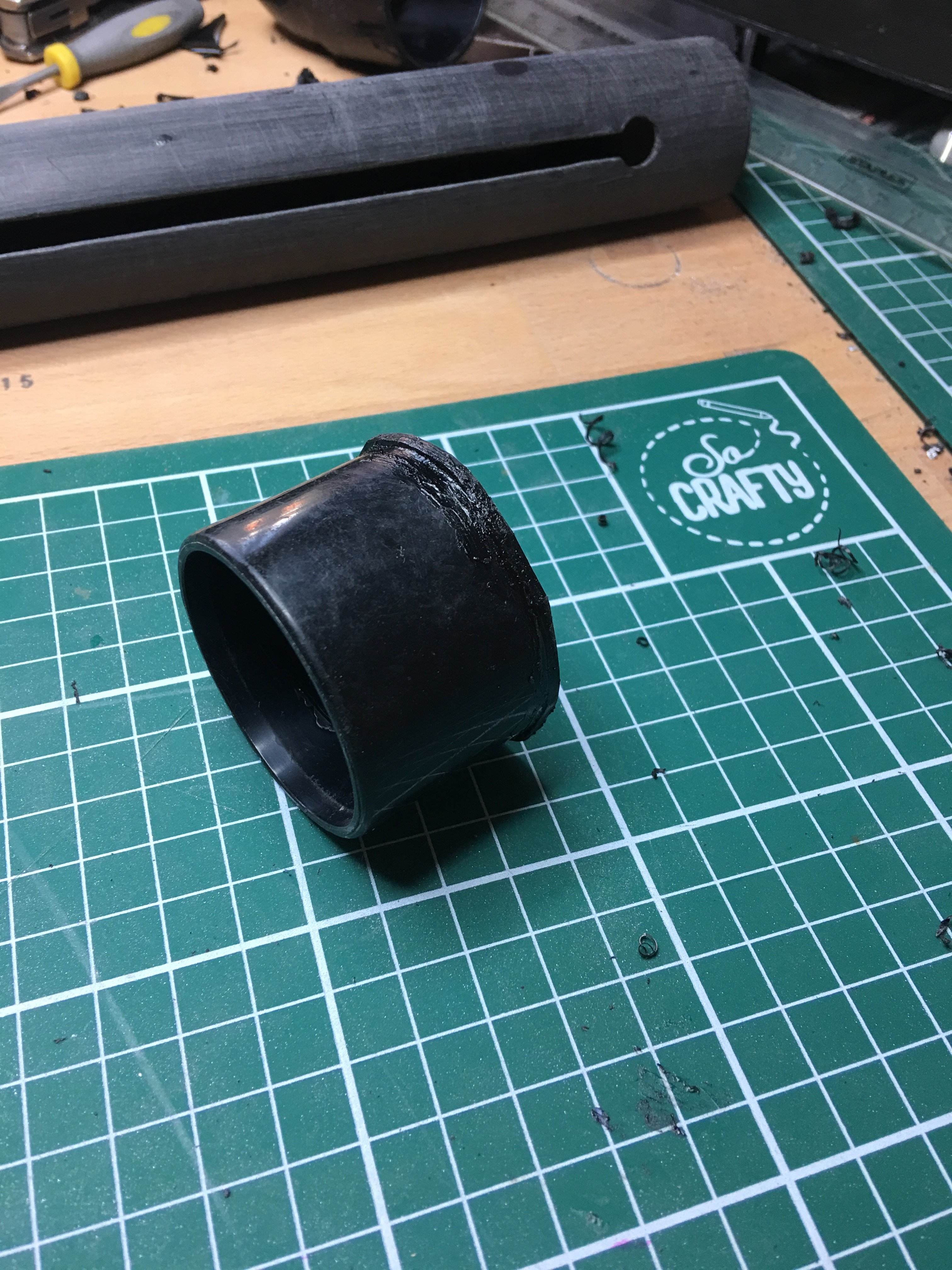

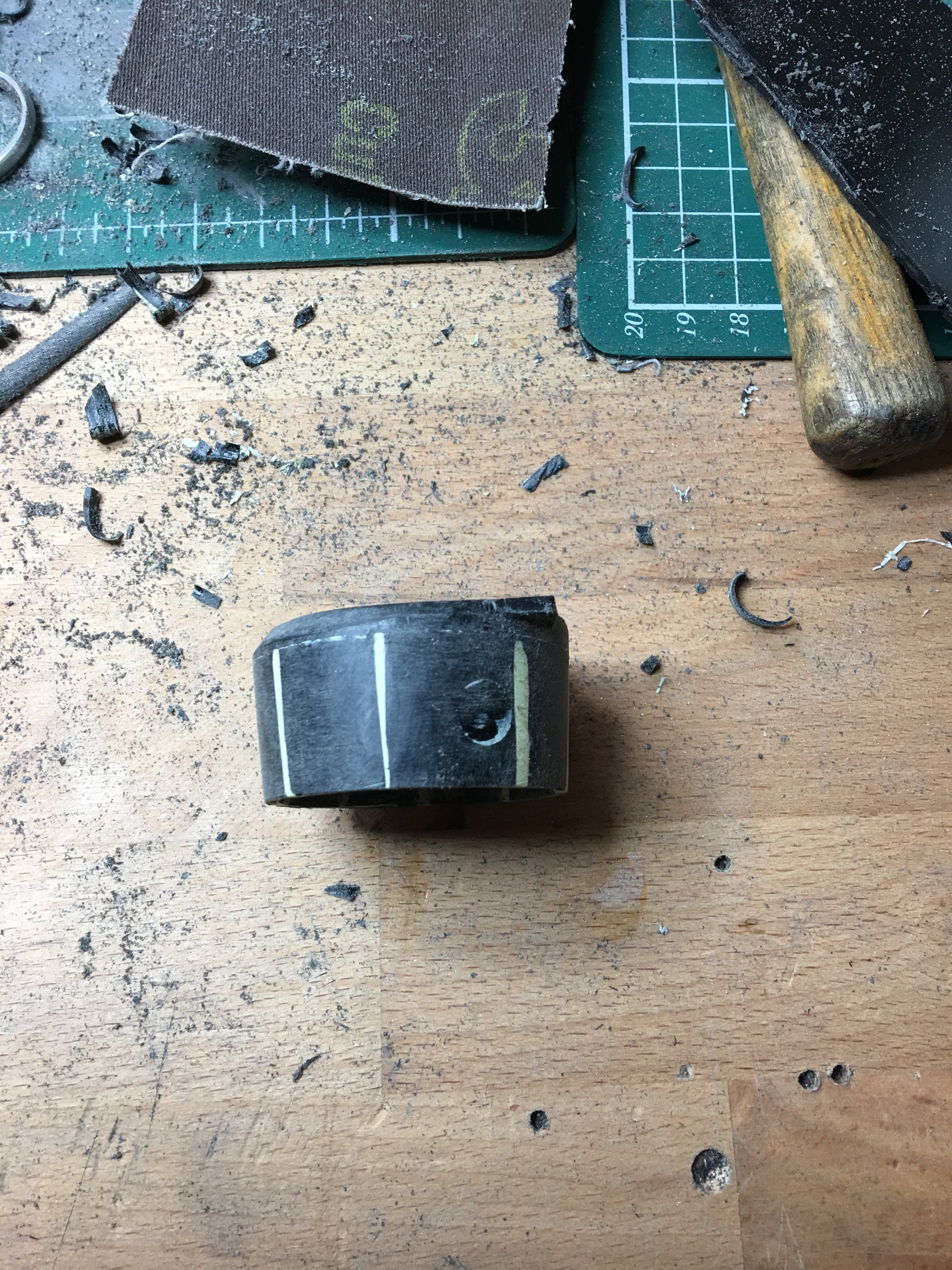

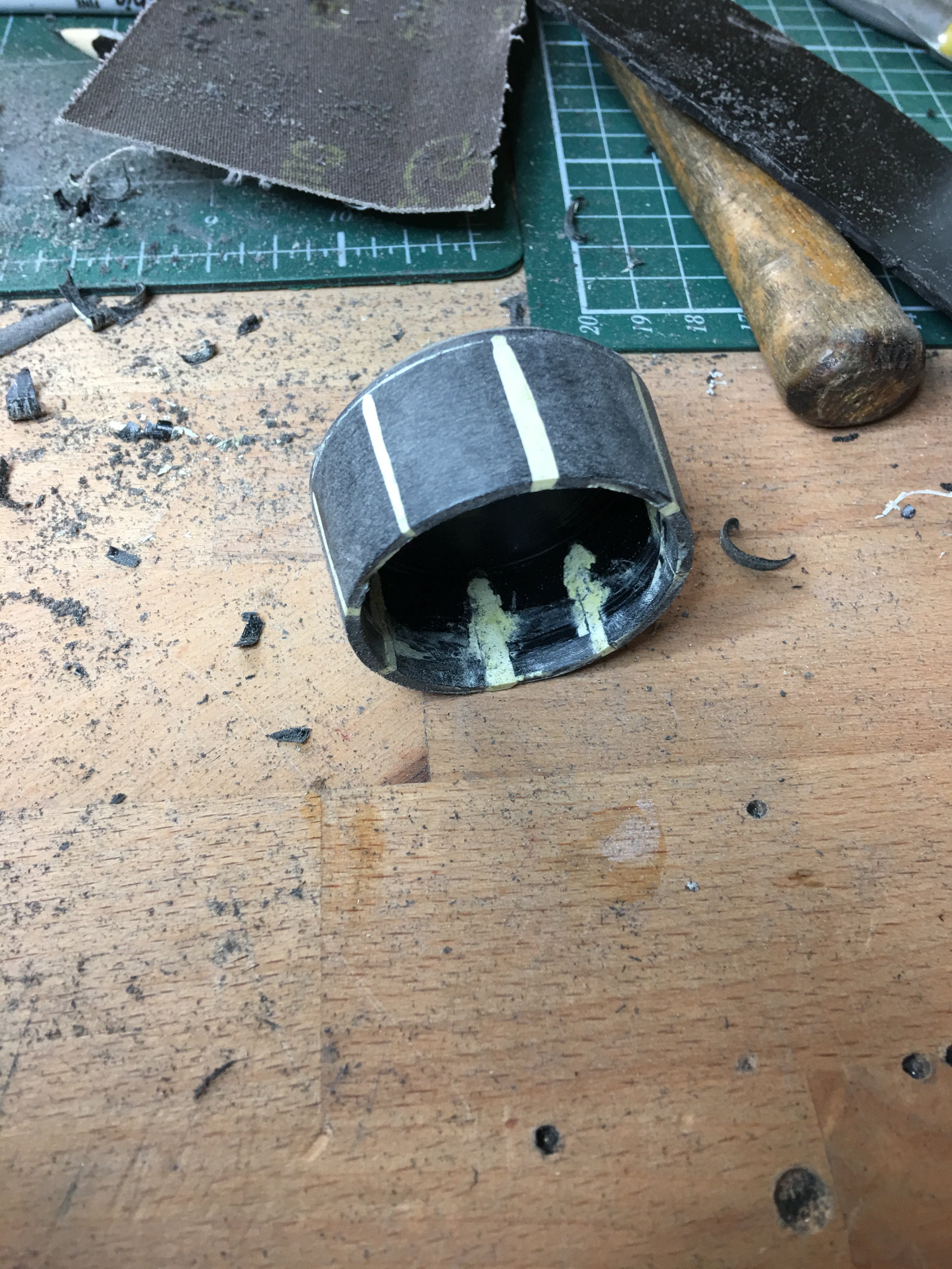

i started with and waste pipe fitting and cut off one of the ends for the socket,
I flattened a piece of pipe, I softened it up in the oven then flattened it out, this was for an end cap on the socket, I did the flat piece 2 times to give it more thickness for shaping later
8AECBFD3-EF9C-45E8-9BEE-C7A964330777.jpeg2806E022-3694-4771-850B-DCFF7E3B4EC6.jpegC7F1A6A2-3430-4EE7-BE0C-3A38CB3DCA85.jpeg
I cut some lines into the socket and pulled it together to give it a chamfered look, then filled the cuts for sanding tomorrow, it doesn’t look like much as yet, but it will ( hopefully)

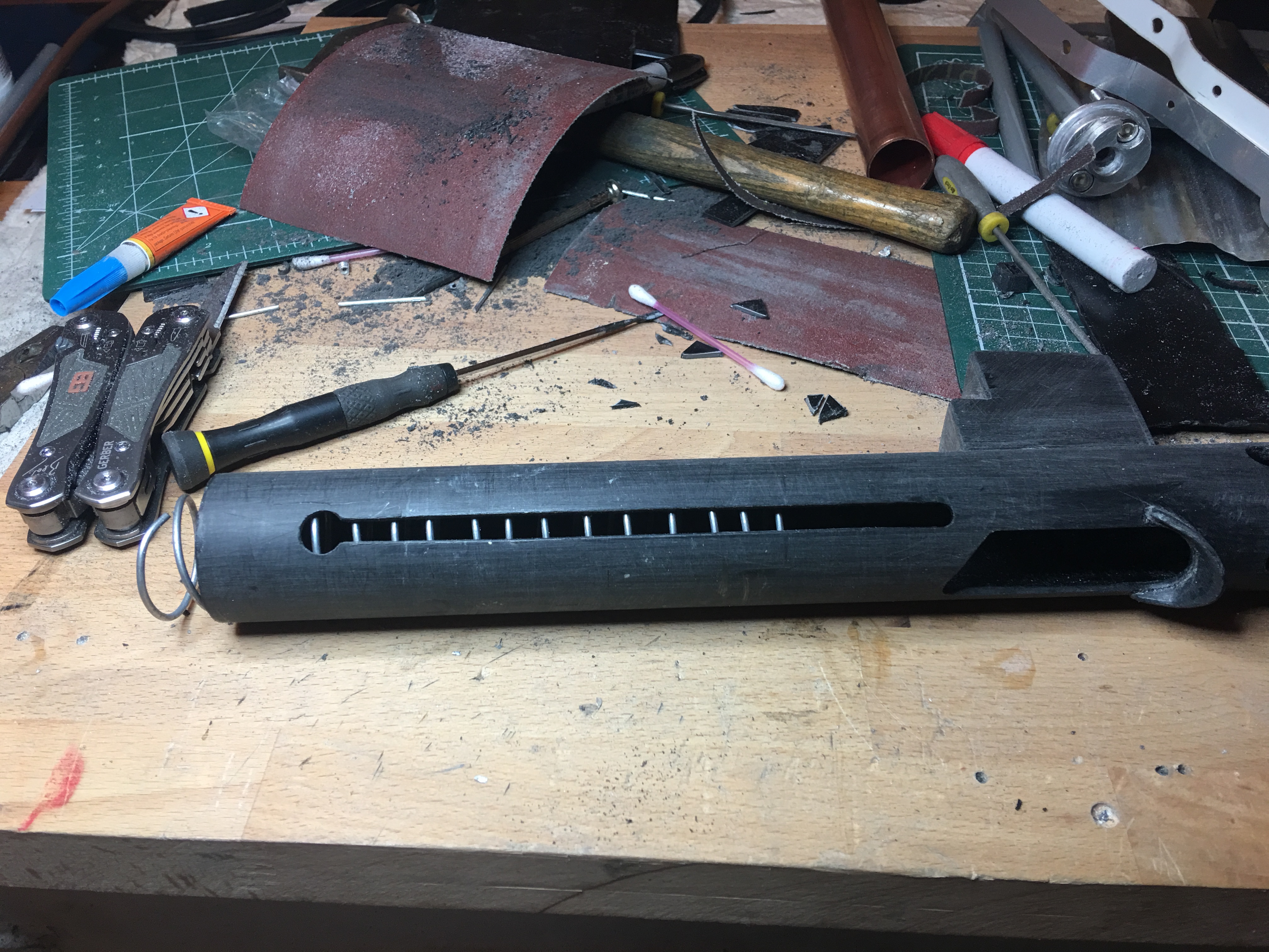

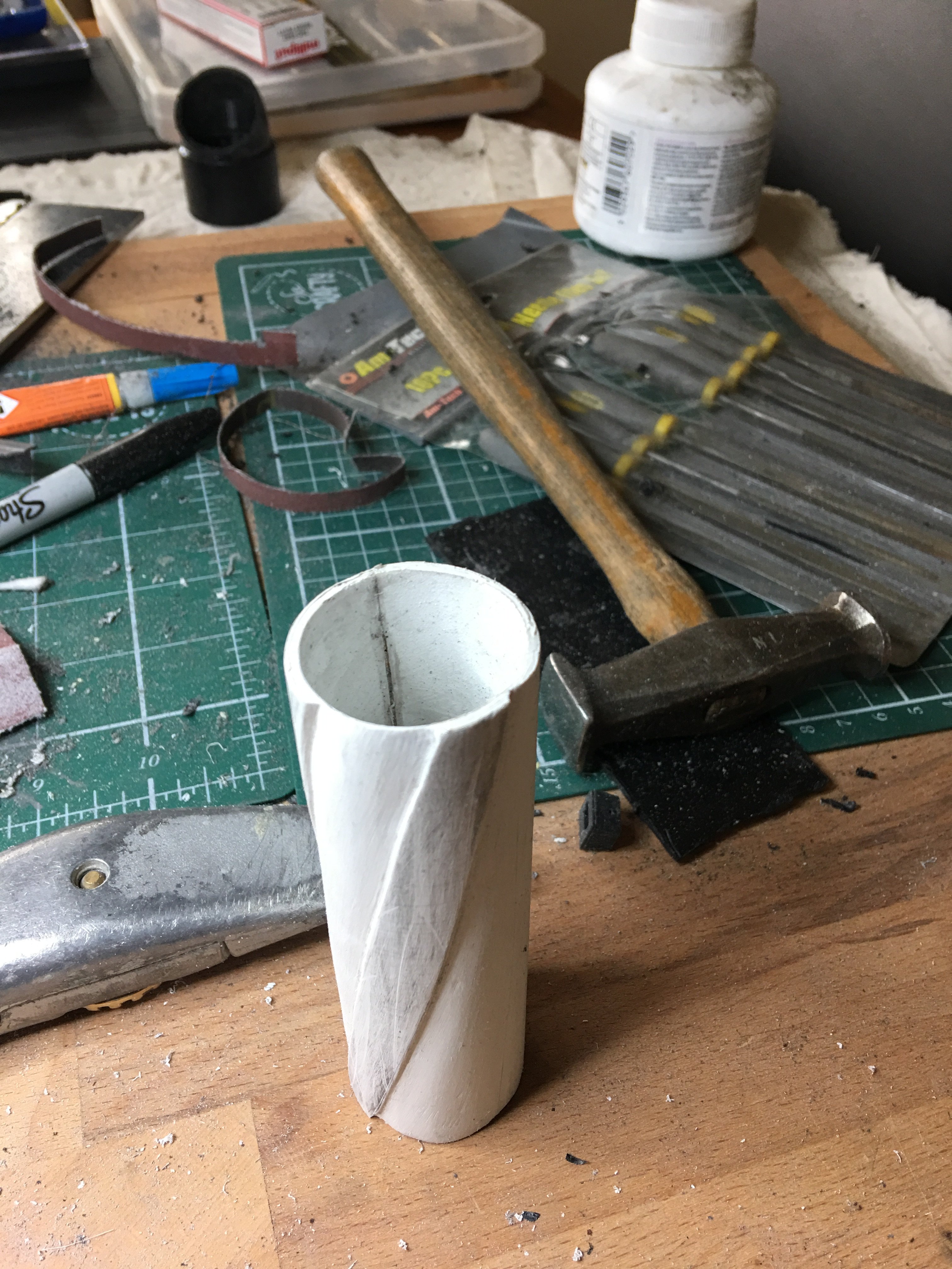

I then started the firing bolt, I cut some smaller waste pipe, cut a 3mm channel out of one edge and glued it back to gether as I did with the barrel, this will now fit inside and hopefully slide back and forth when I put it all together
Drying now until tomorrow when I can sand it down and add some detail grooves

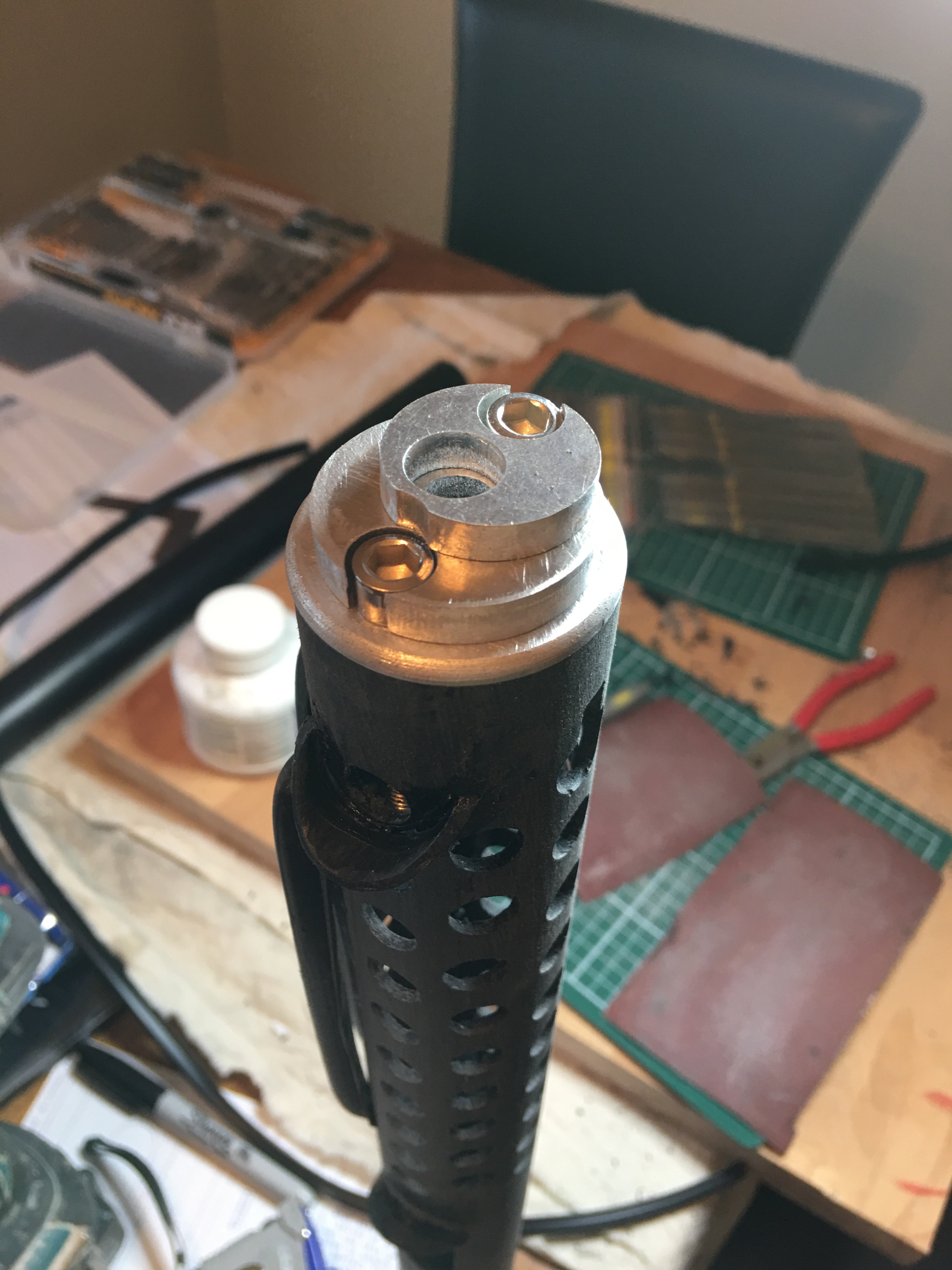

ive worked on the bolt, I sanded it down to fit inside the barrel, I also carved out the pattern that’s on the bolt, all I need to do is blank the end to receive the spring

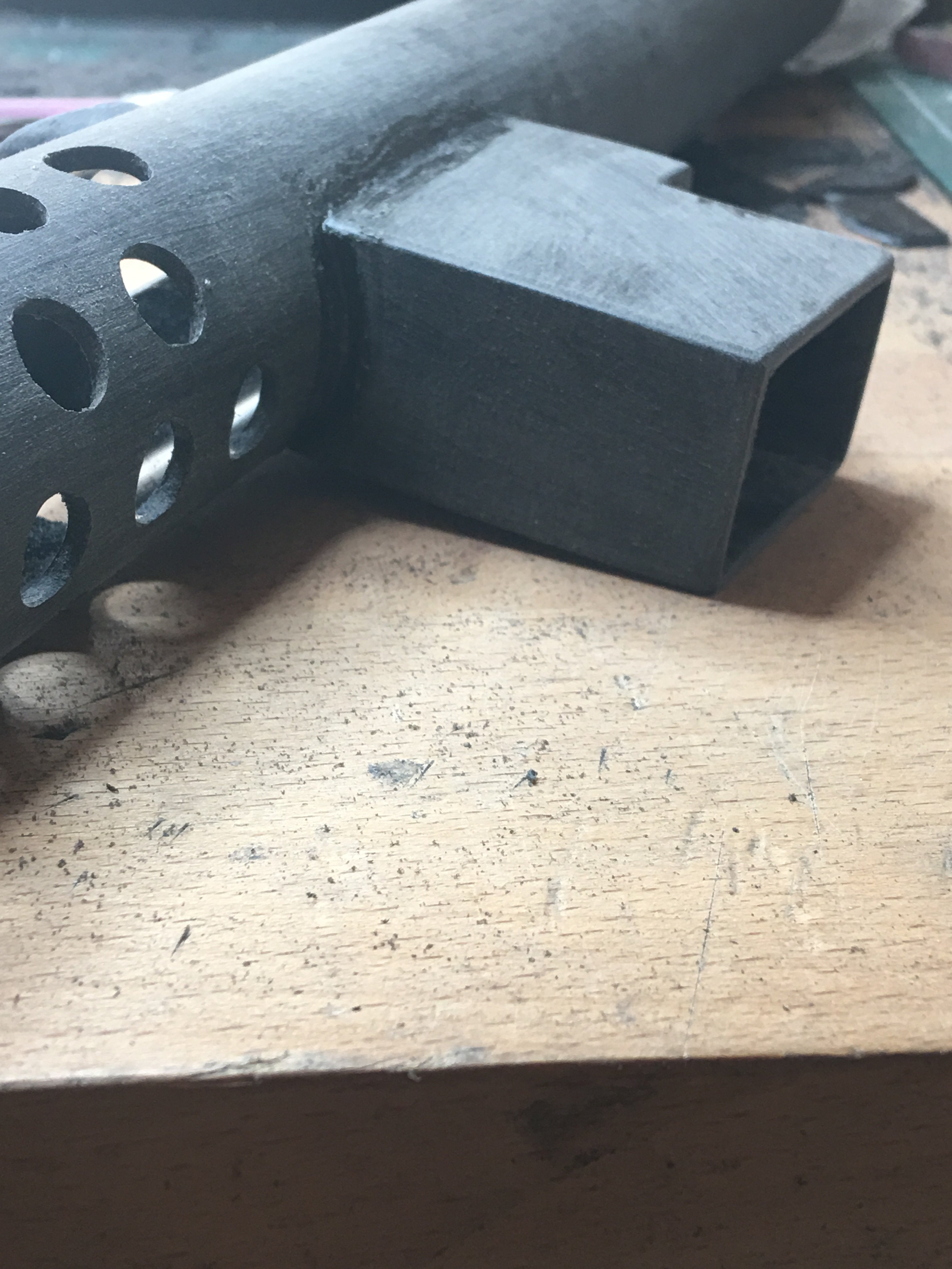

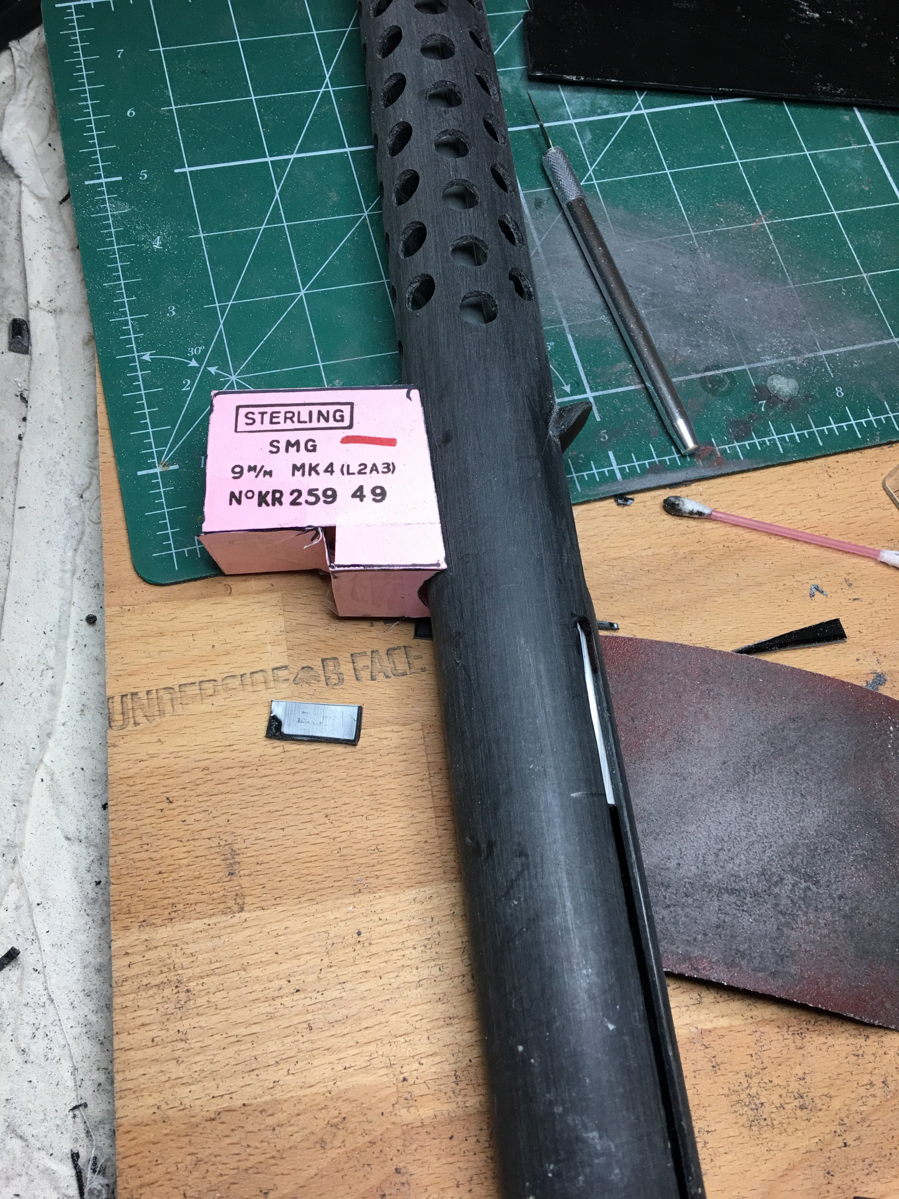

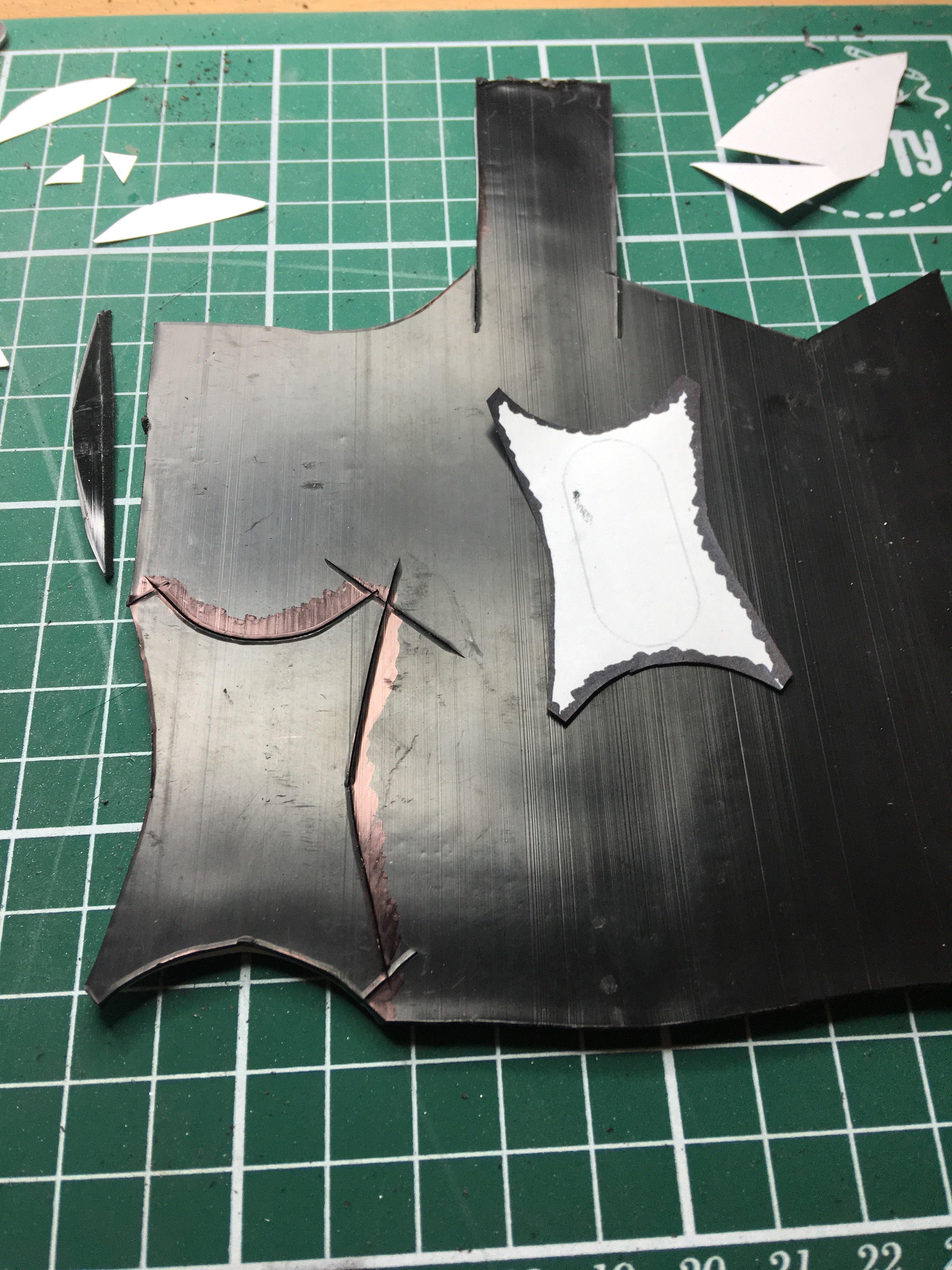

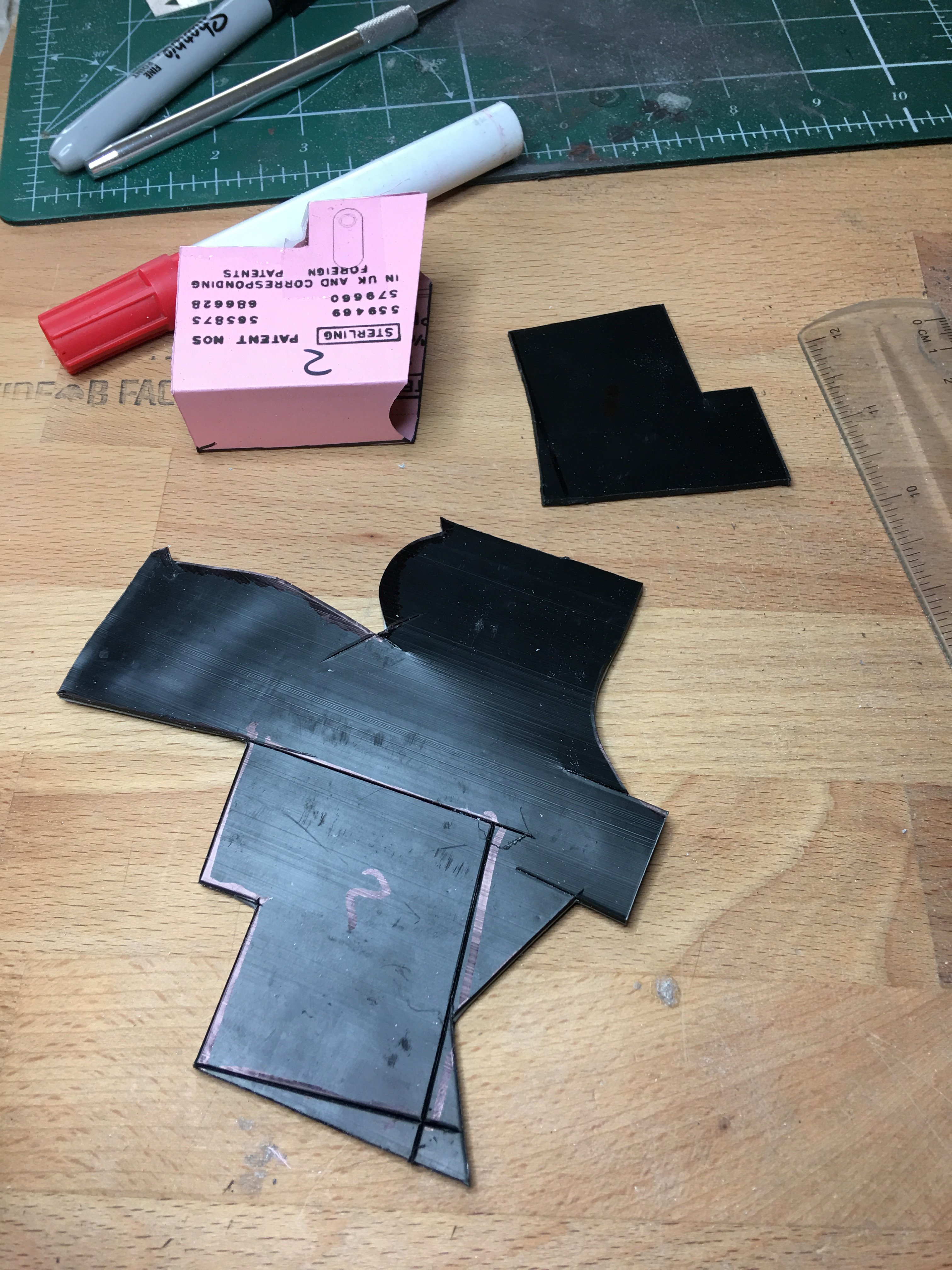

I also worked on the mag holder

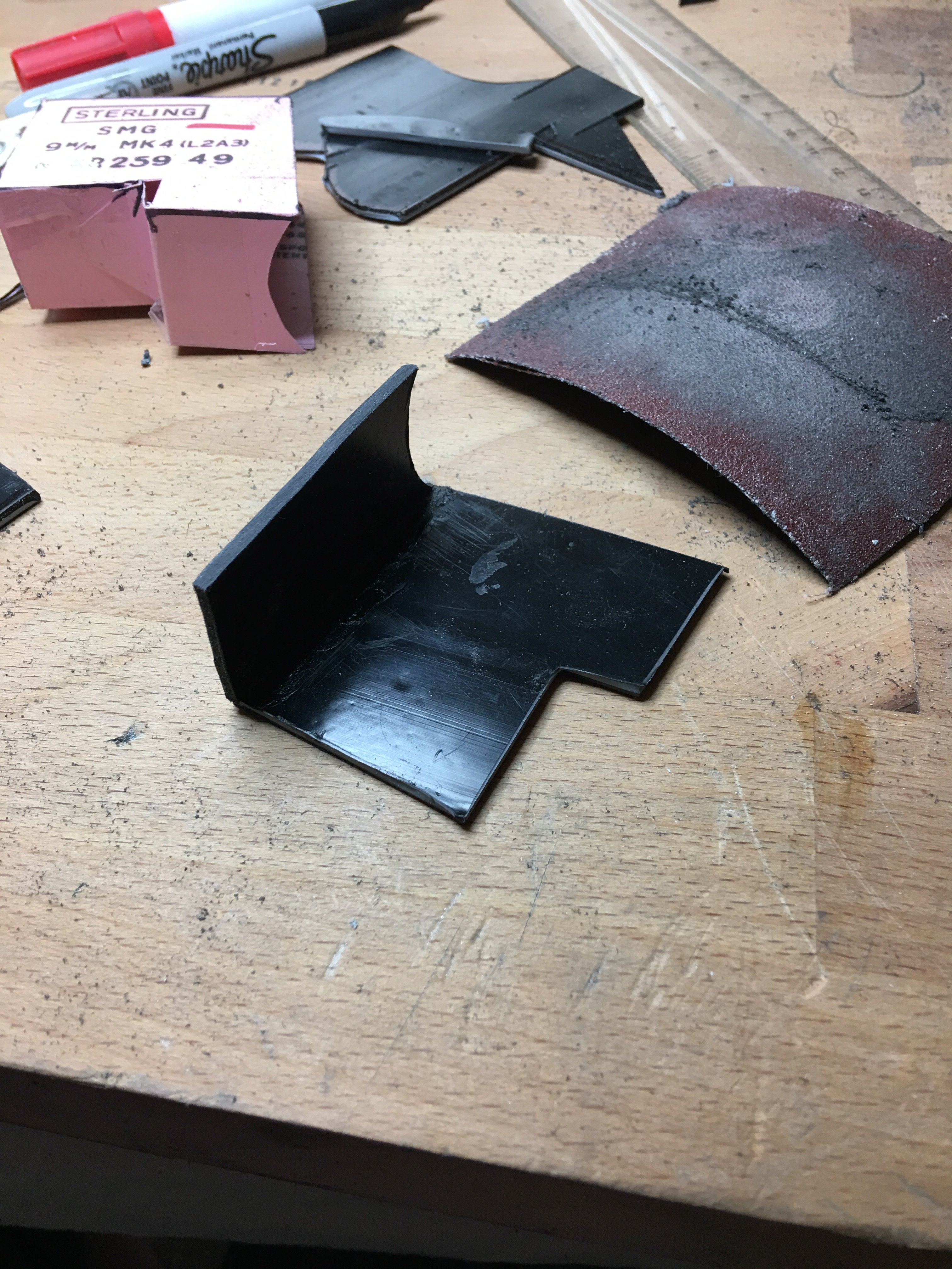

I printed off a template and cut it out, folded it into shape and tested it against my barrel
I then cut out the same shapes from my flat plastic pipe and glued it all together
The mag holder now needs to dry so I can sand it down and glue it to the side of the barrel

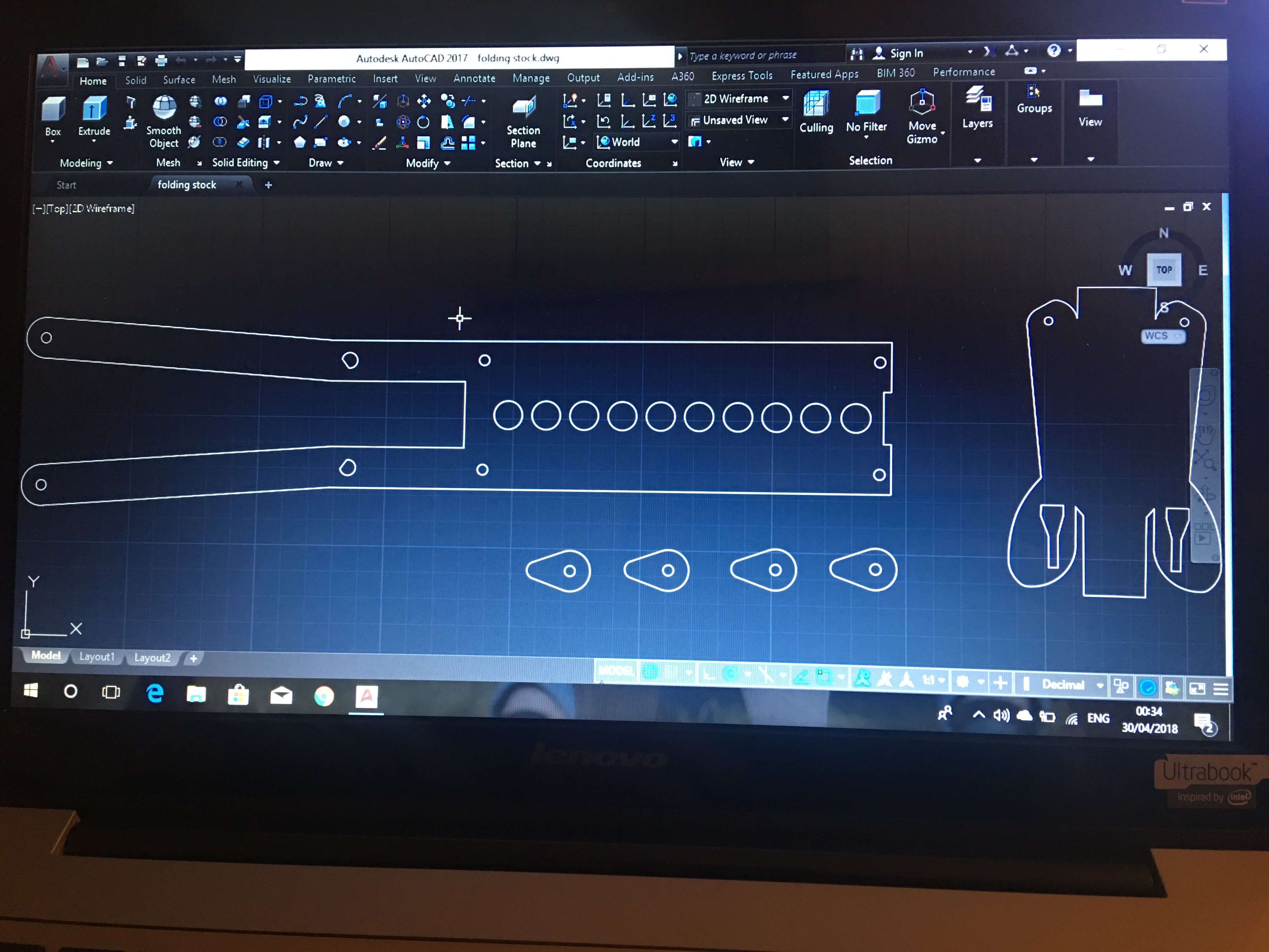

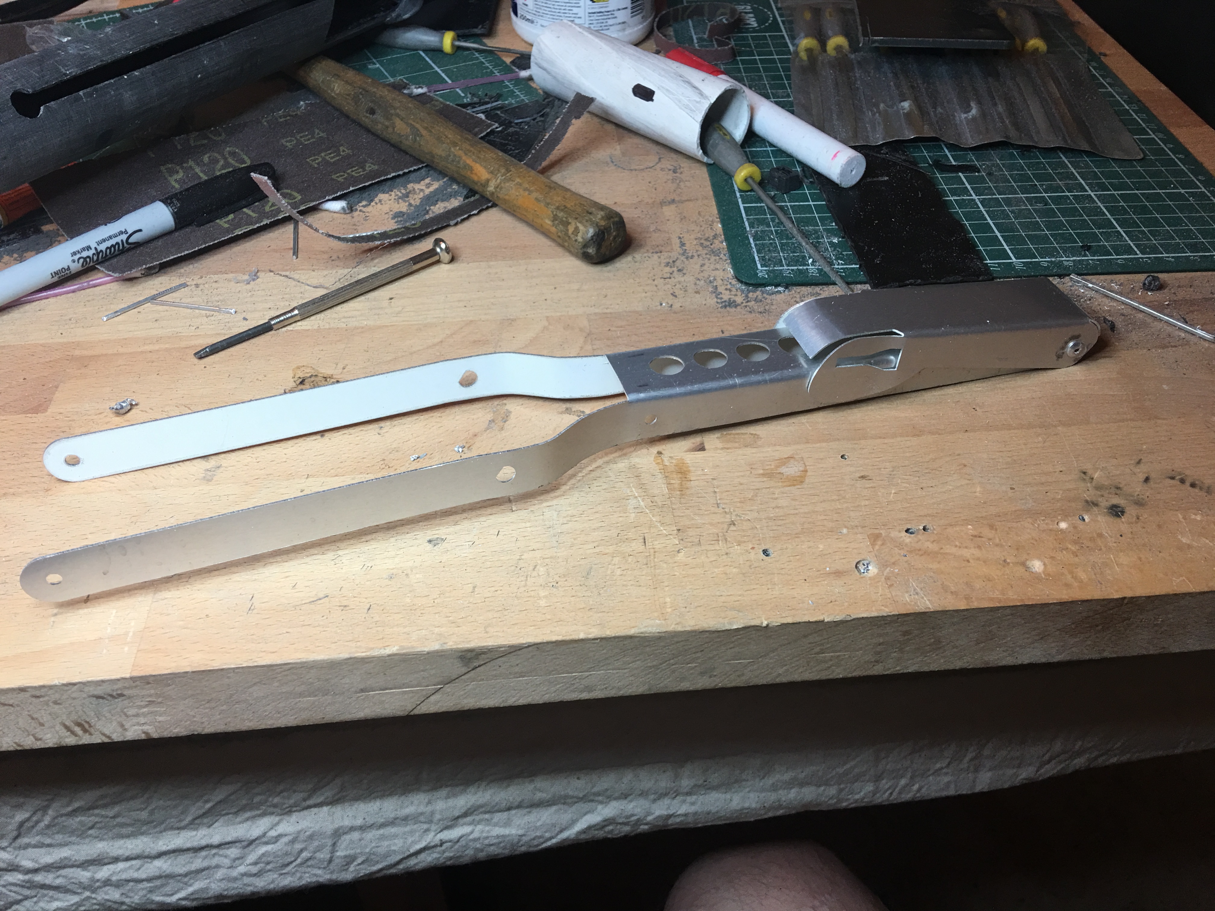

Just finished drawing up the folding stock to be cut from aluminium

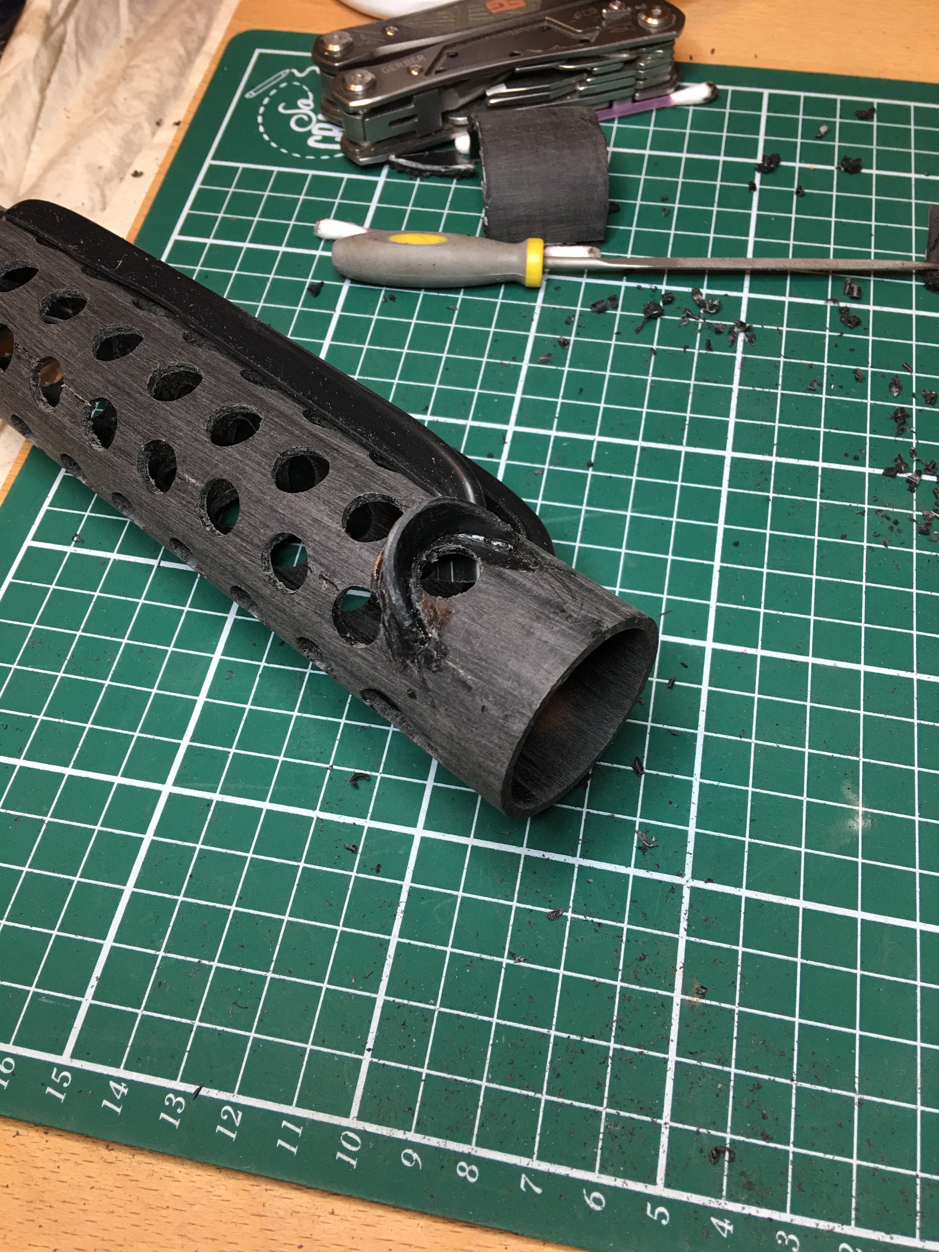

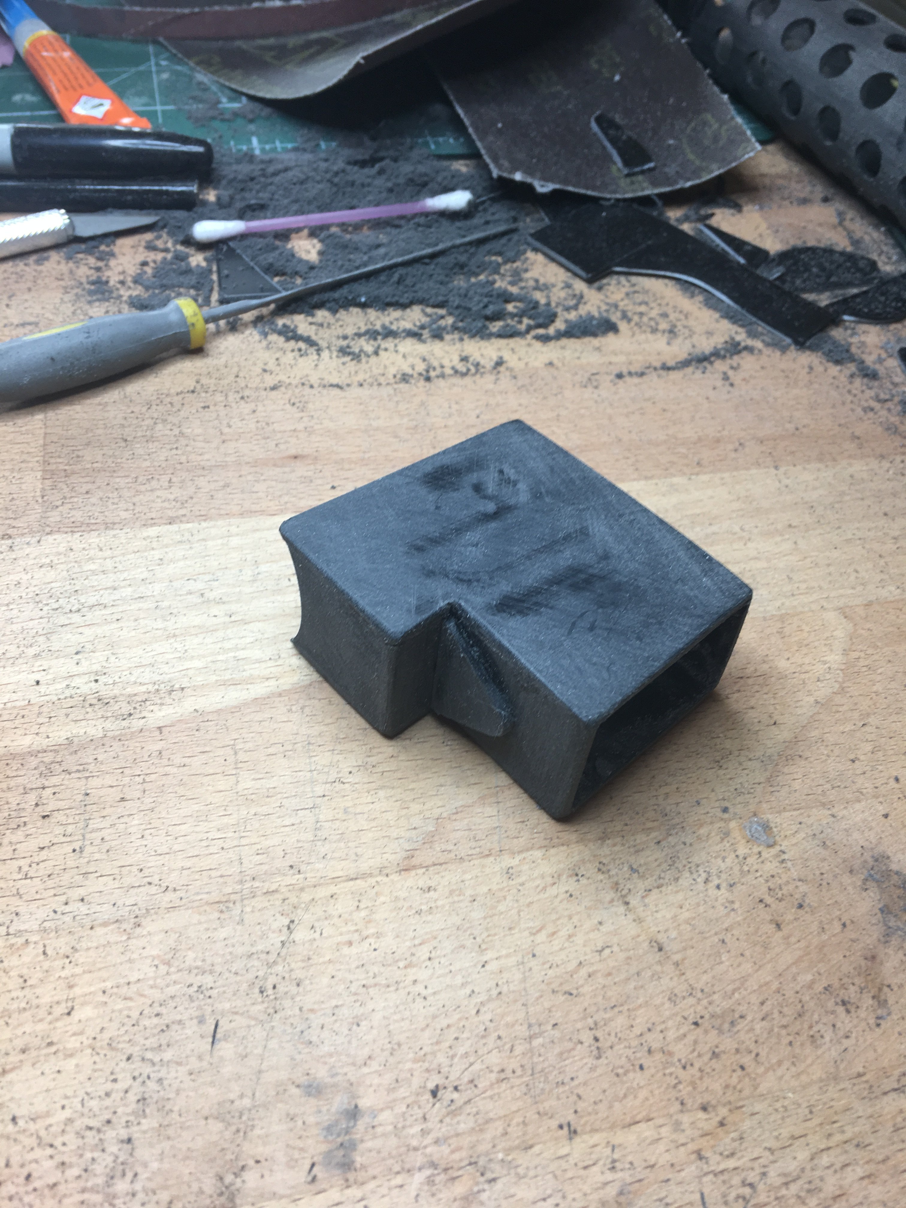

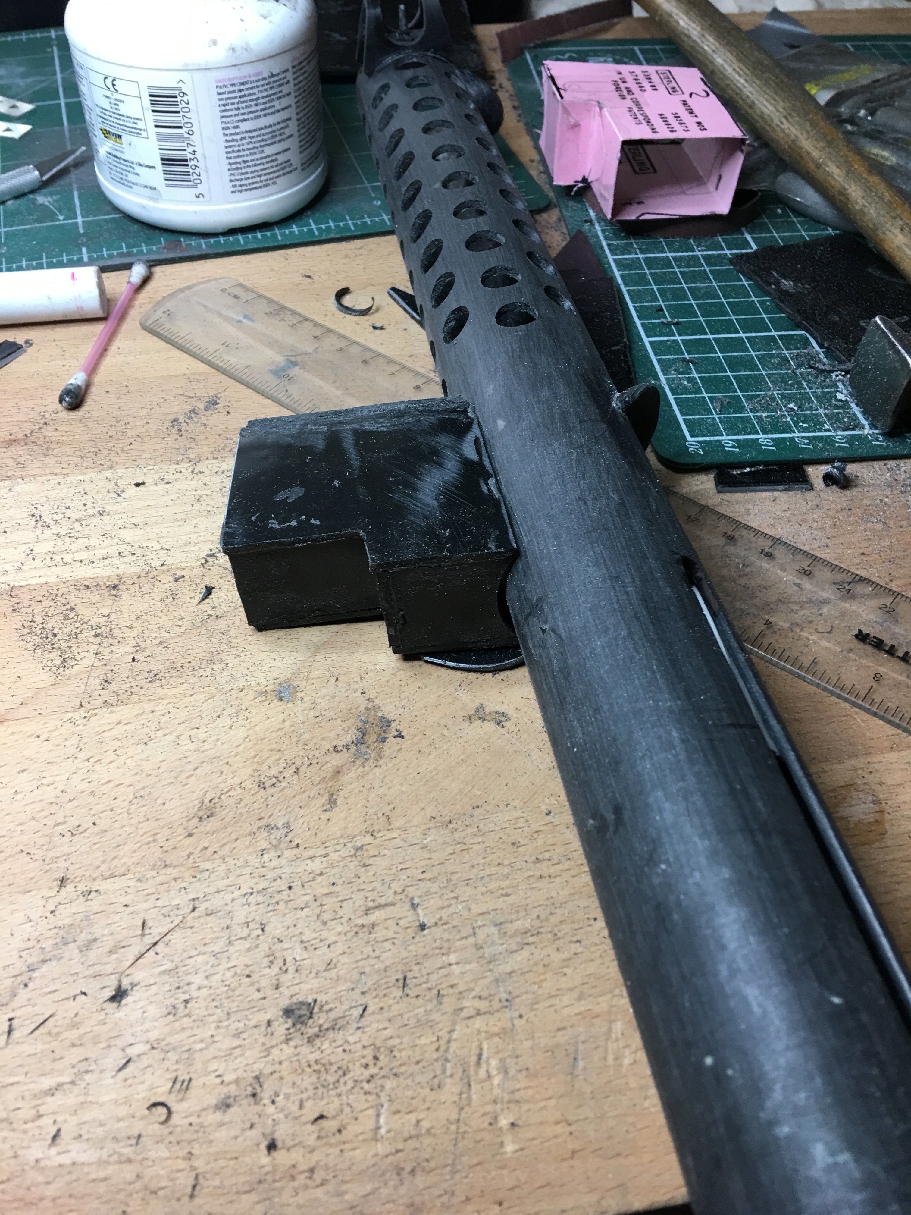

Quick update, got home early from work so I thought I would have a quick play with the mag holder before the wife got home and before the chores need doing
A 10min sanding and double checking the bevelled edges to make sure it lined up and fit together nicely
AC4DD616-E20A-4B8A-8BBD-E2685E50ABBA.jpeg6ECE5E67-3B03-4923-9610-765D3F0DE7F8.jpegD93F861C-69AB-4D88-8452-C60267B62D62.jpeg
I then glued all the edges and stuck it on, it’s now drying and all the excess glue will be smoothed away later
E92B1B60-F87D-4789-AD3B-D808A992ECB6.jpegD447C349-EEB0-4975-BE7E-81084D661AA2.jpeg1579D5DD-A5CC-47E0-8788-943B04BDE3AE.jpeg
Tonight I will be having a go at bending the folding stock, I’m not sure if the sizes are correct as there are many different drawings and sizes out there, I will also be drawing up the handle and trigger section for cutting out of aluminium, top rail and anything else I can draw up
Not much done today mag holder done on the previous post earlier today
this evening I picked up the pieces for the folding stock, they are only 1mm Aluminium and a bit to flimsy, the files are for a fixed stock so it going to stay as a fixed stock
I’m having these re cut out of 1.2mm aluminium tomorrow

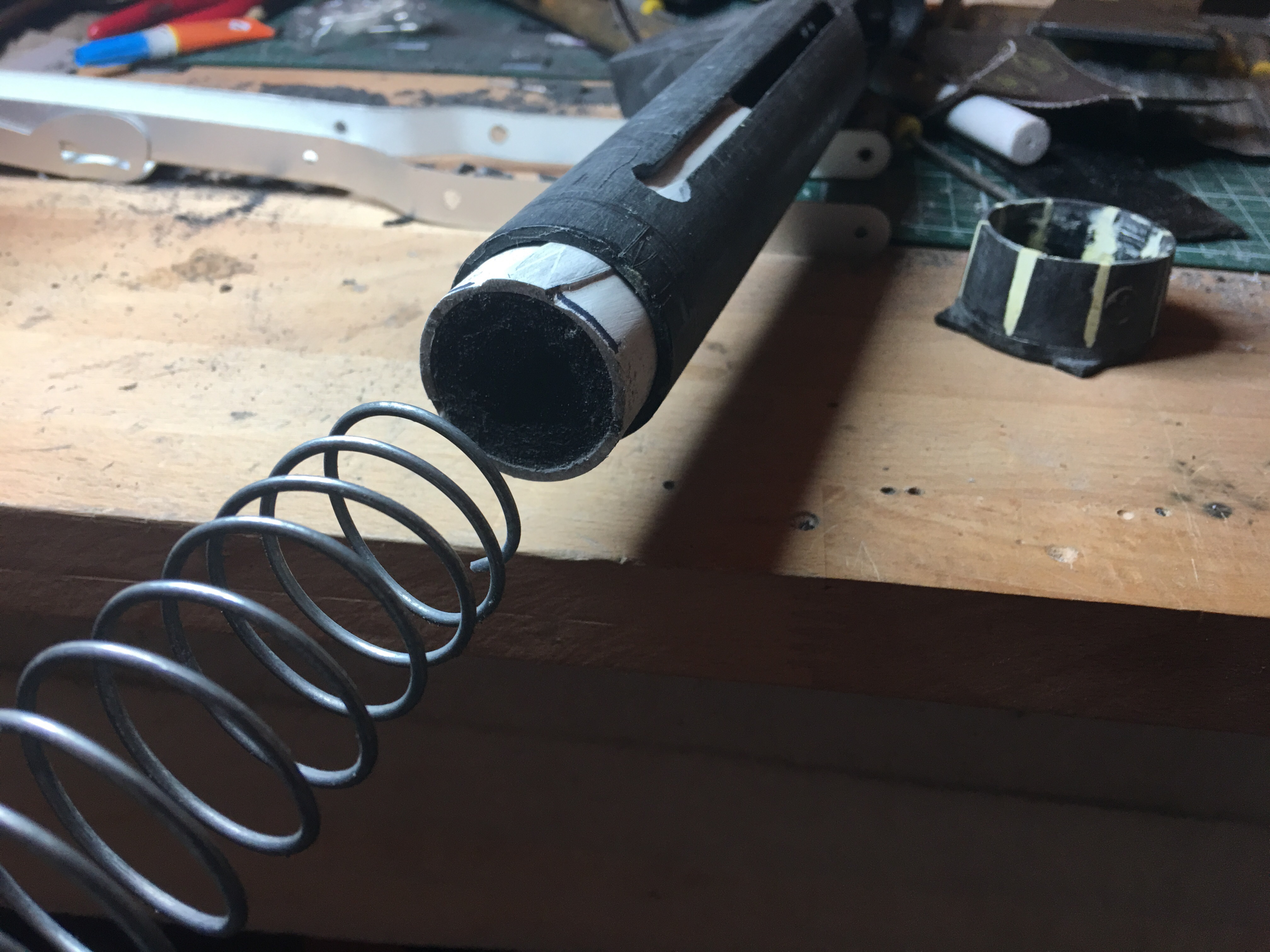

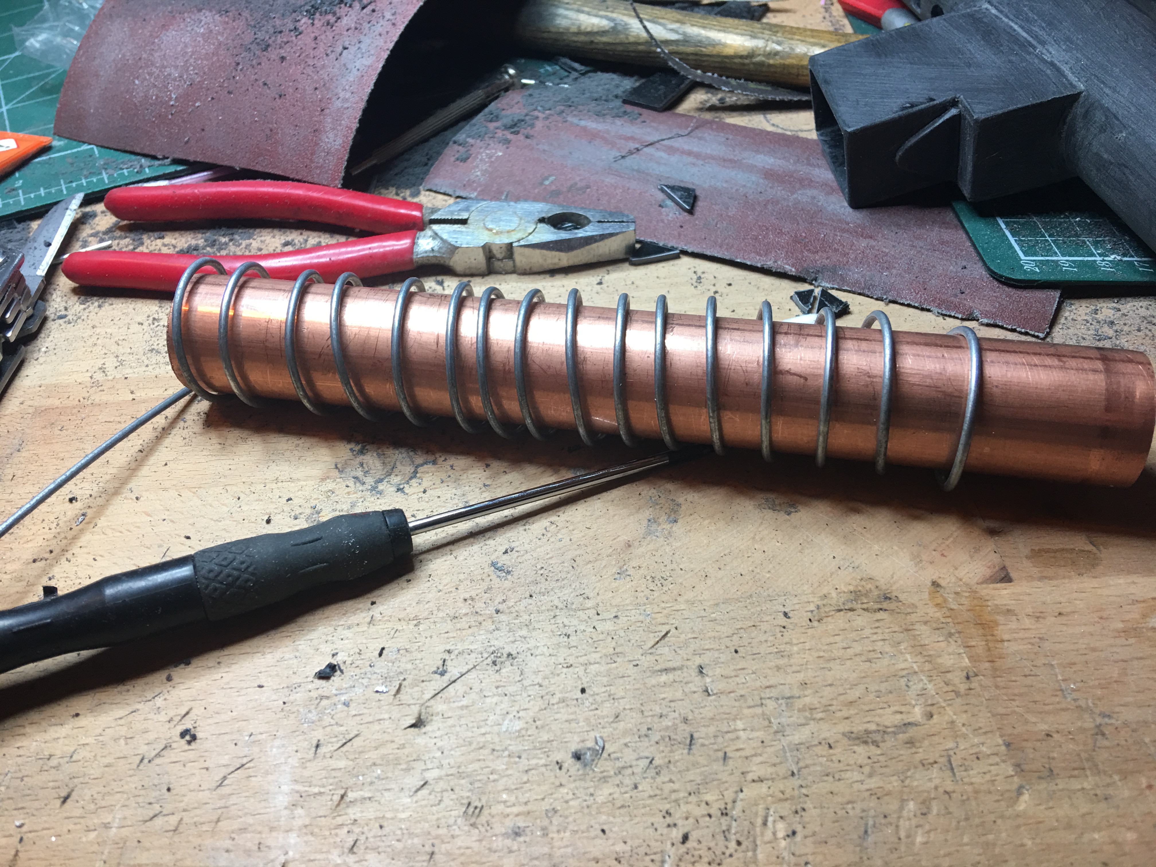

I then twisted some stiff wire around some 28mm copper tube to make a spring and plugged the end of the bolt for the spring to sit against
E88D6649-53C9-4AB6-AEE0-2BC08C9C31E6.jpegAC2BEED3-C3C3-4C95-865D-BDE7132C3EA3.jpegimage.jpg
It will be able to cock back and spring forward, there was really no need for me to do this but I though why not

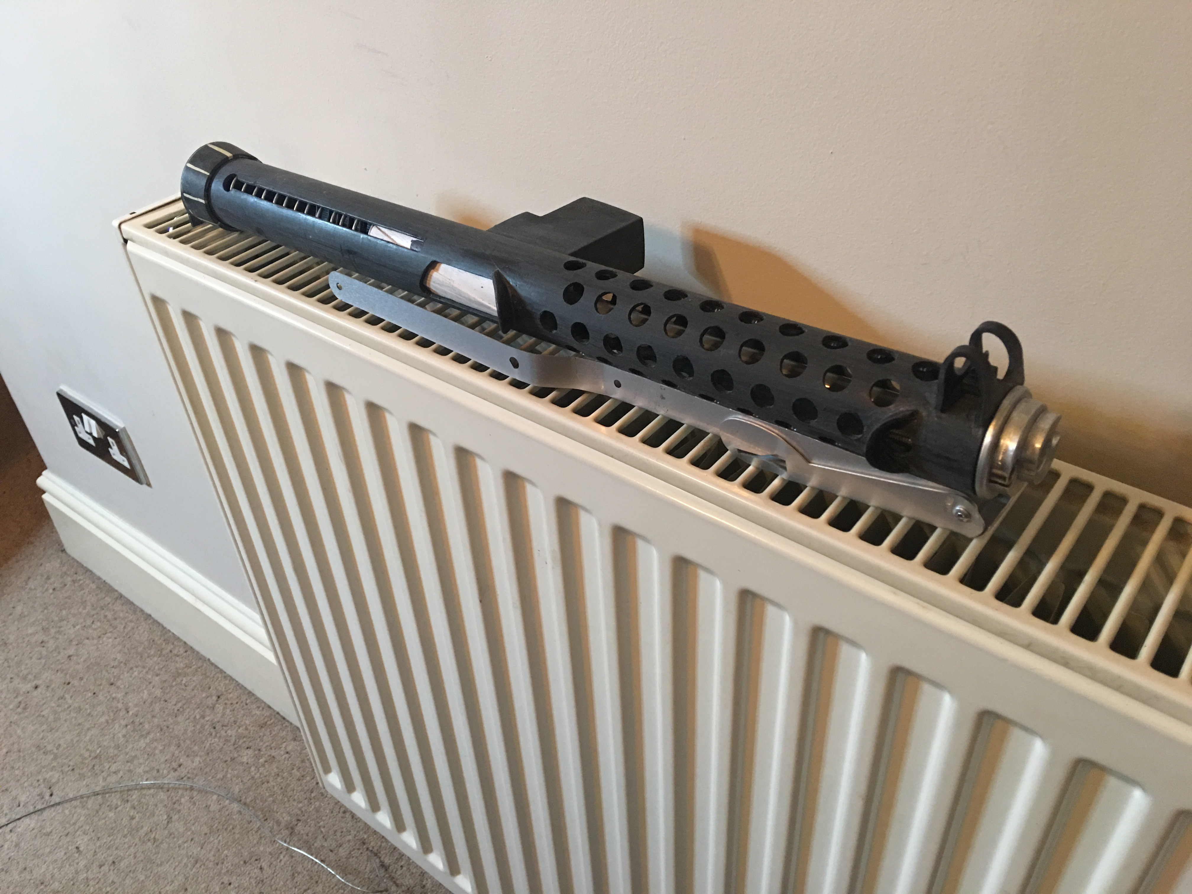

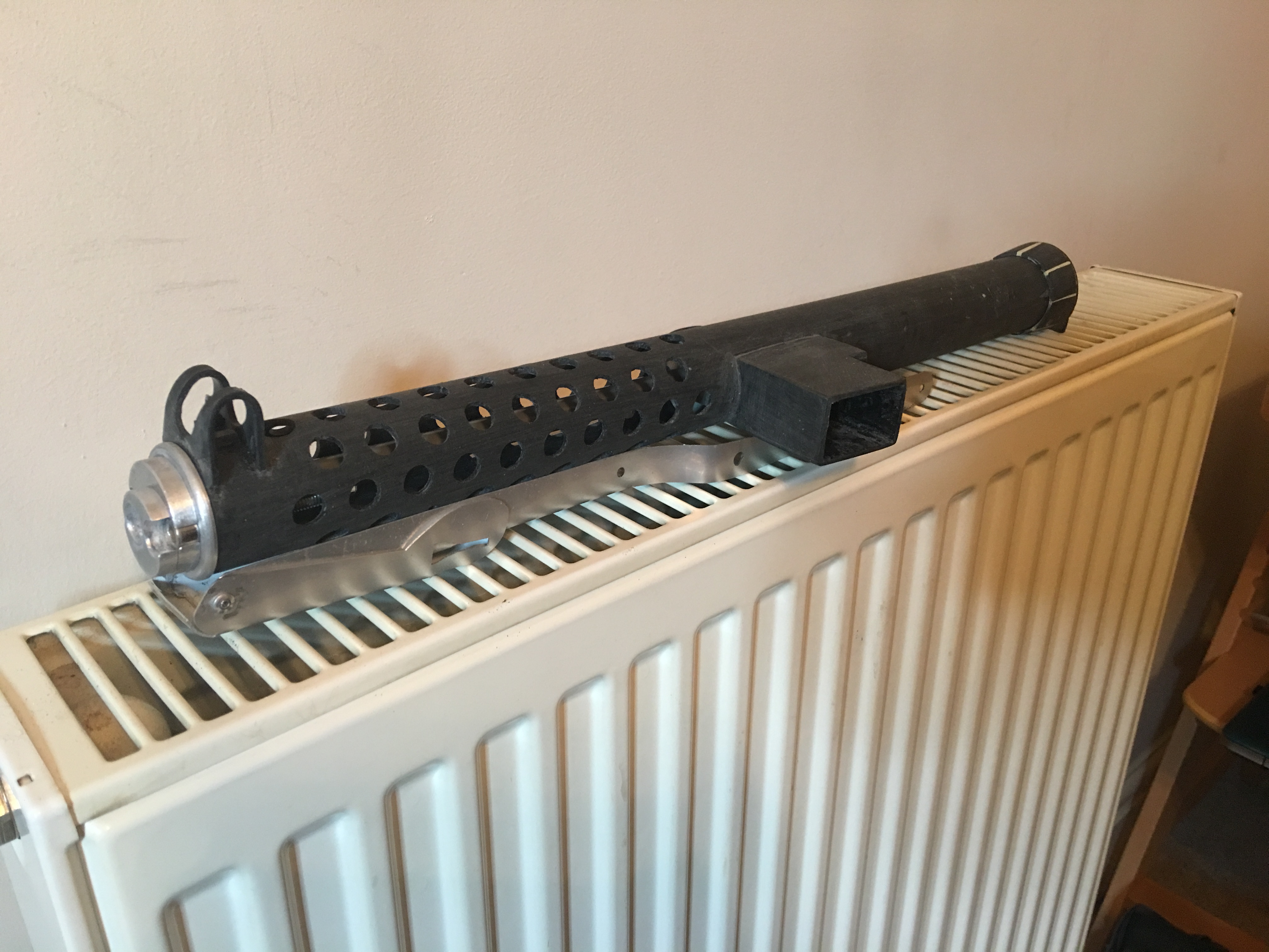

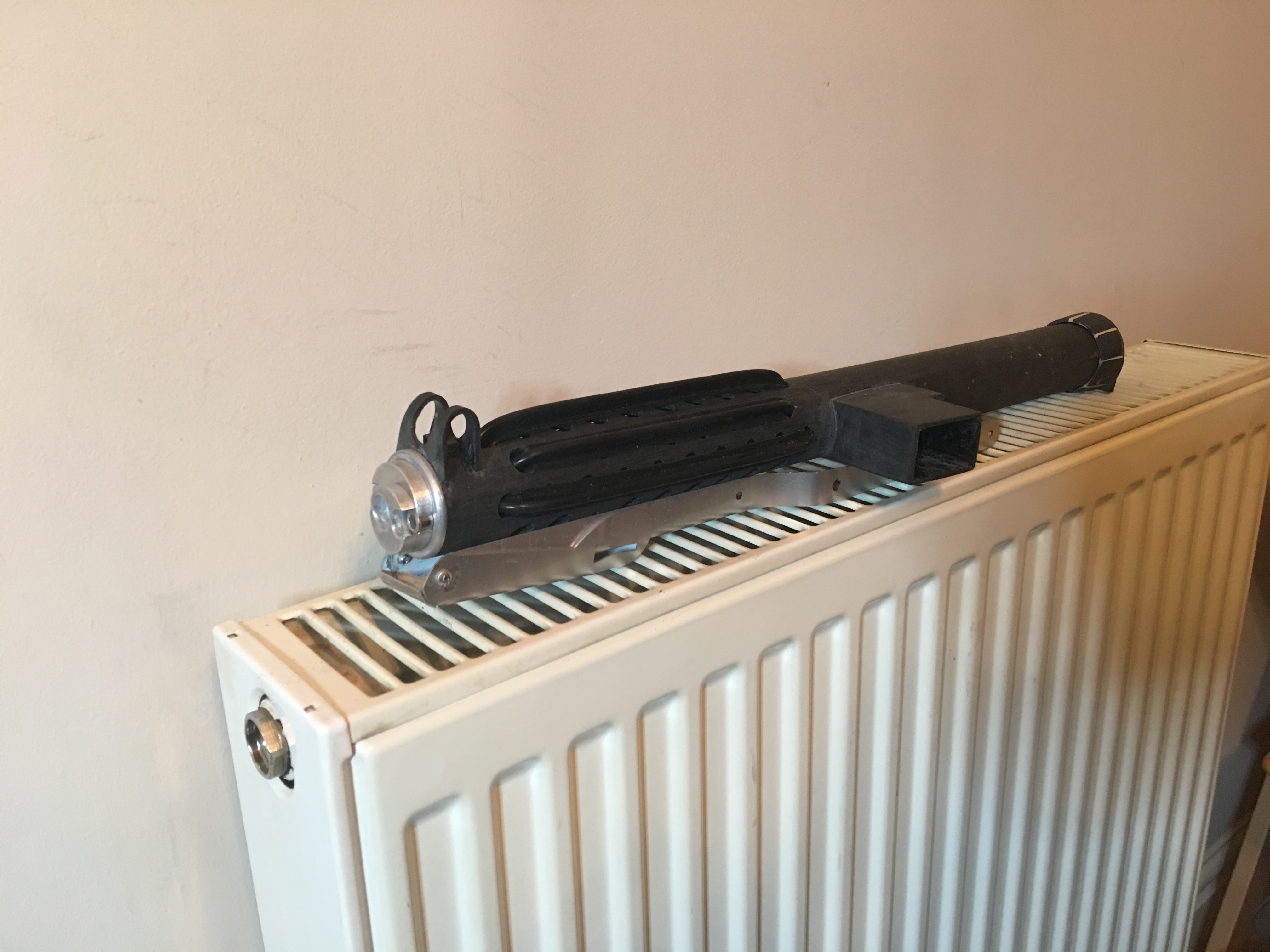

this is where I’m at, end of day 5
without T track
With T track

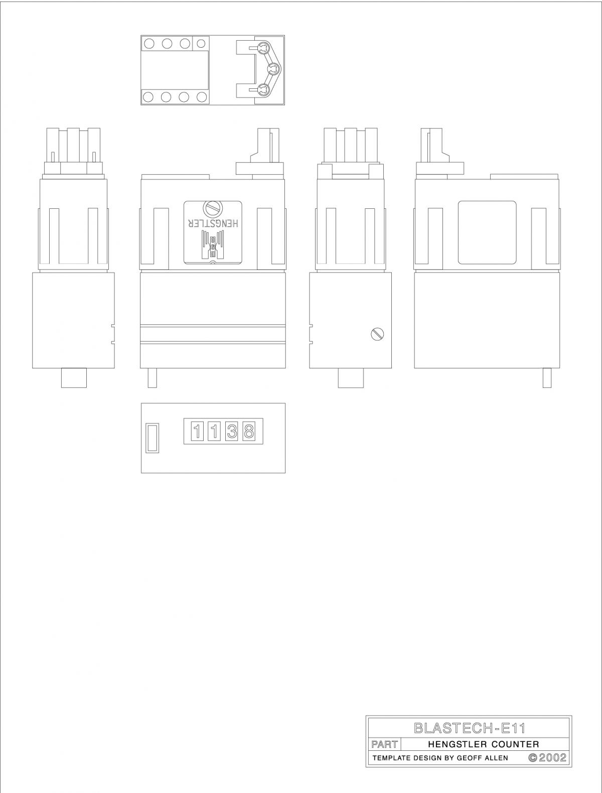

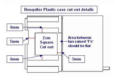

I don’t know what I will be working on tomorrow evening, I need to draw up the grip and trigger section, I might try the magazine and the Hen counter box
Has anybody got any decent measurements for the Hengsiler counter box ?
I want to make this tonight but I just can’t find what I’m looking for
