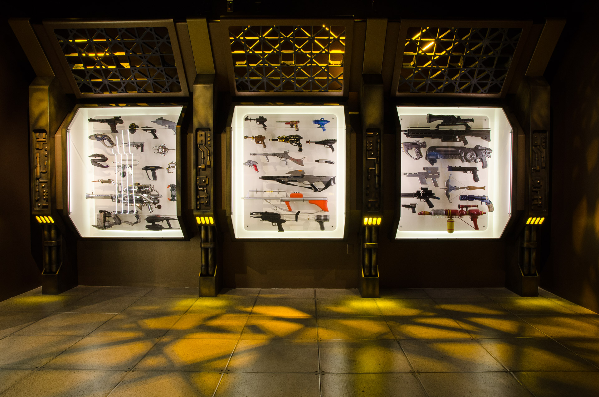

The "Gun Pods" we made for the sci-fi gallery. Tons of cool stuff. We ended up not being able to use the DL-44.

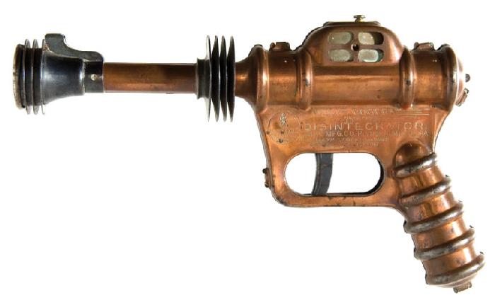

Buck Roger's XZ-38. I love the look of this ray-gun.

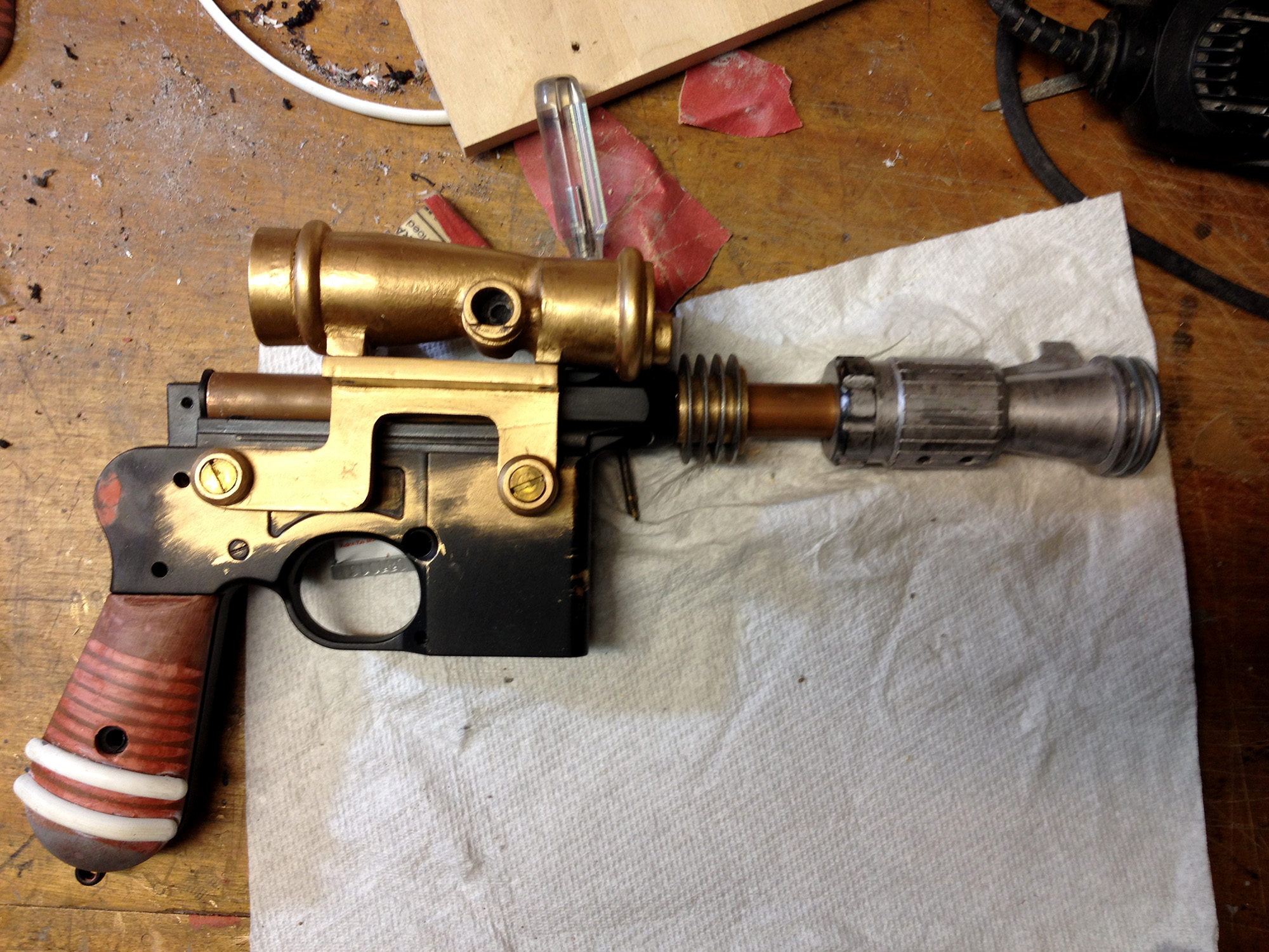

Since I didn't have time to build a scope from scratch, I used a messed up resin cast of a tank scope and added details. I thought I had more pictures of the flash hider build, but I must have deleted them from my phone. I used one of Boba Debts delrin ROTJ hiders and sliced up the cone, interspersing it with large fender washers. This was my first experience with Rub 'n Buff, and getting it to stick to delrin was a real challenge. I ended up sanding it and fogging it with superglue to create a surface that it would stay put on.
I like the swoopy shape of this smallish ROTJ mount for this. I used antique gold Rub 'n Buff for the body. It's not ideal for large areas or high detail, but it came out pretty well. I don't usually do anything this glam, so it was fun to do something flashy and different.
We just had a plumbing emergency, so I had a ton of 1/2" copper pipe they had to rip out, so the barrel was probably the most expensive part at $800.00.
The copper pipe was a perfect fit for the barrel and grill. It's so satisfying when stuff just fits together without a lot of jiggery-pokery.
I just bondoed the crap grips that came with the base airsoft. Gluing up the half round on the grips was a *******, I had to buy up all the 1 1/2" Irwin clamps at the two closest Home Depots. Still, you can never have enough clamps.
And...done. Done-ish any way. I think I'd like to go back and do a few changes, like extend the trigger guard forward, and find a nicer solution for the scope attachment.
