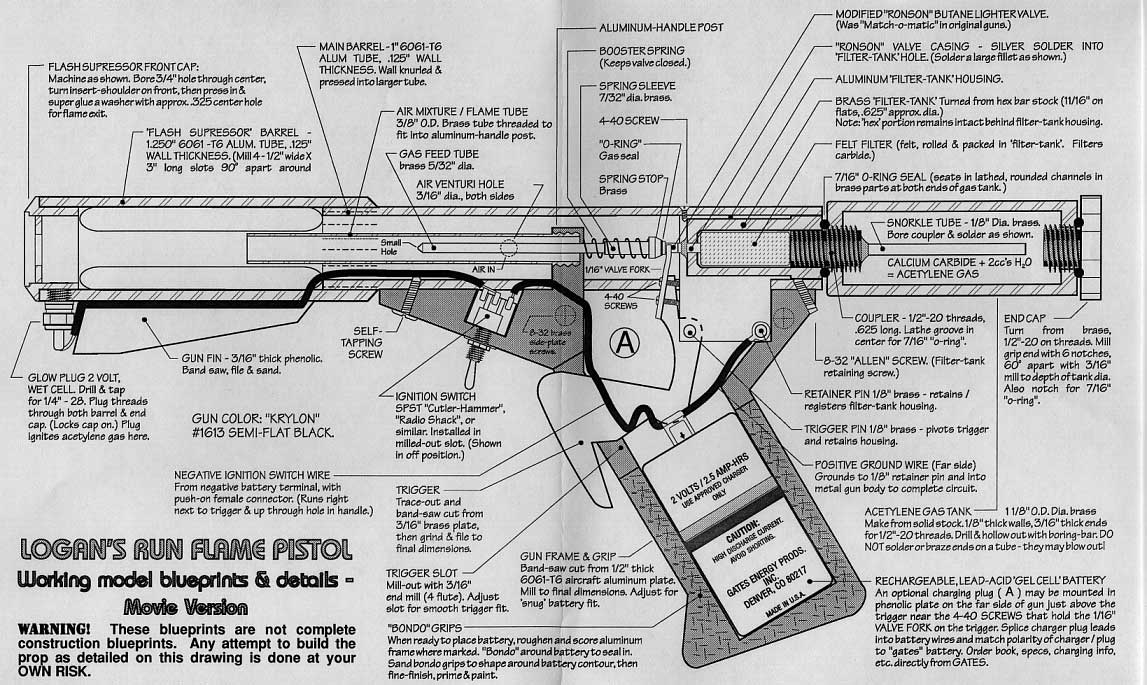

*That attached image is for reference and is not the JJ Lastelick version.
