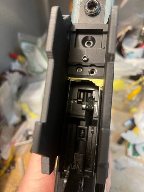

Magwell attaches to the receiver via 2-3 screws on the center inside and one on each outside. I had to redesign the Magwell 4-5 times, as it was very hard to keep enough clearance for inserting the magazine, and still have it securely fastened. You can also see at the top where the "wood" foregrip attaches to the magwell, and where the foregrip fastens to the barrel via the M16 grub screw and connector plate.
The grip on Vera is much longer than the original Saiga, and since long-enough screws are difficult to find, an extension was made so that I could use the original M5 hardware. You can also see the cut-down trigger. Vera's larger trigger will slide over it and fasten with a grub screw. Same with the mag release lever, which didn't need to me modified.

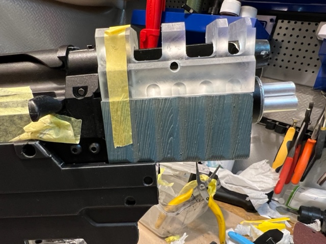

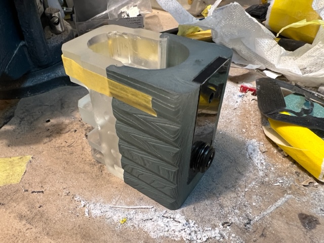

Here's a better look at the rear foregrip. Note how the top/bottom pieces interlock so that they stay in place better. Wood grain was modeled into the bottom piece, and has been done to the grip sides as well. (If I ever come across someone who machines in wood, they can easily be swapped out!) <the black connector plate is HTPLA.
Here we see it slid onto the barrel. Note that the lower piece looks a little "chunky" compared to the top one (brass on Vera). That matches the real ones too as the wood pieces were much more rough.
