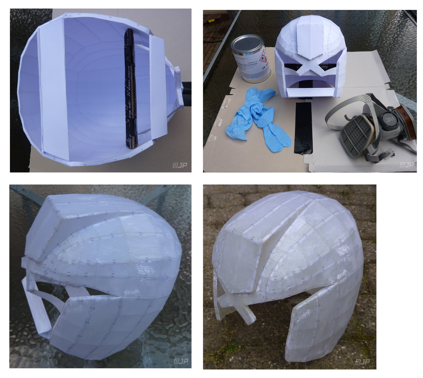

Part 1: Pepakura build

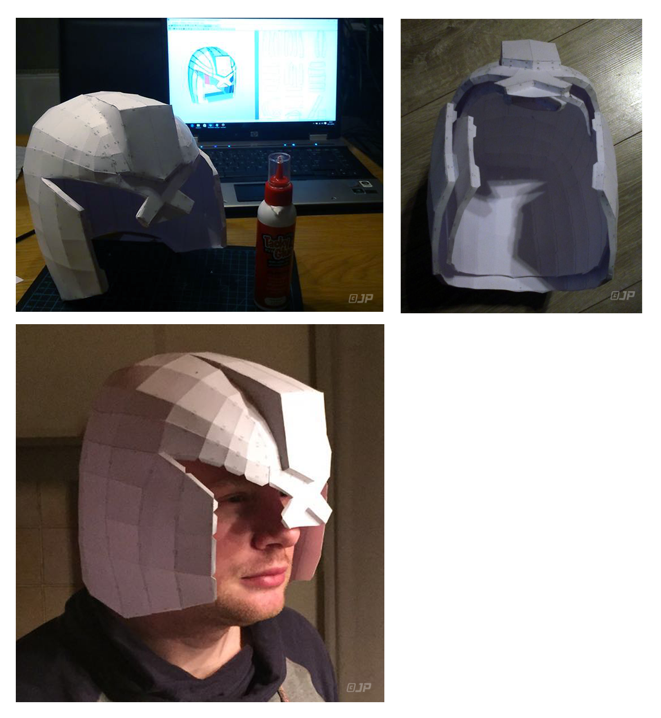

As many before me I choose a pepakura model as starting point for my helmet build.
The pepakura model itself is not very hard to assemble but it helps if you get the scaling first-time right. As you can see in the picture I had to re-size the helmet since my first build was a bit too small. It is however worth it to get it right before continuing since this will be the starting base. The helmet was scaled to my head but I used the studio creations website (link to be added) to keep it as screen accurate as possible.
Note:
Use the right paperweight for your pepakura build this will make your base model more rigid.
(to be added -> paper weight I used)
Part 2: Polyesterresin coat
The next step in the build will be to reinforce the pepakura paper model. This is done using polyester resin (link to be added) and fiberglass sheets. In order to avoid deformation of the model while the resin cures the paper model needs to be reinforced with some additional cardboard or sticks. I coated the inside and the outside of the model first with only resin which is soaked into the paper.Once cured you will find that the model is hard but very brittle. Roughly three layers of fiber glass sheets were placed on the inside of the model to reinforce it and make it durable.
Note:
1. By using fiberglass sheets only on the inside you will retain the outer shape of your pepakura model.
2. Please use proper protection when working with fiberglass and polyester resin. Protective eye-wear, gloves and a good respirator with carbon filter is mandatory!
After curing I just had to do a fit test. A towel was needed to pad the inside to see how it would fit.

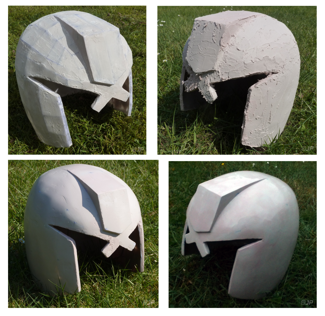

Part 3: Polyester Putty and sanding
Now to the longest part of the whole build: Puttying and sanding of the helmet. Over and over and over again.
Many refer to this step naming it the "Sanding Hell". Considering this was a Dredd build"The Long Walk" sounds more appropriate.

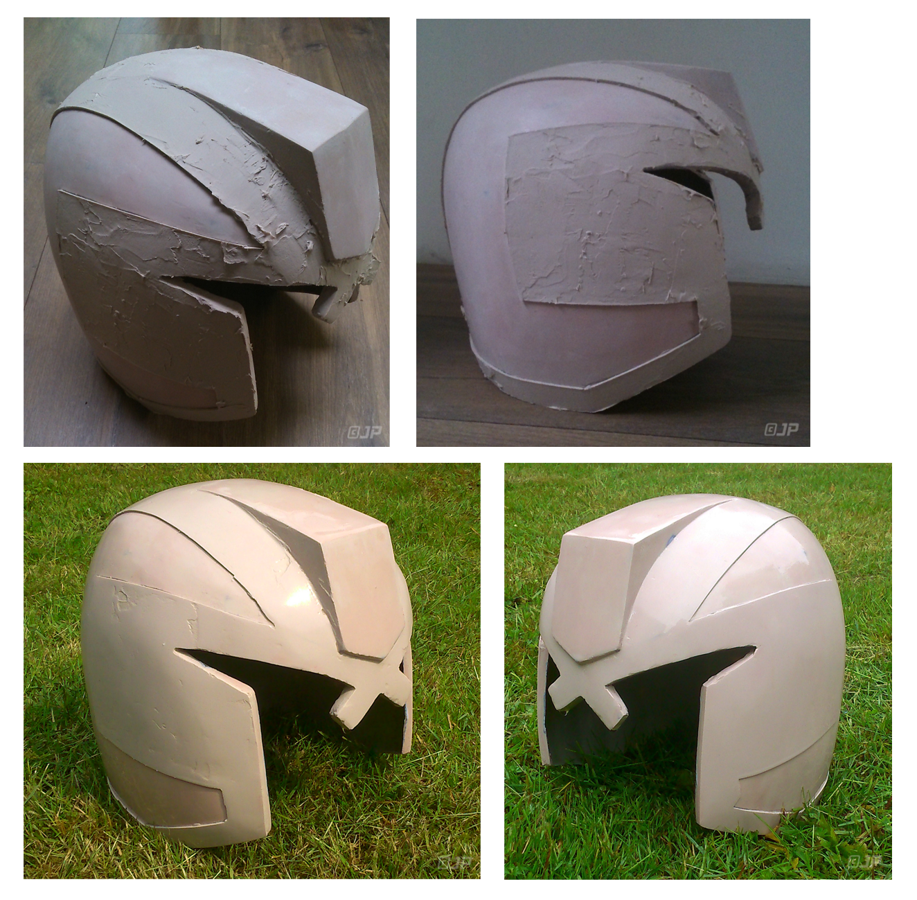

In order to get rid of the polygon shapes of the pepakura model you will need to apply putty. Bondo is the magical term outside of Europe to use in this step. In the Netherlands I could not find any bondo and had to look for alternatives which was not that hard. I'll update the thread later with the materials I used. Mix the putty and apply it in thin layers to the helmet, let it cure and sand it down.
Putty, Sand, Repeat:That's the bottom line.
Eventually you will need less and less putty and use finer grid paper. This helmet took at least 5or 6 layers and in the final steps it came down to wet sanding with 1000grid and 1200grid paper.
Note:
1. The more putty you use the more you will have to sand down again.
2. Start with rough grid paper (for example: 120grid) and gradually work your way up to finer grid paper (400grid).
3. A sanding block made out of cork will help even the pressure during sanding. If you use just your hands you will get more local pressure at your finger tips through the paper.
4. When sending you will eventually reach the top parts of the pepakura model. This is a good indicator to start putty again if the surface isn't smooth enough.

Part 5: Sanding again...
I used a dremel tool to cut a small line between the raised areas at the front side of the helmet.(see the bottom right previous picture and compare it with the top left of the picture below). Apart from that the edges of the raised areas were rounded to make the transition more natural. The helmet was still not smooth enough thus that meant:
Putty, Sand, Repeat.

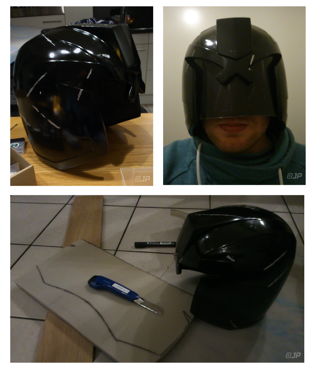

Finally the helmet was smooth enough but after close inspection some spots were still cracked/rough. By applying local putty to those spots this could be fixed quite easily. Next was the battle damage step: using a dremel tool with grinding disk cuts were made. Screen reference pictures were used to get the damage in the same spots. (as good as possible of course).
After that the helmet was rinsed with a mixture of St. Marc (will add info later) and water to degrease the surface. After degreasing water was used to rinse again. The first coat was a primer using a spray can followed by metallic aluminium spray paint.(I'll add info later -> standard construction market spray paint).
Note:
I found some tutorials that used Vaseline between spray layers. If you spray a different color after applying Vaseline to certain areas the paint will not adhere to those areas. After the paint is dry you can wipe the Vaseline away and see the underlying color -> aluminium in this case.
I tried it on the scratches and sprayed a new black coat on top of it. While removing the Vaseline too much paint came off. For weathering Vaseline is perfect but for scratches it turned out to be not that good.
So I re-sprayed a black coat (without Vaseline in between) and used some toothpicks to scratch away the black paint before it would fully dry.

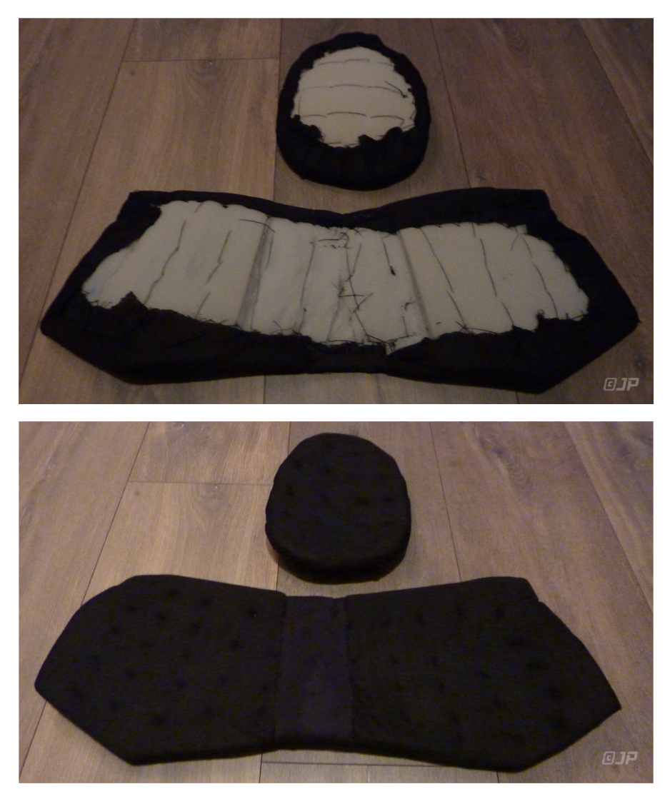

In the picture below you can see how I stitched some black stretch fabric to the inside foam padding. Just to make it look better.
Some old black T-shirts would also work as donor material.

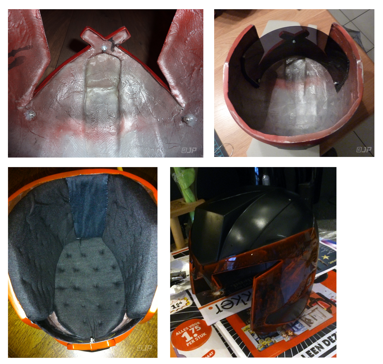

A good way to attach the visor into the helmet was already given here on the forum. And I decided to do the same. Using a glue gun some nicely cut to size bolts were glued into the helmet. This makes it also easy to exchange the visor if it gets damaged during field duty. The padding was simply put in place using double sided tape.
In the bottom right figure you will see one of the black acrylic washes I applied to the helmet in order to weather it. The wash was made by mixing black acrylic paint with a lot of water. Just coat the helmet with it and wipe of the excess leaving just enough on it as seen fit. Repeat this until you are satisfied with the degree of weathering.

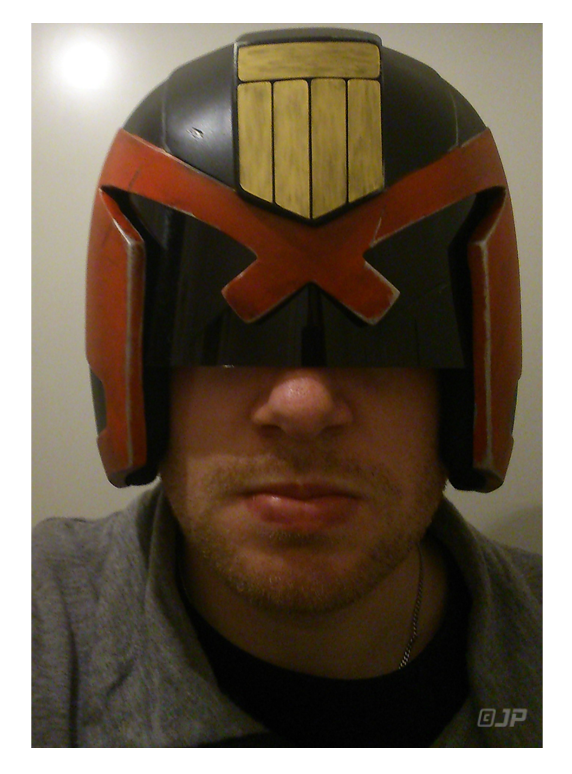

Finally I spray-painted two layers of clear-coat on the helmet to seal in all the weathering that was done. Here is the end result.
I hope my Long Walk will give you some inspiration and maybe some tips while building your own Dredd helmet.
