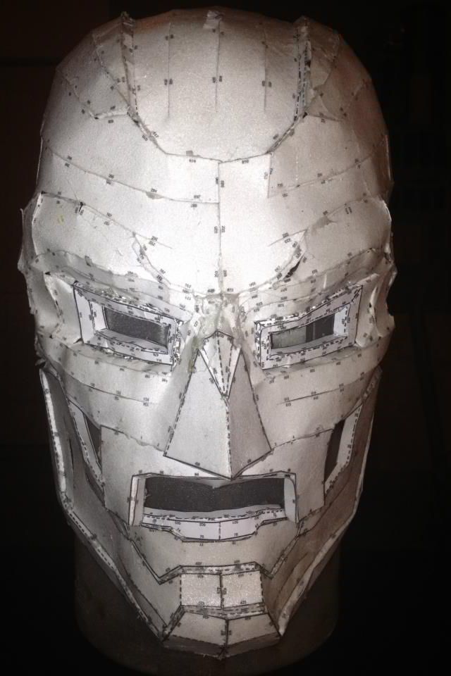

Man I had started this same helmet as my first pep and it was amazing till I fiberglassed the inside it went terribly wrong if you don't mind me asking how did you go about laying your cloth in around the face and nose area tight like that because I'm loving the way yours is coming together and trust me I know all about cutting this sucker out folding and glueing so kudos for getting done with that and the putty seems to work very nice great work so far
This was my helmet
Pepakura Prep
This was my helmet
Pepakura Prep
Thanks for asking. What I did was spray into the nooks and crannies with a cheap can of spray adhesive that I picked up at Fred's Store (like a dollar store). I had small strips that were slightly fitted to the areas that I was placing them and pressed the fiber cloth until the adhesive held it tight. I repeated this until all the areas were adequately covered. I then poured my mixed resin and hardener in the face and worked it around with a brush, making sure not to pour an excessive amount in. Worked pretty well I thought. One thing I noticed was that it looks like you applied resin to the inside before you coated the outside a couple times. From what I have been told, the resin shrinks as it dries up and cures. I would say that is what happened to the eye area. If you apply to the outside first, it shrinks up a little bit, but doesn't distort your paper. I haven't been doing this long at all....(first ever build)...and I don't want to step out of line by offering up advice being a newbie and all, but try that way if you are unable to repair your helmet. I have had great advice from my coworker BSD along the way so that has helped me alot. Any other questions about doing your version of the Doom helmet, just ask and I will try my best to help.

Here is something funny to look at. Before I had committed to even starting a pepakura build I was playing around with regular printer paper and built a Dr. Doom. Far cry from a pep build, but fun none the less. paper and tape and lots of smiles.
