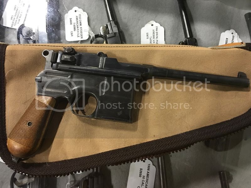

Hello all, I really don't mean to brag about this but, I'm going to anyway! Look what I just picked up today at the Gun Show in sunny Costa Mesa CA. and I'm sure you all have a pretty good idea what I'm going to do with it and who I'm going to ask to help me with customizing the certain upper business end of it too!? This has turned out to be quite an amazing day for me!! Isn't she a real beauty?
^^ I am simultaneously excited for the find and sad about the destruction to come. But mostly excited! :D
http://i34.photobucket.com/albums/d...B-A6C5-4A93-AF3D-BA1E52FD3D43_zpsdszw3iwq.jpg
http://i34.photobucket.com/albums/d...F-9F74-4AFE-95BD-EBB8D32F0512_zpsazzkrjwy.jpg
Thanks, congrats on your score Tomm! I myself still don't have an MGC of my own yet, which is quite strange that it's so much easier to get your hands on a real Mauser than it is to get an MGC nowadays!? I thought I'd surely own an MGC way before ever being able to afford a decent looking real Broomhandle!?!? A real one is still a little more $$$$ but, not too far off from what sellers are asking for an MGC, I just got lucky I guess....
Sorry to get off topic, my bad!
I'm sorry, mistook yours for a MGC, even better to score a real Mauser (alot better). Sorry for thread hijack, back on topic, super cool of Dave stepping in to help out with the broken mount!

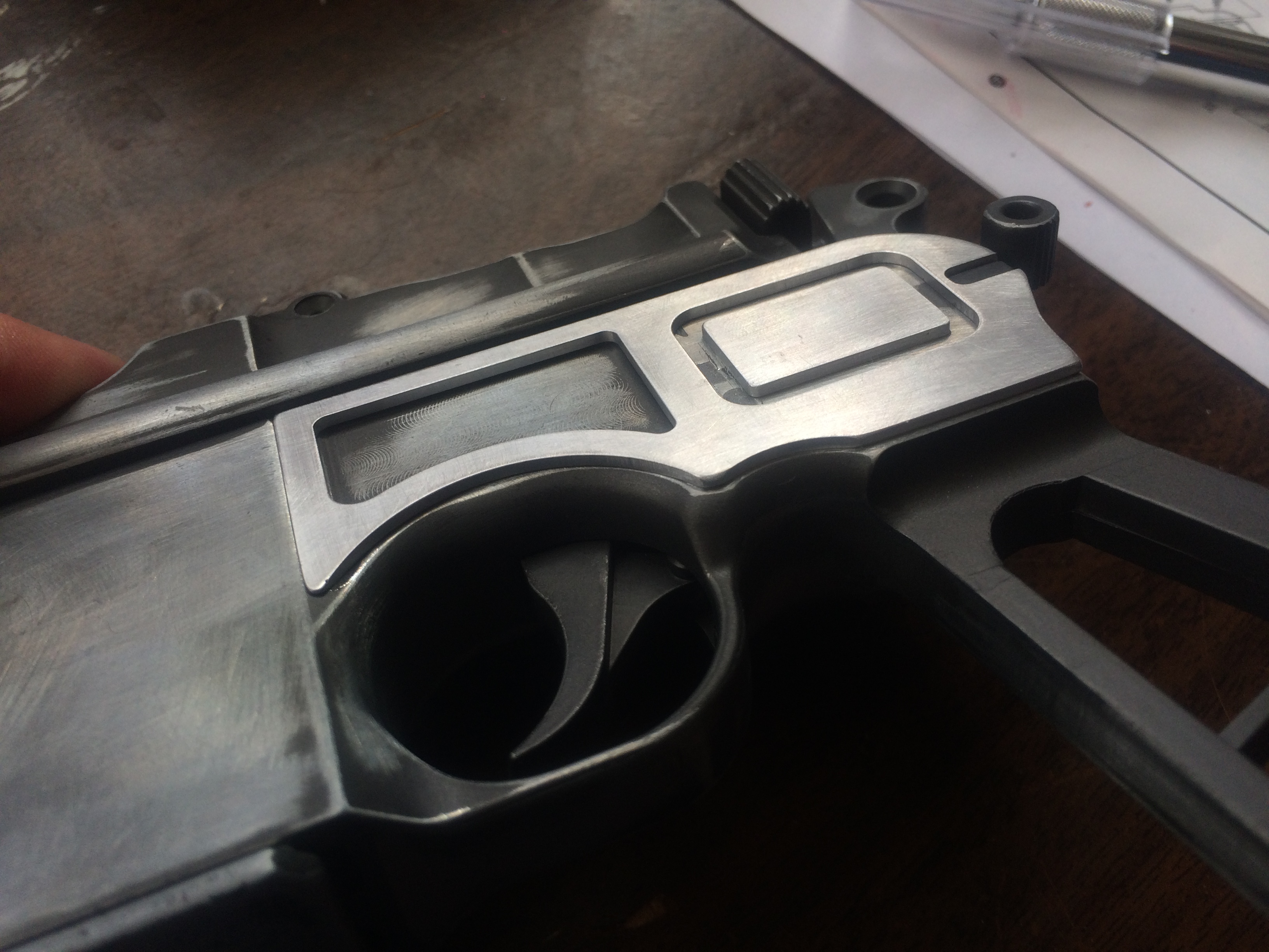

Got my aluminum side plates glued on, had to sand the edges a bit so they didn't cut or dig into my hand when holding, but all good now! I only stripped enough paint for the areas that I know will have metal showing through the new paint layer.

If you want smoother edges you can use steel filled epoxy to fill the small seams and edges if you want. the steel fill will bluing too. Test it and see if it works for you.
Looks great !

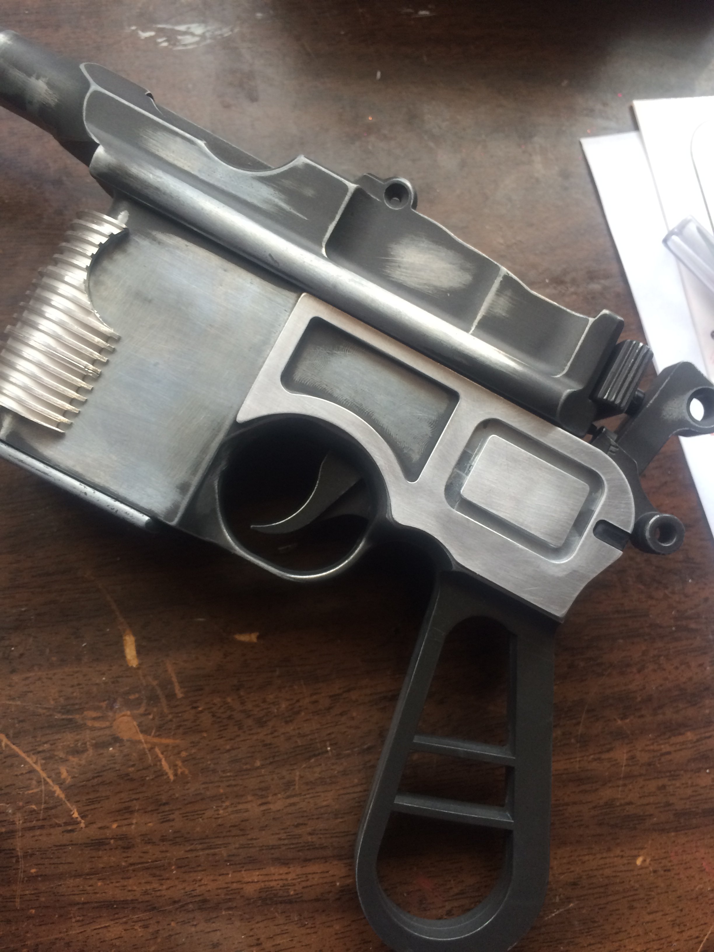

Looks great !

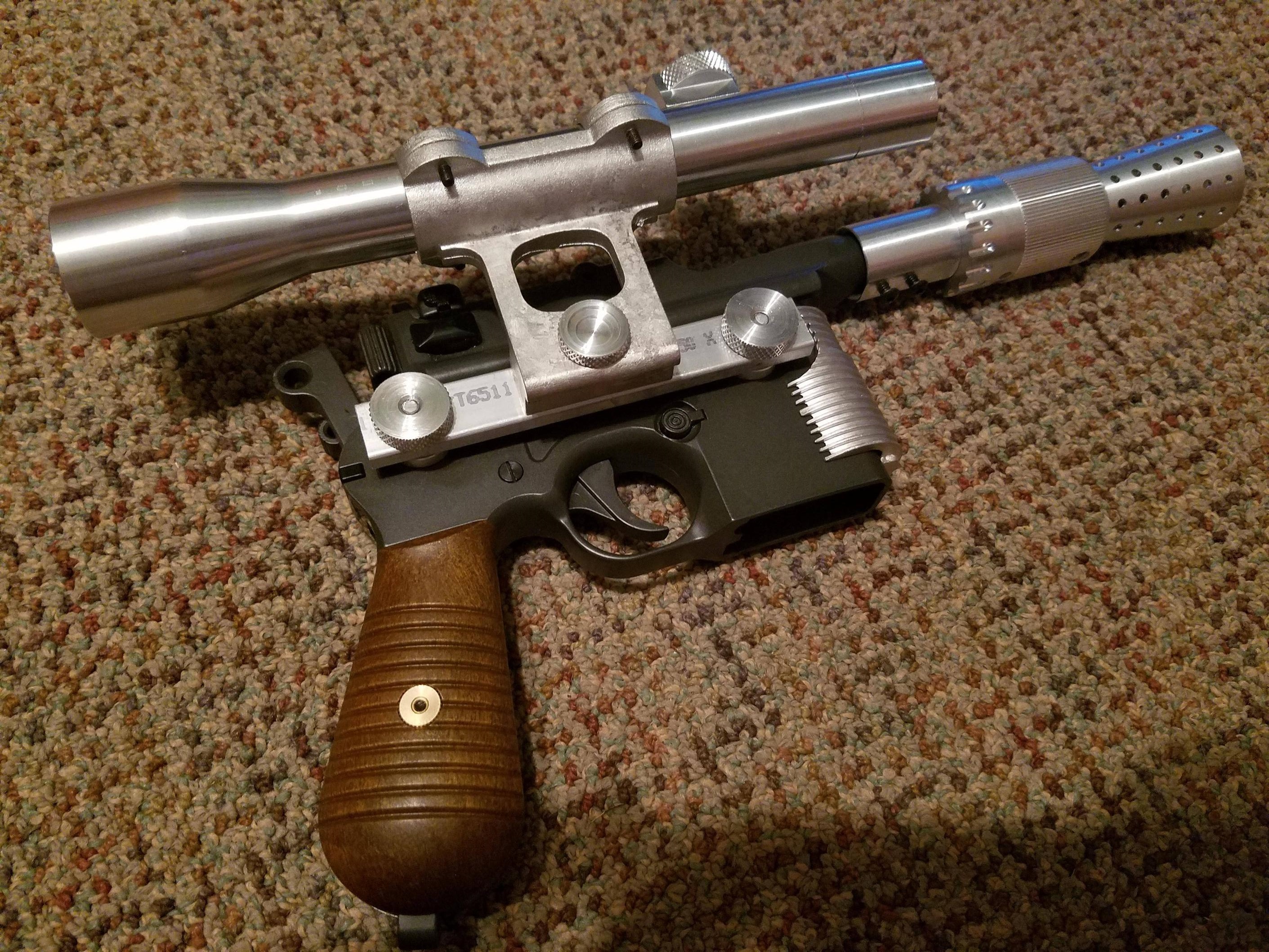

First rough fit, still gotta do more sanding. Aside from the part where I drilled the bolt holes just a smidge crocked, I'm really happy with it purely because swinging it around and making blaster noises makes me feel like a kid again. So thanks a million for doing another run, Dmac.
To move to questions, I know there's the two camps of painting and bluing and I think I'm gonna join the painting camp. I scanned back through the run and I may have missed it, but what kind of paint am I going to need?
