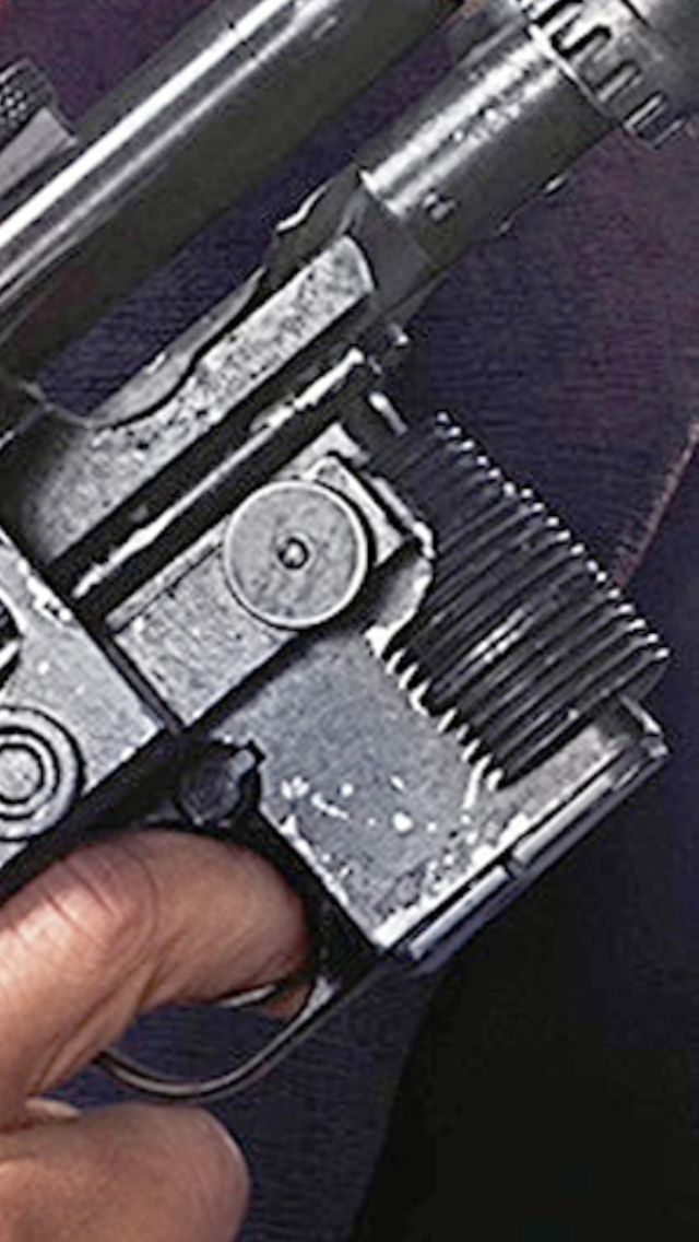

I realize this is super picky, but is there a reason the grill was not cast with the beveled edges on the ribs like we see in the Wired image? Your grill has a flat edge. I suppose this could be corrected with a file, but it would be quite a bit of work.

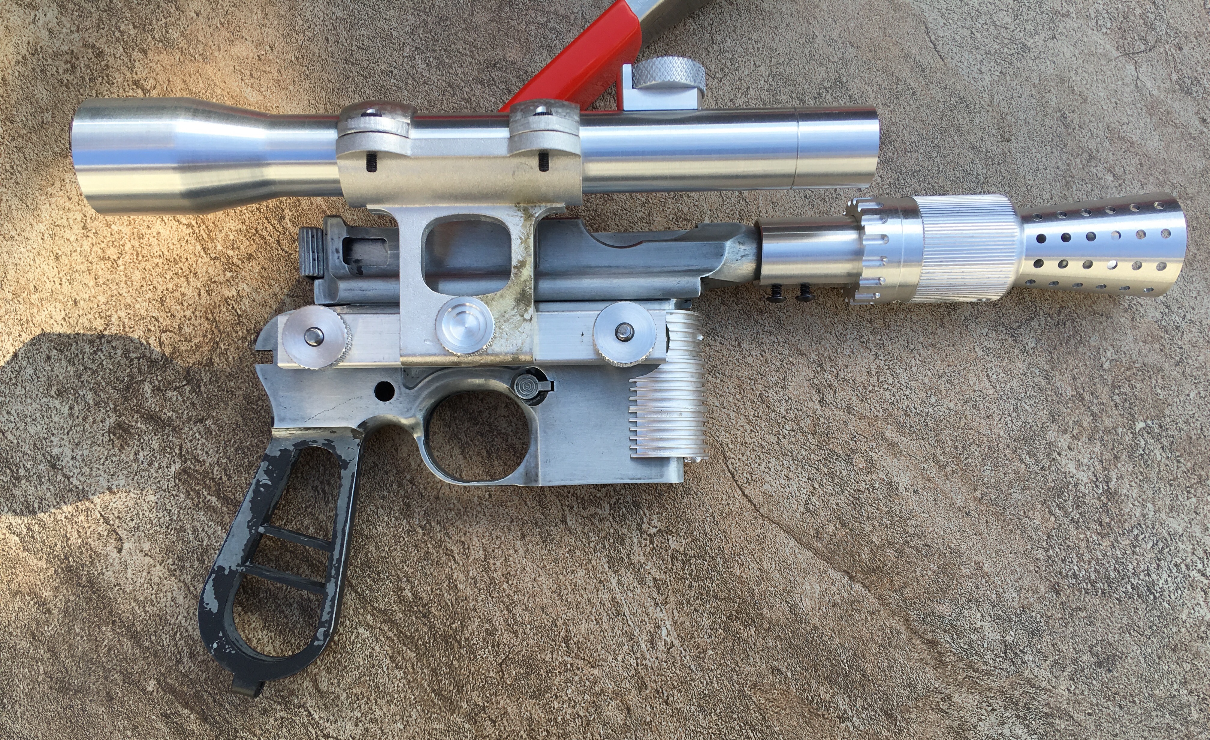

I am doing further hand sanding to try to get as much exposed aluminum as possible. There are a few spots where the paint seems to be deeper in the metal, or is in a crevice and it is a challenge to get to.
The alu black will show up any spots where the paint is left really clearly as a ugly grey color , and those spots are likely to in places where the gun should not be worn at all ( totally black from the blueing) belive me i found out by trial and error ;)
so just take the time and get it all clean
This kit is not made from the Wired one, that one looks too pointy this kit is made as close as possible to what was shown in the movie.
There are a few thousandths of an inch taper on the fins but the "hero" shot looks pretty flat to me.
This shot from rom the poster looks pretty beveled to me, but yeah it's not entirely clear. Either way, I still love the kit!

I finally gave up on the paint strippers. Nothing was working. I even tried burning it off with a propane torch, and it didn't even phase it.
I went to Harbor Freight and picked up a cheap abrasive blaster kit, and used 3 boxes of baking soda. It took it right off. Only took about half an hour to do the entire gun. I highly recommend it. The baking soda is strong enough to remove the paint, but it won't damage the metal at all.

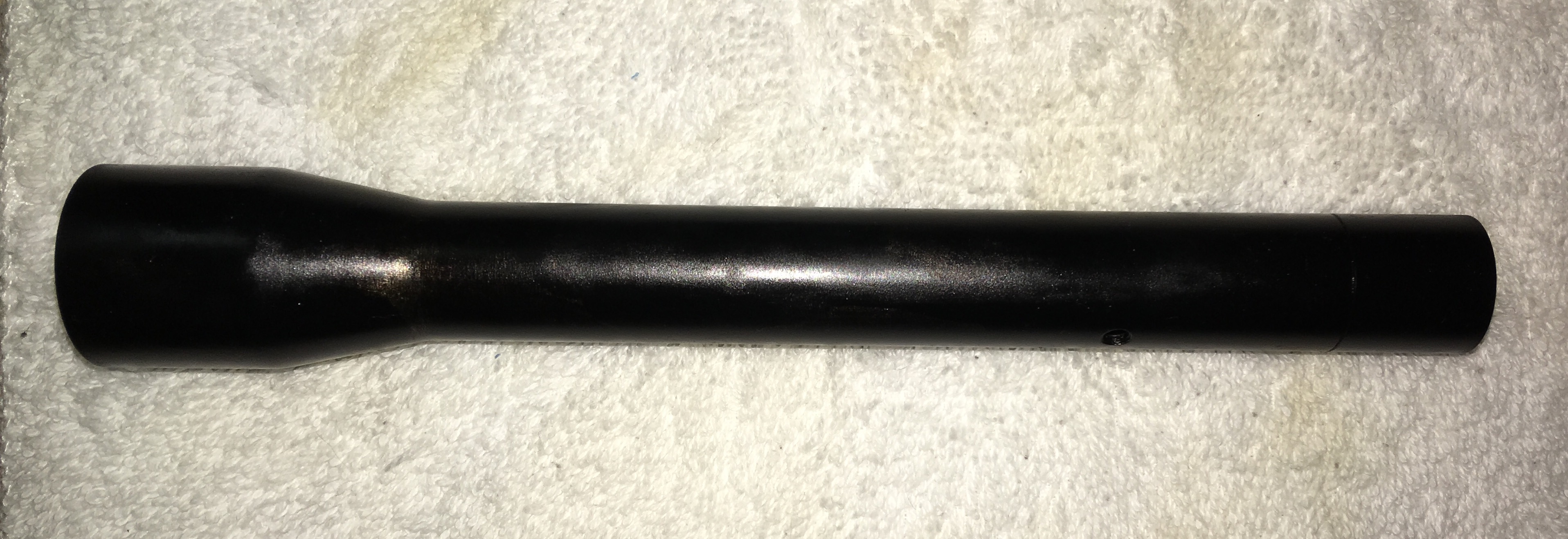

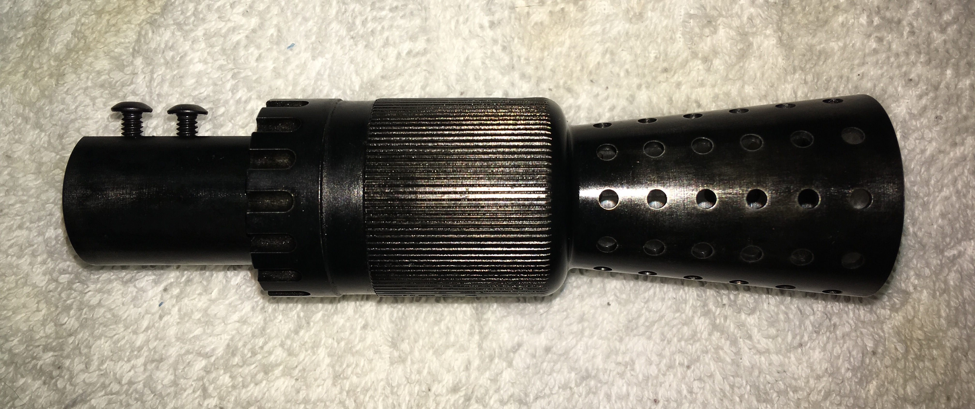

My original plan was to use Aluminum Black on everything, but I am not sure if it will blend with the plastic piece mounted on the side. Does anyone have any suggestions? If not, then I think that I will paint the main pieces of the gun.
fabricate a new square piece out of aluminum
Aluminum Black on the flash hider and the scope. I am going to eventually take some steel wool to the flash hider and take some of the black down.
