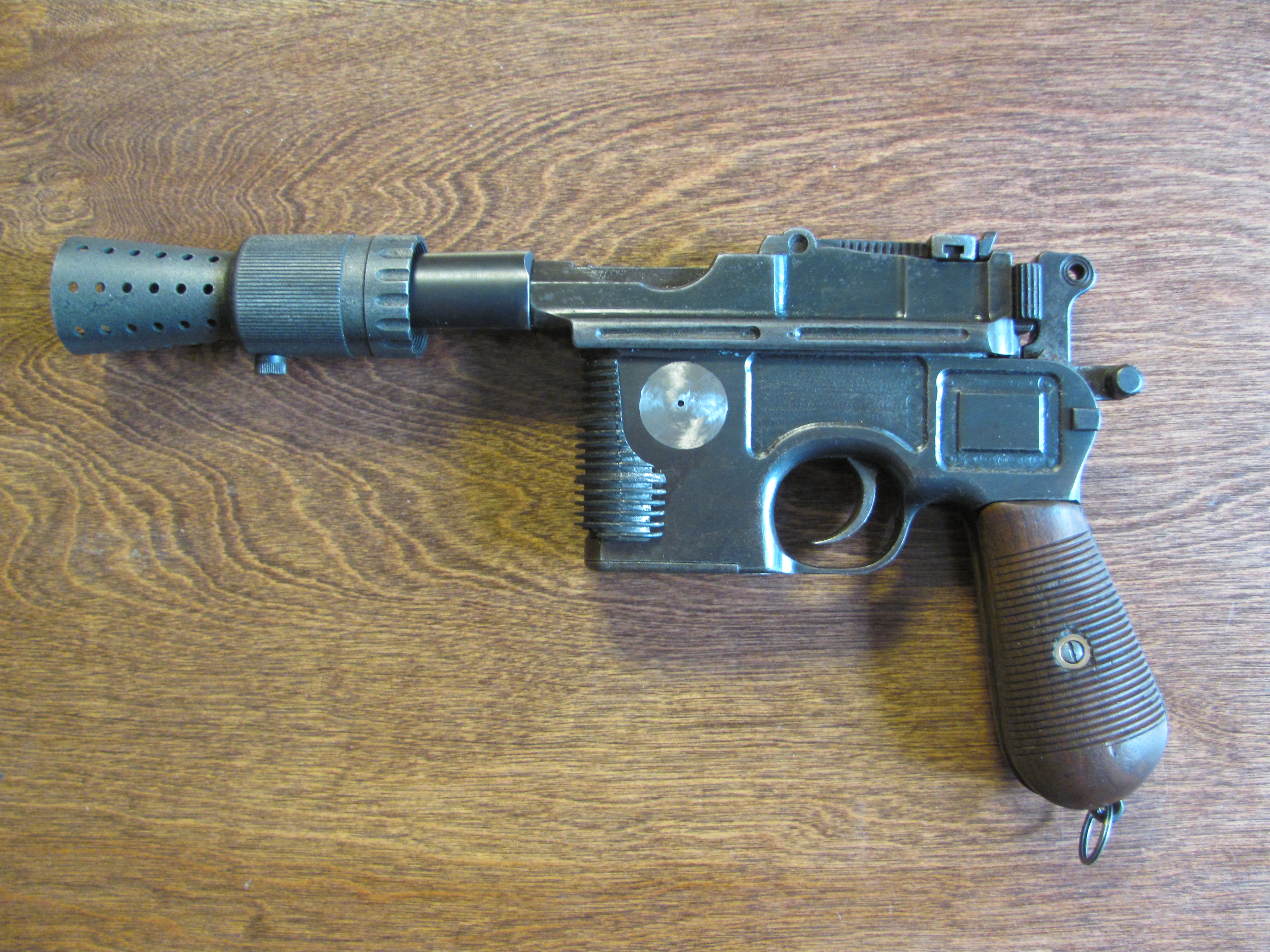

What are some suggestions for making the mystery disc? I was thinking about taping off the area and chemically stripping but I am afraid the stripping agent might get under the masked area. . Also I was thinking about a 1" grinding wheel or polishing wheel on a drill press with the frame secured to the platform on the press.
What have you guys used with success? I would like to not have to reblue or mess with the original finish. I just want the remove the finish where the circle needs to be.

I stripped the finish for the mystery disc.
I also got the sight done. These are the aluminum parts from DEC. I went with little magnets in the base to temporarily mount for display and then remove for shooting.

I have gotten as far as I can until I get the scope and scope mount. Hopefully I will get them in the next couple weeks, but we shall see. I will put the plastic grill on for live shooting but the metal looks a lot better so I will probably use it for display. Also the sight is removable with the magnets so here is a picture with and without the sight.
