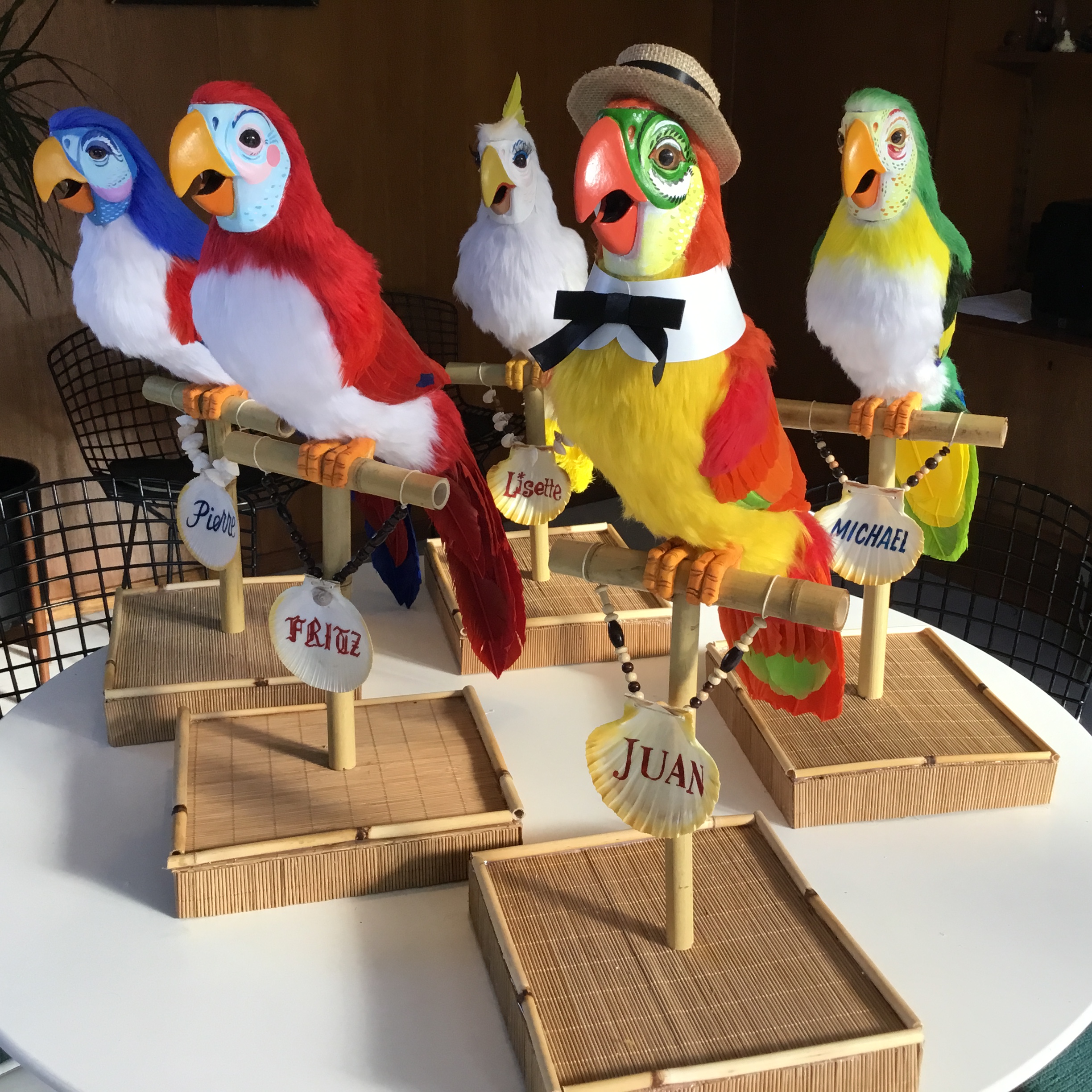

Fritz, Jose, Pierre, Michael and the Orange Barker Bird all have their heads firmly attached (epoxied) to their shoulders!
Sorry to say I'm not planning on doing a run because there was 0 thought put into engineering these. The heads don't fit the bodies well, drilling out the holes for the leg pegs is really difficult, and the wings are just sort of glued into place by eye. And speaking of eyes, I didn't account for shrinkage when carving the heads, so the eye sockets all have to be dremmeled out before placing the eyes. Very frustrating!
Also my casting skills are amateurish, so there are huge gross bubbles ALL over these castings. Luckily most of them are hidden by fur and feathers - but it's really not the kind of thing I could charge money for and feel good about myself.

Jose, Pierre and Fritz received feathers over the long weekend.

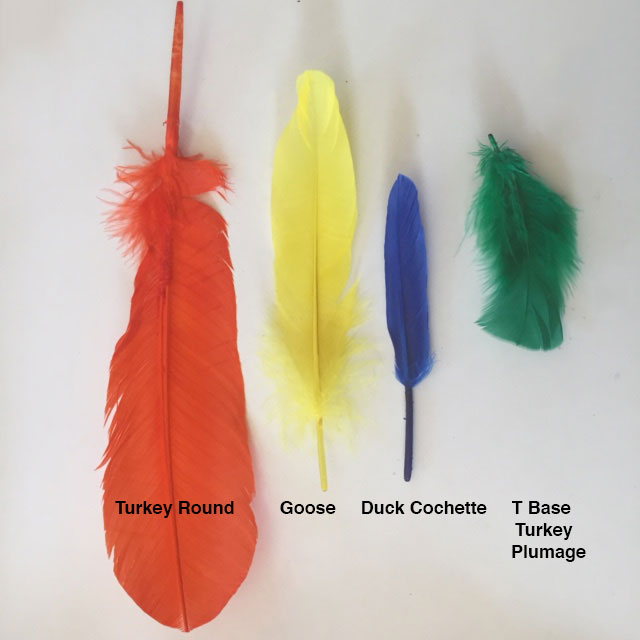

Here's what was used:
The original birds used goose feathers on the wings, but ...
Back in the day feather suppliers would rip the feathers off of young geese, resulting in smaller feathers.
They don't do that in 2017. Now they use "fallen feathers", resulting in a much larger feather.
Duck cochettes are substituted instead.
Before you apply the feather, they have to be trimmed and sorted by left and right side.
Consider the "More feather" part of the feather the top when gluing it to the wing.
At the top of the wing, the "shoulder," you find a fluffy feather with a fan shaped tip. This is called "Turkey T Base" plumage. The fluff transitions nicely from the fur to the feathers.
The tails are made of "Turkey rounds." A few birds. like Jose, also have long pheasant feathers, and are further decorated with cochettes, goose feathers and T-base plumage.
