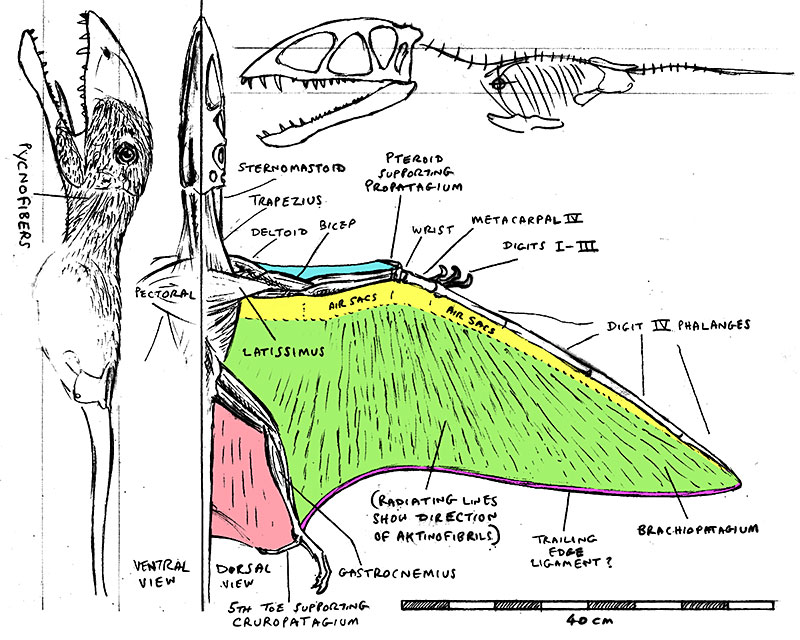

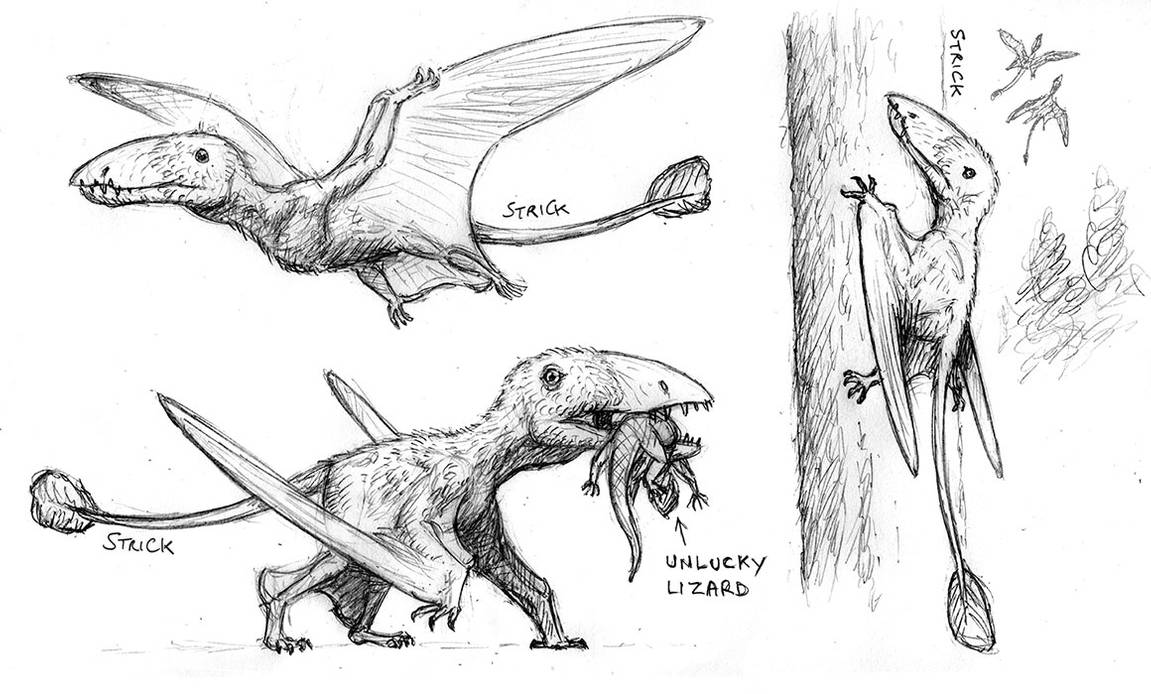

Made a sketch to use as a sculpting overlay, couldn't resist adding a few labels and annotations. Not sure about the air-sacs behind the arm (in yellow), they are known (or believed to be likely) from later larger pterosaurs so I've added them more as indicator than intent. I doubt they would be visible externally so they won't influence the sculpting.

Thanks, the plan is to do a walking and (at least one) flying version. Some think that Dimorphodon was also well adapted for tree-climbing so I might also try one in a vertical posture to hang on the side of my printer :D.
Found a little time today to run up some pose concepts.

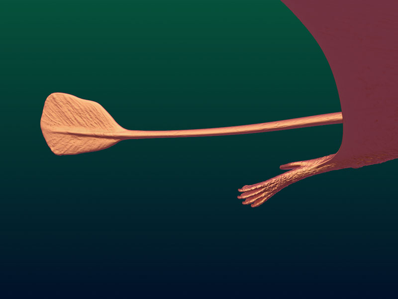

Spent a couple of hours this morning with detailing (mainly carving out pycnofibers). It's mostly done but needs a bit of muscle definition here and there. In reality the fibres were more fluffy than bristly but this will be a small scale solid model so fine details need a bit of exaggeration.

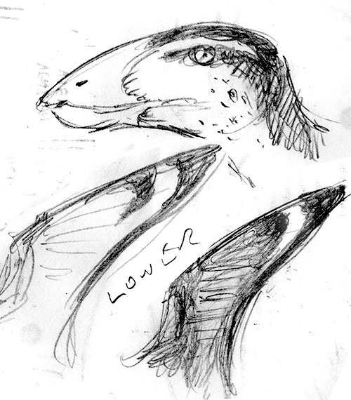

One thing though, I think that the nostril might a bit too low and forward. Looking at other pics of dimo they seem to place the nostril further up and back. But I guess that there's a certain amount of artist's interpretation to that since I don't believe that the exact placement of the nostril is evident in the skull structure.
Yeah it's a tricky one, as with many pterosaurs, Dimorphodon merged its nasal and antorbital openings into a large nasoantorbital fenestra so there's a pretty big area in which the nostril could be situated. I've gone with the fairly current view (Witmer 2001) which suggests that nostril position in most archosaurs and diapsids (which includes pterosaurs) is quite low and forward in the opening, there's also a good modern paleoart example here.

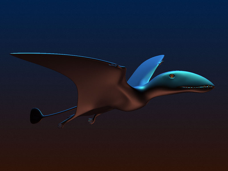

Going to produce a 3D print of the Dimorphodon in this flying pose. As I mentioned in the previous post I'm no longer doing a walking version now that science has overtaken the model as I made it. Should get the sculpting done this weekend. Saturday afternoon is quiet time. No idea yet how well this is going to work as a 3D print or what it will cost to order from Shapeways. Just going to go ahead with it and see what happens.
Added some details last couple of evenings. Going to leave it at this and fix up a 3d print version.

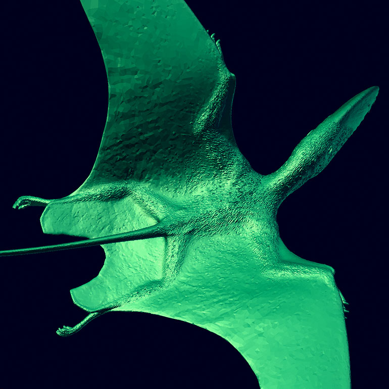

Under & upper side views. Lightly indicated actinofibrils on outer wing and pycnofibers on arms, torso & legs.
That looks really good. It also addresses one of the things that was kind of bothering me was that there wasn't the usual delineation between where the pycnofibres start and end on the head. But now that you've textured it out I can see that it's there. Very nice!

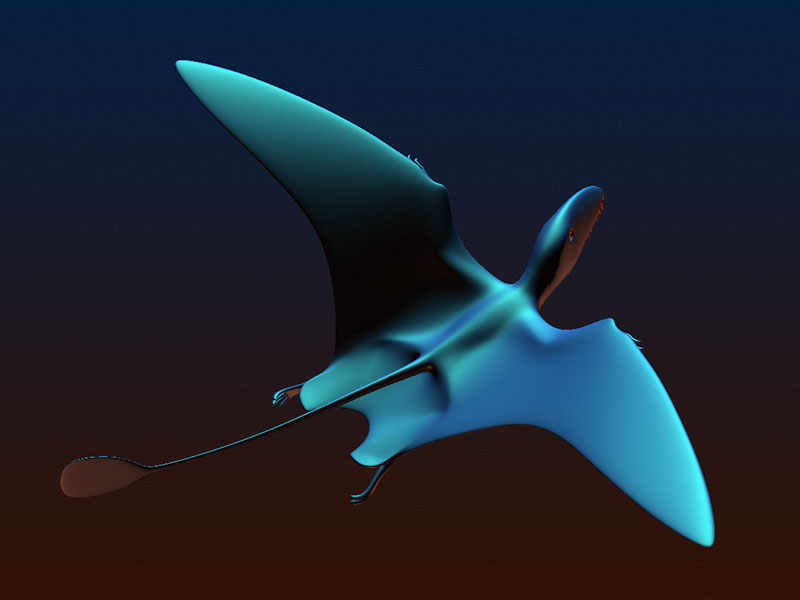

I've applied the slightly curving flying pose to the sculpted model and I'm well into the process of converting for 3D print. Having a few issues getting the 3D mesh compliant but I'll overcome them. Some finer details get lost in the transition but it's a fair trade-off for small scale models. Hopefully I'll get a print ordered this week, currently I'm thinking 1/4th, 1/6th and 1/10th scale. I might prepare a graphic to show the sizes.
