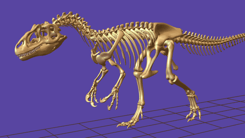

A couple of months ago I dragged an old project from backup. I had the animated Allosaurus skeleton on a real-time 3D website iin 2017 but I had to close my account when someone alerted me that people were stealing my work.
Anyway I brought it back as a Youtube video, it was a neat way to make a public record of an old project.
There's a few things wrong with it and if I ever re-visit it there'd have to be a few revisions. I'd love to build a real motorised version of the walking skeleton, pretty sure it's do-able if I ever found the time to work it out.

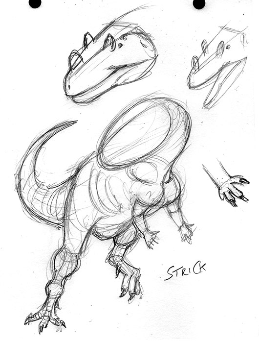

Been away from arty things for a while but I hope to get back on the cerato soon. Couple of sketches-

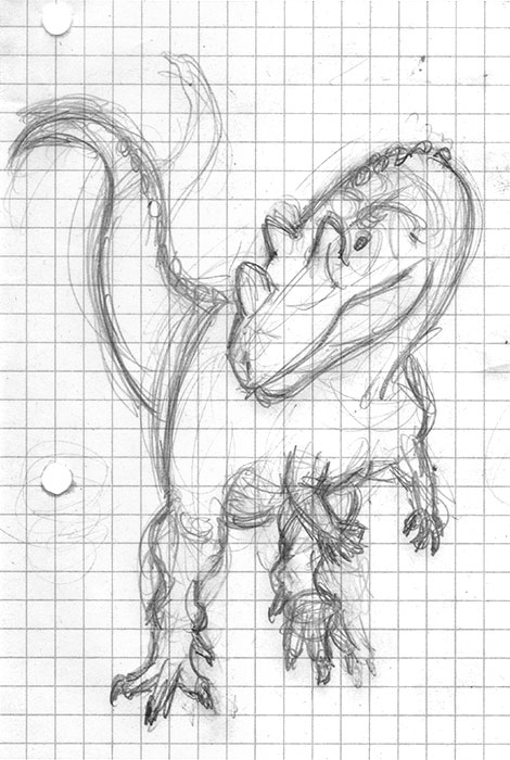

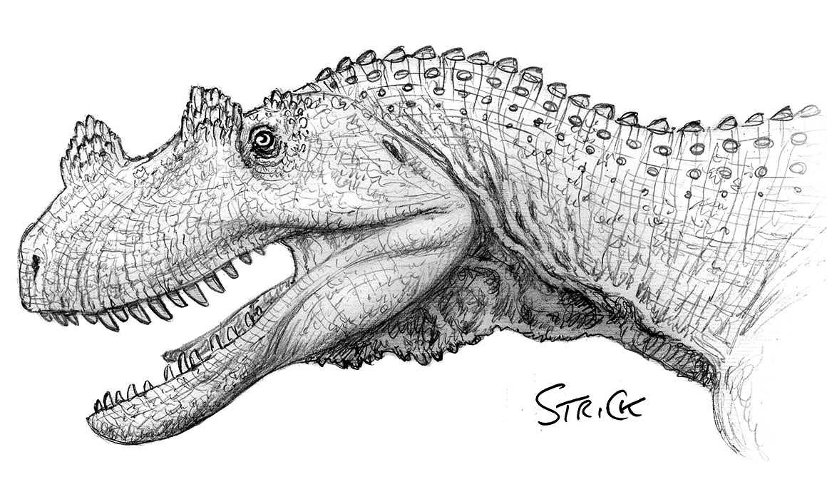

Haven't had many opportunities to do arty stuff this year, too much other stuff to do. Still need a new desktop PC at some point but I've had my scanner/printer in my old laptop so I managed to scan this the other day.
In hindsight I'm not sure if I like Ceratosaurus with this spiky/crusty look, might try something different.

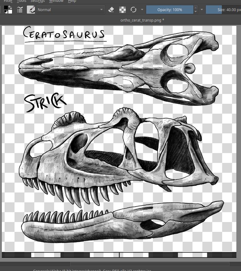

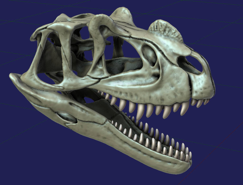

Decided to make another skull for 3D print. Mostly based on specimen MWC 1 with parts adapted from other Ceratosaurus fossils. I normally create these orthographic views traditionally with pencil and tracing paper, this time I drew it entirely digitally in Krita, traced over digitally assembled reference.
Original research paper here- https://ugspub.nr.utah.gov/publications/misc_pubs/mp-00-2.pdf

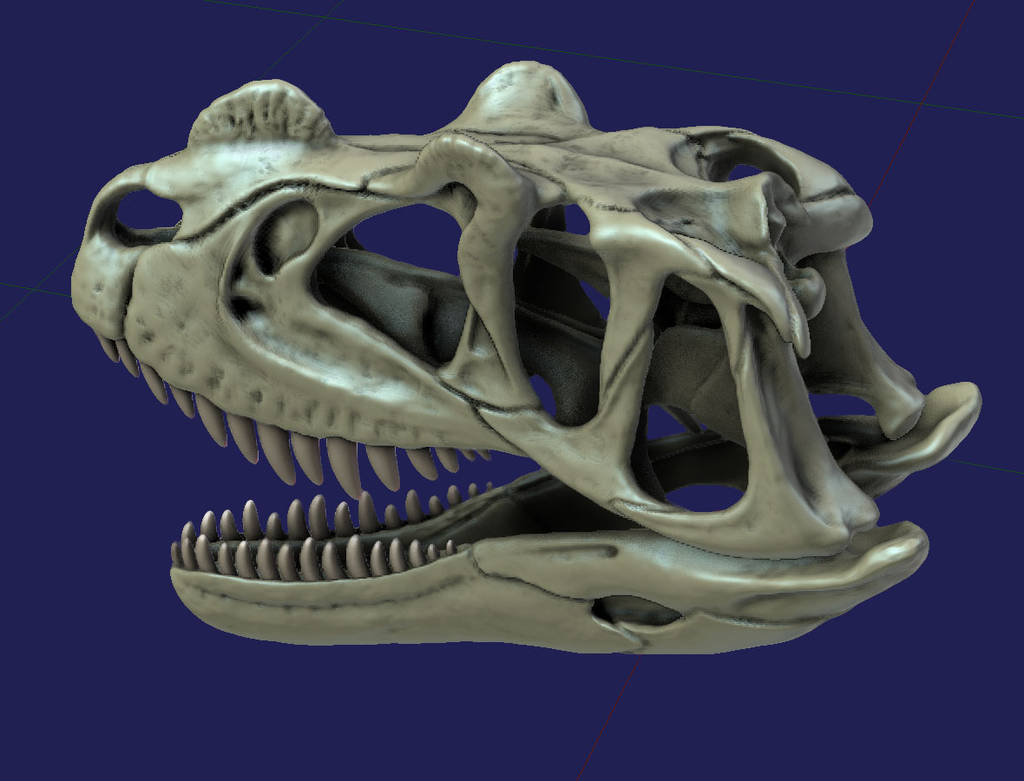

This one's been brooding in the background for too long, time to get started on the 3D model.
I'll put a few process pics up but not too many 'cause it slows me down. If anyone's interested in my methods there's a few threads on the Dinotoy Forum.

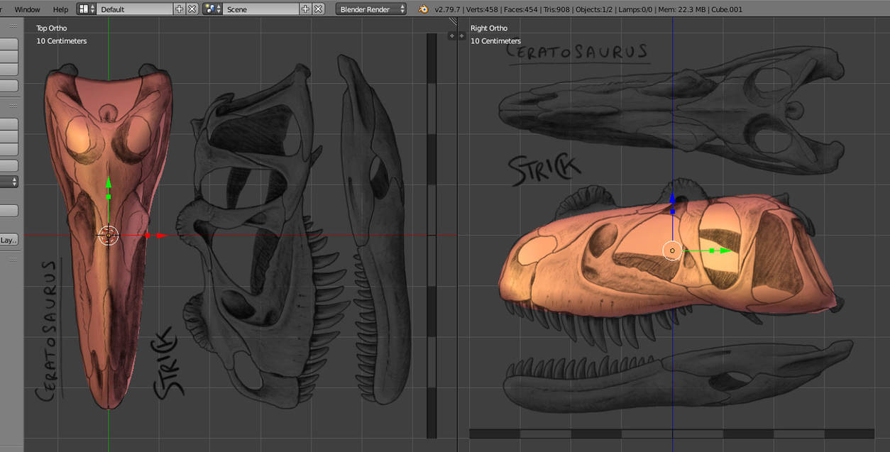

Used Krita's color-to-alpha filter to make the ortho drawing transparent for placement in Blender as a template.
tarnyloo73

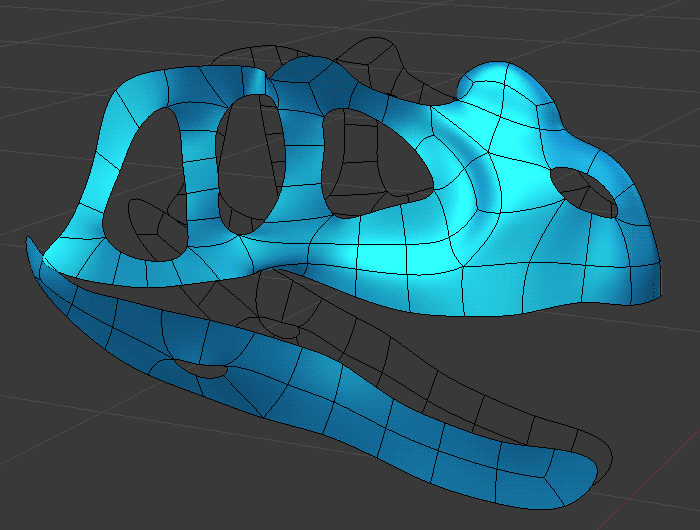

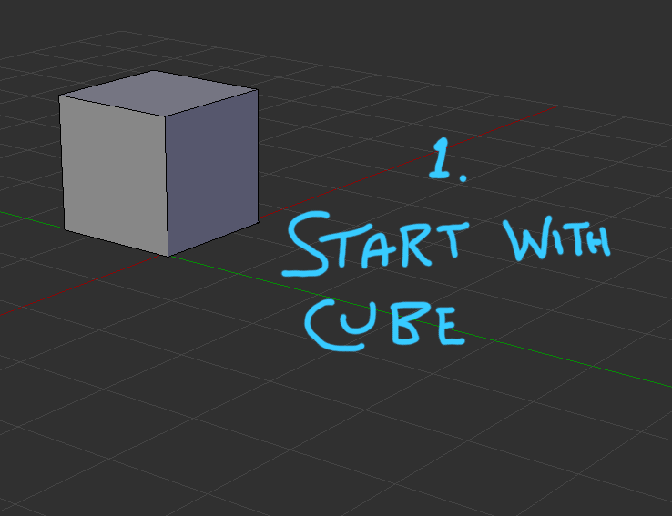

To make the skull I'm going to employ the same 3-step process I used for the Mosasaurus and the Styracosaurus, it's a bit of an odd approach but I like it.
  1. freeform a 'scaffold sculpt' to form the basic shape
  2. construct a low poly mesh over the scaffold
  3. subdivide the low poly mesh and add details

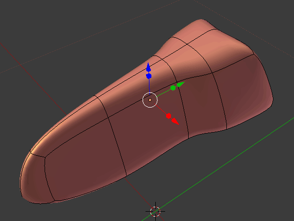

The original orthographic drawing had a 0.5 meter scalebar but I've changed it to 0.8 meter so it encloses the length of the skull. This makes it easy to set up the template images in Blender which lets you set the width of the image numerically.
Starting the scaffold by approximating the form with subdivision surfaces, this eliminates a lot of messing about push/pulling a cube or sphere into shape.

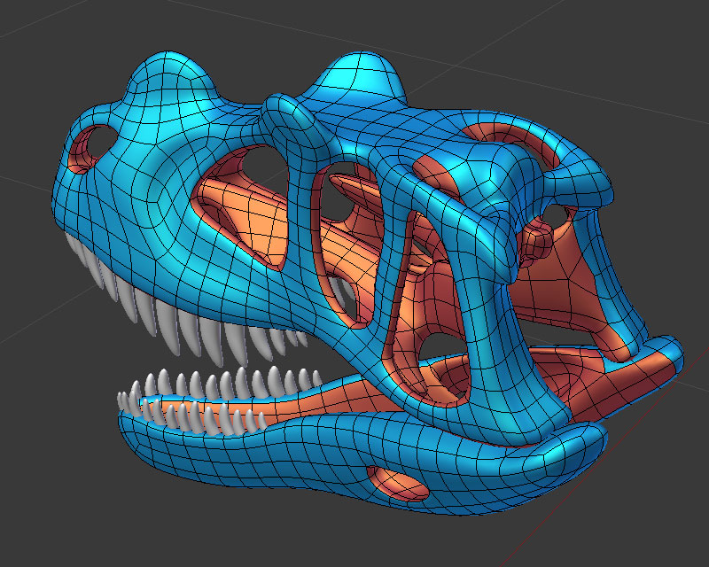

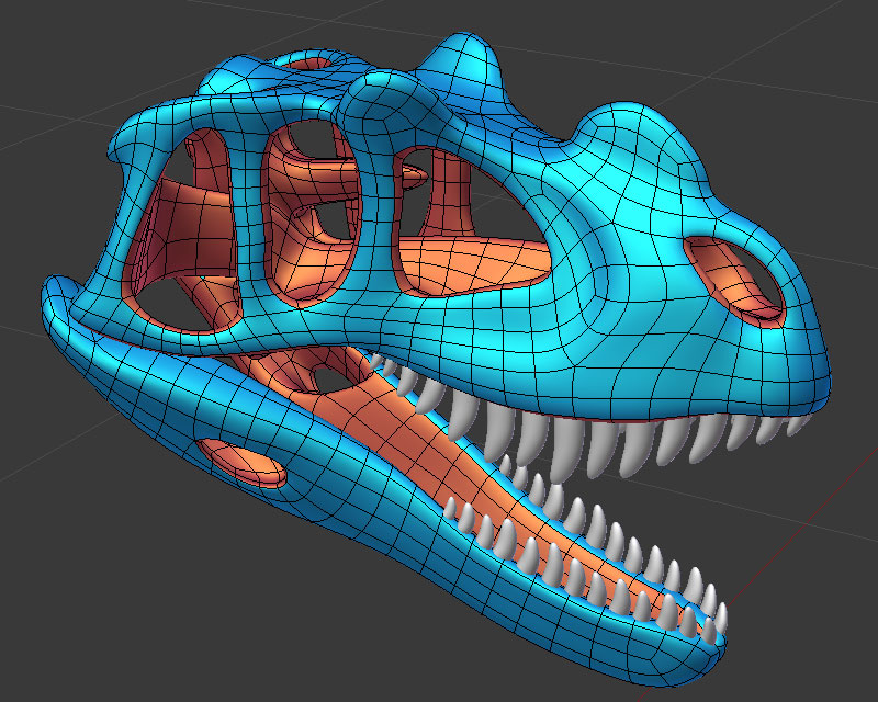

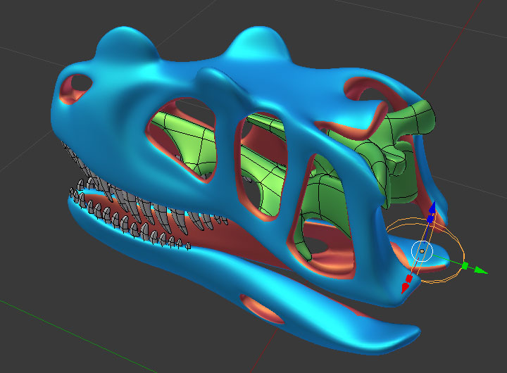

Might as well keep pushing this forward while I'm in the mood. Theropod teeth in Blender, a relaxing break from making the cranium. Apart from the profile shape the main thing is to make sure they are narrow.
The solidify modifier is my quick and easy way to add thickness to the polygon surface. Once it's applied I'll need to make a few adjustments with respect to inner structures. Also form a cranium roof.
tarnyloo73

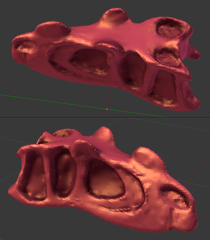

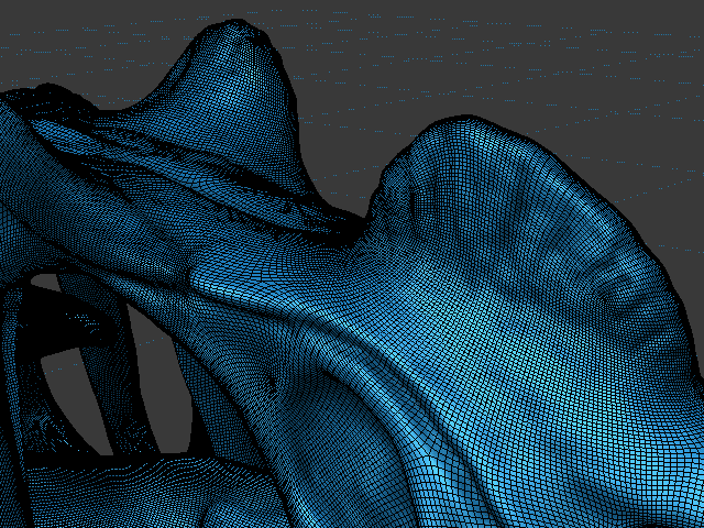

This is how the connected mesh came out

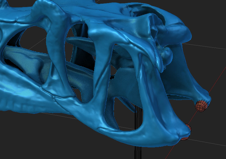

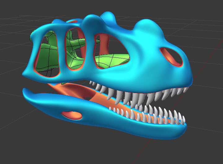

Too much happening last couple of weeks to do much with this but I managed to get back on it Wednesday night. Reckon I'm done with the sculpting part.
Now for the next stage which is making ready for 3D print, so I'll need to make-
  • poly reduced version
  • knuckle and pivot for jaw hinge
  • Jaw brace part(s) for tension fit jaw
  • cylindrical hole under brain-case area to mount stand
tarnyloo73
How do you make a poly reduced version without losing any of that wonderful detail?
Blender's decimate modifier can get a couple of million polys down to a few hundred thousand without mangling the details. I don't go too fine with details anyway as they disappear in the print.

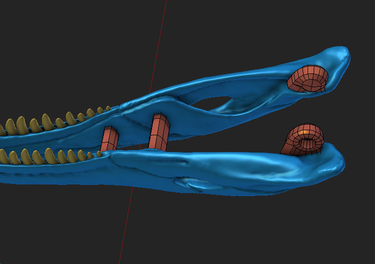

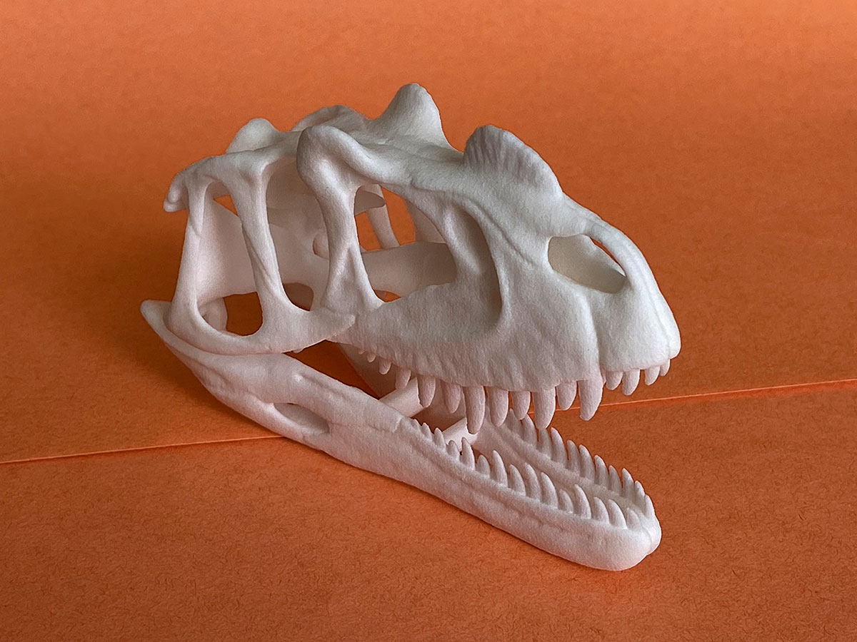

Made the parts for the print version. This is just about ready now, going to try it at these scales- 1:8, 1:10, 1:12 and 1:16.
tarnyloo73

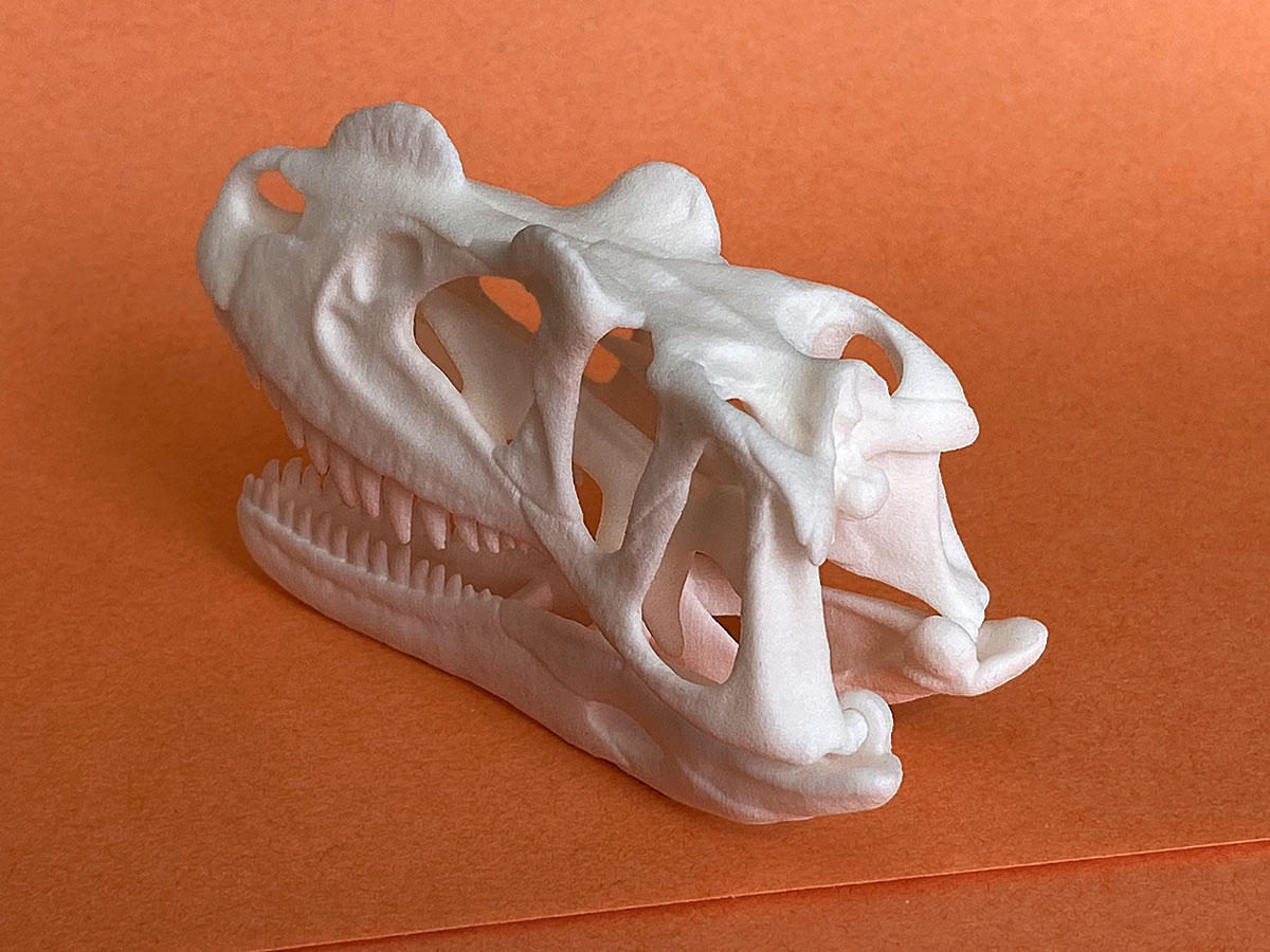

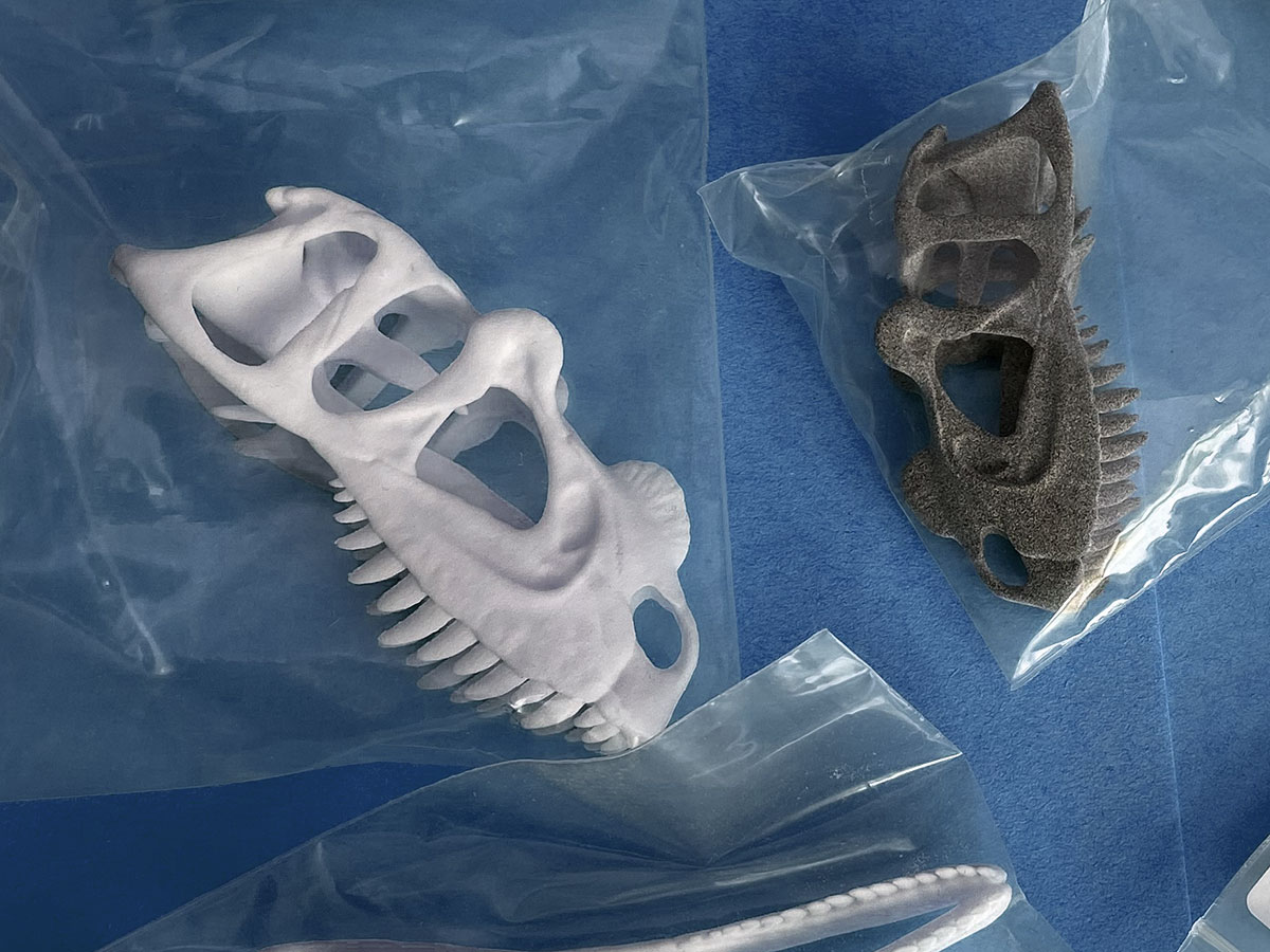

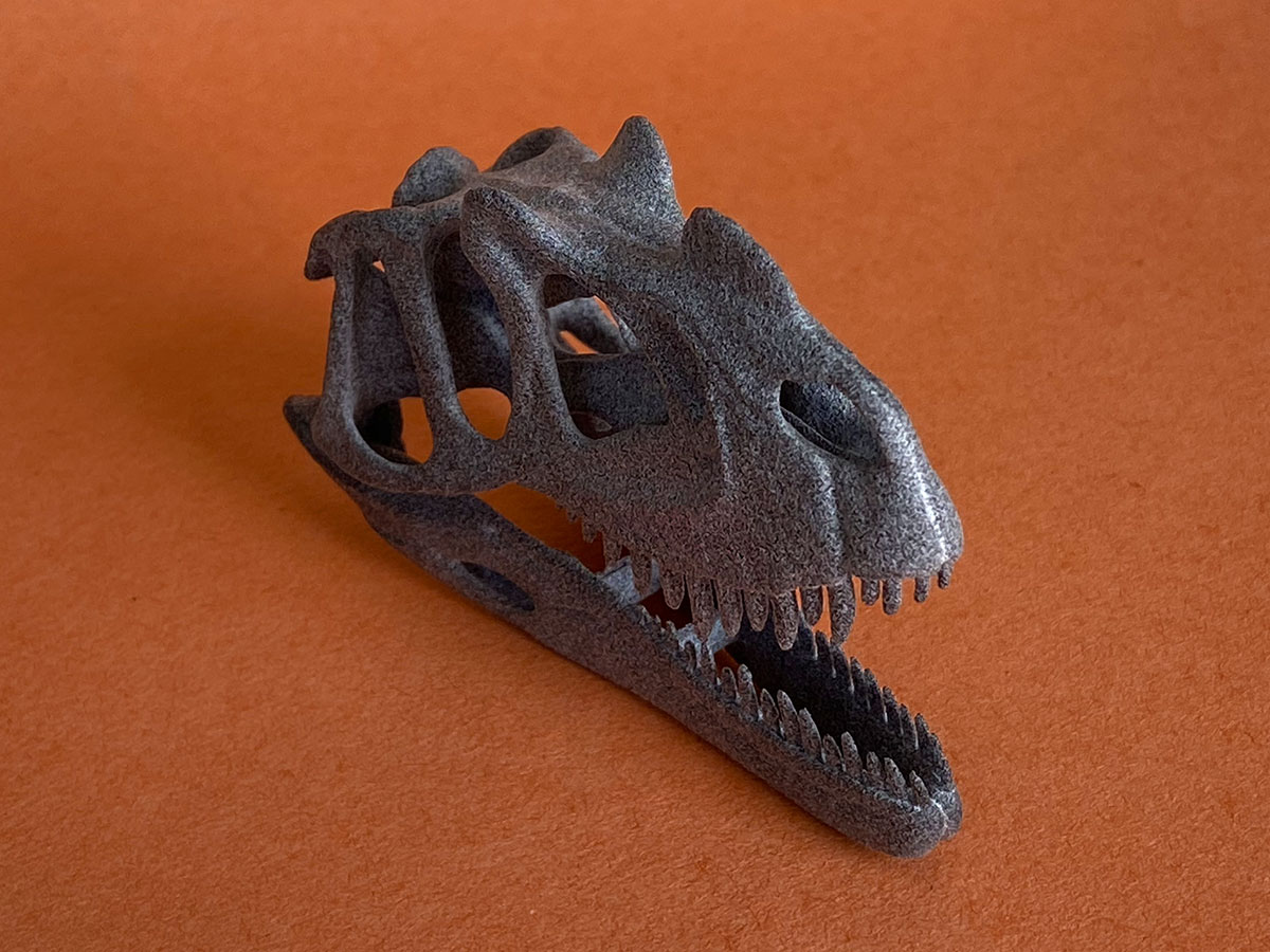

Received my Ceratosaurus skull 3D prints

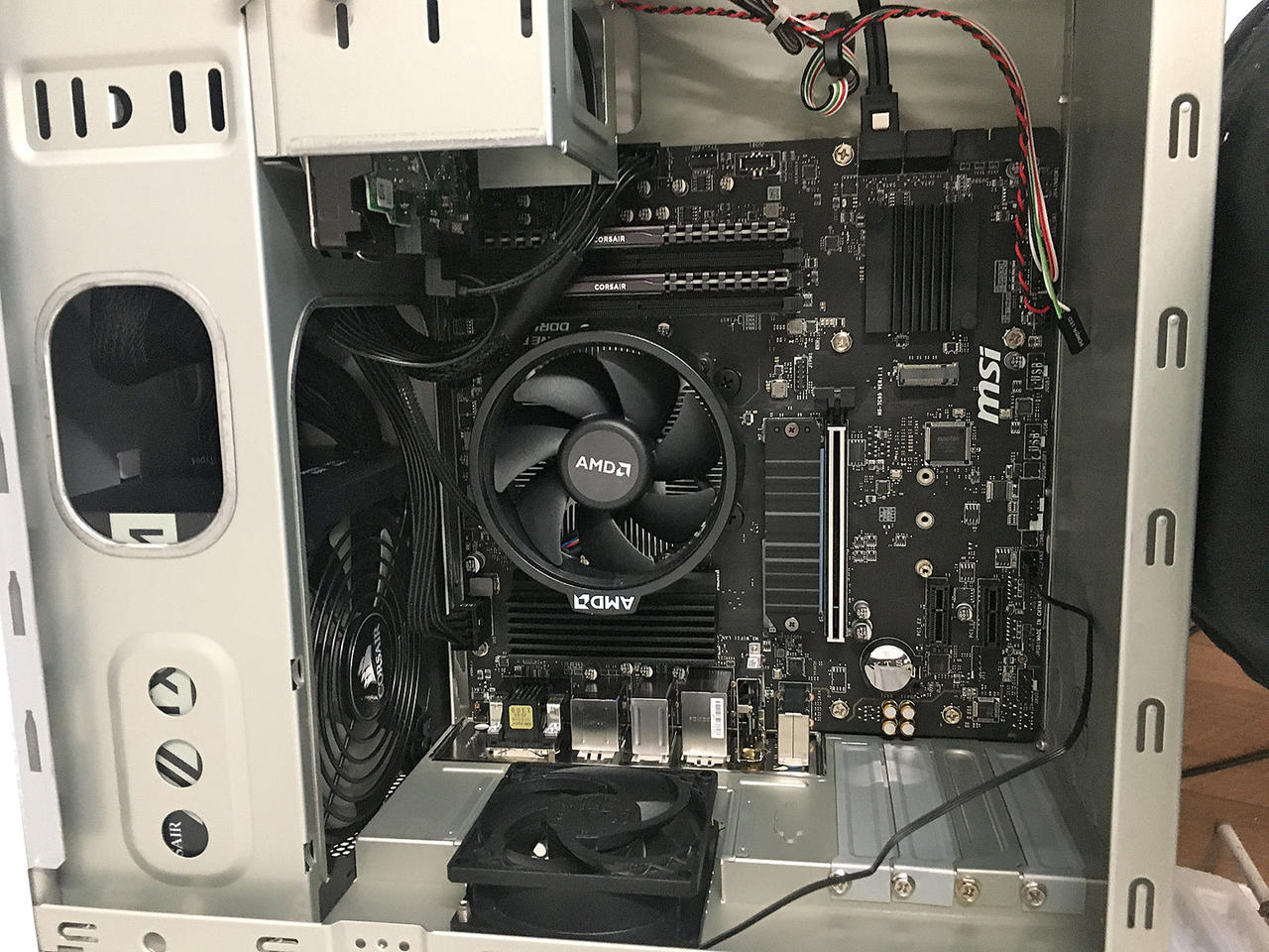

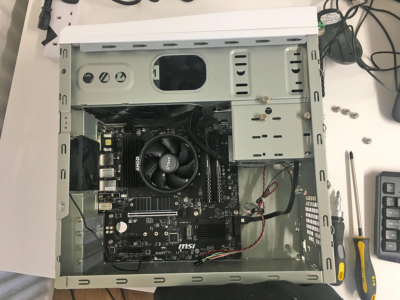

Also got started on my new PC build. It's a fairlymodest spec, a 6 core AMD Ryzen 5 APU with 16Gb Ram.
The old mechanical hard drive is temporary, got an M2 drive coming this weekend but I want to test this now.
It should mean I can finally move on from Blender 2.79 and onto the newer versions. Might add a proper GPU later.
The case was donated by a friend. I had to replace my previous desk and my old Antec 300 case is too tall for the new one. Might keep the case if the cooling is adequate.

A few more photos before I paint these, jaw articulation seems to work well. Both prints are nylon material, the white one is Selective laser sintering process and The grey is multi jet fusion.
