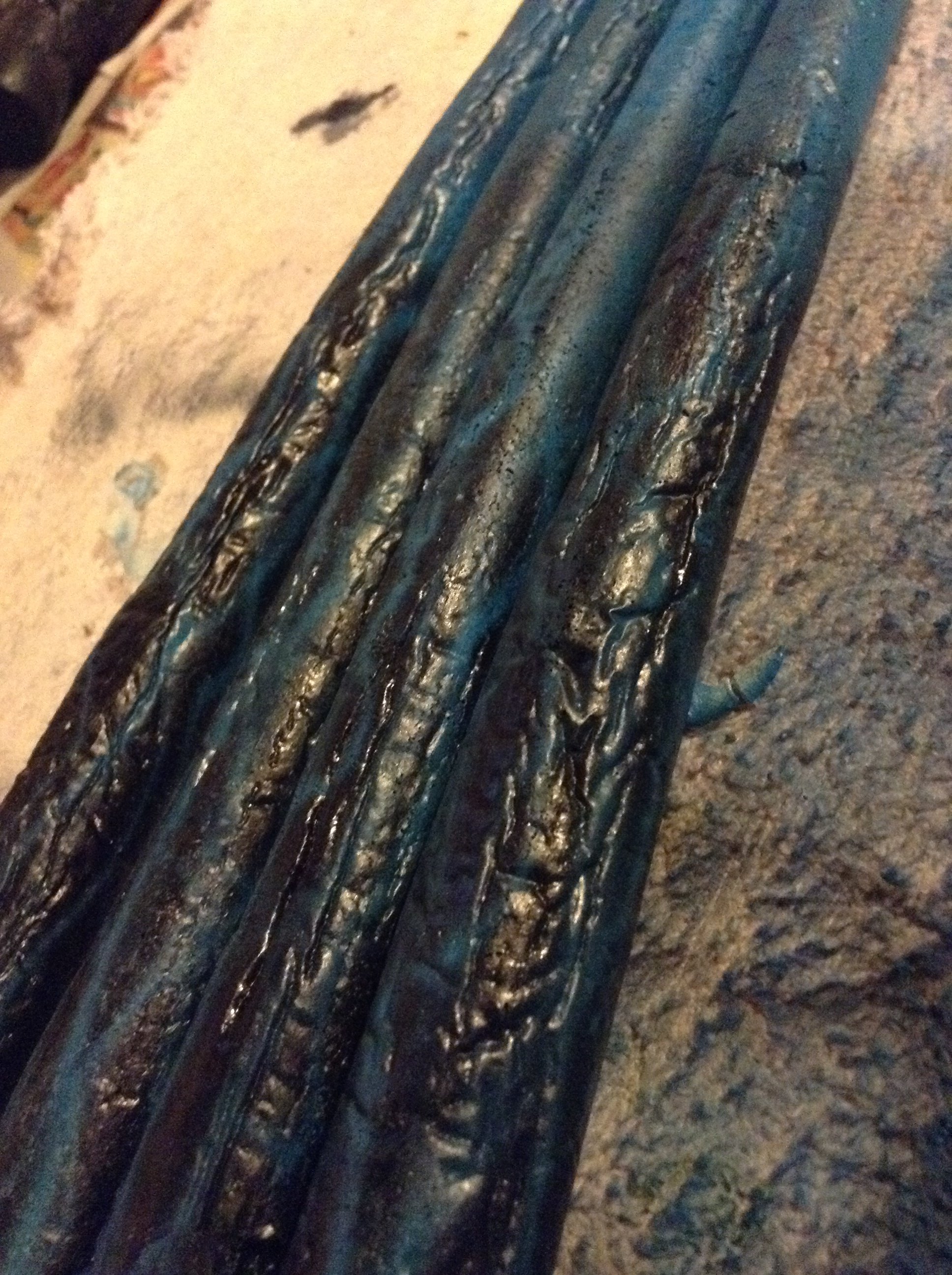

For awhile I noticed something about cold-foam dreadlocks, and have been wanting to ask:
I noticed Bambooie's (Joe) dreads were highly flexible, like all cold-foam dreads, but his seemed to have a very shiny, smooth surface. And probably had best movement.
I ordered dreads from a seller on ebay that were cold foam dreads, just like Joe's. They are flexible, but seem to have a very wrinkly texture. Some the of the out-layer has pealed off on some, and the foam shows underneath. This doesn't bother me much, they still work great.
But how do some dreads have a smooth, shiny surface like joe's, then some are wrinkly? Is it the process of making them, or is it something you can do to them after there made?

In my experience working with different foams, there's allot of variables that come into play.  Different foams will give different finishes (glossy, matte,. etc.), along with how the foam is tinted.  Also, making dreads in a silicone (usually one seam line) yields a different 'feel' to the foam, as opposed to a 2 part stone mold.  The pockets of air inside the dread  (which usually cause the skin of the foam to be wrinkly) can be cause by temperature and/or relative humidity.  Another thing that can greatly affect the dread is weather or not back pressure was used while the foam was curing.  Back pressure generally causes the dread to be a little 'fuller' (less air pockets/bubbles) but can create a stiffer dread.  All of these variables are the reason I never went into full production... it's a pain in the ass.  I have figured out a reasonably good mix of flex and density and have about 90% success rate, but the dreads are about twice the weight of the ones I've compared them to.  They're also a bit more expensive than most, and there's allot of waste due to mixing 2:1 instead of 1:1.  I'm sure others have different experiences, and hopefully they'll share here as well.

The reason the dreads have some missing skin is that when I put them back in the box when repainting my mask, and i had put them in the basement. It was summer so it was very humid. When I went to pull them out they stuck to one another. Some of thier skins were peeled off.

Well... im not sure if my methods are just wayyyyyyy off the bat with dreads, or just simply a different method. I started out with backer rod foam, heated the ends to taper them, and now I am contemplating what coating to use over them >..
Backer rods an alternative that's been used a good deal here on the lair.  Cutting, sanding, and heating is typical of that method.  Most  use plastidip to coat them.  ;)
Plastidip was actually the first thing I had considered, as its whats easiest for me to get my hands on. I guess I will try a few different methods. Although I have latex coming out of my ears, but wasnt sure if that would be a heavier alternative to plastidip... guess it will be a matter of trial and error until i find something that im happy with.
Latex would for sure make them heavier.  Also, latex doesn't stick to the backer rod very well.  I made a few and used plastidip and was surprised at how well it stuck to the foam.
