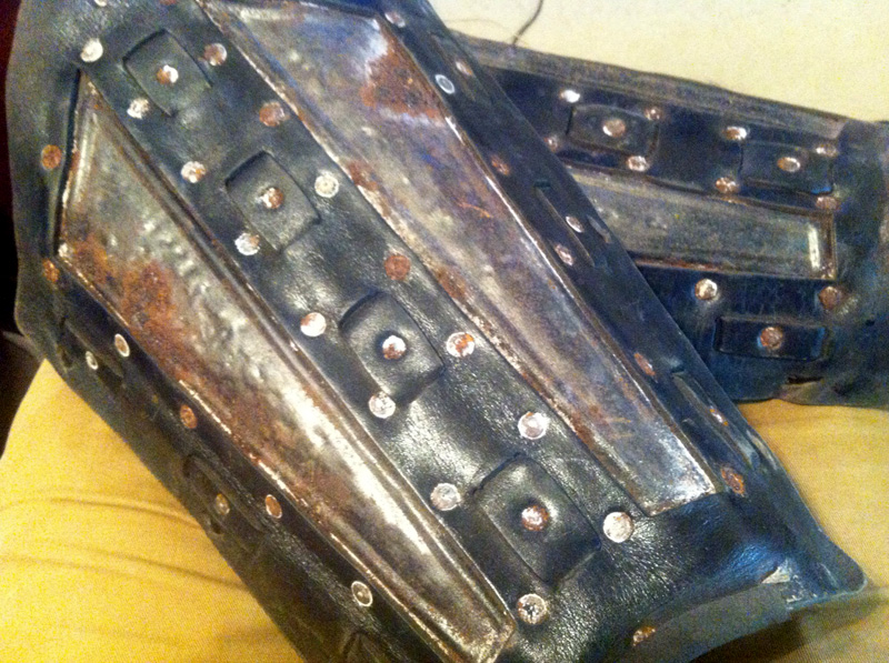

For years I have been after a set of Myrmidon armor from Troy and I finally got a set (a friend also got a set)! The problem is, those costume pieces were used on a real beach, in sea water, then put up wet after the movie. The greaves were horribly rusted from it. Now, I stupidly didn't take any before photos, but here is a shot of my buddy's greaves. Mine pretty much looked the same, with the same amount of rust.
This was a bit more complicate because many of the rivets aren't attached to any other metal, but only hold leather to leather. I ended up making a pretty complex copper wire chain to link every piece of metal on the greaves (over 20 connections). From there, I let the Electrolysis do its work. This actually served two purposes. One: it removed a good deal of the rust. Two: the leather had become very rigid and and stiff in a flattened out form and I was afraid to wrap it around a leg without cracking the leather. Soaking it in water softened it.
Because this was far more than simple surface rust, I kept a constant watch on the pieces and pulled them out after 8 hours. With careful cleanup (no abrasives... no scrubbing) and oiling the leather, this is where I was able to get them. I truly believe if I had tried the typical scrubbing approach to this, I would have ruined these pieces. Just something to consider.
