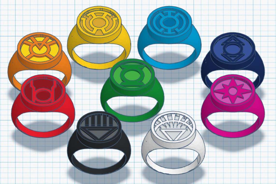

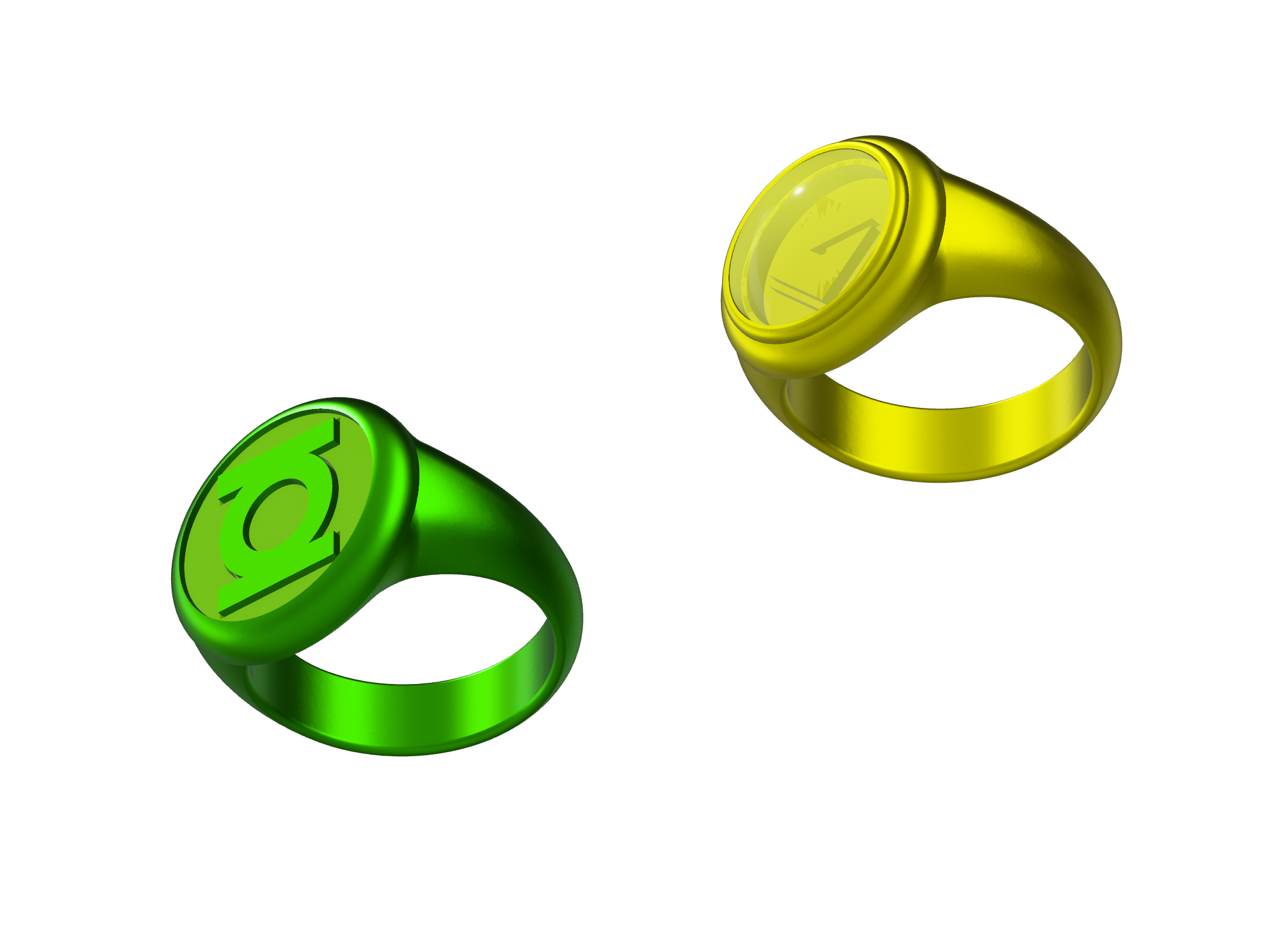

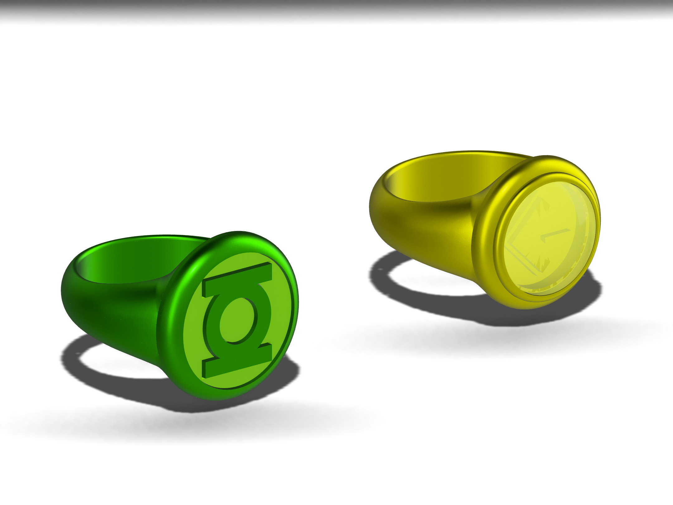

Glad to see this thread is still going. I've actually done a little more work on my own ring customs. The Ring of Volthoom actually has a sort of concavity to the "X" symbol too. I'm rather proud of that.View attachment 1695079View attachment 1695080View attachment 1695081

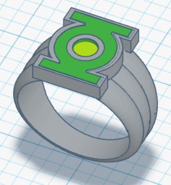

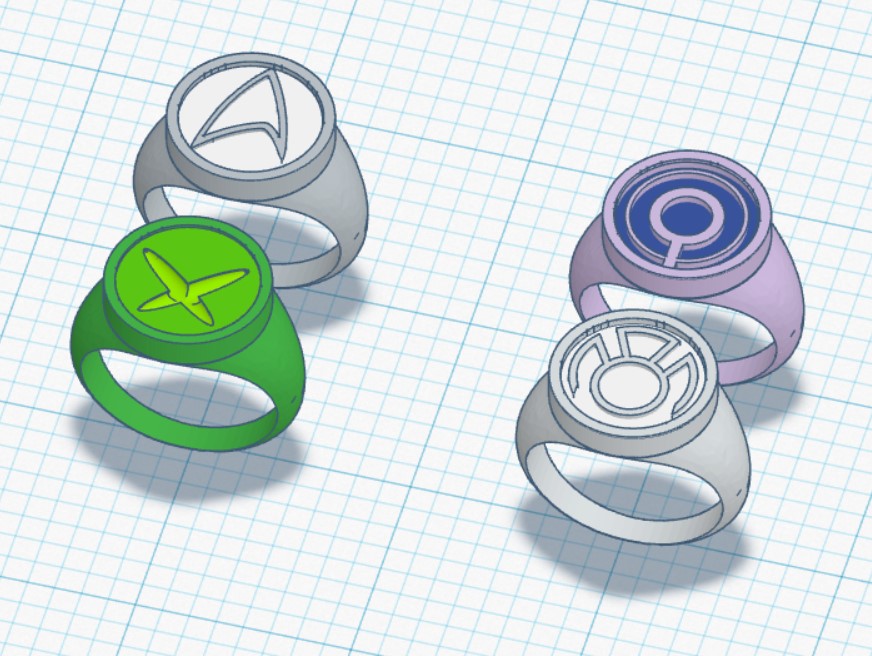

Truth be told I found and downloaded the symbols and a blank signet ring model, then tweaked everything to fit just so. I don't intend to sell any of these so I guess it'll be okay, right? Regarding disc size, I mostly worked with what I had but also tried for a more idealized version of the Blackest Night promo rings. The color discs are just in there for show, as I intend to print a ring of each color in stainless steel just for myself, then inlay the faces with colored resin and glow powder. As for the tri-band on the Kyle ring I had to use both TinkerCAD and Vectary. I made three solid circles, stacked them on top of one another, then used the perspective tool in Vectary to warp them. From there I made adjustments and added a hole in my ring size.

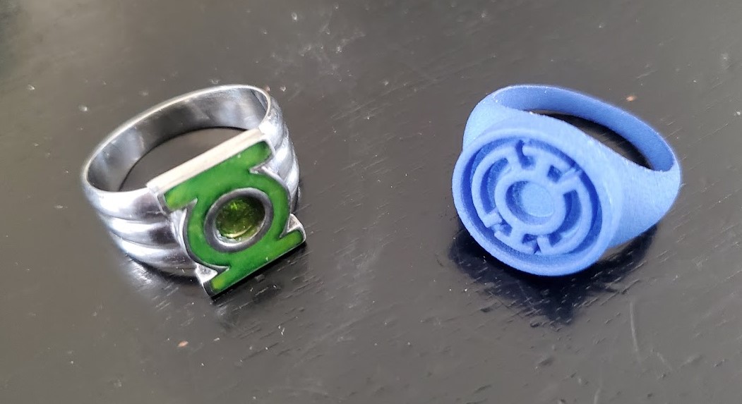

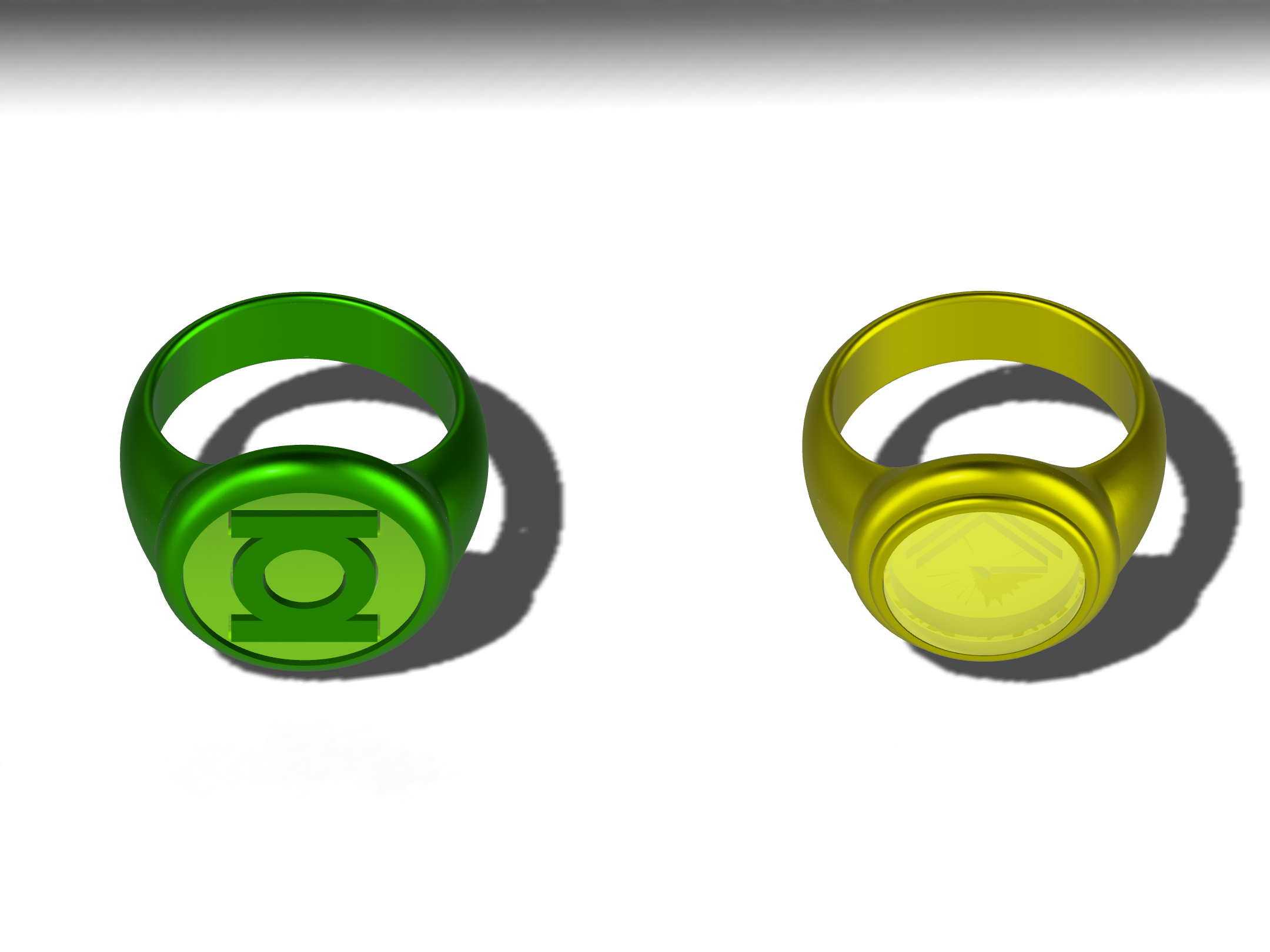

Got the nylon prototype for my new signet style Blue Lantern Ring today. Overall I like it. Fit is good, details are solid and it looks an awful lot like the Blackest Night promo rings. The back of the band is a little thin for my tastes but I can live with it. I've made a few small adjustments to the model to make inlaying with glow powder and resin easier. Now I'm ready to get this one and the Green signet style done up in steel.

Thanks! You were definitely an inspiration. I plan to get all nine "basic" Rings, maybe do two at a time for a few months. Kinda like the way the promo Rings were released.

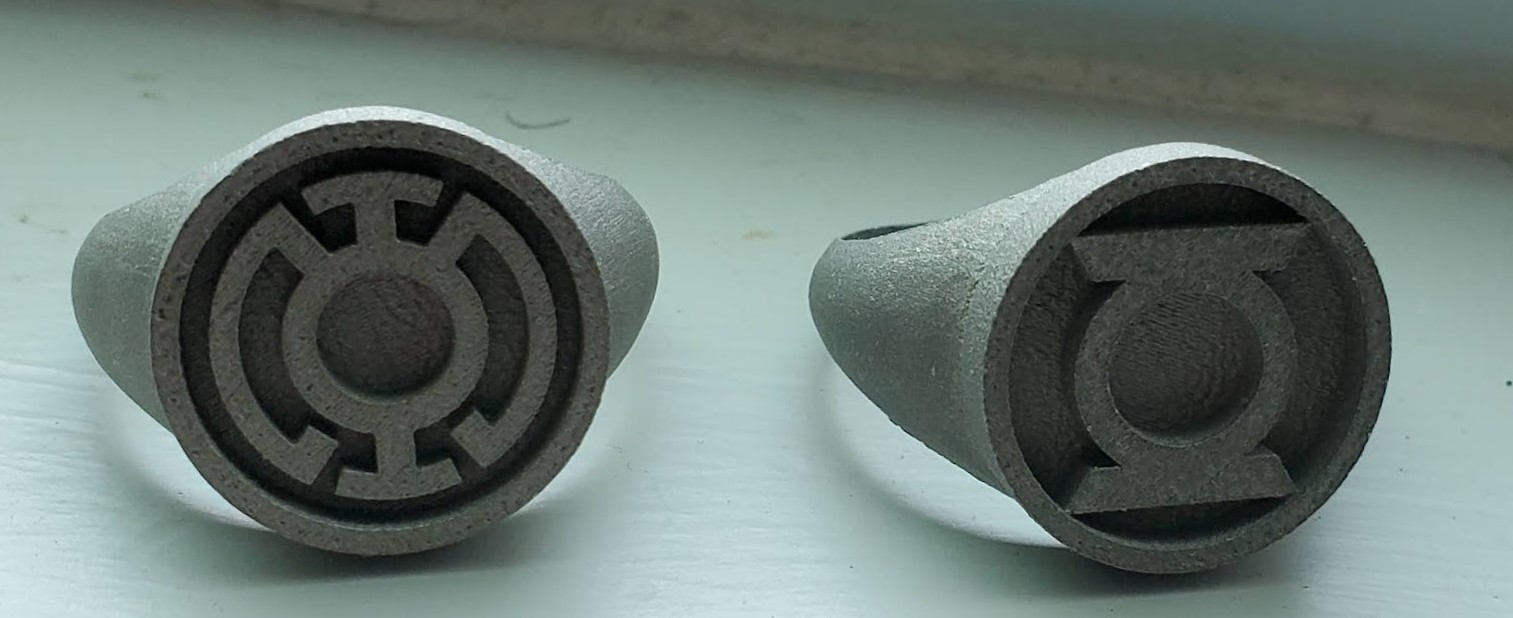

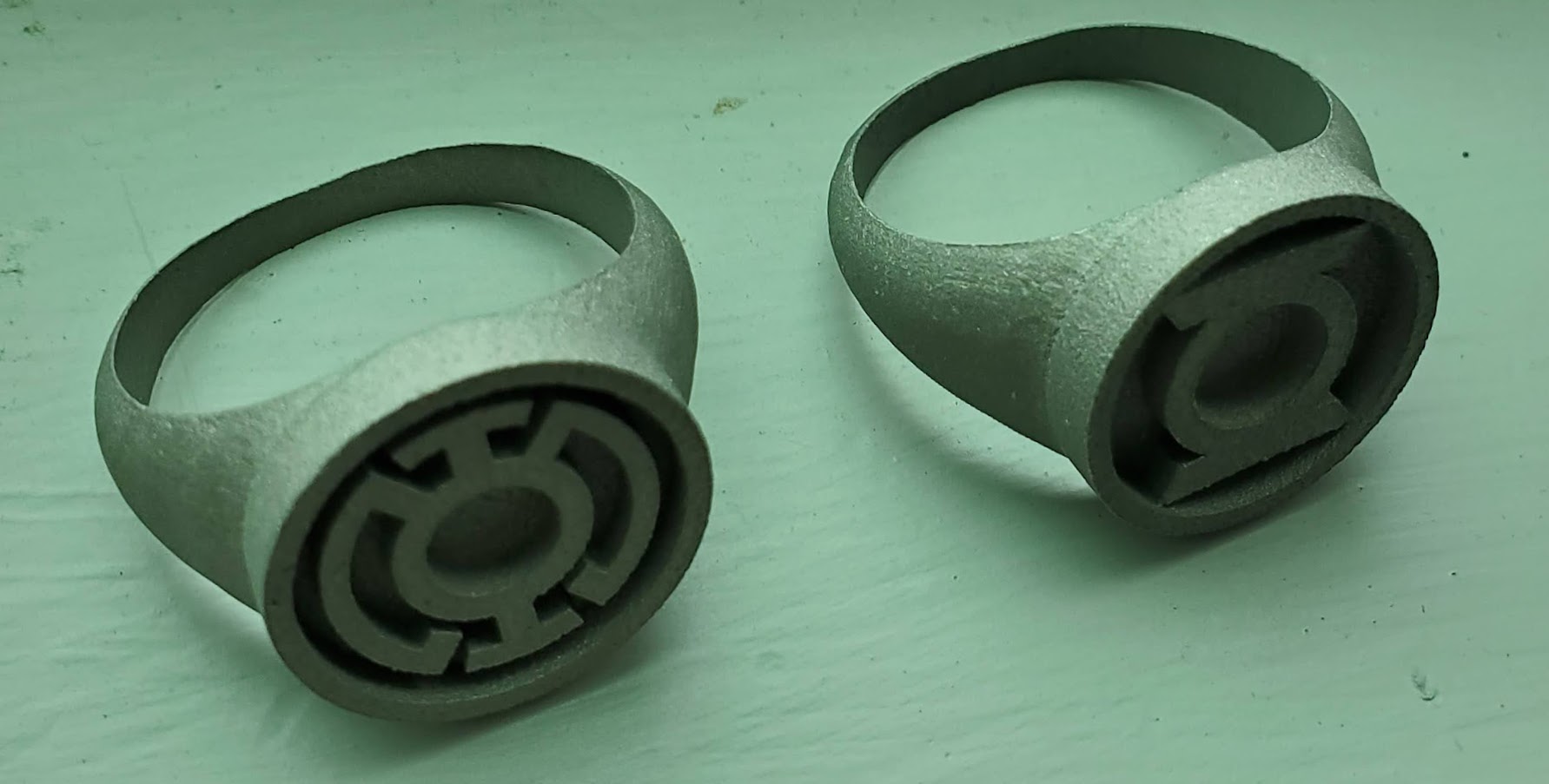

Well, I got my next steel ring printouts and I'm honestly rather disappointed. The printers didn't even bother polishing them, which is the major disappointment. Secondary to that is the warping in the shanks. I'm going to try a jeweler I know who offers repair services to see if I can salvage these.
Did they actually offer polishing as an option, but then neglect to do it?
As for the shanks, how thick are they? That tends to be a factor in printing even my plastic test rings.
Yes, which is weird because they polished the Kyle Rayner style ring I first got from them. They told me the shank of the new ring(s) design was too rough to polish, but I thought they'd at least try. As for the thinnest part of the shank I'm not sure. I don't have any tools to measure it with, but I'm gonna guess it's only a few millimeters.
For the plastic rings, Shapeways' software pops up a "thin walls" warning for anything under 0.50 mm or so. If these are several mm worth of metal, you'd think it wouldn't be a problem.
