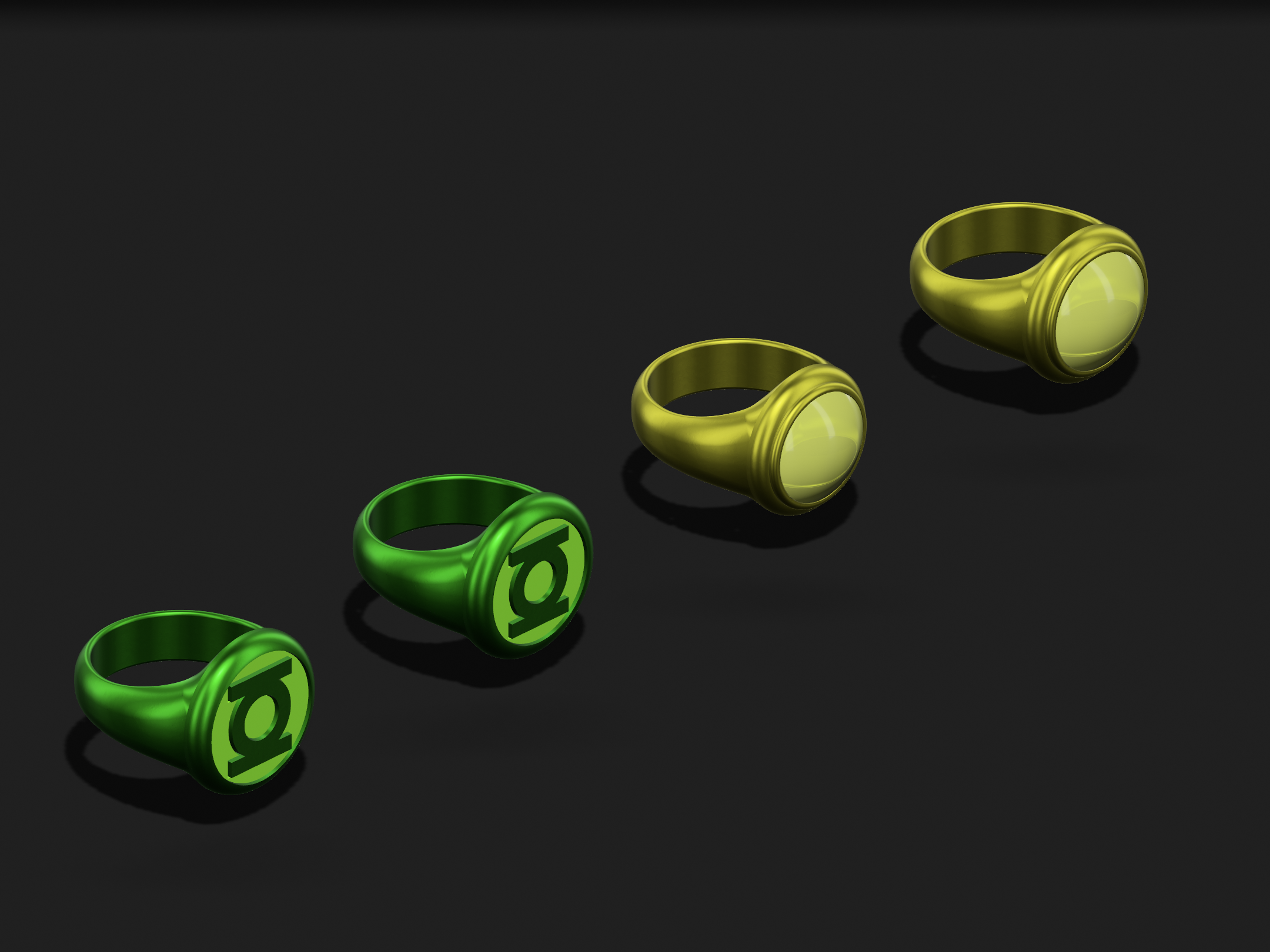

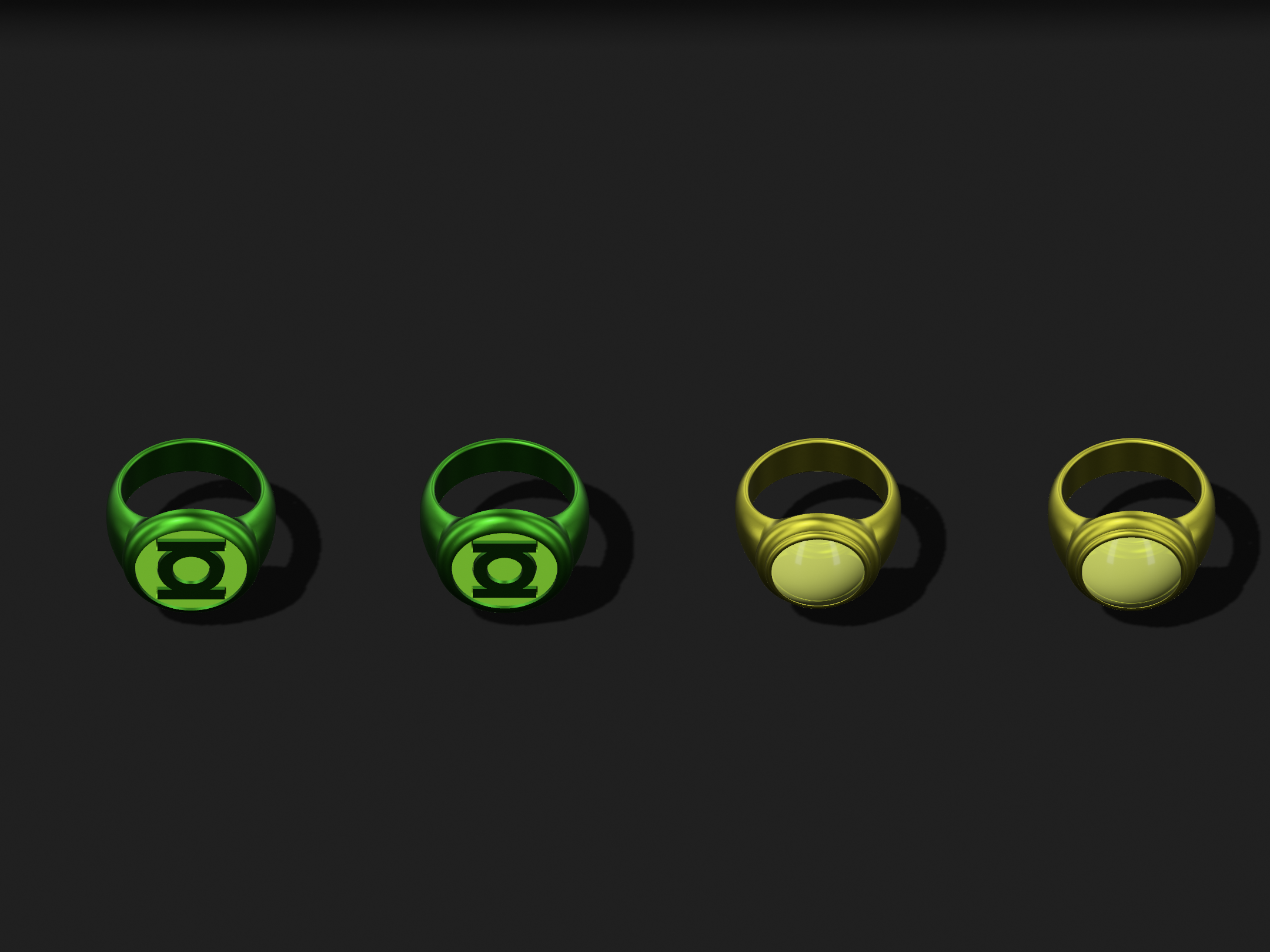

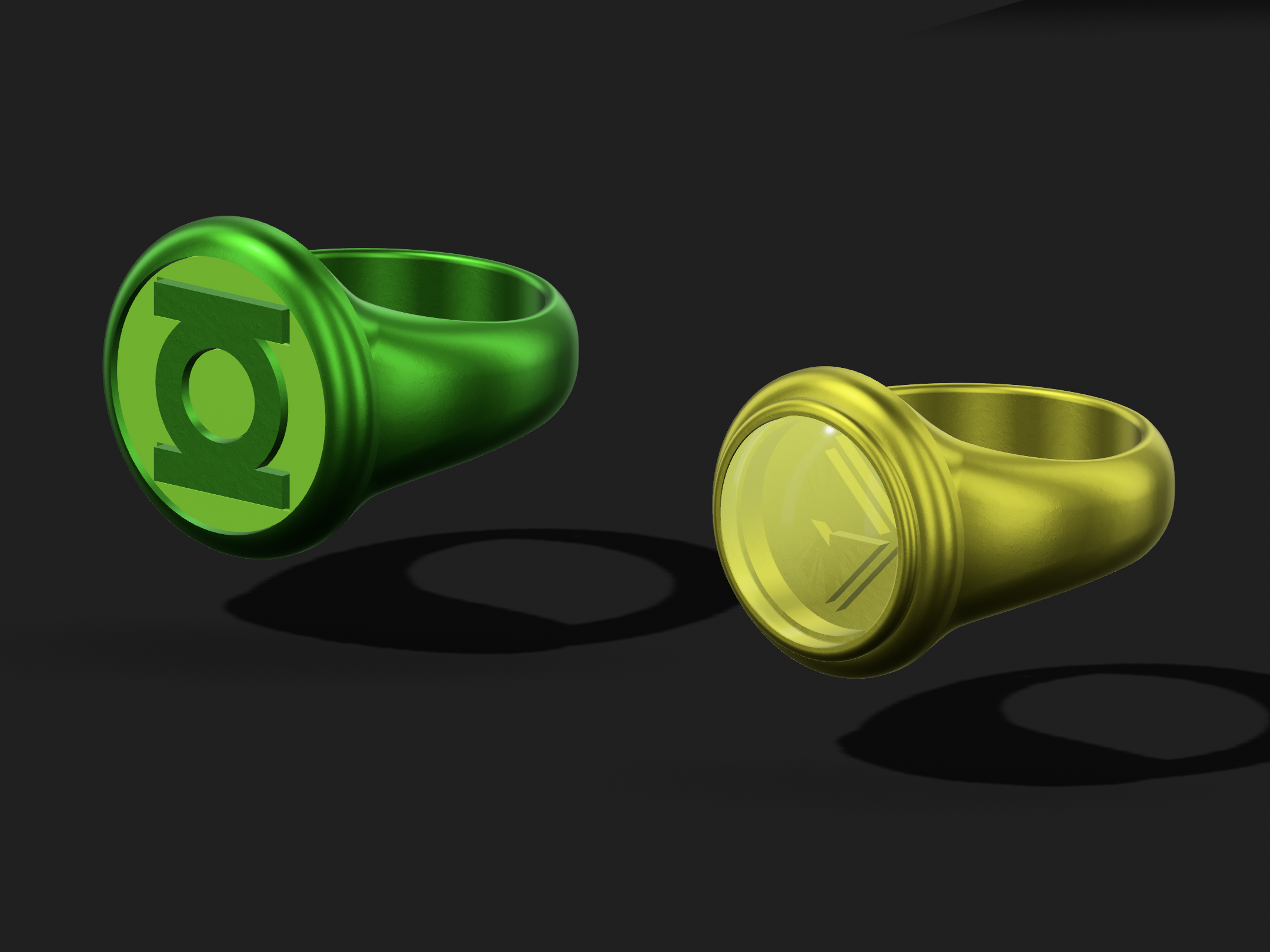

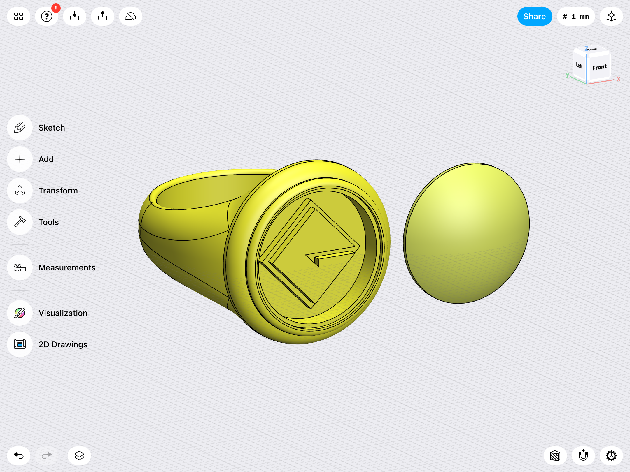

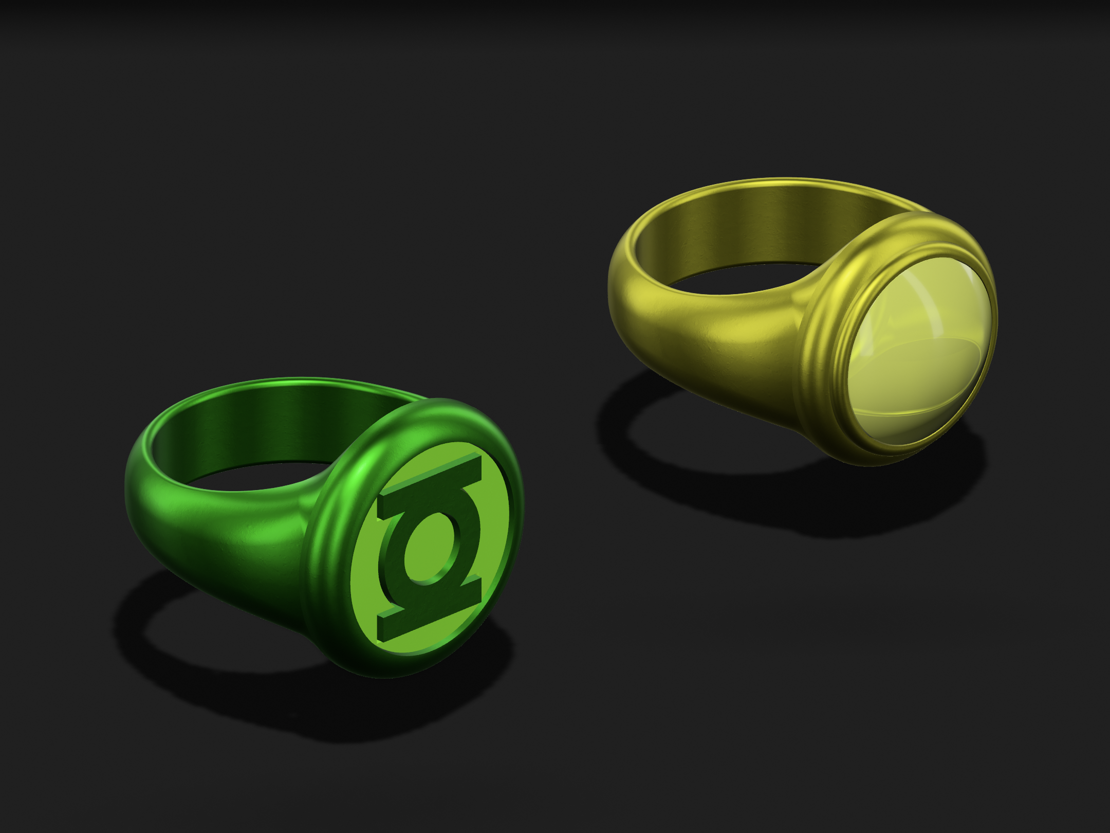

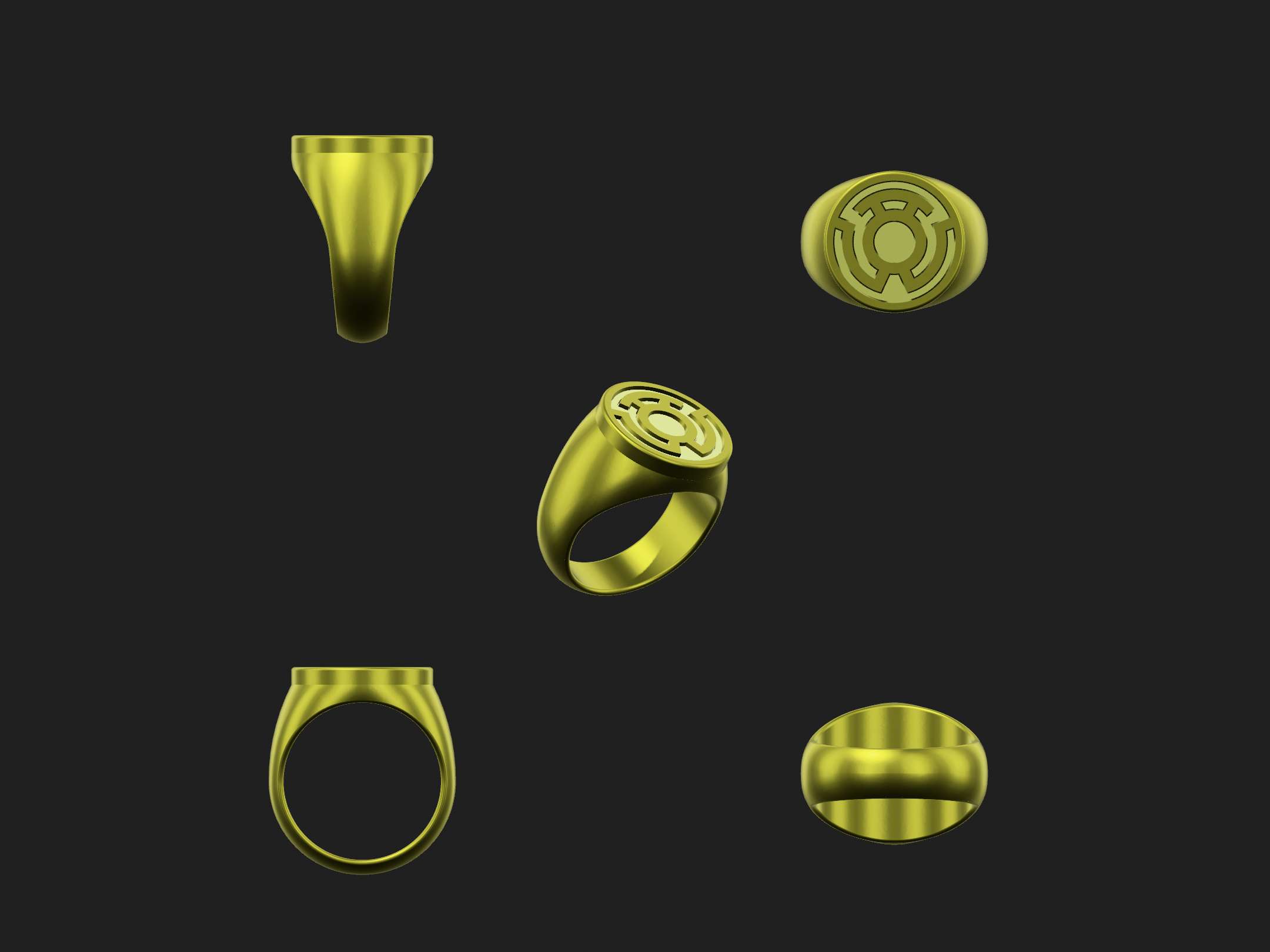

Tweaking the Gardner ring. Still on the fence about how big to make the bezel. This version is 22mm.
I also made a 21mm version, and now here’s the latest—a 20mm version. Definitely leaning toward one of these smaller versions. The 22mm test print looks about right for the EMERALD DAWN, but the same-sized test print for the Gardner just looks too big, especially due to the huge domed gem. I was thinking that the EMERALD DAWN and Gardner should be essentially the same, since they were around during the same comic era, and the yellow rings began as knockoffs of the GL design, but that may not be how this ends up.

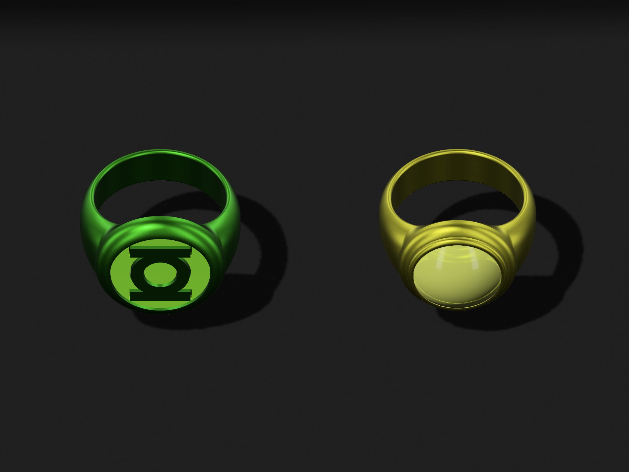

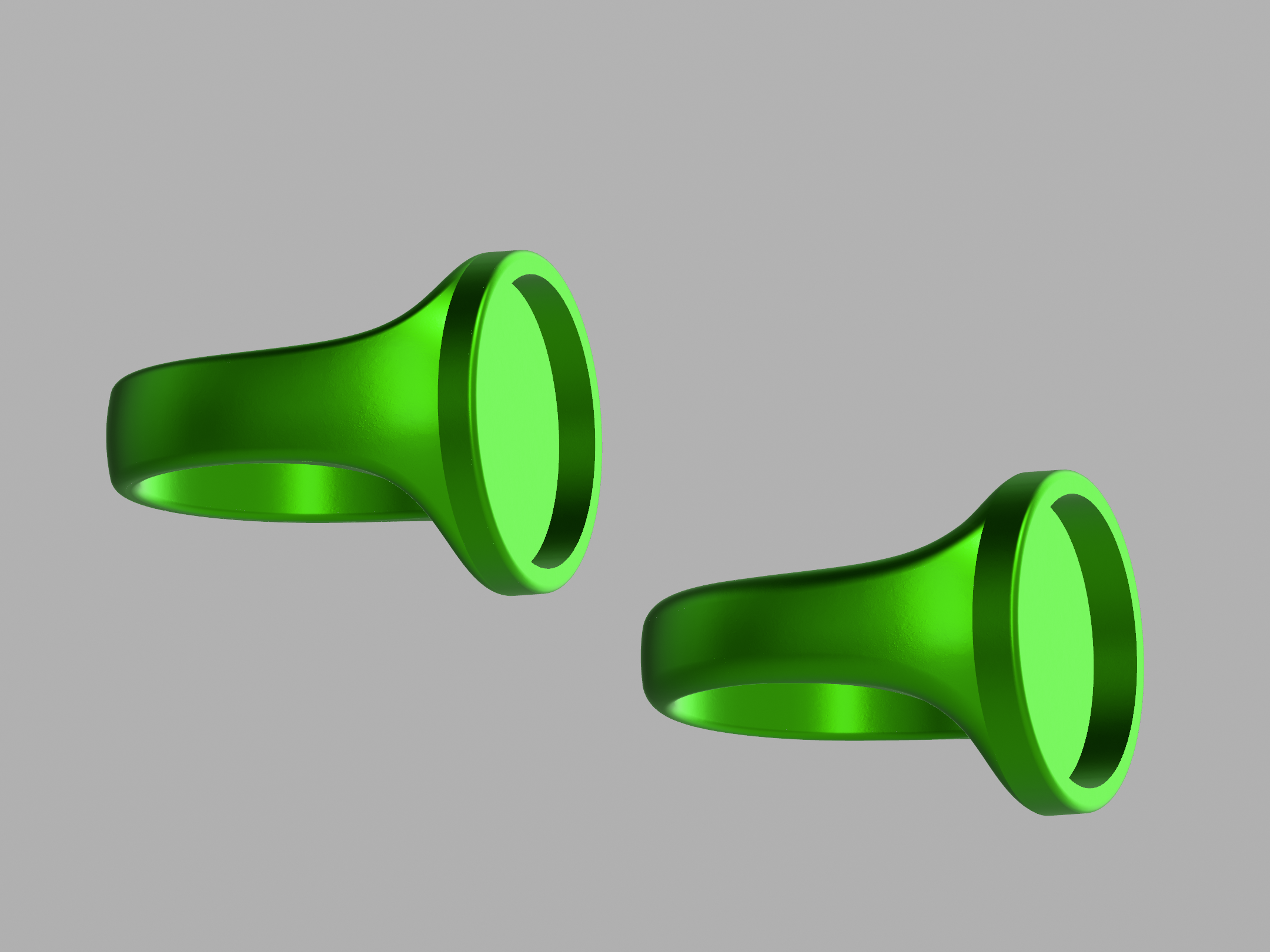

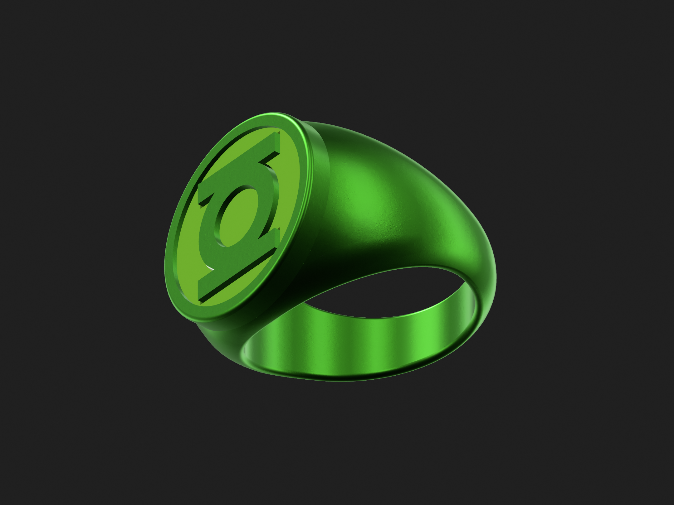

Playing with the V1. The current iteration has the squared-off band with minimal filleting as seen previously (right), but I’m playing with a softer, curvier band, too (although not as curvy as some of the other models seen upthread). Gil Kane’s art goes with either look, from time to time.
More V1 tweaks. Here we have the 23mm version (right) and a 22mm version with a curvy band (left). I also added 1mm of material between the finger-hole and the bottom of the disc.
And here we have the addition of a 22mm variant with the more squared band (left):

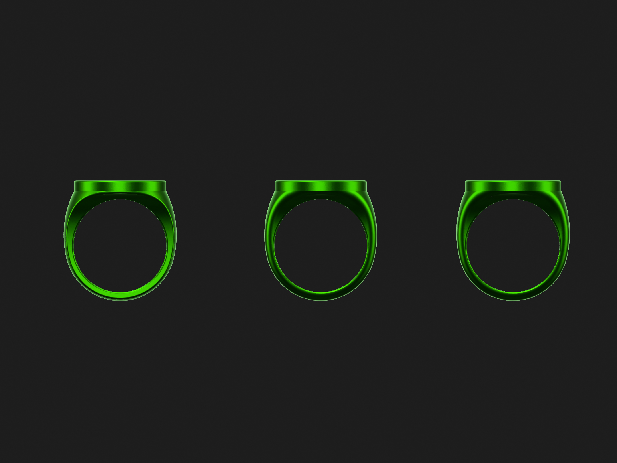

As noted many times, the face of the ring looks BIG in the comics. However, I find myself not liking the shoulder section of the band on the iterations with a larger disc. It looks a bit “off”, as if the shoulders are actually bowing outward instead of gracefully curving upward and inward to form the platform for the signet disc. Almost like the ring has been squashed. In order to compensate for this, I’d have to make the ring shank thicker, which isn’t something I really want to do. I think 2.1mm is reasonably thick, and that’s the measurement I’ve used for all of the current designs.
The disc has also been reduced from 3mm to 2.5mm to match the REBIRTH, but I’m still not sure if that’s too slim. Or perhaps I should consider not keeping the two designs’ discs consistent. Hmmm.

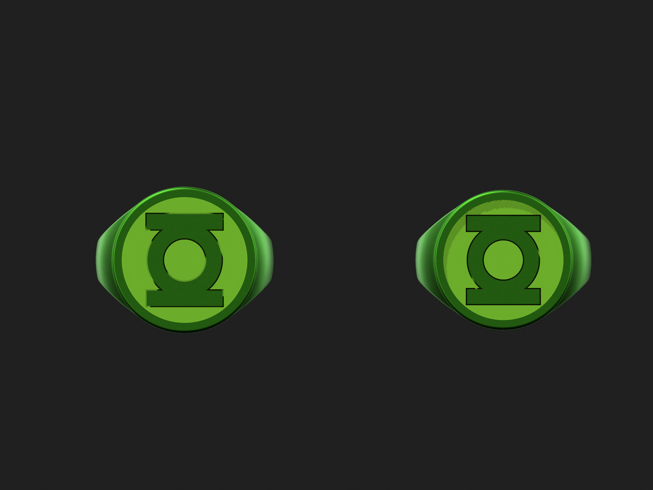

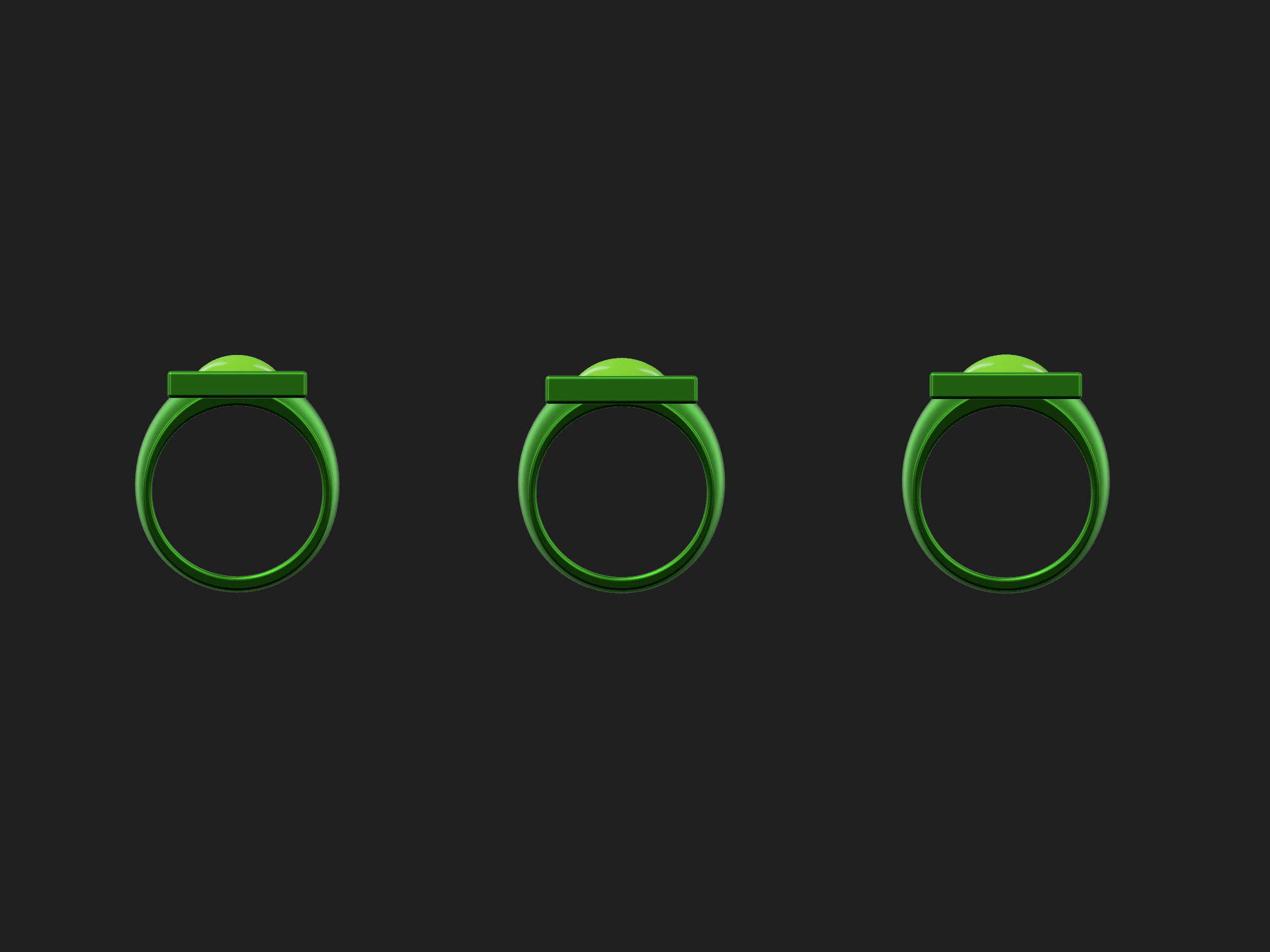

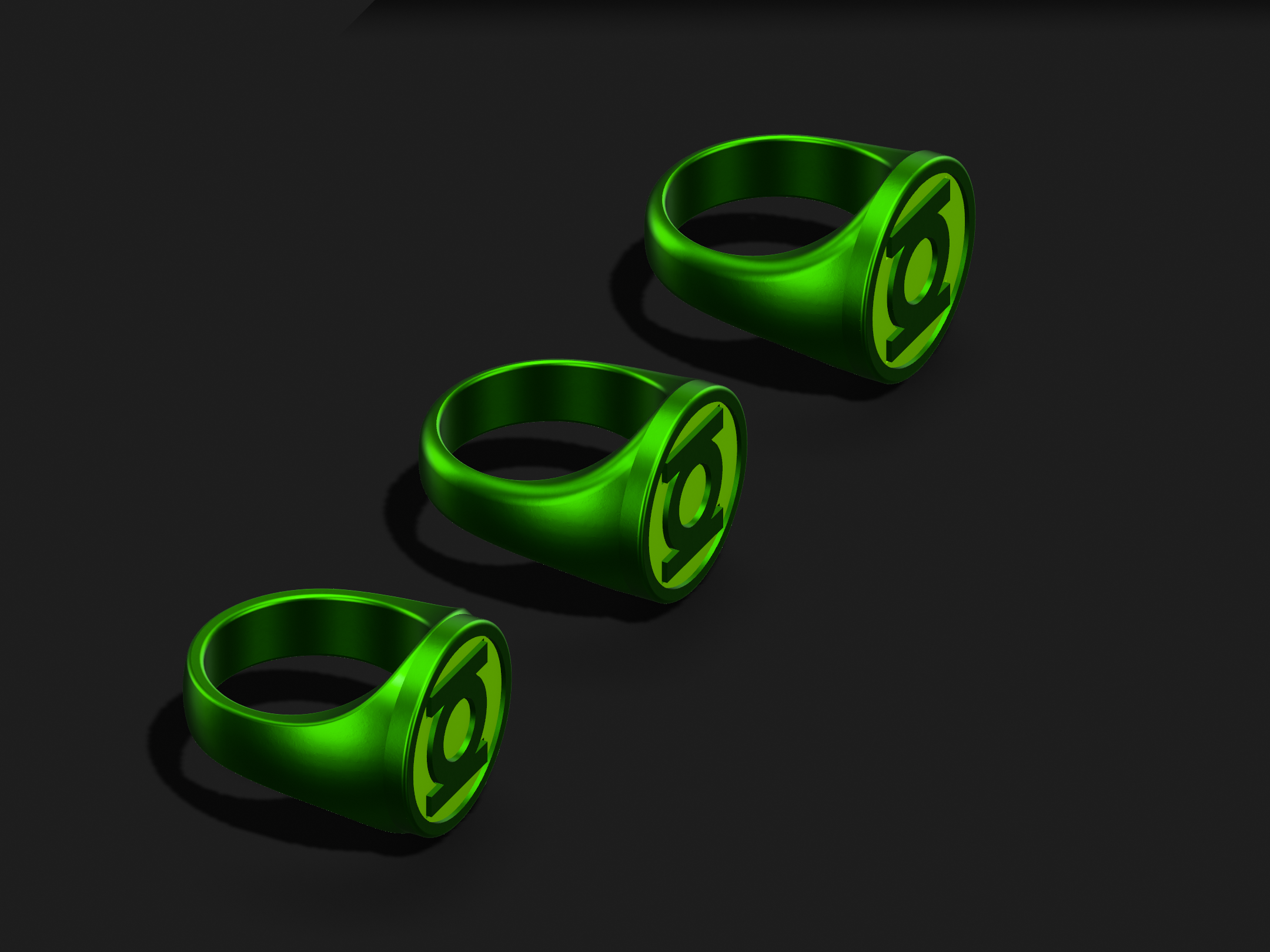

V1 tweaks. The version on the left has minimal band filleting (0.50mm) and a 2.5mm disc, while the one on the right has more aggressive filleting (2.0mm) and a 3mm disc.

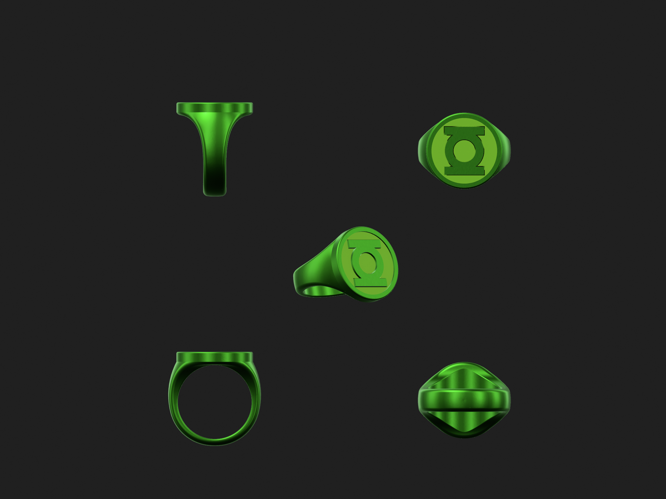

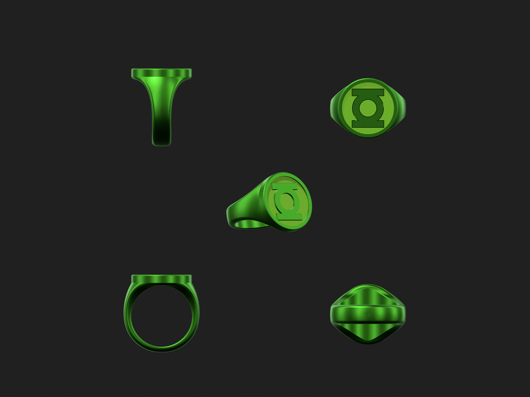

After a lot of head-scratching, I finally hit on a modification to improve the V1. Up until now, there seemed to be too much of a gap between the finger-hole and the bottom edge of the disc. The trick was reducing material in-between those two areas for a more compact design.
Here are the results, in 22mm (right) and 23mm (left) flavors:
And, for the sake of thoroughness, a single-piece version with no lime-green insert (left) as seen in the comics most of the time. Still on the fence about which way to go, but logic dictates that it be the version with the insert. In spite of the usually solid green coloring on the page, the ring from this era was still described as having a “gem” or “power element” which was removable from the main body.

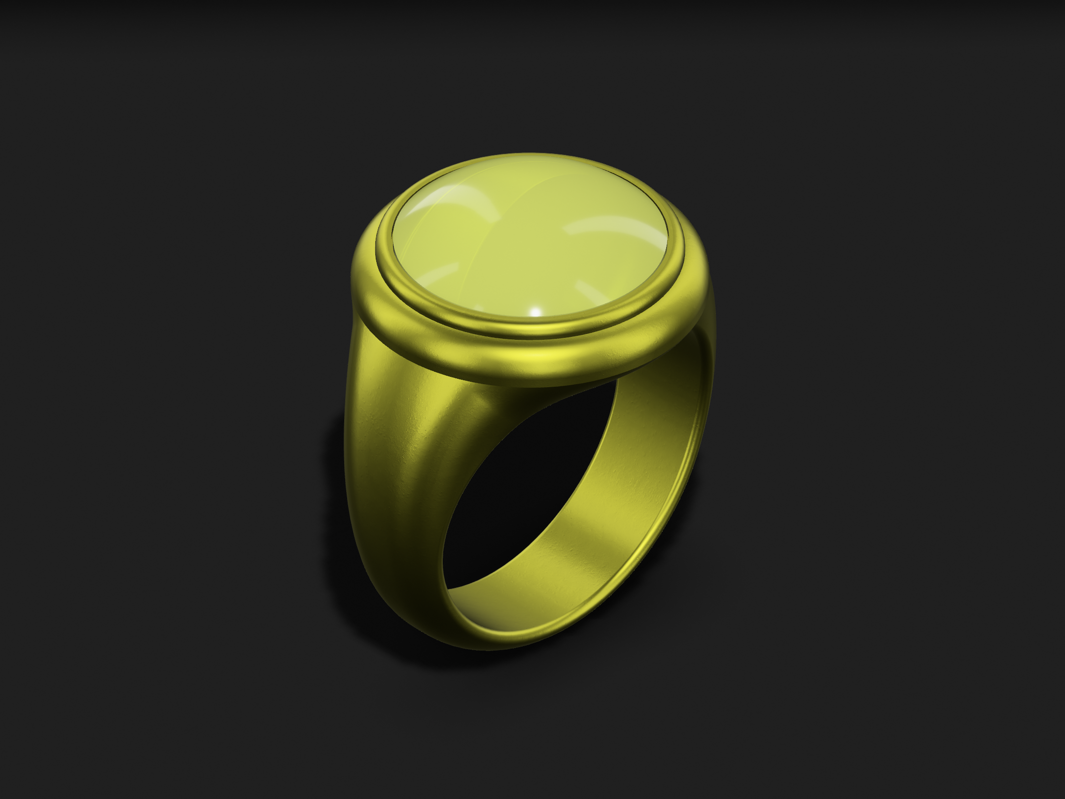

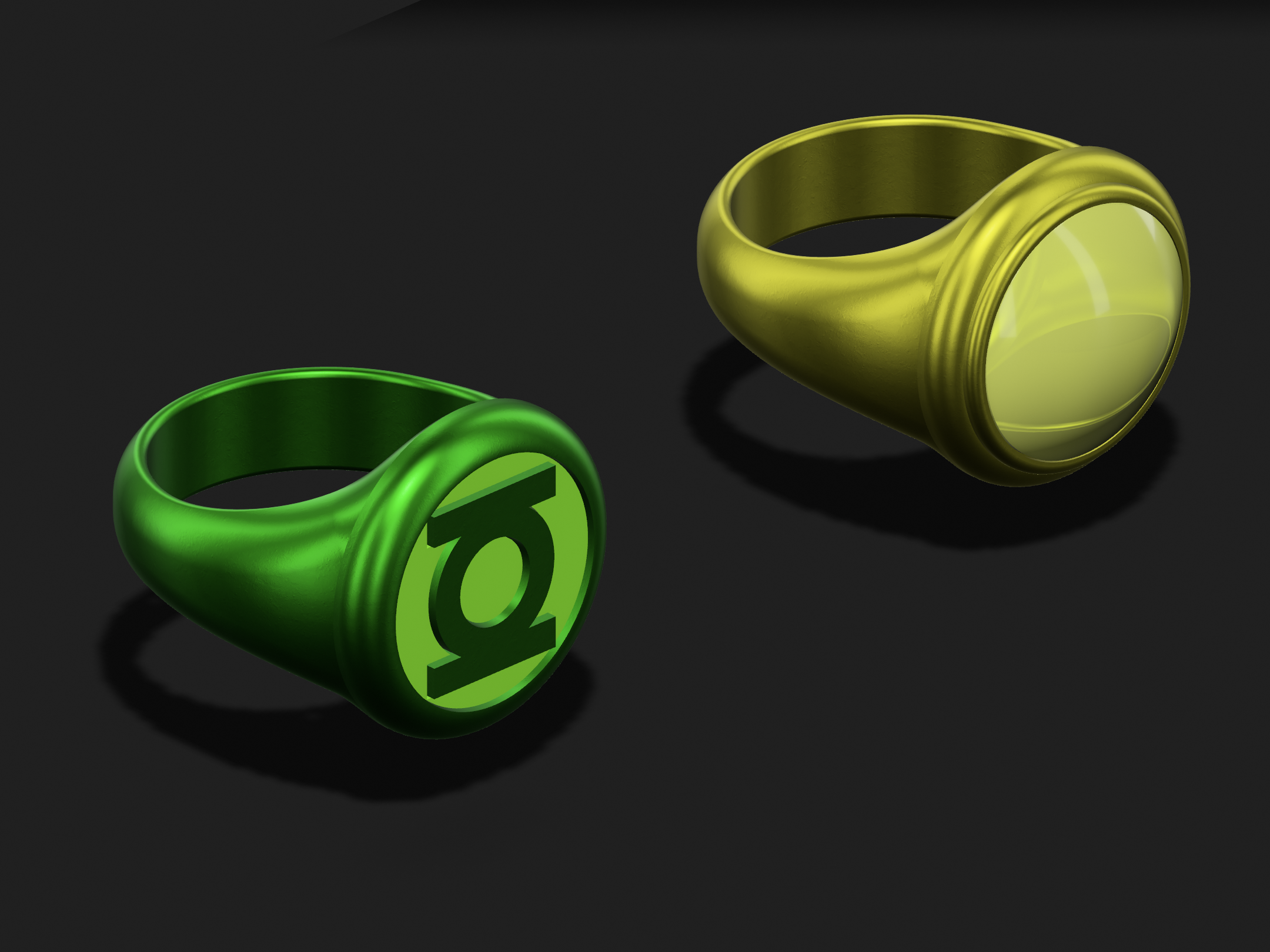

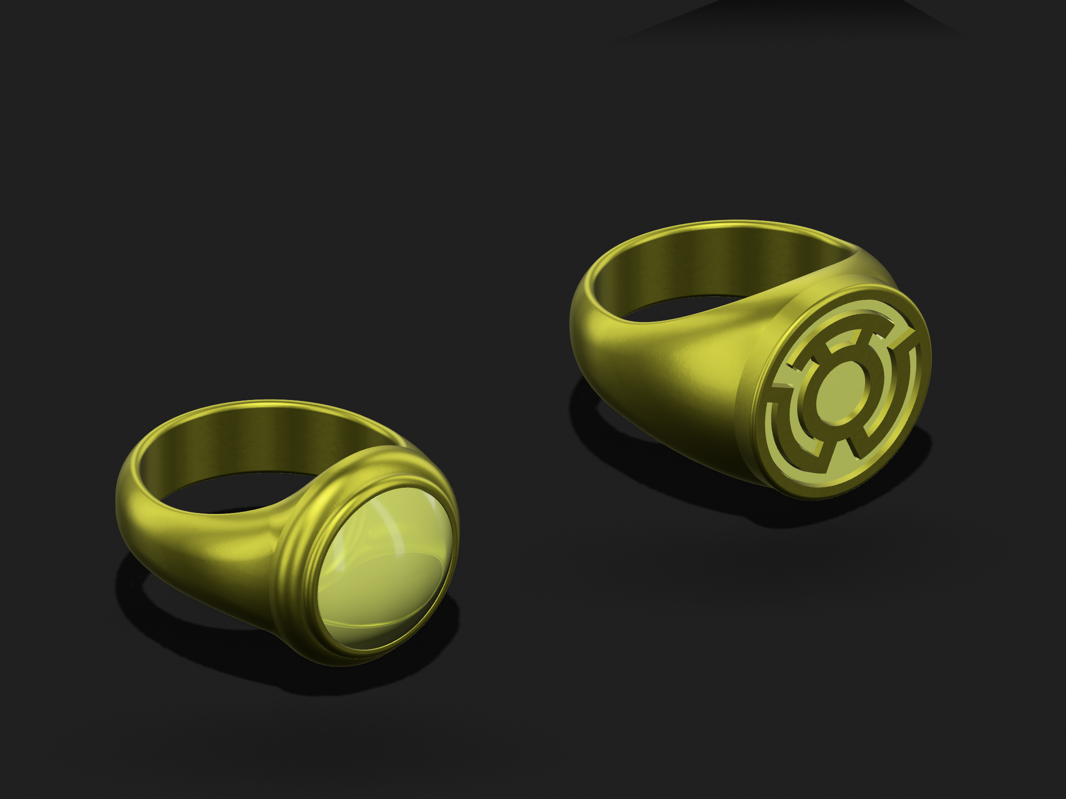

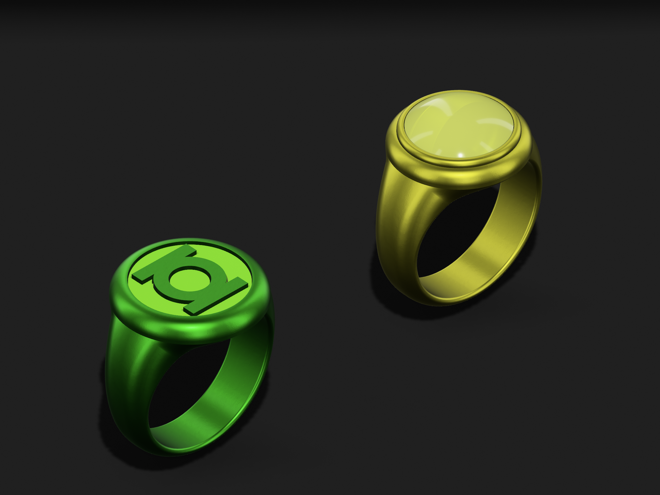

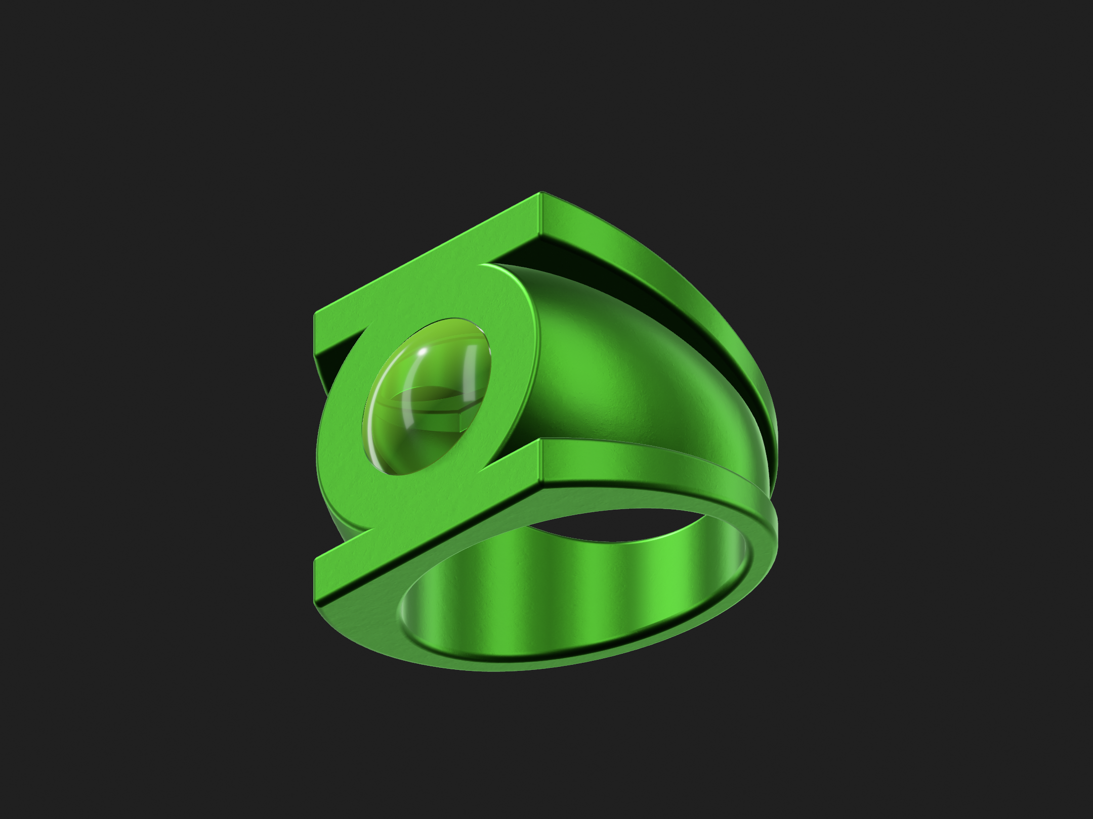

After nearly three years, I’m convinced that the EMERALD DAWN—as seen on the page—is something which cannot be replicated in three-dimensional reality. But I’m liking my compromise version. Gave it the same tweak as the V1 to remove material above the finger-hole and make it more compact. Same with the Gardner.

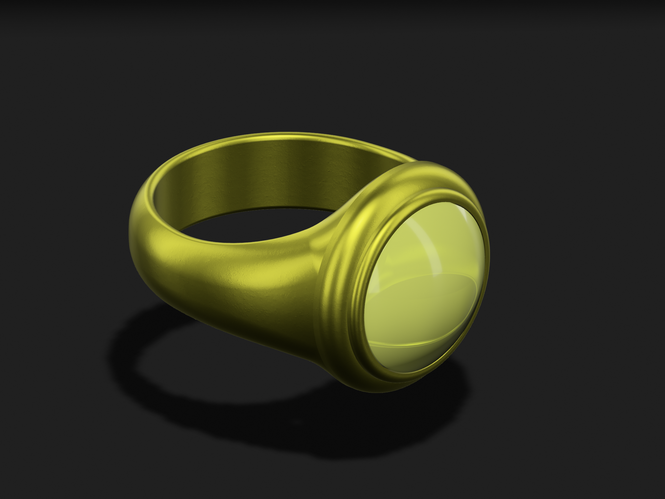

Still wondering how thick to make the ED bezel, and whether or not the GL symbol should be a bit larger. The proper size of the Gardner ring’s symbol underneath the gem is a question mark, since it’s hard to know what kind of magnification effect the domed resin gem will have on it when cast and installed.

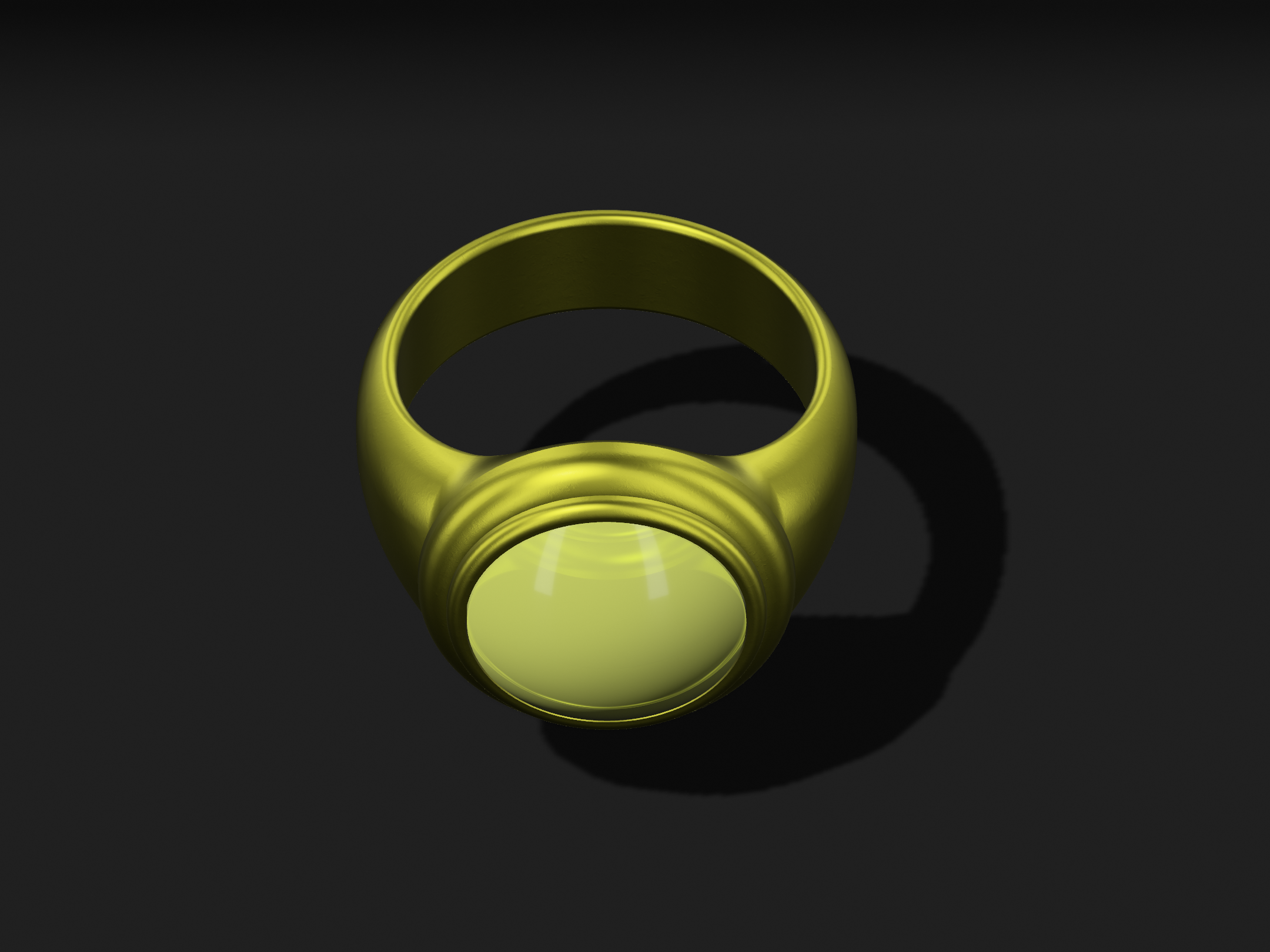

22mm bezel for the ED, 20mm for the Gardner.

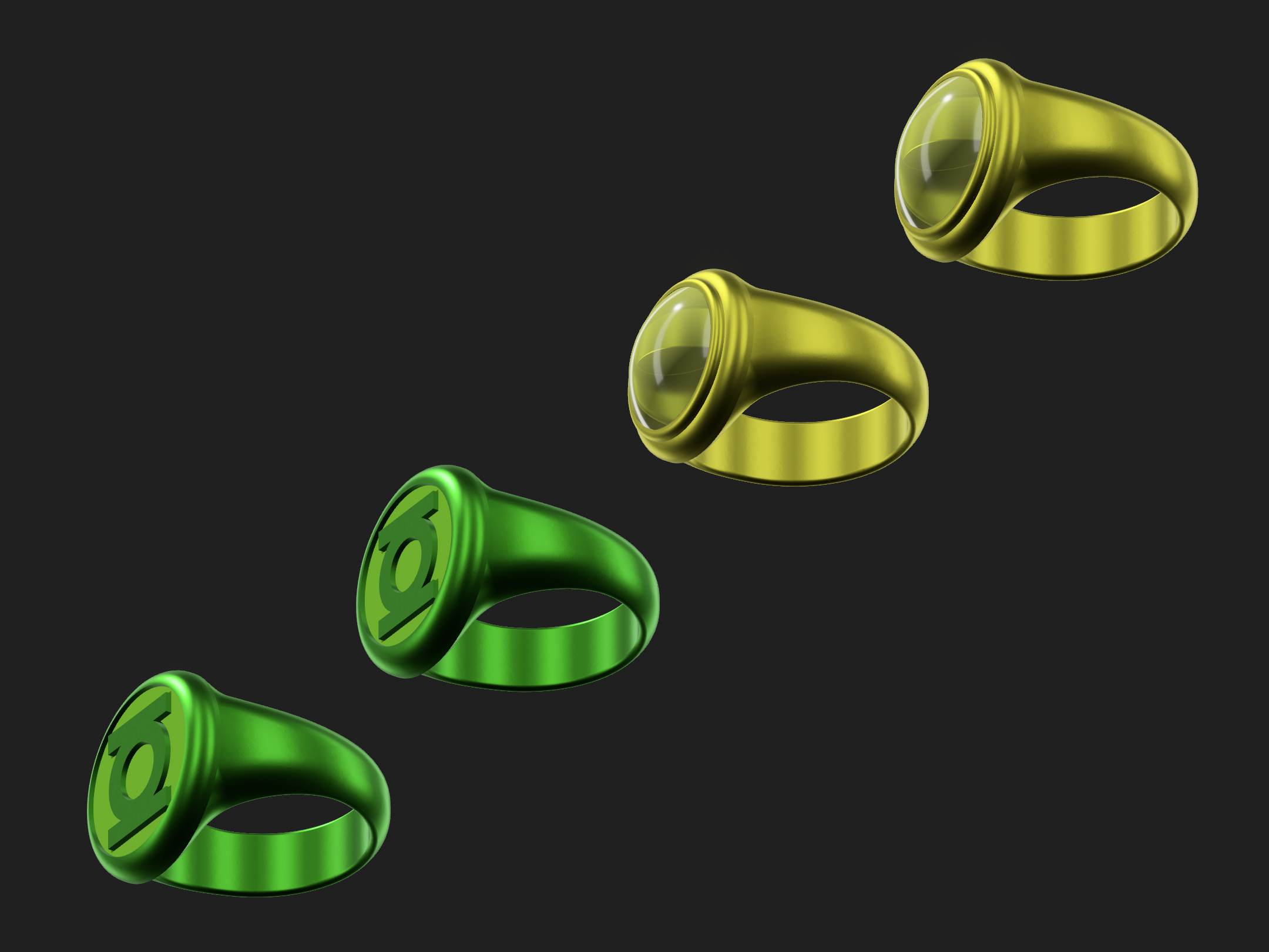

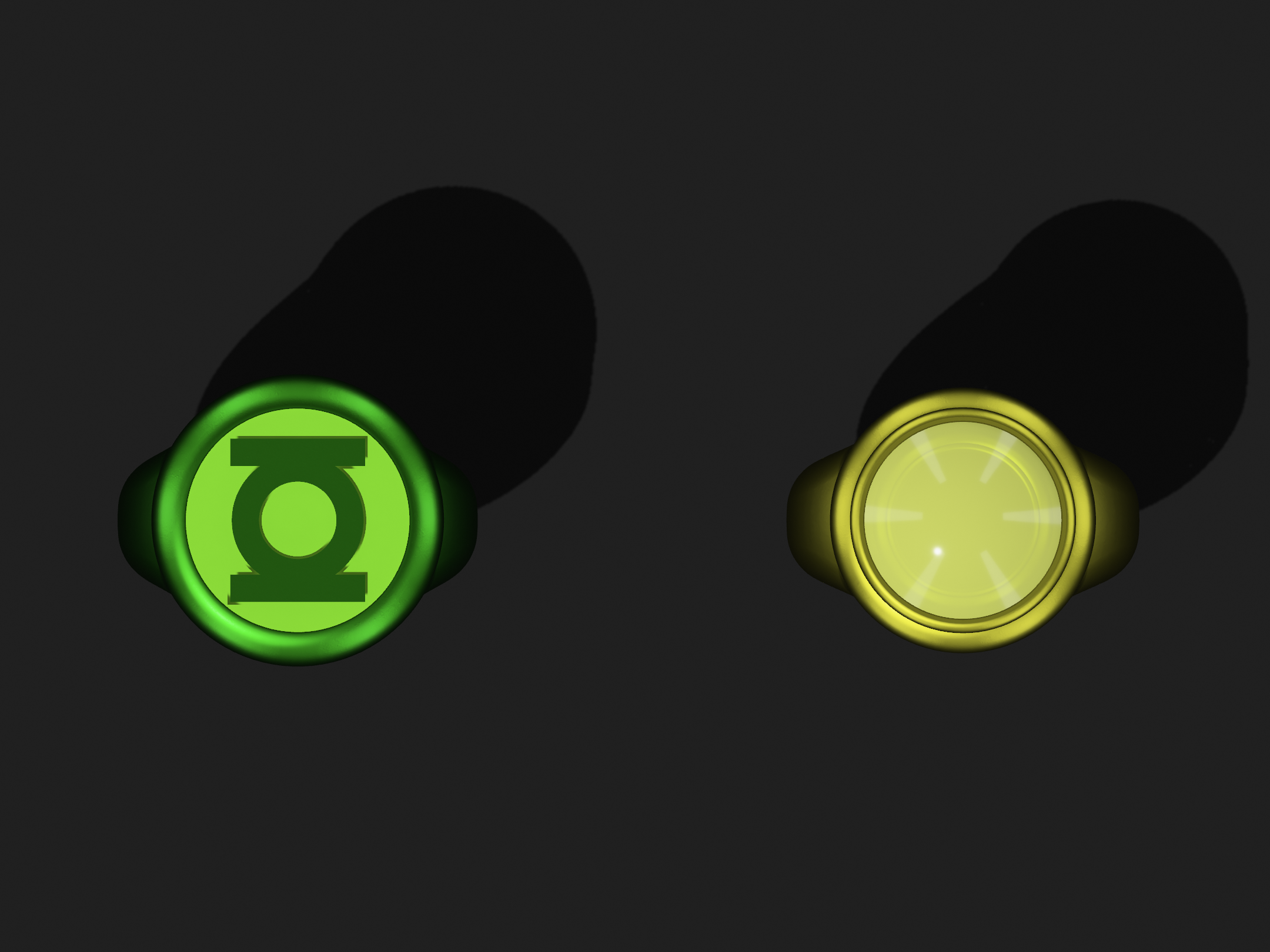

Subtle tweaks. Increased the inner diameter of the bezel-socket/symbol (but not the outer diameter of the bezel) on the EMERALD DAWN by 1mm (far left), and created a 21mm iteration of the current Gardner (far right).
A few tweaks to the ED and Gardner bands. Also, I finally got around to setting the Gardner gem to semi-translucent when in “Visualize” mode.

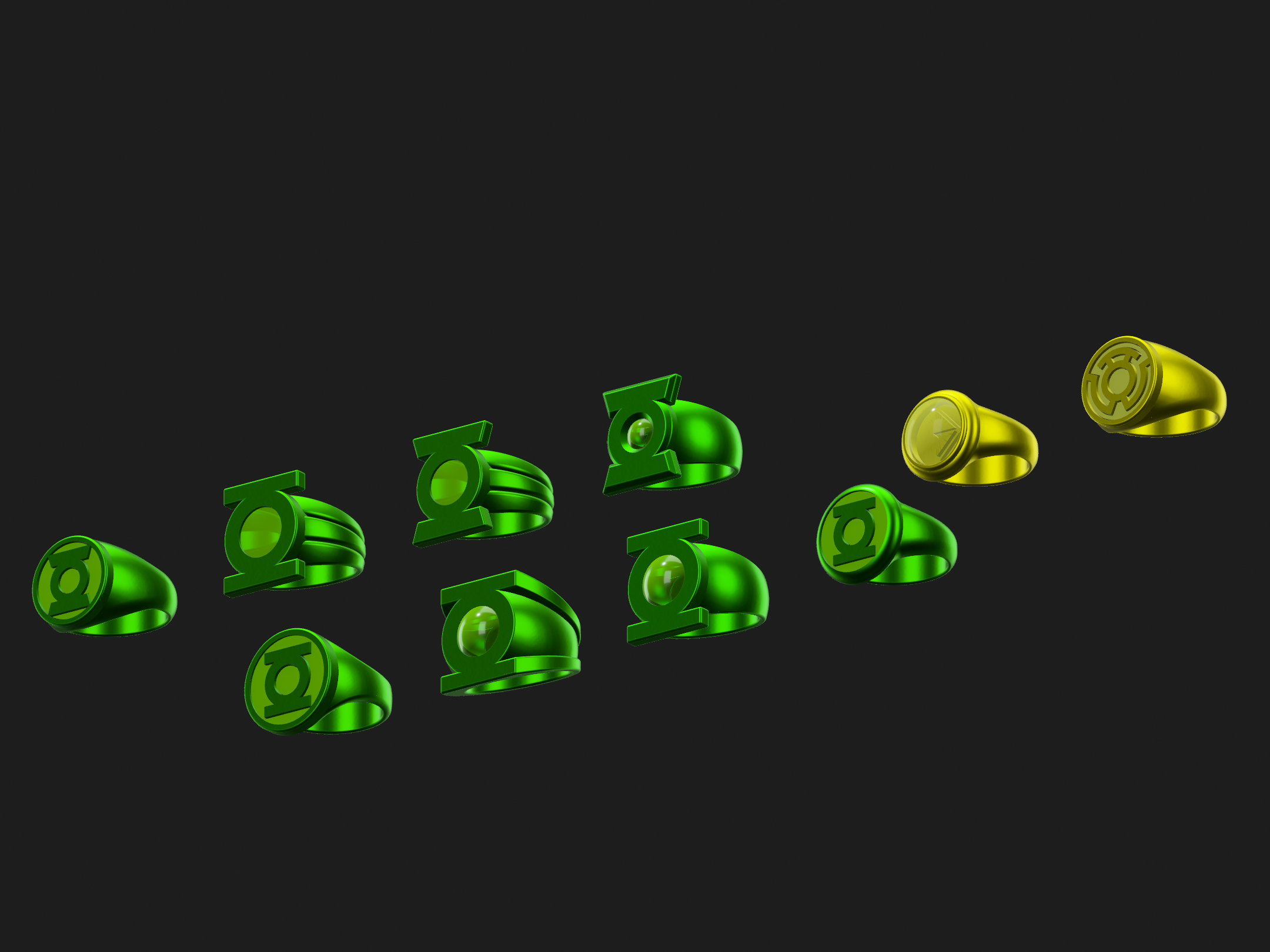

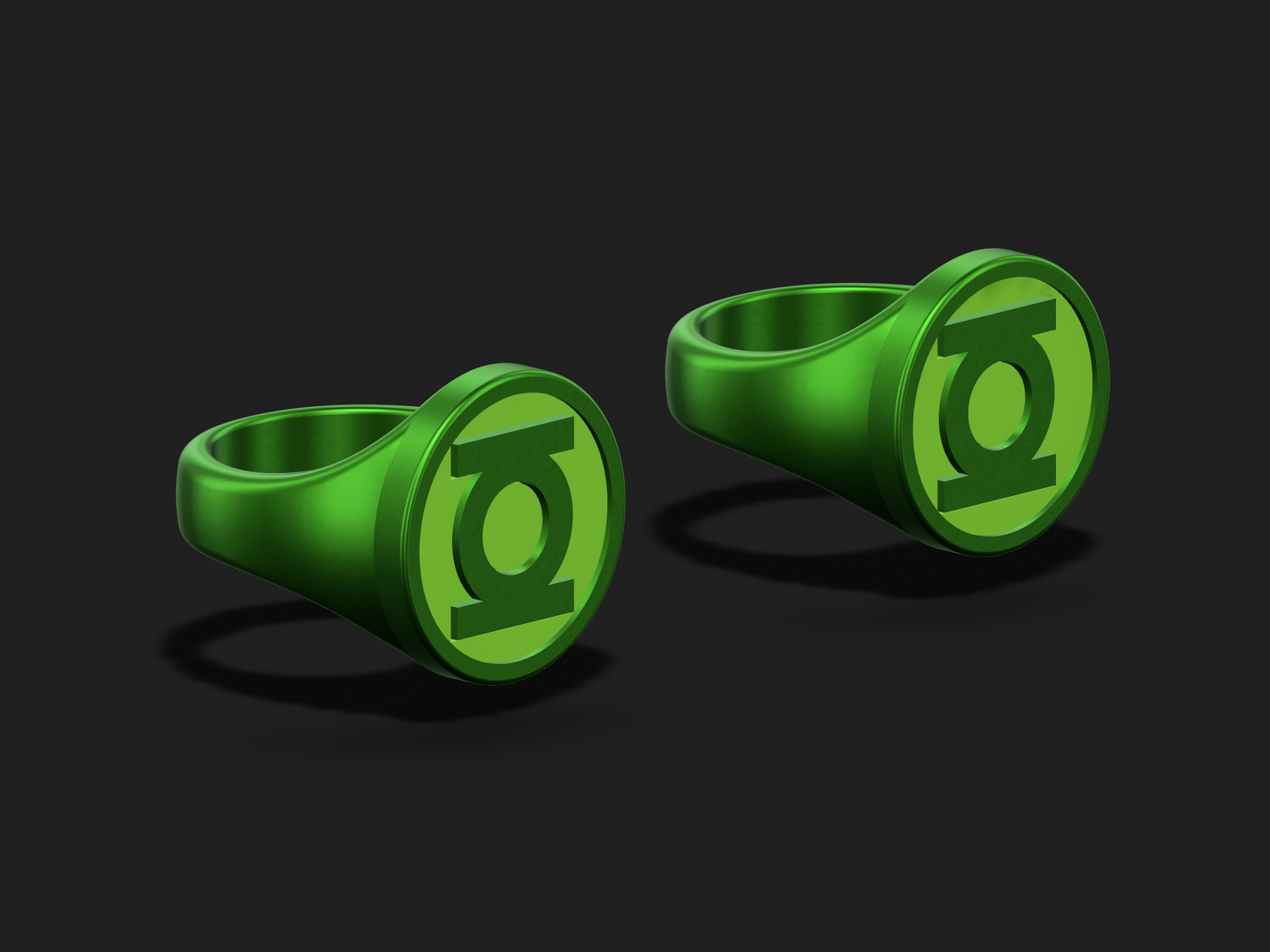

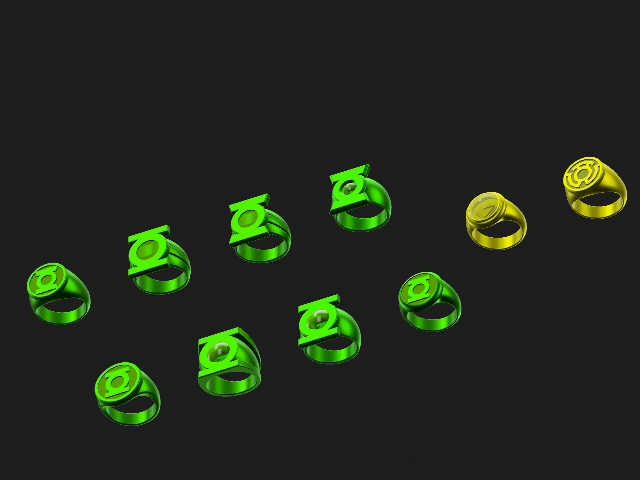

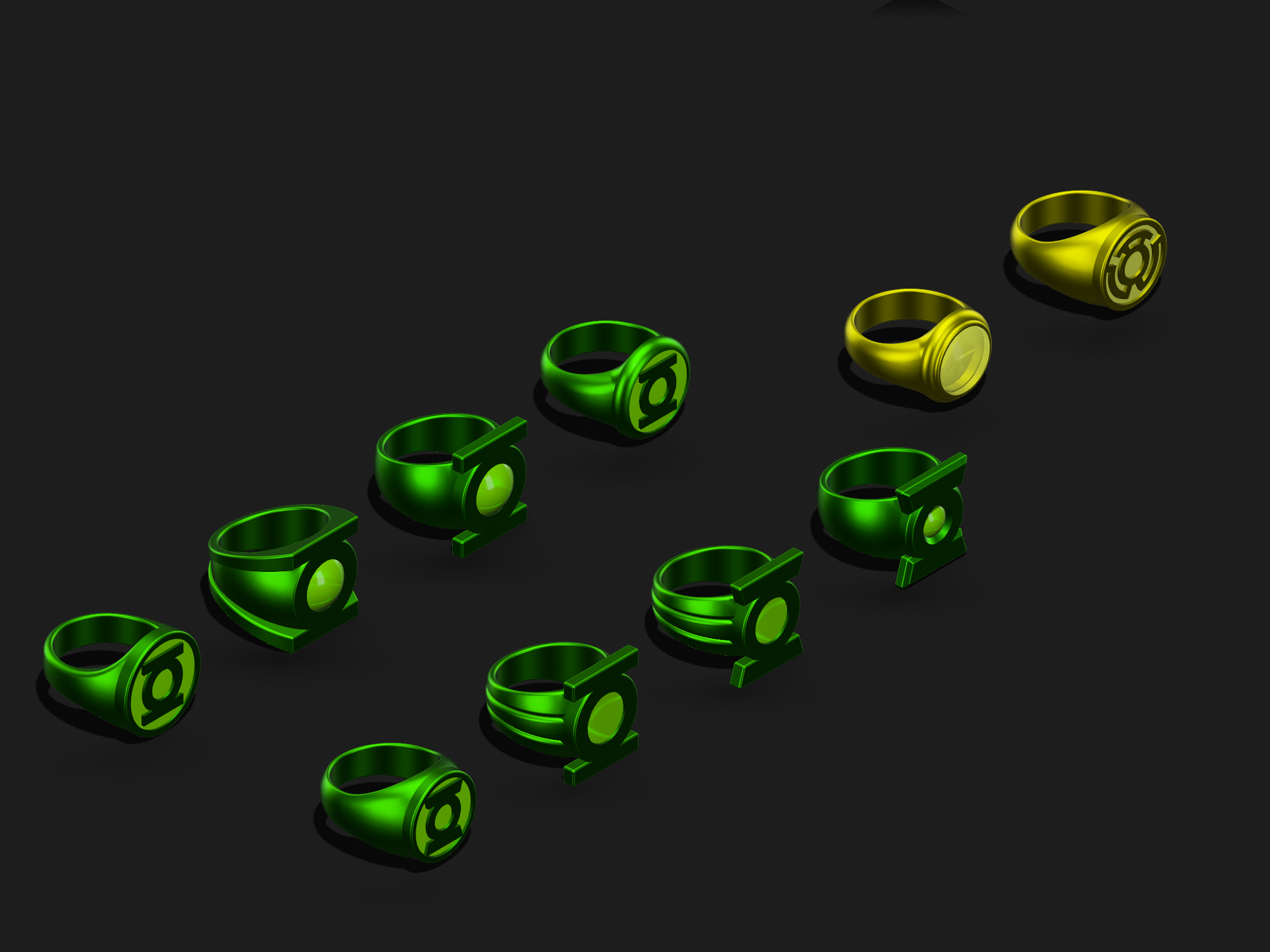

Updated the showcase (See what I did, there?) with the current models for the V1/V2/V3/ED/Gardner. The V2 and V3 are now the 24mm versions, as well.

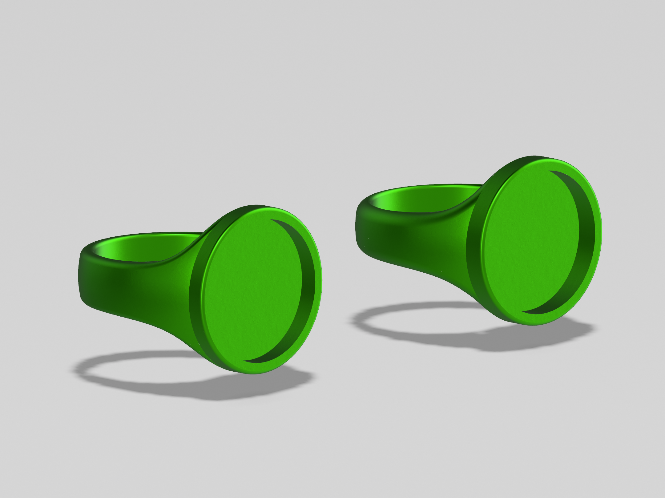

Nitty-gritty tweaks. Here we have the V2 as last printed (left, 22mm symbol, 3.5mm thick, 1.0mm between the finger-hole and the bottom of the symbol), a version with a 24mm/3.5mm thick symbol, but less space (0.5mm) between the finger-hole and the symbol, and a hybrid version (24mm/3.5mm, 1.0mm space).
I tend to think the middle version looks a little squashed. Leaning toward a taller symbol at 3.5mm, but the extra space between the hole and the symbol could make the ring a bit too high-profile. The one on the right ain’t bad, though.

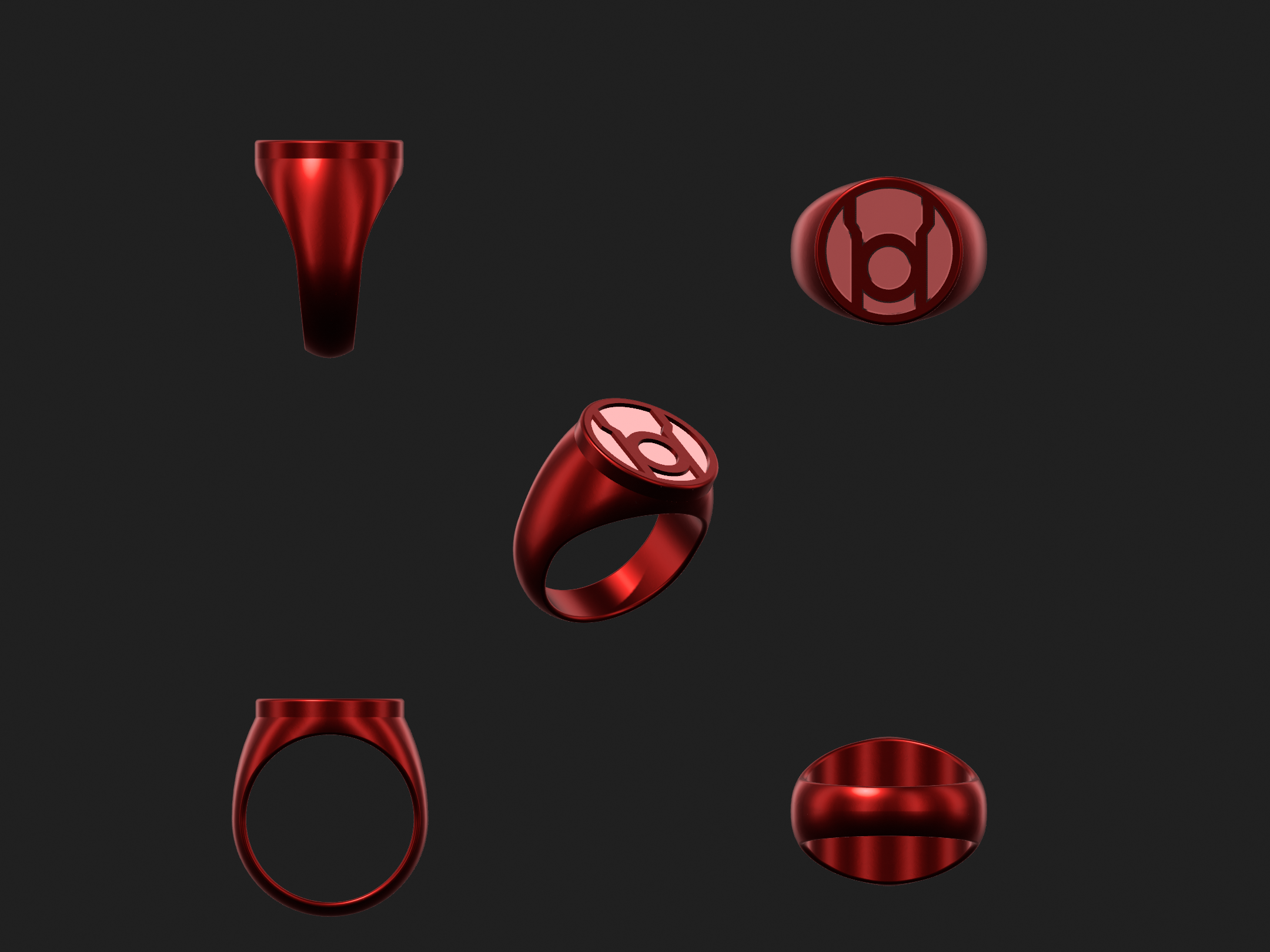

Made a minor tweak to the REBIRTH/Sinestro Corps design. Up until now, I was using splines for cutting the curvature of the band in profile view. I replaced these with arcs, instead. They look virtually identical, but now the curves are a mathematically consistent and precise 25 degrees each.
