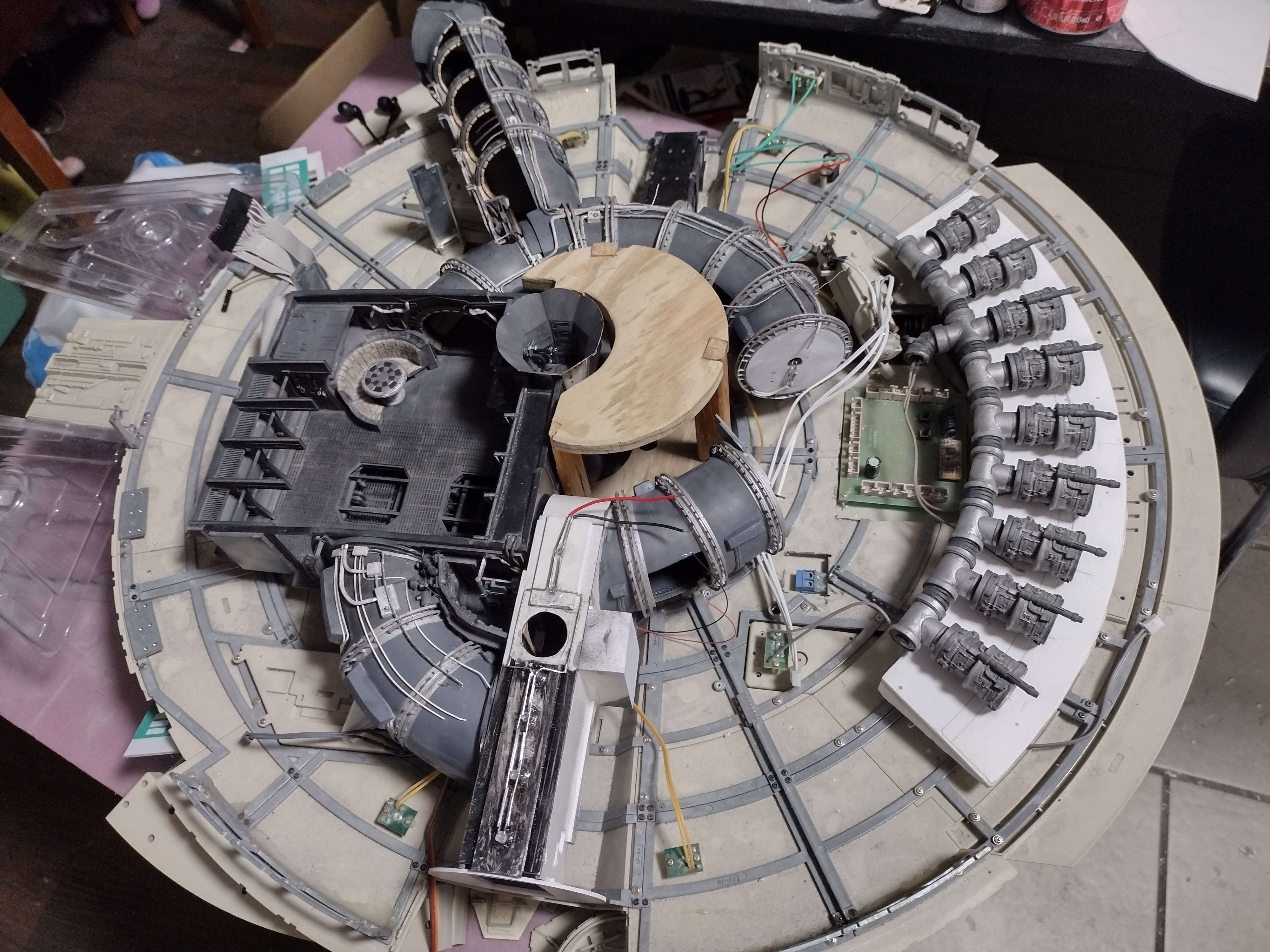

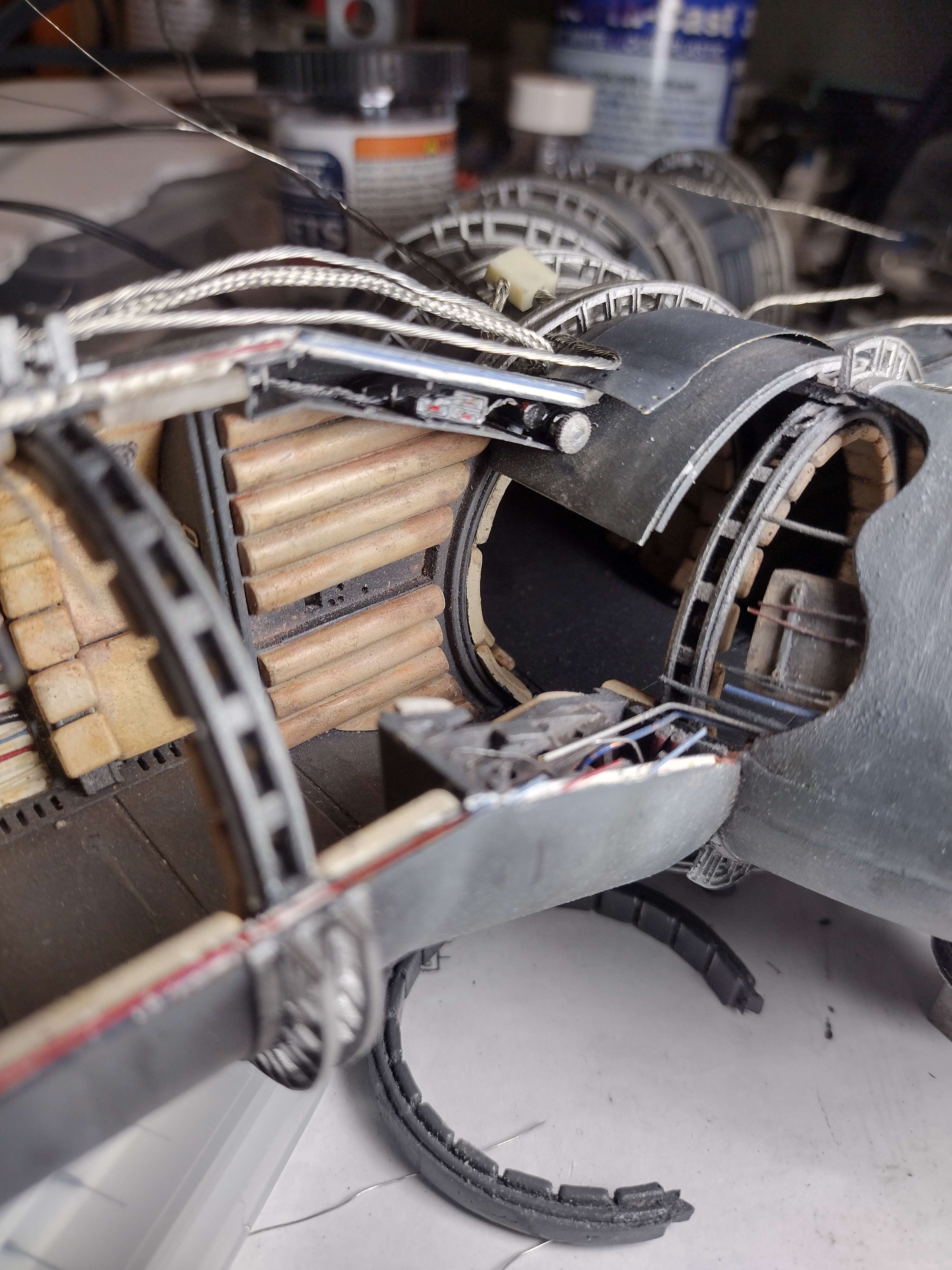

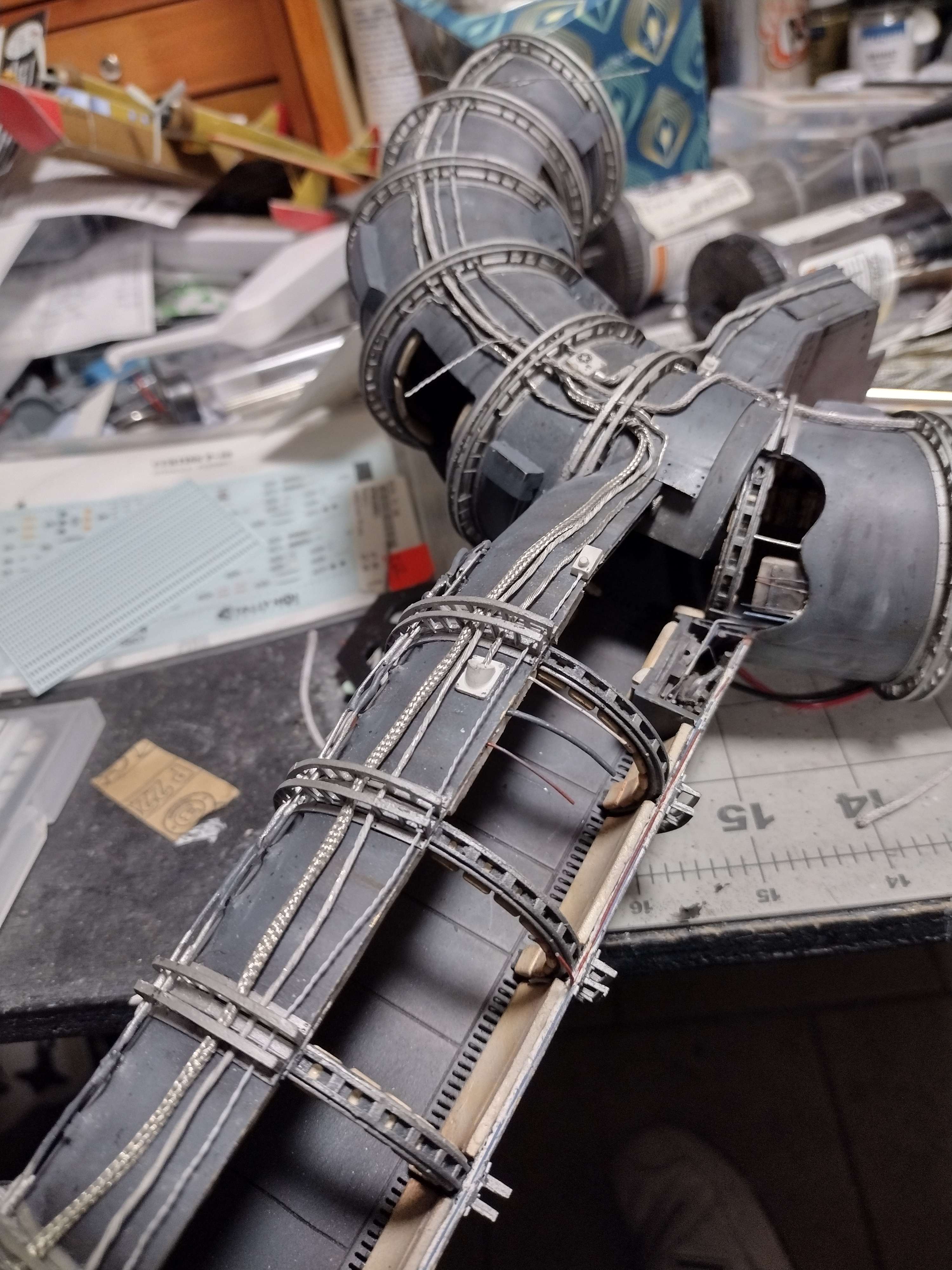

After that, it was time to move on to the transverse corridor. The first thing I needed to do was to figure out the dimensions of the corridor. I wasn't going to have a repeat of the Cargo Loading Room Incident of 2023, so this time around I decided to be a lot more careful and actually build the room's wall panels by fitting them to the existing sections. This did require me casting multiple copies of the standoffs that are mounted under the corridor, of which DeAgostini nee Fanhome only provide one, but after I got them mounted to the underside of the corridors and then pins glued to the interior of the hull that they fit onto, I was ready to do some cutting and fitting. To make things easier on myself, instead of trying to get the hole that the portside corridor fits into sized perfectly, I simply cut the original main hold wall that I'd glued a Shapeways ring segment into, separating the socket from the wall and then gluing that to a piece of styrene which was cut to the desired interior height. I then used the engineering corridor's location to determine where I should cut the end, and then after that I cut a duplicate for the other wall, then cut the floor and ceiling panels. I used a piece of ABS piping that was close to the internal diameter of the corridors to form a piece of curved styrene for the end of the corridor, then I added clips to the sides which would hold the panels together while I worked on them in order to ensure everything fit together smoothly. Before I did any further work, I stopped and cut open one of the circular greebles on the portside docking arm, then assembled the corridor, put the outer hull on, and inserted a pencil into the hole in the top to mark where I should cut open the ceiling for the top hatch elevator mechanism. After making some internal ribs for faux framing, in order to match similar elements in the main hold, I began detailing the panels.

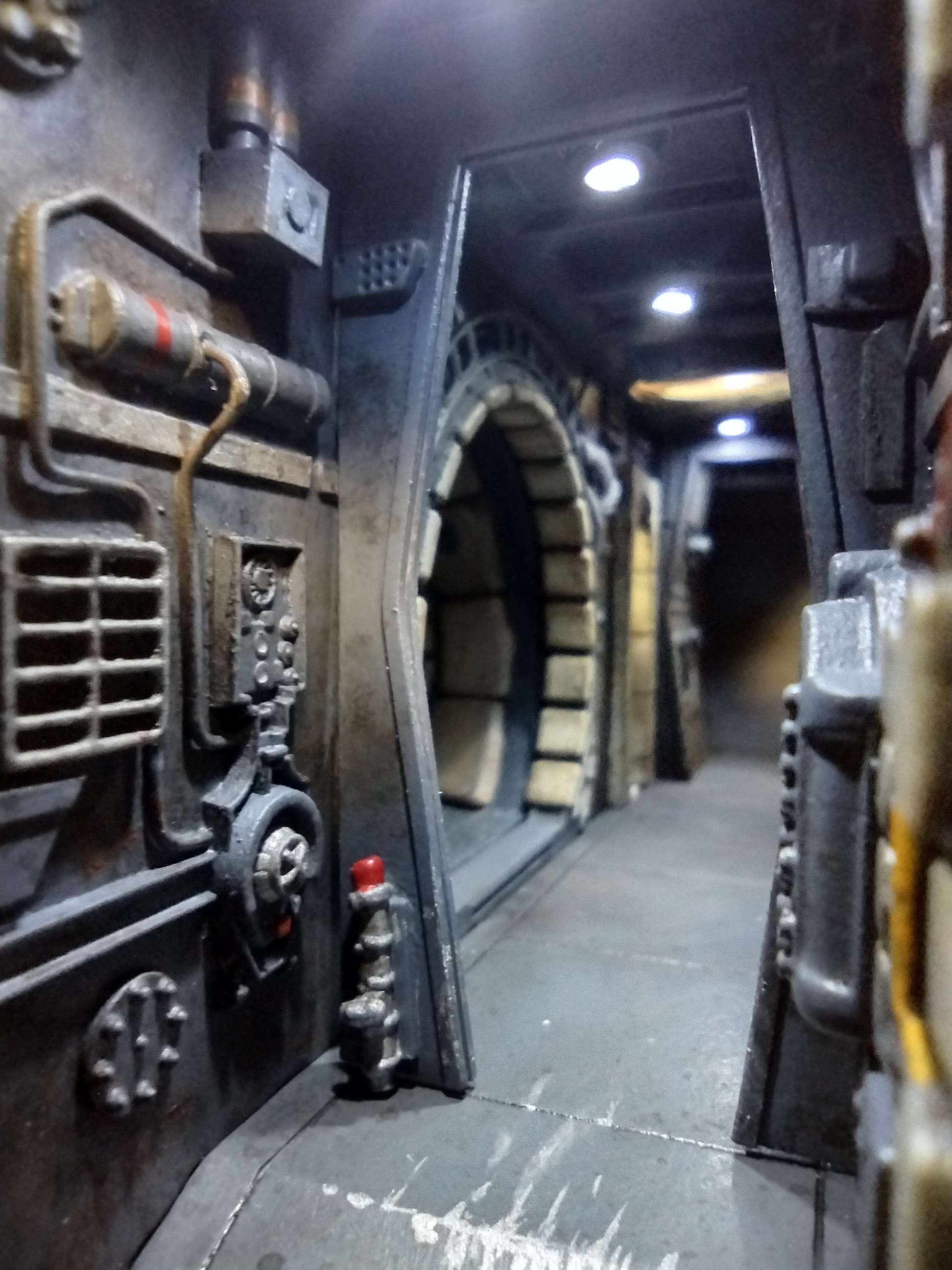

I also wired in some LEDs into the ceiling lights for interior illumination.
When all the detailing was complete, I painted the interior panels, then weathered them using the same techniques I used on the main hold, including spattering with black oil paint to break up the surfaces.
