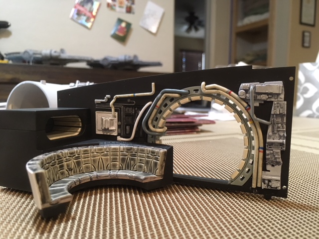

So the interior of course looks too toy-like and the detail on the pieces that are there are bleak. I'm not going to go nuts with it, but I added a few things to busy it up a little, probably do more before it's over. I did order the game table (drilled for FO) and the grated floor from 308 bits. Along with a few other things. Interior not film accurate by any stretch, but it'll still end up looking better than a toy. One would think for 1200 bucks this stuff would at least have the detail of FM, if not PG. Have to say, I'm pretty disappointed with it so far. I thought about selling it before I started, but too late now. Follow thru...and I'm sure I'll have to get more Shapeways, much more...before this is over.

Internally I ended up using the Paragrafix Hold & Corridor sets. Shapeways for items I couldn’t scratch - cargo, hold chairs, tools and light fixtures and the small component piece over the maintenance (kissy room)..., everything else seen was scratched and/or modded.(y)

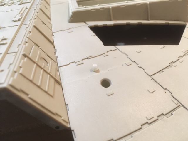

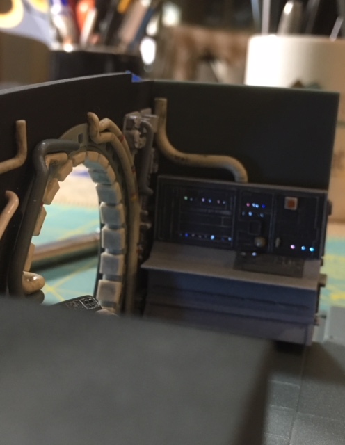

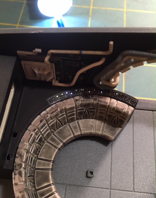

Not too much, but I managed to stuff some FO in a couple of the appropriate places though it doesn't quite light as well as I had hoped. I used .25 and probably should go with .50 with a bigger mushroom at the end. Anyway...It's clear that I'll also need Tony's corridor floors. There's no way to light the edges on the stock pieces and I don't feel like slotting them, take way too long.

Hall floors aren't too horrible...40 bucks...but I want the cockpit corridor as well...but 150 is a big pill to swallow:eek:

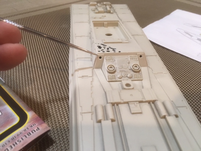

Had a box of SW goodies show up today so I pulled the rear gear panels back off and the front lower jaw. Drilled for the red hazard lights, drilled for all the smaller sized landing lights. mapping those was a bit tricky due to the metal framing but it worked out pretty well. The chopped pieces of MPC locators for their hulls that I saved were the perfect size for my landing light cans...it pays to not throw anything out that looks like it could be useful.
I planted my hazard lamp fixtures with the CA glue of course. I gotta say, it really annoys me that regular model glue doesn't work on this kit. I took an old fine tip paint brush that the bristles were all gone, (didn't throw it out either) and poked it through the holes from the inside to line up my lamps while I glued them down. thus insuring when I get the 2mm post style red LED's they will go in without any trouble.
Once I had the lamps fixed in place, I screwed the panels back in place temporarily and shot the lower with primer. There will be many more greebs to be added later but I wasn't going to try to dig for them now. Got the cockpit pieces I deemed necessary and probably start that soon. I have corridor floors coming so all those other pieces were by-passed for now. Also got the main hold floor but didn't realize the two opening grates were separate. Have to make a 3rd SW order I suppose.
