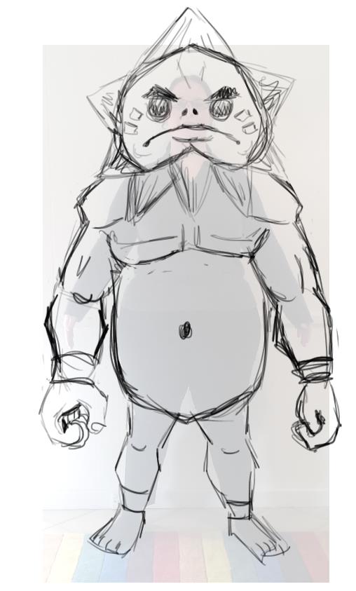

That sorted, I've done a derpy looking proportion sketch to make sure it'll work. Gotta shrink the head slightly and play with the arms so things line up better, but I'll definitely be doing arm extensions. Not sure if I'll build or purchase them because building something mechanical isn't my area - but if all else fails I can easily whip up some static ones, no sweat.

Rough proportion sketch:

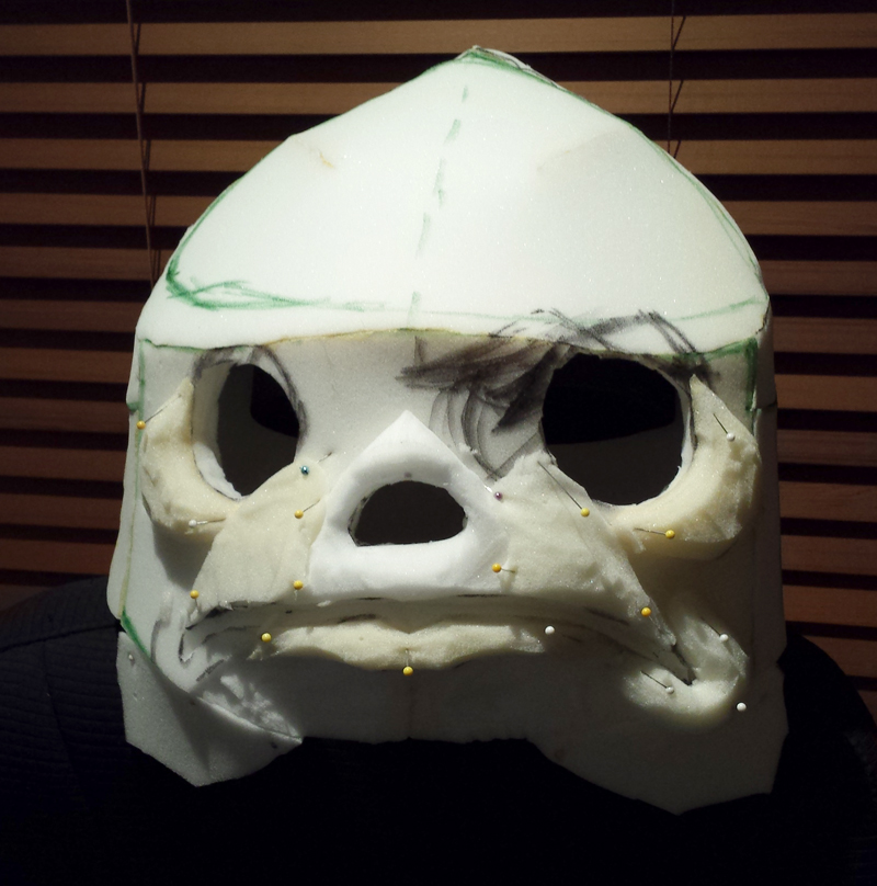

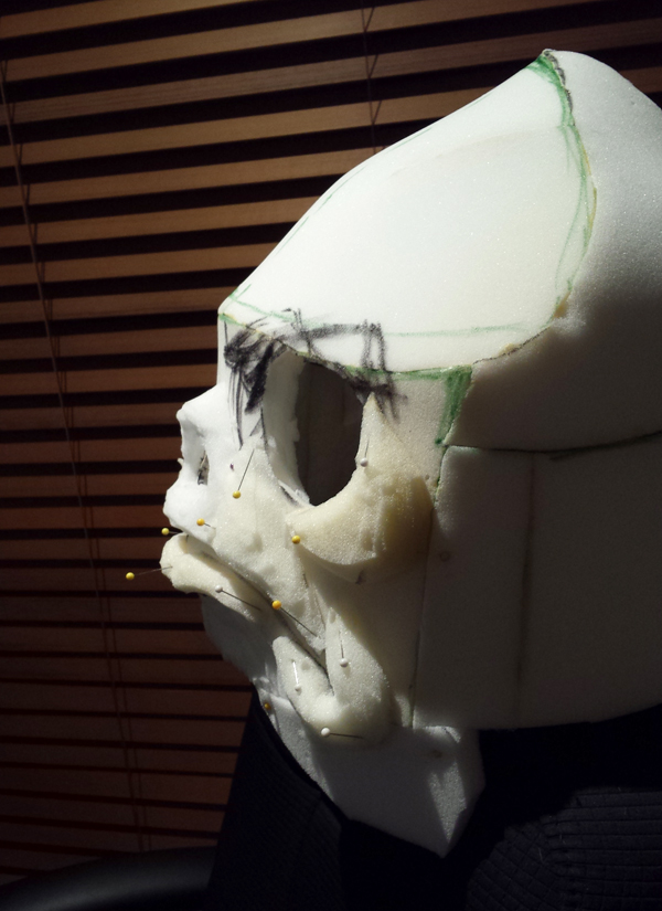

fallimar

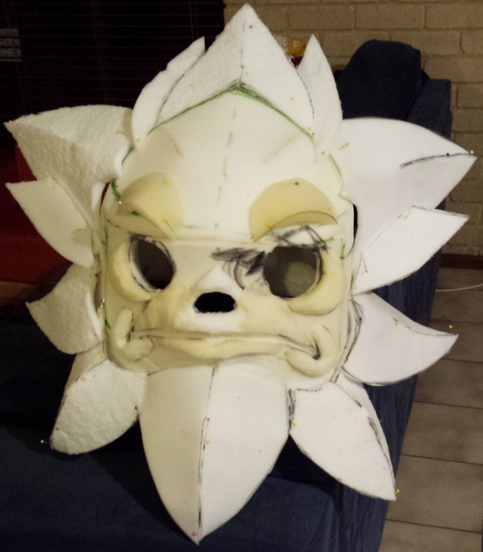

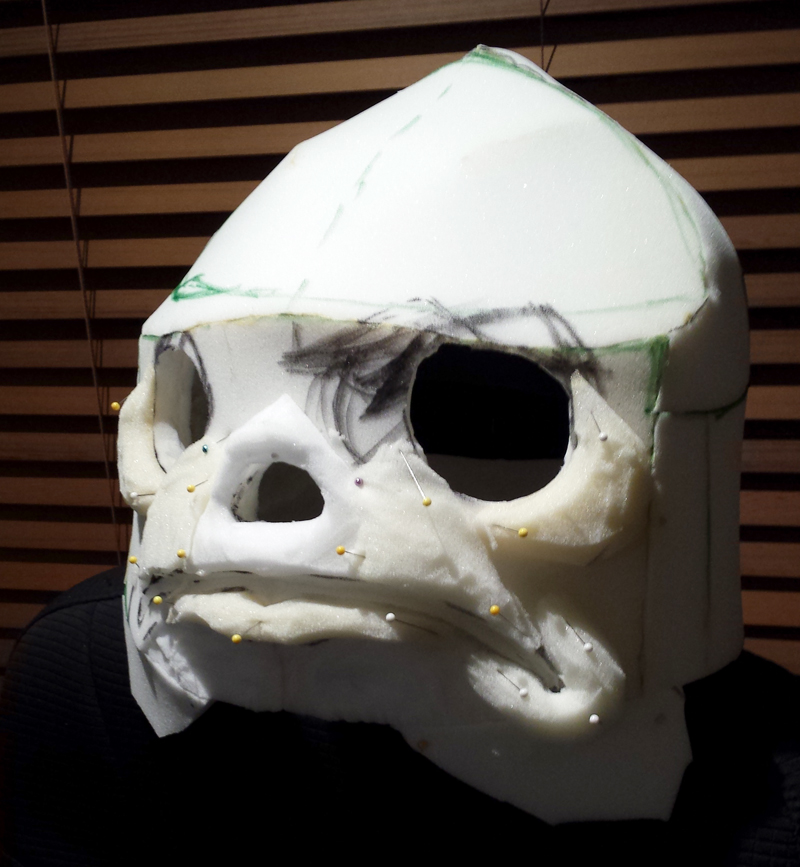

I always seem to start with the head. Roughed out a foam base, cut eye and nose parts for reference, now I'm blocking in features.
After this I'll trim the head into a better shape and stat adding the beard/hair understructure.
I'm still unsure what I'll do with the eyes, but the nose is open because I want to have that as a frontal vision port, so the nostril distinction will be done with paint only. Shouldn't be horribly visible, if it is I'll add a little definition with thin foam, but I'm hoping not to have to.
So that's where I am right now - did a quick paintover of the second pic to see if I like where the features sit - looks like it'll work just fine so far:

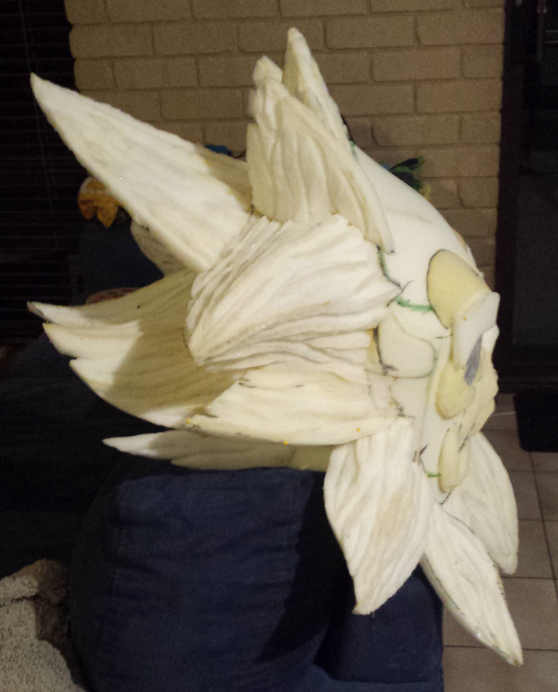

True! Darunia has a massive, massive head o..0
In other news, I spent this afternoon thinking about how to do the hair eventually. Still not entirely sure but for now I'm blocking in the basic hair shapes. I have to cut them down a bit and then figure out how to add detail in the way I want to.

fallimar

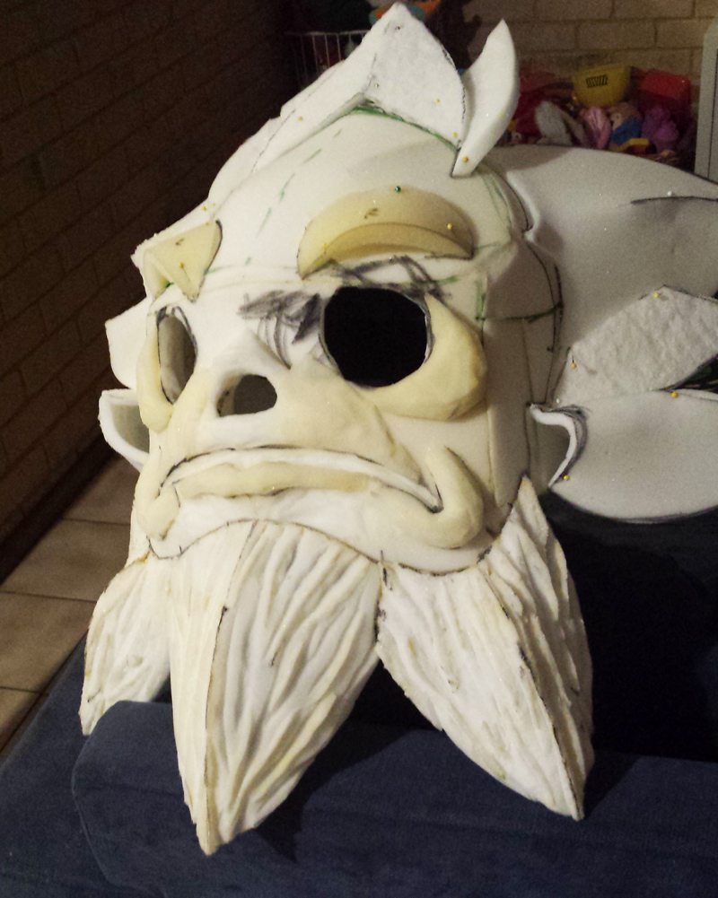

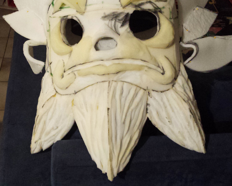

Fixing hair placement and texturing the beard. I'm just using a craft knife to cut channels into the foam to represent clumps of hair and gluing some of the strips that are cut out on as high points. Seems to be working. I'll see how it looks with hair over it as soon as my braids arrive.
I'm continuing the texturing tomorrow, but it takes so long to do. Oh well! Once the front is textured I've got to go in and add pieces until the hair is all 3D spikes instead of just plates. Might leave the backs of the three bottom points open so they don't catch on the body, but the rest need to be all enclosed.

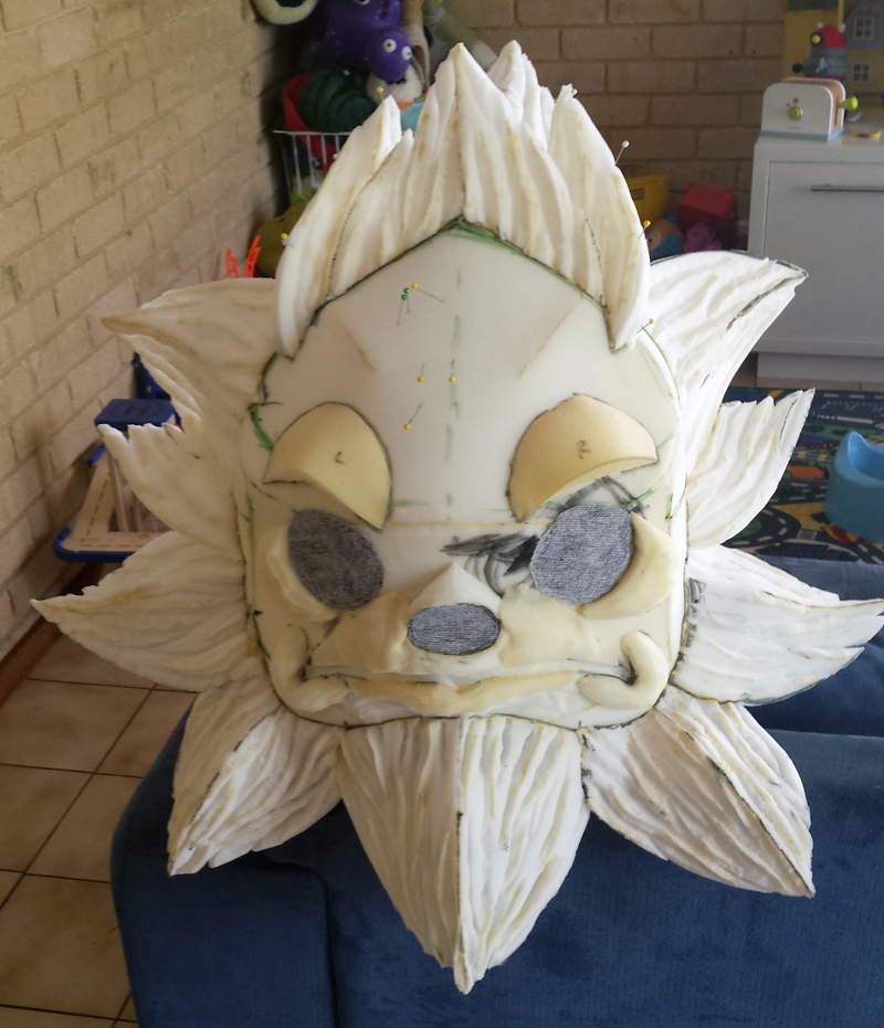

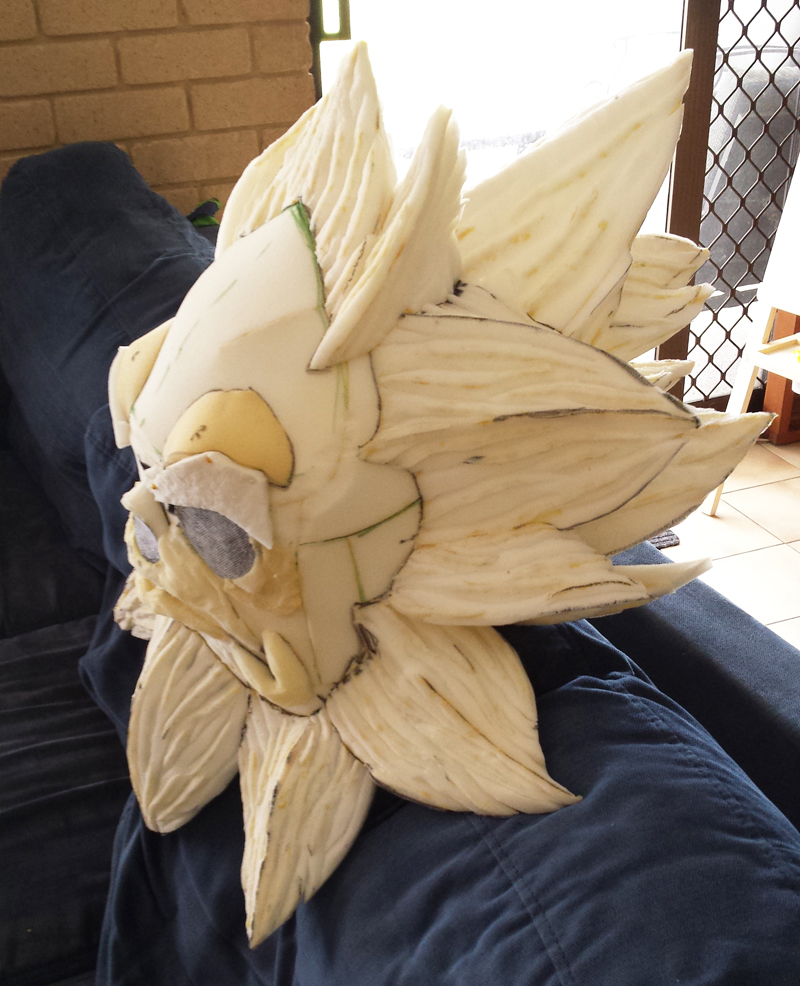

fallimar

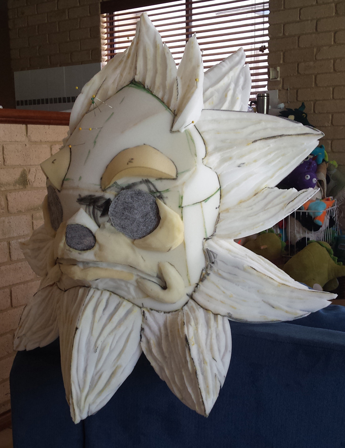

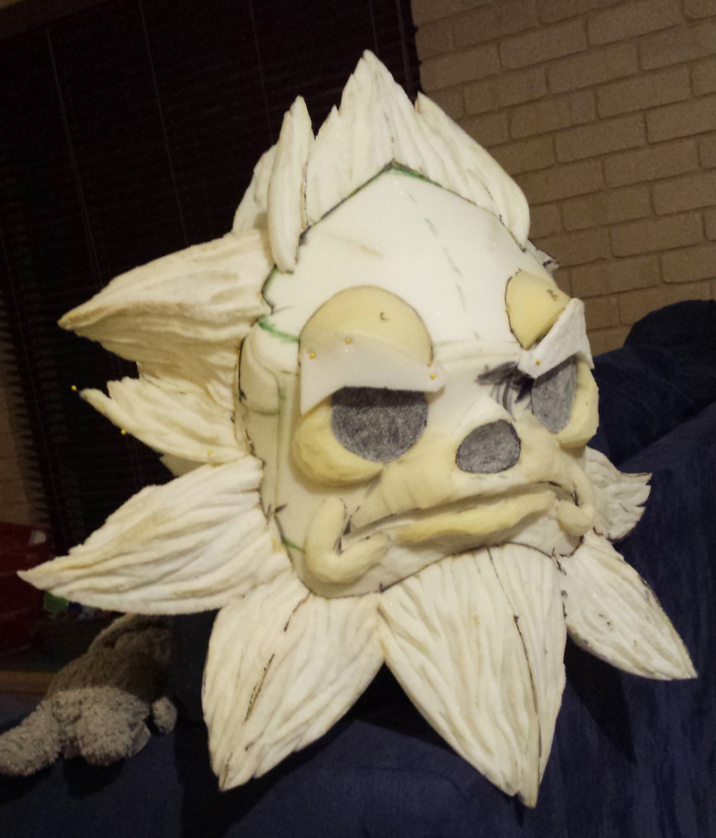

More work on Darunia - textured up the front parts of the hair, added more panels to the top and glued mesh into the vision ports.
Considering removing the cheek crescents and just rounding out the face more. I think his cheeks are lower and rounder in the games.

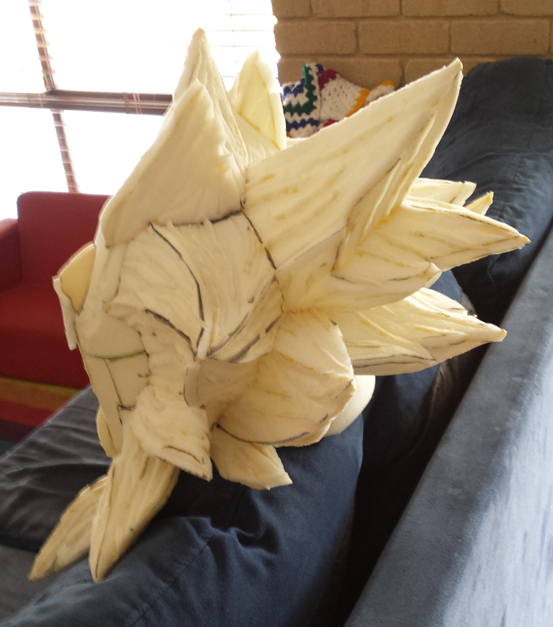

fallimar

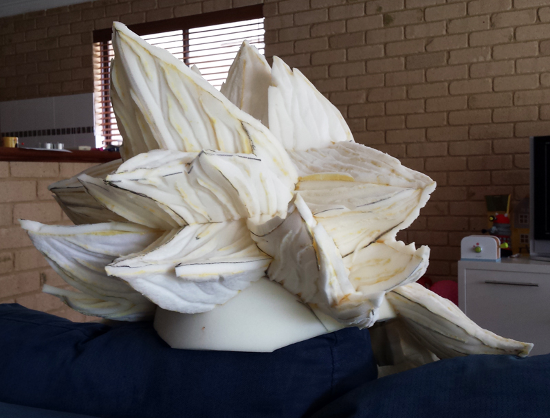

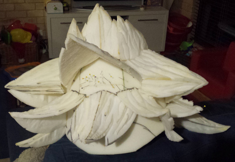

The hair is plodding along at a snail's pace - getting each panel shaped correctly, textured then glued in is a bit of a chore. Still, plenty done since the last post though it may not look it - I've been filling in the back of the head with hair spike thingies. You can see my little sacrificial pin forest in the last pic there, organised chaos. heh.
DaruniaHairprog1.jpg DaruniaHairprog2.jpg DaruniaHairprog3.jpg DaruniaHairprog4.jpg
fallimar
WAH! Finally!
Damn, always feels crappy when you've done so much work but it looks like no progress at all. The hair spikes are all 3D now, I've got one set of hair to glue down but the colour is a bit too blonde so I've ordered some white to mix it with. Once I have that I can start laying the synth hair on, then once I get the fleece I'll start laying the face.
