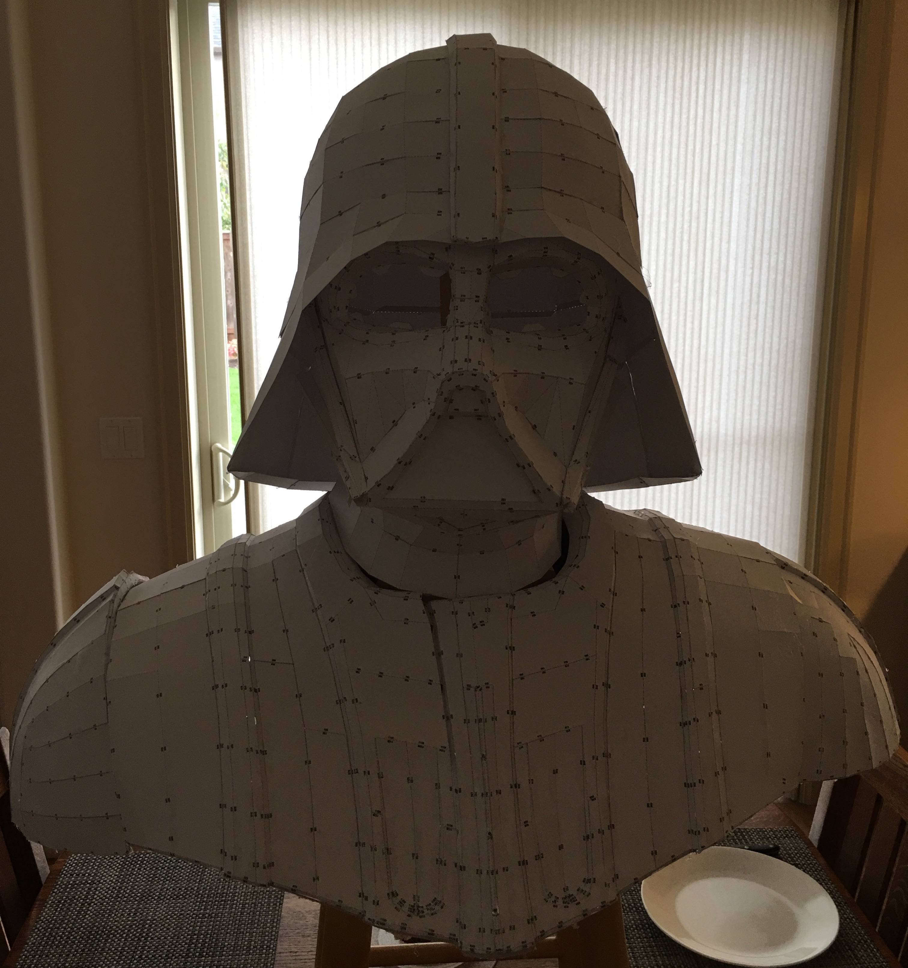

Okay big day today. All the peps are officially done. The shoulder piece was the most difficult by far, but I think it turned out great. The neck hole is a bit small but I've seen some people cut away part of the back and it works out fine since the cloak covers it. The leather under suit is about 40% done. I had a test fitting of the top today and it looks great so far, just need to make small alterations to it. Should be done in about a week. Next stage is resin the outside. I'll be working on that all this week as much as possible, exams are coming up so I'm working quickly and diligently.
I couldn't resist taping the pep together. The front of the chest is just taped for now so it may look a bit off

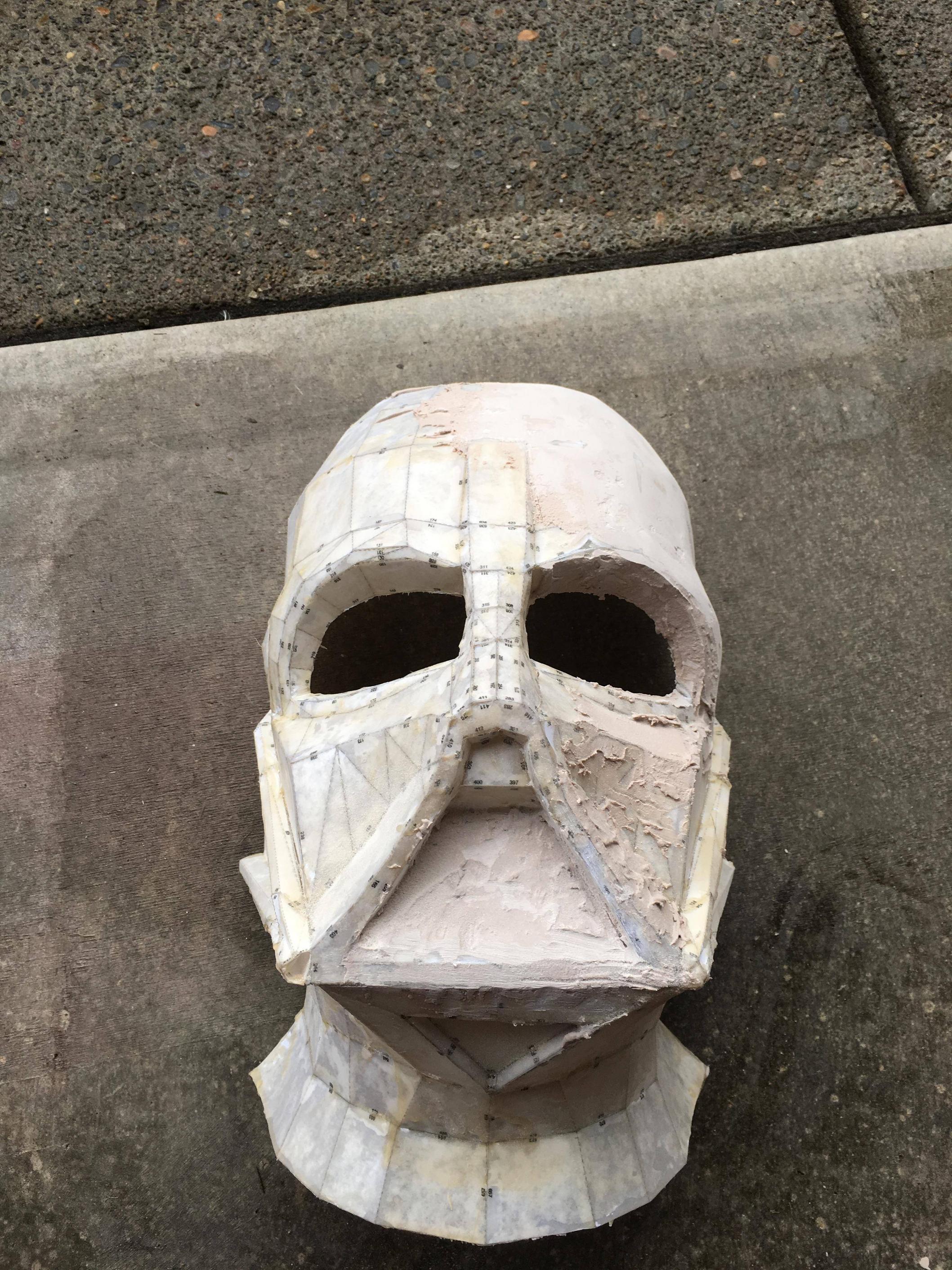

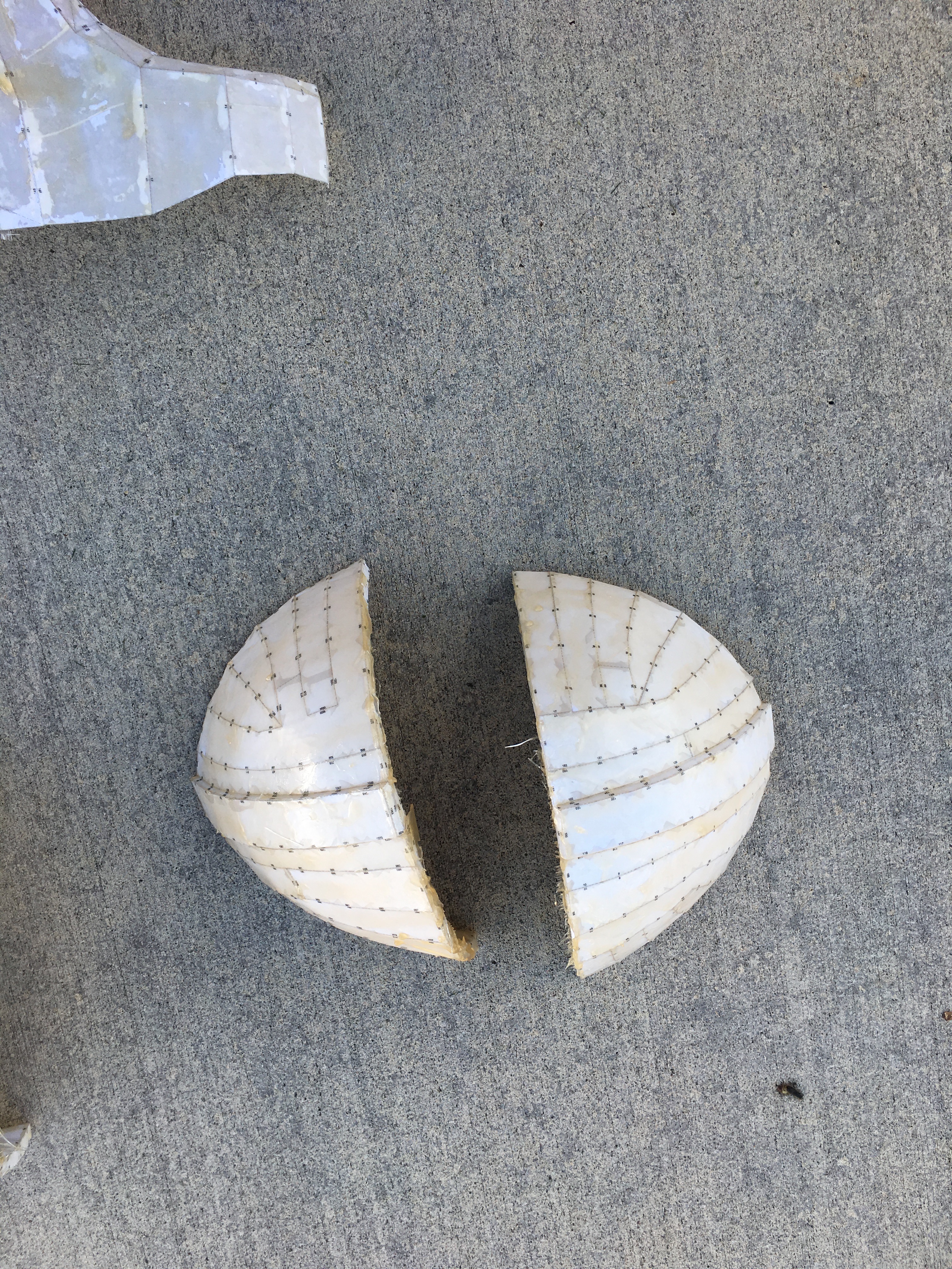

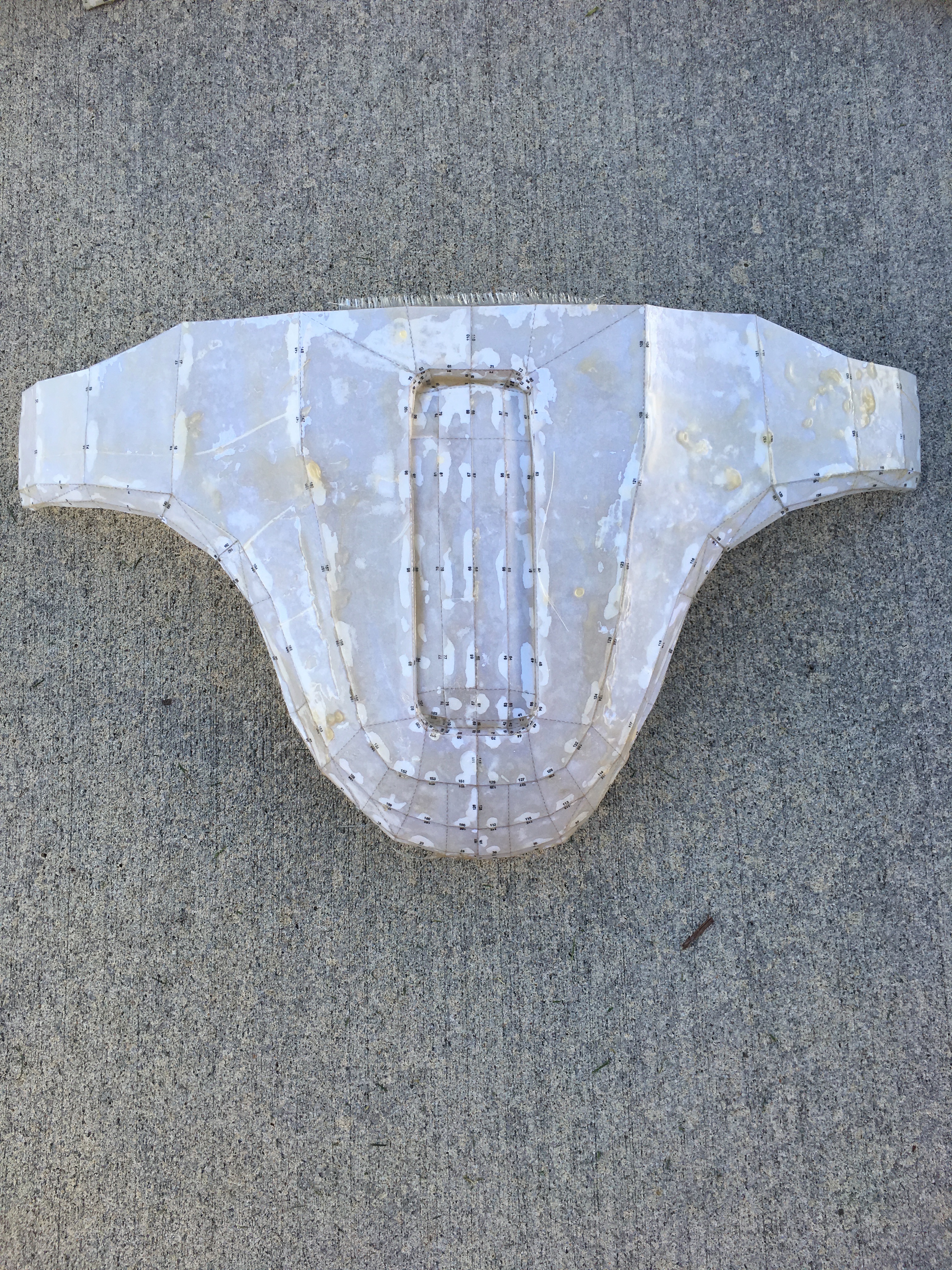

Here are some of the photos I took of the completed fiberglass parts. Since then (and not pictured) I've cleaned them up a bit with a dremel, cutting away overhanging fiberglass and filing down drips of resin.
Re: Darth Vader One Month Build
I finished cleaning up each part as best I could. I think next time I make any pepakura I'll probably use rondo instead. Here's a photo of the helmet cleaned up and ready for bondo. The helmet seems a bit unsymmetrical in the photo and proportioned oddly but it looks pretty even in person.
