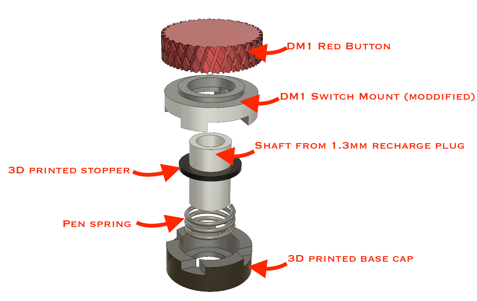

Hand painted emitters fins and grooves
LED bezels and rubber O-rings added to increase accuracy
TCSS DM1 infinity coupler
Custom 3D printed chassis in both sides
Dual Plecter Labs Nano Bisoctti v4 modules
dR/dR main blades with white FoC
The 3D printed chassis in each hilt is fully removable for easy SD card access as well as recharging. Two of the red buttons were modified with a plunger and spring in order to allow such a chassis system to be used.

Yup! I wanted to be able to split the hilt in two hence the two soundboards. Also Maul's saber is suppose to be two separate hilts fused in the center so there's that too. :)

Indeed I did. I model and print my own chassis parts.
