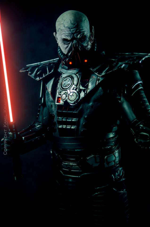

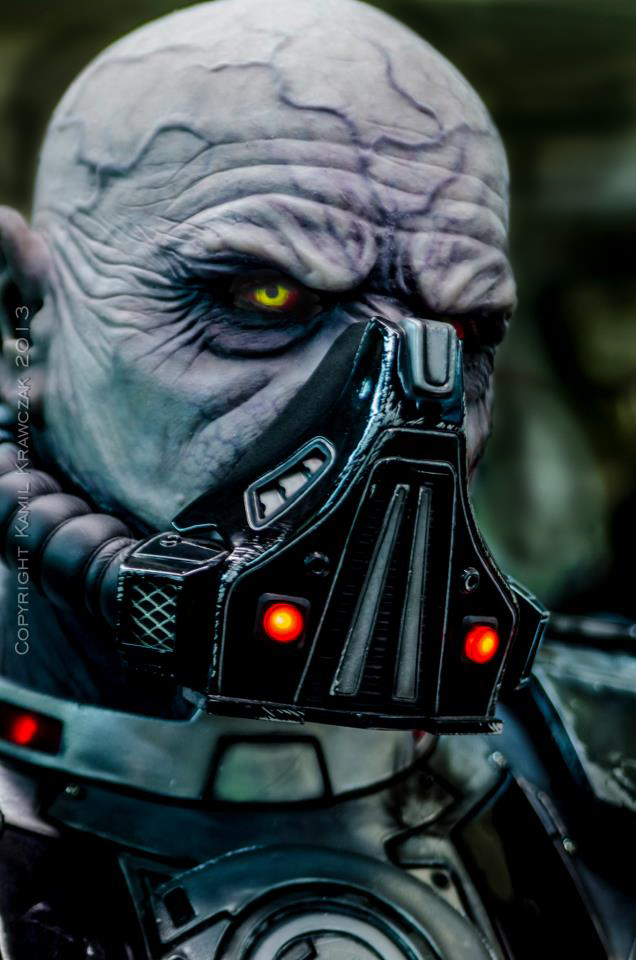

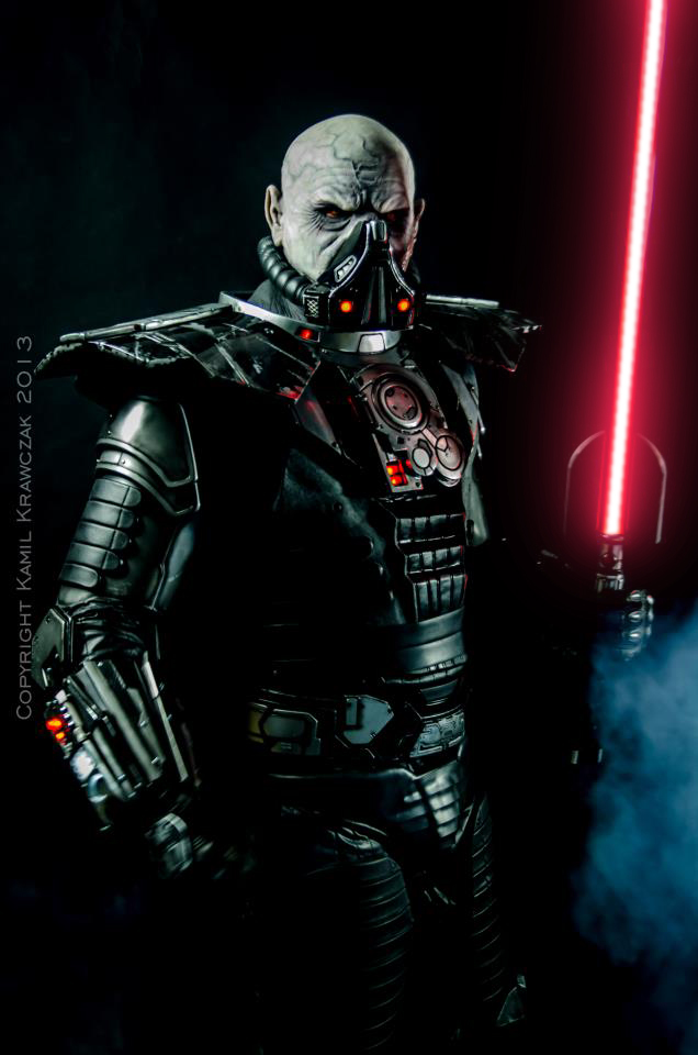

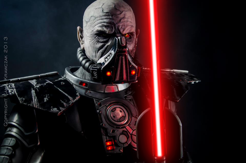

Latest update after the shoot last wednesday. The first FULL try on went better than expected with no major problems rearing their heads. The cape and hood were just temporary and are being finished next weekend thanks to my good friends Annas and Paul(DarthMac) who are coming down for a workshop visit.
Here are a few pics from the shoot.
Sorry I couldn't resist jumping on the band wagon and doing a 'Vadering' shot. (Except this is called 'Malgusing!' lol)
Im still waiting to see the film footage as it was all shot in RAW and proceesing that takes a long time I'm told. Might see a few seconds of a clip by next week. I'll post up a link then.
