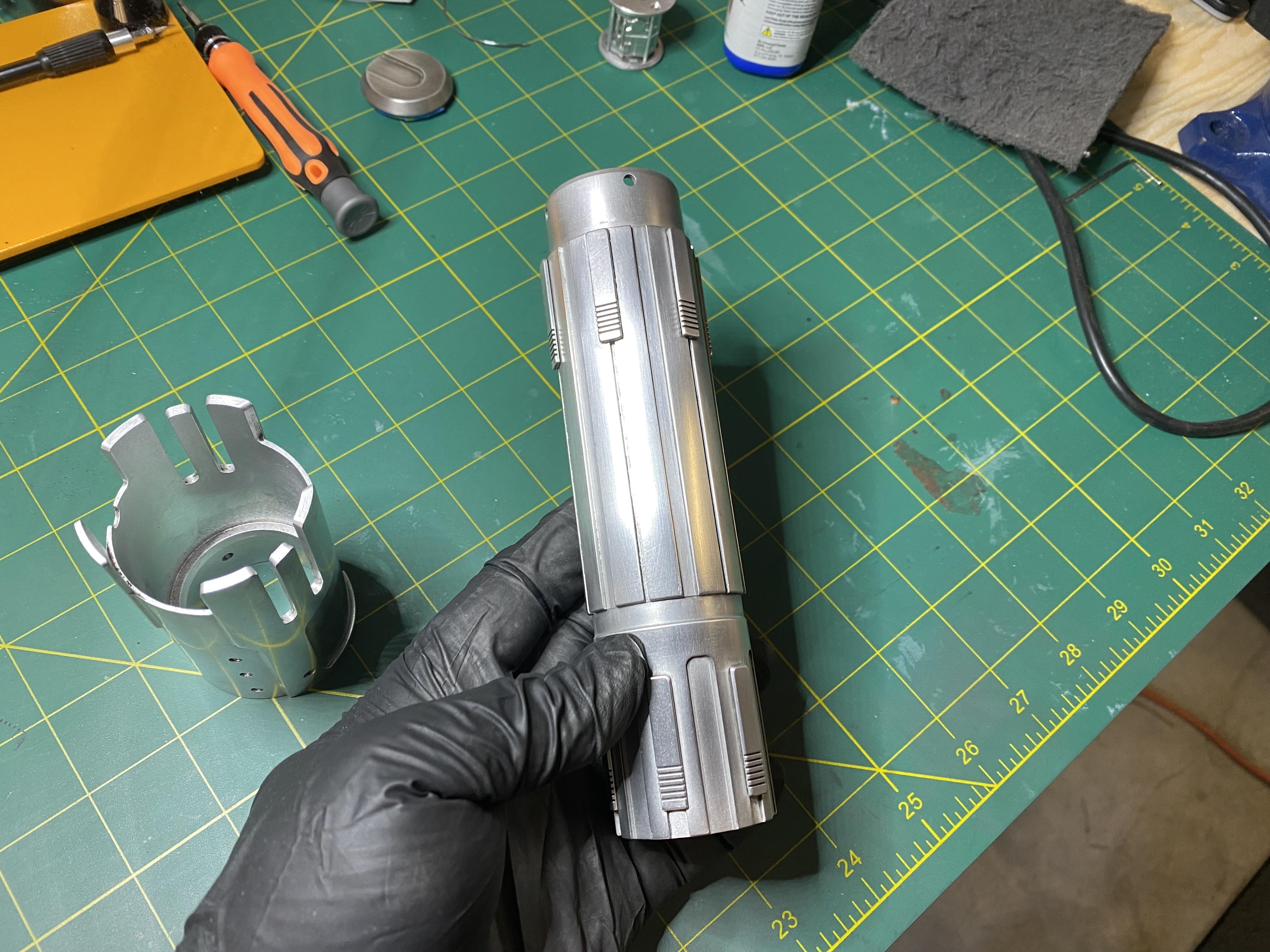

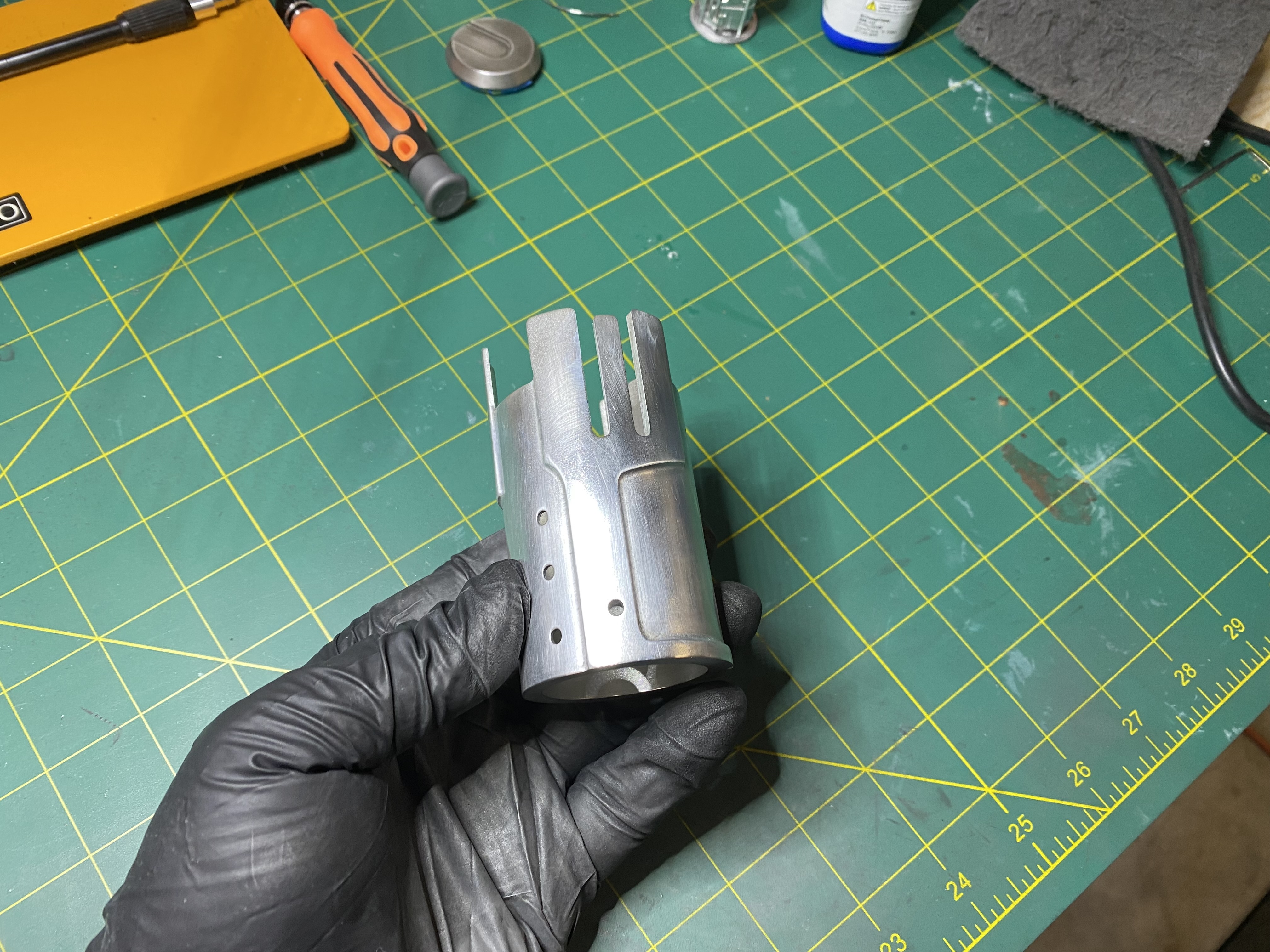

This was my Ben Solo hilt from Phoenix Props. Here are the two main pieces of the hilt after I cleaned them up for the Aluminum Dark bath.

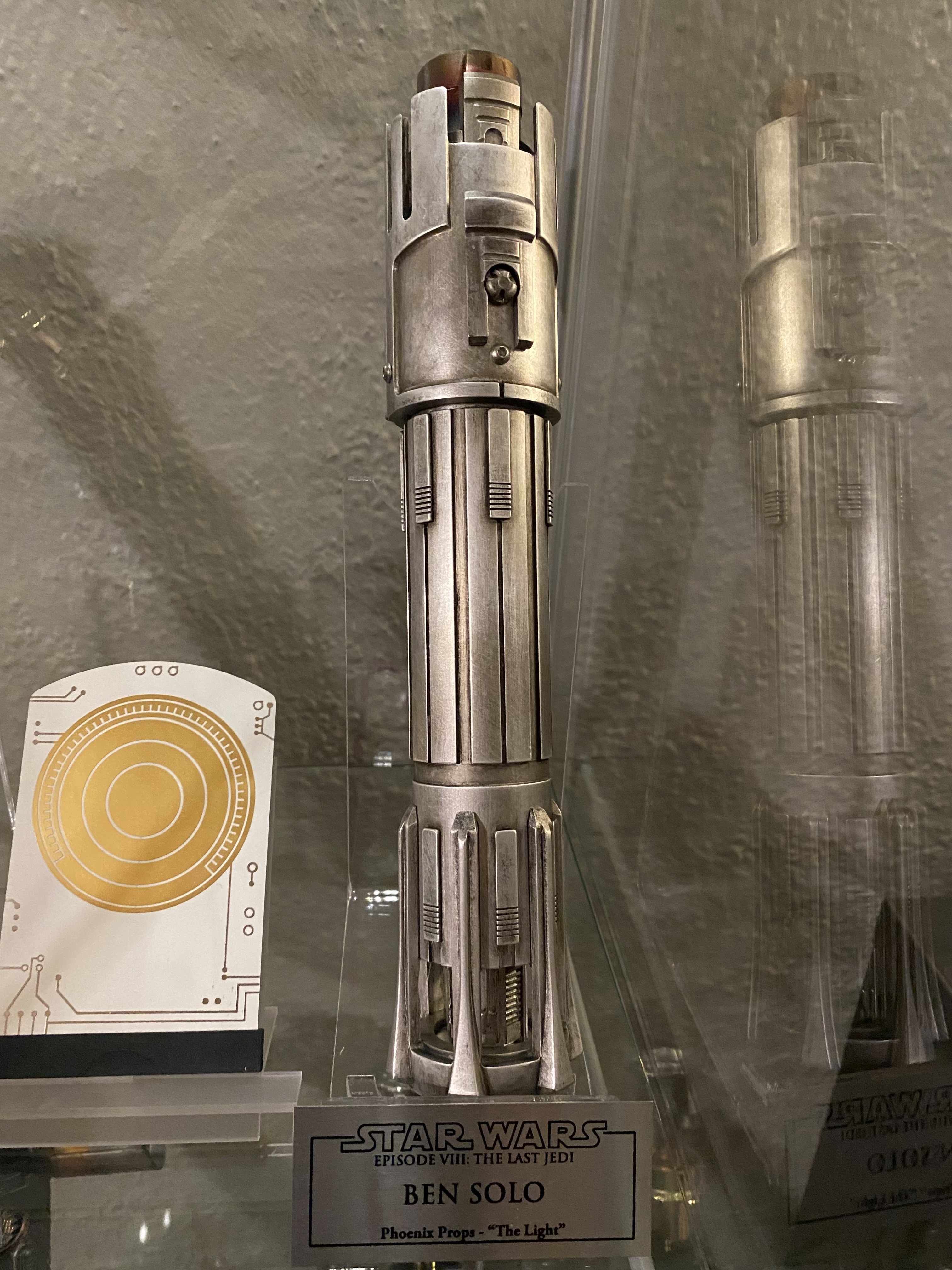

And here is the finished hilt in my cabinet.
Thanks to everyone who provided advice on this. The hilt was driving me a bit crazy so I'm glad it's complete.
Looks great! You'd never know it's aluminum.
Thanks! Using a very small amount of Aluminum Black worked really well. Previously, when weathering the hilt, I was able to get some nice definition but it still had the lighter gray color you see in the first pics. The slower changes helped alter the tint a bit even in the more cleaned up areas, which is what I wanted.
I like the effect! It aged it a little without killing the look.
Yeah, it changed the shade, which was the biggest thing I wanted. I weathered it a couple times prior to this and it looked nice, but just couldn't get the right look. Finally got the look I wanted thanks to the group here.
