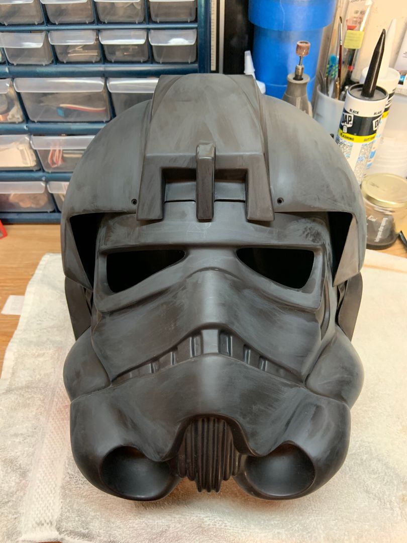

BIG Day - Scuffed him all up

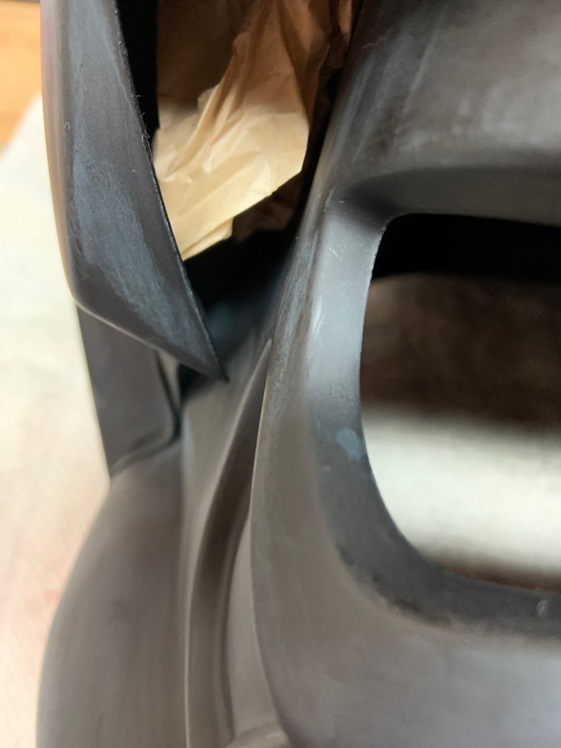

Packed him with some paper to space out the face from the head and mohawk so none of the pieces would stick to each other

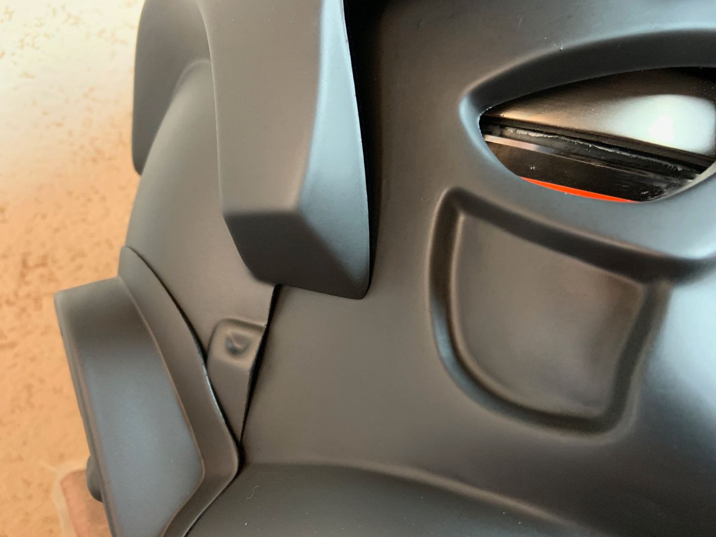

Sprayed him and it all looks pretty good! A few small pieces of fuzz, but no runs or flashing!

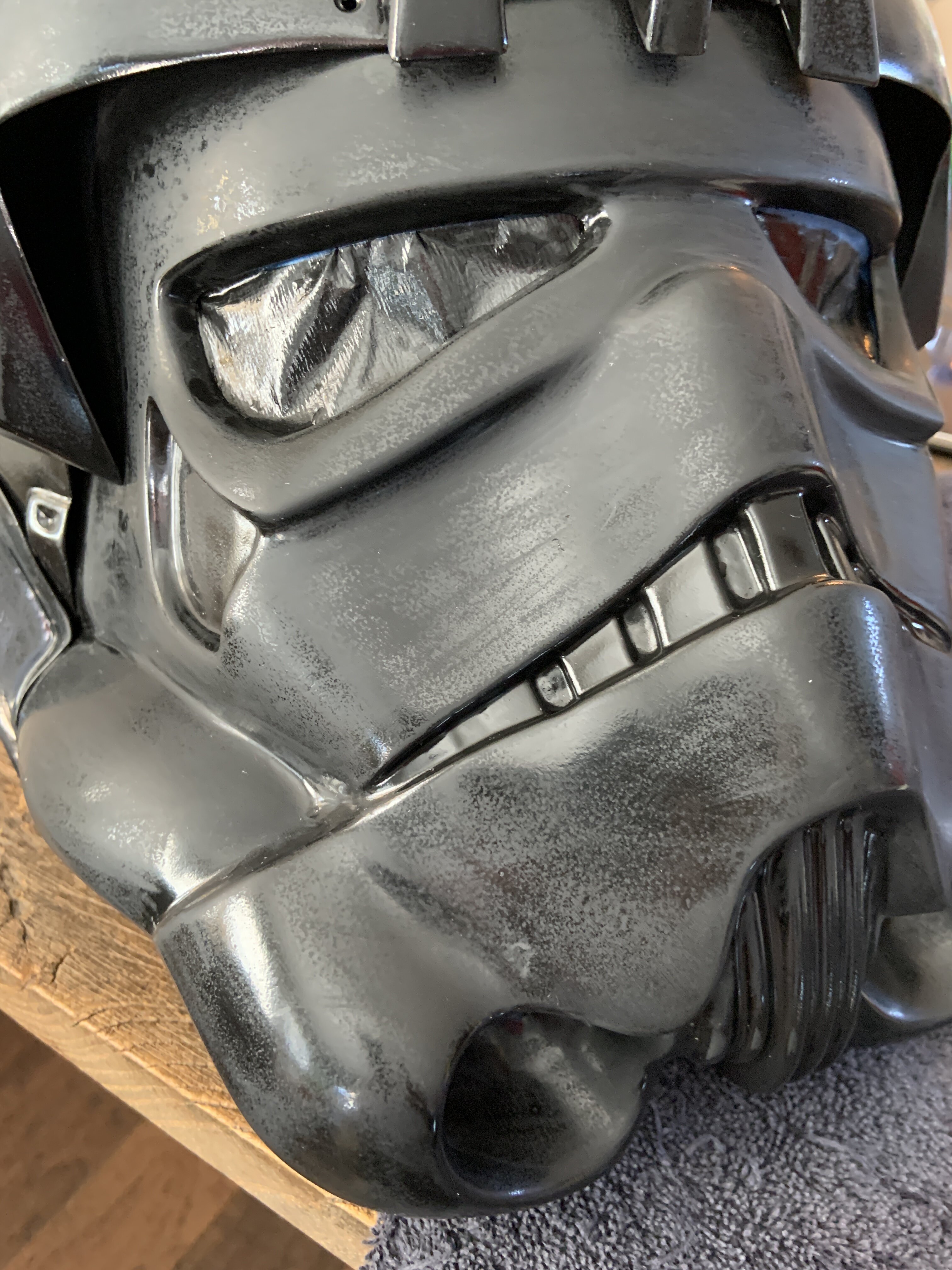

I've never tried to wet sand rattle can paint. So I gave it a go with warm water, a little soap, and 1000 grit wet paper. It worked great getting out the few runs and little imperfections in the black paint. No burn throughs. I gave Mr. Tie a nice warm water and soap bath afterwards. Tomorrow I'l re-tape off the eyes and put back the paper blocking to keep some of the parts of the helmet from touching each other, and clear him! I'm hoping all will go well....Here's his current state
