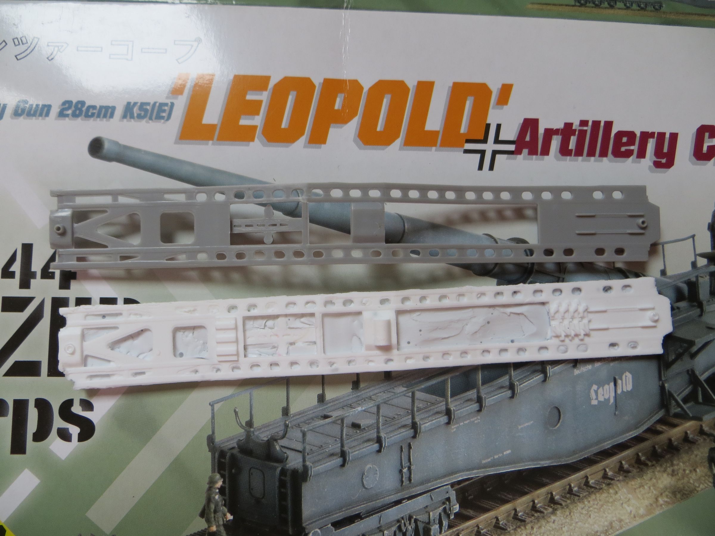

Because we can recognize this part, it is the floor of the WW2 Leopold german rail gun.
Here the LarsonDesign kit part next to Dragon kit one in 1/144.
On the studio model, this is the 1/72 Hasegawa part that was used (it can be found on many other ships of the classic serie, and also on some SW ships (many of the same modelers worked on the 2 shows).

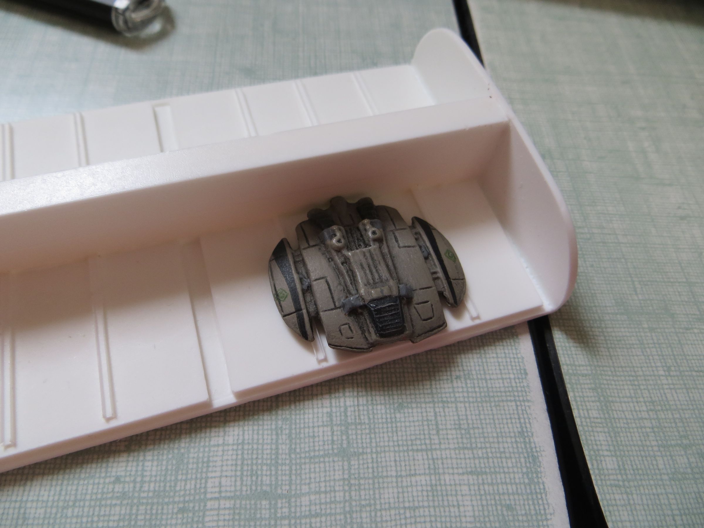

A little test with an old small mini metal model, from Comet Miniatures, to see if it could go in the bays, but it was too big. So I had to find another solution (scratch, 3D print ou papercraft model).

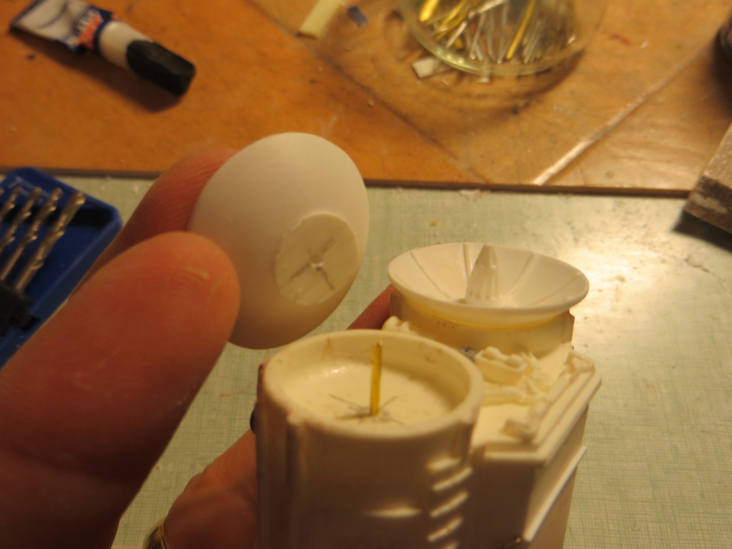

It lacked a little turret, it is redone. The guns are thin brass rods.

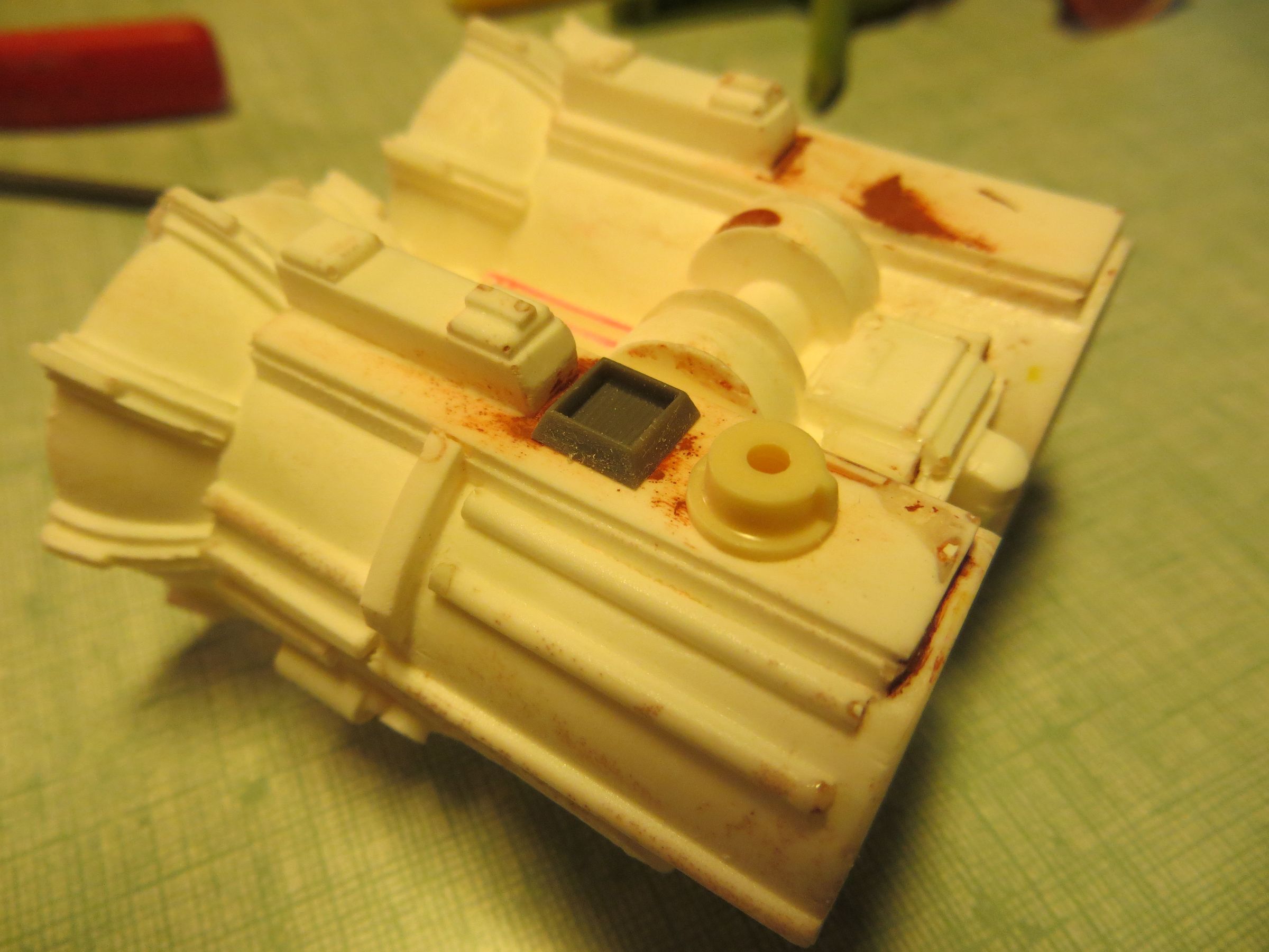

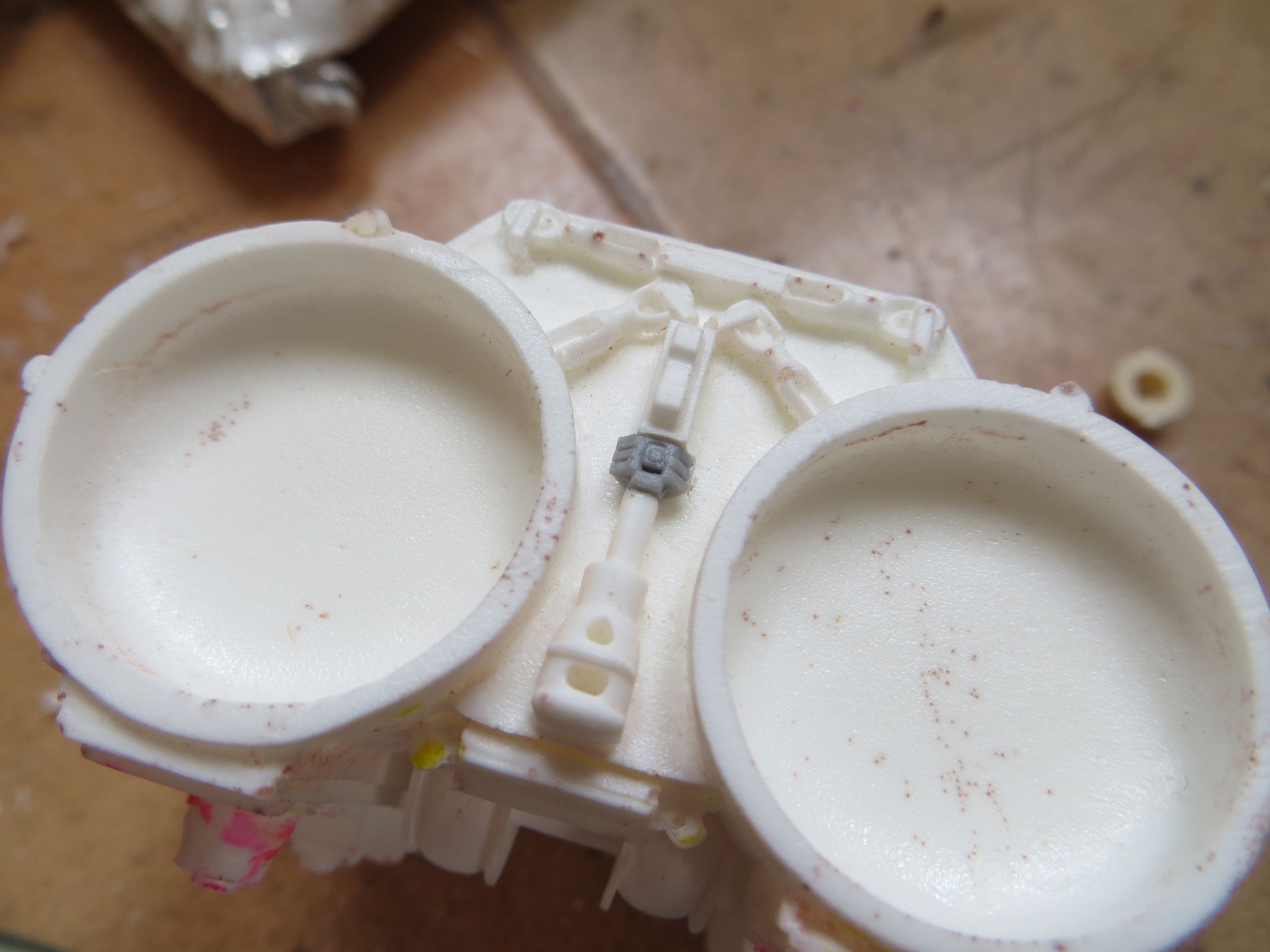

The engine block requires more work. There was indeed much more bubbles.
This empty area between the two engines is incorrect, and need to be covered.
Some poorly molded details were completed, and others, incorrect, needed to be redone.
On two small surfaces below each engine, the details are wrong and poorly casted, so I remove them, filled any remaining holes, and redid details with parts from the spare box and upgrade kits (wave / kotobukyia).
In pink, the areas to be corrected:
small household !
holes and gaps are filled,
Adding new details (by the way, the space between the two engines began to be covered)

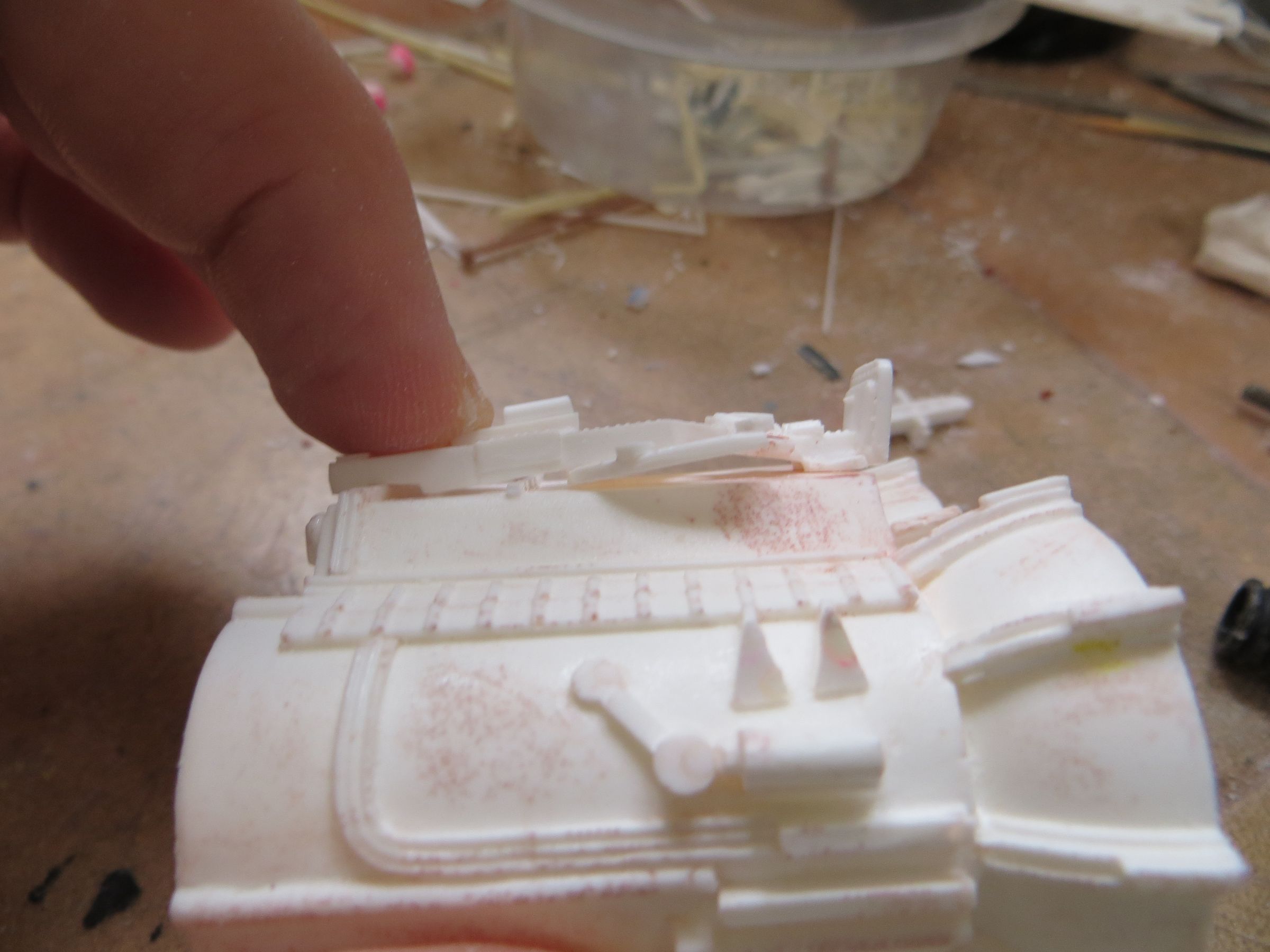

The part that goes on the rear deck above the engine block does not suit me (ugly, too long), so I redid the front half in scratch using axles and suspension from 1/72th trucks and gun barrel, plastic strips...
Before
After
Nice :)

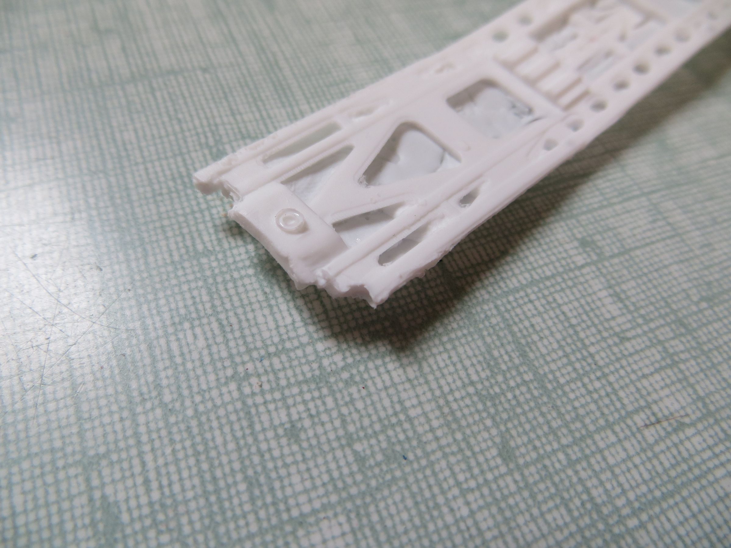

The molding of the Leopold part is not very nice. I could have change it, but it is on the underside, not so viewable finally, so I'll keep it.
The kit Leopold 1/144 is also no longer available, and I have other uses in mind (because it can be found on other StarWars and Galactica ships, less anecdotal than this tanker).
So I re-hollowed the rows of holes, added some missing details and closed the sides (this is more accurate, and will prevent the part from bending).
It's not top notch, but I will stay as is on this one.

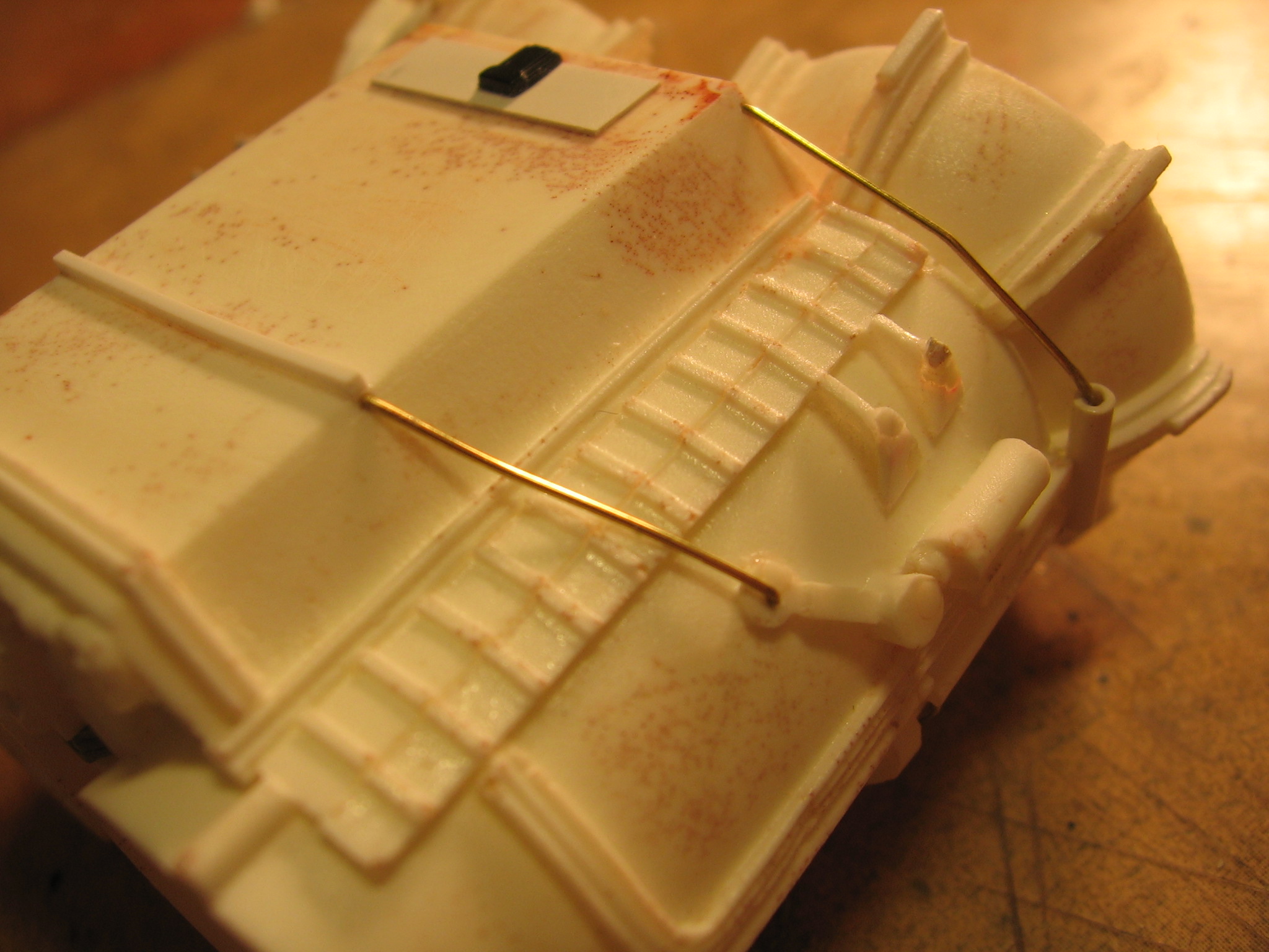

Back on the engines module, where I have a few details to complete, especially in the space between the body of the two engines, with plastic profiles. I may use this old 1/720 helicopter propeller for the last strip that will be added after the painting stage will be completed.
There are a lot of piping encircling the engine module, that I did with brass rods.

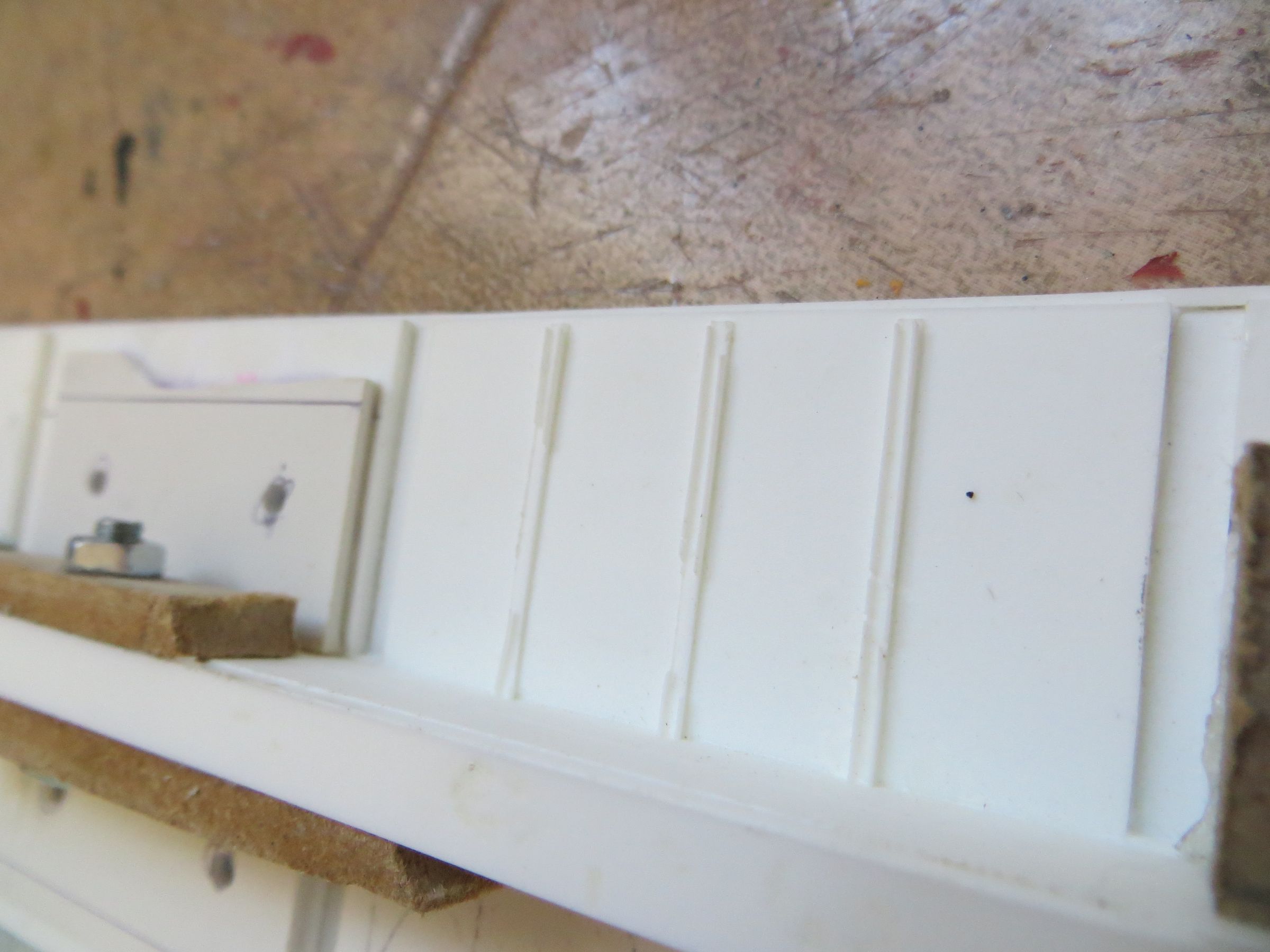

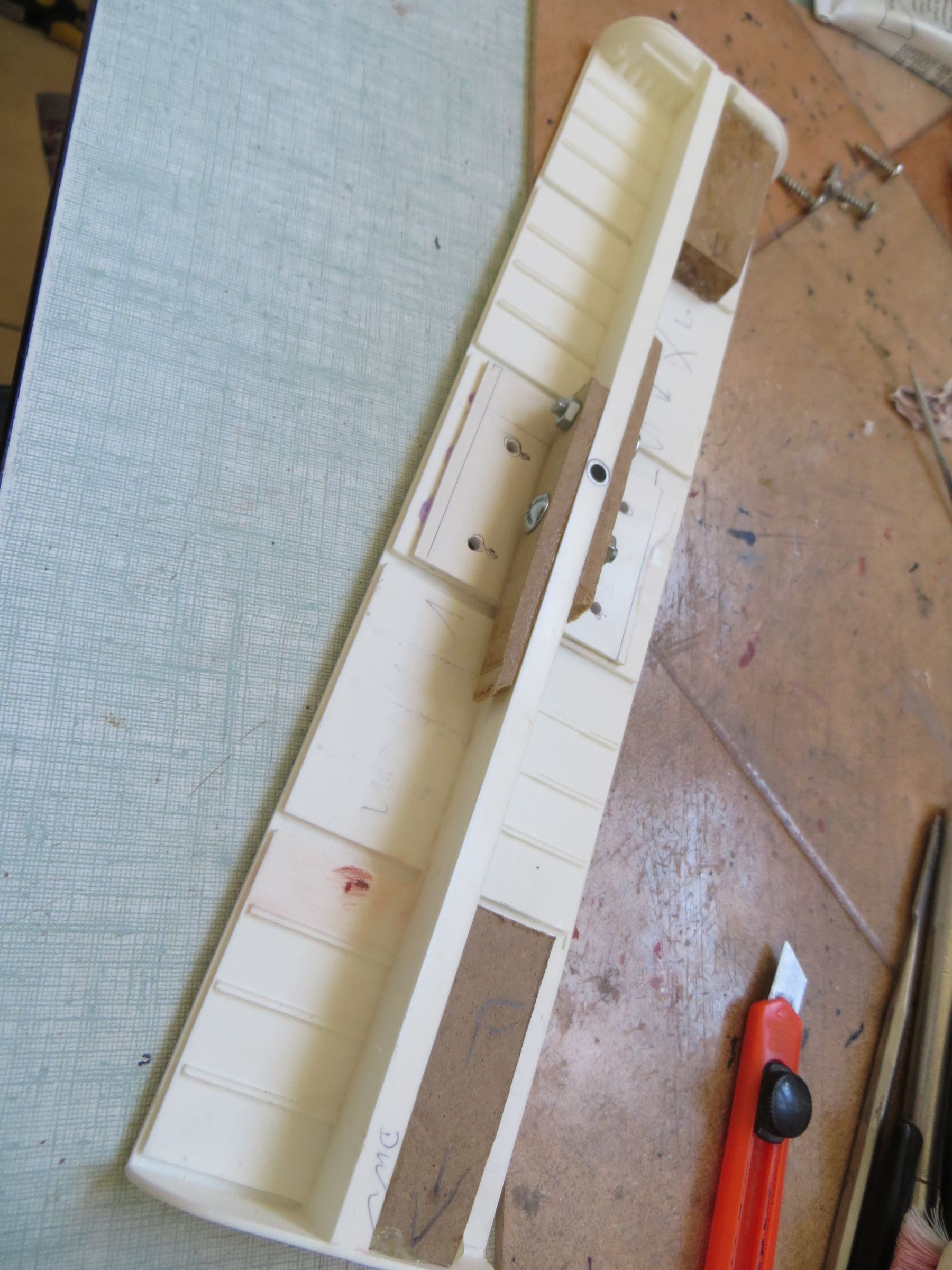

Before continue with these parts, I had to finish the assembly of the large central box. I hesitated if I was going to use 1 or 2 support rods.
I chose one because it looks best, but more complicated due to the length of the model. To be sure that the ship will stay straight, I used a fixed drill, embedded an aluminum tube, itself secured by wooden sticks and some nuts and bolts.
Wooden blocks are added in the bayes (that will be closed in the end), to strengthen the assembly and screw together the long parts.
Same thing at the ends to add material to plug rods and support the weight of the head and engine modules (as being full filled, they are quite heavy).
For the installation of the inner walls, I realized that I had finally removed too much material ! It was therefore necessary to add thickness with plastic cards. I used the new superglue 3 "universal", which has a slight delay in the curing, which allows the easy adjustment.
Many of those who were not visible were also glued to be able to support the cylindrical bay doors.
The rails in the bay are very thin, and several were damaged after all these manipulations. I have therefore removed (scraping, sanding) and replaced them with evergreen U-profiles.
The two large bays parts are finally glued togethern, using cyano and screws.
As they were not completely symmetrical , it was necessary to add one or two layers of plastic card at the end of the assembly.
The two upper and lower parts (roofs) are installed.
To make sure they stay straight, I added few layers of foam board (to avoid adding weight).
Incidentally, it will also allow me to give more matter to lay the cylindrical doors on it.
To align them, I also had to fill inner walls (as they have proved to lack some height to meet the ceiling) with plastic strips. It was necessary to go gradually and identified each parts and locations, as each one is adjusted spécifically.
Once glued, we can not see all the things added inside to arrive to a fair result.

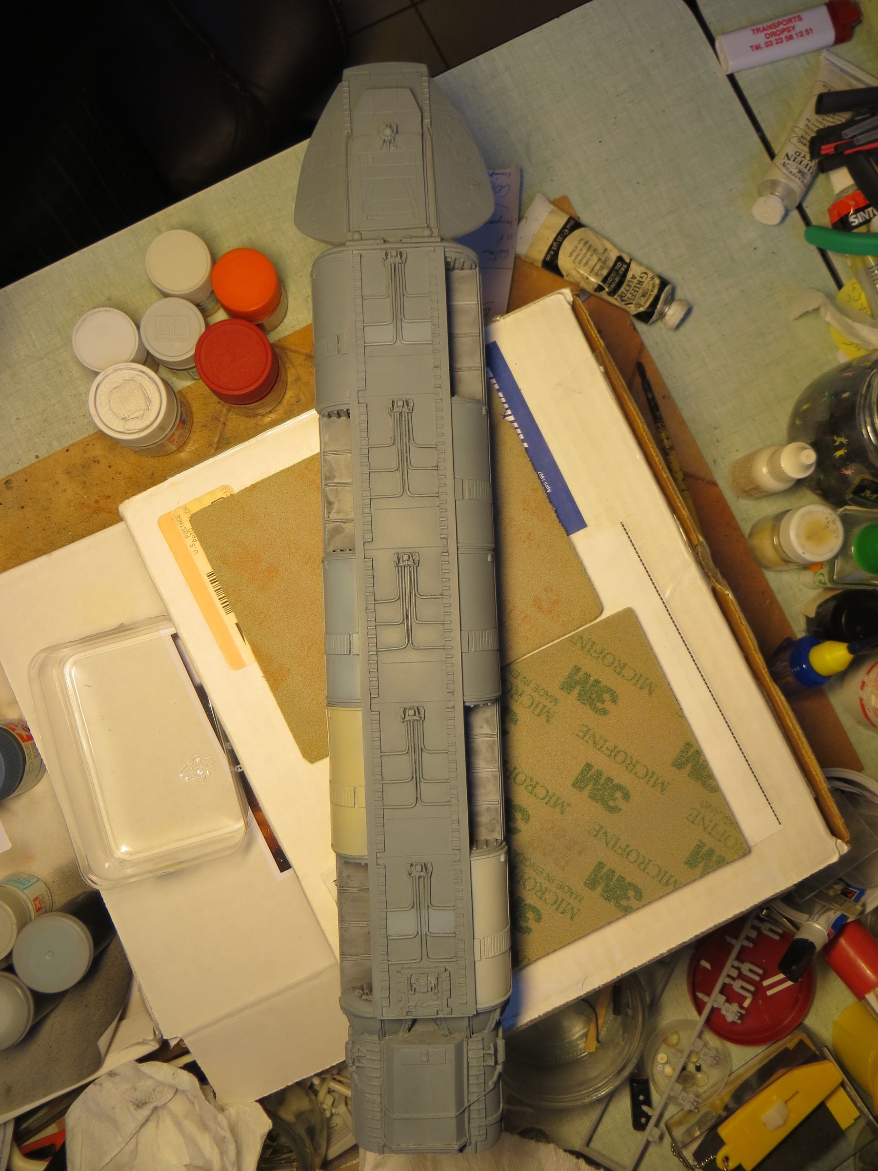

The head and engine modules are finally bonded to the central body.
There are few small seams to fill here or there (putty, plastic card).
some tank track links are added on the edge of open bays to simulate locks (like on the original model).
Here dry tested, we see that the bells nozzles are almost touching each others, while there should be a gap of about 5mm.
I also noted that they were not centered correctly. All this is corrected (tagging correctly the length on each radius), and then sanding quietly (to not remove too much material !)
Not without difficulty, it's ready for the painting.

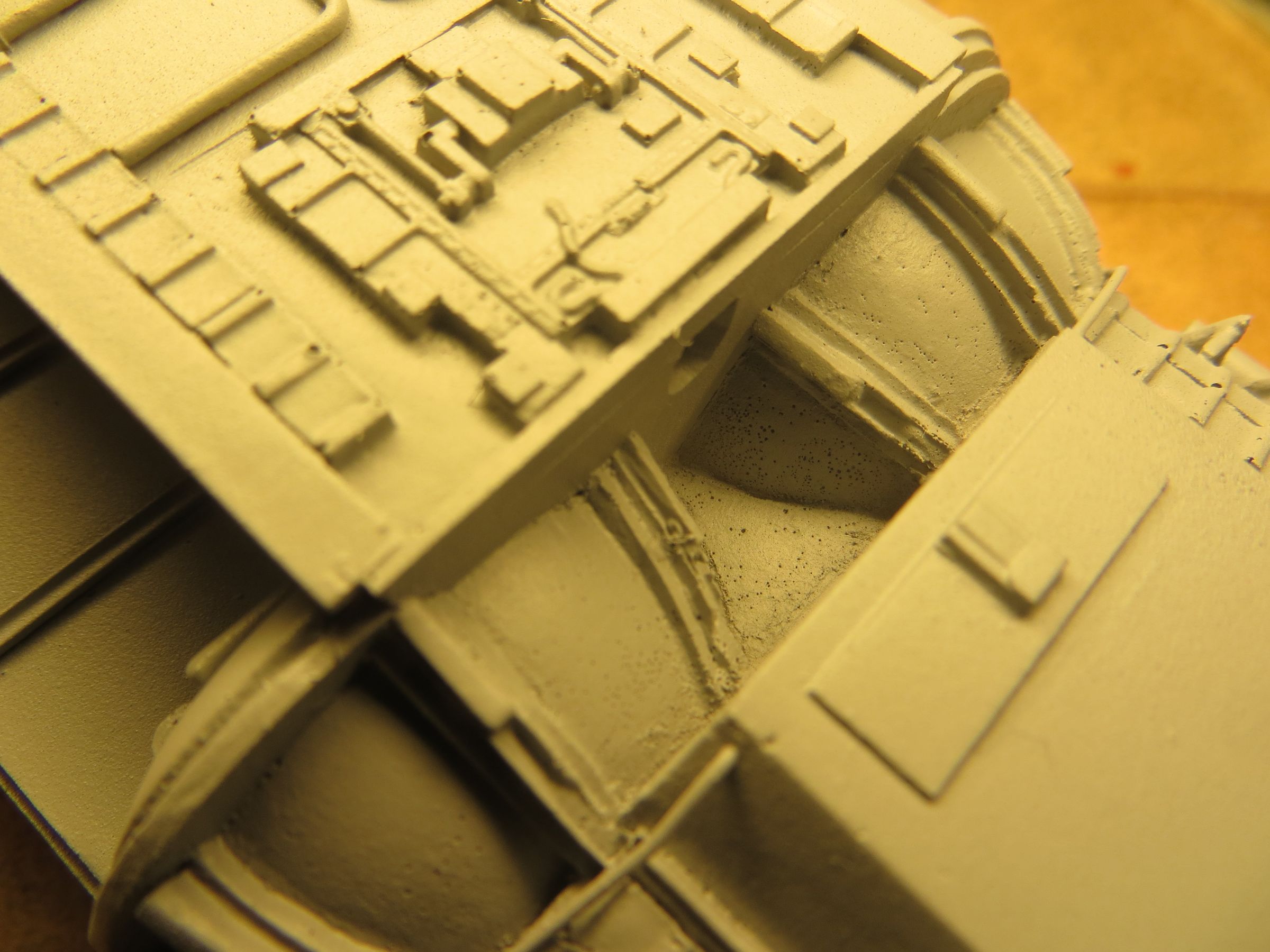

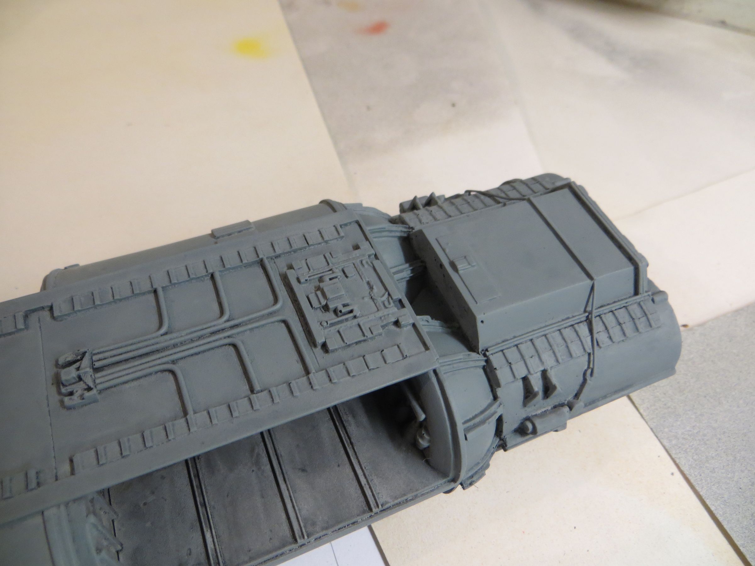

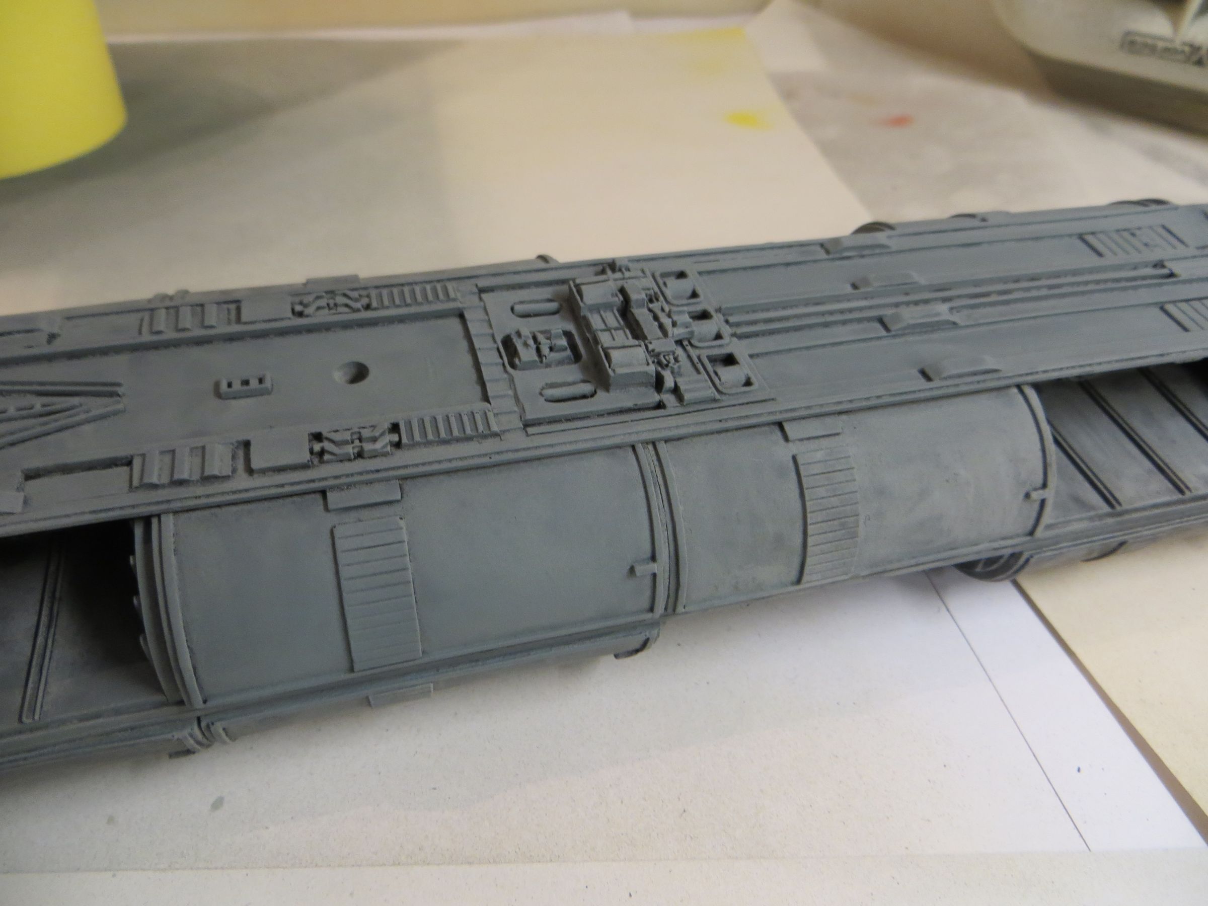

A coat of primer reveals some defects on the engine block surface.
In addition, I spray the primer too far , and it is not super smooth.
So I went for a overall sanding, then filling bubbles with plastic putty.
And a new coat of primer, and once dry, as is my habit on this type of building, I smeared the model of a very heavy black wash as a preshading (which makes voluntary non-uniform under painted surfaces) .
I then apply a first coat of Tamiya xf66 light gray (misnamed in my opinion, as it is anything but light !)

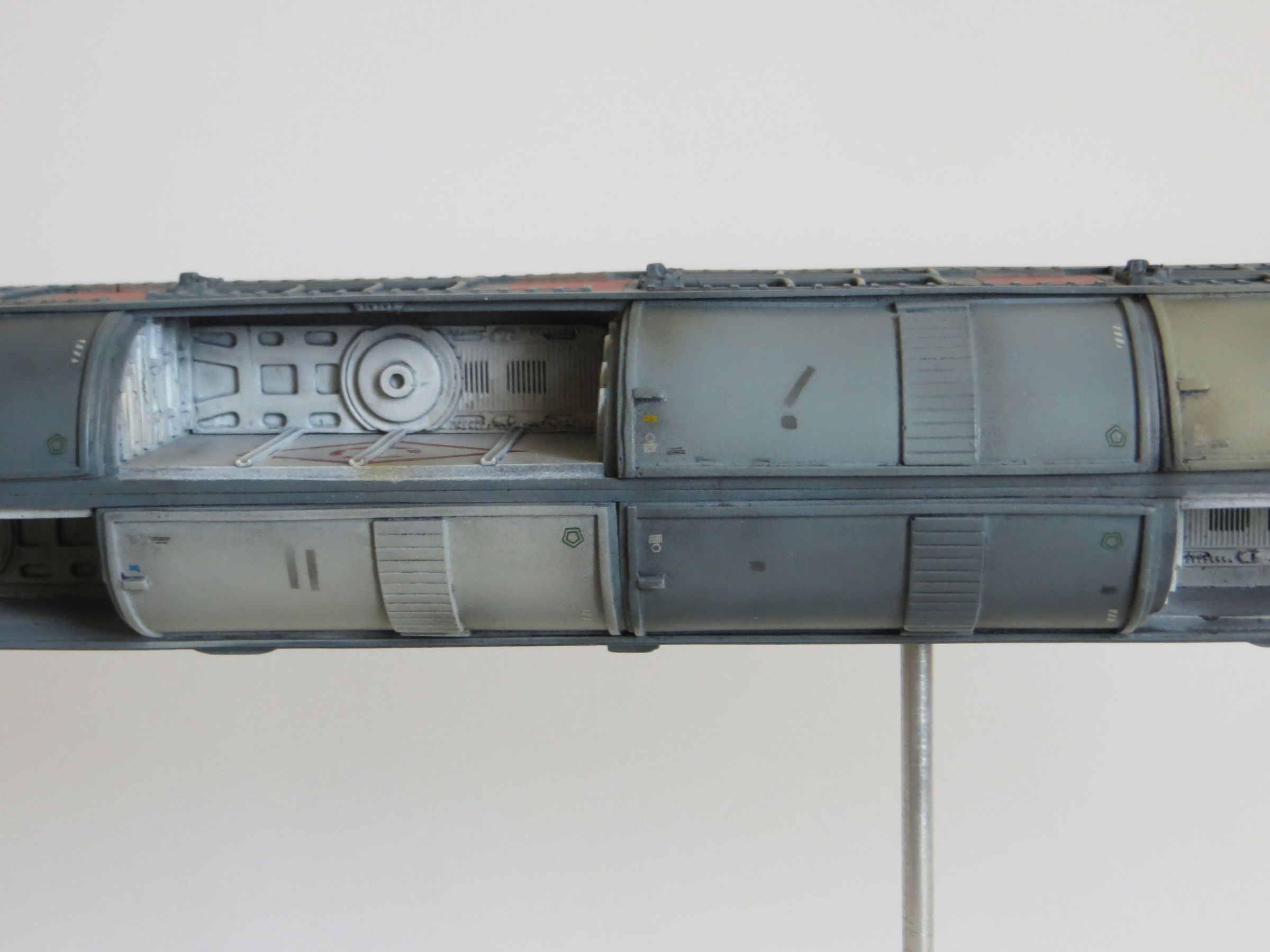

I applied differents colors on the bay doors :
Blue Grey
Tan / beige
off white
I had to make several attempts before finding the right shade so the préombrage has almost completely disappeared. So, I had to equalize the gray base color with another coat.
The interior of the open bays are matt white .

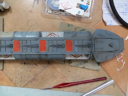

The red stripes on the top are prepared with an underlayer of white (spraid non-uniformly), followed by a red broken with few drops of yellow. In the airbrush cup, the color is reddish orange, but once applied, the eye sees it as a warm red.
To achieve red diamonds insignia in the bays, I planned initially to use a stencil I, and finally I xent with homemade decals .
It took a full afternoon to install them properly and regularly replace those who tried to come off as it dries. They were deliberately cutted off to give them a worn effect (still trying to stick to the original model).
The corners of the casements, various markings are applied by drawing in various boards .
Mini Cylon insignia are from the Revell Viper mk1 decals board (victory marks) in its latest edition.
Postshading and streaks are made in two colors: black and rust brown.

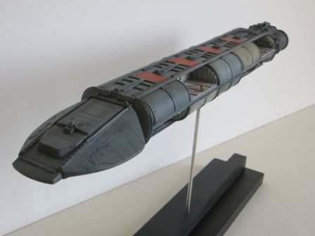

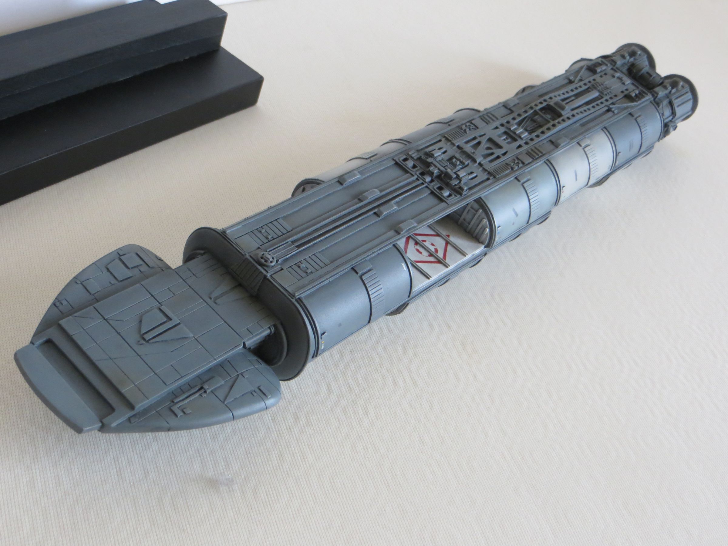

A layer of Klir/Future to protect everything. Then a slight dark gray juice is applied, that will be only very slightly wiping to keep streaks and the dark veil effect.
He then received a coat of matt varnish.
Then finally final assembly.
The photos are a bit dull, I will do more later on a dark background.
I now need to build a small diorama where it will be the centerpiece .
