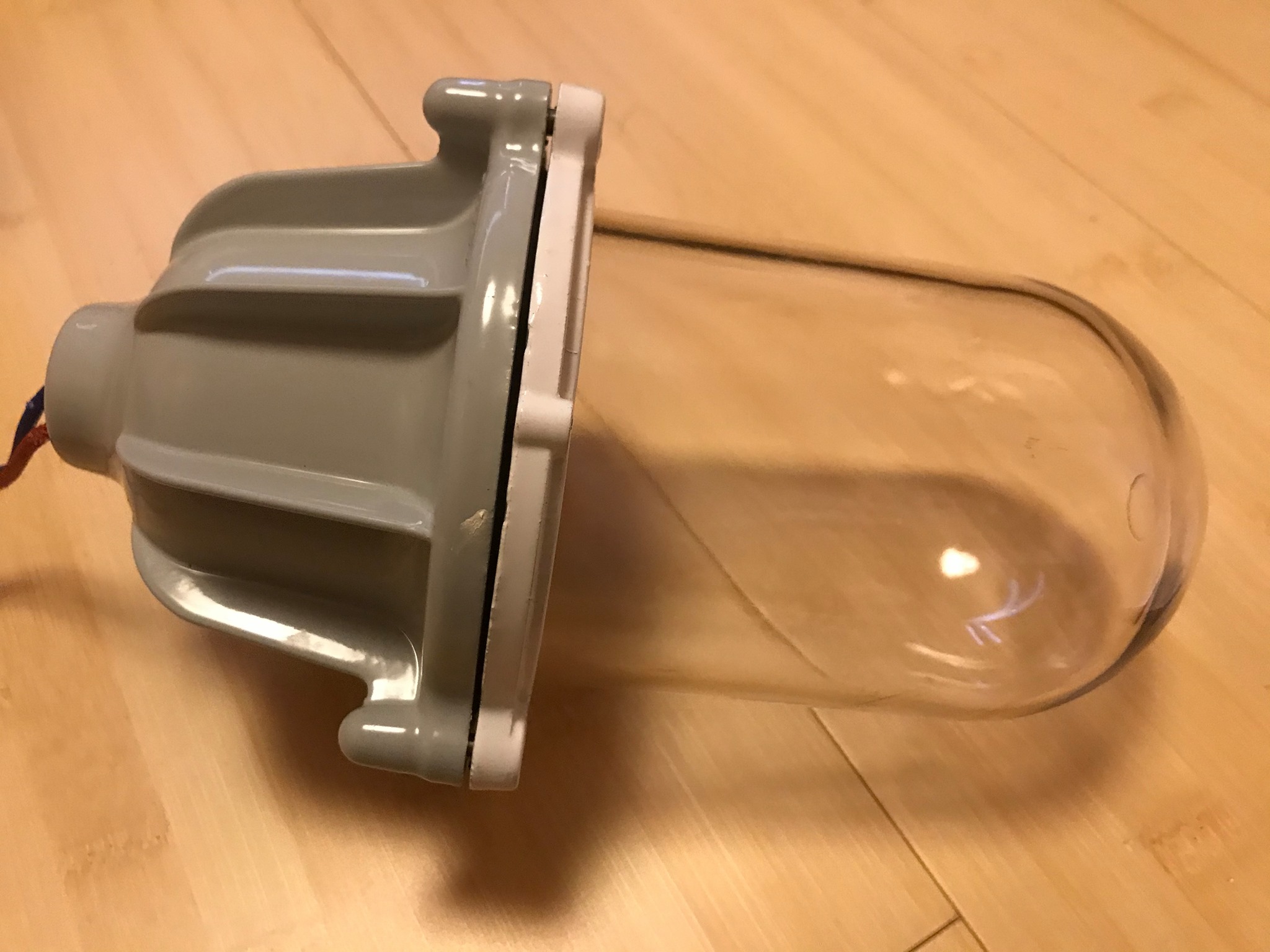

Coughtrie is a small Scottish company, founded in 1939, that manufactures industrial and commercial lights. They're known for solid and weatherproof, if not particularly high-tech, lamps that basically consist of cast aluminium shells, ceramic bayonet British lamp sockets, and incandescent light bulbs. Their lamps are seen across the UK, often on the sides of old factories and housing estates. Nothing particularly glamorous. The firm still exists today.
One of their lamps, the SW10, was first made in the 1950s or so, and consists of a solid metal shell with fins for radiating the heat from a tungsten bulb, a rubber (formerly cork) gasket and metal retaining ring (rated IP65), a glass dome or "wellglass", grease-lubricated stainless steel screws to hold the base and ring together, and a curved swan neck metal conduit. Optional dish-shaped reflector. The base and ring are cast aluminium, usually enamelled with thick grey, white, or black paint to protect the metal from the weather and conceal the somewhat rough casting.
The lamp shown here was probably manufactured sometime in the 1990s, and is new old stock.
This lamp is still produced and sold today in 2020. The only difference, so far as I can tell, is that the drilled-out hole in the top changed at some point from a 3/4" hole (about 19mm) to a 20mm hole. The writing on the base may also have changed - current products read "COUGHTRIE GLASGOW REF S.W.10". Old lamps, frequently taken off demolished council buildings and whatnot, make their way to auction sites where they tend to command surprisingly high prices, considering the rough state they're often in. Regardless - these things are easy to find, and new and new old stock lamps are readily available in the UK. Sometimes you see people selling paint-stripped and polished-up lamps as kinda dieselpunky pendant lights for installing in pubs in Shoreditch, etc. I'm going to put one in my home office, in fact. Fun!

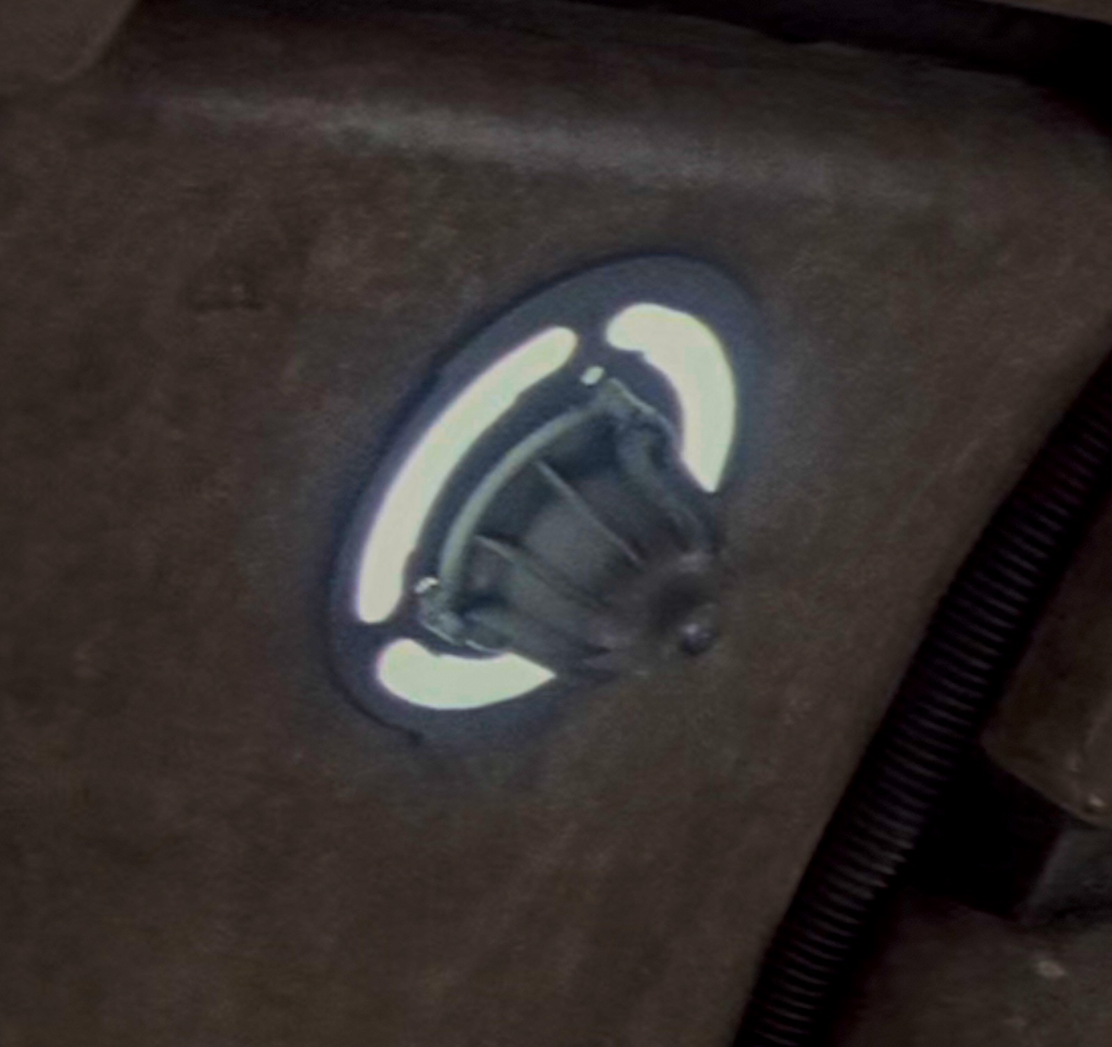

For the Empire Strikes Back the corridors were rebuilt. Coughtrie bases were used again, but this time circular backlights were used. These make no sense from a story continuity perspective, as the original square holes are larger than the circles. But hey - so it goes. The panels were backlit pale blue. Interestingly the one below seems to be falling off its backlight ring.

The Coughtrie bases were all painted dark grey or maybe black. There were a lot of them required, and given British set builders' tendency to make plaster casts, I suspect that they didn't buy tons of old lamps, but made casts for them all. That is conjecture, however, and I have no evidence one way or the other for that.

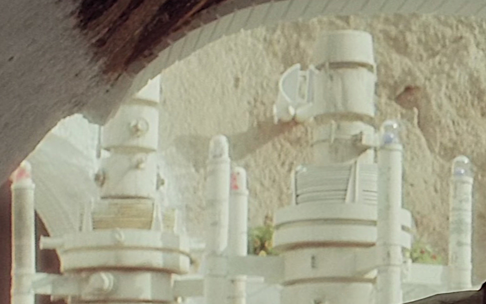

The moisture vaporator props had lamps on the top of the lower four posts. These resemble the glass domes used in Coughtrie lamps, though the ones below are painted white. However, the flange or lip looks a bit thicker to me than the should be for Coughtries, and they also seem a tiny bit too long and/or narrow. So I'd say they might be some Coughtrie variant, or perhaps some other company's glass dome/wellglass.

A couple of other places, and I think the glass is used on the vaperators. There's one or two being used inside-out.
