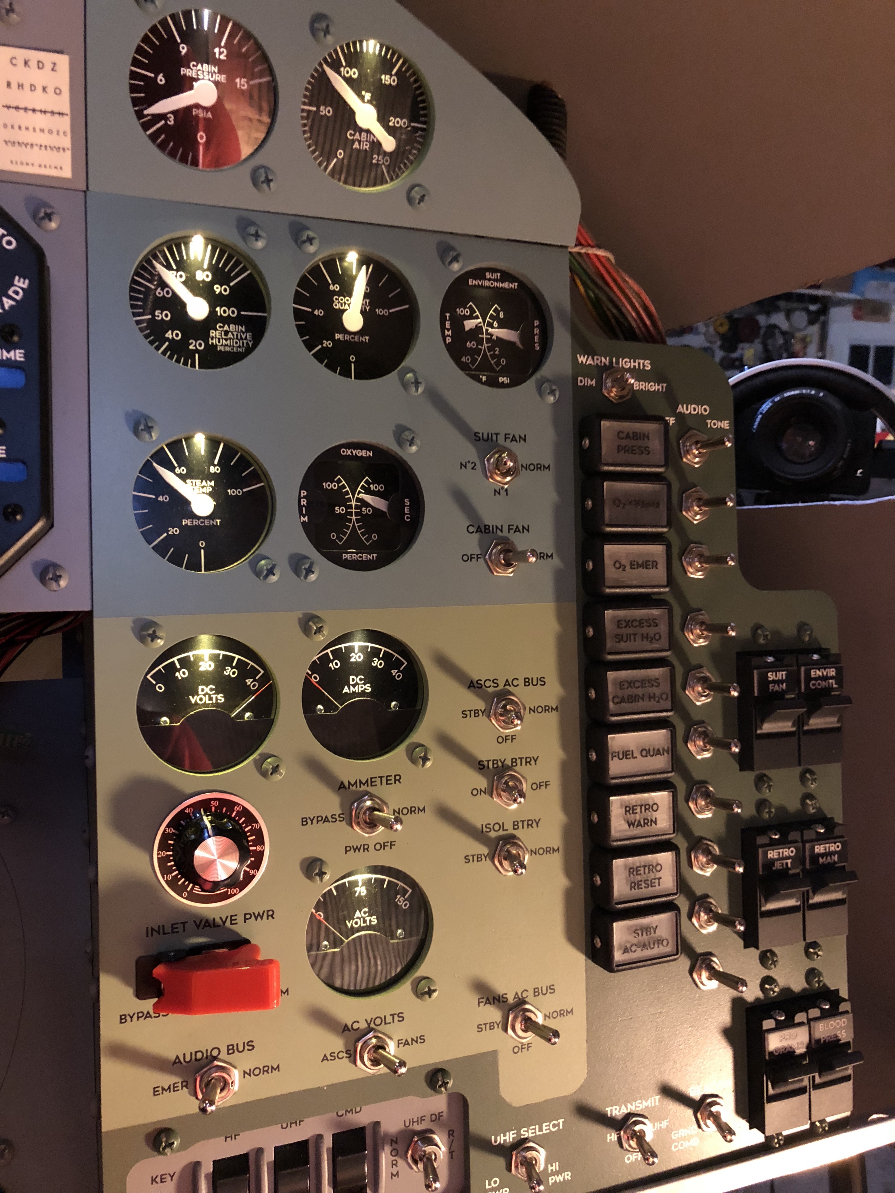

I just finished building a Mercury capsule cockpit over the summer for a short film I directed. For the dials, a few I was able to mod some cheapie analog gauges from eBay, just designed and printed a new backing (see the bottom 3 gauges in the photo below - DC volts, amps, etc). For all the other ones (at least the ones I needed to have move), I just designed them to work with micro servos. 3d printed the fixture and housing. They're all connected to an Arduino that controls them.
My whole setup is a dumb setup though. The Arduino just responds to commands that are sent to it off-screen by someone with a laptop. Turn light 3 on, gauge 2 to 50%, etc. One day I'd love to go back and turn it into an actual simulator!
Wow that is actually amazing! Do you have a thread open about it or do you have more pictures? Is it a plastic, metal or wooden board and how did you print the text on it because it looks pretty good!

Thanks! Yeah I have a thread open about it here: Mercury Capsule set for short film 'Infinity 7'
I got the boards laser cut out of hardboard. I don't own a laser cutter, so I ordered them online. The lettering was rub-on lettering I ordered too. First time messing with rub-on stuff, but it went on really easily.
I had bought a 3d printer just before starting this project. What a great investment! I used it a TON on this project. For making masters for molds, the gauges and pull handles, brackets to hold panels together, etc.
