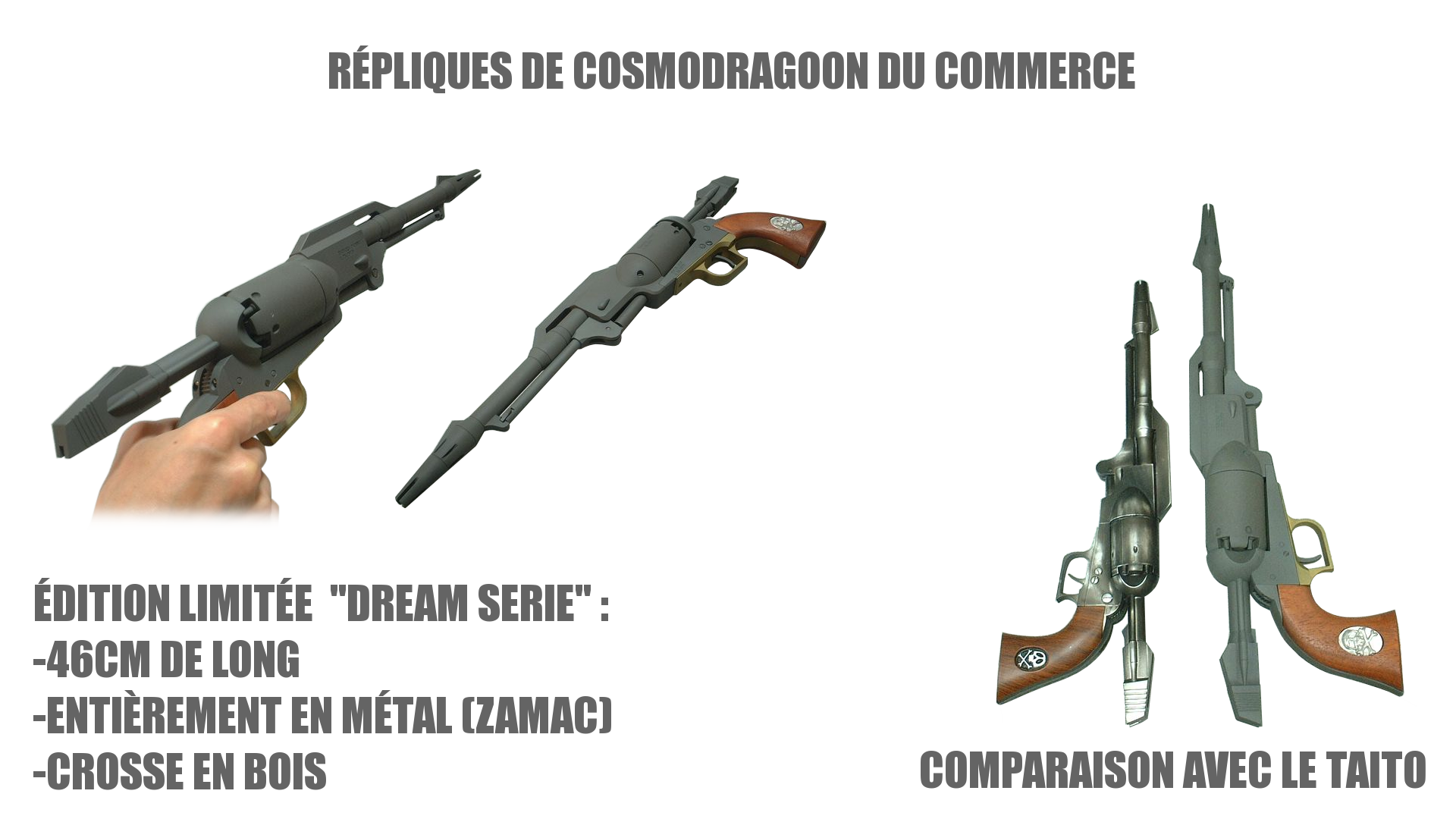

You can see on the VICE gun they filled the gap between barrel and cylinder creating a wrong assembly design.
you can also have a quick comparition with the taito gun.

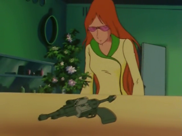

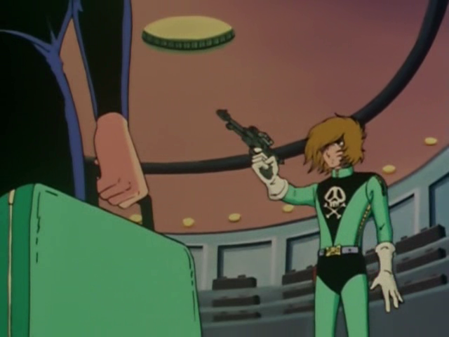

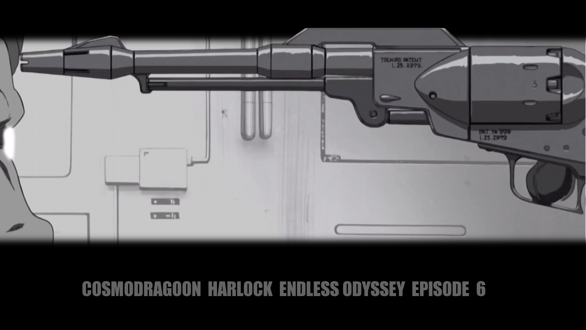

Here you can see a larger picture of the best available screenshot:
you can see the frame height, and how the barrel and frame-cylinder meet together, making a straight line.
you can also see the lever base (walker) lever end (1851 navy), barrel lenght, barrel base shape,, the cylinder and barrel base have quite similar lenght, but depending on pictures, the barrel base is sometimes longer, depending on pictures, I would choose a cylinder lenght between 5 and 6 cm.
The barrel maximum diameter is about ⅓ of the cylinder, and it's easy to see the "cap n ball" technology replicated on the picture.
Once you have seen this picture, it's easy to virtually just add the conical end to the real walker barrel, adding 3 cm on barrel and 4 cm with the additionnal part on handle, and you get a 46cm cosmodragoon.

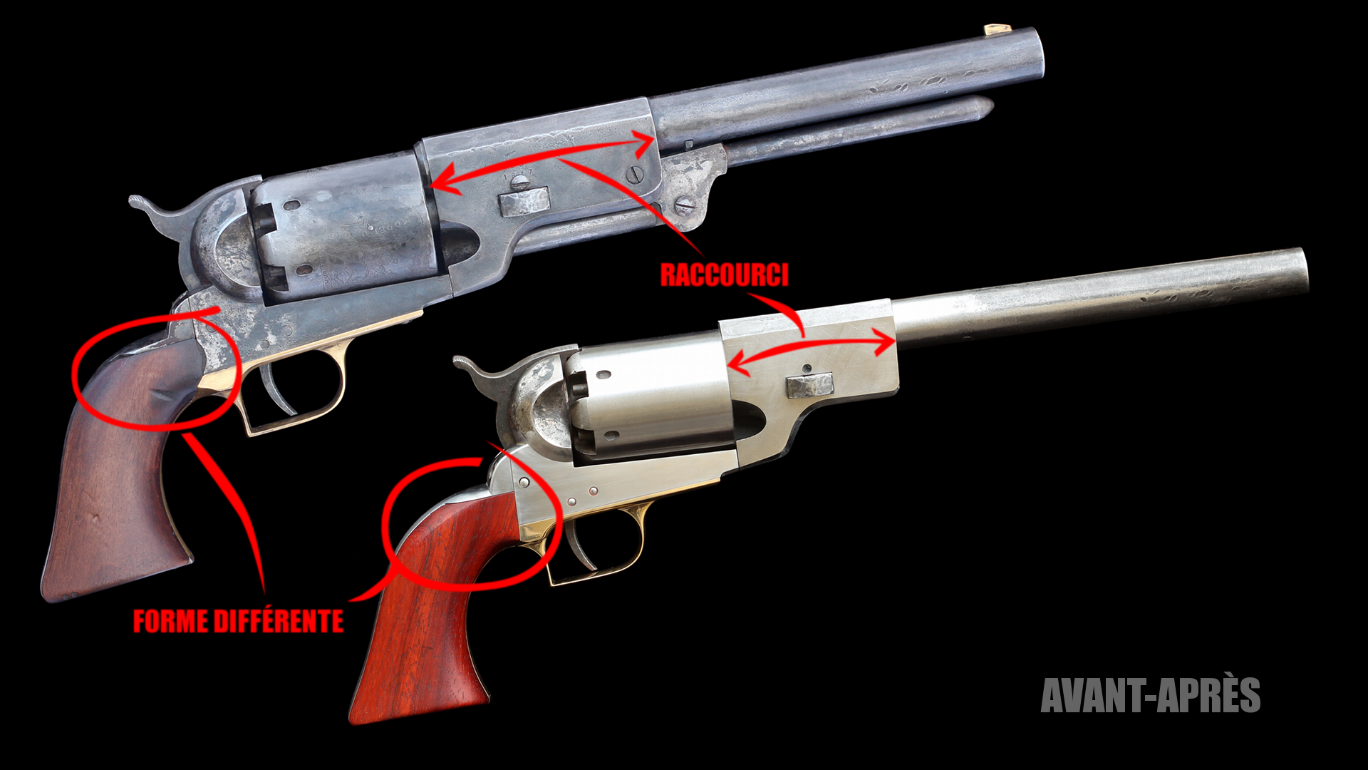

The walker is 39cm long, the dragoon is about 33 cm long if my memory is correct.

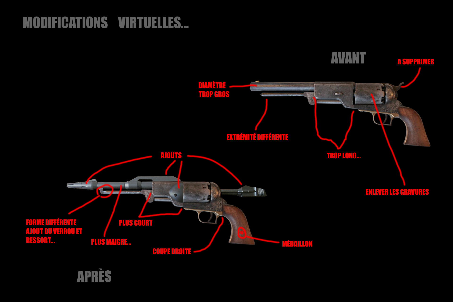

Here is my actual work, first view is virtual modification:
Quite "easy" to do, except soldering on frame.
here is my actual work:
You can see the guard trigger is not accurate on matsumoto's design, as the cylinder notches position
What I qee as wrong on your design:
-the 2 bolts on bottom are too big.
About the cosmodragoon, there is actually no view of the bolts, each view I have seen doesn't show the bolt heads, so, no way to know on which side they are, so I assume your design is correct, as mine, as the real colt design is, as it is on each existing replica.
-the lever base shape is not correct compared to the best available screenshot.
-the diameter ration between barrel and cylinder is closer to ½ I think the cylinder is too weak.
-the ratio between barrel end and central piece is not correct the central piece is too narrow
-the barrel base is not correct, sections are not rounded and the bevel is missing
-the "cap'nball" are missing on the cylinder, and the design is wrong
I especially like your skull and bones emblem, very nice design

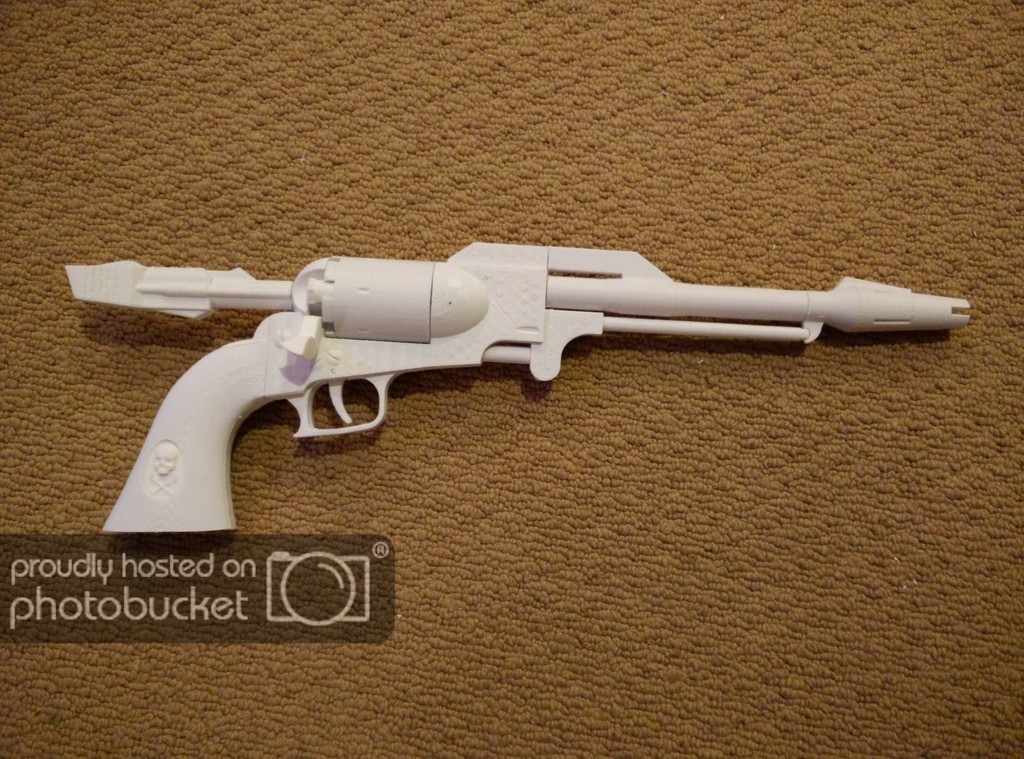

Re: 3D Printed Kit - Cosmo Dragoon - New Pics post #42
I've got 3 printers dedicated to getting the 1st prototype done. We appreciate the feedback, but in the end we won't be able to make every person completely happy, but we'll try to make it as accurate as can be.

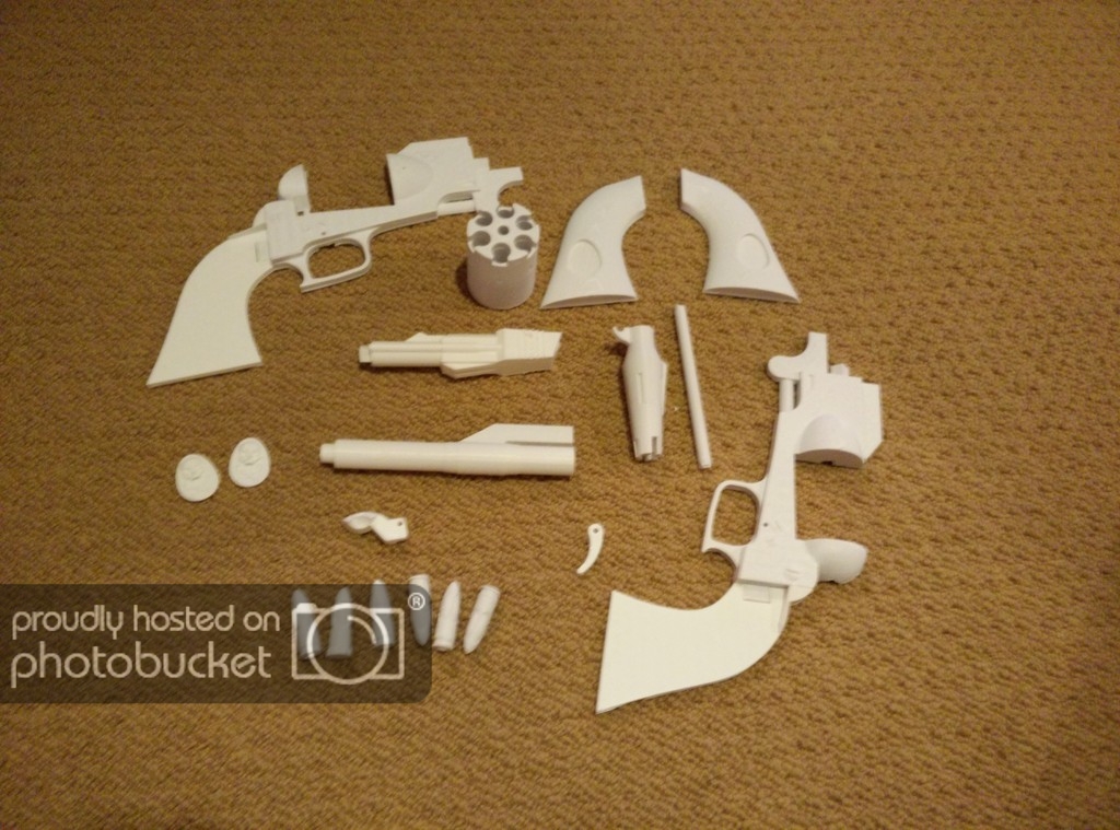

Q - How are the parts going to be broken down? I am going to want to do some modification myself. Here are 2 ways hat I have seen it done:
They're cutup to fit the printers best, but they make sense and should allow some customization. You'll see the pics of the parts soon

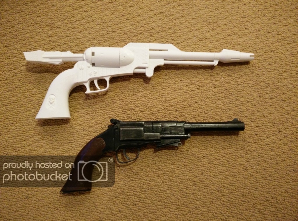

It's alive!!
So I've had 3 printers going for a couple days to get here. This is still draft quality and it's missing parts, but it's fricking cool! This is a BIG gun.
Re: 3D Printed Kit - Cosmo Dragoon - 1st print post #65

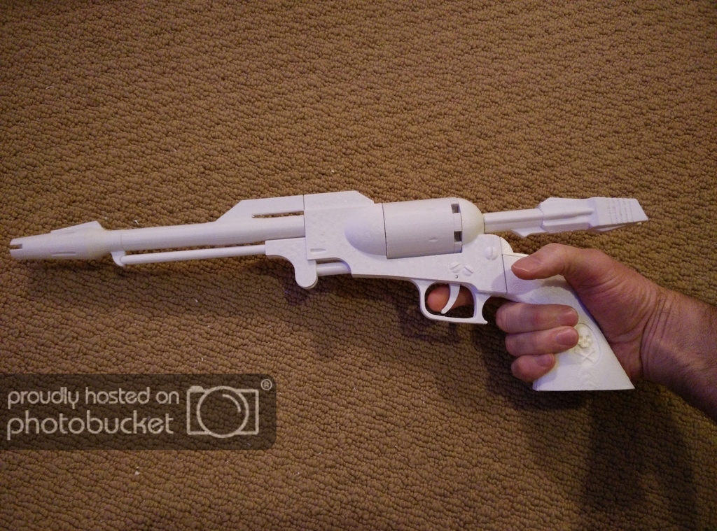

I'm a fan of the big size. But I'm not the one that can currently hold it in my hand. When you hold it, does it still seem "real" ?
Ya, it seems good, and I don't have big hands. I'll show some pics once I get all the pieces done and glued together
I am down for one!
Looks VERY Nice !!!
One comment is the back piece really tight/snug to the side of the hand when the gun is held??? The picture gives me that impression.

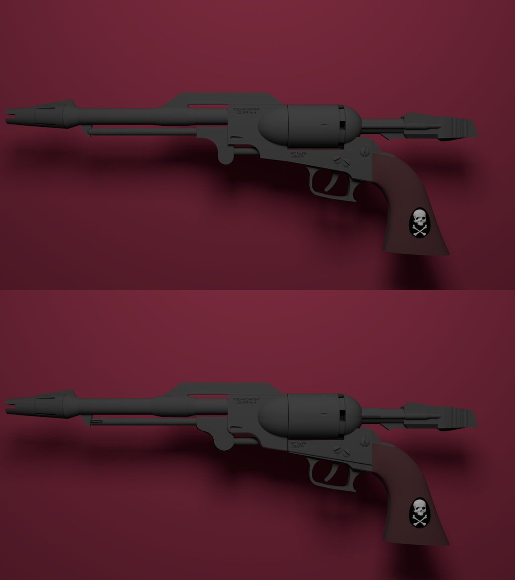

So here we have it, finally got it all printed, assembled and glued together. Everything fits really well. The trigger moves, the cylinder cover opens, the cylinder rotates (or doesn't with a touch of glue). What you see here is 99% final. I'll look at making 2 of the small changes that @matt09 mentioned, but aside from that, this will be the final. I likely won't reprint another version just for those 2 small changes. Look for this to go on sale mid-late next week, once my supplies come in. This is the biggest gun I've ever done, but I'll keep the price at $150 as I mentioned in the 1st post.
What you see in the pics below are completely untouched, no sanding. Just a few supports picked off and it all glued together:
That...that is a thing of beauty and I can't wait to get one
Excellent work !! Can't wait to have it on my wall.

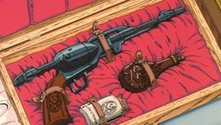

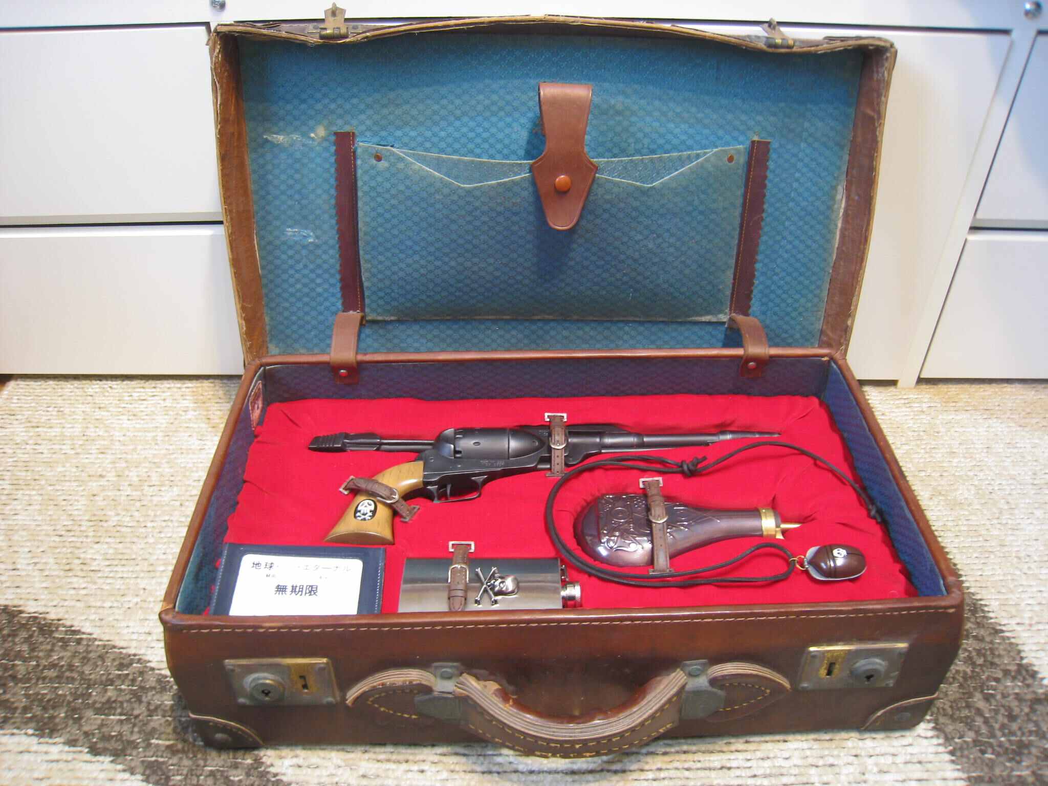

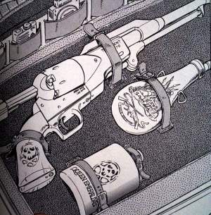

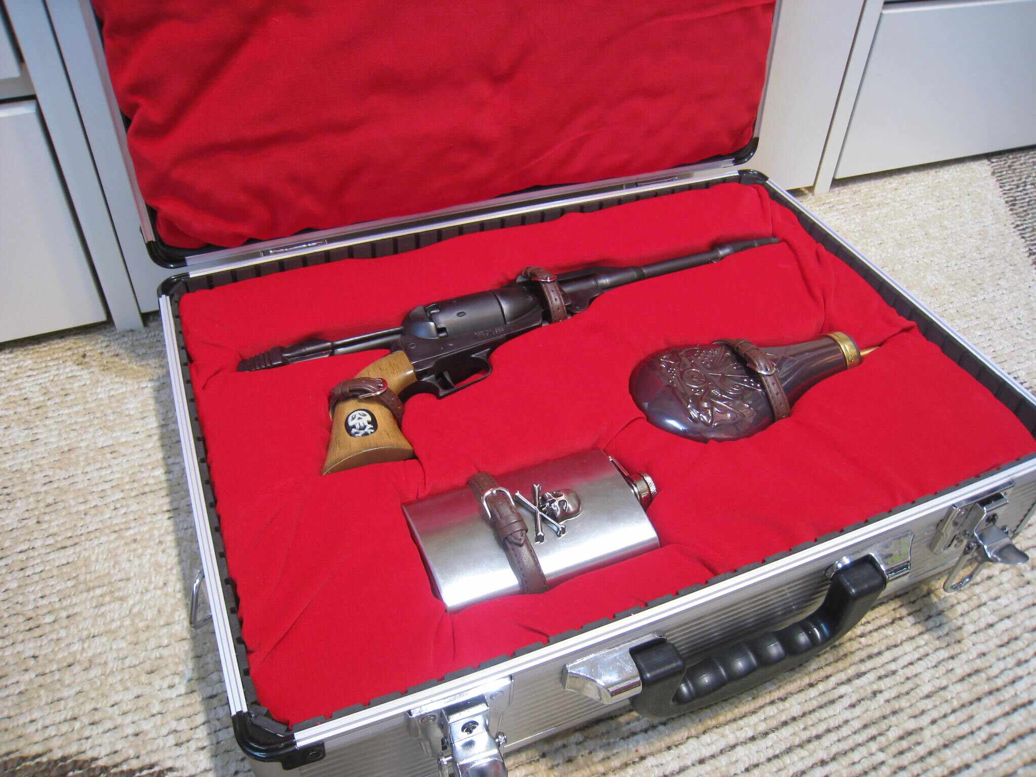

Re: 3D Printed Kit - Cosmo Dragoon - Full Print #70
1920401_752089551524830_8334127356308794095_n[1].jpgdragoon1[1].jpgsennsino[1].jpgimg_0[1].jpgimg_2[6].jpgimg_2[2] (3).jpg
The above are pics and reference material of the dragoon in it's case. The one with all the extra stuff is from a really obsessive fan who got a bunch of different GE props to go in the case (I have a list if anyone is interested). The silver cased gun is a Tanaka and the other is a Taito I believe (based on a shot of the guy holding it and the grip being way to small).

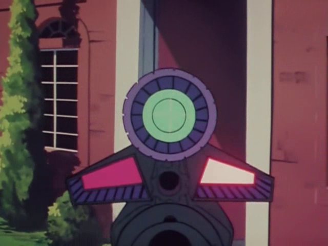

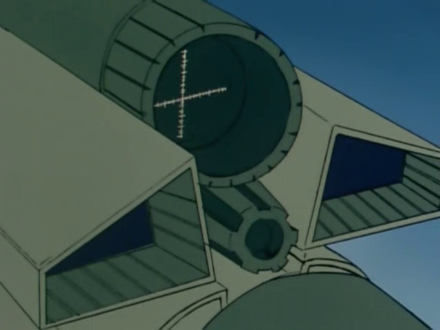

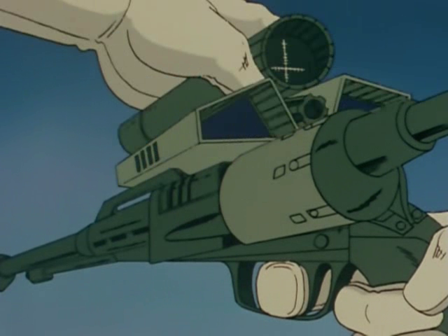

Here is the Mazone detector from the original series. It slides onto the top of the dragoon from the back.
vlcsnap-2015-04-24-13h25m58s354.pngvlcsnap-2015-04-24-13h26m17s240.pngvlcsnap-2015-04-24-13h27m05s048.pngvlcsnap-2015-04-24-13h27m26s582.pngvlcsnap-2015-04-24-13h30m32s562.pngvlcsnap-2015-04-24-13h32m55s018.pngvlcsnap-2015-04-24-13h34m43s886.pngvlcsnap-2015-04-24-13h38m59s029.pngvlcsnap-2015-04-24-13h40m21s622.pngvlcsnap-2015-04-24-13h44m29s874.png
I thank my friend Matt with the crazy memory for these pics. Anyway, put this bad boy with the Dragoon and the Anti-Noo bullet and you have the ultimate dragoon prop. Who knows, maybe you can do a separate run for accessories. :)
