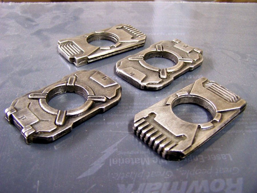

One is a resin cast that has a silver powder dusted into the mold. It gives the resin a metallic look, and also helps to aid with capturing all of the details. But the other one is solid pewter. I use platinum cure silicones, and they are heat resistant up to 450 degrees. Pewter has a melting point of around 400. I used a small cast iron pot, and a stove top burner to melt the pewter down. Then I pour it into the mold. It the exact same concept as casting with resin, only more dangerous, and you have to pour quickly, before the metal cools.

I just figured that out. I prefer to dust my molds, just because it helps the resin pick up all of the really fine details, and helps to eliminate air bubbles. The cold cast comes out ok. I did a few different tests, and I liked using my impact resistant resin much better than the translucent resin. I add some tint to make it gray, and with the aluminum powder mixed into the resin, it looks pretty good. But I'll have to try dusting the molds with a silver powder in addition to the cold cast.
Got the new silicone in yesterday, and made a mold for the Halo 3 version. It came out great! I also learned how to use cold cast resin. It looks better than just dusting the mold with silver powder.
I did a few tests with the pewter, and it has pretty much the same results as the old silicone. So I will just keep both molds. They both yield great results with resin, and good results with the pewter.
I also used a acid to oxidize the surface of the metal ones. It turns them black and dirty.
Then I use steel wool to buff them. It really highlights the details.

That's quite a nice brushed metal look you ended up with on the pewter, after you used the steel-wool on it.

Can hardly tell which ones the resin ones are and which the pewter ones are :)
