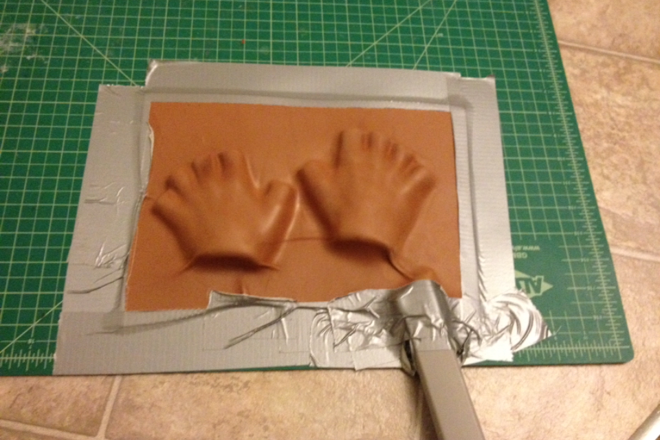

I was thinking about vacuum forming some pistol holsters with craft foam when I had a stroke of genius that I'm sure someone else has already thought of. I decided to mold my son's hands and vacuum form craft foam over them.
Plaster gauze over hands--
Several layers of caulk--
the hand pieces--
The super quick vacuum forming setup--
I know you're supposed to warm the sheet in an oven and sandwich it between frames, but aint nobody got time for that. I just taped it down and used a heat gun over the foam while the vacuum was on.

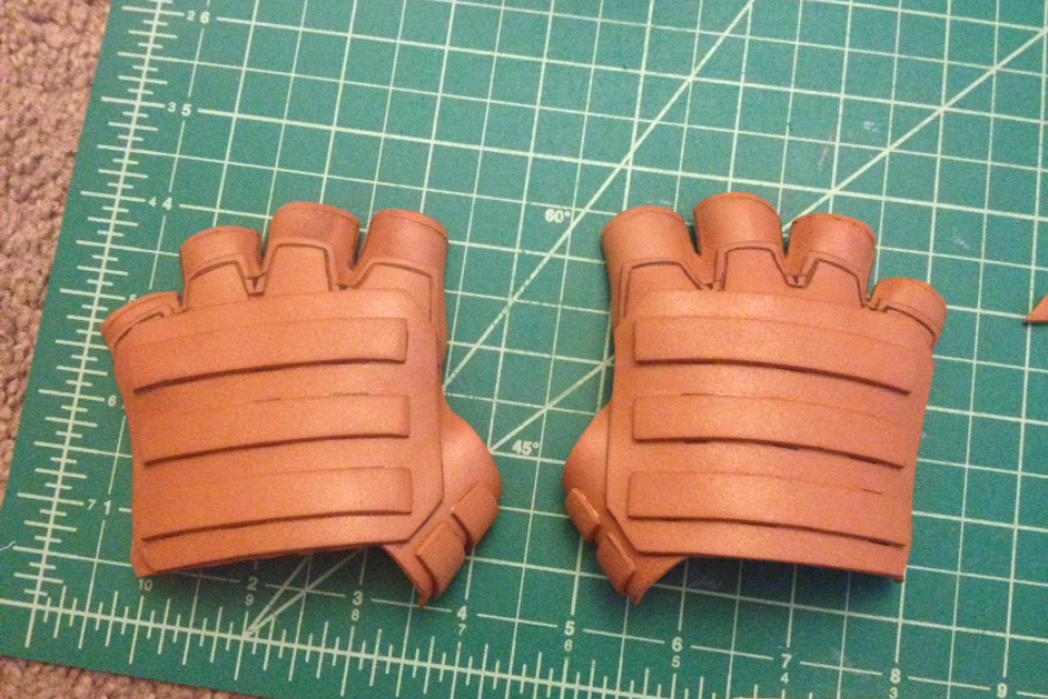

additional foam pieces added--
and Plasti Dip'd--
Not perfect, but not terrible. (That also happens to be my motto in life).
You'll also see the gloves I sewed. I basically just traced an outline around my son's hands and used that as a top and bottom pattern for the gloves. The red and the black fabric are both 4-way stretch so the gloves turned out great and are perfectly sized. I only did the backside of his hands with the foam, so it's more comfortable and flexible, and also won't get messed up as easy. As always, ignore the washable marker lines. I like to wait until I'm finished before rinsing them off.

Hey! Thanks, sir. It's just a 2mm sheet of craft foam. I think it was a pack of Foamies brand craft foam. Same stuff I used for the pouches. One thing I liked about it was that it not only stretched the foam out to form around the hands, the heat gun also collapsed the cells. Now it's almost half as thick, which seems to help it flex easier. I'll probably use the technique more in the future, maybe even with thicker foam and stronger vacuum.

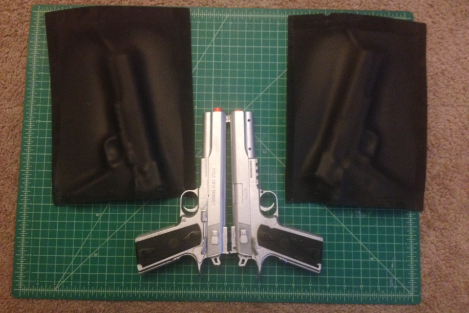

We had an old airsoft gun that I figured would work for this. I know it's not the right kind, but I won't tell if you won't.
We only had one, though, so I just bought another broken one off ebay and painted that up, too. A layer of black spray paint, then brushed on silver. A little light, so I may have to go back over it with some black to dirty it up.
Currently working on the holsters.
I removed the internal weights from the guns so they'd be light and I could make the holsters out of foam instead of something more sturdy like plastic.
