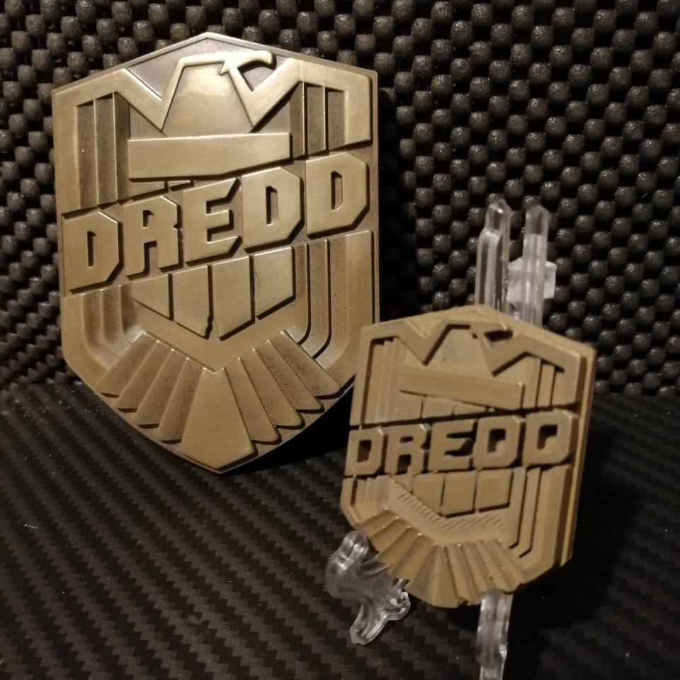

Cold cast mini dredd badge.
shokk
Playing around with some resin and brass powder.
The little badge is a little rough, but I'll get that sorted.
Standard sg 2000 resin. It drys to a slight off white colour.
But the mould is coated with brass powder, that's how you get the colour.
