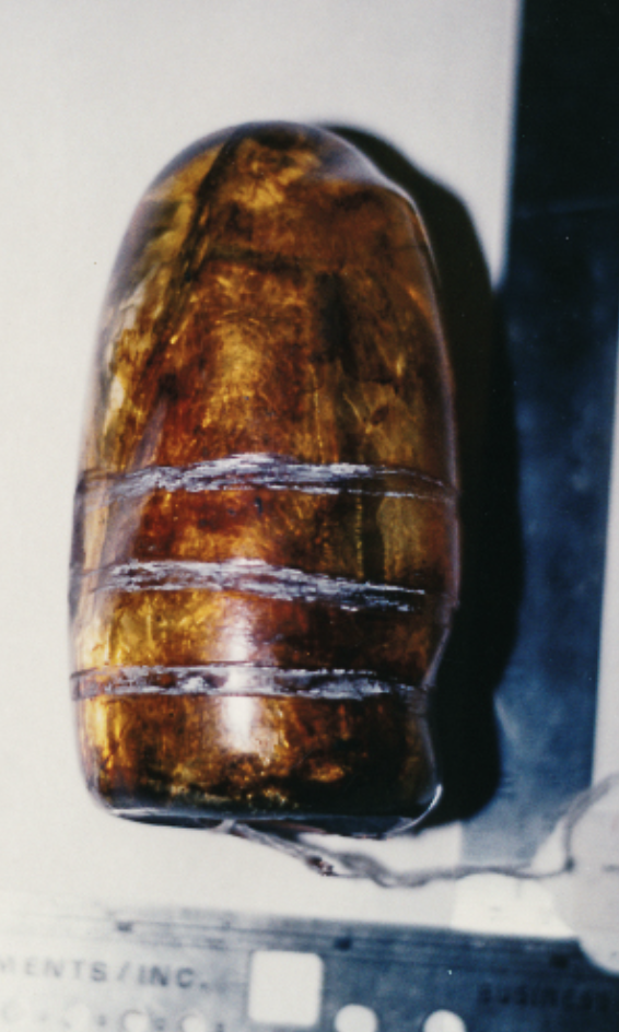

So I wanted to try making some mini and maybe full-sized Sankara stone Replicas for fun. I have seen the PERFECT replicas by Restaurajones Jones, but just wanted to do this as a side project / chance to learn a new technique.
I've heard from him and others that adding a TON of hardener to Polyester Resin will cause cracks, but I've had some really unsuccessful tests (and ironically) near-perfect casts.
I posted pics of the effect I'm looking for below - If anyone has any idea how to achieve this I would love to hear thoughts! I'm absolutely fascinated with this!

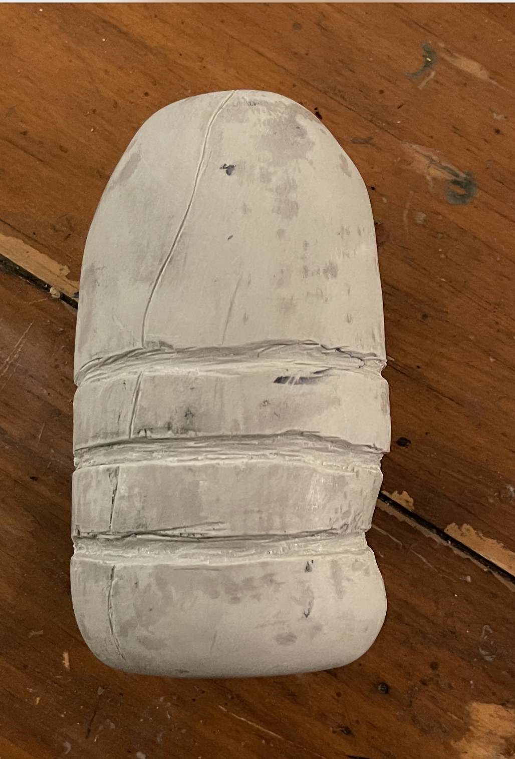

Update: First off. Just buy these from Restaurajones Jones - don't be a fool like me. This is an expensive, messy and frustrating process!
So I did a very bad sculpted a stone in z-brush really roughly and 3D printed it.
I cast one that was a total dud with some excess resin and decided to paint it with some glass paint - not too shabby. Looks a bit weird though.

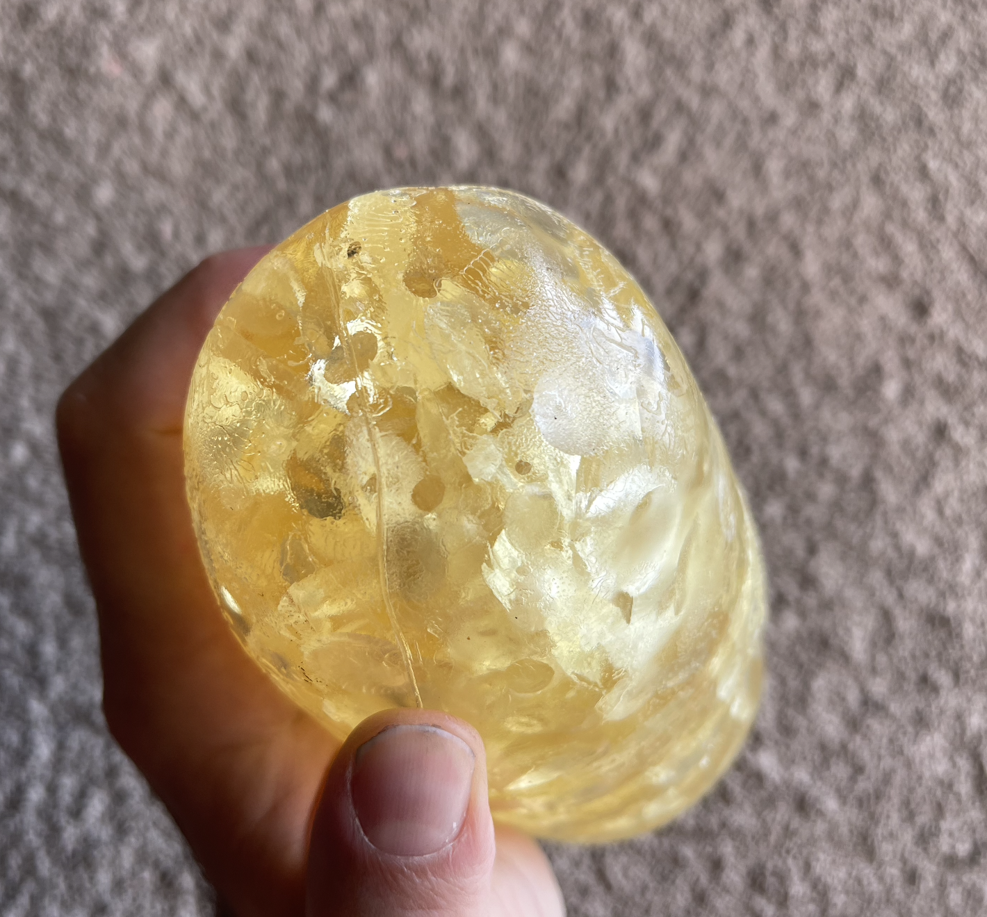

Then I just went absolutely ham on the resin adding about 45ml of Hardener to 16oz of Casting Craft resin. This stuff SMELLS! ...BAD!
I also had some little bits of resin that I broke up and threw inside the stone to fill out the space (I was out of resin)
But to my surprise... IT WORKED!!!!
Now there is no color since the heating process 100% baked out the color I added. So I'm assuming anyone that does this must add the color after-the-fact.
So here are some pics of the stone before it has gotten any sort of polishing or coating to make it amber. There are also weird ripples on the outside that was part of the horrendous casting process - those need to be sanded off.
So excited it's starting to work!!!

You can see below the odd bump in the side that I tried to match _ the scratches. The Stone is tilted down in the refernce photo in the middle and taken from straight-on in the one of the right - so I did my best to blend the two.
