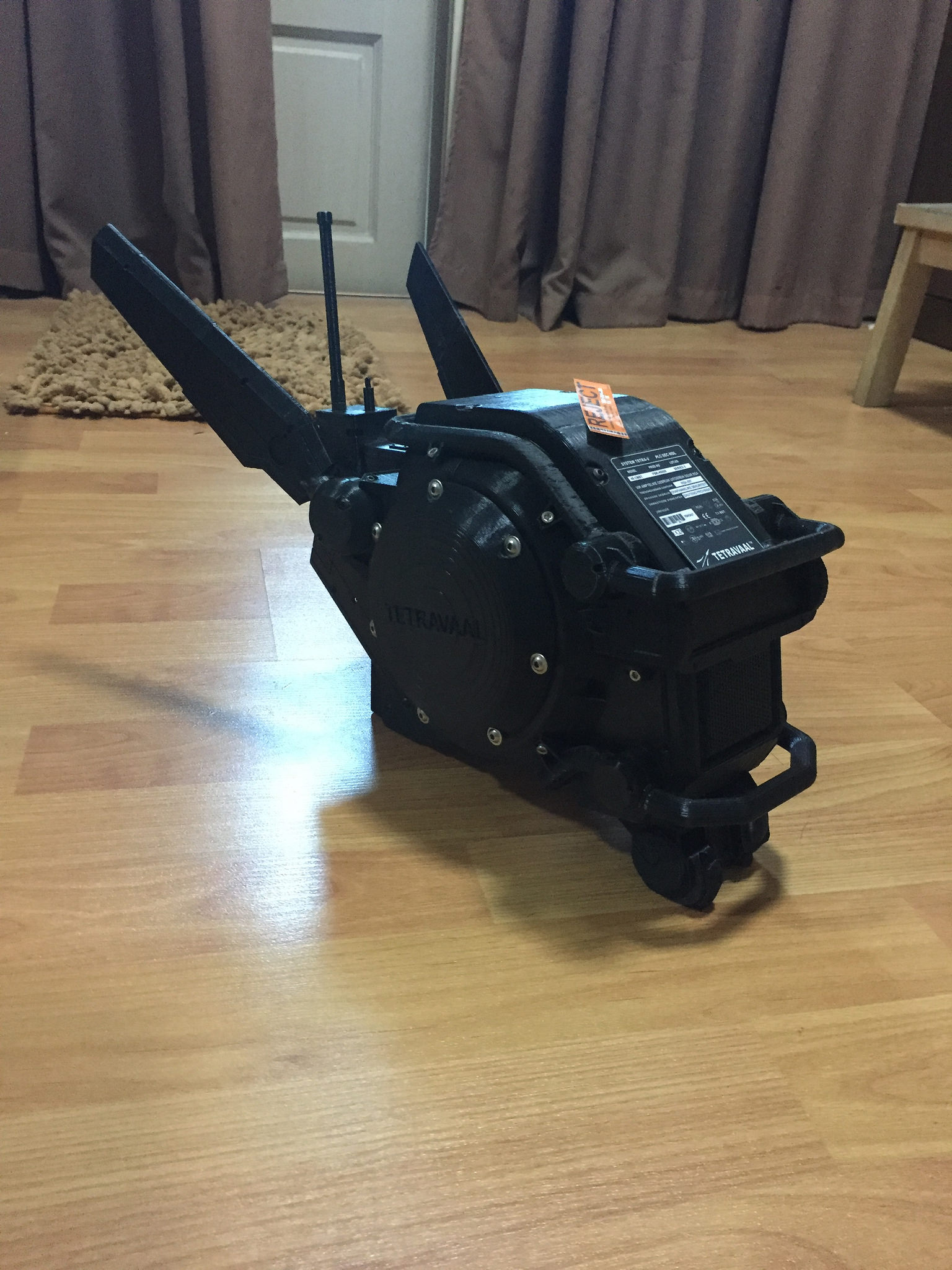

This is a project that I have been wanting to do for a while now, and have been inspired by amuelb's awesome build to get started. I purchased the 3D files from fellow member Razmataz, and have commissioned skynet23 to print it.

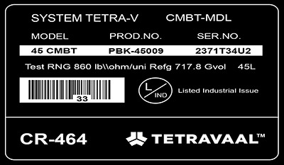

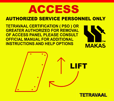

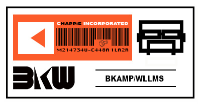

Whilst it is printing, I have been researching the head stickers and was lucky to obtain the front data plate from amuelb, which is perfect.

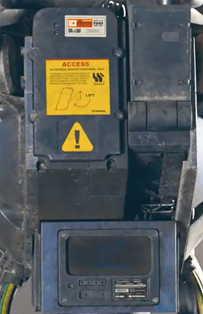

I have been trying to use the actual scout build, but have also had to refer to the 3D model too. I am 99% done on the designs I have done with maybe a bit more tweaking to do on the BW sticker:
I have some time now to work on the lighting options for the head and paint tests, and will post my development of this shortly.
Scott

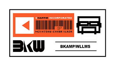

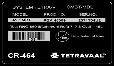

All lighting ordered, so did some minor improvements to the stickers:
The sticker which bothered me the most was the BW one, and I spent hours trying to research it in order to replicate it as accurate as possible. I was so happy when Christian Pearce the senior concept artist at Weta responded. I wasn't too far off as you can see:
I am SOOOO excited to see this come together!
You're stickers were really accurate. I am excited to get them printed out :)
Thanks Amy!

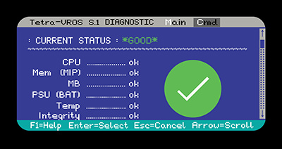

I am not 100% happy with using standard LED's for the eyes, as even the 3mm LED's pulling 2.5V appear too bright. I have asked a friend who is familiar with OLED display modules to have a go at replicating the eyes. I have the dimensions of 88mm x 24mm for the eye frame to work with, and this ratio of 3:11 fitted perfectly with the screen stills of Chappie.
As such I was able to use screen shots to replicate the eye dimensions from the 88mm x 24mm frame, which gave me the following (+-0.5mm):

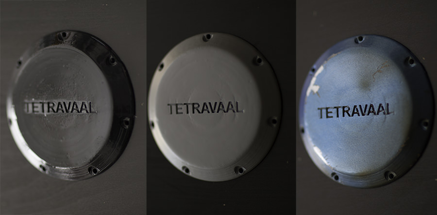

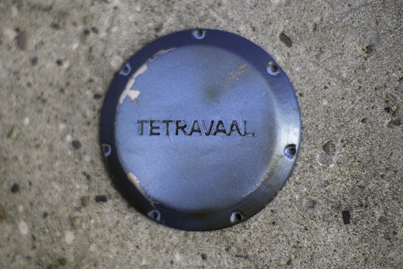

Had some free time this weekend, and with everything in hand, I did a paint test.
A layer of XTC-3D, a layer of ProXL Build Primer, layer of Tamiya Silver Leaf, layer of metallic blue and some airbrush weathering with raw umber. I could have done with a second layer of XTC, but have learned for the other parts...
