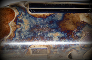

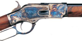

I'm currently doing a project with pot metal (maybe zinc?) and aluminum. It's actually a Sidkit Mal Pistol. When I was thinking about how I wanted the finish I thought that case hardened finish you see on old western gun would look really good. Unfortunately I'm not working with steel. Does anyone have any suggestions on how to accomplish this?

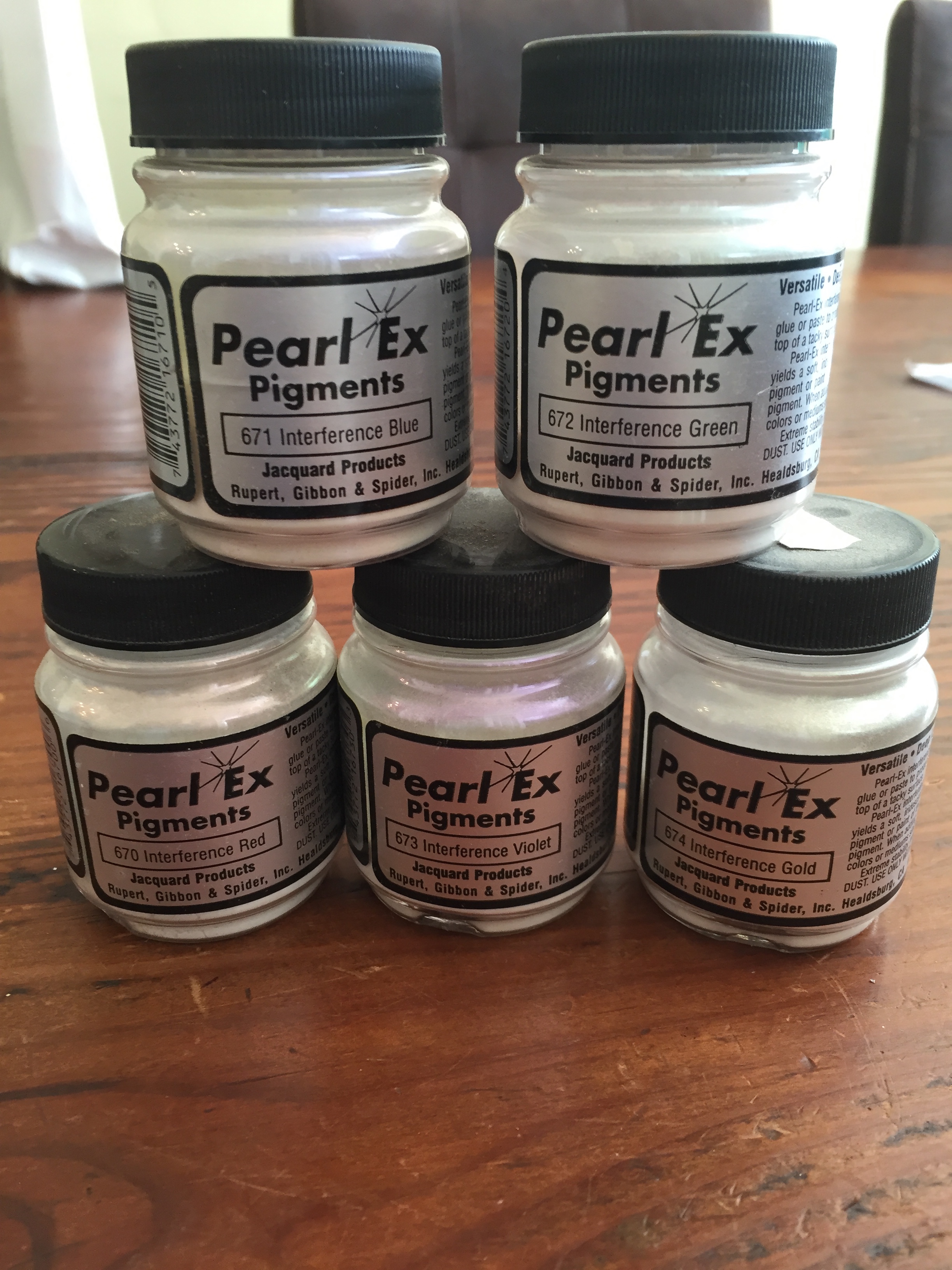

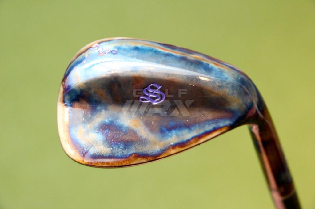

A method I've seen used for that "hot metal" look works great, but is rather complicated. The method uses interference paints. This is the type of paint you see on fancy cars where the color shifts as you move around the car. Here are some hobby sized pigments.
To apply, you mix the different interference color powders in clear paint and apply different colors with an airbrush in layers, alternating with a layer of diluted black paint as well.
It takes a while to apply all the layers to build the look, but it looks great when done well.

Very interesting. Do you have a pictures of your work?
I've never airbrushed before. Would you say there is a big learning curve?
Not at all, especially for the effect you're trying to replicate. It's basically color patch blending, sounds technical, but it's not.
You basically have to see the base, the layers and start from there. It is more than possible to render metal like finishes using paint and an airbrush
If you've never used an airbrush before, yes there is a learning curve, but you're not trying to render photo realistic air brush work, so the learning curve for this type of work is not steep.
Plus, once you know how to use an airbrush, the application of that (even basic) knowledge is limitless.
