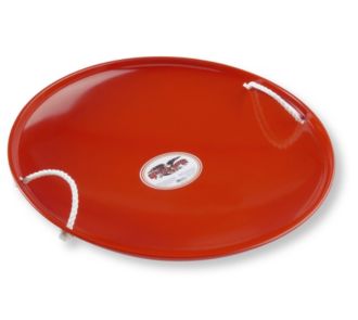

I have a tutorial saved on one of my computers for doing the shield which i too plan to start this summer and this is what the creator suggested as a base for the shield
http://www.amazon.com/Flexible-Flyer-826-Steel-Saucer/dp/B0006N8WYM
hope that helps as a start to such an iconic piece
I thought about using a sled for the shield, but half of the point of this project is to get some experience with fiberglass with a relatively simple shape.
It's hard to tell from the picture, but if that sled has the right curvature it would be almost perfect. I'm excited to see how yours turns out.

you could try this as a base as most of it is already done, though I see someone above already listed a source for this.
http://www.llbean.com/llb/shop/43608?pi=753121&qs=3012739-Google_Base&subrnd=0

That sled is really tempting, I'll probably go with it if the fiberglassing doesn't work out. Though I am afraid I'd have to go through several before I cut one that was even close to round, and that could get expensive pretty quick.
