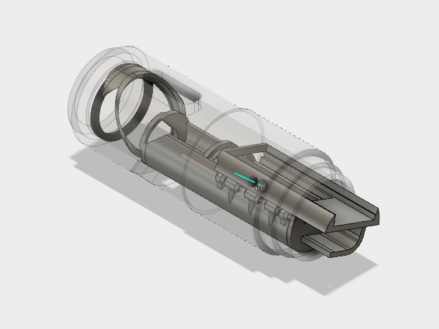

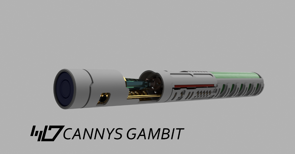

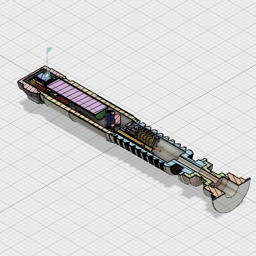

Im really lovin the shared stunt run and that's nearing completion so I thought I would make a chassis to hold a 18650 battery, sound board a spark 2/spark colour/I2 or a Nano biscotti, speaker and recharge port. Then a Chamber that will fit above it. Im just waiting to get hold of the Spirits shared stunt to go further.
I have got Korbanths K4 also so thats in hand and have started planning that out.

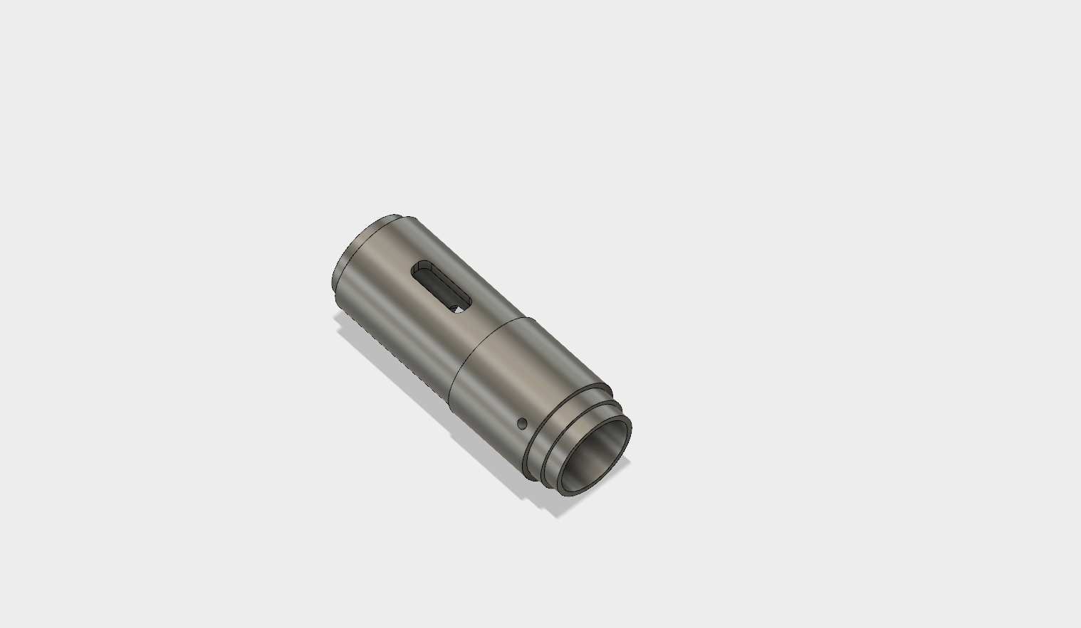

Ok I have remade the main body of the Obi shared stunt and will continue tonight. After measuring my estimated design that I made from the plan views available on the run thread Im a little out on the length but the width is spot on I will use the little grubb screw to hold the chassis in place, nice work ob1/ people that made the original prop. Makes it easier for me :)

for those interested i ordered a NB4 to build a compatible one for that too. im also making a chassis for Randy's K4. I want to be able to send off the shared stunt and K4 at the same time so I can save a bit on shipping to NZ.
K4 top section
I have the Shared stunt ready to print, not done anything since above just need to make sure the the blue center line is in the correct spot for the grub screw on the saber so it will lock it in place which will help align and lock the future crystal chamber in place.

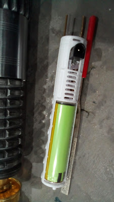

here is the K4
Now that the chassis is printed I'm pretty pleased with the print. There are a few details I will need to change, and now that I have discussed some of the design features with a friend I will tweak them also.
The back channel of the print allows for wiring
The battery clips in nicely to the print and holds it well, just need to tweak the alignment.
The spark 2 fits, some modification for ease of wiring is needed.
I will need to drill out part of the grenade section to allow for the the charge port under the rear hole in the clamp section, I might change to a smaller recharge port also.

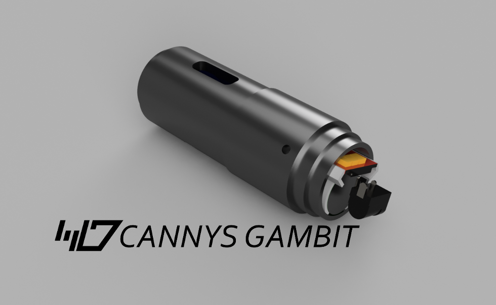

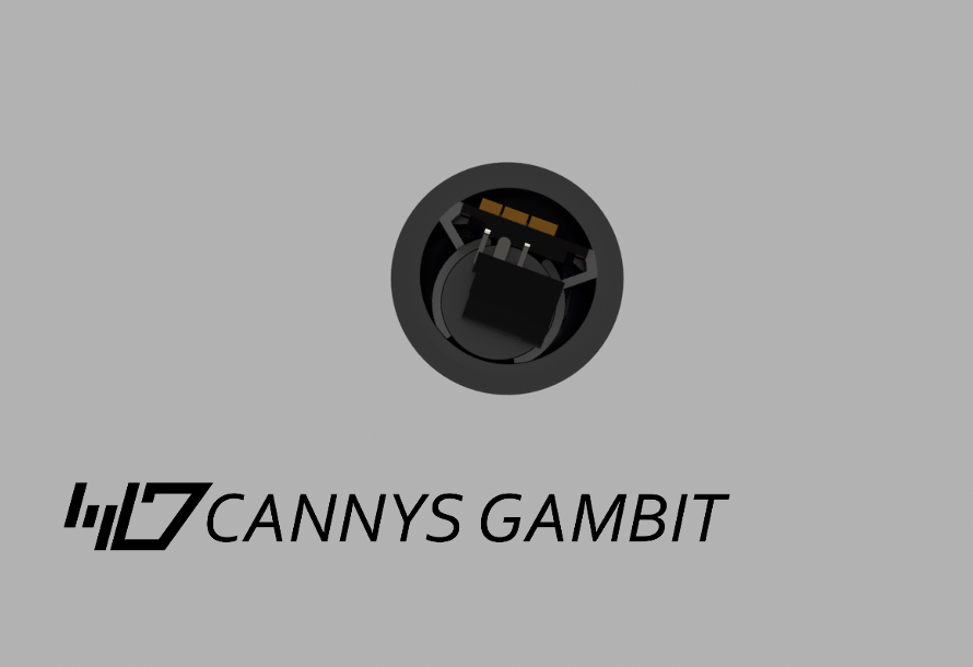

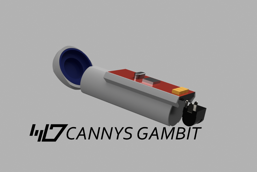

Lower section of the K4, almost finished work on the lower chassis, I would like to see how its working once printed before I add a few atheistic details. I have moved the recharge port to the lower chassis and made it a 1.3mm instead of a 2.1. Speaker housing should fit nicely.
SS is almost ready just need to design a wire run that will fit under speaker, and design some aesthetics which hold it all together.
Luke_shared_stunt_2017-Jun-02_09.pngLuke_shared_stunt_2017-Jun-02.pngLuke_shared_stunt_2017-Jun-02_09angle.png
As you can see its a snug fit inside the main body and I have kept the grub screw on the side to help hold the chamber in place. I will add the end cap which will cover the sound card , hold the recharge port, and stop the battery coming out. this will look much the same as the original design. at the speaker end It has a 4mm bigger area which will increase the quality of the sound, the main body cut outs fit nicely for optimal venting. After I get back from my over night hike I will print this off too and get some pics up.
